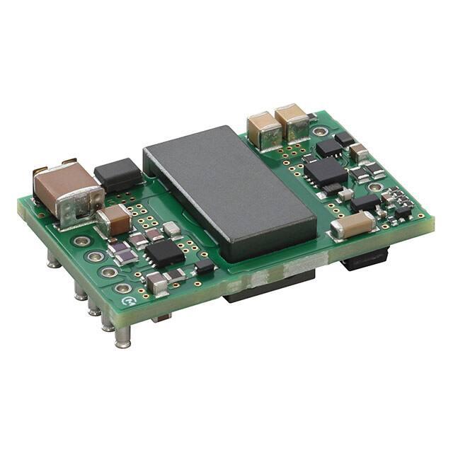

MYBSP0122BABFT / MYBSP0055AABFT Isolated DC-DC converter for PoE PD Typical unit PRODUCT OVERVIEW FEATURES Support IEEE802.3at class4 25.5W DC-DC converter Support Type2 PSE Indicator Support Adapter ORing 37-57V Input Voltage range 22.4 x 35.5 x 10.55mm Size 92.5% efficiency (typical, 12Vout) Surface mount module 2250Vdc Input-Output Isolation Operating Temperature range -40 to +85 °C RJ-45 The MYBSP0122BABFT / MYBSP0055AABFT is an isolated, regulated, DCDC converter for PoE PD that has an input range of 37-57Vdc with a typical efficiency of 92.5%(12Vout), and full 2250 Volt DC isolation. The MYBSP0122BABFT / MYBSP0055AABFT is ideal for IEEE 802.3at Compliant Devices. Module has self-protection features. These include input undervoltage lockout and output current limit. The outputs current limit is using the hiccup autorestart technique. And the module has detection and classification for compliant IEEE802.3at. MYBSP0122BABFT / MYBSP0055AABFT has three additional pins for Type2 PSE Indicator and Adapter ORing compared to MYBSP0122BABF/ MYBSP0055AABF. MYBSP0122BABFT / MYBSP0055AABFT 1 Data +Vin +Vout T2P indicator 2 UTP Cable 3 To PSE Power + Data Data -Vout -Vin 6 PD controller and Flyback controller •Hot swap •PoE detection and classification 4 Optocoupler Vout Detection 5 DEN 7 T2P VC Option1: Type2 PSE Indicator 8 Option2: Adapter ORing Adapter Figure 1. Simplified Block Diagram Typical topology is shown. http://www.murata.com/products/power Export Control Code : X0863 Document No : D90DH - 00043 MYBSP0122BABFT / MYBSP0055AABFT A01 Page 1 of 16 MYBSP0122BABFT / MYBSP0055AABFT Isolated DC-DC converter for PoE PD PERFORMANCE SPECIFICATIONS SUMMARY AND ORDERING GUIDE Output Input Vin Vout Iout Power R/N Max. Regulation Typ. Nom. (Vdc) (A,Max.) (W) (mVp-p) Line (%) Load (%) (Vdc) Model Number Range (Vdc) Iin, no Iin, full load load Typ.(mA) Typ.(A) Efficiency (%) Min. Typ. MYBSP0122BABFT 12 2.125 25.5 150 ±0.1 ±0.1 48 37-57 3 0.57 90 92.5 MYBSP0055AABFT 5 5.1 25.5 150 ±0.1 ±0.1 48 37-57 5 0.59 88 90.5 A B Package (mm) 22.4 x 35.5 x 10.55 1. Please refer to the Part Number Structure for additional ordering information and options. 2. All specifications are at nominal line voltage, full load, +25°C unless otherwise stated. PART NUMBER STRUCTURE MY BSP 012 2B F T Option Code T = Support T2P and Adapter ORing MURATA Standard DC-DC Convertor Internal Control Code Isolated DC-DC Convertor for PoE PD IEEE802.3xx Pin Type B = Surface mount pin Output Voltage 012 = 12V 005 = 5V Nominal Input Voltage A = 48V nominal Output Current 2B = 2.125A 5A = 5.1A Product Marking Layout Top View Codes MFG ID Model Number Internal Manufacturing Code 1Pin http://www.murata.com/products/power MYBSP0122BABFT / MYBSP0055AABFT A01 Page 2 of 16 MYBSP0122BABFT / MYBSP0055AABFT Isolated DC-DC converter for PoE PD FUNCTIONAL SPECIFICATIONS, MYBSP0122BABFT ABSOLUTE MAXIMUM RATINGS Input Voltage, Continuous Input Voltage, Transient Isolation Voltage Output Power Conditions 100ms max. duration Input to output, Leak current 1mA max for 1minute at +25°C/60%RH. Minimum 0 Typical / Nominal Maximum 57 60 Units Vdc Vdc 2250 Vdc 0 25.5 W Current-limited, no damage, short-circuit Output Current 0 2.125 A protected °C Storage Temperature Range Vin = Zero (no power) -40 90 Absolute maximums are stress ratings. Exposure of devices to greater than any of these conditions may adversely affect long-term reliability. Proper operation under conditions other than those listed in the Performance/Functional Specifications Table is not implied or recommended. INPUT Operating Voltage Range 37 48 57 Vdc Start-up threshold Rising input voltage 36.1 40.2 Vdc Undervoltage shutdown Falling input voltage 30.3 33.8 Vdc Internal Filter Type Pi Input current Full Load Conditions Vin = nom., Iout = max 0.57 A Low Line Input current Vin = min., Iout = max. 0.64 A No Load Current Vin = nom., Iout = 0A. 3 mA On Resistance of Internal Hotswap 0.45 Ω Resistance for detection Vin=2.7 to 10.1V 24.9 kΩ Classification current Vin=14.5 to 20.5V 40 mA GENERAL and SAFETY Efficiency Vin = 48V, full load 90 92.5 Isolation Input to output, Leak current 1mA max Isolation Voltage 2250 Vdc for 1minute at +25°C/60%RH. Insulation Safety Rating Functional Isolation Capacitance 1500 pF Telcordia SR-332, issue 1, class 3, Calculated MTBF 2476 Hours x 103 ground fixed, Ta = +25°C DYNAMIC CHARACTERISTIC Fixed Switching Frequency *1 Iout = max 220 kHz Vout Rise Time From 10%-90% of Vout 10 ms Dynamic Load Response 50-100-50% load step to 1% of Vout 150 μSec ±200 Dynamic Load Peak Deviation same as above mVdc http://www.murata.com/products/power MYBSP0122BABFT / MYBSP0055AABFT A01 Page 3 of 16 MYBSP0122BABFT / MYBSP0055AABFT Isolated DC-DC converter for PoE PD FUNCTIONAL SPECIFICATIONS, MYBSP0122BABFT(CONT.) OUTPUT Total Output Power Voltage Nominal Output Voltage Overvoltage Protection Current Output Current Range *2 Current Limit Inception Short circuit protection method Regulation Line Regulation Load Regulation Ripple and Noise Temperature Coefficient Maximum Capacitive Loading T2P / VC / DEN T2P Sinking Current VC Output Voltage DEN Output Voltage Output Current Disable Voltage MECHANICAL Outline Dimensions Weight Pin Diameter Pin Material ENVIRONMENTAL Operating Ambient Temperature Range Storage Temperature Thermal Protection/Shutdown Electromagnetic Interference Conducted, EN55022/CISPR22 RoHS rating Conditions Minimum 0 Typical / Nominal Maximum 25.5 Units W all conditions 11.64 12 None 12.36 Vdc Vdc 2.125 A A Hiccup current limiting Vin=min. to max., Vout=nom., full load Iout = min. to max. 150 MHz BW, Cout=1μF MLCC paralleled with 10μF At all outputs Low ESR 0 2.2 Non-latching ±0.1 ±0.1 0 ±0.02 After 2 event classification, T2P connect to VC 1.2 After start up 8.5 DEN=open DEN connect to -Vin Falling LxWxH External filter is required 150 mV pk-pk 400 % of Vout/°C μF mA 12 V +Vin 5 2.8 V mA V 22.4 x 35.5 x 10.55 13.1 1.57 Copper alloy -40 Vin = Zero (no power) Measured at hotspot % of Vout % of Vout -40 None B mm Grams mm 85 °C 90 °C °C Class RoHS-6 Specification Notes Unless otherwise noted, all specifications are typical at nominal input voltage, nominal output voltage and full load. General conditions are +25°C ambient temperature, near sea level altitude, natural convection airflow. All models are tested and specified with external parallel 0.1μF and 10μF output capacitors (See Technical Notes). *1 Variable frequency operation at light load. *2 Input current must be greater than or equal to 10mA if your application applies Maintain Power Signature(MPS) by IEEE802.3at. Please check with your application. http://www.murata.com/products/power MYBSP0122BABFT / MYBSP0055AABFT A01 Page 4 of 16 MYBSP0122BABFT / MYBSP0055AABFT Isolated DC-DC converter for PoE PD PERFORMANCE DATA, MYBSP0122BABFT Efficiency vs. Line Voltage and Load Current (Ta=+25°C) Load Regulation (Ta=+25°C) Vout Start-up (Vin=48V, Iout=2.125A, Ta=+25°C) Output Ripple and Noise (Vin=48V, Iout=2.125A, Ta=+25°C) 5V/div 10ms/div Transient Response (Vin=48V, Iout=1.06A to 2.125A, Ta=+25°C) Ch2=Vout, 200mV/div, Ch4=Iout, 1A/div 400μs/div 50mV/div 4μs/div Transient Response (Vin=48V, Iout=2.125A to 1.06A, Ta=+25°C) Ch2=Vout, 200mV/div, Ch4=Iout, 1A/div 400μs/div http://www.murata.com/products/power MYBSP0122BABFT / MYBSP0055AABFT A01 Page 5 of 16 MYBSP0122BABFT / MYBSP0055AABFT Isolated DC-DC converter for PoE PD PERFORMANCE DATA, MYBSP0122BABFT(CONT.) Conduction Noise (Vin=48V, Iout=2.125A, Ta=+25°C) with External Input Filter Thermal Derating Unit under test (UUT) is covered by acrylic box to avoid airflow. (Vin=42.5-57V, See Technical Notes) http://www.murata.com/products/power MYBSP0122BABFT / MYBSP0055AABFT A01 Page 6 of 16 MYBSP0122BABFT / MYBSP0055AABFT Isolated DC-DC converter for PoE PD FUNCTIONAL SPECIFICATIONS, MYBSP0055AABFT ABSOLUTE MAXIMUM RATINGS Input Voltage, Continuous Input Voltage, Transient Isolation Voltage Output Power Conditions 100ms max. duration Input to output, Leak current 1mA max for 1minute at +25°C/60%RH. Minimum 0 Typical / Nominal Maximum 57 60 Units Vdc Vdc 2250 Vdc 0 25.5 W Current-limited, no damage, short-circuit Output Current 0 5.1 A protected °C Storage Temperature Range Vin = Zero (no power) -40 90 Absolute maximums are stress ratings. Exposure of devices to greater than any of these conditions may adversely affect long-term reliability. Proper operation under conditions other than those listed in the Performance/Functional Specifications Table is not implied or recommended. INPUT Operating Voltage Range 37 48 57 Vdc Start-up threshold Rising input voltage 36.1 40.2 Vdc Undervoltage shutdown Falling input voltage 30.3 33.8 Vdc Internal Filter Type Pi Input current Full Load Conditions Vin = nom., Iout = max 0.59 A Low Line Input current Vin = min., Iout = max. 0.67 A No Load Current Vin = nom., Iout = 0A. 5 mA On Resistance of Internal Hotswap 0.45 Ω Resistance for detection Vin=2.7 to 10.1V 24.9 kΩ Classification current Vin=14.5 to 20.5V 40 mA GENERAL and SAFETY Efficiency Vin = 48V, full load 88 90.5 Isolation Input to output, Leak current 1mA max Isolation Voltage 2250 Vdc for 1minute at +25°C/60%RH. Insulation Safety Rating Functional Isolation Capacitance 1500 pF Telcordia SR-332, issue 1, class 3, Calculated MTBF 2476 Hours x 103 ground fixed, Ta = +25°C, DYNAMIC CHARACTERISTIC Fixed Switching Frequency *1 Iout = max 220 kHz Vout Rise Time From 10%-90% of Vout 5 ms Dynamic Load Response 50-100-50% load step to 1% of Vout 150 μSec ±100 Dynamic Load Peak Deviation same as above mVdc http://www.murata.com/products/power MYBSP0122BABFT / MYBSP0055AABFT A01 Page 7 of 16 MYBSP0122BABFT / MYBSP0055AABFT Isolated DC-DC converter for PoE PD FUNCTIONAL SPECIFICATIONS, MYBSP0055AABFT(CONT.) OUTPUT Total Output Power Voltage Nominal Output Voltage Overvoltage Protection Current Output Current Range *2 Current Limit Inception Short circuit protection method Regulation Line Regulation Load Regulation Ripple and Noise Temperature Coefficient Maximum Capacitive Loading T2P / VC / DEN T2P Sinking Current VC Output Voltage DEN Output Voltage Output Current Disable Voltage MECHANICAL Outline Dimensions Weight Pin Diameter Pin Material ENVIRONMENTAL Operating Ambient Temperature Range Storage Temperature Thermal Protection/Shutdown Electromagnetic Interference Conducted, EN55022/CISPR22 RoHS rating Conditions Minimum 0 Typical / Nominal Maximum 25.5 Units W all conditions 4.85 5 None 5.15 Vdc Vdc 5.1 A A Hiccup current limiting Vin=min. to max., Vout=nom., full load Iout = min. to max. 150 MHz BW, Cout=1μF MLCC paralleled with 10μF At all outputs Low ESR 0 5.3 Non-latching ±0.1 ±0.1 0 ±0.02 After 2 event classification, T2P connect to VC 1.2 After start up 8.5 DEN=open DEN connect to -Vin Falling LxWxH External filter is required 150 mV pk-pk 400 % of Vout/°C μF mA 12 V +Vin 5 2.8 V mA V 22.4 x 35.5 x 10.55 13.1 1.57 Copper alloy -40 Vin = Zero (no power) Measured at hotspot % of Vout % of Vout -40 None B mm Grams mm 85 °C 90 °C °C Class RoHS-6 Specification Notes Unless otherwise noted, all specifications are typical at nominal input voltage, nominal output voltage and full load. General conditions are +25°C ambient temperature, near sea level altitude, natural convection airflow. All models are tested and specified with external parallel 0.1μF and 10μF output capacitors (See Technical Notes). *1 Pulse skip operation at light load. *2 Input current must be greater than or equal to 10mA if your application applies Maintain Power Signature(MPS) by IEEE802.3at. Please check with your application. http://www.murata.com/products/power MYBSP0122BABFT / MYBSP0055AABFT A01 Page 8 of 16 MYBSP0122BABFT / MYBSP0055AABFT Isolated DC-DC converter for PoE PD PERFORMANCE DATA, MYBSP0055AABFT Efficiency vs. Line Voltage and Load Current (Ta=+25°C) Load Regulation (Ta=+25°C) Vout Start-up (Vin=48V, Iout=5.1A, Ta=+25°C) Output Ripple and Noise (Vin=48V, Iout=5.1A, Ta=+25°C) 2V/div 10ms/div Transient Response (Vin=48V, Iout=2.55A to 5.1A, Ta=+25°C) Ch3=Vout, 200mV/div, Ch4=Iout, 2A/div 200μs/div 50mV/div 4μs/div Transient Response (Vin=48V, Iout=2.55A to 5.1A, Ta=+25°C) Ch3=Vout, 200mV/div, Ch4=Iout, 2A/div 200μs/div http://www.murata.com/products/power MYBSP0122BABFT / MYBSP0055AABFT A01 Page 9 of 16 MYBSP0122BABFT / MYBSP0055AABFT Isolated DC-DC converter for PoE PD PERFORMANCE DATA, MYBSP0055AABFT(CONT.) Conduction Noise (Vin=48V, Iout=5.1A, Ta=+25°C) with External Input Filter Conduction Noise (Vin=48V, Iout=5.1A, Ta=+25°C) with External Input Filter Thermal Derating Unit under test (UUT) is covered by acrylic box to avoid airflow. (Vin=42.5-57V, See Technical Notes) http://www.murata.com/products/power MYBSP0122BABFT / MYBSP0055AABFT A01 Page 10 of 16 MYBSP0122BABFT / MYBSP0055AABFT Isolated DC-DC converter for PoE PD MECHANICAL SPECIFICATIONS Bottom View 11.43±0.25 (2.53) Top View 6 7 (18.8) 35.5±0.5 30.44±0.25 Pickup area Φ8.0 5 4 3 2 P P P (10.0) 22.4±0.5 1 (3.58) (8.85) (4.85) 10.55±0.6 15.24±0.25 P=3.0±0.25 Tolerance of “P” should not be accumulated. 0.15 Pin 1 2 3 4 5 6 7 [Unit:mm] INPUT / OUTPUT CONNECTIONS Designation Function +Vin Positive Input Voltage DEN Detection and Enable T2P Type-2 PSE Indicator VC Controller Voltage -Vin Negative Input Voltage -Vout Negative Output Voltage +Vout Positive Output Voltage Pin size Φ1.57 Φ1.57 Φ1.57 Φ1.57 Φ1.57 Φ1.57 Φ1.57 RECOMMENDED FOOTPRINT (TOP VIEW) 35.5±0.5 30.5 7-2.2×2.8 R1.0 Only GND pattern for primary side 8 11.43±0.25 P P P 15.24±0.25 22.4±0.5 4 P=3.0±0.25 Tolerance of “P” should not be accumulated. 30.44±0.25 Keep out area for Isolation barrier [Unit : mm] http://www.murata.com/products/power MYBSP0122BABFT / MYBSP0055AABFT A01 Page 11 of 16 MYBSP0122BABFT / MYBSP0055AABFT Isolated DC-DC converter for PoE PD PACKAGING INFORMATION (SURFACE MOUNT, MSL Rating 2) Packaging form The products are placed in the Emboss Tape as below 1Pin Pulling Direction 57.5 φ100 φ330 A 2.0 φ21.0 Indication φ13.0 [Unit:mm] Detail A http://www.murata.com/products/power MYBSP0122BABFT / MYBSP0055AABFT A01 Page 12 of 16 MYBSP0122BABFT / MYBSP0055AABFT Isolated DC-DC converter for PoE PD PACKAGING INFORMATION (SURFACE MOUNT, MSL Rating 2) Packaging form Taping Specification Epmty portion (200mm MIN) Epmty portion (180mm MIN) Leader portion (200mm MIN) "Module on tape" portion Indication 1. 2. 3. 4. 5. 6. The adhesive strength of the protective tape must be within 0.1-1.3N. Each reel contains 100 pcs. Each reel set in moisture-proof packaging because of MSL Rating 2. The deficiency per reel is 0 piece. The reel shows customer part number, Murata part number and quantity. The color of reel is not designated. Aircap Aluminum packing for moisture-proof Aircap Inner Box Label Remark Marking on the box and real 1.MURATA Parts Number 2.Quantity 3.No./Inspection No. 4.ROHS -Y http://www.murata.com/products/power MYBSP0122BABFT / MYBSP0055AABFT A01 Page 13 of 16 MYBSP0122BABFT / MYBSP0055AABFT Isolated DC-DC converter for PoE PD TECHNICAL NOTES Over Current Protection Over Current Protection operates with a controller circuit failure or over-load condition, and DC-DC converter will enter hiccup mode. After rejected the abnormal mode, DC-DC converter will automatically restart. External Input Capacitor Do not connect any capacitor between positive input and negative input to avoid large inrush current. It is one of the requirements of IEEE802.3at standard. Test Circuit The initial values in Functional Specification are measured in the following test circuit. 1 10mΩ v Vin +Vout +Vin v 2 -Vout -Vin -Vin v Ripple Noise Test Output ripple noise is measured using designated external output components, circuits and layout as shown below. 50mm C2 : Ceramic Capacitor 0.1μF C3 : Ceramic Capacitor 10μF C3 VC Type2 PSE Indicator -Vout PC1 When deviating from the above, DC-DC converter may operate abnormally. It should be fully confirmed on your board before use. C2 R1 3.3kohm T2P 3 C1 : Ceramic Capacitor 0~400μF RL : Electronic Load Device : LN-1000A-G7 KEISOKU GIKEN equivalent Vin : DC Power Supply :Model HP6675A KEYSIGHT equivalent V : Digital Multimeter :Model HP34401A KEYSIGHT equivalent DC-DC Converter 3.3kohm RL v LOAD +Vout 8.5Vtyp 10mΩ C1 MYBSP0122BABFT / MYBSP0055AABFT +Vin 4 DC-DC Convertor Type2 PSE Indicator T2P(Pin3) is open drain output. After 2 event classification, MYBSP0122BABFT / MYBSP0055AABFT pulls T2P low. Please pull up T2P by VC(Pin4). VC is source only for T2P. Do not apply VC for any other purpose. Appropriate board design for isolation barrier is required(Opto-coupler selection and Isolation distance). Also consider CTR of Opto-coupler which may affect value of R1. Keep T2P and VC open if you don’t apply this function. Typical application circuit is below. Terminating resistance TRC-50F LOAD Isolation barrier Example R1: MYBSP0122BABFT: 33kohm 0.1W MYBSP0055AABFT: 15kohm 0.1W PC1: TLP293(GRH (TOSHIBA) Classification 1-event 2-event Type2 PSE Indicator High Low Adapter ORing DEN(Pin2) handles Enable / Disable of MYBSP0122BABFT / MYBSP0055AABFT. In case of applying external power output by adapter, MYBSP needs to be disable. Connecting DEN to –Vin disable MYBSP. There is limitation for voltage from adapter. Please see chart next page. Keep open if you don’t use this function. Typical application circuit is below. Oscilloscope Coaxial cable 1.5m50Ω BW=150MHz Conduction Noise The external input filter is installed and the circuit diagram is shown below. 20000pF Resistive load 68μH 48V LISN (KNW407) DC-DC Converter Input External Common mode choke : PE-53913NL(Pulse) 20000pF http://www.murata.com/products/power MYBSP0122BABFT / MYBSP0055AABFT A01 Page 14 of 16 MYBSP0122BABFT / MYBSP0055AABFT Isolated DC-DC converter for PoE PD Limitation for adapter voltage P/N MYBSP0122BABFT MYBSP0055AABFT Acceptable voltage range from Adapter at Vout of MYBSP 10.0 – 12.8V 4.5 – 5.05V Thermal Derating Condition The output current is limited by the derating curve. The derating curve in this datasheet illustrate typical operation under a variety of conditions. DC-DC Converter is tested on a 101.6x188mm, 2 layers Copper evaluation board at Vin=48V. The Unit Under Test (UUT) is set up as shown below. UUT is covered by acrylic box to avoid airflow. The temperature measurement points are shown below table. The temperature of measurement points should not exceed the maximum temperatures in the below table. Position P1 P2 P3 P4 Description FET FET Opto-coupler Transformer pattern Max temperature TP1MAX = 124°C TP2MAX = 124°C TP2MAX = 105°C TP3MAX = 125°C Detection and Hardware Classification DC-DC converter implements IEEE 802.3at compliant detection and hardware classification. When DC-DC converter(PD) is connected to PSE, the PSE applies two voltages in the range of 2.8 V to 10 V and measures the corresponding current. Connection to PD is detected by measured current.(Detection) After Detection, the PSE applies voltage in the range of 15.5 V to 20.5 V and measures the corresponding current. PD is classified by measured current.(Hardware Classification) Please check with your application. SMT Reflow Soldering Guidelines The surface-mount reflow solder profile is shown below. This graph should be used only as a guideline. Reflow Soldering Profiles : JEDEC IPC/JEDE J-STD-020D Soldering temperature Soldering time Heating time Preheat time Programming rate Descending rate Total soldering time Time 245°C +0/-5°C 30 seconds, 240°C-245°C 60~150 seconds, 217°C min. 60~120 seconds, 150°C-200°C 3°C /sec.max., 217°C-245°C 6°C /sec.max. 8 minutes max.,25°C-245°C 1time P1 (FET) 245℃ P3 (Opto-coupler) 217℃ 200℃ P4 (Transformer pattern) 150℃ P2 (FET) 1Pin Top View 60-150 seconds 60-120 seconds 1Pin Bottom View Times Do not vibrate for the products on reflow. Please need to take care temperature control because mounted parts may come off if the product is left under the high temperature. Do not mount on backside of the board. Many other factors influence the success of SMT reflow soldering. Since your production environment may differ, please thoroughly review these guidelines with your process engineers. 101.6mm 188.0mm 1Pin Acrylic box Unit Under Test (UUT) http://www.murata.com/products/power MYBSP0122BABFT / MYBSP0055AABFT A01 Page 15 of 16 MYBSP0122BABFT / MYBSP0055AABFT Isolated DC-DC converter for PoE PD Functional Specifications Please contact Murata Sales before using this product for the applications listed below. These are applications that require very high reliability of prevention of defects which might directly cause damage to third party’s life, body, or property. 1. Aircraft equipment 2. Aerospace equipment 3. Undersea equipment 4. Power plant control equipment 5. Medical equipment 6. Transportation equipment (cars, buses, trucks, trains, ships, etc.) 7. Traffic signal equipment 8. Disaster prevention /crime prevention equipment 9. Data-processing equipment 10. Application of similar complexity and /or reliability listed as above. Storage Please store this product in an environment where the temperature/humidity is stable in the range 0 to 40°C/10 to 75%RH and no direct sunlight. Use the product within 6 months after delivery. Please avoid storage conditions where humidity and temperature change rapidly, as that may cause condensation on the product, which might degrade the quality of the product. Please do not store the product environments that are dusty, in direct exposure to sea breeze, or in an atmosphere containing corrosive gas (Cl2, NH3, SO2, NOX and so on). Operational environment and operational conditions This product is not chemical-proof or rust-proof. In order to prevent this product from leakage of electricity and/or abnormal temperature increase, do not use the product under the following circumstances: (1) in an atmosphere containing corrosive gas (Cl2, NH3, SO2, NOX and so on). (2) in a dusty place. (3) in a place exposed to direct sunlight. (4) in such a place where water splashes or in such a humid place where water condenses. (5) in a place exposed to sea breeze. (6) in any other places similar to the above (1)through (5). Operational Conditions Please use the product within specified values (power supply, temperature, input, output and load condition etc.). Input voltage drops for line impedance, so please make sure that input voltage is within in specified values. If the product is used over the specified values, it may damage the product, reduce the quality, and even if the products can endure the condition for short time, it may cause degradation of the reliability. Note Prior to use If you apply high static electricity, voltage higher than rated voltage or reverse voltage to the product, it may cause defects in the products or degrade the reliability. Please avoid the following items: 1. Over rating power supply, reverse power supply or not-enough connection of input voltage and 0V(DC)line 2. Electrostatic discharge by production line and/or operator 3. Electrified product by electrostatic induction Do not subject product to excessive mechanical shock. If you drop the product on the floor it might cause a crack to the core of inductors and monolithic ceramic capacitors. Also please pay attention to handling; the mounted parts can be dislodged if subjected to excessive force. Transportation If you transport the product, please pack it so that the package will not be damaged by mechanical vibration or mechanical shock, and please educate and guide the carrier to prevent rough handling. Note 1. Please make sure that the product has been evaluated and confirmed against your specifications when it is mounted to your product. 2. All the items and parameters in this product specification have been prescribed on the premise that our product is used for the purpose, under the conditions and in the environment agreed upon between you and us. You are requested not to use our product deviating from such agreement. 3. We consider it not appropriate to include other terms and conditions for transaction warranty in product specifications, drawings or other technical documents. Therefore, if your technical documents as above include such terms and conditions as warranty clause, product liability clause, or intellectual property infringement liability clause, we will not be able to accept such terms and conditions unless they are based on the governmental regulation or they are stated in a separate contract agreement. ! This product is subject to the following operating requirements and the Life and Safety Critical Application Sales Policy: Refer to: https://power.murata.com/en/requirements Murata Manufacturing Co., Ltd makes no representation that the use of its products in the circuits described herein, or the use of other technical information contained herein, will not infringe upon existing or future patent rights. The descriptions contained herein do not imply the granting of licenses to make, use, or sell equipment constructed in accordance therewith. Spec and cautions are subject to change without notice. © 2018 Murata Manufacturing Co., Ltd http://www.murata.com/products/power Specifications are subject to change without notice. MYBSP0122BABFT / MYBSP0055AABFT A01 Page 16 of 16
MYBSP0055AABFT
物料型号: - MYBSP0122BABFT - MYBSP0055AABFT
器件简介: 这些是Murata公司生产的隔离型直流-直流转换器,专为PoE PD(Power over Ethernet Power Device)设计。它们支持IEEE802.3at标准,具有37-57V的输入电压范围和高达2250V的输入输出隔离电压。
引脚分配: - +Vin:正输入电压 - DEN:检测和使能 - T2P:Type-2 PSE指示器 - VC:控制器电压 - -Vin:负输入电压 - -Vout:负输出电压 - +Vout:正输出电压
参数特性: - 典型效率:92.5%(12V输出) - 工作温度范围:-40至+85°C - 输出功率:最高25.5W - 输出电流:MYBSP0122BABFT为2.125A,MYBSP0055AABFT为5.1A - 封装尺寸:22.4 x 35.5 x 10.55mm
功能详解: - 自我保护特性,包括输入欠压锁定和输出电流限制。 - 采用hiccup自动重启技术的输出电流限制。 - 支持Type2 PSE指示和适配器ORing。 - 符合IEEE802.3at标准,具有检测和分类功能。
应用信息: 这些转换器适用于符合IEEE802.3at标准的设备,例如网络摄像头、无线接入点等。
封装信息: - 表面安装模块 - 封装类型:SMD
