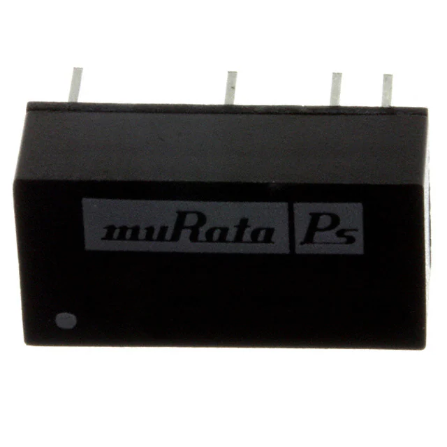

    CONV DC/DC 1W 12VIN 9VOUT DIP DL
NMA1209DC 数据手册
NMA 5V, 12V & 15V Series WWW.MURATA.COM Isolated 1W Dual Output DC-DC Converters Output Current Input Current at Rated Load Efficiency Isolation Capacitance MTTF1 V mA mA % pF kHrs FEATURES NMA0505DC NMA0512DC NMA0515DC NMA0505SC NMA0509SC NMA0512SC NMA0515SC NMA1205DC NMA1212DC NMA1215DC NMA1205SC NMA1209SC NMA1212SC NMA1215SC 5 5 5 5 5 5 5 12 12 12 12 12 12 12 ±5 ±12 ±15 ±5 ±9 ±12 ±15 ±5 ±12 ±15 ±5 ±9 ±12 ±15 ±100 ±42 ±33 ±100 ±55 ±42 ±33 ±100 ±42 ±33 ±100 ±55 ±42 ±33 289 260 256 289 267 260 256 120 111 110 120 113 111 110 69 77 78 69 75 77 78 69 75 76 69 74 75 76 28 34 36 28 32 34 36 33 55 54 33 46 55 54 3103 1579 1065 3103 2257 1579 1065 2193 1303 932 2193 1734 1303 932 „ Efficiency up to 80% „ Wide temperature performance at full 1 Watt load, –40°C to 85°C „ Dual output from a single input rail „ Industry standard pinout „ Power sharing on output „ 1kVDC isolation ‘Hi Pot Test’ „ 5V & 12V inputs „ 5V, 9V, 12V & 15V outputs NMA0509DC NMA1512SC NMA1515SC 5 15 15 ±9 ±12 ±15 ±55 ±42 ±33 267 87 84 75 78 80 32 68 84 2257 790 523 NMA1209DC NMA1505DC NMA1505SC NMA1512DC NMA1515DC 12 15 15 15 15 ±9 ±5 ±5 ±12 ±15 ±55 ±100 ±100 ±42 ±33 113 91 91 87 84 74 71 71 78 80 46 39 39 68 84 1734 1941 1941 790 523 Recommended Alternative Output Voltage V Order Code Package Style Nominal Input Voltage SELECTION GUIDE DIP SIP DIP SIP „ Internal SMD construction „ Fully encapsulated with toroidal magnetics DIP SIP MEA1D0509SC MEA1D1512SC MEA1D1515SC „ No external components required „ MTTF up to 3.1 million hours „ Pin compatible with NKA & MEA1 series „ No electrolytic or tantalum capacitors DIP SIP DIP NKA1209SC Contact Murata Contact Murata Contact Murata NMV1515SC DESCRIPTION The NMA series of industrial temperature range DC-DC converters are the standard building blocks for on-board distributed power systems. They are ideally suited for providing dual rail supplies on primarily digital boards with the added benefit of galvanic isolation to reduce switching noise. All of the rated power may be drawn from a single pin provided the total load does not exceed 1 watt. For full details go to https://www.murata.com/englobal/products/power/rohs INPUT CHARACTERISTICS Parameter Conditions Min. Typ. Max. Voltage range Continuous operation, 5V input types Continuous operation, 12V input types Continuous operation, 15V input types 4.5 10.8 13.5 5 12 15 20 5.5 13.2 16.5 40 Reflected ripple current Units V mA p-p 1. Calculated using MIL-HDBK-217FN2 calculation model with nominal input voltage at full load. All specifications typical at TA=25°C, nominal input voltage and rated output current unless otherwise specified. www.murata.com KDC_NMA.N01 Page 1 of 9 NMA 5V, 12V & 15V Series Isolated 1W Dual Output DC-DC Converters OUTPUT CHARACTERISTICS Parameter Rated Power Voltage Set Point Accuracy Line regulation Load Regulation 10% load to rated load Conditions TA=-40°C to 120°C, see derating graph See tolerance envelope High VIN to low VIN 5V & 12V input 15V input Ripple and Noise1 Min. 5V output types 9V output types 12V output types 15V output types 5V output types 12V output types 15V output types BW=DC to 20MHz, 5V output types BW=DC to 20MHz, 9V output types BW=DC to 20MHz, 12V output types BW=DC to 20MHz, 15V output types Typ. Max. Units 1 W 1.0 10 9 6.5 6 5.5 2.6 2.3 10 7 7.5 8 1.2 12.5 10 7.5 7.0 10 3.0 3.0 20 15 15 15 %/% Typ. Max. % mV p-p ISOLATION CHARACTERISTICS Parameter Conditions Min. Isolation test voltage Resistance Flash tested for 1 second Viso= 1000VDC 1000 Parameter Conditions Min. Switching frequency 5V input types 12V input types 15V input types Units VDC GΩ 10 GENERAL CHARACTERISTICS Typ. Max. 110 140 90 Units kHz TEMPERATURE CHARACTERISTICS Parameter Conditions Min. Specification Storage All output types -40 -50 Case Temperature above ambient Cooling 0505, 1205 0509, 0512, 0515, 1209, 1212, 1215 1505 1512, 1515 Free air convection Typ. Max. Units 85 130 33 28 26 17 °C ABSOLUTE MAXIMUM RATINGS Lead temperature 1.5mm from case for 10 seconds Wave Solder Input voltage VIN, NMA05 types Input voltage VIN, NMA12 types Input voltage VIN, NMA15 types 260°C Wave Solder profile not to exceed the profile recommended in IEC 61760-1 Section 6.1.3. Please refer to application notes for further information. 7V 15V 18V 1. See Ripple & Noise characterisation method. www.murata.com KDC_NMA.N01 Page 2 of 9 NMA 5V, 12V & 15V Series Isolated 1W Dual Output DC-DC Converters TECHNICAL NOTES ISOLATION VOLTAGE ‘Hi Pot Test’, ‘Flash Tested’, ‘Withstand Voltage’, ‘Proof Voltage’, ‘Dielectric Withstand Voltage’ & ‘Isolation Test Voltage’ are all terms that relate to the same thing, a test voltage, applied for a specified time, across a component designed to provide electrical isolation, to verify the integrity of that isolation. Murata Power Solutions NMA series of DC-DC converters are all 100% production tested at their stated isolation voltage. This is 1kVDC for 1 second. A question commonly asked is, “What is the continuous voltage that can be applied across the part in normal operation?” For a part holding no specific agency approvals, such as the NMA series, both input and output should normally be maintained within SELV limits i.e. less than 42.4V peak, or 60VDC. The isolation test voltage represents a measure of immunity to transient voltages and the part should never be used as an element of a safety isolation system. The part could be expected to function correctly with several hundred volts offset applied continuously across the isolation barrier; but then the circuitry on both sides of the barrier must be regarded as operating at an unsafe voltage and further isolation/insulation systems must form a barrier between these circuits and any user-accessible circuitry according to safety standard requirements. REPEATED HIGH-VOLTAGE ISOLATION TESTING It is well known that repeated high-voltage isolation testing of a barrier component can actually degrade isolation capability, to a lesser or greater degree depending on materials, construction and environment. The NMA series has toroidal isolation transformers, with no additional insulation between primary and secondary windings of enamelled wire. While parts can be expected to withstand several times the stated test voltage, the isolation capability does depend on the wire insulation. Any material, including this enamel (typically polyurethane) is susceptible to eventual chemical degradation when subject to very high applied voltages thus implying that the number of tests should be strictly limited. We therefore strongly advise against repeated high voltage isolation testing, but if it is absolutely required, that the voltage be reduced by 20% from specified test voltage. This consideration equally applies to agency recognised parts rated for better than functional isolation where the wire enamel insulation is always supplemented by a further insulation system of physical spacing or barriers. RoHS COMPLIANT INFORMATION This series is compatible with RoHS soldering systems with a peak wave solder temperature of 260°C for 10 seconds. Please refer to application notes for further information. The pin termination finish on the SIP package type is Tin Plate, Hot Dipped over Matte Tin with Nickel Preplate. The DIP types are Matte Tin over Nickel Preplate. Both types in this series are backward compatible with Sn/ Pb soldering systems. For further information, please visit www.murata-ps.com/rohs PART NUMBER STRUCTURE NMA XX XX S C Series name RoHS compliant Input voltage Package type Output voltage S - SIP D - DIP M - Surface mount Z - ZIP www.murata.com KDC_NMA.N01 Page 3 of 9 NMA 5V, 12V & 15V Series Isolated 1W Dual Output DC-DC Converters CHARACTERISATION TEST METHODS Ripple & Noise Characterisation Method Ripple and noise measurements are performed with the following test configuration. C1 1μF X7R multilayer ceramic capacitor, voltage rating to be a minimum of 3 times the output voltage of the DC-DC converter 10μF tantalum capacitor, voltage rating to be a minimum of 1.5 times the output voltage of the DC-DC converter with an ESR of less than 100mΩ at 100 kHz C3 100nF multilayer ceramic capacitor, general purpose R1 450Ω resistor, carbon film, ±1% tolerance R2 50Ω BNC termination T1 3T of the coax cable through a ferrite toroid RLOAD Resistive load to the maximum power rating of the DC-DC converter. Connections should be made via twisted wires Measured values are multiplied by 10 to obtain the specified values. C2 Differential Mode Noise Test Schematic DC/DC Converter OSCILLOSCOPE C1 C2 C3 + SUPPLY Input - + R1 T1 R2 Y INPUT Output - R LOAD APPLICATION NOTES Minimum load The minimum load to meet datasheet specification is 10% of the full rated load across the specified input voltage range. Lower than 10% minimum loading will result in an increase in output voltage, which may rise to typically double the specified output voltage if the output load falls to less than 5%. Capacitive loading and start up Typical start up times for this series, with a typical input voltage rise time of 2.2μs and output capacitance of 10μF, are shown in the table below. The product series will start into a capacitance of 47μF with an increased start time, however, the maximum recommended output capacitance is 10μF. Typical Start-Up Wave Form NMA0505xC NMA0509xC NMA0512xC NMA0515xC NMA1205xC NMA1209xC Start-up time μs 2018 6610 14520 20200 1061 3935 NMA1212xC NMA1215xC NMA1505xC NMA1512xC NMA1515xC Start-up time μs 9765 15980 1060 1627 6275 www.murata.com KDC_NMA.N01 Page 4 of 9 NMA 5V, 12V & 15V Series Isolated 1W Dual Output DC-DC Converters APPLICATION NOTES (Continued) Output Ripple Reduction By using the values of inductance and capacitance stated, the output ripple at the rated load is lowered to 5mV p-p max. Component selection Capacitor: It is required that the ESR (Equivalent Series Resistance) should be as low as possible, ceramic types are recommended. The voltage rating should be at least twice (except for 15V output), the rated output voltage of the DC-DC converter. Inductor: The rated current of the inductor should not be less than that of the output of the DC-DC converter. At the rated current, the DC resistance of the inductor should be such that the voltage drop across the inductor is 20MHz. L DC Power Source NMA0505xC NMA0509xC NMA0512xC NMA0515xC NMA1205xC NMA1209xC NMA1212xC NMA1215xC NMA1505xC NMA1512xC NMA1515xC L, μH 22 100 150 220 22 47 150 220 22 150 220 Inductor SMD 82223C 82104C 82154C 82224C 82223C 82473C 82154C 82224C 82223C 82154C 82224C Through Hole 11R223C 11R104C 11R154C 11R224C 11R223C 11R473C 11R154C 11R224C 11R223C 11R154C 11R224C C Load DC Capacitor C, μF 2.2uF 0.47uF 0.33uF 1uF 2.2uF 1uF 0.33uF 1uF 2.2uF 0.33uF 2.2uF www.murata.com KDC_NMA.N01 Page 5 of 9 NMA 5V, 12V & 15V Series Isolated 1W Dual Output DC-DC Converters TOLERANCE ENVELOPES The voltage tolerance envelope shows typical load regulation characteristics for this product series. The tolerance envelope is the maximum output voltage variation due to changes in output loading. All variants 10% Typica l Output Voltage 5% Load L ine 2.5% 0% -2.5% -7.5% 10 25 50 75 Output Load Current (%) 100 TEMPERATURE DERATING GRAPH Output Power (W) 1.5 1.0 0.5 85°C Safe Operating Area 120°C 0 -40 100 50 0 Ambient Temperature (°C) 150 www.murata.com KDC_NMA.N01 Page 6 of 9 NMA 5V, 12V & 15V Series Isolated 1W Dual Output DC-DC Converters PACKAGE SPECIFICATIONS MECHANICAL DIMENSIONS PIN CONNECTIONS - 14 PIN DIP SIP package DIP package        Pin Function 1 -VIN 7 NC 8 OV 9 +VOUT 11 -VOUT 14 +VIN NMAXXXXSC XWWYY       PIN CONNECTIONS - 7 PIN SIP                      Pin Function 1 +VIN 2 -VIN 4 -VOUT 5 OV 6 +VOUT      Unless otherwise stated all dimensions in mm ±0.25mm. All pins on a 2.54mm pitch and within 0.25mm of true position. For SIP products, from date code D2224 onwards, products have an embossed logo on the top of the case. Prior to this date, SIP products have a flat surface finish. Weight: 2.4g (DIP) 2.1g (SIP) www.murata.com KDC_NMA.N01 Page 7 of 9 NMA 5V, 12V & 15V Series Isolated 1W Dual Output DC-DC Converters PACKAGE SPECIFICATIONS (Continued) RECOMMENDED FOOTPRINT DETAILS 7 Pin SIP Package 14 Pin DIP Package TUBE OUTLINE DIMENSIONS 7 Pin SIP Tube 14 Pin DIP Tube 9.3 [0.366] 12.0 [0.472] 12.43 [0.489] 14.5 [0.571] 18.0 [0.709] 5.07±0.80 [0.200±0.03] 5.05 [0.199] Unless otherwise specified all dimensions in mm [inches] ±0.55mm [0.022]. Tube length (14 Pin DIP) : 520mm [20.472] ±2.0 [0.079]. Tube length (7 Pin SIP) : 520mm [20.472] ±2.0 [0.079]. 5.0 [0.197] Tube Quantity : 25 www.murata.com KDC_NMA.N01 Page 8 of 9 NMA 5V, 12V & 15V Series Isolated 1W Dual Output DC-DC Converters DISCLAIMER Unless otherwise stated in the datasheet, all products are designed for standard commercial and industrial applications and NOT for safety-critical and/or life-critical applications. Particularly for safety-critical and/or life-critical applications, i.e. applications that may directly endanger or cause the loss of life, inflict bodily harm and/or loss or severe damage to equipment/property, and severely harm the environment, a prior explicit written approval from Murata is strictly required. Any use of Murata standard products for any safety-critical, life-critical or any related applications without any prior explicit written approval from Murata shall be deemed unauthorised use. These applications include but are not limited to: • Aircraft equipment • Aerospace equipment • Undersea equipment • Power plant control equipment • Medical equipment • Transportation equipment ( automobiles, trains, ships, etc.) • Traffic signal equipment • Disaster prevention / crime prevention equipment • Data Processing equipment Murata makes no express or implied warranty, representation, or guarantee of suitability, fitness for any particular use/purpose and/or compatibility with any application or device of the buyer, nor does Murata assume any liability whatsoever arising out of unauthorised use of any Murata product for the application of the buyer. The suitability, fitness for any particular use/purpose and/or compatibility of Murata product with any application or device of the buyer remain to be the responsibility and liability of the buyer. Buyer represents and agrees that it has all the necessary expertise to create and implement safeguards that anticipate dangerous consequences of failures, monitor failures and their consequences, lessen the likelihood of failures that might cause harm, and take appropriate remedial actions. Buyer will fully indemnify and hold Murata, its affiliated companies, and its representatives harmless against any damages arising out of unauthorised use of any Murata products in any safety-critical and/ or life-critical applications. Remark: Murata in this section refers to Murata Manufacturing Company and its affiliated companies worldwide including, but not limited to, Murata Power Solutions. This product is subject to the following operating requirements and the Life and Safety Critical Application Sales Policy: Refer to: https://www.murata.com/en-eu/products/power/requirements Murata Power Solutions (Milton Keynes) Ltd. makes no representation that the use of its products in the circuits described herein, or the use of other technical information contained herein, will not infringe upon existing or future patent rights. The descriptions contained herein do not imply the granting of licenses to make, use, or sell equipment constructed in accordance therewith. Specifications are subject to change without notice. © 2022 Murata Power Solutions (Milton Keynes) Ltd. www.murata.com KDC_NMA.N01 Page 9 of 9
