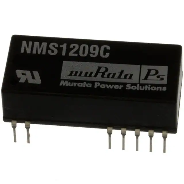

    Isolated Module DC DC Converter 2 Output 9V -9V 111mA, 111mA 10.8V - 13.2V Input
NMS1209C 数据手册
NMS Series www.murata.com 6kVDC Isolated 2W Dual Output DC-DC Converters SELECTION GUIDE Order Code Nominal Input Voltage V Output Voltage Output Current Efficiency Isolation Capacitance MTTF1 V mA % pF kHrs Recommended Alternative NMS0505C NMS1205C 5 12 ±5 ±5 ±200 ±200 74 78 1.8 1.9 747 365 MEJ2D0505SC MEJ2D1205SC NMS0509C NMS0512C NMS0515C NMS1209C NMS1212C NMS1215C 5 5 5 12 12 12 ±9 ±12 ±15 ±9 ±12 ±15 ±111 ±83 ±67 ±111 ±83 ±67 76 77 78 81 82 82 1.9 2.0 2.1 2.0 2.1 2.2 327 169 93 224 136 82 MEJ2D0509SC MEJ2D0512SC MEJ2D0515SC MEJ2D1209SC MEJ2D1212SC MEJ2D1215SC FEATURES „ RoHS compliant „ UL1950 recognised „ Efficiency to 82% „ Power density up to 0.44W/cm3 „ Dual outputs „ Low profile package When operated with additional external load capacitance the rise time of the input voltage will determine the maximum external capacitance value for guaranteed start up. The slower the rise time of the input voltage the greater the maximum value of the additional external capacitance for reliable start up. „ UL 94V-0 package material INPUT CHARACTERISTICS „ No heatsink required Parameter Conditions Min. Typ. Max. Units „ Footprint 4.75cm2 Voltage range Continuous operation, 5V input types Continuous operation, 12V input types 4.5 10.8 5 12 5.5 13.2 V „ 6kVDC isolation OUTPUT CHARACTERISTICS „ 5V & 12V inputs Parameter Conditions TA=0°C to 70°C Min. Typ. Max. Units See tolerance envelope High VIN to low VIN 10% load to rated load, 5V output types 10% load to rated load, 9V output types 10% load to rated load, 12V output types 10% load to rated load, 15V output types BW=DC to 20MHz, all output types -7.5 2 10 1.2 15 15 15 15 200 W % %/% mV p-p Max. Units „ 5V output „ Internal SMD construction Rated Power2 Voltage Set Point Accuracy Line regulation „ Fully encapsulated with toroidal magnetics „ MTTF up to 747 kHrs „ PCB mounting Load Regulation Ripple and Noise 1.0 10 6 6 6 DESCRIPTION ISOLATION CHARACTERISTICS The NMS series of DC-DC converters are UL1950 recognised which makes them ideal for all telecom and safety applications where approved isolation is required. The low profile package allows mounting in rack systems without risk of touching other boards. The output configuration allows all of the rated power to be drawn from a single pin provided the total load does not exceed 2 watts. The devices feature low noise and low isolation capacitance suiltable for applications in high noise environments, e.g. heavy electrical machine interface. Parameter Conditions Min. Isolation test voltage Resistance Flash tested for 1 second Viso= 500VDC 6000 For full details go to www.murata.com/en-global/ products/power/rohs Typ. % VDC GΩ 10 GENERAL CHARACTERISTICS Parameter Conditions Switching frequency All input types Min. Typ. 35 Max. Units kHz ABSOLUTE MAXIMUM RATINGS Short-circuit protection3 1 second Wave Solder Wave Solder profile not to exceed the profile recommended in IEC 61760-1 Section 6.1.3. Please refer to application notes for further information. Lead temperature 1.5mm from case for 10 seconds Internal power dissipation Input voltage VIN, NMS05 types Input voltage VIN, NMS12 types 300°C 900mW 7V 15V 1. Calculated using MIL-HDBK-217F with nominal input voltage at full load. 2. See derating graph. 3. Supply voltage must be disconnected at the end of the short circuit duration. All specifications typical at TA=25°C, nominal input voltage and rated output current unless otherwise specified. www.murata.com KDC_NMS.J01 Page 1 of 4 NMS Series 6kVDC Isolated 2W Dual Output DC-DC Converters TEMPERATURE CHARACTERISTICS Parameter Conditions Min. Specification Storage Case Temperature above ambient Cooling All output types 0 -50 Typ. All output types Free air convection Max. Units 70 130 32 °C TECHNICAL NOTES ISOLATION VOLTAGE ‘Hi Pot Test’, ‘Flash Tested’, ‘Withstand Voltage’, ‘Proof Voltage’, ‘Dielectric Withstand Voltage’ & ‘Isolation Test Voltage’ are all terms that relate to the same thing, a test voltage, applied for a specified time, across a component designed to provide electrical isolation, to verify the integrity of that isolation. Murata Power Solutions NMS series of DC-DC converters are all 100% production tested at their stated isolation voltage. This is 6kVDC for 1 second. A question commonly asked is, “What is the continuous voltage that can be applied across the part in normal operation?” The NMS series has been recognised by Underwriters Laboratory to a working voltage of 300Vrms for Supplementary Insulation system and 150Vrms for Reinforced Insulation systems. REPEATED HIGH-VOLTAGE ISOLATION TESTING It is well known that repeated high-voltage isolation testing of a barrier component can actually degrade isolation capability, to a lesser or greater degree depending on materials, construction and environment. We therefore strongly advise against repeated high voltage isolation testing, but if it is absolutely required, that the voltage be reduced by 20% from specified test voltage. RoHS COMPLIANCE INFORMATION This series is compatible with RoHS soldering systems with a peak wave solder temperature of 300ºC for 10 seconds. Please refer to application notes for further information. The pin termination finish on this product series is Matte Tin over Nickel Preplate. The series is backward compatible with Sn/Pb soldering systems. For further information, please visit www.murata-ps.com/rohs TEMPERATURE DERATING GRAPH TOLERANCE ENVELOPE 10% Safe Operating Area 1.0 0 20 40 60 Ambient Temperature (°C) Typic a 5% 70°C 2.0 Output Voltage Output Power (W) 3.0 0 SAFETY APPROVAL 80 l Loa 0 d Lin 2.5% e -2.5% -7.5% 10 75 50 25 Output Load Current (%) The NMS series has been recognised by Underwriters Laboratory (UL) to UL1950 for supplementary insulation up to 300Vrms and reinforced insulation up to 150Vrms working voltage. File number E151252 applies. 100 www.murata.com KDC_NMS.J01 Page 2 of 4 NMS Series 6kVDC Isolated 2W Dual Output DC-DC Converters PACKAGE SPECIFICATIONS MECHANICAL DIMENSIONS PIN CONNECTIONS 32.60 (1.28) MAX 1 24 2 23 8 17 9 16 10 15 11 14 12 13 4.00 (0.157) 9.40±0.30 (0.370±0.012) 0.60 (0.0236) 14.72 (0.58) 0.55 (0.022) 0.45 (0.018) 0.30 (0.012) 0.20 (0.008) 15.24 (0.600) 2.54 (0.1) Function 1 2 8 9 10 11 12 13 14 15 16 17 23 24 +VIN -VIN -VOUT NC OV NC +VOUT +VOUT NC OV NC -VOUT NC NC 16.95 (0.6673) MAX Weight: 7.5g All dimensions in inches ±0.01 (mm ±0.25mm). All pins on a 0.1 (2.54) pitch and within ±0.01 (0.25) of true position. TUBE OUTLINE DIMENSIONS 20.70±0.55 (0.815±0.022) 1.15 (0.045) Ø 1.00 (0.04) 0.1 (0.004) 2.54 (0.1) 16.70±0.55 (0.657±0.022) 11.70±0.80 (0.461±0.031) 2.54 (0.1) 16.70±0.80 (0.657±0.031) RECOMMENDED FOOTPRINT DETAILS 5.50±0.25 (0.217±0.010) 2.16 (0.085) Pin 6.80±0.55 (0.268±0.022) 0.60±0.15 (0.024±0.006) Unless otherwise stated all dimensions in inches ±0.01 (mm) ±0.5mm. Unless otherwise stated all dimensions in inches ±0.01 (mm) ±0.5mm. Tube length : 20.47±0.079 (520mm ±2mm). Tube Quantity: 15 www.murata.com KDC_NMS.J01 Page 3 of 4 NMS Series 6kVDC Isolated 2W Dual Output DC-DC Converters DISCLAIMER Unless otherwise stated in the datasheet, all products are designed for standard commercial and industrial applications and NOT for safety-critical and/or life-critical applications. Particularly for safety-critical and/or life-critical applications, i.e. applications that may directly endanger or cause the loss of life, inflict bodily harm and/or loss or severe damage to equipment/property, and severely harm the environment, a prior explicit written approval from Murata is strictly required. Any use of Murata standard products for any safety-critical, life-critical or any related applications without any prior explicit written approval from Murata shall be deemed unauthorised use. These applications include but are not limited to: • Aircraft equipment • Aerospace equipment • Undersea equipment • Power plant control equipment • Medical equipment • Transportation equipment ( automobiles, trains, ships, etc.) • Traffic signal equipment • Disaster prevention / crime prevention equipment • Data Processing equipment Murata makes no express or implied warranty, representation, or guarantee of suitability, fitness for any particular use/purpose and/or compatibility with any application or device of the buyer, nor does Murata assume any liability whatsoever arising out of unauthorised use of any Murata product for the application of the buyer. The suitability, fitness for any particular use/purpose and/or compatibility of Murata product with any application or device of the buyer remain to be the responsibility and liability of the buyer. Buyer represents and agrees that it has all the necessary expertise to create and implement safeguards that anticipate dangerous consequences of failures, monitor failures and their consequences, lessen the likelihood of failures that might cause harm, and take appropriate remedial actions. Buyer will fully indemnify and hold Murata, its affiliated companies, and its representatives harmless against any damages arising out of unauthorised use of any Murata products in any safety-critical and/ or life-critical applications. Remark: Murata in this section refers to Murata Manufacturing Company and its affiliated companies worldwide including, but not limited to, Murata Power Solutions. This product is subject to the following operating requirements and the Life and Safety Critical Application Sales Policy: Refer to: https://www.murata.com/en-eu/products/power/requirements Murata Power Solutions (Milton Keynes) Ltd. makes no representation that the use of its products in the circuits described herein, or the use of other technical information contained herein, will not infringe upon existing or future patent rights. The descriptions contained herein do not imply the granting of licenses to make, use, or sell equipment constructed in accordance therewith. Specifications are subject to change without notice. © 2022 Murata Power Solutions (Milton Keynes) Ltd. www.murata.com KDC_NMS.J01 Page 4 of 4
