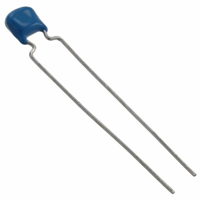

    贴片电容(MLCC) 径向 22nF ±10% 500V X7R
RDER72H223K3K1C11B 数据手册
Epoxy Coated, Radial Lead Type Monolithic Ceramic Capacitor Base Metal Electrode RDE series Features 1. Small size and large capacitance 2. Low ESR characteristics for high frequency 3. Coated with epoxy resin whose flammability is equivalent to UL94V-0 Dimension 0.5+/-0.05 5 .0+/-0.8 25.0min. 25.0min. 25.0mi n. 25.0min 0.5±0.05 5.0+/-0.8 5.5max * 0.5+/-0.05 4.0max. 12.5max. 3.15max 1.5max. 4.5max * U 7.7max. 4.0max. 7.5max. 4.0max. 3.15max. 3.5max 5 25.0min. 5.0max. 5.0max * 8 7.5max. 2.0max. 3 7.5max. 2 0.5+/- 0.05 0.5+/- 0.05 5.0+/-0.8 5.0+/-0.8 5.0+/-0.8 *Coating extension does not exceed the end of the lead bend. Capacitance range Type TC RDE_2(131/132) X7R RDE_3(121/122) X7R RDE_8(124) X7R RDE_5(113) X7R RDE_U(115) X7R Capacitance Range 1 10 WV [nF] 500V 200V 500V 200V 500V 200V 500V 200V 500V 200V 1.0 nF to 15.0 nF 1.0 nF to 47.0 nF 22.0 nF to 47.0 nF 68.0 nF to 0.1 uF 68.0 nF to 0.1 uF 0.15 uF to 0.22 uF 0.15 uF to 0.22 uF 0.33 uF to 0.47 uF 0.47 uF 0.68 uF to 1.0 uF ESR - Freq 200V 100000 ESR - Freq 500V 1000000 103K200 104K200 10000 105M200 1000 100 10 ESR [Mohm] ESR [Mohm] [uF] 1 100 102K500 100000 103K500 10000 104K500 1000 100 10 0 1 10 100 Frequency [MHz] muRata RPE 2005_ P.1 1,000 0 1 10 100 1,000 Frequency [MHz] All information is subject to change without notice, is not warranted in any fashion. Epoxy Coated, Radial Lead Type Monolithic Ceramic Capacitor Base Metal Electrode RDE series Global Part Numbering RDE R7 2D 104 K 2 K_ -1- -2- -3- -4- -5- -6- -1-: Tempera ture Cha ra cteri s ti cs Temperature Temperature Cap. Change or Code Characteristics Range Temp R7 X7R -55 to 125℃ +/-15% -3-: Ca pa ci ta nce Temperature Rated Voltage Capacitance Step Characteristics 200V E6 Series X7R 500V E6 Series B -7- -8- -2-: R a ted V ol ta g e Code Rated Voltage 2D DC 200V 2H DC 500V -4-: Ca pa ci ta nce Tol era nce Temperature Capacitan Code Characteristics Tolerance K +/- 10% X7R M* +/- 20% * Only RDE_U -6-: Lea d Conf i g ura ti on & Spa ce Code Lead Configuration Lead Space A_ Straight Long Bulk F=2.5㎜ B_ Straight Long Bulk F=5.0㎜ E_ Straight Taping F=5.0㎜ K_ Incrimp Bulk F=5.0㎜ M_ Incrimp Taping F=5.0㎜ P_ Outcrimp Bulk F=2.5㎜ S_ Outcrimp Taping F=2.5㎜ -5-: D i mens i ons ( Lx W) Code Dimensions(L×W) 2 5.0×3.0 mm 3 5.0×4.5 mm 8 7.5×5.5 mm 5 7.5×7.5 mm U 7.7×12.5 mm -7-:Individual Specification Code -8-: Pa ck a g i ng Code Package Type A Ammo Pack B Bulk muRata RPE 2005_ P.2 Std Pack quantity 2000/1500/1000 pcs 500/200 pcs All information is subject to change without notice, is not warranted in any fashion. Epoxy Coated, Radial Lead Type Monolithic Ceramic Capacitor Base Metal Electrode RDE series Size TC WV Cap RDE_2 RDE_2 RDE_2 RDE_2 RDE_2 RDE_2 RDE_2 RDE_2 RDE_3 RDE_3 RDE_3 RDE_8 RDE_8 RDE_5 RDE_5 RDE_U RDE_2 RDE_2 RDE_2 RDE_2 RDE_2 RDE_2 RDE_2 RDE_2 RDE_2 RDE_2 RDE_2 RDE_3 RDE_3 RDE_8 RDE_8 RDE_5 RDE_5 X7R X7R X7R X7R X7R X7R X7R X7R X7R X7R X7R X7R X7R X7R X7R X7R X7R X7R X7R X7R X7R X7R X7R X7R X7R X7R X7R X7R X7R X7R X7R X7R X7R 500V 500V 500V 500V 500V 500V 500V 500V 500V 500V 500V 500V 500V 500V 500V 500V 200V 200V 200V 200V 200V 200V 200V 200V 200V 200V 200V 200V 200V 200V 200V 200V 200V 1000pF 1500pF 2200pF 3300pF 4700pF 6800pF 10000pF 15000pF 22000pF 33000pF 47000pF 68000pF 0.10uF 0.15uF 0.22uF 0.47uF 1000pF 1500pF 2200pF 3300pF 4700pF 6800pF 10000pF 15000pF 22000pF 33000pF 47000pF 68000pF 0.10uF 0.15uF 0.22uF 0.33uF 0.47uF muRata RPE 2005_ P.3 Cap Tol Murata Global P/N Sample +/-10% RDER72H102K2K1C11B A vail abie +/-10% RDER72H152K2K1C11B A vail abie +/-10% RDER72H222K2K1C11B A vail abie +/-10% RDER72H332K2K1C11B A vail abie +/-10% RDER72H472K2K1C11B A vail abie +/-10% RDER72H682K2K1C11B A vail abie +/-10% RDER72H103K2K1C11B A vail abie +/-10% RDER72H153K2K1C11B A vail abie +/-10% RDER72H223K3K1C11B A vail abie +/-10% RDER72H333K3K1C11B A vail abie +/-10% RDER72H473K3K1C11B A vail abie +/-10% RDER72H683K8K1C11B A vail abie +/-10% RDER72H104K8K1C11B A vail abie +/-10% RDER72H154K5K1C13B A vail abie +/-10% RDER72H224K5K1C13B A vail abie +/-20% RDER72H474MUK1C13B A vail abie +/-10% RDER72D102K2K1A11B A vail abie +/-10% RDER72D152K2K1A11B A vail abie +/-10% RDER72D222K2K1A11B A vail abie +/-10% RDER72D332K2K1A11B A vail abie +/-10% RDER72D472K2K1A11B A vail abie +/-10% RDER72D682K2K1A11B A vail abie +/-10% RDER72D103K2K1A11B A vail abie +/-10% RDER72D153K2K1C11B A vail abie +/-10% RDER72D223K2K1C11B A vail abie +/-10% RDER72D333K2K1C11B A vail abie +/-10% RDER72D473K2K1C11B A vail abie +/-10% RDER72D683K3K1C11B A vail abie +/-10% RDER72D104K3K1C11B A vail abie +/-10% RDER72D154K8K1C11B A vail abie +/-10% RDER72D224K8K1C11B A vail abie +/-10% RDER72D334K5K1C13B A vail abie +/-10% RDER72D474K5K1C13B A vail abie Mass Production Design Kit M.P. M.P. M.P. M.P. M.P. M.P. M.P. M.P. M.P. M.P. M.P. M.P. M.P. M.P. M.P. M.P. M.P. M.P. M.P. M.P. M.P. M.P. M.P. M.P. M.P. M.P. M.P. M.P. M.P. M.P. M.P. M.P. M.P. ○ ○ ○ ○ ○ ○ ○ ○ ○ ○ ○ ○ All information is subject to change without notice, is not warranted in any fashion.
