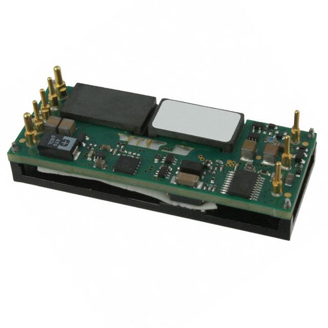

UCE-12/10-D48P-C
UCE-12/10-D48P-C
    MURATA-PS(村田)
    DIP8 模块,1/8砖
    隔离模块 直流转换器 1 输出 12V 10A 36V - 75V 输入
UCE-12/10-D48P-C 数据手册
UCE Series www.murata-ps.com Isolated, High-Density, Eighth-Brick Low Profile DC-DC Converters FEATURES „„ Industry standard eighth-brick pinout and package „„ Low profile 0.4" height with 0.9" x 2.3" outline dimensions „„ 36 to 75 Vdc input range (48V nominal) „„ Fully isolated, 2250 Vdc (BASIC) insulation „„ Outstanding thermal performance and derating „„ Extensive self-protection and short circuit features with no output reverse conduction „„ On/Off control, trim and sense functions „„ Interleaved synchronous rectification yields high efficiency over 90% „„ Fully protected against temperature and voltage limits „„ RoHS-6 or RoHS-5 compliant „„ Certified to UL/EN/IEC 60950-1 and CAN/CSA C22.2 No. 60950-1, 2nd Edition safety approvals Typical unit For efficient, fully isolated DC power in the smallest space, the UCE open frame DC-DC converter series fit in industry-standard “eighth brick” outline dimensions and mounting pins (on quarter-brick pinout). PRODUCT OVERVIEW Units are offered with fixed output voltages from 1.5 to 12 Volts and currents up to 30 Amps. UCEs operate over a wide temperature range (up to +85 degrees Celsius at moderate airflow) with full rated power. Interleaved synchronous rectifier topology yields excellent efficiency over 90% and no reverse output conduction. UCEs achieve these impressive mechanical and environmental specs while delivering excellent electrical performance in a through-hole package. Overall noise is typically 50 mV pk-pk (low voltage models) with fast step response. These converters offer tight output regulation and high stability even with no load. The unit is fully protected against input undervoltage, output overcurrent and short circuit. An on-board temperature sensor shuts down the converter if thermal limits are reached. “Hiccup” output protection automatically restarts the converter when the fault is removed. A convenient remote On/Off control input enables phased startup and shutdown in multi-voltage applications. To compensate for longer wiring and to retain output voltage accuracy at the load, UCEs employ a Sense input to dynamically correct for ohmic losses. A trim input may be connected to a user’s adjustment potentiometer or trim resistors for output voltage calibration. The UCE will tolerate substantial capacitive loading for bypass-cap applications. UCEs include industry-standard safety certifications and BASIC I/O insulation provides input/output isolation to 2250V. Radiation emission testing is performed to widely-accepted EMC standards. SIMPLIFIED BLOCK DIAGRAM +SENSE (7) +VIN (1) +VOUT (8) SWITCH CONTROL −VOUT (4) –VIN (3) PULSE TRANSFORMER PWM CONTROLLER OPTO ISOLATION INPUT UNDERVOLTAGE, INPUT OVERVOLTAGE, AND OUTPUT OVERVOLTAGE COMPARATORS REFERENCE & ERROR AMP REMOTE ON/OFF CONTROL (2) −SENSE (5) VOUT TRIM (6) Typical topology is shown. Figure 1. Simplified Block Diagram For full details go to www.murata-ps.com/rohs www.murata-ps.com/support MDC_UCE.E03 Page 1 of 17 UCE Series Isolated, High-Density, Eighth-Brick Low Profile DC-DC Converters PERFORMANCE SPECIFICATIONS SUMMARY AND ORDERING GUIDE Output Model Family Ripple & Noise (mVp-p) Typ. Max. VOUT (V) IOUT (A) Power (W) 1.2 25 30 1.5 20 30 1.5 40 60 1.8 30 54 2.5 20 50 3.3 15 49.5 3.3 30 99 5 10 50 5 20 100 30 12 4.2 50.4 150 12 8.3 99.6 12 10 120 UCE-1.2/25-D48 UCE-1.5/20-D48 UCE-1.5/40-D48 UCE-1.8/30-D48 UCE-2.5/20-D48 UCE-3.3/15-D48 UCE-3.3/30-D48 UCE-5/10-D48 UCE-5/20-D48 UCE-12/4.2-D48 UCE-12/8.3-D48 UCE-12/10-D48 Input Regulation (max.) Line Load VIN Nom. Range (V) (V) IIN, no load (mA) IIN, full load (A) Efficiency Min. Typ. Package Case Pinout Please contact Murata Power Solutions for further information. 50 100 ±0.15% ±0.3% 48 36-75 50 0.72 85% 87% C56 P32 C56 P32 Please contact Murata Power Solutions for further information. 30 50 80 100 ±0.125% ±0.1% ±0.25% 1.28 87% 50 1.14 88% 91% 1.15 86% 90% 2.27 89% 91% 1.15 88% 90.5% 2.25 90% 92.5% 60 ±0.2% 48 200 45 36-75 30 60 ±0.125% ±0.25% 50 300 1.14 2.31 88% 92% 86% 2.78 90%  Please refer to the model number structure for additional ordering part numbers and options. PART NUMBER STRUCTURE U CE - 3.3 / 30 - D48 N B H Output Configuration: Lx - C RoHS Hazardous Materials compliance C = RoHS6 (does not claim EU RoHS exemption 7b–lead in solder), standard Y = RoHS5 (with lead), optional, special quantity order U = Unipolar/Single Pin Length Option (Through-hole packages only) Eighth-Brick Package Blank = Standard pin length 0.180 inches (4.6mm) L1 = Pin length 0.110 inches (2.79mm)* L2 = Pin length 0.145 inches (3.68mm)* Nominal Output Voltage Maximum Rated Output Current in Amps Input Voltage Range: D48 = 36-75V, 48V nominal Conformal coating (optional) Blank = no coating, standard H = Coating added, optional, special quantity order *Special quantity order is required; no sample quantities available. Baseplate (optional, not available on some models) Blank = No baseplate, standard B = Baseplate installed, optional, special quantity order On/Off Control Logic N = Negative logic, standard P = Positive logic, optional Note: Some model combinations may not be available. Contact Murata Power Solutions for availability. As of September 2017, ONLY the following part numbers will be available: UCE-5/20-D48N-C; UCE-5/20-D48NB-C. Product Adaptations Murata Power Solutions offers several variations of our core product family. These products are available under scheduled quantity orders and may also include separate manufacturing documentation from a mutually agreeable Product Specification. Since these product adaptations largely share a common parts list and similar specifications and test methods with their root products, they are provided at excellent costs and delivery. Please contact Murata Power Solutions for details. As of this date, the following products are available: UCE-3.3/30-D48NHL2-Y UCE-12/4.2-D48NHL2-Y These models are all negative On/Off logic, no baseplate, conformal coating added, 3.68mm pin length, and RoHS-5 hazardous substance compliance (with lead). www.murata-ps.com/support MDC_UCE.E03 Page 2 of 17 UCE Series Isolated, High-Density, Eighth-Brick Low Profile DC-DC Converters FUNCTIONAL SPECIFICATIONS INPUT CHARACTERISTICS Model Family UCE-1.5/20-D48 UCE-1.8/30-D48 UCE-2.5/20-D48 UCE-3.3/15-D48 UCE-3.3/30-D48 UCE-5/10-D48 UCE-5/20-D48 UCE-12/4.2-D48 UCE-12/8.3-D48 UCE-12/10-D48 Remote On/Off Control Under- Reflected Start-up voltage (back) Internal Reverse threshold Output ShutRipple Inrush Low Line Standby Input Filter Polarity Positive Logic Negative Logic Min. down Current Transient Short (Vin=min.) Mode Type Protection Current “P” Model “N” Model (A) Circuit (mA) (V) (mA)② A2sec (A) (mA) Suffix Suffix (mA) 34.5 34 32 32.5 32 32 32 32 31.5 34 32 34 10-30, model dependent 0.05 A2sec 50-150, model dependent 500 0.97 1.72 1.53 1.54 3.06 1.53 3.00 1.52 3.07 3.70 L-C 1-10, model dependent None, install external fuse Pi Pi 1.0 OFF=Ground OFF=open or pin to +1V max. +2.5V to +15V max. ON=open or +3.5 to +15V ON=Ground pin to +0.8V max. max. L-C OUTPUT CHARACTERISTICS Model Family UCE-1.5/20-D48 UCE-1.8/30-D48 UCE-2.5/20-D48 UCE-3.3/15-D48 UCE-3.3/30-D48 UCE-5/10-D48 UCE-5/20-D48 UCE-12/4.2-D48 UCE-12/8.3-D48 UCE-12/10-D48 Vout Accuracy 50% Load % of Vnom Capacitive Loading Max. Low ESR
