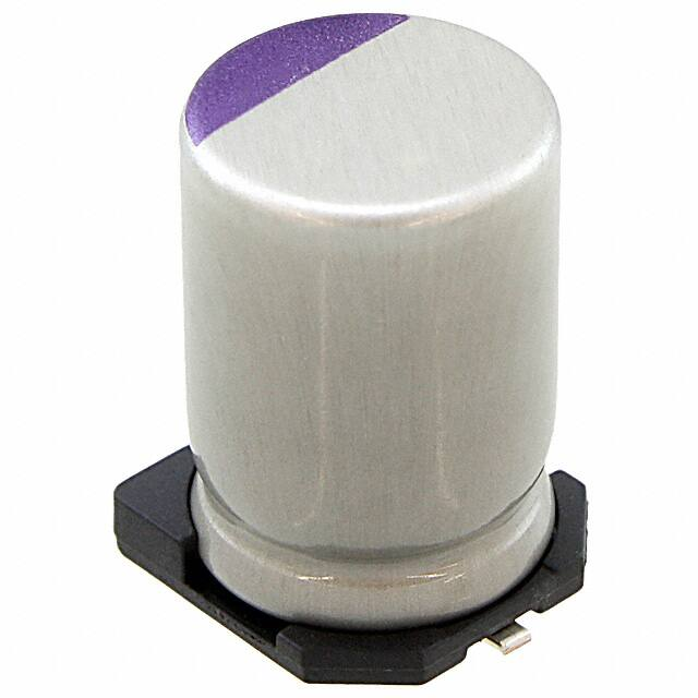

    SMD,D8xL11.9mm
    铝聚合物电容器 AEC_D8X11.9MM_SM 180µF ±20% 16V Ф8.00 x 11.90mm 20mΩ
16SVP180M 数据手册
4. SPECIFICATIONS FOR EACH SERIES Conductive polymer type SVP Series Standard SMD type Standard SMD type product Use for surface mounted type switching power supplies. This product can support lead free-reflow. (※2). ■Specifications Conditions Items Category temperature range Tolerance on rated capacitance Tangent of loss angle Leakage current ※1 ESR Characteristics of impedance ratio at high temp. and low temp. Characteristics -55°C to +105°C M: ±20% 120Hz Less than or equal to the value of Table7 120Hz After 2 minutes Less than or equal to the value of Table7 Less than or equal to the value of Table7 Based the value at Z / Z 20°C 0.75 to 1.25 -55°C 100KHz,+20°C Z / Z 20°C 0.75 to 1.25 +105°C ∆C/C Within ±20% 105°C, 2,000h, Rated tanδ 1.5 times or less than an initial standard Endurance voltage applied ESR 1.5 times or less than an initial standard (25V→20V applied) Leakage current Below an initial standard ∆C/C Within ±20% 60°C, 90 to 95%RH, tanδ 1.5 times or less than an initial standard Damp heat (Steady state) 1,000h, ESR 1.5 times or less than an initial standard No-applied voltage Leakage current Below an initial standard (after voltage processing) Within ±10% ∆C/C Resistance to 1.3 times or less than an initial standard tanδ ※2 (VPS) (230°C X 75s) soldering heat 1.3 times or less than an initial standard ESR Leakage current Below an initial standard (after voltage processing) ※1 In case of some problems for measured values, measure after applying rated voltage for 2.5 to 20V products or 20V for 25V products    for 120 minutes at 105°C . (unit : mm) ※2 Refer to Page 56 for reflow soldering conditions. +0.1 ■Dimensions Size Code φD±0.5 L W±0.2 H±0.2 C±0.2 R P±0.2 -0.4 4.3 5.4 A5 4.0 4.3 5.0 0.6 to 0.8 1.0 5.3 5.9 B6 5.0 5.3 6.0 0.6 to 0.8 1.4 6.6 5.9 C6 6.3 6.6 7.3 0.6 to 0.8 2.1 8.3 6.9 E7 8.0 8.3 9.0 0.6 to 0.8 3.2 7.9 10.3 10.3 11.0 0.6 to 0.8 4.6 F8 10.0 8.3 E12 8.0 11.9 8.3 9.0 0.8 to 1.1 3.2 F12 10.0 12.6 10.3 10.3 11.0 0.8 to 1.1 4.6 0.2max. L P C H W φD R (+) ■Size List µF RV : Rated voltage (SV) : Surge (room temperature) 2.5 4 6.3 10 16 20 25 (3.3)(5.2)(8.2)(11.5) (18.4) (23.0) (25.0) RV (SV) 3.3 4.7 6.8 10 15 22 27 33 39 47 56 68 82 100 120 150 180 220 270 330 470 560 680 820 1200 1500 A5 A5 A5 A5 A5 A5 A5 B6 B6 B6 B6 B6 C6 E7 F8 E12 a F12 b C6 B6 C6 C6 E7 E7 F8 F8 E7 F8 E12 F8 F8,E12 F12 B6 C6 C6 C6 C6,E7 E7 E7,F8 E7,F8 C6 E7 E12 C6 C6 E7 E12 F8 ■Recommended land pattern dimension of PWB c Specifications for each series Marking : Polarity( ), Rated voltage, Lot.No. (Purple) SVP(Upper E7), Rated capacitance. F8 F8 F8,E12 F8,E12 F12 F12 F12 F12 F12 ※For the minimum packing quantity, please refer to page 55. 30 (unit : mm) Size Code A5 B6 C6 E7 F8 E12 F12 a 1.0 1.4 2.1 2.8 4.3 2.8 4.3 b 6.2 7.4 9.1 11.1 13.1 11.1 13.1 c 1.6 1.6 1.6 1.9 1.9 1.9 1.9 4. SPECIFICATIONS FOR EACH SERIES ■Table7 SVP Series Characteristics List Size Code B6 C6 E7 F8 E12 F12 ※1 ※2 ※3 16SVP3R3M 10SVP4R7M 10SVP6R8M 10SVP10M 10SVP15M 6SVP22M 4SVP33M 20SVP10M 16SVP15M 16SVP22M 10SVP33M 6SVP47M 4SVP39M 4SVP68M 25SVP6R8M 20SVP22M 20SVP27M 16SVP39M 10SVP47M 10SVP56M 6SVP82M 6SVP100M 6SVP120MV 4SVP150MX 2R5SVP220M 25SVP10M 20SVP33M 20SVP47M 16SVP56M 16SVP82M 10SVP120M 10SVP150MX 6SVP220MX 4SVP150M 4SVP330M 25SVP22M 20SVP56M 20SVP68M 16SVP100M 16SVP150M 16SVP180MX 10SVP150M 10SVP270M 10SVP330MX 6SVP220M 6SVP330M 6SVP470MX 4SVP680M 25SVP33M 20SVP100M 16SVP180M 10SVP330M 6SVP470M 4SVP560M 2R5SVP680M 25SVP56M 20SVP150M 16SVP330M 10SVP560M 6SVP820M 4SVP1200M 2R5SVP1500M ※3 ※3 ※3 ※3 ※3 16 10 10 10 10 6.3 4 20 16 16 10 6.3 4 4 25 20 20 16 10 10 6.3 6.3 6.3 4 2.5 25 20 20 16 16 10 10 6.3 4 4 25 20 20 16 16 16 10 10 10 6.3 6.3 6.3 4 25 20 16 10 6.3 4 2.5 25 20 16 10 6.3 4 2.5 Rated Capacitance (µF) Rated ESR 100kHz to 300kHz ripple current (mΩ) (max.) (mArms) 3.3 4.7 6.8 10 15 22 33 10 15 22 33 47 39 68 6.8 22 27 39 47 56 82 100 120 150 220 10 33 47 56 82 120 150 220 150 330 22 56 68 100 150 180 150 270 330 220 330 470 680 33 100 180 330 470 560 680 56 150 330 560 820 1200 1500 260 240 240 220 200 200 200 120 120 90 70 70 70 60 80 60 60 50 50 45 45 40 17 40 23 60 45 45 45 40 35 35 35 35 35 50 40 40 35 30 30 30 25 25 25 25 25 25 30 24 20 17 15 13 13 28 20 16 13 12 12 12 660 670 670 700 740 740 740 1020 1020 1060 1100 1100 1100 1400 1200 1450 1450 1620 1620 1700 1700 1810 2780 1810 2390 1500 1890 1890 1890 2120 2560 2560 2560 2560 2560 2000 2400 2400 2670 3020 3020 3020 3700 3700 3700 3700 3700 3700 2980 3320 3640 3950 4210 4520 4520 3800 4320 4720 5230 5440 5440 5440 Tangent of loss angle (max.) 0.07 0.08 0.09 0.10 0.10 0.12 0.15 0.10 0.10 0.10 0.12 0.12 0.12 0.12 0.10 0.10 0.10 0.10 0.12 0.12 0.12 0.12 0.12 0.12 0.12 0.10 0.12 0.12 0.12 0.12 0.12 0.12 0.12 0.12 0.12 0.10 0.12 0.12 0.12 0.12 0.12 0.12 0.12 0.12 0.12 0.12 0.12 0.12 0.12 0.15 0.15 0.15 0.15 0.15 0.15 0.12 0.15 0.15 0.15 0.15 0.18 0.18 Leakage current (µA) (max.)※2 26.4 23.5 34.0 50.0 75.0 69.3 66.0 100 120 176 165 148 78 136 85 88 108 125 94 112 103 126 151 120 110 125 132 188 179 262 240 300 277 120 264 275 224 272 320 480 576 300 540 660 277 416 592 544 413 400 576 660 592 448 340 700 600 792 840 775 960 750 Specifications for each series A5 Rated Voltage (V) Part Number ※1 Capacitance tolerance : M ±20% After 2 minutes The surge voltage of 25V products is 25V. Please consider SVPD series 25V products (whose surge voltage is 29V) in placing a new order. Frequency coefficient for ripple current Frequency Coefficient 120Hz≦ f <1kHz 0.05 1kHz≦ f <10kHz 0.3 10kHz≦ f <100kHz 0.7 100kHz≦ f ≦500kHz 1 31
