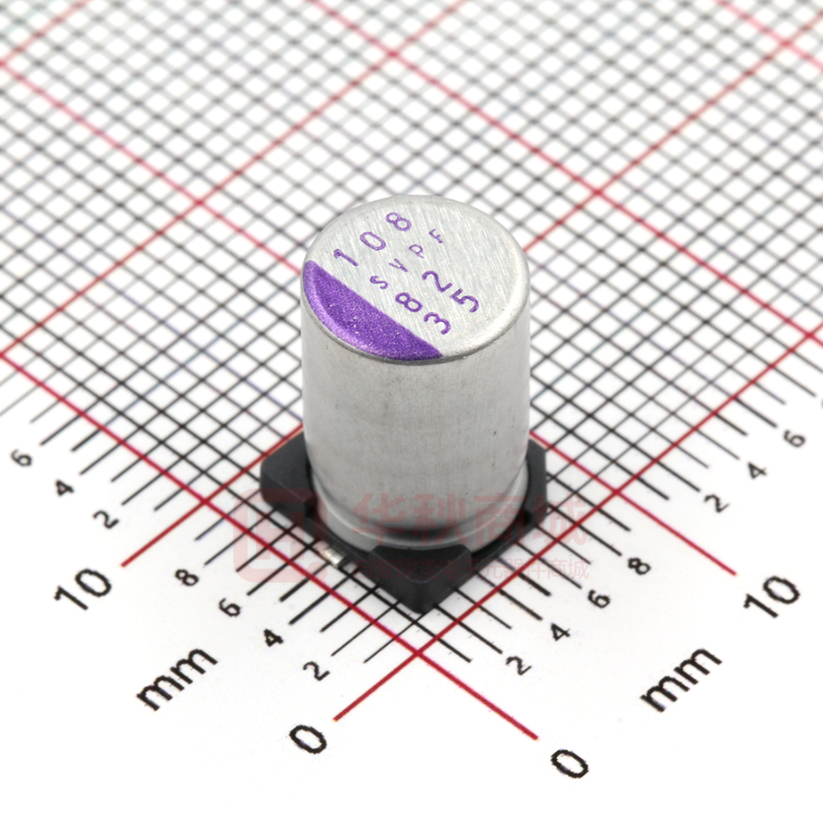

    贴片铝电解电容 SMD,D8xL11.9mm 82µF ±20% 35V 5000Hrs@105℃
35SVPF82M 数据手册
Conductive Polymer Aluminum Solid Capacitors Surface Mount Type Series : SVPF Features ● High voltage (50 V.DC max.) capacitance (1000 μF max.) ● 105 °C 5000 h ● RoHS compliance, Halogen free ● Large Specifications Size code B6 C6 E7 E12 Category temperature range –55 °C to +105 °C Rated voltage range 16 V.DC to 25 V.DC 16 V.DC to 50 V.DC Rated capacitance range 27 μF to 82 μF 10 μF to 180 μF 18 μF to 270 μF 39 μF to 560 μF Capacitance tolerance ±20 % (120 Hz / + 20 °C) Leakage current Please see the attached characteristics list Dissipation factor (tan d) Please see the attached characteristics list +105 °C, 5000 h, rated voltage applied Capacitance change Within ±20 % of the initial value Endurance tan d < 150 % of the initial limit DC leakage current Within the initial limit +60 °C, 90 % to 95 %, 1000 h, No-applied voltage Capacitance change Within ±20 % of the initial value Damp heat (Steady State) tan d < 150 % of the initial limit DC leakage current Within the initial limit (after voltage processing) Marking F12 68 μF to 1000 μF Dimensions (not to scale) 0.2 max. W C H fD P – Polarity marking (−) Lot. No. + L R Unit : mm Series R. Capacitance R. Voltage Size code fD±0.5 B6 C6 E7 E12 F12 5.0 6.3 8.0 8.0 10.0 L +0.1 −0.4 5.9 5.9 6.9 11.9 12.6 W±0.2 H±0.2 C±0.2 5.3 6.6 8.3 8.3 10.3 5.3 6.6 8.3 8.3 10.3 6.0 7.3 9.0 9.0 11.0 R P±0.2 0.6 to 0.8 0.6 to 0.8 0.6 to 0.8 0.8 to 1.1 0.8 to 1.1 1.4 2.1 3.2 3.2 4.6 ✽ Externals of figure are the reference. Design and specifications are each subject to change without notice. Ask factory for the current technical specifications before purchase and/or use. Should a safety concern arise regarding this product, please be sure to contact us immediately. 01 Nov. 2015 Conductive Polymer Aluminum Solid Capacitors Characteristics list Rated Rated Series voltage capacitance (V.DC) (μF) 16 20 SVPF 25 35 50 82 180 270 560 1000 56 120 180 390 560 27 47 56 82 100 180 330 22 39 82 120 10 18 39 68 Case size (mm) fD L 5.0 6.3 8.0 8.0 10.0 5.0 6.3 8.0 8.0 10.0 5.0 6.3 6.3 8.0 8.0 8.0 10.0 6.3 8.0 8.0 10.0 6.3 8.0 8.0 10.0 5.9 5.9 6.9 11.9 12.6 5.9 5.9 6.9 11.9 12.6 5.9 5.9 5.9 6.9 6.9 11.9 12.6 5.9 6.9 11.9 12.6 5.9 6.9 11.9 12.6 Size code B6 C6 E7 E12 F12 B6 C6 E7 E12 F12 B6 C6 E7 E12 F12 C6 E7 E12 F12 C6 E7 E12 F12 Specifications Ripple ✽1 ESR ✽2 current tan d ✽3 (mΩ max.) (mAr.m.s.) 3000 27 0.12 3300 22 0.12 3300 22 0.12 4950 14 0.12 5400 12 0.12 2800 30 0.12 3200 25 0.12 3200 25 0.12 4950 14 0.12 5400 12 0.12 2450 40 0.12 2800 30 0.12 2800 30 0.12 3000 28 0.12 3200 24 0.12 4650 16 0.12 5000 14 0.12 2600 35 0.12 2800 30 0.12 4000 20 0.12 4400 18 0.12 2500 40 0.12 2700 35 0.12 3800 25 0.12 4300 20 0.12 LC ✽4 (μA) 262 576 864 1792 3200 224 480 720 1560 2240 135 235 280 410 500 900 1650 154 273 574 840 100 180 390 680 Standard (Reel size : f380) Min. Packaging Q'ty Part number (pcs) 16SVPF82M 1500 16SVPF180M 1000 16SVPF270M 1000 16SVPF560M 400 16SVPF1000M 400 20SVPF56MX 1500 20SVPF120M 1000 20SVPF180M 1000 20SVPF390M 400 20SVPF560M 400 25SVPF27MX 1500 25SVPF47M 1000 25SVPF56M 1000 25SVPF82M 1000 25SVPF100M 1000 25SVPF180M 400 25SVPF330M 400 35SVPF22M 1000 35SVPF39M 1000 35SVPF82M 400 35SVPF120M 400 50SVPF10M 1000 50SVPF18M 1000 50SVPF39M 400 50SVPF68M 400 ✽1 Ripple current (100 kHz/ +105 °C ), ✽2 ESR (100 kHz to 300 kHz/+20 °C) ✽3 tan d (120 Hz/+20 °C) ✽4 After 2 minutes ◆ Please refer to each page in this catarog for “Reflow conditions” and “Taping specifications”. Frequency correction factor for ripple current Frequency 120 Hz < f < 1 kHz 1 kHz < f < 10 kHz 10 kHz < f < 100 kHz 100 kHz < f < 500 kHz Coefficient 0.05 0.3 0.7 1 Design and specifications are each subject to change without notice. Ask factory for the current technical specifications before purchase and/or use. Should a safety concern arise regarding this product, please be sure to contact us immediately. 01 Nov. 2015
