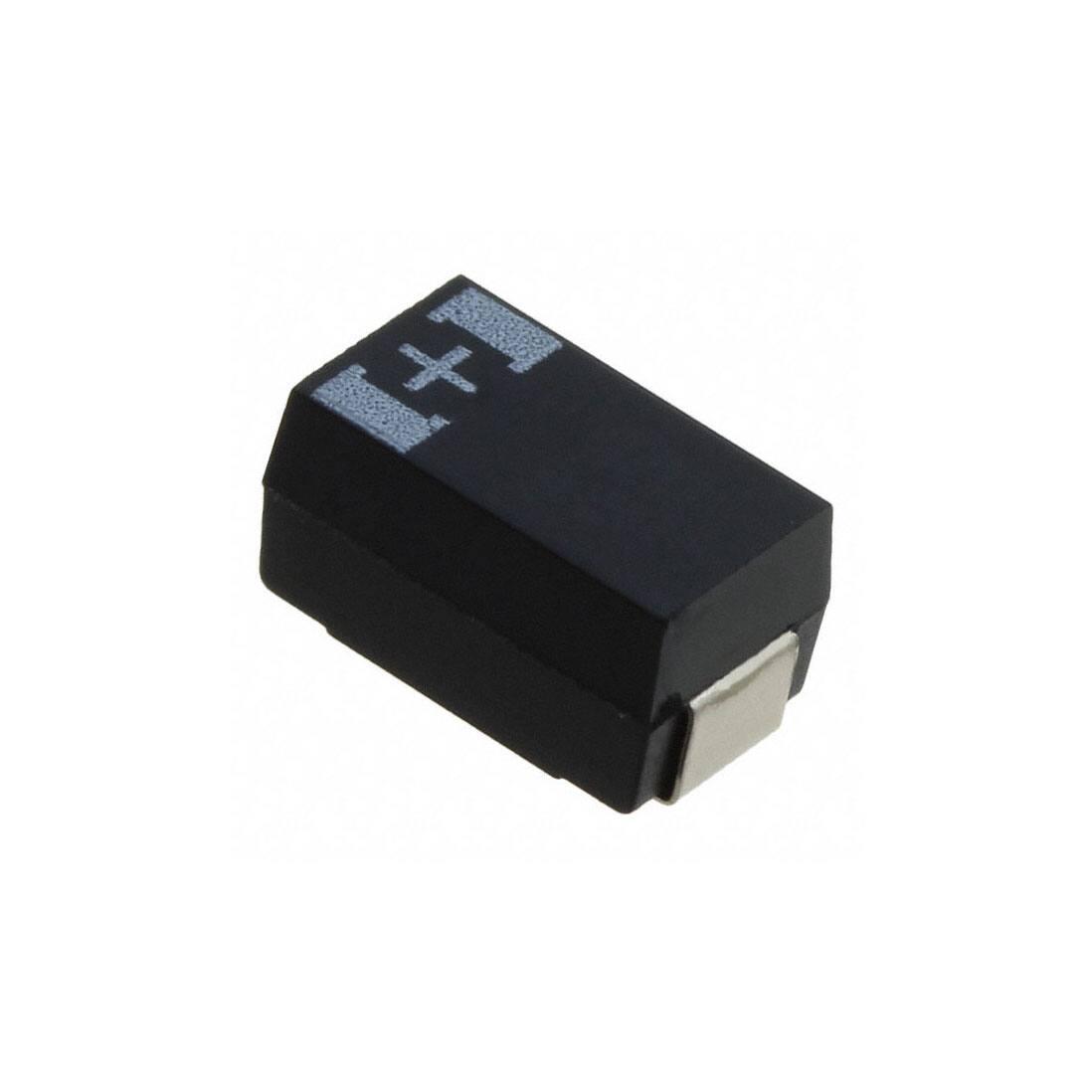

4TPF330MFL
4TPF330MFL
    NAIS(松下)
    D7343-28
    钽电容 330μF ±20% 4V
4TPF330MFL 数据手册
Conductive Polymer Tantalum Surface Mount Type TPF series Solid Capacitors UPGRADE Features ● Super low ESR(5 mΩ max.) ● Large capacitance(1000 μF max.) ● RoHS compliance, Halogen free Specifications Size code D2E D3L Category temp. range D4 –55 ℃ to +105 ℃ Rated volt. range 2.0 V 2.5 V to 10 V 2.5 V to 6.3 V Category volt. range 2.0 V 2.5 V to 10 V 2.5 V to 6.3 V Rated cap. range 220 μF to 330 μF 150 μF to 680 μF 470 μF to 1000 μF Capacitance tolerance ±20 % (120 Hz / +20 ℃) Leakage current Please see the attached characteristics list Dissipation factor(tan δ) Please see the attached characteristics list Surge voltage (V) Rated voltage × 1.15 +105 ℃ 2000 h rated voltage applied Endurance Capacitance change Within ±20 % of the initial value Dissipation factor(tan δ) ≦ 1.5 times of the initial limit Leakage current Within the initial limit +60 ℃, 90 % to 95 % RH, 500 h, No-applied voltage Within +50 %, −20 % of the initial value Capacitance change Damp heat (Steady State) (2TPF220M6, 2TPF330M6, ETPF1000M6H (5H)) Within +40 %, −20 % of the initial value (Except for above model) Dissipation factor(tan δ) ≦ 1.5 times of the initial limit Leakage current ≦ 3 times of the initial limit Marking Dimensions (not to scale) L W Rated capacitance (μF) H Polarity marking (+) Lot No. S Rated voltage code S W1 Unit:mm Size code L±0.3 W±0.2 R. voltage code Unit:V d 2.0 g 4.0 e 2.5 j 6.3 A 10 D2E 7.3 D3L D4 H S±0.2 W1±0.1 4.3 1.8±0.1 7.3 4.3 2.8±0.2 1.3 2.4 7.3 4.3 3.8±0.2 1.3 2.4 1.3 2.4 * Externals of figure are the reference. Design and specifications are each subject to change without notice. Ask factory for the current technical specifications before purchase and/or use. Should a safety concern arise regarding this product, please be sure to contact us immediately. 09-Jul-21 Conductive Polymer Tantalum Solid Capacitors TPF series Characteristics list CateRated CateRated gory Rated capacitemper- gory tempervoltage tance ature voltage ature (V) (μF) (V) (℃) (℃) 2.0 NEW 2.5 NEW NEW NEW 4.0 Specifications (mm) L W H Size *1 Ripple code ESR*2 tan δ*3 current (mA rms) 105 2.0 105 220 7.3 4.3 1.8 105 2.0 105 330 7.3 4.3 1.8 105 2.5 105 330 7.3 4.3 2.8 105 2.5 105 7.3 4.3 2.8 105 2.5 105 7.3 4.3 2.8 105 2.5 105 105 2.5 105 105 2.5 105 2.5 105 2.5 105 105 2.5 105 105 2.5 105 (mΩ max.) Floor life level Standard LC*4 (μA) Part number Min. packaging Reflow Reflow q'ty (pcs) 4700 6 0.10 88.0 2TPF220M6 3000 4700 6 0.10 132.0 2TPF330M6 3000 4400 7 0.10 82.5 2R5TPF330M7L 2500 4400 6 0.10 117.5 2R5TPF470M6L 2500 4400 7 0.10 117.5 2R5TPF470M7L 2500 7.3 4.3 2.8 4400 10 0.10 117.5 2R5TPF470ML 2500 7.3 4.3 3.8 D4 6100 5 0.10 117.5 ETPF470M5H 2000 105 7.3 4.3 2.8 3850 9 0.10 117.5 2R5TPF470M9L 2500 105 7.3 4.3 2.8 4400 6 0.10 170.0 2R5TPF680M6L 2500 470 D3L D3L 4400 7 0.10 170.0 2R5TPF680M7L 2500 4400 10 0.10 170.0 2R5TPF680ML 2500 105 7.3 4.3 3.8 6100 5 0.10 170.0 ETPF680M5H 2000 2.5 105 7.3 4.3 3.8 2700 25 0.10 170.0 ETPF680MPH 2000 105 2.5 105 6100 5 0.10 250.0 ETPF1000M5H 2000 105 2.5 105 7.3 4.3 3.8 5600 6 0.10 250.0 ETPF1000M6H 2000 105 4.0 105 7.3 4.3 2.8 3900 9 0.10 132.0 4TPF330M9L 2500 105 4.0 105 4000 12 0.10 132.0 4TPF330ML 2500 105 4.0 105 3550 15 0.10 132.0 4TPF330MFL 2500 105 4.0 105 7.3 4.3 2.8 4400 10 0.10 188.0 4TPF470ML 2500 105 4.0 105 7.3 4.3 3.8 4400 10 0.10 272.0 4TPF680MAH 2000 105 4.0 105 NEW 105 4.0 105 NEW 105 6.3 105 105 6.3 105 105 6.3 105 6.3 7.3 4.3 2.8 D2E 7.3 4.3 2.8 NEW NEW Case size 680 1000 330 7.3 4.3 3.8 7.3 4.3 2.8 7.3 4.3 2.8 470 680 D4 D3L 7.3 4.3 3.8 D4 3550 15 0.10 272.0 4TPF680MFH 2000 7.3 4.3 3.8 2350 35 0.10 272.0 4TPF680MZH 2000 7.3 4.3 2.8 2750 25 0.10 94.5 6TPF150MPL 2500 7.3 4.3 2.8 6100 5 0.10 138.6 6TPF220M5L 2500 105 7.3 4.3 2.8 5550 6 0.10 138.6 6TPF220M6L 2500 105 7.3 4.3 2.8 4600 9 0.10 138.6 6TPF220M9L 2500 150 220 105 6.3 105 7.3 4.3 2.8 D3L 4000 12 0.10 138.6 6TPF220ML 2500 6.3 NEW 105 6.3 105 7.3 4.3 2.8 3550 15 0.10 138.6 6TPF220MFL 2500 105 6.3 105 7.3 4.3 2.8 2750 25 0.10 138.6 6TPF220MPL 2500 105 6.3 105 7.3 4.3 2.8 3900 9 0.10 207.9 6TPF330M9L 2500 105 6.3 105 7.3 4.3 2.8 3650 10 0.10 207.9 6TPF330MAL 2500 105 6.3 105 7.3 4.3 3.8 4400 10 0.10 296.1 6TPF470MAH 2000 105 6.3 105 3550 15 0.10 296.1 6TPF470MFH 2000 105 10 105 7.3 4.3 2.8 D3L 3600 15 0.10 150.0 10TPF150ML 2500 NEW NEW NEW 10 330 470 150 7.3 4.3 3.8 D4 temp temp ≦260℃ ≦250℃ – 3 2a – 3 – *1: Ripple current(100 kHz / +45 ℃) *2: ESR(100 kHz / +20 ℃)  *3: tan δ (120 Hz / +20 ℃) *4: After 5 minutes ◆ Please refer to each page in this catarog for “Reflow conditions” ,“Taping specifications” and "Floor life level" . ◆ Small order quantity (500 pcs/reel) is available with TPF series. Please contact our sales representative if you prefer it. Design and specifications are each subject to change without notice. Ask factory for the current technical specifications before purchase and/or use. Should a safety concern arise regarding this product, please be sure to contact us immediately. 09-Jul-21 Guidelines and precautions regarding the technical information and use of our products described in this online catalog. ■ If you want to use our products described in this online catalog for applications requiring special qualities or reliability, or for applications where the failure or malfunction of the products may directly jeopardize human life or potentially cause personal injury (e.g. aircraft and aerospace equipment, traffic and transportation equipment, combustion equipment, medical equipment, accident prevention, anti-crime equipment, and/or safety equipment), it is necessary to verify whether the specifications of our products fit to such applications. Please ensure that you will ask and check with our inquiry desk as to whether the specifications of our products fit to such applications use before you use our products. ■ The quality and performance of our products as described in this online catalog only apply to our products when used in isolation. Therefore, please ensure you evaluate and verify our products under the specific circumstances in which our products are assembled in your own products and in which our products will actually be used. ■ If you use our products in equipment that requires a high degree of reliability, regardless of the application, it is recommended that you set up protection circuits and redundancy circuits in order to ensure safety of your equipment. ■ The products and product specifications described in this online catalog are subject to change for improvement without prior notice. Therefore, please be sure to request and confirm the latest product specifications which explain the specifications of our products in detail, before you finalize the design of your applications, purchase, or use our products. ■ The technical information in this online catalog provides examples of our products' typical operations and application circuits. We do not guarantee the non-infringement of third party's intellectual property rights and we do not grant any license, right, or interest in our intellectual property. ■ If any of our products, product specifications and/or technical information in this online catalog is to be exported or provided to non-residents, the laws and regulations of the exporting country, especially with regard to security and export control, shall be observed. ■ The switchover date for compliance with the RoHS Directive/REACH Regulations varies depending on the part number or series of our products. ■ When you use the inventory of our products for which it is unclear whether those products are compliant with the RoHS Directive/REACH Regulation, please select "Sales Inquiry" in the website inquiry form and contact us. We do not take any responsibility for the use of our products outside the scope of the specifications, descriptions, guidelines and precautions described in this online catalog. 01-Oct-19 Notices / Items to be observed Notices ■ Applicable laws and regulations ・This product complies with the RoHS Directive (Restriction of the use of certain hazardous substances in electrical and electronic equipment (DIRECTIVE 2011/65/EU and(EU)2015/863)). ・ No Ozone Depleting Chemicals(ODC's), controlled under the Montreal Protocol Agreement, are used in producing this product.  We do not use PBBs or PBDEs as brominated flame retardants. ・ Export procedure which followed export related regulations, such as foreign exchange and a foreign trade method, on the occasion of export of this product. ・ These products are not dangerous goods on the transportation as identified by UN(United Nations) numbers or UN classification. ■ Limited applications ・ This capacitor is designed to be used for electronics circuits such as audio/visual equipment, home appliances, computers and other office equipment, optical equipment, measuring equipment. ・ Prior to usage of this capacitor for applications requiring high reliability and safety and malfunction of capacitor might  threaten human life or property, it is highly recommended to confirm the usage of this capacitors with Panasonic. ■ Intellectual property rights and licenses ・ The technical information in this specification provides examples of our products' typical operations and application circuits. We do not guarantee the non-infringement of third party's intellectual property rights and we do not grant any license, right, or interest in our intellectual property. Items to be observed ■ For specification ・ This specification guarantees the quality and performance of the product as individual components. The durability differs depending on the environment and the conditions of usage. Before use, check and evaluate their compatibility with actual conditions when installed in the products. When safety requirements cannot be satisfied in your technical examination, inform us immediately. ・ Do not use the products beyond the specifications described in this document. ■ Upon application to products where safety is regarded as important Install the following systems for a failsafe design to ensure safety if these products are to be used in equipment where a defect in these products may cause the loss of human life or other signification damage, such as damage to vehicles (automobile, train, vessel), traffic lights, medical equipment, aerospace equipment, electric heating appliances, combustion/ gas equipment, rotating rotating equipment, and disaster/crime prevention equipment. (1) The system is equipped with a protection circuit and protection device. (2) The system is equipped with a redundant circuit or other system to prevent an unsafe status in the event of a single fault. ■ Conditions of use ・ Before using the products, carefully check the effects on their quality and performance, and determined  whether or not they can be used. These products are designed and manufactured for general-purpose and  standard use in general electronic equipment. These products are not intended for use in the following special  conditions. (1) In liquid, such as Water, Oil, Chemicals, or Organic solvent. (2) In direct sunlight, outdoors, or in dust. (3) In vapor, such as dew condensation water of resistive element, or water leakage, salty air, or air with a high concentration corrosive gas, such as Cl2, H2S, NH3, SO2, or NOx. (4) In an environment where strong static electricity or electromagnetic waves exist. (5) Mounting or placing heat-generating components or inflammables, such as vinyl-coated wires, near these products. (6) Sealing or coating of these products or a printed circuit board on which these products are mounted, with resin and other material. (7) Using resolvent, water or water-soluble cleaner for flux cleaning agent after soldering. (In particular, when using water or a water-soluble cleaning agent, be careful not to leave water residues) (8) Using in the atmosphere where strays acid or alkaline. (9) Using in the atmosphere where there are excessive vibration and shock. (10) Using in the atmosphere where there are low pressure or decompression. ・ Please arrange circuit design for preventing impulse or transitional voltage.  Do not apply voltage, which exceeds the full rated voltage when the capacitors receive impulse voltage,  instantaneous high voltage, high pulse voltage etc. ・ Our products there is a product are using an electrolyte solution. Therefore, misuse can result in rapid  deterioration of characteristics and functions of each product. Electrolyte leakage damages printed circuit and affects performance, characteristics, and functions of customer system. 01-Oct-19 Conductive Polymer Tantalum Solid Capacitors   Guidelines and precautions(POSCAP) 1. Circuit design 1.1 Prohibited circuits Since problems can be expected, POSCAP cannot be used on the following circuits. (1) High impedance voltage retention circuits (2) Coupling circuit (3) Time constant circuits (4) Circuits greatly affected by leakage current (5) The circuit in which two or more POSCAP are connected in a series so as to raise the endurance voltage. 1.2 Failure and life-span The failure rate is 0.5 %* / 1000 h (Confidence level : 60 %) based on JIS C 5003. The mainly failure modes are as follows. * B2 size or less : 1.0 % 1.2-1 Contingency failure The main causes of failure are thermal stresses cause by the soldering or thermal use environment, along with heat stresses, electrical stresses or mechanical stresses. The most common failure mode is a short circuit. In case a short circuit occurs, ensure safety by fully considering the followings. (a) If POSCAP emit smoke, turn off the main power of the equipment. In this case, keep your face and hands away from the area. (b) It may take a few seconds to a few minutes before POSCAP emits smoke by the situation. Increase safety by using a protective circuit. (c) If the smoke comes into eyes, rinse immediately. If the smoke is inhaled, gargle immediately. (d) In case a large current continues to flow after a short circuit, in the worst case, the shorted-out section may ignite. For safety, install a redundant circuit or a protective circuit, etc. 1.2-2 Wear-out failure (lifetime) When lifetime exceeded the specified guarantee time of Endurance and Damp heat, electrolyte might insulate and cause electric characteristic changed. This is called an open circuit. The rated capacitance values and the electrical characteristics values such as ESR specified in the characteristics list are factory default values. Please carefully design a circuit since rated capacitance values and the electrical characteristics values may change (increase) beyond the specified values under the conditions of rated voltage/temperature and electrical/mechanical performances. 1.3 Reduction of failure stress When POSCAP is used within the rated voltage, it shows a stable characteristic, but it may be damaged in a short circuit when an overvoltage, for instance, is applied. The time to reach the failure mode can be extended by using POSCAP with reduced environment temperature, ripple current and applied voltage. Failure rate ・ In the case of the endurance which is 105 °C 2000 h. 0.5 %/1000 h (Environment temp. : 105 °C, Rated voltage or Category voltage applied) ・ In the case of the endurance which is 105 °C 1000 h or 125 °C 1000 h. 1.0 %/1000 h (Environment temp. : 105 °C, Rated voltage or Category voltage applied) ・ In the case of the endurance which is 85 °C 1000 h. 1.0 %/1000 h (Environment temp. : 85 °C, Rated voltage applied) 1.4 Check the rated performance After checking the operation and installation environments, design the circuit so that it falls within the rated performance range stipulated in this delivery specification. 1.5 Operating temperature and ripple current (1) Set the operating temperature so that it falls within the range stipulated in this delivery specification. (2) Do not apply current that exceeds the allowable ripple current. Ripple current should be controlled so that  surface temperature of a capacitor do not exceed the rated temperature. (For questions regarding TQC series, please contact us.) (3) The ESR values specified in the characteristics list are factory default values.  ESR values may change (increase) beyond the specified values depending on the customer's use conditions. 11-Mar-20 Conductive Polymer Tantalum Solid Capacitors 1.6 Leakage current Even when the soldering conditions fall within the range of this delivery specifications, leakage current increases a little on occasion. It also increases a little during high temperature storage, high humidity storage こand temperature cycling with no voltage applied. In cases such as these, leakage current will decrease by applying voltage under the condition of below the POSCAP's maximum operating temperature. The speed at which the leakage current is restored is increased by applying voltage when the POSCAP's temperature is close to the maximum operating temperature. 1.7 Rapid charge and discharge limitation Rapid charge and discharge are restricted (for maintainance of high-proof reliability). A protective circuit is recommended for when a rapid charge or discharge causes excessive rush current since this is main cause of short circuit and large leakage current. Use a protective circuits in case the rush current value exceeds 20 A*. Be sure to insert a protection resistor of about 1 kΩ for charge and discharge when measuring the leakage current. * When TH series use under the ambient temperature more than 105 °C : 10 A, TPU series : 10 A 2. Mounting 2.1 Protect circuit The failure mode of POSCAP is the short mode. When it breaks down, short electric current flows to it. POSCAP gives off heat by this short current. Do the following consideration in design fully for the safety because it has a bad influence on the part around POSCAP due to this heat. ・ A protective circuit and a protective device are set up, so as to make the system safer. ・ A diffuse circuit and so on is set up, so as to make the system safer such as that a machine may not break down as to the single trouble. 2.2 Considerations when soldering The soldering conditions are to be within the range prescribed in this delivery specification. If the specifications are not followed, there is the possibility of degradation of electric characteristic and lifetime when soldering is conducted under conditions that are harsher that those stipulated. 2.3 Others POSCAP’s Electrical characteristics are affected by temperature and frequency fluctuations. Design circuits after checking the amount of fluctuation. 3. Storage It is necessary to set an environment to prevent a trouble at the time of soldering by the degradation of solder ability or moisture's getting into the molding resin when POSCAP are stored. ● Please make storage of POSCAP sealing up in the reel and storage bag at the time of delivery in the following environment. Also, set storage period of unopened as 18 months or shorter after shipment from factory. ・ Room temperature and room humidity (generally : 15 to 35 °C, 45 to 75% RH ) are desirable. ・ Place where POSCAP is not exposed by direct sunshine. ● Please unseal storage bag just before mounting and use up POSCAP in the storage bag. Level 2a 3 5 Floor life Time Conditions 4 weeks ≦ 30 ℃ / 60 %RH 168 hours ≦ 30 ℃ / 60 %RH 48 hours ≦ 30 ℃ / 60 %RH POSCAP is not compatible with JEDEC J-STD-020, J-STD-033 ✽ Intellectual property right We, Panasonic Group are providing the product and service that customers can use without anxiety, and are working positively on the protection of our products under intellectual property rights. Representative patents relating to POSCAP are as follows: US Patent   No.6508800, No.6891717, No.7158368, No.7326260号, No.8081421, No.8149569, No.8456804, No.8559166 11-Mar-20
