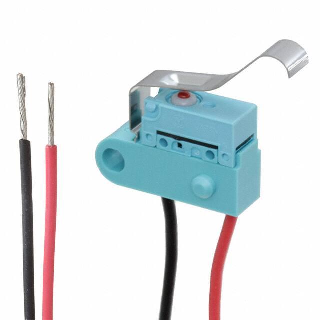

SnapActionSwitch_neu.book Seite 25 Montag, 20. Oktober 2008 4:03 16 ABJ1,2,3,4,5 TURQUOISE SWITCHES ABJ TYPE HIGH ENVIRONMENTAL RESISTANCE FEATURES 12.8 6 6.5 Dust protected type (Mounting hole 2.3mm type) Immersion protected type (wire leads bottom type) (Mounting hole 2.3mm type) Immersion protected (wire leads side type) Long stroke type • Ultra-miniature size (12.8×6.5×6 mm) • Sealed construction for use in adverse environment-Sealed construction by epoxy resin and rubber cap greatly reduces possible miscontact due to contaminants such as dust. Conforming to IP67* of IEC protective construction classification • Elastomer double molding technology, an industry first and ultrasonic swaging technology contribute to uniform sealing in high production quantities • UL/CSA approved (Except the long stroke type of ABJ2 and the side wire leads type.) • Long stroke type is available Since the repeatability is excellent and the play distance (overtravel) from the operating position is ample, the task of performing adjustments during installation is easy. Operating position accuracy ±0.4 mm Overtravel= Min. 2.0 mm As wide range of high pressure is achieved, a stable reliability is ensured • Leaf lever side wire leads type added. We now offer two types. M3 type installation hole Fixed pin type TYPICAL APPLICATIONS http://panasonic-denko.co.jp/ ac/e/service/environment • Industrial use video jack • Automotive (ex. Device for opening and shutting of automobile doors) * Based on the protective construction classification of IEC, items which satisfy the test requirements are denoted with an IP designation. ORDERING INFORMATION (If Agency standard required, please refer to the “with Agency standard type”. See next page.) Ex. ABJ Type of switch Size of mounting hole ABJ: Turquoise switch J type 1: 1.2 mm 2: 2.3 mm 3: 3 mm 4: Fixed pin (right side pin) type Fixed pin (left side pin) type 1 4 1 0 Contact arrangement Terminal 4: Solder terminal 5: PC board terminal 6: Wire leads (bottom type) 7: Wire leads (right side type) 8: Wire leads (left side type) 1: SPDT 2: SPST-NC (Wire leads type only) 3: SPST-NO (Wire leads type only) 4 0 Actuator 0: Pin plunger 2: Hinge lever 4: Simulated roller lever 6: Roller lever 8: Leaf lever (Mounting hole 3 mm lead wire type only) L: Long stroke type Operating force by pin plunger (max.) 4: 1.23 N 6: 1.96 N 7: 2.45 N (Long stroke type only) Contact 0: AgNi alloy 1: AgNi alloy + Au clad Remarks: 1. Standard packing: Dust protected type 100 pcs./carton, 2,000 pcs./case; Immersion protected type 50 pcs./case. 2. Not every combination is available. Please refer to the following table, “PRODUCT TYPES”. 25 06/2009 SnapActionSwitch_neu.book Seite 26 Montag, 20. Oktober 2008 4:03 16 ABJ1,2,3,4,5 With Agency standard type Ex. ABJ Type of switch ABJ: Turquoise switch J type Size of mounting hole 1: 1.2 mm 2: 2.3 mm 3: 3 mm 1 4 Terminal 4: Solder terminal 5: PC board terminal 6: Wire leads (bottom type) 1 0 4 0 9 Contact arrangement Actuator 1: SPDT 2: SPST-NC (Wire leads type only) 3: SPST-NO (Wire leads type only) 0: Pin plunger 2: Hinge lever 4: Simulated roller lever 6: Roller lever 8: Leaf lever (Mounting hole 3 mm lead wire type only) Operating force by pin plunger (max.) 4: 1.23 N 6: 1.96 N Contact Agency standard 0: AgNi alloy 1: AgNi alloy + Au clad 9: UL/CSA 6 × 103 rated Remarks: 1. Standard packing: Dust protected type 100 pcs./carton, 2,000 pcs./case; Immersion protected type 50 pcs./case. 2. Not every combination is available. Please refer to the following table, “PRODUCT TYPES”. CONTACT ARRANGEMENT 1. SPDT 2. SPST-NC (Wire leads type only) COM NO NC COM NC APPLICABLE CURRENT RANGE (reference) 2A AgNi alloy 1A OF1.23N OF1.96N 100mA Au clad 1mA 0 DC 5V AC 5V 15V 15V 30V 125V Note) OF: Value of pin plunger 26 06/2009 3. SPST-NO (Wire leads type only) COM NO SnapActionSwitch_neu.book Seite 27 Montag, 20. Oktober 2008 4:03 16 ABJ1,2,3,4,5 PRODUCT TYPES 1. Dust protected type (Terminal type) Mounting hole 1.2mm type / Mounting hole 2.3mm type AgNi alloy Actuator Pin plunger Hinge lever Simulated roller lever Roller lever Operating force Max. 1.23 N 1.96 N 0.39 N 0.64 N 0.39 N 0.64 N 0.39 N 0.64 N Mounting hole 1.2 mm type Solder terminal PC board terminal ABJ1410409 ABJ1510409 ABJ1410609 ABJ1510609 ABJ1412409 ABJ1512409 ABJ1412609 ABJ1512609 ABJ1414409 ABJ1514409 ABJ1414609 ABJ1514609 ABJ1416409 ABJ1516409 ABJ1416609 ABJ1516609 Mounting hole 2.3 mm type Solder terminal ABJ2410409 ABJ2410609 ABJ2412409 ABJ2412609 ABJ2414409 ABJ2414609 ABJ2416409 ABJ2416609 Mounting hole 1.2 mm type Solder terminal PC board terminal ABJ1410419 ABJ1510419 ABJ1410619 ABJ1510619 ABJ1412419 ABJ1512419 ABJ1412619 ABJ1512619 ABJ1414419 ABJ1514419 ABJ1414619 ABJ1514619 ABJ1416419 ABJ1516419 ABJ1416619 ABJ1516619 Mounting hole 2.3 mm type Solder terminal ABJ2410419 ABJ2410619 ABJ2412419 ABJ2412619 ABJ2414419 ABJ2414619 ABJ2416419 ABJ2416619 AgNi alloy + Au clad Actuator Pin plunger Hinge lever Simulated roller lever Roller lever Operating force Max. 1.23 N 1.96 N 0.39 N 0.64 N 0.39 N 0.64 N 0.39 N 0.64 N 2-(1). Immersion protected type (Bottom wire leads type) Mounting hole 1.2mm type AgNi alloy Actuator Pin plunger Hinge lever Simulated roller lever Roller lever Operating force Max. 1.23 N 1.96 N 0.39 N 0.64 N 0.39 N 0.64 N 0.39 N 0.64 N SPDT ABJ1610409 ABJ1610609 ABJ1612409 ABJ1612609 ABJ1614409 ABJ1614609 ABJ1616409 ABJ1616609 Mounting hole 1.2 mm type SPST-NC ABJ1620409 ABJ1620609 ABJ1622409 ABJ1622609 ABJ1624409 ABJ1624609 ABJ1626409 ABJ1626609 SPST-NO ABJ1630409 ABJ1630609 ABJ1632409 ABJ1632609 ABJ1634409 ABJ1634609 ABJ1636409 ABJ1636609 SPDT ABJ1610419 ABJ1610619 ABJ1612419 ABJ1612619 ABJ1614419 ABJ1614619 ABJ1616419 ABJ1616619 Mounting hole 1.2 mm type SPST-NC ABJ1620419 ABJ1620619 ABJ1622419 ABJ1622619 ABJ1624419 ABJ1624619 ABJ1626419 ABJ1626619 SPST-NO ABJ1630419 ABJ1630619 ABJ1632419 ABJ1632619 ABJ1634419 ABJ1634619 ABJ1636419 ABJ1636619 Mounting hole 2.3mm type AgNi alloy + Au clad Actuator Pin plunger Hinge lever Simulated roller lever Roller lever Operating force Max. 1.23 N 1.96 N 0.39 N 0.64 N 0.39 N 0.64 N 0.39 N 0.64 N 27 06/2009 SnapActionSwitch_neu.book Seite 28 Montag, 20. Oktober 2008 4:03 16 ABJ1,2,3,4,5 Mounting hole 2.3mm type AgNi alloy Actuator Pin plunger Hinge lever Simulated roller lever Roller lever Operating force Max. 1.23 N 1.96 N 0.39 N 0.64 N 0.39 N 0.64 N 0.39 N 0.64 N SPDT ABJ2610409 ABJ2610609 ABJ2612409 ABJ2612609 ABJ2614409 ABJ2614609 ABJ2616409 ABJ2616609 Mounting hole 2.3 mm type SPST-NC ABJ2620409 ABJ2620609 ABJ2622409 ABJ2622609 ABJ2624409 ABJ2624609 ABJ2626409 ABJ2626609 SPST-NO ABJ2630409 ABJ2630609 ABJ2632409 ABJ2632609 ABJ2634409 ABJ2634609 ABJ2636409 ABJ2636609 SPDT ABJ2610419 ABJ2610619 ABJ2612419 ABJ2612619 ABJ2614419 ABJ2614619 ABJ2616419 ABJ2616619 Mounting hole 2.3 mm type SPST-NC ABJ2620419 ABJ2620619 ABJ2622419 ABJ2622619 ABJ2622419 ABJ2624619 ABJ2626419 ABJ2626619 SPST-NO ABJ2630419 ABJ2630619 ABJ2632419 ABJ2632619 ABJ2634419 ABJ2634619 ABJ2636419 ABJ2636619 SPDT ABJ3618409 ABJ3618609 Mounting hole 3 mm type SPST-NC ABJ3628409 ABJ3628609 SPST-NO ABJ3638409 ABJ3638609 SPDT ABJ3618419 ABJ3618619 Mounting hole 3 mm type SPST-NC ABJ3628419 ABJ3628619 SPST-NO ABJ3638419 ABJ3638619 AgNi alloy + Au clad Actuator Pin plunger Hinge lever Simulated roller lever Roller lever Operating force Max. 1.23 N 1.96 N 0.39 N 0.64 N 0.39 N 0.64 N 0.39 N 0.64 N Mounting hole 3mm type (Leaf lever type) AgNi alloy Actuator Operating force Max. 0.98 N 1.27 N Leaf lever AgNi alloy + Au clad Actuator Operating force Max. 0.98 N 1.27 N Leaf lever 2-(2). Immersion protected type (Side wire leads type) Fixed pin (right side pin) type AgNi alloy Actuator Leaf lever Operating force Max. Wire leads direction 1.27 N 1.27 N 1.76 N 1.76 N Right Left Right Left Operating force Max. Wire leads direction 1.27 N 1.27 N 1.76 N 1.76 N Right Left Right Left Wire leads type SPST-NC ABJ472840 ABJ482840 ABJ472860 ABJ482860 SPST-NO ABJ473840 — ABJ473860 — AgNi alloy + Au clad Actuator Leaf lever 28 06/2009 Wire leads type SPST-NC ABJ472841 ABJ482841 ABJ472861 ABJ482861 SPST-NO ABJ473841 — ABJ473861 — SnapActionSwitch_neu.book Seite 29 Montag, 20. Oktober 2008 4:03 16 ABJ1,2,3,4,5 Fixed pin (left side pin) type AgNi alloy Actuator Leaf lever Operating force Max. Wire leads direction 1.27 N 1.27 N 1.76 N 1.76 N Right Left Right Left Operating force Max. Wire leads direction 1.27 N 1.27 N 1.76 N 1.76 N Right Left Right Left Operating force Max. Wire leads direction 1.27 N 1.76 N Left Operating force Max. Wire leads direction 1.27 N 1.76 N Left Wire leads type SPST-NC ABJ572840 ABJ582840 ABJ572860 ABJ582860 SPST-NO ABJ573840 — ABJ573860 — AgNi alloy + Au clad Actuator Leaf lever Wire leads type SPST-NC ABJ572841 ABJ582841 ABJ572861 ABJ582861 SPST-NO ABJ573841 — ABJ573861 — Mounting hole 3mm type AgNi alloy Actuator Leaf lever Wire leads type SPST-NC ABJ382840 ABJ382860 AgNi alloy + Au clad Actuator Leaf lever Wire leads type SPST-NC ABJ382841 ABJ382861 3. Immersion protected type (Bottom wire leads type) Long stroke type Mounting hole 2.3mm type AgNi alloy Actuator Pin plunger (Horizontal) Operating force Max. 2.45 N SPDT *ABJ261L70 Mounting hole 2.3 mm type SPST-NC ABJ262L70 SPST-NO ABJ263L70 SPDT *ABJ261L71 Mounting hole 2.3 mm type SPST-NC ABJ262L71 SPST-NO ABJ263L71 AgNi alloy + Au clad Actuator Pin plunger (Horizontal) Operating force Max. 2.45 N SPECIFICATIONS 1. Contact rating Type Operating force Max. Standard rating Low-level circuit rating 1.76 N, 1.96 N 2 A 125 V AC 2 A 30 V DC — 1.23 N, 1.27 N 1 A 125 V AC 1 A 30 V DC — 2.45 N 1 A 125 V AC 1 A 30 V DC — AgNi alloy + Au clad contact 1.23 N, 1.27 N 1.76 N, 1.96 N 0.1 A 125 V AC 5 mA 6 V DC 2 mA 12 V DC 1 mA 24 V DC Long stroke type AgNi alloy + Au clad contact 2.45 N 0.1 A 125 V AC 0.1 A 30 V DC 5 mA 6 V DC 2 mA 12 V DC 1 mA 24 V DC AgNi alloy contact Long stroke type AgNi alloy contact 29 06/2009 SnapActionSwitch_neu.book Seite 30 Montag, 20. Oktober 2008 4:03 16 ABJ1,2,3,4,5 2. Characteristics Leaf lever, Long stroke type Mechanical life (O.T.: Specified value) Min. 5×105 (at 60 cpm) Wire leads (right & left side type) Min. 3×105 (at 60 cpm) Other types Min. 106 (at 60 cpm) AgNi alloy contact type Min. 3×104 (at 20 cpm) AgNi alloy + Au clad contact type Min. 105 (at 20 cpm) Min. 100 MΩ (at 500 V DC insulation resistance meter) Electrical life at rated load (O.T.: max.) Insulation resistance Dielectric strength Between non-continuous terminals Between each terminal and other exposed metal parts Between each terminal and ground Vibration resistance (Pin plunger type) Shock resistance (Pin plunger type) Silver contact type Contact resistance (Initial) Gold clad contact type Allowable operating speed (at no load) Max. operating cycle rate (at no load) Ambient temperature Unit weight 600 Vrms 1,500 Vrms 1,500 Vrms 10 to 55 Hz at single amplitude of 0.75 mm (Contact opening max. 1 msec.) Min. 294 m/s2{30 G} (Contact opening max. 1 msec.) Dust protected type (IP50): Max. 50 mΩ Immersion protected type (IP67): Max. 100 mΩ (By voltage drop 1 A 6 to 8 V DC) Dust protected type (IP50): Max. 100 mΩ Immersion protected type (IP67): Max. 150 mΩ (By voltage drop 0.1 A 6 to 8 V DC) 1 to 500 mm/sec. Other type: 120 cpm Long stroke type: 60 cpm –40°C to +85°C Approx. 0.5 g (IP50 type) 3. Operating characteristics Type of actuator Operating force, Max. Release force, Min 1.23N 0.15N Pin plunger 1.96N 0.25N 0.39N 0.029N 0.64N 0.049N 0.39N 0.029N 0.64N 0.049N 0.39N 0.029N Hinge lever Pretravel, Max. mm Movement differential, Max. mm Overtravel, Min. mm Operating position, mm 0.6 0.12 0.25 Mounting hole: 1.2 5.5±0.2 Mounting hole: 2.3 7.0±0.2 0.5 Mounting hole: 1.2 6.8±1.0 Mounting hole: 2.3 8.3±1.0 3.0 Simulated roller lever Roller lever 0.5 3.0 0.5 0.5 Mounting hole: 1.2 9.8±1.0 Mounting hole: 2.3 11.3±1.0 3.0 0.5 0.5 Mounting hole: 1.2 13.1 ±1.0 Mounting hole: 2.3 14.6±1.0 Mounting hole: 3.0 16.0±2.0 0.64N 0.049N 0.98N 0.20N 6.0 1.0 2.5 1.27N 0.22N 2.6 0.5 1.4 1.76N 0.26N 2.6 0.5 1.4 1.27N 0.29N 6.0 1.0 2.5 Mounting hole: 3.0 16.0±2.0 2.45N 0.20N — 0.5 2.0 2.5±0.4 Leaf lever Long stroke type Note: The O.P. differs between the 1.2 mm and 2.3 mm dia. installation hole types. 30 06/2009 Fixed pin type 10.7±0.7 Mounting hole: 3.0 16.25±0.7 Fixed pin type 10.7±0.7 Mounting hole: 3.0 16.25±0.7 SnapActionSwitch_neu.book Seite 31 Montag, 20. Oktober 2008 4:03 16 ABJ1,2,3,4,5 DIMENSIONS mm General tolerance: ±0.25 1. Dust protected type 1-(1) PC board terminal Mounting hole 1.2 mm type Pin plunger 1.2±0.05 dia. 5.4±0.3 1.5 dia Pretravel 0.6Max. Operating Position 5.5±0.2 1.0 5.0±0.15 5.08±0.1 5.08±0.1 1.1±0.12 +0.12 2-0 1.5±0.1 5.50 dia. 1.5±0.12 1.6 0.9 5.08±0.15 t=0.4 6-C 0.3 6.5±0.1 1.25±0.12 5.08±0.15 12.8±0.15 4.4 6 Pretravel, Max. mm Movement differential, Max. mm Overtravel, Min. mm Distance from mounting hole, mm Operating position Distance from stand-off, mm 0.6 0.12 0.25 5.5±0.2 7±0.3 Hinge lever 8.6 4.4±0.4 1.2±0.05 dia. 3 Pretravel 3.0Max. R13.3 5.08±0.1 Operating Position 6.8±1.0 4.2 8.3±1.2 5.08±0.1 Pretravel, Max. mm Movement differential, Max. mm Overtravel, Min. mm Distance from mounting hole, mm Operating position Distance from stand-off, mm 3.0 0.5 0.5 6.8±1.0 8.3±1.2 Simulated roller lever 3.3±0.4 1.2±0.05 dia. Pretravel 3.0Max. 3 R13.2 R2.5 5.08±0.1 Operating Position 9.8±1.0 5.08±0.1 Pretravel, Max. mm Movement differential, Max. mm Overtravel, Min. mm Distance from mounting hole, mm Operating position Distance from stand-off, mm 11.3±1.2 3.0 0.5 0.5 9.8±1.0 11.3±1.2 Roller lever 3.4±0.4 2.2 Pretravel 3.0Max. 1.2±0.05 dia. R13.8 4.8 dia. Operating Position 13.1±1.0 5.08±0.1 5.08±0.1 14.6±1.2 Pretravel, Max. mm Movement differential, Max. mm Overtravel, Min. mm Distance from mounting hole, mm Operating position Distance from stand-off, mm 3.0 0.5 0.5 13.1±1.0 14.6±1.0 31 06/2009 SnapActionSwitch_neu.book Seite 32 Montag, 20. Oktober 2008 4:03 16 ABJ1,2,3,4,5 1-(2) Solder terminal Pin plunger Mounting hole: 1.2 mm 5.4±0.3 mm General tolerance: ±0.25 Mounting hole: 2.3 mm 1.5 dia Pretravel 0.6Max. 4.6±0.3 Operating Position 5.5±0.2 5±0.15 1.5 dia Operating Position 7±0.2 +0.1 2.4-.05 6.5±0.15 5.7 1.0 1.5 Pretravel 0.6Max 5 1.7 1.5±0.1 1.5 +0.12 -0 2-1.2 1.2 dia. 2.2 2 0.4 6-C 0.3 6.5±0.1 +0.1 5.08±0.15 5.08±0.15 12.8±0.15 0.4 2.4-0.05 dia. 0.5 4.4 1.2 2.2 4.8±0.1 6 6 6 5.08±0.15 5.08±0.15 12.8±0.15 Remarks: Dimensions of the actuator type are the same as corresponding PC board terminal types. 2. Immersion protected type 2-(1) Bottom wire leads type Pin plunger Mounting hole: 1.2 mm Mounting hole: 2.3 mm 13.9 6.5±0.15 7.50 8.2 COM N.O. Thickness of the lead wire: 0.3 mm2 UL/CSA approved type: AWG22 Color of the lead wire: COM ...Black N.C. ...Red N.O. ...White 300±10 5±2 300±10 5±2 13.9±0.4 6 Remarks: 1. As for M1.2 type, other dimensions are the same as those of corresponding PC board terminal types. As for M2.3 type, other dimensions are the same as those of corresponding solder terminal types. 2. Dimensions of the actuator type are the same as corresponding PC board terminal types. 32 06/2009 N.C. Thickness of the lead wire: 0.3 mm2 UL/CSA approved type: AWG22 Color of the lead wire: COM ...Black N.C. ....Red N.O. ...White SnapActionSwitch_neu.book Seite 33 Montag, 20. Oktober 2008 4:03 16 ABJ1,2,3,4,5 Leaf lever Mounting hole: 3 mm mm General tolerance: ±0.25 Pretravel 6 max. 13±0.1 9 R2.5 4.8±0.3 2.5 8.6±1 5 Free Position (19.0) Operating Position (16±2) 5 3.1 +0.1 –0.05 Totaltravel Position (11.5 min.) 3.3 9.25 7.5 6.5 4.4 3 +0 –0.15 dia. R3.25 300±10 Pretravel, Max. mm Movement differential, Max. mm Overtravel, Min mm Distance from Operating mounting hole, position mm 5±2 6 20.0±0.4 6.0 1.0 2.5 16.0±2.0 2-(2) Side wire leads type Fixed pin type Right side pin type Right wire leads type 9.53±0.1 6.0 5.0 C0.2 +0.0 5.0−0.2 2.2±0.05 dia. 2.6±0.05 Free position (F.P.) 13.05 max. Operating position (O.P.) 10.7±0.7 Totaltravel position (T.T.P.) (8.55) 6.7 2.6±0.05 R2.0 9.53 7.6±1.0 6.9±0.3 3.45 8.55 5±2 16.65 300±10 Pretravel, Max. mm Movement differential, Max. mm Overtravel, Min mm Distance from Operating mounting hole, position mm 2.6 0.5 1.4 10.7±0.7 33 06/2009 SnapActionSwitch_neu.book Seite 34 Montag, 20. Oktober 2008 4:03 16 ABJ1,2,3,4,5 Right side pin type Left wire leads type mm General tolerance: ±0.25 9.53±0.1 C0.2 +0.0 5.0−0.2 2.2±0.05 dia. 2.6±0.05 Free position (F.P.) 13.05 max. Operating position (O.P.) 10.7±0.7 Totaltravel position (T.T.P.) (8.55) 6.7 6.0 5.0 2.6±0.05 R2.0 9.53 7.6±1.0 6.9±0.3 3.45 Pretravel, Max. mm Movement differential, Max. mm Overtravel, Min mm Distance from Operating mounting hole, position mm 8.55 5 ±2 300±10 16.65 Left side pin type Right wire leads type 2.6 0.5 1.4 10.7±0.7 9.53 2.6±0.05 C0.2 2.2±0.05 dia. 9.53±0.1 6.7 6.0 5.0 Free position (F.P.) 13.05 max. Operating position (O.P.) 10.7±0.7 Totaltravel position (T.T.P.) (8.55) +0.0 5.0−0.2 2.6±0.05 R2.0 7.6±1.0 6.9±0.3 3.45 8.55 5 16.65 Left side pin type Left wire leads type 300±10 ±2 Pretravel, Max. mm Movement differential, Max. mm Overtravel, Min mm Distance from Operating mounting hole, position mm 2.6 0.5 1.4 10.7±0.7 9.53 2.6±0.05 C0.2 2.2±0.05 dia. 9.53±0.1 6.7 6.0 5.0 Free position (F.P.) 13.05 max. Operating position (O.P.) 10.7±0.7 Totaltravel position (T.T.P.) (8.55) +0.0 5.0−0.2 2.6±0.05 R2.0 7.6±1.0 6.9±0.3 3.45 8.55 5±2 300±10 16.65 34 06/2009 Pretravel, Max. mm Movement differential, Max. mm Overtravel, Min mm Distance from Operating mounting hole, position mm 2.6 0.5 1.4 10.7±0.7 SnapActionSwitch_neu.book Seite 35 Montag, 20. Oktober 2008 4:03 16 ABJ1,2,3,4,5 Mounting hole 3mm type mm General tolerance: ±0.25 C0.30 +0.1 8.4−0.3 R2.0 +0.2 6.0−0.15 5.8±1.0 +0 3.0−0.1 dia. 5 12.3 1.85±0.3 Free position (F.P.) 18.6 max. Operating position (O.P.) 16.25±0.7 Totaltravel position (T.T.P.) (14.1) 5.0 Pretravel, Max. mm Movement differential, Max. mm Overtravel, Min mm Distance from Operating mounting hole, position mm +0.1 3.1−0 9.0 3.3 6.0 ±2 4.0 300±10 13.0 ±0.1 19.6 2.6 0.5 1.4 16.25±0.7 3. Immersion protected type (Bottom wire leads type) Long stroke type Mounting hole: 2.3 mm Free position (F.P.) 3.2 max. 16.7 Operating position (O.P.) 1.0 2.5±0.4 2.0 dia. 9.0 4.95 6.0 12.8 −0.15 dia. 3.0 +0. 6.0±0.15 8.1 +0.1 2.4−0.05 19.4 2.5±0.1 8.2 C0.6 −0.05 dia. 2.4 +0.1 4.8±0.1 300±10 5±2 COM NO Movement differential, Max. mm Overtravel, Min mm Operating position NC 13.9±0.4 0.5 2.0 2.5 ±0.4 35 06/2009
