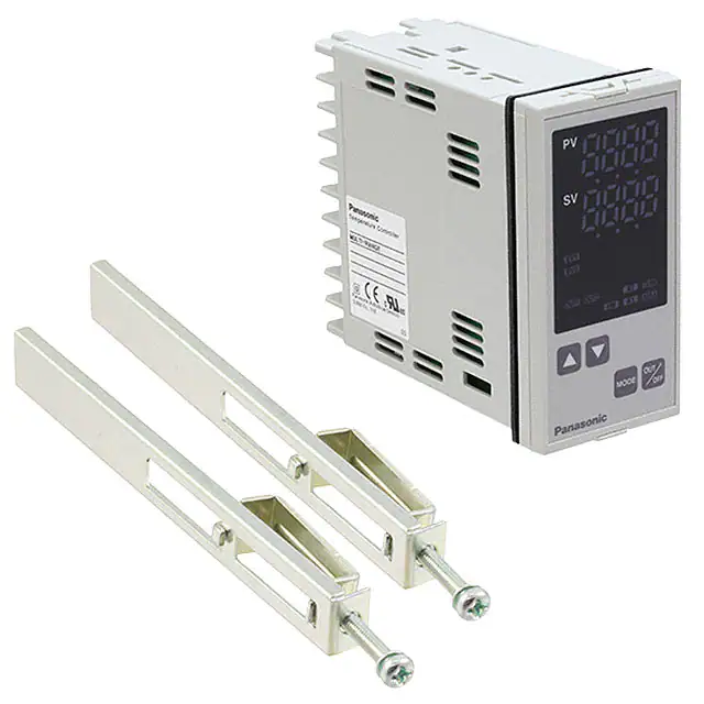

KT Series Temperature Controller 08/2006 KT Series Overview Common Features KT4H KT2 KT4 KT7 A Multi-input: Versatile thermocouple, RTD, DC Current, DC Voltage A Control modes: PID, on/off control, Anti-Reset-Windup (ARW) A Control output: Relay, non-contact voltage output (for SSR drive, DC current output) A Accuracy: ± 0.2% span A Simple operation A Heater-burn-out alarm available A Alarm output with 9 different operation modes A RS485 ASCII/Modbus communication available A Supply voltage: 24V AC/DC or 100 to 240V AC A Compliant with UL, CSA standards and CE marking Multi-input: KT8 KT9 A A A A Thermocouples K, J, R, S, B, E, T, N, PL-II, C(W/Re5-26) RTD Pt100, JPt100, 3-conductor system DC current 0/4 - 20mA DC Voltage 0 to 1V, 0 to 5V, 1 to 5V, 0 to 10V Application examples: Constant temperature bath Scrubber Shrink wrapping machine Oven Warm and cold storage units Output Methods: Output method Characteristics Relay contact output is used for switching up to 3A 250V AC (resistive load) in applications in which the on-off frequency is low. This voltage output is used for driving the SSR . Since the SSR is a semiconductor relay, contact life is long. This type is used in applications in which the on-off frequency is high. Up to 40mA 12V DC can be switched. This current output is used to control a power regulator. Smooth and accurate control is possible because phase control corresponds to the current output. Relay contact output Voltage output for SSR drive DC current output 2 08/2006 KT Series Display and Operation Indicators (backlight: orange) Lights up respectively when temperature unit F°/C° is selected. Light ups during serial communication (option) TX output. Lights up when control output is ON or Heating output (option) is ON. Switches the control output ON or OFF and selects Auto/Manual control. KT2 display and operation features: PV indicator SV indicator Autotuning indicator Indicator for serial comm. Out1 indicator PV/SV display (switchable) Event1: Indicator for Alarm 1/2 or Control Out2 MEMO/STEP display indicates memory number during fixed value control. Indicates step number during program control. Event2: Indicator for Alarm 1/2 3 08/2006 KT4H Product Types Space saving, high performance Temperature Controller KT4H • 1/16 DIN size temperature controller • Size 48 x 48 x 56mm (WxHxD) • Panel-mounted type • IP66 waterproof (frontside if panel mounted) • 2nd optional alarm output • Heating and cooling control with 2nd optional control output (non-contact voltage output) • 11-segment display with 3 colours for PV • 4 set values (externally selectable) • Tool Port as standard • MEWTOCOL communication • Heater burnout alarm supports 3-phase heaters Ordering code A K T 4 H 1 1 1 1 0 0 1 Power supply 1=100 to 240V AC 2=24V AC/DC Sensor input 1=multi-input In stock: A K T 4 H 1111 0 0 A K T 4 H 11 2 1 0 0 A K T 4 H 11 3 1 0 0 A K T 4 H 2 111 0 0 AKT4H212100 AKT4H213100 A K T 4 H 1111 0 0 1 A K T 4 H 2 111 0 0 1 Communication function blank=not available 1=RS485 2=contact input Control output 1=relay 2=non-contact voltage 3=DC current Alarm output 1=alarm1 relay 2=alarm1 and alarm2 relay other types on demand Heater burnout alarm 0=not available 3=20A single phase 4=50A single phase 5=20A three phase 6=50A three phase Heating/Cooling control output 0=no control output 2 1=relay 2=non-contact voltage 4 08/2006 KT4H New Features of KT4H (in comparison with KT4) Better readability Time-proven display with negative LCD + LED backlight 11-segment LCD with improved readability Largest display of PV in its class PV indication in three different colour Also, the 11-segment LCD displays makes it easier to read alphanumeric characters The The ability of the PV value to change color makes it easy to determine the process status at a glance (three colour available). Improved control functions Four setting values (SV) selectable using external input (option). 5 08/2006 KT4H New Features of KT4H (in comparison with KT4) Improved communication functions several KT4H to FP-Series PLCs MEWTOCOL communications protocol is built in. Up to 31 units can be connected and data can be collected using a FP (Sigma) PLC. Comes with MEWTOCOL. Collect data with the PLC. FP (Sigma) Standard external tool port Tool Port of KT4H With the external tool port, all settings can be loaded and made. USB Port KT Monitor Software AKT4H820 Tool Port Converter Cable Space savings inch Ability to use any sensor (input) is inherited from KT Series The KT4H comes equipped with the ability to use any sensor High accuracy and high sampling period also inherited from KT Series Easier operation The switch layout has been changed so that mode changes can be executed more easily using the front keys. Protective construction 6 08/2006 KT4H KT-Monitor Software KT-Monitor is a convenient software tool for editing the parameters of KT4H, saving parameters in a file, monitoring of temperature data, and monitoring and saving log files of designated values. KT-Monitor Main Window Parameters can easily be understood and are accessible in a clear, convenient form. Ordering information: KT-Monitor Set CD with Software, Manuals, Tool Port cable AKT4H820 Requirements: PC with Windows 98/ME/2000 or XP, USB-Port, Tool cable AKT4H820, USB driver installed (included with KT-Monitor) 7 08/2006 KT4H KT-Monitor Software Sampling and trend monitoring of PV, SV, MV1 and MV2 KT-Monitor Trace display With the Trace display you can display and analyze the temperature PV, the set value SV and the control output MV. MV2 will be indicated only when Heating/Cooling control option is added. All values can also be recorded into a CSV-File for later rework with e.g. Excel. The colours of the traces are selectable. The recording time interval is selectable (min. 1 sec.) and also the total number of records can be selected between 600 (10 min.) and 9000 (150 min.). For scaling of the displayed values, high and low limit values can be entered. 8 08/2006 KT2 Product Types Ti n y s i z e – p a t t e r n c o n t r o l Temperature Controller KT2 • 1/32 DIN size temperature controller • Size 48 x 24 x 98.5mm (WxHxD) • 9-step pattern control (ramp function) • Panel-mounted type • IP66 waterproof (front side if panel mounted) • 2 set values possible (externally selectable) • 2nd optional alarm output • Heating and cooling control with 2nd optional control output (relay) • Analogue value converter function Ordering code A K T 2 1 1 1 1 0 0 1 Power supply 1=100 to 240V AC 2=24V AC/DC Sensor input 1=multi-input In stock: A K T 2 111 2 0 0 A K T 2 11 2 2 0 0 A K T 2 11 3 2 0 0 A K T 2 2 11 2 0 0 AKT2212200 A K T 2 1111 0 0 1 AKT22120101 AKT22121001 RS485 interface blank=not available 1=available Control output 1=relay 2=non-contact voltage 3=DC current Alarm output 0=no alarm output 1=1 alarm output* 2=2 alarm outputs, 1 relay, 1 open collector output Heater burnout alarm 0=not available other types on demand Heating/Cooling control output 0=no control output 2 1=relay 3A 250V AC * Type depends on other options 9 08/2006 KT4 Product Types Small sized standard type Temperature Controller KT4 • 1/16 DIN size temperature controller • Size 48 x 48 x 95mm (WxHxD) • Panel-mounted type • IP66 waterproof (frontside if panel mounted) • 2nd optional alarm output • Heating and cooling control with 2nd optional control output (non-contact voltage output) Ordering code A K T 4 1 1 1 1 0 0 1 Power supply 1=100 to 240V AC 2=24V AC/DC Sensor input 1=multi-input In stock: A K T 4 1111 0 0 A K T 4 111 2 0 0 A K T 4 11 2 1 0 0 A K T 4 11 2 1 4 0 A K T 4 11 3 1 0 0 A K T 4 2 111 0 0 A K T 4 2 111 4 0 AKT4212100 AKT4212140 A K T 4 1111 0 0 1 A K T 4 2 111 0 0 1 other types on demand Communication function blank=not available 1=RS485 Control output 1=relay 2=non contact voltage 3=DC current Heater burnout alarm 0=not available 1=5A 2=10A 3=20A 4=50A Heating/Cooling control output 0=no control output 2 4=SSR output 0.3A 250V AC Alarm output 1=alarm 1 relay 2=alarm1 and alarm2 relay 10 08/2006 KT7 Product Types Handy and slim Temperature Controller KT7 • Size 22.5 x 75 x 100mm (WxHxD) • Front screw terminals • DIN rail mounting type • Analogue value converter function Ordering code A K T 7 1 1 1 1 0 0 1 Power Supply 1=100 to 240V AC 2=24V AC/DC Sensor input 1=multi-input In stock: A K T 7 1111 0 0 A K T 7 11 2 1 0 0 A K T 7 11 3 1 0 0 A K T 7 2 111 0 0 AKT7212100 AKT7213100 A K T 7 1111 0 0 1 A K T 7 1111 0 0 1 A K T 7 2 111 0 0 1 AKT72121001 other types on demand Control output 1=relay 2=non-contact voltage 3=DC current Alarm output 0=alarm1 open collector Communication function blank=not available 1=RS485 Heater burnout alarm 0=not available 1=5A 2=10A 3=20A 4=50A Heating/Cooling control output 0=no control output 2 11 08/2006 KT8 Product Types Wi d e v a r i e t y o f o p t i o n s , e a s i l y r e a d a b l e d i s p l a y Temperature Controller KT8 • 1/8 DIN size temperature controller • Size 48 x 96 x 98.5mm (WxHxD) • Panel-mounted type • IP66 waterproof (front side if panel mounted) • 2 set values possible (externally selectable) • 2nd optional alarm output • Heating and cooling control with 2nd optional control output (relay, non-contact voltage, or current) • Ordering code Ordering code A K T 8 1 1 1 1 0 0 1 Power supply 1=100 to 240V AC 2=24V AC/DC Sensor input 1=multi-input In stock: Control output 1=relay A K T 8 1111 0 0 2=non-contact voltage A K T 8 11 2 1 0 0 3=DC current A K T 8 11 2 2 0 0 AKT8212210 Alarm output A K T 8 11 2 2 0 0 1 0=alarm1 open AKT82122001 collector other types on demand 2=alarm1 and alarm2 relay Communication function blank=not available 1=RS485 Heater burnout alarm 0=not available 1=5A 2=10A 3=20A 4=50A Heating/Cooling control output 0=no control output 2 1=relay 2=non-contact voltage 3=current output 12 08/2006 KT9 Product Types Big display Temperature Controller KT9 • 1/4 DIN size temperature controller • Size 96 x 96 x 98.5mm (WxHxD) • Panel-mounted type • IP66 waterproof (front side if panel mounted) • 2 set values possible (externally selectable) • 2nd optional alarm output • Heating and cooling control with 2nd optional control output (relay, non-contact voltage, or current) • Ordering code Ordering code A K T 9 1 1 1 1 0 0 1 Power supply 1=100 to 240V AC 2=24V AC/DC Sensor input 1=multi-input In stock: A K T 9 1111 0 0 A K T 9 11111 0 A K T 9 11 2 1 0 0 A K T 9 11 3 2 3 0 AKT9212100 AKT9212120 A K T 9 1111 0 0 1 A K T 9 2 111 0 0 1 Control output 1=relay 2=non-contact voltage 3=DC current Alarm output 1=alarm1 open collector 2=alarm1 and alarm2 relay Communication function blank=not available 1=RS485 Heater burnout alarm 0=not available 1=5A 2=10A 3=20A 4=50A Heating/Cooling control output 0=no control output 2 1=relay 2=non-contact voltage 3=current output other types on demand 13 08/2006 KT Series Ratings and Specifications Speci fica tions Display KT2 Size (W x H x D) KT4 48 x 24 x 98.5mm KT4H Frequency Power cons ump tion Ap prox. V 5A Ap prox. V 8A Approx. 8VA Inpute pty Ap prox. V 8A Approx. 6VA –200 to 1370°C J –200 to 1000°C R S B E T 0 to 1760°C 0 to 1760°C 0 to 1820°C –200 to 800°C –200.0 to 400.0°C –199.9 to 400.0°C –199.9 to 400.0°C –200 to 1300°C 0 to 1390°C 0 to 2315°C Pt100 DCVoltage 50/60Hz Ap prox. V 8A –199.9 to 400.0°C N PL-II C (W/Re5-26) DC Current KT7 Input range K RTD KT9 48 x 96 x 98.5mm 96 x 96x 98.5mm22.5 x 75 x 100mm 100 to 240V AC 24V AC/D C Sup lpy voltage (mustpecified) be s Thermocoupl e KT8 48 x 48 x 95mm 48 x 48 x 56mm JPt100 3-conductor ysstem –199.9 to 850.0°C –200 to 850°C –200 to 850.0°C –199.9 to 850.0°C –199.9 to 500.0°C –200 to 500°C –200 to 500.0°C –199.9 to 500.0°C 4 to 20mA DC 1) 0 to 20mA DC 1) 0 to 1V C D 2) 0 to 10V DC 3) 1 to 5V C D 3) –1999 to 9999, –199.9 to 999.9 –19.99 to 99.99, –1.999 to 9.999 –2000 to 10000 –1999 to 9999, –199.9 to 999.9 –19.99 to 99.99, –1.999 to 9.999 0 to 5V C D 3) • Scal ing and change to the deci mal oint p pos ti ion sipossi ble for CD cur • DC current input supported is th wi an externa lly mounted 50 Rela y conta ct Control output Non-contact DC voltage DC current (Must be specified) Alarm output1 Output Methods Control mode Accuracy Sampling period Hysteres is Proportional band Integral time Derivative time Proportional cycle Allowable voltage fluctuation Insulated resistance Breakdown voltage Malfunction vibration 1a 1a 1b 1a 3A 250V AC (Res tive is loa d), 1A 250V W rent n ad DC vol tagenp u i t. shunt res istor (sol de s rat pa y). el 1a1b AC (Inductive o l ad cosØ=0.4),ect El 1a 1b 1a ric life: 100,000 mes ti 12 +20 14V DC; ma x., loa d current: 40mA (Short-circuit protected) 4 to 20mAD C Load res istance: x.550 Ma W Relay conta ct 1a3A 250V AC (Res tive is oad) l Open col lector, Contr ol Electric life: 100,000mes ti capacity: 24V DC 0.1A(Max.) Actions mentioned below can beelescted by key operation. [Default PID] PI D (with auto-tuning function), PI, PD (with manual res et function), P (with manual res et function), ON/OFF action Thermocouple: Within ±0.2% of each input p s an ±1 digit or within ±2°C whichever isgreater However, R and S input; within ±6°C in the range of 0 to 200°C B input 0 to 300°C: Accuracy isnot guaranteed. K, J, E and N input e l ss than 0 °C: Within ±0.4% of input p s an ±1 digit RTD: Within ±0.1% of each input p s an ±1 digit or ±1°C whichever is greater DC current and DC voltage: Within ±0.2% of each input p s an ±1 digit 250ms Thermocouple & RTD: 0.1 to 100.0 °C DC current and DC voltage: 1 to 1000 (The decimal point place followsthe sel ection) Thermocouple: 0 to 1000°C RTD: 0.0 to 999.9°C 0.0 to 110.0% DC current and DC voltage: 0.0 to 100.0% 0 to 1000 e s conds 0 to 300 e s conds 1 to 120 e s conds When 100 to 240V AC; 85 to 264V AC When 24V AC/DC; 20 to 28V AC/DC 500V DC 10MW or greater 1.5KV AC for 1 See KT8/KT9 min between input terminal and power terminal & between output terminal and power terminal 1.5KV AC for 1 1.5kV AC for 1min between input min between input terminal and ground terminal, terminal and power between input terminal and power terminal & between terminal between power terminaland output terminal ground terminal and power between output terminal and ground terminal terminal, & between output term inal and power terminal 10 to 55Hz (0.35mm) to each direction (120ms sw eep) for 10min. 14 08/2006 1.5KV AC for 1 min between input terminal and power terminal & between output terminal and power terminal KT Series Ratings and Specifications Display Specifications KT2 Breakdown vibration Malfunction shock Approx. 120g Waterproof Display character height Alarm output 2 Options Heating/Cooling control PV: 8.7mm SV: 8.7mm* 0.1A 24V DC Relay contact: 1a 3A 250V DC (Resistive load) None Communication function Tool Port KT8 KT9 Same as above, but 30G 0 to 50°C 35 to 85%RH (No condensation) Approx. 120g Approx. 130g Approx. 240g Approx. 370g IP66 (applicable only to the front panel subject to rubber gasket employed) PV: 12mm PV: 10.2mm PV: 11.2mm PV: 18mm SV: 6mm SV: 8.8mm SV: 11.2mm SV: 13.2 mm The same as the one of Alarm output 1 KT7 Non contact relay 0.3A 250V AC (Resistive load) Approx. 150g None PV: 7.4mm SV: 7.4mm None • Relay contact 1a: 3A 250V AC • Relay contact: 1a 250VAC 3A (Resistive load), (Resistive load) 250V AC 1A (Inductive load cosø=0.4), Electric life: 100,000 times Electric life: 100,000 times Non contact voltage: • Non-contact voltage: 12 – 14V DC max. 40mA 12V DC ±15% max. 40mA (Short-circuit protected) (Short circuit protected) • DC current: 4 to 20mA DC Load resistance: Max. 550 Heater rated current must be selected from 5A, 10A, 20A and 50A Setting accuracy: Within 5% of heater rated current Heater burn-out alarm Output KT4H 10 to 55Hz (0.75mm) to each direction (120ms sweep) for 10min. X, Y & Z each direction for 5 times 10G Breakdown shock Ambient temperature Ambient humidity Mass KT4 Relay contact 1a 250V AC 3A (Resistive load), Electric life: 100,000 times None . Open collector, Control capacity: 24V DC 0.1A (Max.) RS485 interface for multidrop communication (details see below) None None Communication interface C-MOS level, cannot be used at the same time as serial communication (option). This port can only be used with the tool cable (AKT4H820). None *PV/SV switching display 15 08/2006 KT Series Communication Function Overview Communication via RS485 and Modbus (ASCII) or Modbus RTU protocol Example 1 Multidrop communication with a programmable logical controller (PLC) FP_PLC with FPG-COM3 communication cassette Standard ASCII or Modbus ASCII Protocol PV PV PV SV TX/RX OUT OUT MODE OFF OFF OFF KT4 KT4 KT4 Up to 31 units can KT8 be connected KT9 KT7 10 to 55Hz (0.75mm) to each direction (120ms sweep) for 10min. X, Y & Z each direction for 5 times 10G Same as above, but 30G 0 to 50°C 35 to 85%RH (No condensation) Approx. Approx. 240g Approx. 370g PC130g RS-232 interface IP66 with (applicable only to the front panel subject to rubber gasket employed) Example 2 Multidrop communication with a personal computer Display character height Alarm output 2 PV: 7.4mm SV: 7.4mm The same as the one of Alarm output None RS232 OUT1 EVT SV1 SV2 TX/RX AT MODE OUT OFF KT4 RS485 • Relay contact: 1a 250VAC 3A (Resistive load), 250V AC 1A (Inductive load cosø=0.4), Electric life: 100,000 times • Non-contact voltage: 12 – 14V DC max. 40mA KT4 KT4 protected) (Short-circuit • DC current: 4 to 20mA DC Load resistance: Max. 550 OUT1 OUT1 OUT2 OUT2 SV SV A1 A1 A1 Non contact relay 0.3A 250V AC (Resistive load) RS232 – RS485 e.g. AFP8532J PV PV PV SV Heating/Cooling control Converter Approx. 150g None PV: 10.2mm PV:ASCII 11.2mm PV: 18mm Standard ASCII, Modbus or Modbus RTU protocol SV: 8.8mm SV: 11.2mm SV: 13.2 mm OUT2 Options AT Specifications KT4 Breakdown vibration Malfunction shock Breakdown shock Ambient temperature Ambient humidity Mass Waterproof TX/RX OUT RS485 Display SV2 SV1 AT MODE KT(AKT4,7,8,9) EVT EVT TX/RX SV2 SV1 AT MODE A1 A1 EVT SV2 OUT2 OUT2 SV A1 SV1 OUT1 OUT1 OUT1 OUT2 SV EVT EVT SV1 SV2 TX/RX SV1 AT MODE OUT OFF SV2 TX/RX None AT MODE OUT OFF Heater rated current must be selected from 5A, 10A, 20A and 50A . Heater burn-out alarm output Up to 31 units can be connected Setting accuracy: Within 5% of heater rated current With the optional communication function settings be(Resistive entered or Electric changed. Relay all contact 1a 250Vcan AC 3A load), life: 100,000 times Input value (PV) and other parameters can be read easily. All commands are described in the KTC1E1 manual. Open collector, Control capacity: 24V DC 0.1A (Max.) Communication via MEWTOCOL (slave) with any FP-Series PLC* COMMUNICATION FUNCTION OVERVIEW Item Communication type Communication speed Synchronization type Protocols Coding Error correcting Error detection Data structure Interface No. of nodes Maximum cable length Specification Half-duplex Select 2400, 4800, 9600, or 19200 bps using key operation. Asynchronous Standard protocol (ASCII), Modbus (ASCII) or Modbus RTU mode (8-bit binary coding), KT4H also MEWTOCOL (Slave) ASCII/binary Command re-send Parity check, CRC-16 (RTU), LRC (ASCII) Start bit: 1 Data bit: 7 (ASCII), 8 (RTU) Parity: Even, No, Odd (Selectable), KT2: Even (ASCII), None (RTU) Stop bit: 1/2 RS485 compliant 31 1,000 m (cable resistance must be within 50W ) Note) That main setting no. 2 is not possible on the KT8 and KT9 when the communications functions are added. * Only for KT4H 16 08/2006 KT2 Dimensions KT2 Series (unit: mm) • Panel cutout 47.6 45+0.6 0 22.2+0.3 0 44.8 40 Rubber packing Mounting frame 60 36.5 MEMO/STEP PV SV AT T/R OUT EV1 24 EV2 MODE OUT 21.6 OFF KT2 48 10.6 48 98.5 KT4 Series (unit: mm) • Panel cutout Rubber gasket Screw type mounting 75 45+0.5 0 PV OUT1 75 OUT2 SV EVT SV1 SV2 TX/RX 59.7 AT MODE 45+0.5 0 44.5 A1 OUT 45+0.5 0 OFF n x 48 – 3 +0.5 0 Lateral close mounting n: Number of units mounted KT4 j 48 Note) The communications terminal is the screw terminal on the back of the unit. 95 11.5 KT4H Series (unit: mm) • Panel cutout Rubber gasket Mounting frame Terminal cover (Sold seperately) M3 Screw 17 08/2006 KT Series Dimensions KT8 Series (unit: mm) • Panel cutout Rubber gasket Screw type mounting 75 92+0.5 0 PV SV 130 91 SV1 n x 48 – 3 +0.5 0 96 SV2 OUT1 OUT2 HB AT TX/RX A1 A2/LA 106.2 92 +0.5 0 Lateral close mounting n: Number of units mounted OUT MODE OFF 45+0.5 0 KT8 11.5 Note) The communications terminal is the screw terminal on the back of the unit. 98.5 48 KT9 Series (unit: mm) • Panel cutout Rubber gasket Screw type mounting 130 92+0.8 0 PV 130 SV 91 SV1 n x 96 – 3 +0.5 0 SV2 OUT1 OUT2 HB AT TX/RX A1 A2/LA 106.2 Lateral close mounting n: Number of units mounted OUT MODE k92 +0.5 0 OFF KT9 k96 11.5 98.5 Note) The communications terminal is the screw terminal on the back of the unit. DIN rail mounting Recommended DIN rail: Part No. AT8DLA1 Recommended fastening plate: Part No. ATA4806 KT7 Series (unit: mm) 1 2 3 OUT EVT T/R 4 KT7 DIN rail AT PV SV 75 MODE G/T pv 5 6 7 8 EV T 7 AT Fastening plate MO DE 97 5 22.5 KT T/B av 9 100 Note) The communications terminal is the modular jack on the bottom of the unit. 6 7 8 9 Note) The communications terminal is the modular jack on the bottom of the unit. 18 08/2006 KT Series Accessories all units on this page in mm AKT4811 for KT7 Shunt resistor for current input (mA) AKT4810 for KT2, KT4, KT4H, KT8, KT9 26±1 74 ±6 Terminal cover to protect rear side screw terminals from contact AKT4801 for KT4 AKT8801 for KT8 AKT9801 for KT9 9 × 8.4 = 75.6 9 × 8.4 = 75.6 19 AKT4H801 for KT4H 20 40 44.5 47.5 44.5 88 48 >PC< 92 46.5 6 47.7 17 AKT2801 for KT2 47.5 20 22.3 29 24.5 6 23.8 3.5 15.5 Current Transformer CT1 or CT2 for current detection is provided as an accessory for all types with heater burnout alarm function. They are enclosed for these types and need not be ordered separately. CT2 (for 50A) l 30 k CT1 (for 20A) l 15 k 5.8 dia. 7.5 0.5 100 2.8 K L 25 40 10.5 3 21 12 dia. 40 40 10 30 15 2-M3 2-3.5 dia. 30 Tool cable to connect the KT4H's tool port to a PC's USB port. AKT4H820 n2.5 Plug 3-Pole type 200 20 50 USB Plug 35 2000 19 08/2006 Global Network Services North America Europe Asia Pacific China Japan Panasonic Electric Works Please contact our Global Sales Companies in: Europe A Headquarters A Austria Panasonic Electric Works Europe AG Panasonic Electric Works Austria GmbH PEW Electronic Materials Europe GmbH A Benelux Panasonic Electric Works Sales Western Europe B.V. A Czech Republic Panasonic Electric Works Czech s.r.o. Panasonic Electric Works A France Sales Western Europe B.V. PEW Electronic Materials France S.A.R.L. A Germany Panasonic Electric Works Deutschland GmbH A Ireland Panasonic Electric Works UK Ltd. A Italy Panasonic Electric Works Italia s.r.l. PEW Building Materials Europe s.r.l. A Nordic Countries Panasonic Electric Works Nordic AB PEW Fire & Security Technology Europe AB Panasonic Electric Works España S.A. A Portugal A Spain Panasonic Electric Works España S.A. A Switzerland Panasonic Electric Works Schweiz AG A United Kingdom Panasonic Electric Works UK Ltd. Rudolf-Diesel-Ring 2, 83607 Holzkirchen, Tel. (08024) 648-0, Fax (08024) 648-111, www.panasonic-electric-works.com Josef Madersperger Str. 2, 2362 Biedermannsdorf, Tel. (0 22 36) 2 68 46, Fax (0 22 36) 4 61 33, www.panasonic-electric-works.at Ennshafenstraße 30, 4470 Enns, Tel. (0 72 23) 8 83, Fax (0 72 23) 8 83 33, www.panasonic-electronic-materials.com De Rijn 4, (Postbus 211), 5684 PJ Best, (5680 AE Best), Netherlands, Tel. (0499) 372727, Fax (0499) 372185, www.panasonic-electric-works.nl Prumyslová 1, 34815 Planá, Tel. 374 799 990, Fax 374 799 999, www.panasonic-electric-works.cz French Branch Office, B.P. 44, 91371 Verrières le Buisson CEDEX, Tél. 01 60135757, Fax 01 60135758, www.panasonic-electric-works.fr 26 Allée du Clos des Charmes, 77090 Collegien, Tél. 01 64622919, Fax 01 64622809, www.panasonic-electronic-materials.com Rudolf-Diesel-Ring 2, 83607 Holzkirchen, Tel. (08024) 648-0, Fax (08024) 648-555, www.panasonic-electric-works.de Dublin, Tel. (01) 4600969, Fax (01) 4601131, www.panasonic-electric-works.co.uk Via del Commercio 3-5 (Z.I. Ferlina), 37012 Bussolengo (VR), Tel. (045) 6752711, Fax (045) 6700444, www.panasonic-electric-works.it Viale Elvezia 18, 20154 Milano (MI), Tel. (02) 33604525, Fax (02) 33605053, www.panasonic-building-materials.com Sjöängsvägen 10, 19272 Sollentuna, Sweden, Tel. (08) 59476680, Fax (08) 59476690, www.panasonic-electric-works.se Citadellsvägen 23, 21118 Malmö, Tel. (040) 6977000, Fax (040) 6977099, www.panasonic-fire-security.com Portuguese Branch Office, Avda Adelino Amaro da Costa 728 R/C J, 2750-277 Cascais, Tel. (21) 4812520, Fax (21) 4812529 Barajas Park, San Severo 20, 28042 Madrid, Tel. (91) 3293875, Fax (91) 3292976, www.panasonic-electric-works.es Grundstrasse 8, 6343 Rotkreuz, Tel. (041) 7997050, Fax (041) 7997055, www.panasonic-electric-works.ch Sunrise Parkway, Linford Wood, Milton Keynes, MK14 6LF, Tel. (01908) 231555, Fax (01908) 231599, www.panasonic-electric-works.co.uk North & South America A USA PEW Corporation of America Head Office USA 629 Central Avenue, New Providence, N.J. 07974, Tel. 1-908-464-3550, Fax 1-908-464-8513, www.pewa.panasonic.com Asia Pacific / China / Japan A China A Hong Kong A Japan A Singapore Panasonic Electric Works (China) Co., Ltd. Panasonic Electric Works (Hong Kong) Co., Ltd. Matsushita Electric Works, Ltd. Panasonic Electric Works Asia Pacific Pte. Ltd. 2013, Beijing Fortune, Building No. 5, Dong San Huan Bei Lu, Chaoyang District, Beijing, Tel. (010) 6590-8646, Fax (010) 6590-8647 Rm1601, 16/F, Tower 2, The Gateway, 25 Canton Road, Tsimshatsui, Kowloon, Hong Kong, Tel. (0852) 2956-3118, Fax (0852) 2956-0398 1048 Kadoma, Kadoma-shi, Osaka 571-8686, Japan, Tel. (06) 6908-1050, Fax (06) 6908-5781, www.mew.co.jp/e-acg/ 101 Thomson Road, #25-03/05, United Square, Singapore 307591, Tel. (06255) 5473, Fax (06253) 5689 Copyright © 2006 • Printed in Germany 6205 euen 06/06 08/2006

物料型号: - KT2系列 - KT4系列 - KT7系列 - KT8系列 - KT9系列 - KT4H/B系列
器件简介: 松下KT系列温度控制器是一种简单、精确、经济的解决方案,适用于多种应用和空间需求。这些控制器支持多种输入类型,包括热电偶、RTD、直流电压和直流电流,并具备多种功能,如多步模式控制、通信规格使用RS485(Modbus协议)等。
引脚分配: - KT2系列:48×24×98.5mm,支持多种输入和输出选项。 - KT4系列:48×48×95mm,提供多种电源和传感器输入选项。 - KT7系列:22.5×75×100mm,具有DIN轨道安装类型。 - KT8系列:48×96×98.5mm,提供多种控制输出和报警输出选项。 - KT9系列:96×96×98.5mm,具有较大的尺寸和输出能力。 - KT4H/B系列:具有最大的PV数字尺寸和11段显示,提高了可视性。
参数特性: - 支持多输入类型,包括热电偶、RTD、直流电流和直流电压。 - 简单的操作界面,通过前面板按键实现所有操作。 - 高精度PID控制模式,输入范围±0.2%。 - 符合市场对成本效益的需求,KT系列提供经济且高性能的解决方案。 - 符合UL、CSA标准和CE标记。
功能详解: - 九步模式控制,即使在DIN 48×24尺寸下也能实现。 - 提供了多种输出选项,包括继电器接触输出、非接触电压输出(用于SSR驱动)、电流输出等。 - 可选的加热/冷却控制功能和加热器断路报警功能。
应用信息: KT系列温度控制器适用于多种工业应用,如注塑机、印刷机、厨房电器、LCD固化炉等的温度控制系统。
封装信息: - KT2系列:48×24×98.5mm - KT4系列:48×48×95mm - KT7系列:22.5×75×100mm - KT8系列:48×96×98.5mm - KT9系列:96×96×98.5mm - KT4H/B系列:48×48×56mm
