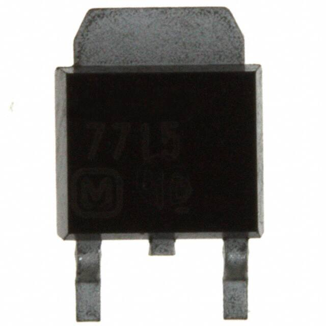

    TO-252(DPAK)
    IC REG LINEAR 15V 1.2A SP3SUA
AN7715SP 数据手册
Voltage Regulators AN77xxSP Series 3-pin, positive output, low dropout voltage regulator (1.2 A type) AN77xxSP series The AN77xxSP series is stabilized constant-voltage power supplies with small difference between I/O voltages (0.5 V typ.). It is suitable for low-voltage, batterydriven equipment, and home appliances and industrial equipment with great fluctuation of the supply voltage. The output voltage ranges: 3.3 V, 3.5 V, 5 V, 6 V, 7 V, 8 V, 9 V, 10 V, 12 V, and 15 V Unit: mm 6.50±0.10 5.30±0.10 4.35±0.20 3.00±0.20 ■ Features 2 3 0.75±0.10 1 • Minimum I/O voltage difference: 0.5 V typ. • On-chip overcurrent limiter • On-chip thermal protection circuit • On-chip inrush current protection circuit at the time of input voltage start-up • On-chip input short-circuit protection circuit (When the input pin is short-circuited to the ground, the circuit between pins 1 and 3 is shut down to prevent current flow.) 7.30±0.10 9.80±0.10 0.80 max. 0.20 max. 5.50±0.20 2.50±0.20 1.80±0.30 1.00±0.20 2.30 0.55±0.15 0.10±0.05 2.30±0.10 4.60±0.10 1.00±0.30 ■ Overview SP-3SU Note) The package of this product will be changed to lead-free type (SP-3SUA). See the new package dimensions section later of this datasheet. ■ Applications • Power supply equipment ■ Block Diagram VREF Publication date: November 2001 Inrush current protection R1 Thermal protection Error amplifier 1 Output stage Overcurrent limiter Output driver Voltage reference Starter Input short-circuit protection 2 SFF00003CEB R2 3 1 AN77xxSP Series ■ Pin Descriptions Pin No. Description 1 Input pin (In) 2 Ground pin (COM) 3 Output pin (Out) ■ Absolute Maximum Ratings at Ta = 25°C Parameter Supply voltage *2 Supply current *3 Power dissipation *4 Operating ambient temperature Storage temperature *1 *1 Symbol Rating Unit VIN 30 V IIN 2.4 A PD 5.0 W Topr −30 to +85 °C Tstg −55 to +150 °C Note) *1: Expect for the operating ambient temperature and storage temperature, all ratings are for Ta = 25°C. *2: At the application of VIN = 30 V, the overvoltage protection may be operated by the ASO protection circuit, leading to the output shut down. *3: The current value does not exceed this criterion because of the on-chip current limiter. *4: The internal circuit shuts off the output when Tj ≥ 150°C (designed value). The relationship between the IC power dissipation and ambient temperature shall conform to the derating curve (■ Main Characteristics PD  Ta). ■ Recommended Operating Conditions at IOUT = 500 mA, Ta = 25°C Part No. 2 Output voltage Operating supply voltage range (VIN) Unit AN77033SP 3.3 4.3 to 14 V AN77035SP 3.5 4.5 to 14 V AN7705SP 5 6 to 16 V AN7706SP 6 7 to 17 V AN7707SP 7 8 to 18 V AN7708SP 8 9 to 19 V AN7709SP 9 10 to 20 V AN7710SP 10 11 to 21 V AN7712SP 12 13 to 23 V AN7715SP 15 16.5 to 26.5 V SFF00003CEB AN77xxSP Series ■ Electrical Characteristics at Ta = 25°C • AN77033SP (3.3 V type) Parameter Symbol Conditions VIN = 4.3 V, IOUT = 500 mA, Tj = 25°C Output voltage VOUT Line regulation REGIN VIN = 4.3 V to 14.3 V, IOUT = 500 mA, Tj = 25°C Min Typ Max Unit 3.20 3.30 3.40 V  3 35 mV Load regulation REGLOA VIN = 4.3 V, IOUT = 0 mA to 1 200 mA, Tj = 25°C  15 70 mV Input dependency of bias current ∆IBias(IN) VIN = 4.3 V to 14.3 V, IOUT = 500 mA, Tj = 25°C  1 10 mA Load dependency of bias current ∆IBias(LOA) VIN = 4.3 V, IOUT = 0 mA to 1 200 mA, Tj = 25°C  10 50 mA Bias current at no load IBias VIN = 4.3 V, IOUT = 0 mA  2.6 5.0 mA Bias current before the regulation starts Irush VIN = 3.0 V, IOUT = 0 mA  3 5 mA Minimum I/O voltage difference 1 VDIF(min)1 VIN = 3.7 V, IOUT = 500 mA, Tj = 25°C  0.4 0.6 V Minimum I/O voltage difference 2 VDIF(min)2 VIN = 3.7 V, IOUT = 1 200 mA, Tj = 25°C  0.5 1.0 V 1.2 1.8 2.4 A 53 74  dB Peak output current 1 * Ripple rejection ratio IO(Peak)1 VIN = 4.3 V, Tj = 25 °C RR VIN = 4.3 V to 8.0 V, IOUT = 100 mA, f = 120 Hz Note) * : This current exceeds PD(max) because it is a parameter during abnormal (overcurrent) operation. However, normally, it shall conform to the derating curve ( ■ Main Characteristics PD  Ta ). • Design reference data Note) The characteristics listed below are theoretical values based on the IC design and are not guaranteed. Parameter Peak output current 2 * Peak output current 3 * Output short-circuit current Thermal protection operating temperature Output voltage temperature coefficient Symbol Min Typ Max Unit IO(Peak)2 VIN = 13.3 V, Tj = 25°C  1.5  A IO(Peak)3 VIN = 18.3 V, Tj = 25°C  1.0  A IO(Short) VIN = 30 V, Tj = 25°C The load is shorted.  10  mA VIN = 4.3 V  150  °C VIN = 4.3 V, Tj = 25°C to 125°C  −40  ppm/°C Tj(TH) a Conditions Note) * : This current exceeds PD(max) because it is a parameter during abnormal (overcurrent) operation. However, normally, it shall conform to the derating curve ( ■ Main Characteristics PD  Ta ). SFF00003CEB 3 AN77xxSP Series ■ Electrical Characteristics at Ta = 25°C (continued) • AN77035SP (3.5 V type) Parameter Symbol Conditions VIN = 4.5 V, IOUT = 500 mA, Tj = 25°C Output voltage VOUT Line regulation REGIN VIN = 4.5 V to 14.5 V, IOUT = 500 mA, Tj = 25°C Min Typ Max Unit 3.39 3.50 3.61 V  3 35 mV Load regulation REGLOA VIN = 4.5 V, IOUT = 0 mA to 1 200 mA, Tj = 25°C  15 70 mV Input dependency of bias current ∆IBias(IN) VIN = 4.5 V to 14.5 V, IOUT = 500 mA, Tj = 25°C  1 10 mA Load dependency of bias current ∆IBias(LOA) VIN = 4.5 V, IOUT = 0 mA to 1 200 mA, Tj = 25°C  10 50 mA Bias current at no load IBias VIN = 4.5 V, IOUT = 0 mA  2.6 5.0 mA Bias current before the regulation starts Irush VIN = 3.2 V, IOUT = 0 mA  3 5 mA Minimum I/O voltage difference 1 VDIF(min)1 VIN = 3.7 V, IOUT = 500 mA, Tj = 25°C  0.4 0.6 V Minimum I/O voltage difference 2 VDIF(min)2 VIN = 3.7 V, IOUT = 1 200 mA, Tj = 25°C  0.5 1.0 V 1.2 1.8 2.4 A 53 74  dB Peak output current 1 * Ripple rejection ratio IO(Peak)1 VIN = 4.5 V, Tj = 25°C RR VIN = 4.5 V to 8.0 V, IOUT = 100 mA, f = 120 Hz Note) * : This current exceeds PD(max) because it is a parameter during abnormal (overcurrent) operation. However, normally, it shall conform to the derating curve ( ■ Main Characteristics PD  Ta ). • Design reference data Note) The characteristics listed below are theoretical values based on the IC design and are not guaranteed. Parameter Peak output current 2 * Peak output current 3 * Output short-circuit current Thermal protection operating temperature Output voltage temperature coefficient Symbol Min Typ Max Unit IO(Peak)2 VIN = 13.5 V, Tj = 25°C  1.5  A IO(Peak)3 VIN = 18.5 V, Tj = 25°C  1.0  A IO(Short) VIN = 30 V, Tj = 25°C The load is shorted.  10  mA VIN = 4.5 V  150  °C VIN = 4.5 V, Tj = 25°C to 125°C  −40  ppm/°C Tj(TH) a Conditions Note) * : This current exceeds PD(max) because it is a parameter during abnormal (overcurrent) operation. However, normally, it shall conform to the derating curve ( ■ Main Characteristics PD  Ta ). 4 SFF00003CEB AN77xxSP Series ■ Electrical Characteristics at Ta = 25°C (continued) • AN7705SP (5 V type) Parameter Symbol Conditions Min Typ Max Unit Output voltage VOUT VIN = 6 V, IOUT = 500 mA, Tj = 25°C 4.85 5.00 5.15 V Line regulation REGIN VIN = 6 V to 16 V, IOUT = 500 mA, Tj = 25°C  5 50 mV Load regulation REGLOA VIN = 6 V, IOUT = 0 mA to 1 200 mA, Tj = 25°C  25 100 mV Input dependency of bias current ∆IBias(IN) VIN = 6 V to 16 V, IOUT = 500 mA, Tj = 25°C  1 10 mA Load dependency of bias current ∆IBias(LOA) VIN = 6 V, IOUT = 0 mA to 1 200 mA, Tj = 25°C  10 50 mA Bias current at no load IBias VIN = 6 V, IOUT = 0 mA  2.6 5 mA Bias current before the regulation starts Irush VIN = 4.5 V, IOUT = 0 mA  3 5 mA Minimum I/O voltage difference 1 VDIF(min)1 VIN = 4.5 V, IOUT = 500 mA, Tj = 25°C  0.4 0.6 V Minimum I/O voltage difference 2 VDIF(min)2 VIN = 4.5 V, IOUT = 1 200 mA, Tj = 25°C  0.5 1.0 V 1.2 1.8 2.4 A 50 70  dB Peak output current 1 * Ripple rejection ratio IO(Peak)1 VIN = 6 V, Tj = 25°C RR VIN = 6 V to 8 V, IOUT = 100 mA, f = 120 Hz Note) * : This current exceeds PD(max) because it is a parameter during abnormal (overcurrent) operation. However, normally, it shall conform to the derating curve ( ■ Main Characteristics PD  Ta ). • Design reference data Note) The characteristics listed below are theoretical values based on the IC design and are not guaranteed. Parameter * Peak output current 3 * Output short-circuit current Peak output current 2 Thermal protection operating temperature Output voltage temperature coefficient Symbol Min Typ Max Unit IO(Peak)2 VIN = 15 V, Tj = 25°C  1.5  A IO(Peak)3 VIN = 20 V, Tj = 25°C  1.0  A IO(Short) VIN = 30 V, Tj = 25°C The load is shorted.  10  mA VIN = 6 V  150  °C VIN = 6 V, Tj = 25°C to 125°C  −40  ppm/°C Tj(TH) a Conditions Note) * : This current exceeds PD(max) because it is a parameter during abnormal (overcurrent) operation. However, normally, it shall conform to the derating curve ( ■ Main Characteristics PD  Ta ). SFF00003CEB 5 AN77xxSP Series ■ Electrical Characteristics at Ta = 25°C (continued) • AN7706SP (6 V type) Parameter Symbol Conditions Min Typ Max Unit Output voltage VOUT VIN = 7 V, IOUT = 500 mA, Tj = 25°C 5.82 6.00 6.18 V Line regulation REGIN VIN = 7 V to 17 V, IOUT = 500 mA, Tj = 25°C  6 60 mV Load regulation REGLOA VIN = 7 V, IOUT = 0 mA to 1 200 mA, Tj = 25°C  30 120 mV Input dependency of bias current ∆IBias(IN) VIN = 7 V to 17 V, IOUT = 500 mA, Tj = 25°C  1 10 mA Load dependency of bias current ∆IBias(LOA) VIN = 7 V, IOUT = 0 mA to 1 200 mA, Tj = 25°C  10 50 mA Bias current at no load IBias VIN = 7 V, IOUT = 0 mA  2.6 5.0 mA Bias current before the regulation starts Irush VIN = 5.4 V, IOUT = 0 mA  3 5 mA Minimum I/O voltage difference 1 VDIF(min)1 VIN = 5.4 V, IOUT = 500 mA, Tj = 25°C  0.4 0.6 V Minimum I/O voltage difference 2 VDIF(min)2 VIN = 5.4 V, IOUT = 1 200 mA, Tj = 25°C  0.5 1.0 V 1.2 1.8 2.4 A 48 68  dB Peak output current 1 * Ripple rejection ratio IO(Peak)1 VIN = 7 V, Tj = 25°C RR VIN = 7 V to 9 V, IOUT = 100 mA, f = 120 Hz Note) * : This current exceeds PD(max) because it is a parameter during abnormal (overcurrent) operation. However, normally, it shall conform to the derating curve ( ■ Main Characteristics PD  Ta ). • Design reference data Note) The characteristics listed below are theoretical values based on the IC design and are not guaranteed. Parameter * Peak output current 3 * Output short-circuit current Peak output current 2 Thermal protection operating temperature Output voltage temperature coefficient Symbol Min Typ Max Unit IO(Peak)2 VIN = 16 V, Tj = 25°C  1.5  A IO(Peak)3 VIN = 21 V, Tj = 25°C  1.0  A IO(Short) VIN = 30 V, Tj = 25°C The load is shorted.  10  mA VIN = 7 V  150  °C VIN = 7 V, Tj = 25°C to 125°C  −40  ppm/°C Tj(TH) a Conditions Note) * : This current exceeds PD(max) because it is a parameter during abnormal (overcurrent) operation. However, normally, it shall conform to the derating curve ( ■ Main Characteristics PD  Ta ). 6 SFF00003CEB AN77xxSP Series ■ Electrical Characteristics at Ta = 25°C (continued) • AN7707SP (7 V type) Parameter Symbol Conditions Min Typ Max Unit Output voltage VOUT VIN = 8 V, IOUT = 500 mA, Tj = 25°C 6.79 7.00 7.21 V Line regulation REGIN VIN = 8 V to 18 V, IOUT = 500 mA, Tj = 25°C  7 70 mV Load regulation REGLOA VIN = 8 V, IOUT = 0 mA to 1 200 mA, Tj = 25°C  35 140 mV Input dependency of bias current ∆IBias(IN) VIN = 8 V to 18 V, IOUT = 500 mA, Tj = 25°C  1 10 mA Load dependency of bias current ∆IBias(LOA) VIN = 8 V, IOUT = 0 mA to 1 200 mA, Tj = 25°C  10 50 mA Bias current at no load IBias VIN = 8 V, IOUT = 0 mA  2.6 5.0 mA Bias current before the regulation starts Irush VIN = 6.3 V, IOUT = 0 mA  3 5 mA Minimum I/O voltage difference 1 VDIF(min)1 VIN = 6.3 V, IOUT = 500 mA, Tj = 25°C  0.4 0.6 V Minimum I/O voltage difference 2 VDIF(min)2 VIN = 6.3 V, IOUT = 1 200 mA, Tj = 25°C  0.5 1.0 V 1.2 1.8 2.4 A 47 67  dB Peak output current 1 * Ripple rejection ratio IO(Peak)1 VIN = 8 V, Tj = 25°C RR VIN = 8 V to 10 V, IOUT = 100 mA, f = 120 Hz Note) * : This current exceeds PD(max) because it is a parameter during abnormal (overcurrent) operation. However, normally, it shall conform to the derating curve ( ■ Main Characteristics PD  Ta ). • Design reference data Note) The characteristics listed below are theoretical values based on the IC design and are not guaranteed. Parameter * Peak output current 3 * Output short-circuit current Peak output current 2 Thermal protection operating temperature Output voltage temperature coefficient Symbol Min Typ Max Unit IO(Peak)2 VIN = 17 V, Tj = 25°C  1.5  A IO(Peak)3 VIN = 22 V, Tj = 25°C  1.0  A IO(Short) VIN = 30 V, Tj = 25°C The load is shorted.  10  mA VIN = 8 V  150  °C VIN = 8 V, Tj = 25°C to 125°C  −40  ppm/°C Tj(TH) a Conditions Note) * : This current exceeds PD(max) because it is a parameter during abnormal (overcurrent) operation. However, normally, it shall conform to the derating curve ( ■ Main Characteristics PD  Ta ). SFF00003CEB 7 AN77xxSP Series ■ Electrical Characteristics at Ta = 25°C (continued) • AN7708SP (8 V type) Parameter Symbol Conditions Min Typ Max Unit Output voltage VOUT VIN = 9 V, IOUT = 500 mA, Tj = 25°C 7.76 8.00 8.24 V Line regulation REGIN VIN = 9 V to 19 V, IOUT = 500 mA, Tj = 25°C  8 80 mV Load regulation REGLOA VIN = 9 V, IOUT = 0 mA to 1 200 mA, Tj = 25°C  40 160 mV Input dependency of bias current ∆IBias(IN) VIN = 9 V to 19 V, IOUT = 500 mA, Tj = 25°C  1 10 mA Load dependency of bias current ∆IBias(LOA) VIN = 9 V, IOUT = 0 mA to 1 200 mA, Tj = 25°C  10 50 mA Bias current at no load IBias VIN = 9 V, IOUT = 0 mA  2.6 5.0 mA Bias current before the regulation starts Irush VIN = 7.2 V, IOUT = 0 mA  3 5 mA Minimum I/O voltage difference 1 VDIF(min)1 VIN = 7.2 V, IOUT = 500 mA, Tj = 25°C  0.4 0.6 V Minimum I/O voltage difference 2 VDIF(min)2 VIN = 7.2 V, IOUT = 1 200 mA, Tj = 25°C  0.5 1.0 V 1.2 1.8 2.4 A 46 66  dB Peak output current 1 * Ripple rejection ratio IO(Peak)1 VIN = 9 V, Tj = 25°C RR VIN = 9 V to 11 V, IOUT = 100 mA, f = 120 Hz Note) * : This current exceeds PD(max) because it is a parameter during abnormal (overcurrent) operation. However, normally, it shall conform to the derating curve ( ■ Main Characteristics PD  Ta ). • Design reference data Note) The characteristics listed below are theoretical values based on the IC design and are not guaranteed. Parameter * Peak output current 3 * Output short-circuit current Peak output current 2 Thermal protection operating temperature Output voltage temperature coefficient Symbol Min Typ Max Unit IO(Peak)2 VIN = 18 V, Tj = 25°C  1.5  A IO(Peak)3 VIN = 23 V, Tj = 25°C  1.0  A IO(Short) VIN = 30 V, Tj = 25°C The load is shorted.  10  mA VIN = 9 V  150  °C VIN = 9 V, Tj = 25°C to 125°C  −40  ppm/°C Tj(TH) a Conditions Note) * : This current exceeds PD(max) because it is a parameter during abnormal (overcurrent) operation. However, normally, it shall conform to the derating curve ( ■ Main Characteristics PD  Ta ). 8 SFF00003CEB AN77xxSP Series ■ Electrical Characteristics at Ta = 25°C (continued) • AN7709SP (9 V type) Parameter Symbol Conditions Min Typ Max Unit Output voltage VOUT VIN = 10 V, IOUT = 500 mA, Tj = 25°C 8.73 9.00 9.27 V Line regulation REGIN VIN = 10 V to 20 V, IOUT = 500 mA, Tj = 25°C  9 90 mV Load regulation REGLOA VIN = 10 V, IOUT = 0 mA to 1 200 mA, Tj = 25°C  45 180 mV Input dependency of bias current ∆IBias(IN) VIN = 10 V to 20 V, IOUT = 500 mA, Tj = 25°C  1 10 mA Load dependency of bias current ∆IBias(LOA) VIN = 10 V, IOUT = 0 mA to 1 200 mA, Tj = 25°C  10 50 mA Bias current at no load IBias VIN = 10 V, IOUT = 0 mA  2.6 5.0 mA Bias current before the regulation starts Irush VIN = 8.1 V, IOUT = 0 mA  3 5 mA Minimum I/O voltage difference 1 VDIF(min)1 VIN = 8.1 V, IOUT = 500 mA, Tj = 25°C  0.4 0.6 V Minimum I/O voltage difference 2 VDIF(min)2 VIN = 8.1 V, IOUT = 1 200 mA, Tj = 25°C  0.5 1.0 V 1.2 1.8 2.4 A 45 65  dB Peak output current 1 * Ripple rejection ratio IO(Peak)1 VIN = 10 V, Tj = 25°C RR VIN = 10 V to 12 V, IOUT = 100 mA, f = 120 Hz Note) * : This current exceeds PD(max) because it is a parameter during abnormal (overcurrent) operation. However, normally, it shall conform to the derating curve ( ■ Main Characteristics PD  Ta ). • Design reference data Note) The characteristics listed below are theoretical values based on the IC design and are not guaranteed. Parameter * Peak output current 3 * Output short-circuit current Peak output current 2 Thermal protection operating temperature Output voltage temperature coefficient Symbol Min Typ Max Unit IO(Peak)2 VIN = 19 V, Tj = 25°C  1.5  A IO(Peak)3 VIN = 24 V, Tj = 25°C  1.0  A IO(Short) VIN = 30 V, Tj = 25°C The load is shorted.  10  mA VIN = 10 V  150  °C VIN = 10 V, Tj = 25°C to 125°C  −40  ppm/°C Tj(TH) a Conditions Note) * : This current exceeds PD(max) because it is a parameter during abnormal (overcurrent) operation. However, normally, it shall conform to the derating curve ( ■ Main Characteristics PD  Ta ). SFF00003CEB 9 AN77xxSP Series ■ Electrical Characteristics at Ta = 25°C (continued) • AN7710SP (10 V type) Parameter Symbol Conditions Min Typ Max Unit Output voltage VOUT VIN = 11 V, IOUT = 500 mA, Tj = 25°C 9.7 10.0 10.3 V Line regulation REGIN VIN = 11 V to 21 V, IOUT = 500 mA, Tj = 25°C  10 100 mV Load regulation REGLOA VIN = 11 V, IOUT = 0 mA to 1 200 mA, Tj = 25°C  50 200 mV Input dependency of bias current ∆IBias(IN) VIN = 11 V to 21 V, IOUT = 500 mA, Tj = 25°C  1 10 mA Load dependency of bias current ∆IBias(LOA) VIN = 11 V, IOUT = 0 mA to 1 200 mA, Tj = 25°C  10 50 mA Bias current at no load IBias VIN = 11 V, IOUT = 0 mA  2.6 5.0 mA Bias current before the regulation starts Irush VIN = 9 V, IOUT = 0 mA  3 5 mA Minimum I/O voltage difference 1 VDIF(min)1 VIN = 9 V, IOUT = 500 mA, Tj = 25°C  0.4 0.6 V Minimum I/O voltage difference 2 VDIF(min)2 VIN = 9 V, IOUT = 1 200 mA, Tj = 25°C  0.5 1.0 V 1.2 1.8 2.4 A 44 64  dB Peak output current 1 * Ripple rejection ratio IO(Peak)1 VIN = 11 V, Tj = 25°C RR VIN = 11 V to 13 V, IOUT = 100 mA, f = 120 Hz Note) * : This current exceeds PD(max) because it is a parameter during abnormal (overcurrent) operation. However, normally, it shall conform to the derating curve ( ■ Main Characteristics PD  Ta ). • Design reference data Note) The characteristics listed below are theoretical values based on the IC design and are not guaranteed. Parameter * Peak output current 3 * Output short-circuit current Peak output current 2 Thermal protection operating temperature Output voltage temperature coefficient Symbol Min Typ Max Unit IO(Peak)2 VIN = 20 V, Tj = 25°C  1.5  A IO(Peak)3 VIN = 25 V, Tj = 25°C  1.0  A IO(Short) VIN = 30 V, Tj = 25°C The load is shorted.  10  mA VIN = 11 V  150  °C VIN = 11 V, Tj = 25°C to 125°C  −40  ppm/°C Tj(TH) a Conditions Note) * : This current exceeds PD(max) because it is a parameter during abnormal (overcurrent) operation. However, normally, it shall conform to the derating curve ( ■ Main Characteristics PD  Ta ). 10 SFF00003CEB AN77xxSP Series ■ Electrical Characteristics at Ta = 25°C (continued) • AN7712SP (12 V type) Parameter Symbol Conditions VIN = 13 V, IOUT = 500 mA, Tj = 25°C Output voltage VOUT Line regulation REGIN VIN = 13 V to 23 V, IOUT = 500 mA, Tj = 25°C Min Typ Max Unit 11.64 12.00 12.36 V  12 120 mV Load regulation REGLOA VIN = 13 V, IOUT = 0 mA to 1 200 mA, Tj = 25°C  60 240 mV Input dependency of bias current ∆IBias(IN) VIN = 13 V to 23 V, IOUT = 500 mA, Tj = 25°C  1 10 mA Load dependency of bias current ∆IBias(LOA) VIN = 13 V, IOUT = 0 mA to 1 200 mA, Tj = 25°C  10 50 mA Bias current at no load IBias VIN = 13 V, IOUT = 0 mA  2.6 5.0 mA Bias current before the regulation starts Irush VIN = 10.8 V, IOUT = 0 mA  3 5 mA Minimum I/O voltage difference 1 VDIF(min)1 VIN = 10.8 V, IOUT = 500 mA, Tj = 25°C  0.4 0.6 V Minimum I/O voltage difference 2 VDIF(min)2 VIN = 10.8 V, IOUT = 1 200 mA, Tj = 25°C  0.5 1.0 V 1.2 1.8 2.4 A 42 62  dB Peak output current 1 * Ripple rejection ratio IO(Peak)1 VIN = 13 V, Tj = 25°C RR VIN = 13 V to 15 V, IOUT = 100 mA, f = 120 Hz Note) * : This current exceeds PD(max) because it is a parameter during abnormal (overcurrent) operation. However, normally, it shall conform to the derating curve ( ■ Main Characteristics PD  Ta ). • Design reference data Note) The characteristics listed below are theoretical values based on the IC design and are not guaranteed. Parameter * Peak output current 3 * Output short-circuit current Peak output current 2 Thermal protection operating temperature Output voltage temperature coefficient Symbol Min Typ Max Unit IO(Peak)2 VIN = 22 V, Tj = 25°C  1.5  A IO(Peak)3 VIN = 27 V, Tj = 25°C  1.0  A IO(Short) VIN = 30 V, Tj = 25°C The load is shorted.  10  mA VIN = 13 V  150  °C VIN = 13 V, Tj = 25°C to 125°C  −40  ppm/°C Tj(TH) a Conditions Note) * : This current exceeds PD(max) because it is a parameter during abnormal (overcurrent) operation. However, normally, it shall conform to the derating curve ( ■ Main Characteristics PD  Ta ). SFF00003CEB 11 AN77xxSP Series ■ Electrical Characteristics at Ta = 25°C (continued) • AN7715SP (15 V type) Parameter Symbol Conditions VIN = 16.5 V, IOUT = 500 mA, Tj = 25°C Output voltage VOUT Line regulation REGIN VIN = 16.5 V to 26.5 V, IOUT = 500 mA, Tj = 25°C Min Typ Max Unit 14.55 15.00 15.45 V  15 150 mV Load regulation REGLOA VIN = 16.5 V, IOUT = 0 mA to 1 200 mA, Tj = 25°C  75 300 mV Input dependency of bias current ∆IBias(IN) VIN = 16.5 V to 26.5 V, IOUT = 500 mA, Tj = 25°C  1 10 mA Load dependency of bias current ∆IBias(LOA) VIN = 16.5 V, IOUT = 0 mA to 1 200 mA, Tj = 25°C  10 50 mA Bias current at no load IBias VIN = 16.5 V, IOUT = 0 mA  2.6 5 mA Bias current before the regulation starts Irush VIN = 13.5 V, IOUT = 0 mA  3 5 mA Minimum I/O voltage difference 1 VDIF(min)1 VIN = 13.5 V, IOUT = 500 mA, Tj = 25°C  0.4 0.6 V Minimum I/O voltage difference 2 VDIF(min)2 VIN = 13.5 V, IOUT = 1 200 mA, Tj = 25°C  0.5 1.0 V 1.2 1.8 2.4 A 40 60  dB Peak output current 1 * Ripple rejection ratio IO(Peak)1 VIN = 16.5 V, Tj = 25°C RR VIN = 16.5 V to 18.5 V, IOUT = 100 mA, f = 120 Hz Note) * : This current exceeds PD(max) because it is a parameter during abnormal (overcurrent) operation. However, normally, it shall conform to the derating curve ( ■ Main Characteristics PD  Ta ). • Design reference data Note) The characteristics listed below are theoretical values based on the IC design and are not guaranteed. Parameter Symbol Conditions Min Typ Max Unit Peak output current 2 * IO(Peak)2 VIN = 25 V, Tj = 25°C  1.5  A Output short-circuit current IO(Short) VIN = 30 V, Tj = 25°C The load is shorted.  10  mA VIN = 16.5 V  150  °C VIN = 16.5 V, Tj = 25°C to 125°C  −40  ppm/°C Thermal protection operating temperature Output voltage temperature coefficient Tj(TH) a Note) * : This current exceeds PD(max) because it is a parameter during abnormal (overcurrent) operation. However, normally, it shall conform to the derating curve ( ■ Main Characteristics PD  Ta ). 12 SFF00003CEB AN77xxSP Series ■ Usage Notes Not required 2. Capacitor for external compensation To maintain the stability, insert a 33 mF capacitor as close to pin 3 and pin 2 as possible. In case of using at low temperature, decrease in capacity of the aluminum electrolytic capacitor and increase of ESR of this capacitor may lead to oscillation. In the AN77xxSP series, for the output capacitor COUT , it is recommended to use an aluminum electrolytic capacitor or tantalum capacitor whose equivalent series resistance (ESR) has the temperature characteristic within the recommended area shown on the right. 3 1 VIN VOUT COUT 33 µF 2 CIN 0.33 µF Output capacitor ESR (Equivalent series resistance) Ta = 25°C 10 000 VIN = Refer to the table below. IOUT = 0 A to 1 A COUT = 33 µF 1 000 100 ESR (Ω) 1. Input short-circuit protection circuit When the DC input pin (pin 1) and the ground pin (pin 2) of our conventional three-pin regulators (AN78xxNSP series, etc.) were short-circuited at normal use conditions in some cases, the voltage of the output pin (pin 3) becomes higher than that of the DC input pin and electrons charged in the output capacitor COUT flow into the input side, resulting in break of the element. In those cases, it was necessary for you to connect a general silicon diode as shown in the figure on the right. In the AN77xxSP series, however, it is not necessary to connect the protection diode because these series have a built-in protection circuit to safeguard the element from discharge current. 10 Ω (typ.) 10 Usable range 1.0 0.1 1 CIN 0.33 µF 2 VIN 3 IOUT COUT 33 µF ESR GND 0.01 0 0.2 0.4 Part No. 3. Others Cautions for the input voltage that exceeds the operating supply voltage: 1) The overvoltage protection is activated with the ASO protection circuit when VIN = 30 V is applied, and the output shuts down occasionally. (3 V type to 10 V type) 2) Please note that at IOUT < 2 mA, the output voltage rises and may exceed the maximum of the operation range. (12 V type to 24 V type) SFF00003CEB 0.6 0.8 1.0 1.2 1.4 IOUT (A) VIN AN77033SP AN77035SP 4.3 V to 14 V 4.5 V to 14 V AN7705SP 6 V to 16 V AN7706SP AN7707SP AN7708SP AN7709SP 7 V to 17 V 8 V to 18 V 9 V to 19 V 10 V to 20 V AN7710SP AN7712SP AN7715SP 11 V to 21 V 13 V to 23 V 16.5 V to 26.5 V 13 AN77xxSP Series ■ Main Characteristics PD  T a VOUT  VIN 16 (1)When AL board is mounted (Basic size : 50 × 50 × t2.0 mm3) Rth(j-a) = 25.0°C/W (2)When glass epoxy is mounted 2 (Basic size : 50 × 50 × t1.5 mm3) Rth(j-a) = 89.3°C/W (3)When glass epoxy is mounted 1 (Basic size : 50 × 50 × t1.7 mm3) Rth(j-a) = 147.0°C/W (4)Without heat sink Rth(j-a) = 178.0°C/W 12 10 8 6 (1) 4 2 (2) 0 (4) IOUT = 1 A AN7705SP Output voltage VOUT (V) Power dissipation PD (W) 14 10 5 (3) 0 25 50 75 100 125 0 150 0 Ambient temperature Ta (°C) IBias  VIN VOUT  IOUT IOUT = 1 A AN7705SP Output voltage VOUT (V) Bias current IBias (mA) 4 3 2 10 100 VIN = 25 V 5 VIN = 20 V 50 VIN = 6 V VIN = 30 V VIN = 15 V VIN = 10 V 0 0 0 10 20 30 0 Input voltage VIN (V) VDIF(min)  IOUT 1.0 1 2 0 3 1 10 100 Output current IOUT (A) f (Hz) IBias  IOUT VOUT  Ta 1k 20 AN7705SP 5 Output current IOUT 1.0 (A) Output voltage VOUT (V) 0.5 0 AN7705SP AN7705SP IBias (mA) VDIF(min) (V) VIN = 6 V to 8 V IOUT = 100 mA AN7705SP 1 14 30 RR  f AN7705SP 5 0 20 RR (dB) 6 10 Input voltage VIN (V) 10 0 0 0.5 Output current IOUT (A) SFF00003CEB 1.0 VIN = 6 V IOUT = 0 mA 5.1 5.0 4.9 −50 −25 0 25 50 75 Ambient temperature Ta (°C) 100 AN77xxSP Series ■ New Package Dimensions (Unit: mm) • SP-3SUA (Lead-free package) (0.50) 2.30 3 0.75+0.10 -0.05 4.60±0.10 0.23 M 0.10±0.10 0.50+0.10 -0.05 2.30±0.10 1 1.00±0.20 1.00±0.20 2 (0.50) 2.50±0.20 9.80±0.20 5.50±0.10 (5.30) (2.50) (1.80) 6.50±0.10 5.40±0.10 (4.35) (3.00) SFF00003CEB 15 Request for your special attention and precautions in using the technical information and semiconductors described in this material (1) An export permit needs to be obtained from the competent authorities of the Japanese Government if any of the products or technologies described in this material and controlled under the "Foreign Exchange and Foreign Trade Law" is to be exported or taken out of Japan. (2) The technical information described in this material is limited to showing representative characteristics and applied circuit examples of the products. It does not constitute the warranting of industrial property, the granting of relative rights, or the granting of any license. (3) The products described in this material are intended to be used for standard applications or general electronic equipment (such as office equipment, communications equipment, measuring instruments and household appliances). Consult our sales staff in advance for information on the following applications: • Special applications (such as for airplanes, aerospace, automobiles, traffic control equipment, combustion equipment, life support systems and safety devices) in which exceptional quality and reliability are required, or if the failure or malfunction of the products may directly jeopardize life or harm the human body. • Any applications other than the standard applications intended. (4) The products and product specifications described in this material are subject to change without notice for reasons of modification and/or improvement. At the final stage of your design, purchasing, or use of the products, therefore, ask for the most up-to-date Product Standards in advance to make sure that the latest specifications satisfy your requirements. (5) When designing your equipment, comply with the guaranteed values, in particular those of maximum rating, the range of operating power supply voltage and heat radiation characteristics. Otherwise, we will not be liable for any defect which may arise later in your equipment. Even when the products are used within the guaranteed values, redundant design is recommended, so that such equipment may not violate relevant laws or regulations because of the function of our products. (6) When using products for which dry packing is required, observe the conditions (including shelf life and after-unpacking standby time) agreed upon when specification sheets are individually exchanged. (7) No part of this material may be reprinted or reproduced by any means without written permission from our company. Please read the following notes before using the datasheets A. These materials are intended as a reference to assist customers with the selection of Panasonic semiconductor products best suited to their applications. Due to modification or other reasons, any information contained in this material, such as available product types, technical data, and so on, is subject to change without notice. Customers are advised to contact our semiconductor sales office and obtain the latest information before starting precise technical research and/or purchasing activities. B. Panasonic is endeavoring to continually improve the quality and reliability of these materials but there is always the possibility that further rectifications will be required in the future. Therefore, Panasonic will not assume any liability for any damages arising from any errors etc. that may appear in this material. C. These materials are solely intended for a customer's individual use. Therefore, without the prior written approval of Panasonic, any other use such as reproducing, selling, or distributing this material to a third party, via the Internet or in any other way, is prohibited. 2001 MAR
