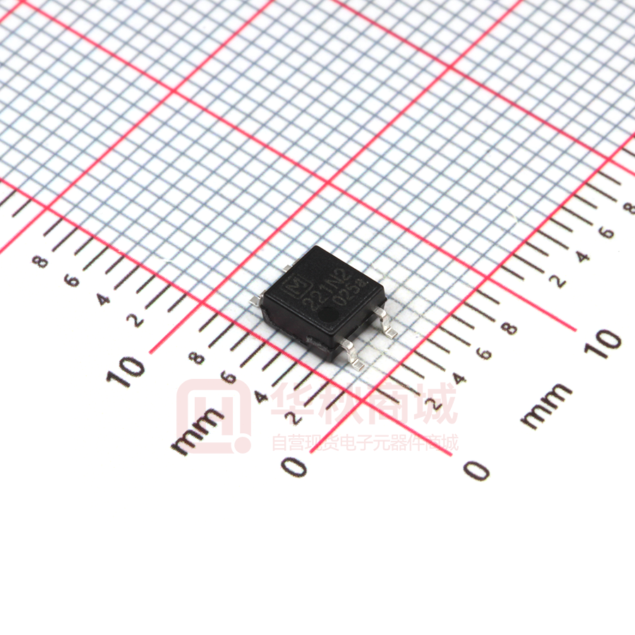

AQY221N2S
AQY221N2S
    NAIS(松下)
    SOP4_4.3X4.4MM
    固态继电器(SSR) SPST-NO 40V 120mA
AQY221N2S 数据手册
Miniature SOP4-pin C×R10 40V load voltage RF SOP 1 Form A C×R10 (AQY221❍2S) 4.3 .169 4.4 .173 2.1 .083 mm inch 3 2 TYPICAL APPLICATIONS 1. Both low on-resistance (R type) and low capacitance (C type) available at excellent characteristics of C×R10 1. Measuring and testing equipment IC tester, Liquid crystal driver tester, Semiconductor performance tester, Bare board tester, In-circuit tester, Function tester, etc. 2. Telecommunication and broadcasting equipment 3. Medical equipment Ultrasonic wave diagnostic machine 4. Multi-point recorder Data logger, Warping and Thermocouple, etc. AQY221R2S (R type) AQY221N2S (C type) 0.8Ω 9.5Ω 13pF 1pF Low on resistance: R Low output capacitance: C 4 1 FEATURES 2. High speed switching Turn on time: Typ. 0.03ms Turn off time: Typ. 0.03ms (AQY221N2S) 3. Small profile of miniature SOP4-pin 4. Low-level off state leakage current of Typ. 0.01nA (AQY221N2S) RoHS compliant TYPES Output rating* Type AC/DC dual use Low on resistance (R type) Load voltage Load current 40V 250mA Package Tube packing style Part No. Tape and reel packing style Picked from the Picked from the 1/2-pin side 3/4-pin side AQY221R2S AQY221R2SX AQY221R2SZ AQY221N2S AQY221N2SX AQY221N2SZ SOP4-pin Low capacitance (C type) 40V 120mA Packing quantity Tube Tape and reel 1 tube contains: 100 pcs. 1 batch contains: 2,000 pcs. 1,000 pcs. * Indicate the peak AC and DC values. Note: For space reasons, the initial letters of the part number “AQY”, the package (SOP) indicator “S” and the packing style indicator “X” or “Z” are not marked on the device. (Ex. the label for product number AQY221R2SX is 221R2) RATING 1. Absolute maximum ratings (Ambient temperature: 25°C 77°F) Item Input Output LED forward current LED reverse voltage Peak forward current Power dissipation Load voltage (peak AC) Continuous load current Peak load current Power dissipation Total power dissipation I/O isolation voltage Operating Ambient temperature Storage Symbol IF VR IFP Pin VL IL Ipeak Pout PT Viso Topr Tstg AQY221R2S (R type) AQY221N2S (C type) 50mA 5V 1A 75mW 40V 0.25A 0.75A Remarks f=100 Hz, Duty factor=0.1% 0.12A 0.30A Peak AC, DC 100 ms (1 shot), VL= DC 300mW 350mW 500Vrms 1,500Vrms –40 to +85°C –40 to +185°F –40 to +100°C –40 to +212°F –1– (Non-icing at low temperatures) ASCTB156E 201703-T RF SOP 1 Form A C×R10 (AQY221❍2S) 2. Electrical characteristics (Ambient temperature: 25°C 77°F) Item LED operate current Input LED turn off current LED dropout voltage Symbol Typical Maximum Minimum Typical Typical Maximum AQY221R2S (R type) 0.5 mA IFon 3.0 mA 0.1 mA IFoff VF Typical Output capacitance Off state leakage current 0.8Ω 9.5Ω 1.25Ω 12.5Ω 13 pF 1.0 pF Ron Maximum Output Cout IF = 50 mA IF = 5 mA IL = 250 mA (R type), IL = 80 mA (C type) Within 1 s IF = 0 mA VB = 0 V f = 1 MHz 1.5 pF Typical Maximum 0.03 nA 0.01 nA IF = 0 mA VL = Max. 0.03 ms IF = 5 mA VL = 10V RL = 40Ω (R type), 125Ω (C type) IF = 5 mA VL = 10V RL = 40Ω (R type), 125Ω (C type) ILeak *10 nA 0.1 ms Ton Maximum 0.5ms 0.06 ms Typical Turn off time** 0.03 ms Toff Maximum Initial I/O isolation resistance IL = 250 mA (R type) IL = 80 mA (C type) 18 pF Typical I/O capacitance Condition IL = 250 mA (R type) IL = 80 mA (C type) Maximum Turn on time** Transfer characteristics 0.2 mA 0.4 mA 0.85 mA 1.25 V (1.14 V at IF = 5 mA) 1.5 V Typical On resistance AQY221N2S (C type) 0.9 mA Typical Maximum Minimum 0.2 ms 0.8 pF Ciso f = 1 MHz VB = 0 V 1.5 pF 1,000MΩ Riso 500 V DC *Available as custom orders (1 nA or less) **Turn on/Turn off time Input 90% 10% Output Ton Toff 3. Recommended operating conditions (Ambient temperature: 25°C 77°F) Please use under recommended operating conditions to obtain expected characteristics. Item LED current Load voltage (Peak AC) AQY221R2S Continuous load current Load voltage (Peak AC) AQY221N2S Continuous load current Symbol IF VL IL VL IL Min. 5 — — — — Max. 30 15 0.25 15 0.12 Unit mA V A V A ■ These products are not designed for automotive use. If you are considering to use these products for automotive applications, please contact your local Panasonic Corporation technical representative. –2– ASCTB156E 201703-T RF SOP 1 Form A C×R10 (AQY221❍2S) REFERENCE DATA 1. Load current vs. ambient temperature characteristics 2. Load current vs. Load voltage characteristics Ambient temperature: 25°C 77°F Allowable ambient temperature: –40 to +85°C –40 to +185°F 3. On resistance vs. ambient temperature characteristics Measured portion: between terminals 3 and 4 LED current: 5 mA; Load voltage: Max. (DC); Load current: 250mA (DC) [R type], 80mA (DC) [C type] 280 350 25 AQY221R2S AQY221R2S 250 200 150 AQY221N2S On resistance, Ω 240 Load current, mA Load current, mA 300 200 160 AQY221N2S 120 100 80 50 40 20 AQY221N2S 15 10 5 AQY221R2S 0 -40 -20 0 20 40 60 0 8085 100 0 10 20 Ambient temperature, °C 30 40 0 50 -40 -20 Load voltage, V 0 20 40 60 8085 Ambient temperature, °C 4. Turn on time vs. ambient temperature characteristics 5. Turn off time vs. ambient temperature characteristics 6. LED operate current vs. ambient temperature characteristics Measured portion: between terminals 3 and 4 LED current: 5 mA; Load voltage: 10V (DC); Continuous load current: 250mA (DC) [R type], 80mA (DC) [C type] LED current: 5 mA; Load voltage: 10V (DC); Continuous load current: 250mA (DC) [R type], 80mA (DC) [C type] Load voltage: Max. (DC); Continuous load current: 250mA (DC) [R type], 80mA (DC) [C type] 0.1 AQY221R2S 0.2 0.15 Turn off time, ms Turn on time, ms 0.25 2 0.08 0.06 0.04 0.1 AQY221R2S AQY221N2S 0 -40 -20 0 80 85 0 20 40 60 Ambient temperature, °C AQY221N2S 1.5 1 AQY221R2S 0.5 0.02 0.05 LED operate current, mA 0.3 AQY221N2S -40 -20 0 20 40 60 80 85 Ambient temperature, °C 0 -40 -20 0 20 40 60 8085 Ambient temperature, °C 7. LED turn off current vs. ambient temperature characteristics 8. LED dropout voltage vs. ambient temperature characteristics 9. Current vs. voltage characteristics of output at MOS portion Load voltage: Max. (DC); Continuous load current: 250mA (DC) [R type], 80mA (DC) [C type]; LED current: 5 to 50 mA Measured portion: between terminals 3 and 4 Ambient temperature: 25°C 77°F 1.5 1 AQY221R2S 0.5 Current, mA AQY221N2S LED dropout voltage, V LED turn off current, mA 300 1.5 2 1.4 1.3 -40 -20 0 20 40 60 8085 Ambient temperature, °C AQY221N2S 100 -3.0 -2.5-2.0-1.5-1.0-0.5 1.2 1.1 1.0 0 AQY221R2S 200 0 -40 -20 -100 5mA -200 0 20 40 60 80 85 100 Ambient temperature, °C –3– 0.5 1,0 1.5 2.0 2.5 3.0 Voltage, V 50mA 30mA 20mA 10mA -300 ASCTB156E 201703-T RF SOP 1 Form A C×R10 (AQY221❍2S) 10. Off state leakage current vs. load voltage characteristics 11. Turn on time vs. LED forward current characteristics 12. Turn off time vs. LED forward current characteristics Measured portion: between terminals 3 and 4 Ambient temperature: 25°C 77°F Measured portion: between terminals 3 and 4 Load voltage: 10V (DC); Continuous load current: 250mA (DC) [R type], 80mA (DC) [C type]; Ambient temperature: 25°C 77°F Measured portion: between terminals 3 and 4 Load voltage: 10V (DC); Continuous load current: 250mA (DC) [R type], 80mA (DC) [C type]; Ambient temperature: 25°C 77°F 10 -6 10 -9 AQY221N2S 10-12 0.2 AQY221R2S 0.15 0.1 AQY221R2S 10 20 30 40 Load voltage, V 50 0.08 0.06 0.04 AQY221N2S AQY221R2S 0.02 0.05 0 0 Turn off time, ms 0.25 Turn on time, ms Off state leakage current, A 0.1 0.3 10 -3 AQY221N2S 0 10 50 20 30 40 LED forward current, mA 0 60 0 10 20 30 40 50 LED forward current, mA 60 13. Output capacitance vs. applied voltage characteristics 14. Isolation vs. frequency characteristics (50Ω impedance) 15. Insertion loss vs. frequency characteristics (50Ω impedance) Measured portion: between terminals 3 and 4 Frequency: 1 MHz, 30mVrms; Ambient temperature: 25°C 77°F Measured portion: between terminals 3 and 4 Ambient temperature: 25°C 77°F Measured portion: between terminals 3 and 4 Ambient temperature: 25°C 77°F 25 20 15 Insertion loss, dB 80 Isolation, dB Output capacitance, pF 2 100 30 60 AQY221N2S 40 1.5 1 AQY221N2S 10 0.5 20 AQY221R2S 5 AQY221R2S AQY221R2S AQY221N2S 0 0 10 20 30 40 Applied voltage, V 50 0 4 10 105 106 107 Frequency, Hz –4– 108 0 104 105 106 Frequency, Hz 107 ASCTB156E 201703-T
