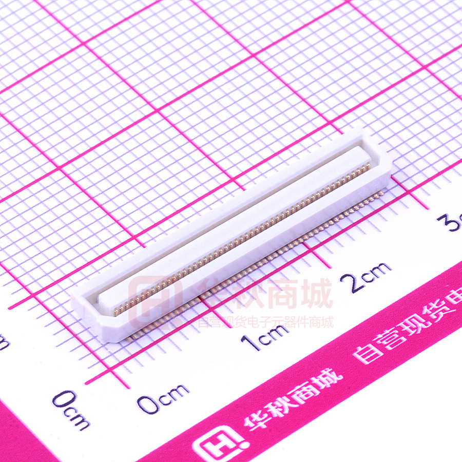

Narrow pitch connectors For board-to-board P5K , P5KS (0.5 mm pitch) (0.5 mm pitch) Mated heights of 3.0 to 9.0 mm supported with “TOUGH CONTACT” construction provides resistant to various environmental conditions. FEATURES P5K 5.8mm Socket 4.6mm Header Wide range of mated heights (3.0 to 9.0 mm) is available. “TOUGH CONTACT” construction provides high contact reliability design resistant to various environmental conditions. The effective mating length is long and there is enough space for mating. Models that support an ambient temperature of 105°C are also available. (P5KS) (For more information, please contact our sales representative.) TYPICAL APPLICATIONS P5KS Mobile devices and industrial equipment 5.4mm Socket 5.0mm Header DETAILS FEATURES  he effective mating length is long and there is T enough space for mating Effective mating length Even if the connection is incomplete, as the effective mating is longer, the normal electrical connection can be expected. Type Effective mating length P5K 0.65 mm P5KS 1.0 mm Automatic mounting Suction area for automatic mounting machines is employed. Suction face P5K Header 2021.10 P5K Socket industrial.panasonic.com/ac/e/ ー1ー Panasonic Corporation 2021 ACCTB22E 202110 Narrow Pitch Connectors P5K (0.5 mm pitch), P5KS (0.5 mm pitch) ORDERING INFORMATION (PART NO.) P5K (Mated height 3.0 mm) AXK Number of pins (2 digits) 5: Socket 6: Header 7 Y G Functions 3: With positioning bosses 4: Without positioning bosses Y: (Fixed) Packing G: 1,500 pieces embossed tape and plastic reel × 2 reels Surface treatment (Contact portion / Terminal portion) 7: Base: Ni plating, Surface: Au plating/ Base: Ni plating, Surface: Au plating Mated height (Socket) 1: For mated height 3.0 mm (Header) 3: For mated height 3.0 mm P5KS(Mated height 4.0 mm • 4.5 mm • 5.0 mm • 5.5 mm • 6.0 mm • 6.5 mm • 7.0 mm • 8.0 mm • 9.0 mm) AXK 7 Y G 5S: Socket 6S: Header Mated height (mm) (Socket) 0: For mated height 4.0/5.0/6.0 2: For mated height 4.5/5.5/6.5 3: For mated height 7.0/8.0/9.0 (Header) 4: For mated height 4.0/4.5/7.0 5: For mated height 5.0/5.5/8.0 6: For mated height 6.0/6.5/9.0 Packing G: For 4.0/4.5/5.0/5.5/6.0/6.5 mm mated height Socket and 4.0/4.5/7.0 mm mated height Header: 1,500 pieces embossed tape and plastic reel × 2 reels G: For 7.0/8.0/9.0 mm mated height Socket and 5.0/5.5/6.0/6.5/8.0/9.0 mm mated height Header: 1,000 pieces embossed tape and plastic reel × 2 reels Y: (Fixed) Functions 3: With positioning bosses 4: Without positioning bosses Number of pins (2 digits) Surface treatment (Contact portion / Terminal portion) 7: Base: Ni plating, Surface: Au plating/ Base: Ni plating, Surface: Au plating PRODUCT TYPES P5K Mated height 3.0 mm Number of pins Part No. Standard packing Socket Header 20 AXK520147YG AXK620347YG 30 AXK530147YG AXK630347YG 40 AXK540147YG AXK640347YG 50 AXK550147YG AXK650347YG 60 AXK560147YG AXK660347YG 70 AXK570147YG AXK670347YG 80 AXK580147YG AXK680347YG 100 AXK500147YG AXK600347YG 120 AXK5A2147YG AXK6A2347YG Inner carton (1-reel) Outer carton 1,500 pcs. 3,000 pcs. Notes: 1. Order unit: For volume production: 1-inner carton (1-reel) units. For samples, please contact our sales representative. 2. The standard type comes without positioning bosses. Connectors with positioning bosses are available for on-demand production. Panasonic Corporation Electromechanical Control Business Division industrial.panasonic.com/ac/e/ ー2ー Panasonic Corporation 2021 ACCTB22E 202110 Narrow Pitch Connectors P5K (0.5 mm pitch), P5KS (0.5 mm pitch) P5KS Mated height 4.0 mm 4.5 mm 5.0 mm 5.5 mm 6.0 mm Number of pins Part No. Standard packing Socket Header 20 AXK5S20047YG AXK6S20447YG 24 AXK5S24047YG AXK6S24447YG 30 AXK5S30047YG AXK6S30447YG 34 AXK5S34047YG AXK6S34447YG 40 AXK5S40047YG AXK6S40447YG 50 AXK5S50047YG AXK6S50447YG 60 AXK5S60047YG AXK6S60447YG 70 AXK5S70047YG AXK6S70447YG 80 AXK5S80047YG AXK6S80447YG 100 AXK5S00047YG AXK6S00447YG 20 AXK5S20247YG AXK6S20447YG 24 AXK5S24247YG AXK6S24447YG 30 AXK5S30247YG AXK6S30447YG 34 AXK5S34247YG AXK6S34447YG 40 AXK5S40247YG AXK6S40447YG 50 AXK5S50247YG AXK6S50447YG 60 AXK5S60247YG AXK6S60447YG 70 AXK5S70247YG AXK6S70447YG 80 AXK5S80247YG AXK6S80447YG 100 AXK5S00247YG AXK6S00447YG 20 AXK5S20047YG AXK6S20547YG 24 AXK5S24047YG AXK6S24547YG 30 AXK5S30047YG AXK6S30547YG 34 AXK5S34047YG AXK6S34547YG 40 AXK5S40047YG AXK6S40547YG 50 AXK5S50047YG AXK6S50547YG 60 AXK5S60047YG AXK6S60547YG 70 AXK5S70047YG AXK6S70547YG 80 AXK5S80047YG AXK6S80547YG 100 AXK5S00047YG AXK6S00547YG 20 AXK5S20247YG AXK6S20547YG 24 AXK5S24247YG AXK6S24547YG 30 AXK5S30247YG AXK6S30547YG 34 AXK5S34247YG AXK6S34547YG 40 AXK5S40247YG AXK6S40547YG 50 AXK5S50247YG AXK6S50547YG 60 AXK5S60247YG AXK6S60547YG 70 AXK5S70247YG AXK6S70547YG 80 AXK5S80247YG AXK6S80547YG 100 AXK5S00247YG AXK6S00547YG 20 AXK5S20047YG AXK6S20647YG 30 AXK5S30047YG AXK6S30647YG 40 AXK5S40047YG AXK6S40647YG 50 AXK5S50047YG AXK6S50647YG 60 AXK5S60047YG AXK6S60647YG 70 AXK5S70047YG AXK6S70647YG 80 AXK5S80047YG AXK6S80647YG 100 AXK5S00047YG AXK6S00647YG Inner carton (1-reel) Outer carton 1,500 pcs. 3,000 pcs. Socket: 1,500 pcs. Header: 1,000 pcs. Socket: 3,000 pcs. Header: 2,000 pcs. Notes: 1. Order unit: For volume production: 1-inner carton (1-reel) units. For samples, please contact our sales representative. 2. The standard type comes without positioning bosses. Connectors with positioning bosses are available for on-demand production. Panasonic Corporation Electromechanical Control Business Division industrial.panasonic.com/ac/e/ ー3ー Panasonic Corporation 2021 ACCTB22E 202110 Narrow Pitch Connectors P5K (0.5 mm pitch), P5KS (0.5 mm pitch) P5KS Mated height 6.5 mm 7.0 mm 8.0 mm 9.0 mm Number of pins Part No. Standard packing Socket Header 20 AXK5S20247YG AXK6S20647YG 30 AXK5S30247YG AXK6S30647YG 40 AXK5S40247YG AXK6S40647YG 50 AXK5S50247YG AXK6S50647YG 60 AXK5S60247YG AXK6S60647YG 70 AXK5S70247YG AXK6S70647YG 80 AXK5S80247YG AXK6S80647YG 100 AXK5S00247YG AXK6S00647YG 20 AXK5S20347YG AXK6S20447YG 30 AXK5S30347YG AXK6S30447YG 40 AXK5S40347YG AXK6S40447YG 50 AXK5S50347YG AXK6S50447YG 60 AXK5S60347YG AXK6S60447YG 70 AXK5S70347YG AXK6S70447YG 80 AXK5S80347YG AXK6S80447YG 100 AXK5S00347YG AXK6S00447YG 20 AXK5S20347YG AXK6S20547YG 30 AXK5S30347YG AXK6S30547YG 40 AXK5S40347YG AXK6S40547YG 50 AXK5S50347YG AXK6S50547YG 60 AXK5S60347YG AXK6S60547YG 70 AXK5S70347YG AXK6S70547YG 80 AXK5S80347YG AXK6S80547YG 100 AXK5S00347YG AXK6S00547YG 20 AXK5S20347YG AXK6S20647YG 30 AXK5S30347YG AXK6S30647YG 40 AXK5S40347YG AXK6S40647YG 50 AXK5S50347YG AXK6S50647YG 60 AXK5S60347YG AXK6S60647YG 70 AXK5S70347YG AXK6S70647YG 80 AXK5S80347YG AXK6S80647YG 100 AXK5S00347YG AXK6S00647YG Inner carton(1-reel) Outer carton Socket: 1,500 pcs. Header: 1,000 pcs. Socket: 3,000 pcs. Header: 2,000 pcs. Socket: 1,000 pcs. Header: 1,500 pcs. Socket: 2,000 pcs. Header: 3,000 pcs. 1,000 pcs. 2,000 pcs. Notes: 1. Order unit: For volume production: 1-inner carton (1-reel) units. For samples, please contact our sales representative. 2. The standard type comes without positioning bosses. Connectors with positioning bosses are available for on-demand production. Panasonic Corporation Electromechanical Control Business Division industrial.panasonic.com/ac/e/ ー4ー Panasonic Corporation 2021 ACCTB22E 202110 Narrow Pitch Connectors P5K (0.5 mm pitch), P5KS (0.5 mm pitch) SPECIFICATIONS Characteristics Specifications Item Electrical characteristics Mechanical characteristics (Mated height) 7.0 mm, 8.0 mm 9.0 mm Conditions Rated current 0.5 A/pin contact (Max. 10 A at total pin contacts) Rated voltage 60 V AC/DC Dielectric strength 150 V AC for 1 min. No short-circuiting or damage at a detection current of 1 mA when the specified voltage is applied for one minute. Insulation resistance Min. 1000 MΩ (initial) Using 500 V DC megger (applied for 1 min.) Contact resistance Max. 60 mΩ Composite insertion force Max. 0.785 N/pin contact × pin contacts (initial) Composite removal force Min. 0.0588 N/pin contact × pin contacts Ambient temperature –55 to +85°C No icing. No condensation. Soldering heat resistance The initial specification must be satisfied electrically and mechanically. Reflow soldering: Peak temperature: 260°C or less (on the surface of the PC board around the connector terminals) Soldering iron: 300°C within 5 sec. 350°C within 3 sec. Storage temperature –55 to +85°C (product only) –40 to +50°C (emboss packing) No icing. No condensation. 0.5 A/pin contact (Max. 16 A at total pin contacts) Based on the contact resistance measurement method specified by JIS C 5402. Max. 80 mΩ Conformed to MIL-STD-202F, method 107G Order Temperature (℃) Time (minutes) 1 30 ー55ー03 2 Max. 5 3 30 85 +30 4 Max. 5 0 ー55ー3 Thermal shock resistance (header and socket mated) 5 cycles, insulation resistance Min. 100 MΩ, contact resistance Max. 60 mΩ 5 cycles, insulation resistance Min. 100 MΩ, contact resistance Max. 80 mΩ Humidity resistance (header and socket mated) 120 hours, insulation resistance Min. 100 MΩ, contact resistance Max. 60 mΩ 120 hours, insulation resistance Min. 100 MΩ, contact resistance Max. 80 mΩ Conformed to IEC60068-2-78 Temperature 40±2°C, humidity 90 to 95% RH Saltwater spray resistance (header and socket mated) 24 hours, insulation resistance Min. 100 MΩ, contact resistance Max. 60 mΩ 24 hours, insulation resistance Min. 100 MΩ, contact resistance Max. 80 mΩ Conformed to IEC60068-2-11 Temperature 35±2°C, saltwarter concentration 5±1% H2S resistance (header and socket mated) 48 hours, contact resistance Max. 60 mΩ 48 hours, contact resistance Max. 80 mΩ Temperature 40±2°C, gas concentration 3±1 ppm, humidity 75 to 80% RH Insertion and removal 50 times life Unit weight ~ Lifetime characteristics (Mated height) 3.0 mm ~ Environmental characteristics (Mated height) 4.0 mm, 4.5 mm 5.0 mm, 5.5 mm 6.0 mm, 6.5 mm Repeated insertion and removal speed of Max. 200 times/hour P5K Mated height 3.0 mm 50 pins; Socket: 0.17 g, Header: 0.09 g P5KS Mated height 4.0 mm 30 pins; Socket: 0.18 g, Header: 0.16 g Material and surface treatment Part name Material Surface treatment Molded portion LCP resin (UL94V-0) − Contact and Post Copper alloy Contact portion: Base: Ni plating Surface: Au plating Terminal portion: Base: Ni plating Surface: Au plating (except the terminal tips) The terminals close to the portion to be soldered have nickel barriers (exposed nickel portions). Panasonic Corporation Electromechanical Control Business Division industrial.panasonic.com/ac/e/ ー5ー Panasonic Corporation 2021 ACCTB22E 202110 Narrow Pitch Connectors P5K (0.5 mm pitch), P5KS (0.5 mm pitch) DIMENSIONS Unit: mm CAD The CAD data of the products with a “CAD” mark can be downloaded from our Website. P5K Socket (Mated height 3.0 mm) CAD External dimensions A B±0.1 2.35 2.15 Terminal coplanarity 0.10 Dimension table Dimensions Number of pins 20 A B 8.20 4.50 30 10.70 7.00 40 13.20 9.50 50 15.70 12.00 60 18.20 14.50 70 20.70 17.00 80 23.20 19.50 100 28.20 24.50 120 33.20 29.50 0.17±0.03 (0.9) 4.0 5.8 1.44 (Suction face) (0.9) 0.5±0.05 0.2±0.03 5.0 0.5±0.05 General tolerance: ±0.2 P5K Header (Mated height 3.0 mm) CAD 0.10 Dimensions Number of pins 20 A B 8.20 4.50 30 10.70 7.00 40 13.20 9.50 50 15.70 12.00 60 18.20 14.50 70 20.70 17.00 80 23.20 19.50 100 28.20 24.50 120 33.20 29.50 4.6 0.5±0.05 0.2±0.03 Terminal coplanarity (1.4) 1.8 (1.4) 0.5±0.05 Dimension table 2.40 0.85 3.8 1.44 (Suction face) External dimensions A B±0.1 0.20±0.03 General tolerance: ±0.2 Socket and Header are mated ー0.1 3.0 +0.2 Note: P5KS (mated heights 4.0 mm, 4.5 mm, 5.0 mm, 5.5 mm, 6.0 mm, 6.5 mm, 7.0 mm, 8.0 mm, and 9.0 mm) cannot be mated to this type. Panasonic Corporation Electromechanical Control Business Division industrial.panasonic.com/ac/e/ ー6ー Panasonic Corporation 2021 ACCTB22E 202110 Narrow Pitch Connectors P5K (0.5 mm pitch), P5KS (0.5 mm pitch) P5KS Socket (Mated height 4.0 mm, 4.5 mm, 5.0 mm, 5.5 mm, 6.0 mm, 6.5 mm, 7.0 mm, 8.0 mm and 9.0 mm) CAD External dimensions 0.10 Dimension table (1.10) 0.5±0.05 0.2±0.03 Dimensions Number of pins 20 A B 8.20 4.50 24 9.20 5.50 30 10.70 7.00 34 11.70 8.00 40 13.20 9.50 50 15.70 12.00 60 18.20 14.50 70 20.70 17.00 80 23.20 19.50 100 28.20 24.50 (1.10) 4.6 0.5±0.05 Terminal coplanarity C 3.20 5.4 1.82 (Suction face) A B±0.1 0.15±0.03 General tolerance: ±0.2 Dimensions Mated height C 4.0 mm, 5.0 mm, 6.0 mm 3.05 4.5 mm, 5.5 mm, 6.5 mm 3.55 7.0 mm, 8.0 mm, 9.0 mm 6.05 P5KS Header (Mated height 4.0 mm, 4.5 mm, 5.0 mm, 5.5 mm, 6.0 mm, 6.5 mm, 7.0 mm, 8.0 mm and 9.0 mm) CAD External dimensions 0.10 4.2 C0.9 0.20±0.03 (1.10) 0.5±0.05 0.2±0.03 Terminal coplanarity C Dimension table Dimensions Number of pins 20 A B 2.8 5.0 0.5±0.05 D 8.20 4.50 24 9.20 5.50 30 10.70 7.00 34 11.70 8.00 40 13.20 9.50 50 15.70 12.00 60 18.20 14.50 70 20.70 17.00 80 23.20 19.50 100 28.20 24.50 C D (1.10) 1.72 (Suction face) A B±0.1 General tolerance : ±0.2 Dimensions Mated height 4.0 mm, 4.5 mm, 7.0 mm 0.95 3.30 5.0 mm, 5.5 mm, 8.0 mm 1.95 4.30 6.0 mm, 6.5 mm, 9.0 mm 2.95 5.30 Socket and Header are mated Dimensions +0.2 ー0.1 A Mated height A 4.0 mm 4.00 4.5 mm 4.50 5.0 mm 5.00 5.5 mm 5.50 6.0 mm 6.00 6.5 mm 6.50 7.0 mm 7.00 8.0 mm 8.00 9.0 mm 9.00 Note: P5K (mated heights 3.0 mm) cannot be mated to this type. Panasonic Corporation Electromechanical Control Business Division industrial.panasonic.com/ac/e/ ー7ー Panasonic Corporation 2021 ACCTB22E 202110 Narrow Pitch Connectors P5K (0.5 mm pitch), P5KS (0.5 mm pitch) EMBOSSED TAPE DIMENSIONS Unit: mm Specifications for taping Specifications for the plastic reel In accordance with JIS C 0806:1990. However, not applied to the mounting-hole pitch of some connectors. Tape I Label Top cover tape (A±0.3) (B) φ380 Embossed carrier tape Embossed mounting-hole (2.0) Taping reel (12.0) (12.0) (4.0) Leading direction after packaging (4.0) (C) (1.75) (2.0) Leading direction after packaging D±1 Tape Il (A±0.3) (C) (1.75) In accordance with EIAJ ET-7200B. φ1.5 +0.1 0 φ1.5+0.1 0 Dimension table P5K Type/Mated height Number of pins Type of taping A Socket and header are common 3.0 mm B C D 20 to 50 Tape I 24.0 − 11.5 25.4 60 to 70 Tape II 32.0 28.4 14.2 33.4 80 to 100 Tape II 44.0 40.4 20.2 45.4 120 Tape II 56.0 52.4 26.2 57.4 Type/Mated height Number of pins Type of taping A B C D Socket 4.0 mm, 4.5 mm, 5.0 mm, 5.5 mm, 6.0 mm, 6.5 mm Header 4.0 mm, 4.5 mm, 7.0 mm 20 to 50 Tape I 24.0 − 11.5 25.4 60 to 70 Tape II 32.0 28.4 14.2 33.4 80 to 100 Tape II 44.0 40.4 20.2 45.4 20 to 50 Tape I 24.0 − 11.5 25.4 60 to 70 Tape II 32.0 28.4 14.2 33.4 80 to 100 Tape II 44.0 40.4 20.2 45.4 Quantity per reel 1,500 P5KS Socket 7.0 mm, 8.0 mm, 9.0 mm Header 5.0 mm, 5.5 mm, 6.0 mm, 6.5 mm, 8.0 mm, 9.0 mm Quantity per reel 1,500 1,000 Connector orientation with respect to embossed tape feeding direction Direction of tape progress Direction of tape progress Type Common for P5K Socket Header This corner is oriented on the C side This corner is oriented on the C side Type Common for P5KS Socket Header This corner is oriented on the C side This corner is oriented on the C side Panasonic Corporation Electromechanical Control Business Division industrial.panasonic.com/ac/e/ ー8ー Panasonic Corporation 2021 ACCTB22E 202110 Narrow Pitch Connectors P5K (0.5 mm pitch), P5KS (0.5 mm pitch) NOTES Unit: mm Prevention of reverse mating The socket and header are protected from reverse mating by a molded resin key. Excessive mating force may damage the key, so be sure to match chamfered corners when mating. Outline (top view) Chamfered corner Chamfered corner Chamfered corner Mating state Design of PC board patterns Conduct the recommended foot pattern design, in order to preserve the mechanical strength of terminal solder areas. Recommended PC board and metal mask patterns Connectors are mounted with high pitch density, intervals of 0.35 mm, 0.4 mm or 0.5 mm. In order to reduce solder and flux rise, solder bridges and other issues make sure the proper levels of solder is used. The figures are recommended patterns. Please use them as a reference. Note: Please refer to the dimension table for the B dimension of the socket and header. P5K Socket P5K Header Recommended PC board pattern (TOP VIEW) Recommended PC board pattern (TOP VIEW) B±0.05 0.50±0.05 0.50±0.05 0.25±0.05 0.125±0.05 0.75±0.05 3.20±0.05 0.125±0.05 0.75±0.05 Recommended metal mask pattern Metal mask thickness: When 150 μm (Opening area ratio: 62%) 0.115±0.01 0.35±0.01 Panasonic Corporation Electromechanical Control Business Division industrial.panasonic.com/ac/e/ ー9ー Panasonic Corporation 2021 (1.55) 0.115±0.01 0.35±0.01 2.50±0.01 5.60±0.01 4.60±0.01 6.80±0.01 (1.10) (1.10) B±0.01 0.50±0.01 0.50±0.01 0.23±0.01 (1.55) Recommended metal mask pattern Metal mask thickness: When 150 μm (Opening area ratio: 56%) B±0.01 0.50±0.01 0.50±0.01 0.23±0.01 1.00±0.05 6.80±0.05 5.60±0.05 B±0.05 0.50±0.05 0.50±0.05 0.25±0.05 ACCTB22E 202110 Narrow Pitch Connectors P5K (0.5 mm pitch), P5KS (0.5 mm pitch) Recommended metal mask pattern Metal mask thickness: When 120 μm (Opening area ratio: 78%) B±0.01 0.50±0.01 0.50±0.01 0.23±0.01 5.60±0.01 0.115±0.01 0.35±0.01 P5KS Socket (1.95) 0.115±0.01 0.35±0.01 1.70±0.01 (1.35) 4.10±0.01 6.80±0.01 (1.35) B±0.01 0.50±0.01 0.50±0.01 0.23±0.01 (1.95) Recommended metal mask pattern Metal mask thickness: When 120 μm (Opening area ratio: 69%) P5KS Header Recommended PC board pattern (TOP VIEW) Recommended PC board pattern (TOP VIEW) B±0.05 0.50±0.05 0.50±0.05 0.25±0.05 0.125±0.05 0.75±0.05 0.125±0.05 0.75±0.05 Recommended metal mask pattern Metal mask thickness: When 150 μm (Opening area ratio: 69%) Recommended metal mask pattern Metal mask thickness: When 120 μm (Opening area ratio: 87%) B±0.01 0.50±0.01 0.50±0.01 0.23±0.01 B±0.01 0.50±0.01 0.50±0.01 0.23±0.01 (1.50) 6.00±0.01 Panasonic Corporation Electromechanical Control Business Division industrial.panasonic.com/ac/e/ ー 10 ー Panasonic Corporation 2021 (1.90) 0.115±0.01 0.35±0.01 2.20±0.01 3.10±0.01 0.115±0.01 0.35±0.01 (1.65) 6.40±0.01 (1.65) Recommended metal mask pattern Metal mask thickness: When 120 μm (Opening area ratio: 76%) 3.00±0.01 6.00±0.01 6.40±0.01 0.115±0.01 0.35±0.01 (1.90) 0.115±0.01 0.35±0.01 (1.30) 3.80±0.01 (1.30) B±0.01 0.50±0.01 0.50±0.01 0.23±0.01 (1.50) Recommended metal mask pattern Metal mask thickness: When 150 μm (Opening area ratio: 60%) B±0.01 0.50±0.01 0.50±0.01 0.23±0.01 2.00±0.05 2.40±0.05 6.00±0.05 6.40±0.05 B±0.05 0.50±0.05 0.50±0.05 0.25±0.05 ACCTB22E 202110 Narrow Pitch Connectors P5K (0.5 mm pitch), P5KS (0.5 mm pitch) Please refer to "the latest product specifications" when designing your product. •Requests to customers: https://industrial.panasonic.com/ac/e/salespolicies/ Panasonic Corporation Electromechanical Control Business Division industrial.panasonic.com/ac/e/ ー 11 ー Panasonic Corporation 2021 ACCTB22E 202110 For board-to-board/board-to-FPC Notes on Using Narrow pitch Connectors/High Current Connectors About safety remarks Observe the following safety remarks to prevent accidents and injuries. • Do not use these connectors beyond the specification sheets. The usage outside of specified rated current, dielectric strength, and environmental conditions and so on may cause circuitry damage via abnormal heating, smoke, and fire. • In order to avoid accidents, your thorough specification review is appreciated. Please contact our sales representative if your usage is out of the specifications. Otherwise, Panasonic Corporation cannot guarantee the quality and reliability. • Panasonic Corporation is consistently striving to improve quality and reliability. However, the fact remains that electrical components and devices generally cause failures at a given statistical probability. Furthermore, their durability varies with use environments or use conditions. In this respect, please check for actual electrical components and devices under actual conditions before use. Continued usage in a state of degraded condition may cause the deteriorated insulation, thus result in abnormal heat, smoke or firing. Please carry out safety design and periodic maintenance including redundancy design, design for fire spread prevention, and design for malfunction prevention so that no accidents resulting in injury or death, fire accidents, or social damage will be caused as a result of failure of the products or ending life of the products. Regarding the design of devices and PC board patterns • When using board to board connectors, a pair of board shaII NOT be connected with multiple connectors. Otherwise, misaligned connector positions may cause mating failure or product breakage. Panasonic corporation does not guarantee the failures caused by using the multiple connectors. • With mounting equipment, there may be up to a ±0.2 to 0.3 mm error in positioning. Be sure to design PC boards and patterns while taking into consideration the performance and abilities of the required equipment. • Some connectors have tabs embossed on the body to aid in positioning. When using these connectors, make sure that the PC board is designed with positioning holes to match these tabs. • To ensure the required mechanical strength when soldering the connector terminals, make sure the PC board meets recommended PC board pattern design dimensions given. • PC board Control the thicknesses of the cover lay and adhesive to prevent poor soldering. This connector has no stand-off. Therefore, minimize the thickness of the cover lay, etc. so as to prevent the occurrence of poor soldering. • For all connectors of the narrow pitch series, to prevent the PC board from coming off during vibrations or impacts, and to prevent loads from falling directly on the soldered portions, be sure to design some means to fix the PC board in place. Example ) Secure in place with screws • When mounting connectors on a FPC • When the connector soldered to FPC is mated or unmated, solder detachment may occur by the force to the terminals. Connector handling is recommended in the condition when the reinforcing plate is attached to the backside of FPC where the connector is mounted. The external dimension of the reinforcing plate is recommended to be larger than the dimension of “ Recommended PC board pattern ” ( extended dimension of one side is approximately 0.5 to 1.0 mm ). The materials and thickness of the reinforcing plate are glass epoxy or polyimide ( thickness 0.2 to 0.3 mm ) or SUS ( thickness 0.1 to 0.2 mm ). • As this connector has temporary locking structure, the connector mating may be separated by the dropping impact depend on the size, weight or bending force of the FPC. Please consider the measures at usage to prevent the mating separation. • The narrow pitch connector series is designed to be compact and thin. Although ease of handling has been taken into account, take care when mating the connectors, as displacement or angled mating could damage or deform the connector. Screw ↓ ↓ Spacer Connector Spacer PC board When connecting PC boards, take appropriate measures to prevent the connector from coming off. Panasonic Corporation Electromechanical Control Business Division industrial.panasonic.com/ac/e/ ー 12 ー Panasonic Corporation 2021 ACCTB48E 202110 Notes on Using Narrow pitch Connectors/High Current Connectors Regarding the selection of the connector placement machine and the mounting procedures • Select the placement machine taking into consideration the connector height, required positioning accuracy, and packaging conditions. • Be aware that if the chucking force of the placement machine is too great, it may deform the shape of the connector body or connector terminals. • Be aware that during mounting, external forces may be applied to the connector contact surfaces and terminals and cause deformations. • Depending on the size of the connector being used, self alignment may not be possible. In such cases, be sure to carefully position the terminal with the PC board pattern. • The positioning bosses give an approximate alignment for positioning on the PC board. For accurate positioning of the connector when mounting it to the PC board, we recommend using an automatic positioning machine. • In case of dry condition, please note the occurrence of static electricity. The product may be adhered to the embossed carrier tape or the cover tape in dry condition. Recommended humidity is from 40 to 60% RH and please remove static electricity by ionizer in manufacturing process. Regarding soldering ■ Reflow soldering • Measure the recommended profile temperature for reflow soldering by placing a sensor on the PC board near the connector surface or terminals. ( Please refer to the specification for detail because the temperature setting differs by products. ) • As for cream solder printing, screen printing is recommended. • When setting the screen opening area and PC board foot pattern area, refer the recommended PC board pattern and window size of metal mask on the specification sheet, and make sure that the size of board pattern and metal mask at the base of the terminals are not increased. • Please pay attentions not to provide too much solder. It makes miss mating because of interference at soldering portion when mating. Terminal Paste solder PC board foot pattern • When mounting on both sides of the PC board and the connector is mounting on the underside, use adhesives or other means to ensure the connector is properly fixed to the PC board. ( Double reflow soldering on the same side is possible. ) • The condition of solder or flux rise and wettability varies depending on the type of solder and flux. Solder and flux characteristics should be taken into consideration and also set the reflow temperature and oxygen level. Panasonic Corporation Electromechanical Control Business Division industrial.panasonic.com/ac/e/ ー 13 ー • Do not use resin-containing solder. Otherwise, the contacts might be firmly fixed. • Soldering conditions Please use the reflow temperature profile conditions recommended below for reflow soldering. Please contact our sales representative before using a temperature profile other than that described below ( e.g. lead-free solder ) Temperature Peak temperature 260℃ 230℃ Preheating 180℃ 150℃ 60 to 120 sec. 220℃ 200℃ 25 sec. 70 sec. Upper limited (Solder heat resistance) Lower limited (Solder wettability) Time For products other than the ones above, please refer to the latest product specifications. • The temperature profiles given in this catalog are values measured when using the connector on a resin-based PC board. When performed reflow soldering on a metal board ( iron, aluminum, etc. ) or a metal table to mount on a FPC, make sure there is no deformation or discoloration of the connector before mounting. • Please contact our sales representative when using a screen-printing thickness other than that recommended. Panasonic Corporation 2021 ACCTB48E 202110 Notes on Using Narrow pitch Connectors/High Current Connectors ■ Hand soldering • Be aware that soldering while applying a load on the connector terminals may cause improper operation of the connector. • Thoroughly clean the soldering iron. • Flux from the solder wire may get on the contact surfaces during soldering operations. After soldering, carefully check the contact surfaces and clean off any solder before use. • These connector is low profile type. If too much solder is supplied for hand soldering, It makes miss mating because of interference at soldering portion. Please pay attentions. • Set the soldering iron so that the tip temperature is less than that given in the table below. Table A Product name Soldering iron temperature SMD type connectors all products 300℃ within 5 sec. 350℃ within 3 sec. rin S iro old n e Apply the solder wire here g • Do not allow flux to spread onto the connector leads or PC board. This may lead to flux rising up to the connector inside. • Touch the soldering iron to the foot pattern. After the foot pattern and connector terminal are heated, apply the solder wire so it melts at the end of the connector terminals. Small angle as possible up to 45 degrees Terminal PC board Pattern ■ Solder reworking • Finish reworking in one operation. • In case of soldering rework of bridges. Do not use supplementary solder flux. Doing so may cause contact problems by flux. • Keep the soldering iron tip temperature below the temperature given in Table A. Handling single components • Make sure not to drop or allow parts to fall from work bench. • Excessive force applied to the terminals could cause warping, come out, or weaken the adhesive strength of the solder. Handle with care. • Do not insert or remove the connector when it is not soldered. Forcibly applied external pressure on the terminals can weaken the adherence of the terminals to the molded part or cause the terminals to lose their evenness. Precautions for mating This product is designed with ease of handling. However, in order to prevent the deformation or damage of contacts and molding, take care and do not mate the connectors as shown right. Our products are symmetrical structure. Please avoid reverse insertion of connector. Inserting a connector in a circuit direction opposite to that you intended may cause circuitry damage via abnormal heating, smoke, and fire. Press-fitting while the mating Strongly pressed and inlets of the socket and Tilted mating twisted header are not matched. Cleaning flux from PC board There is no need to clean this product. If cleaning it, pay attention to the following points to prevent the negative effect to the product. • Keep the cleaning solvent clean and prevent the connector contacts from contamination. • Some cleaning solvents are strong and they may dissolve the molded part and characters, so pure water passed liquid solvent is recommended. Panasonic Corporation Electromechanical Control Business Division industrial.panasonic.com/ac/e/ ー 14 ー Panasonic Corporation 2021 ACCTB48E 202110 Notes on Using Narrow pitch Connectors/High Current Connectors Handling the PC board ■ Handling the PC board after mounting the connector The soldered areas should not be subjected to force. When cutting or bending the PC board after mounting the connector, be careful that the soldered sections are subjected to excessive force. Storage of connectors • To prevent problems from voids or air pockets due to heat of reflow soldering, avoid storing the connectors in areas of high humidity. • Depending on the connector type, the color of the connector may vary from connector to connector depending on when it is produced. Some connectors may change color slightly if subjected to ultraviolet rays during storage. This is normal and will not affect the operation of the connector. • When storing the connectors with the PC boards assembled and components already set, be careful not to stack them up so the connectors are subjected to excessive forces. • Avoid storing the connectors in locations with excessive dust. The dust may accumulate and cause improper connections at the contact surfaces. Other Notes • Do not remove or insert the electrified connector ( in the state of carrying current or applying voltage ). • Dropping of the products or rough mishandling may bend or damage the terminals and possibly hinder proper reflow soldering. • Before soldering, try not to insert or remove the connector more than absolutely necessary. • When coating the PC board after soldering the connector to prevent the deterioration of insulation, perform the coating in such a way so that the coating does not get on the connector. • There may be variations in the colors of products from different production lots. This is normal. • The connectors are not meant to be used for switching. • Product failures due to condensation are not covered by warranty. Regarding sample orders to confirm proper mounting When ordering samples to confirm proper mounting with the placement machine, connectors are delivered in 50-piece units in the condition given right. Consult a sale representative for ordering sample units. Condition when delivered from manufacturing Embossed tape amount required for the mounting Reel Delivery can also be made on a reel by customer request. Required number of products for sample production ( Unit 50 pcs. ) Please refer to "the latest product specifications" when designing your product. •Requests to customers: https://industrial.panasonic.com/ac/e/salespolicies/ Panasonic Corporation Electromechanical Control Business Division industrial.panasonic.com/ac/e/ ー 15 ー Panasonic Corporation 2021 ACCTB48E 202110 Please contact .......... Electromechanical Control Business Division 1006, Oaza Kadoma, Kadoma-shi, Osaka 571-8506, Japan industral.panasonic.com/ac/e/ ©Panasonic Corporation 2021 ACCTB22E 202110 Specifications are subject to change without notice.

物料型号: - P5K系列:板对板连接器,具有0.5mm的间距。 - P5KS系列:板对板连接器,具有0.5mm的间距,支持更高的环境温度。
器件简介: - P5K和P5KS系列连接器采用“TOUGH CONTACT”构造,提供3.0至9.0mm的多种配合高度,具有高接触可靠性,能够抵抗各种环境条件。
引脚分配: - P5K系列:有效配合长度为0.65mm。 - P5KS系列:有效配合长度为1.0mm。
参数特性: - 工作温度范围:P5KS系列支持高达105°C的环境温度。 - 额定电流:每针脚0.5A,最大16A总针脚电流。 - 额定电压:60VAC/DC。 - 绝缘强度:150VAC持续1分钟。 - 绝缘电阻:最小1000MΩ(初始)。 - 接触电阻:最大60mΩ。
功能详解: - 提供了自动贴装所需的吸盘区域。 - 有效配合长度长,即使连接不完全,也能保持正常的电气连接。
应用信息: - 适用于移动设备和工业设备。
封装信息: - 提供了详细的订购信息,包括型号、包装和数量。 - P5K系列:3.0mm配合高度,提供20至120针脚型号。 - P5KS系列:提供4.0mm至9.0mm的多种配合高度,以及20至100针脚型号。
