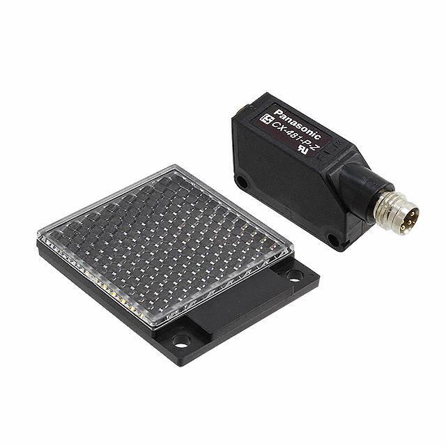

    SENSOR RETROREFLECTIVE 500MM PNP

CX-400 SERIES Compact Photoelectric Sensor Full line of world standard sensors now available! We have a full lineup of world standard photoelectric sensors! 116 models available! A long range and small spot!  Output    NPN, PNP  Connecting method    Cable type, M8 Plug-in connector type, M12 Pigtailed type  Cable length of cable type   0.5 m 1.640 ft, 2 m 6.562 ft, 5 m 16.404 ft 200 mm 7.874 in 100 mm 3.937 in Sensing range 70 to 200 mm 2.756 to 7.874 in The smallest spot in the industry at approx. "2 mm "0.079 in Special transparent object circuit enhances detectability! A bright, spot at approx. "5 mm "0.197 in Diffuse reflective • narrow-view type CX-423 A height difference equal to the thickness of one business card can be detected! A bright spot at approx. "2 mm "0.079 in CX-441 Sensing range 2 m 6.562 ft / 0.5 m 1.640 ft Retroreflective type for transparent object sensing Sensing range 300 mm 11.811 in / 100 mm 3.937 in / 50 mm 1.969 in CX-482/481 800 mm 31.496 in 300 mm 11.811 in Adjustable range reflective type CX-442/444/443/441 100 mm 3.937 in Sensing range 800 mm 31.496 in / 300 mm 11.811 in / 100 mm 3.937 in Diffuse reflective type CX-422/421/424 15 m 49.213 ft Sensing range 15 m 49.213 ft / 10 m 32.808 ft Sensing range 5 m 16.404 ft / 3 m 9.843 ft Thru-beam type Retroreflective type CX-412/411 CX-493/491 162 08/2005 CX-400 CX-400 Series Selection Long range sensing desired Small parts sensing desired  CX-400 series sensors solves all your sensing troubles. Thru-beam type Longest in its class with a distance of 15 m 49.213 ft CX-412 Rertroreflective type Longest in its class with a distance of 5 m 16.404 ft CX-493 Diffuse reflective type Long sensing range 800 mm 31.496 in CX-422 Fit slit for thru-beam type Minimum size for sensing object "0.5 mm "0.020 in with slit fitted CX-411 Diffuse reflective • narrow-view type LED light source realizes a spot diameter of approx. "2 mm "0.079 in CX-423 Adjustable range reflective type Approx. "2 mm "0.079 in spot unaffected by background objects CX-441 High precision, 0.4 mm 0.016 in height difference sensing possible CX-441/443 Long sensing range 300 mm 11.811 in / 100 mm 3.937 in CX-442/444 Thru-beam type Sensing range 15 m 49.213 ft / 10 m 32.808 ft CX-411/412 Rertroreflective type Polarizing filter built-in CX-491 Adjustable range reflective type FGS function ensures stable sensing CX-44 Thru-beam type Uses penetrating infrared light CX-412 Adjustable range reflective type Judgment based on incidence angle to avoid light-receiving amount swaying CX-44 Thru-beam type Uses acrylic for lens surface for superior oil resistance CX-41 Diffuse reflective type Uses acrylic for lens surface for superior oil resistance CX-42 Rertroreflective type Uses acrylic for lens surface for superior oil resistance CX-49 Diffuse reflective • narrow-view type The bright spot makes the beam axis clearly visible CX-423 Adjustable range reflective type The bright spot makes the beam axis clearly visible CX-44 High precision type with built-in special transparent object circuit CX-481 Built-in special transparent object circuit. Long sensing range 2 m 6.562 ft. CX-482 Minute height difference discernment desired (Background present) Adjustable range reflective type Glossy object sensing desired Area prone to dirt and dust Oil is scattered about Simple light beam axis adjustment desired Precise transparent object sensing desired Rertroreflective type 08/2005 163 CX-400 ‘Strong’ against even the harshest conditions guarantees reliability. Strongest in its class m Strong against oil and As of April 2004 and based on coolant liquids m research conducted by SUNX. CX-41/42/49 The lens material for the thru-beam type, retroreflective type (excluding the CX-48) and the diffuse reflective type are made of a strong acrylic that resists the harmful effects of coolants. These sensors can be used with confidence even around metal processing machinery that disperses oil mists. The protection mechanism also conforms to IP67 (IEC). Strong against ethanol CX-44/48 Strong against noise A strong, ethanol resistant polycarbonate was used for the front and display covers. Safe even for installing near food processing machinery that disperses ethanol based detergents. The protection mechanism also conforms to IP67 (IEC). Significantly stronger against inverter light and other extraneous light as well as high frequency and electromagnetic noise generated by high-pressure inverter motors and other devices. Fluorescent light tube Inverter motor Oil Strong against interference Strong The interference prevention function lets two sensors to be mounted close together precisely. Interference prevention filter (Optional) Thru-beam type Only CX-411 Strong Strong Noise Retroreflective type Automatic interference prevention function Diffuse reflective type Adjustable range reflective type Less energy Strong even in cold environments Power consumption Stable performance can be maintained even in environments of 25 C 13 F . The ideal sensors that are people and environmentally friendly are born from the concept of ‘less’ waste. Less space The sensors are compact in size at W11.2 H31D20 mm W0.441H1.220D0.787 in. The mounting pitch is also at the world standard size of 25.4 mm 1.000 in. Compact size Less processing M8 plug-in connector type and M12 pigtailed type are available. This contributes to less time spent in setting up. In addition, cable types are available with cable lengths of 0.5 m 1.640 ft, 2 m 6.562 ft and 5 m 16.404 ft. This results in less wastage. Great maintainability No unnecessary cables or terminal blocks 11.2 mm 0.441 in Industry standard mounting pitch 25.4 mm 1.000 in Cable type M8 plug-in connector type 20 mm 0.787 in 31 mm 1.220 in Digital laser sensor LS series 6.562 ft / ( 52 mm 16.404 ft ) 2 m 6.562 ft / ( 5 m 16.404 ft ) Elbow Straight M12 pigtailed type Straight CX-400 series 5m 16.404 ft 2m 6.562 ft ( 2 m 6.562 ft / 5 m 16.404 ft ) 0.5 m 1.640 ft 164 08/2005 CX-400 The new standard sensors for the 21st Century provide ‘high’ performance detection. High precision optics and high performance special circuitry SUNX s unique optical systems and specially designed electronic circuits provide stable sensing of even the minutest height difference and the thinnest transparent film. Highest performance in its class m m As of April 2004 and based on research conducted by SUNX. CX-441/443 Detecting a height difference of even as little as 0.4 mm 0.016 in possible (equivalent to one business card). 2.5 times the sensing capability! CX-481/482 A full range of 2 m 6.562 ft sensing range types are available. They are capable of sensing a 10 !m transparent film even at a long range. CX-44 ● Even different colored object can be sensed at roughly the same distance. No adjuster control is needed when the setup is changed. 30 % increase in sensing range between black and whitem compared to the conventional products! Twice the sensing range! m The difference in sensing range between black non-glossy paper (lightness: 5) and white nonglossy paper CX-482 ● BGS / FGS functions make even the most challenging settings possible. Controls the adverse effects of background objects. Precision High Refer to p.8 for details. Easy to use high-level functions! CX-400 Conventional Conventional product product High High luminance 0 Smallest spot in its class Spot 1 2 Comparative ratio with 1 representing conventional SUNX sensors Less resources used Wastage m of April 2004 and based on High luminance spot m Asresearch conducted by SUNX. CX-423/44 These sensors realize a high luminance red spot that provides bright visibility. The sensing position can be checked at a glance. Because it has the smallest spot in its class, approx. "2 mm "0.079 in (CX-423/441), even the minutest object can be accurately detected. CX-423 Great visibility approx. "2 mm "0.079 in high luminance spot Less Less power consumed Less resources used The CX-400 series sensors achieve a maximum of approx. 55 % the power consumption of conventional sensors. Contributes to preserving the environment. Based on environmental considerations, simplified packaging is used in order to reduce waste. In addition, the bag is made from polyethylene which produces no toxic gases even when burned. 45 A maximum % reduction compared to conventional sensors!! 08/2005 165 CX-400 Thru-beam type Applications CX-411: 10 m 32.808 ft ● Detecting out of position tape feeder cassette CX-412: 15 m 49.213 ft The longest in its class m Slit mask m As of April 2004 and based on research conducted by SUNX. Out of position m The longest in its class CX-411 Strong infrared beam CX-412 The longest in its class, it realizes a 15 m 49.213 ft long-distance sensing range. Remarkable penetrating power enables applications such as package content detection. (Note) Strong on dust and dirt CX-412 Because the light source is an infrared light, it is strong on dust and dirt compared to the red beam type. ● Synchronizing sensor for image processing systems Even the thru-beam type is strong on mutual interference CX-411 Two CX-411 sensors, with their red beam light source, can be installed close together by fitting an interference prevention filter. CX-411 Interference prevention filter (Optional) Note: When sensing utilizing penetrating power, make sure to verify using the actual sensor. Retroreflective type The longest in its class CX-493: 5 m 16.404 ft CX-491: 3 m 9.843 ft The longest in its class m Long sensing range of 5 m 16.404 ft CX-493 m A long 5 m 16.404 ft sensing range is possible with the red LED type that is easy to align with the beam axis. Can be used for wide automatic door shutters. Retroreflective type with polarizing filters CX-491 Built-in polarizing filters ensure stable sensing even on a mirror surface object. For transparent object sensing No.1 in the industry CX-482: 2 m 6.562 ft CX-481: 0.5 m 1.640 ft m Strong against extraneous light and noise CX-491 With a level of performance ranked No.1 in the industry m, these sensors provide stable sensing. Two sensors can be mounted close together m As of April 2004 and based on research conducted by SUNX. 166 08/2005 The interference prevention function lets two sensors of any type to be mounted close together precisely. CX-400 Diffuse reflective type CX-422: 800 mm 31.496 in CX-421: 300 mm 11.811 in CX-424: 100 mm 3.937 in Applications ● Small parts sensing CX-423 CX-423: 70 to 200 mm Narrow-view type 2.756 to 7.874 in Smallest spot in its class m Beam axis alignment made easy with a high luminance spot beam CX-423 ● Passage confirmation on substrate conveyance equipment These sensors realize a high luminance red LED spot that provides bright visibility enabling the sensing position to be checked at a glance. Because it has the smallest spot in its class, approx. "2 mm "0.079 in, even the minutest object can be accurately detected. Reduction of volume adjustment labor Because these sensors possess many variations depending on the sensing range, enables you to make optimal volume adjustment easily. CX-423 CX-424 Great visibility approx. "2 mm "0.079 in high luminance spot m As of April 2004 and based on research conducted by SUNX. Introducing the transparent object sensing type sensor CX-48 Our unique optical system and transparent object sensing circuitry provide stable sensing of even thinner transparent objects than the conventional models. Applications ● Sensing glossy white electric appliances ● Sensing plastic bottles stacked on pallets Twice the sensing range! CX-491 Transparent objects detectable with CX-48 (Typical examples) Sensing object Glass sheet Cylindrical glass Acrylic board Styrol (Floppy case) Food wrapping film Cigarette case film Vinyl sack Pet bottle (500m#) ● Passage confirmation of object on a conveyor belt CX-482 ● Detecting transparent film Sensing object size (mm in) t 0.7 t 0.028 50 1.969 "50 "1.969 # 50 # 1.969 t 1.3 t 0.051 50 1.969 t 1.0 t 0.039 t 0.9 t 0.035 50 1.969 t 10 !m t 0.394 mil 50 1.969 t 20 !m t 0.787 mil 50 1.969 t 30 !m t 1.181 mil 50 1.969 "66 "2.598 Reflector setting range CX-481: 300 to 500 mm 11.811 to 19.685 in, CX-482: 1 to 2 m 3.281 to 6.562 ft [with the RF-230 reflector at the optimum condition (Note)] Each object should pass across the beam at the center between the sensor and the reflector. ?: Length of cylindrical glasses t : Thickness of sensing object Note: The optimum condition is defined as the condition in which the sensitivity level is set such that the stability indicator just lights up when the object is absent. CX-481 CX-491 08/2005 167 CX-400 Adjustable range reflective type CX-442 CX-444 CX-441 CX-443 1.5 times longer than before 300 mm 11.811 in 100 mm 3.937 in 50 mm 1.969 in The longest in its class m Smallest spot in its class Spot diameter "2 mm "0.079 in approx. High precision type Highest performance in its class m 50 mm 1.969 in Spot diameter "6.5 mm "0.256 in approx. m CX-441/443 ● Can sense differences as small as 0.4 mm 0.016 in, with hysteresis of 2 % or less ● Not affected by color. The difference in sensing range between black and white is 1 % or less. (Note) An advanced optical system provides sensing performance that is approx. 2.5 times than conventional models. Even ultra-small differences of 0.4 mm 0.016 in can be detected accurately. Both black and white objects can be sensed at the same distances. No adjuster control is needed, even when products of different colors are moving along the production line. Within the choice of 50 mm 1.969 in sensing range sensors, we offer small approx. "2 mm "0.079 in spot type optimal for detecting minute object and large approx. "6.5 mm "0.256 in spot type capable of sensing object covered with holes and grooves. 30 % higher sensing capability 2.5 times the sensing capability! 0.4 mm 0.016 in ● Select from 2 spot diameters as per the application Height differences of as little as 0.4 mm 0.016 in can be detected at a setting distance of 20 mm 0.787 in CX-443 CX-441 Note: The difference in sensing range between black non-glossy paper (lightness: 5) and white non-glossy paper Smallest spot in its class Spot diameter: "2 mm "0.079 in approx. [Positioning] Detects minute holes. Spot diameter: "6.5 mm "0.256 in approx. Detection of presence / absence of objects Ignores minute holes and accurately detects objects. [ ] m The bright spot makes beam axis alignment easy Can be used for sensing minute differences These sensors realize a high luminance red spot that provides bright visibility. The sensing position can be checked at a glance. Because the CX-441 sensor has the smallest spot in its class, approx. "2 mm "0.079 in, even the minutest object can be accurately detected. Equipped with a 5-turn adjuster so that even challenging range settings can be handled with ease. Great visibility approx. "2 mm "0.079 in high luminance spot CX-441 168 08/2005 CX-400 BGS / FGS functions make even the most challenging settings possible! For details on the operation of the BGS / FGS functions, refer to p.24, ‘PRECAUTIONS FOR PROPER USE’. The BGS function is best suited for the following case The FGS function is best suited for the following case not present BGS Background When object and background are separated FGS Background present When object and background are close together When the object is glossy or uneven Unaffected by gloss, color or uneven surfaces when sensing objects present on a conveyor belt. Not affected if the background color changes or someone passes behind the conveyor. BGS (Background suppression) function FGS (Foreground suppression) function The sensor judges that an object is present when light is received at position A of the light-receiving element (2-segment element). This is useful if the object and background are far apart. The distance adjustment method is the same as the conventional adjustment method for adjustable range reflective type sensors. The sensor judges that an object is present when no light is received at position B of the light-receiving element (2segment element). Accordingly, even objects that are glossy can be sensed. This is useful if the object and background are close together, or if the object being sensed is glossy. OFF Background ( Light received at element B, or light not received ) ON OFF in this condition only received ( Light ) at element A Object absent ON in all other conditions Object present For glossy object Element A Moving object in the back OFF A Element B Object ON Emitting element B Setting distance ON Lens Setting distance ( Conveyor Conveyor Conveyor Light received at position B Light received at position A Light is not received at position B, so a object is judged to be present A conveyor or other back-ground must be present ) Applications ● Small tablet sensing ● Biscuit sensing Detects minute objects unaffected by glossy background objects. Uses FGS function. ● Passage confirmation Stable sensing even for thin objects. Uses FGS function. CX-441 Not affected by color variations in objects and background objects. Uses BGS function. CX-443 CX-442 08/2005 169 CX-400 ORDER GUIDE Retroreflective Appearance Model No. Sensing range 10 m 32.808 ft For transparent Long sensing With polarizing Long sensing object sensing range filters range Thru-beam Type 15 m 49.213 ft 3 m 9.843 ft (Note 1) PNP output Emitting element CX-411 CX-411-P Red LED CX-412 CX-412-P Infrared LED CX-491 CX-491-P Red LED 5 m 16.404 ft (Note 1) 50 to 500 mm 1.969 to 19.685 in (Note 1) CX-493 CX-493-P CX-481 CX-481-P Infrared LED 0.1 to 2 m 0.328 to 6.562 in (Note 1) Diffuse reflective 100 mm 3.937 in (Note 2) 300 mm 11.811 in (Note 2) Small spot Narrow-view 800 mm 31.496 in (Note 2) Adjustable range reflective NPN output 70 to 200 mm 2.756 to 7.874 in (Note 2) CX-482 CX-482-P CX-424 CX-424-P CX-421 CX-421-P CX-422 CX-422-P CX-423 CX-423-P CX-441 CX-441-P CX-443 CX-443-P Infrared LED Red LED 2 to 50 mm 0.079 to 1.969 in Red LED 15 to 100 mm 0.591 to 3.937 in 20 to 300 mm 0.787 to 11.811 in CX-444 CX-444-P CX-442 CX-442-P NOTE: Mounting bracket is not supplied with the sensor. Please select from the range of optional sensor mounting brackets. Notes: 1) The sensing range of the retroreflective type sensor is specified for the RF-230 reflector. The sensing range represents the actual sensing range of the sensor. The sensing ranges itemized in ‘A’ of the table below may vary depending on the shape of sensing object. Be sure to check the operation with the actual sensing object. Sensing range: A A Sensing object B Setting range of the reflector: B Sensor CX-491 CX-493 3m 9.843 ft 5m 16.404 ft CX-481 CX-482 50 to 500 mm 0.1 to 2 m 1.969 to 19.685 in 0.328 to 6.562 ft 100 to 500 mm 0.8 to 2 m 0.1 to 3 m 0.1 to 5 m 0.328 to 9.843 ft 0.328 to 16.404 ft 3.937 to 19.685 in 2.625 to 6.562 ft Reflector 2) The sensing range of the diffuse reflective type sensor is specified for white non-glossy paper (200200 mm 7.8747.874 in) as the object. 170 08/2005 CX-400 ORDER GUIDE 0.5 m 1.640 ft / 5 m 16.404 ft cable length type, M8 plug-in connector type, M12 pigtailed type 0.5 m 1.640 ft / 5 m 16.404 ft cable length type (standard: 2 m 6.562 ft), M8 plug-in connector type and M12 pigtailed type are available. Type Thru-beam Retroreflective Output Standard NPN output type CX-411 CX-411-P CX-412 CX-412-P CX-491 CX-491-P CX-493 CX-493-P CX-481 CX-481-P CX-482 CX-482-P CX-424 CX-424-P CX-421 CX-421-P CX-422 CX-422-P CX-423 CX-423-P CX-441 CX-441-P CX-443 CX-443-P CX-444 CX-444-P CX-442 CX-442-P PNP output type Long sensing range NPN output type With polarizing filters NPN output type Long sensing range NPN output type PNP output type PNP output type PNP output type NPN output type For transparent object sensing PNP output type NPN output type PNP output type NPN output type PNP output type Diffuse reflective NPN output type PNP output type NPN output type PNP output type Narrow-view Small spot NPN output type PNP output type NPN output type PNP output type NPN output type PNP output type Adjustable range reflective NPN output type PNP output type NPN output type PNP output type 0.5 m 1.640 ft cable 5 m 16.404 ft cable M8 plug-in connector length type length type type (Note) CX-411-C05 CX-411-P-C05 CX-412-C05 CX-412-P-C05 CX-491-C05 CX-491-P-C05 CX-493-C05 CX-493-P-C05 CX-481-C05 CX-481-P-C05 CX-482-C05 CX-482-P-C05 CX-424-C05 CX-424-P-C05 CX-421-C05 CX-421-P-C05 CX-422-C05 CX-422-P-C05 CX-423-C05 CX-423-P-C05 CX-411-Z CX-411-P-Z CX-412-Z CX-412-P-Z CX-491-Z CX-491-P-Z CX-493-Z CX-493-P-Z CX-481-Z CX-481-P-Z CX-482-Z CX-482-P-Z CX-424-Z CX-424-P-Z CX-421-Z CX-421-P-Z CX-422-Z CX-422-P-Z CX-423-Z CX-423-P-Z CX-441-Z CX-441-P-Z CX-443-Z CX-443-P-Z CX-444-Z CX-444-P-Z CX-442-Z CX-442-P-Z CX-411-C5 CX-411-P-C5 CX-412-C5 CX-412-P-C5 CX-491-C5 CX-491-P-C5 CX-493-C5 CX-493-P-C5 CX-481-C5 CX-481-P-C5 CX-482-C5 CX-482-P-C5 CX-424-C5 CX-424-P-C5 CX-421-C5 CX-421-P-C5 CX-422-C5 CX-422-P-C5 CX-423-C5 CX-423-P-C5 M12 pigtailed type (Note) CX-411-J CX-411-P-J CX-412-J CX-412-P-J CX-491-J CX-491-P-J CX-493-J CX-493-P-J CX-481-J CX-481-P-J CX-482-J CX-482-P-J CX-424-J CX-424-P-J CX-421-J CX-421-P-J CX-422-J CX-422-P-J CX-423-J CX-423-P-J Note : Please order the suitable mating cable separately for M8 plug-in connector type and M12 pigtailed type. • Mating cables (2 cables are required for the thru-beam type.) Mating cables Model No. 2 m 6.562 ft CN-24A-C5 5 m 16.404 ft CN-24AL-C2 2 m 6.562 ft CN-24AL-C5 5 m 16.404 ft CN-22-C2 2 m 6.562 ft CN-22-C5 5 m 16.404 ft CN-24-C2 2 m 6.562 ft Elbow 2-core 4-core Cable length CN-24A-C2 Straight For M12 pigtailed type For M8 plug-in connector type Type Description • CN-24A-C2 • CN-24A-C5 • CN-24AL-C2 • CN-24AL-C5 Can be used with all models "9 mm "0.354 in For thru-beam type emitter (2-core) 31.4 mm 1.236 in 20.5 mm 0.807 in 23.1 mm 0.909 in "4 mm "0.157 in Can be used with all models CN-24-C5 5 m 16.404 ft Package without reflector "9 mm "0.354 in "4 mm "0.157 in • CN-22-C2, CN-22-C5 CN-24-C2, CN-24-C5 NPN output type: CX-491-Y PNP output type: CX-491-P-Y "14 mm "0.551 in Accessory "5 mm "0.197 in RF-230 (Reflector) 300 mm 11.811 in 08/2005 171 CX-400 OPTIONS Model No. Designation Slit Sensor CX-411 OS-CX-05 CX-412 Round slit mask For thru-beam type sensor only ( ( CX-411 OS-CX-1 CX-412 CX-411 OS-CX-2 CX-412 Rectangular slit mask For thru-beam type sensor only ( ( OS-CX-05 6 CX-411 OS-CX-1 6 CX-411 OS-CX-2 6 CX-411 Sensing range Slit size CX-412 CX-412 CX-412 Slit on one side Min. sensing object Slit on both sides Slit on one side Slit on both sides "0.5 mm "0.020 in 400 mm 15.748 in 20 mm 0.787 in 600 mm 23.622 in 30 mm 1.181 in "1 mm "0.039 in 900 mm 35.433 in 100 mm 3.937 in 1.35 m 4.429 ft 150 mm 5.906 in "2 mm "0.079 in 2 m 6.562 ft 400 mm 15.748 in 3 m 9.843 ft 600 mm 23.622 in 0.56 mm 0.0200.236 in 2 m 6.562 ft 400 mm 15.748 in 3 m 9.843 ft 600 mm 23.622 in 16 mm 0.0390.236 in 3 m 9.843 ft 1 m 3.281 ft 4.5 m 14.764 ft 1.5 m 4.921 ft 26 mm 0.0790.236 in 5 m 16.404 ft 2 m 6.562 ft 7.5 m 24.606 ft 3 m 9.843 ft "12 mm "0.472 in "0.5 mm "0.020 in "1 mm "0.039 in "12 mm "0.472 in "1.5 mm "0.059 in "2 mm "0.079 in "12 mm "0.472 in "3 mm "0.118 in "12 mm "0.472 in 0.56 mm 0.0200.236 in "12 mm "0.472 in 16 mm 0.0390.236 in "12 mm "0.472 in 26 mm 0.0790.236 in Round slit mask Designation ( Interference prevention filter For CX-441 only ( Model No. Sensing range Min. sensing object PF-CX4-V (Vertical) 5 m 16.404 ft (Note 1) "12 mm "0.472 in (Note 1) PF-CX4-H (Horizonal) 5 m 16.404 ft (Note 1) "12 mm "0.472 in (Note 1) • OS-CX- Fitted on the front face of the sensor with one-touch. Round slit mask (Stainless steel) CX-491 1 m 3.281 ft (Note 2) CX-493 1.5 m 4.921 ft (Note 2) RF-210 ( Reflector For retroreflective type sensor only ( "30 mm "1.181 in CX-481 Rectangular slit mask CX-482 0.1 to 0.6 m 0.328 to 1.969 ft (Note 2) • OS-CX- 6 Fitted on the front face of the sensor with one-touch. CX-491 1.5 m 4.921 ft (Note 2) CX-493 3 m 9.843 ft (Note 2) RF-220 Rectangular slit mask (Stainless steel) "35 mm "1.378 in CX-481 50 to 300 mm 1.969 to 11.811 in (Note 2) CX-482 0.1 to 1.3 m 0.328 to 4.265 ft (Note 2) Notes: 1) Value when attached to both sides. 2) Set the distance between the CX-491/493 and the reflector to 0.1 m 0.328 ft or more. However, see the table below for CX-48. The sensing range ‘A’ may vary depending on the shape of sensing object. Be sure to check the operation with the actual sensing object. Sensing range: A Model No. Sensor Reflector Sensing object CX-481 Setting range of the reflector: B Sensor Reflector Interference prevention filter A B RF-220 100 to 300 mm 50 to 300 mm 1.969 to 11.811 in 3.937 to 11.811 in RF-220 0.1 to 1.3 m 0.328 to 4.265 ft 0.5 to 1.3 m 1.640 to 4.265 ft RF-210 0.1 to 0.6 m 0.328 to 1.969 ft 0.3 to 0.6 m 0.984 to 1.969 ft CX-482 • PF-CX4-V • PF-CX4-H Two sets of CX-441 can be mounted close together. Interference prevention filter Reflector • RF-210 33.3 mm 1.311 in 11 mm 0.433 in • RF-220 35.3 mm 1.390 in 12.8 mm 0.504 in 42.3 mm 1.665 in 172 08/2005 8.3 mm 0.327 in CX-400 OPTIONS Reflector mounting bracket Designation Reflector mounting bracket Model No. Description MS-RF21-1 Protective mounting bracket for RF-210 It protects the reflector from damage and maintains alignment. MS-RF22 For RF-220 MS-RF23 For RF-230 RF-11 Reflective tape RF-12 RF-13 Sensor mounting bracket Universal sensor mounting stand Sensor checker • MS-RF21-1 • Ambient temperature: 25 to 50 C • Sensing range: 13 to 122 F 0.5 m 1.640 ft [CX-491] 0.8 m 2.625 ft [CX-493] • Ambient humidity: 35 to 85 % RH • MS-RF22 • MS-RF23 Notes: 1) Keep the tape free from stress. If it is pressed too • Sensing range: much, its capability may 0.7 m 2.297 ft [CX-491] deteriorate. 1.2 m 3.937 ft [CX-493] 2) Do not cut the tape. It will 0.1 to 0.6 m deteriorate the sensing 0.328 to 1.969 ft [CX-482] performance. • Ambient temperature: 25 to 55 C • Sensing range: 13 to 131 F 0.5 m 1.640 ft [CX-491] 0.8 m 2.625 ft [CX-493] • Ambient humidity: 35 to 85 % RH MS-CX2-1 Foot angled mounting bracket It can also be used for mounting RF-210. MS-CX2-2 Foot biangled mounting bracket It can also be used for mounting RF-210. MS-CX2-4 Protective mounting bracket MS-CX2-5 Back biangled mounting bracket MS-CX-3 Back angled mounting bracket MS-AJ1 MS-AJ2 MS-AJ1-A MS-AJ2-A MS-AJ1-M MS-AJ2-M Horizontal mounting type CHX-SC2 It is useful for beam alignment of thru-beam type sensors. The optimum receiver position is given by indicators, as well as an audio Vertical mounting type Horizontal mounting type Vertical mounting type Horizontal mounting type Vertical mounting type Two M3 (length 8 mm 0.315 in) screws with washers are attached. Two M3 (length 12 mm 0.472 in) screws with washers are attached. Two M4 (length 10 mm 0.394 in) screws with washers are attached. Reflective tape • RF-11 30 mm 1.181 in • RF-12 0.7 mm 0.028 in 30 mm 1.181 in 0.7 mm 0.028 in 8 mm 0.315 in 25 mm 0.984 in The thru-beam type sensor needs two brackets. • RF-13 0.5 mm 0.020 in 30 mm 1.181 in 30 mm 1.181 in Basic assembly Sensor mounting bracket Lateral arm assembly • MS-CX2-1 • MS-CX2-2 Assembly for reflector Notes: 1) The plug-in connector type sensor does not allow use of some sensor mounting brackets because of the protrusion of the connector. Two M3 (length 12 mm 0.472 in) screws with washers are attached. Two M3 (length 12 mm 0.472 in) screws with washers are attached. • MS-CX2-4 • MS-CX2-5 Universal sensor mounting stand • MS-AJ1 • MS-AJ1-A Swivel: 360 rotation 45 45 Elevation angle: 45 Height adjustment: 150 mm 5.906 in approx. Mounting hole for M6 screw With the lateral arm, the sensor can sense from above a production line. 360 rotation Swivel: 360 rotation • MS-AJ1-M Swivel: 360 rotation 45 45 Elevation angle: 45 45 45 Mounting Angle adjustment: 45 hole for • MS-AJ2-A Swivel: 360 rotation 45 45 Elevation angle: 45 Height adjustment: 150 mm 5.906 in approx. Mounting hole for M6 screw Swivel: 360 rotation With the lateral arm, the sensor can sense from above a production line. • MS-AJ2-M Swivel: 360 rotation 45 360 rotation 45 45 Mounting Angle adjustment: 45 hole for Two M3 (length 14 mm 0.551 in) screws with washers are attached. Two M3 (length 12 mm 0.472 in) screws with washers are attached. • MS-CX-3 Mounting hole for M6 screw M6 screw • MS-AJ2 Height adjustment: 150 mm 5.906 in approx. 45 Elevation angle: 45 Height adjustment: 150 mm 5.906 in approx. Two M3 (length 12 mm 0.472 in) screws with washers are attached. Sensor checker • CHX-SC2 PO Mounting hole for M6 screw W ER C H LE VE L X- SC 2 M6 screw Sensor checker 08/2005 173 CX-400 SPECIFICATIONS Model No. Type Item NPN output PNP output Thru-beam CX-411 CX-412 CX-491 CX-493 CX-481 CX-482 CX-424 CX-421 Narrow-view CX-422 CX-423 CX-411-P CX-412-P CX-491-P CX-493-P CX-481-P CX-482-P CX-424-P CX-421-P CX-422-P CX-423-P 15 m 49.213 ft 3m 5m 50 to 500 mm 0.1 to 2 m 100 mm 300 mm 800 mm 70 to 200 mm 9.843 ft (Note 1) 16.404 ft (Note 1) 1.969 to 19.685 in (Note 1) 0.328 to 6.562 ft (Note 1) 3.937 in (Note 2) 11.811 in (Note 2) 31.496 in (Note 2) 2.756 to 7.874 in (Note 2) "50 mm "1.969 in or more opaque, translucent or specular object (Note 1) "12 mm "0.472 in or more opaque object (Note 3) Sensing object Diffuse reflective Long sensing range With polarizing filters Long sensing range For transparent object sensing 10 m 32.808 ft Sensing range Retroreflective "50 mm "1.969 in or more opaque or translucent object (Note 1) "50 mm "1.969 in or more transparent, translucent or opaque object (Note 1) Opaque, translucent or transparent object Opaque, translucent or transparent object Min. sensing object: "0.5 mm "0.020 in copper wire ( 15 % or less of operation distance Hysteresis 0.5 mm 0.020 in or less Repeatability (perpendicular to sensing axis) 1 mm 0.039 in or less 0.5 mm 0.020 in or less 12 to 24 V DC10 % Ripple P-P 10 % or less Supply voltage Current consumption Emitter: 20 mA or less Emitter: 25 mA or less Receiver: 20 mA or less Receiver: 20 mA or less 25 mA or less 20 mA or less 25 mA or less 20 mA or less NPN open-collector transistor • Maximum sink current: 100 mA • Applied voltage: 30 V DC or less (between output and 0 V) • Residual voltage: 1 V or less (at 100 mA sink current) 0.4 V or less (at 16 mA sink current) Output PNP open-collector transistor • Maximum source current: 100 mA • Applied voltage: 30 V DC or less (between output and V) • Residual voltage: 1 V or less (at 100 mA source current) 0.4 V or less (at 16 mA source current) Switchable either Light-ON or Dark-ON Output operation Short-circuit protection Incorporated 1 ms or less Response time Operation indicator Orange LED (lights up when the output is ON)(incorporated on the receiver for thru-beam type) Stability indicator Green LED (lights up under stable light received condition or stable dark condition)(incorporated on the receiver for thru-beam type) Power indicator Green LED (lights up when the power is ON) (incorporated on the emitter) Continuously variable adjuster (incorporated on the receiver for thru-beam type) Sensitivity adjuster Automatic interference prevention function Two units of sensors can be mounted close together with interference prevention filters. (Sensing range: 5 m 16.404 ft) Incorporated (Two units of sensors can be mounted close together.) IP67 (IEC) Protection Environmental resistance ) Ambient temperature 25 to 55 C 13 to 131 F (No dew condensation or icing allowed ), Storage: 30 to 70 C 22 to 158 F Ambient humidity 35 to 85 % RH, Storage: 35 to 85 % RH Sunlight:10,000 ?x at the light-receiving face, Incandescent light: 3,000 ?x at the light-receiving face Ambient illuminance EN 60947-5-2 EMC 1,000 V AC for one min. between all supply terminals connected together and enclosure Voltage withstandability Insulation resistance 20 M , or more, with 250 V DC megger between all supply terminals connected together and enclosure Vibration resistance 10 to 500 Hz frequency, 1.5 mm 0.059 in double amplitude (10 G max.) in X, Y and Z directions for two hours each 500 m/s2 acceleration (50 G approx.) in X, Y and Z directions for three times each Shock resistance Emitting element (modulated) Red LED Infrared LED Red LED Infrared LED Red LED Enclosure: PBT (polybutylene terephthalate), Lens: acrylic (CX-48: polycarbonate), Front cover: acrylic (CX-48: polycarbonate) Material 0.2 mm2 3-core (thru-beam type emitter: 2-core) cabtyre cable, 2 m 6.562 ft long Cable Extension up to total 100 m 328.084 ft is possible with 0.3 mm2, or more, cable (thru-beam type: both emitter and receiver) Cable extension 50 g approx. (Emitter of thru-beam type: 45 g approx.) Weight RF-230 (Reflector): 1 pc. Accessories Notes: 1) The sensing range and the sensing object of the retroreflective type sensor are specified for the RF-230 reflector. The sensing range represents the actual sensing range of the sensor. The sensing ranges itemized in ‘A’ of the table below may vary depending on the shape of sensing object. Be sure to check the operation with the actual sensing object. Sensing range: A Sensor CX-491 CX-493 Sensing object A 3 m 9.843 ft 5 m16.404 ft CX-481 CX-482 Setting range of the reflector: B B 0.1 to 5 m 0.1 to 3 m 100 to 500 mm 0.8 to 2 m 0.328 to 9.843 ft 0.328 to 16.404 ft 3.937 to 19.685 in 2.625 to 6.562 ft 50 to 500 mm 0.1 to 2 m 1.969 to 19.685 in 0.328 to 6.562 ft Reflector 2) The sensing range of the diffuse reflective type sensor is specified for white non-glossy paper (200  200 mm 7.874  7.874 in) as the object. 3) If slit masks (optional) are fitted, an object of "0.5 mm "0.020 in (using round slit mask) can be detected. 174 08/2005 CX-400 SPECIFICATIONS Item Model No. Type Adjustable range reflective Small spot NPN output CX-441 CX-443 CX-444 CX-442 PNP output CX-441-P CX-443-P CX-444-P CX-442-P Adjustable range (Note 1) 20 to 50 mm 0.787 to 1.969 in 20 to 100 mm 0.787 to 3.937 in 40 to 300 mm 1.575 to 11.811 in Sensing range (with white non-glossy paper) 2 to 50 mm 0.079 to 1.969 in 15 to 100 mm 0.591 to 3.937 in 20 to 300 mm 0.787 to 11.811 in Hysteresis Repeatability 2 % or less of operation distance 12 to 24 V DC 10 % Ripple P-P 10 % or less Supply voltage Current consumption 25 mA or less Output NPN open-collector transistor • Maximum sink current: 100 mA • Applied voltage: 30 V DC or less (between output and 0 V) • Residual voltage: 1 V or less (at 100 mA sink current) 0.4 V or less (at 16 mA sink current) Output operation Short-circuit protection Incorporated 1 ms or less Operation indicator Orange LED (lights up when the output is ON) Stability indicator Green LED (lights up under stable operating condition) (Note 2) Distance adjuster 5-turn mechanical adjuster BGS / FGS functions Switchable with wiring of sensing mode selection input Automatic interference prevention function (Note 3) Incorporated Environmental resistance Protection Ambient temperature IP67 (IEC) 25 to 55 C 13 to 131 F (No dew condensation or icing allowed ), Storage: 30 to 70 C 22 to 158 F Ambient humidity Ambient illuminance 35 to 85 % RH, Storage: 35 to 85 % RH Sunlight:10,000 ?x at the light-receiving face, Incandescent light: 3,000 ?x at the light-receiving face EMC Voltage withstandability PNP open-collector transistor • Maximum source current: 100 mA • Applied voltage: 30 V DC or less (between output and V) • Residual voltage: 1 V or less (at 100 mA source current) 0.4 V or less (at 16 mA source current) Switchable either Detection-ON or Detection-OFF Response time Sensing mode 5 % or less of operation distance Along sensing axis: 1 mm 0.039 in or less, Perpendicular to sensing axis: 0.2 mm 0.008 in or less (with white non-glossy paper) EN 60947-5-2 1,000 V AC for one min. between all supply terminals connected together and enclosure Insulation resistance 20 M , or more, with 250 V DC megger between all supply terminals connected together and enclosure Vibration resistance 10 to 500 Hz frequency, 3 mm 0.118 in double amplitude in X, Y and Z directions for two hours each Shock resistance 500 m/s2 acceleration (50 G approx.) in X, Y and Z directions for three times each Emitting element Spot diameter Material Cable Cable extension Red LED (modulated) "2 mm "0.079 in approx. (at 50 mm 1.969 in distance) "6.5 mm "0.256 in approx. (at 50 mm 1.969 in distance) "9 mm "0.354 in approx. 15 mm 0.591 in approx. (at 100 mm 3.937 in distance) (at 300 mm 11.811 in distance) Enclosure: PBT (Polybutylene terephthalate), Front cover: Polycarbonate, Indicator cover: Polycarbonate 0.2 mm2 4-core cabtyre cable, 2 m 6.562 ft long Extension up to total 100 m 328.084 ft is possible with 0.3 mm2, or more, cable. Weight 55 g approx. Actual sensing range of the sensor: A Notes: 1) The adjustable range stands for the maximum sensing range which can be set with the distance adjuster. The sensor can detect an object 2 mm 0.079 in [CX-444(-P): 15 mm 0.591 in, CX-442(-P): 20 mm 0.787 in], or more, away. 2) Refer to ‘Stability indicator’ (p.182) of ‘PRECAUTIONS FOR PROPER USE’ for the details of operation indicator. 3) Note that detection may be unstable depending on the mounting conditions or the sensing object. In the state that this product is mounted, be sure to check the operation with the actual sensing object. Adjustable range: B Sensing object A B 08/2005 CX-441/443 CX-444 CX-442 2 to 50 mm 15 to 100 mm 20 to 300 mm 0.079 to 1.969 in 0.591 to 3.937 in 0.787 to 11.811 in 20 to 50 mm 20 to 100 mm 40 to 300 mm 0.787 to 1.969 in 0.787 to 3.937 in 1.575 to 11.811 in 175 CX-400 I/O CIRCUIT AND WIRING DIAGRAMS NPN output type I/O circuit diagram (Brown / 1) V D Sensor circuit Wiring diagram Color code / Connector pin No. of the plug-in connector type (Black / 4) Output (Note 1) Tr ZD Load  100 mA max. (Blue / 3) 0 V (Pink / 2) Sensing mode selection input (Note 2) Brown 12 to 24 V DC 10 % Load 12 to 24 V DC  10 % Black (Note 1) m1 Blue m1 Internal circuit Pink (Note 2) Users’ circuit Notes: 1) The emitter of the thru-beam type sensor does not incorporate the output. 2) Sensing mode selection input is incorporated only for the CX-44 adjustable range reflective type. When using the CX-44, be sure to wire the sensing mode selection input (pink / 2). Notes: 1) The emitter of the thru-beam type sensor does not incorporate the black wire. 2) The pink wire is incorporated only for the CX-44 adjustable range reflective type. When using the CX-44, be sure to wire the pink wire. m1 • Sensing mode selection input BGS function: Connect to 0 V FGS function: Connect to V m1 • Sensing mode selection input BGS function: Connect to 0 V FGS function: Connect to V Connector pin position M12 pigtailed type M8 plug-in connector type Symbols ... D : Reverse supply polarity protection diode ZD: Surge absorption zener diode Tr : NPN output transistor 2 Not connected 4 Output (Note 1) 2 Sensing mode selection input (Note 2) 1 3 0V V 1 V 3 0V 4 Output (Note 1) Notes: 1) The emitter of the thru-beam type sensor does not incorporate the output. 2) Sensing mode selection input is incorporated only for the CX-44 adjustable range reflective type. When using the CX-44, be sure to wire the sensing mode selection input (pink / 2). PNP output type I/O circuit diagram Wiring diagram Color code / Connector pin No. of the plug-in connector type Sensor circuit (Brown / 1) V ZD Tr 100 mA max. (Black / 4) Output (Note 1) D (Blue / 3) 0 V Load  Brown 12 to 24 V DC 10 % 12 to 24 V DC  10 % Black (Note 1) m1 (Pink / 2) Sensing mode selection input (Note 2) Load Blue m1 Internal circuit Pink (Note 2) Users’ circuit Notes: 1) The emitter of the thru-beam type sensor does not incorporate the output. 2) Sensing mode selection input is incorporated only for the CX-44-P adjustable range reflective type. When using the CX-44-P, be sure to wire the sensing mode selection input (pink / 2). Notes: 1) The emitter of the thru-beam type sensor does not incorporate the black wire. 2) The pink wire is incorporated only for the CX-44-P adjustable range reflective type. When using the CX-44-P, be sure to wire the pink wire. m1 • Sensing mode selection input BGS function: Connect to 0 V FGS function: Connect to V m1 • Sensing mode selection input BGS function: Connect to 0 V FGS function: Connect to V Connector pin position M8 plug-in connector type Symbols ... D : Reverse supply polarity protection diode ZD: Surge absorption zener diode Tr : PNP output transistor 2 Sensing mode selection input (Note 2) 1 V 4 Output (Note 1) 3 0V M12 pigtailed type 2 Not connected 3 0V 1 V 4 Output (Note 1) Notes: 1) The T emitter of the thru-beam type sensor does not incorporate the output. 2) Sensing mode selection input is incorporated only for the CX-44-P adjustable range reflective type. When using the CX-44-P, be sure to wire the sensing mode selection input (pink / 2). 176 08/2005 CX-400 SENSING CHARACTERISTICS (TYPICAL) Thru-beam type Angular deviation L # L # Horizontal 1 direction 3.281 Emitter # # L 20 0 20 40 0.787 0.787 1.575 Center Left Right Operating point ?(mm in) L Receiver 3 9.843 Vertical direction Emitter Slit on both sides Vertical direction # # Slit on one side Horizontal direction 6 19.685 Slit on both sides Horizontal direction 2 Horizontal 6.562 direction Emitter 1 3.281 8 26.247 Slit on one side Slit on one side Vertical Horizontal direction direction L L Slit on one side Vertical direction 4 Slit on both sides Slit on both sides 13.123 Horizontal direction Horizontal Vertical direction Emitter direction 2 6.562 Receiver Receiver Vertical direction Emitter # # L L Receiver Receiver 0 200 100 100 200 0 7.874 3.937 3.937 7.874 (Down) Left Right (Up) Center Operating point ?(mm in) 0 0 200 100 100 200 7.874 3.937 7.874 3.937 (Down) Left Right (Up) Center Operating point ?(mm in) Parallel deviation with round slit masks ("0.5 mm "0.020 in) 800 31.496 15 49.213 Emitter $ 10 32.808 5 16.404 Parallel deviation with round slit masks ("1 mm "0.039 in) 2 6.562 Slit on one side 600 23.622 400 15.748 Emitter 200 7.874 # Slit on both sides L 4 13.123 Emitter L Slit on one side 1.5 4.921 1 3.281 Emitter 0.5 1.640 Receiver 200 0 200 400 7.874 7.874 15.748 Center Left Right Operating point ?(mm in) Slit on both sides Horizontal and Vertical direction 2 6.562 Horizontal direction Emitter Vertical direction Emitter # # L L # Slit on both sides L Receiver 0 200 7.874 50 50 100 0 1.969 1.969 3.937 Center Left Right Operating point ?(mm in) 100 0 100 200 3.937 3.937 7.874 Center Left Right Operating point ?(mm in) Parallel deviation with rectangular Parallel deviation with rectangular slit masks (1 6 mm 0.039 0.236 in) slit masks (2 6 mm 0.079 0.236 in) Slit on one side Slit on one side Horizontal Vertical direction direction 3 9.843 1 3.281 0 100 3.937 40 Receiver Receiver 0 400 200 0 200 400 15.748 7.874 7.874 15.748 (Down) Left Right (Up) Center Operating point ?(mm in) 08/2005 8 26.247 Slit on one side Slit on one side Vertical Horizontal direction direction 4 13.123 Vertical direction Emitter # # L Slit on one side Slit on one side Vertical Horizontal direction direction 6 19.685 Slit on both sides Horizontal and Vertical direction Horizontal 2 direction 6.562 Emitter Setting distance L (m ft) 20 0 20 Center Left Right Operating angle $( ° ) Parallel deviation with rectangular slit masks (0.5 6 mm 0.020 0.236 in) Slit on one side # L Receiver 0 40 Setting distance L (m ft) Setting distance L (m ft) L Emitter # Receiver Receiver 500 500 1,000 0 19.685 19.685 39.370 Center Left Right Operating point ?(mm in) Slit on both sides 0 400 15.748 Slit on both sides Receiver Setting distance L (m ft) L 3 9.843 1 3.281 Vertical direction Emitter Slit on both sides Horizontal direction Setting distance L (mm in) # Setting distance L (m ft) Setting distance L (m ft) Emitter Parallel deviation with round slit masks ("2 mm "0.079 in) 2 6.562 Slit on both sides Vertical direction Angular deviation 15 49.213 4 13.123 400 15.748 0 40 1.575 10 10 20 0 0.394 0.394 0.787 Center Left Right Operating point ?(mm in) 4 13.123 20 65.617 5 16.404 Slit on one side Thru-beam type 20 65.617 10 32.808 800 31.496 Parallel deviation with rectangular Parallel deviation with rectangular slit masks (1 6 mm 0.039 0.236 in) slit masks (2 6 mm 0.079 0.236 in) 0 0 100 50 50 100 3.937 1.969 1.969 3.937 (Down) Left Right (Up) Center Operating point ?(mm in) Parallel deviation 0 1,000 39.370 0 20 0.787 Slit on one side Horizontal direction Receiver 50 0 50 100 1.969 1.969 3.937 Center Left Right Operating point ?(mm in) CX-412 L # 40 Slit on one side Vertical direction 2 6.562 Receiver 0 100 3.937 Emitter Slit on both sides 200 7.874 Setting distance L (m ft) Emitter 20 0 20 Center Left Right Operating angle $( ° ) Parallel deviation with rectangular slit masks (0.5 6 mm 0.020 0.236 in) Setting distance L (m ft) Setting distance L (m ft) Slit on both sides L Receiver 0 40 Slit on one side 1 3.281 $ Slit on one side Receiver Receiver 200 200 400 0 7.874 7.874 15.748 Center Left Right Operating point ?(mm in) Parallel deviation with round slit masks ("2 mm "0.079 in) 2 6.562 Emitter 5 16.404 400 15.748 Setting distance L (m ft) 0 400 15.748 10 32.808 Parallel deviation with round slit masks ("1 mm "0.039 in) Setting distance L (mm in) Emitter 5 16.404 Parallel deviation with round slit masks ("0.5 mm "0.020 in) Setting distance L (mm in) 10 32.808 Setting distance L (m ft) Setting distance L (m ft) Parallel deviation Setting distance L (m ft) CX-411 L Receiver Receiver 0 400 200 0 200 400 15.748 7.874 7.874 15.748 (Down) Left Right (Up) Center Operating point ?(mm in) Slit on both sides Horizontal and Vertical direction 4 Horizontal 13.123 direction Emitter 2 6.562 Vertical direction Emitter # # L L Receiver Receiver 0 800 400 400 800 0 31.496 15.748 15.748 31.496 (Down) Left Right (Up) Center Operating point ?(mm in) 177 CX-400 SENSING CHARACTERISTICS (TYPICAL) 4 13.123 Setting distance L (m ft) 3 9.843 Reflector (RF-230) # 2 6.562 L Sensor angular deviation Reflector (RF-230) $ 2 6.562 Sensor 1 3.281 1 3.281 L 0 200 7.874 CX-481 $L Setting distance L (mm in) Setting distance L (mm in) 400 15.748 # 200 7.874 0 40 Sensor angular deviation $L Sensor 20 0 20 Center Left Right Operating angle $( ° ) Retroreflective type Angular deviation 2 6.562 Reflector (RF-230) # 0 200 7.874 40 L Sensor 100 0 100 200 3.937 3.937 7.874 Center Left Right Operating point ?(mm in) 1 3.281 0 40 Sensor angular deviation Sensor angular deviation $ Reflector L (RF-230) Sensor Sensing range L (mm in) # L Sensor ( aa mm White non-glossy paper 50 1.969 L ) Sensor CX-421 Setting distance L (mm in) 300 11.811 200 7.874 50 100 150 1.969 3.937 5.906 White non-glossy paper side length a (mm in) 200 7.874 Diffuse reflective type Correlation between sensing object size and sensing range Sensing field 400 15.748 0 10 0 10 20 0.394 0.394 0.787 Center Left Right Operating point ?(mm in) 200200 mm 7.8747.874 in White nonglossy paper # L Sensor 100 3.937 400 15.748 Sensing range L (mm in) 0 20 0.787 As the sensing object size becomes smaller than the standard size (white non-glossy paper 200200 mm 7.8747.874 in), the sensing range shortens, as shown in the left graph. For plotting the left graph, the sensitivity has been set such that a 200200 mm 7.8747.874 in white non-glossy paper is just detectable at a distance of 300 mm 11.811 in. 300 11.811 200 7.874 aa mm White nonglossy paper 100 3.937 L ( Sensor 0 40 1.575 178 20 0 20 40 0.787 0.787 1.575 Center Left Right Operating point ?(mm in) 0 50 100 150 1.969 3.937 5.906 White non-glossy paper side length a (mm in) 200 7.874 08/2005 Reflector angular deviation Reflector angular deviation Reflector (RF-230) $ L Sensor 20 0 20 Center Left Right Operating angle $( ° ) As the sensing object size becomes smaller than the standard size (white non-glossy paper 200200 mm 7.8747.874 in), the sensing range shortens, as shown in the left graph. For plotting the left graph, the sensitivity has been set such that a 200200 mm 7.8747.874 in white non-glossy paper is just detectable at a distance of 100 mm 3.937 in. 100 3.937 Reflector angular deviation Sensor angular deviation Reflector angular deviation Reflector (RF-230) $ L Sensor Sensor 20 0 20 40 Center Left Right Operating angle $( ° ) Correlation between sensing object size and sensing range 200200 mm 7.8747.874 in White non-glossy paper 50 1.969 Sensor 100 0 100 200 3.937 3.937 7.874 Center Left Right Operating point ?(mm in) 2 6.562 1 3.281 2 6.562 Sensor Sensor angular deviation Reflector (RF-230) $ L Diffuse reflective type Sensing field 100 3.937 Reflector angular Reflector deviation angular Reflector (RF-230) deviation 0 40 4 13.123 Parallel deviation Sensor 200 7.874 50 0 50 100 1.969 1.969 3.937 Center Left Right Operating point ?(mm in) CX-424 0 200 7.874 40 Sensor angular deviation Reflector (RF-230) $ L 400 15.748 Sensor 0 100 3.937 2 6.562 CX-482 600 23.622 L Reflector (RF-230) # L Sensor 20 0 20 Center Left Right Operating angle $( ° ) 800 31.496 Reflector (RF-230) 6 19.685 4 13.123 Angular deviation 800 31.496 600 23.622 8 26.247 Retroreflective type Parallel deviation Setting distance L (mm in) 0 40 100 0 100 200 3.937 3.937 7.874 Center Left Right Operating point ?(mm in) Angular deviation 8 26.247 6 19.685 Sensor angular deviation Reflector angular deviation Reflector (RF-230) Sensor Parallel deviation Setting distance L (m ft) 3 9.843 Reflector angular deviation Retroreflective type Setting distance L (m ft) Angular deviation 4 13.123 Setting distance L (m ft) Parallel deviation Setting distance L (m ft) CX-493 Retroreflective type Setting distance L (m ft) CX-491 ) 40 CX-400 SENSING CHARACTERISTICS (TYPICAL) CX-422 Diffuse reflective type 200200 mm 7.8747.874 in White nonglossy paper # 500 19.685 L Sensor 800 31.496 ( aa mm White nonglossy paper 400 15.748 L 0 20 0 20 40 0.787 0.787 1.575 Center Left Right Operating point ?(mm in) CX-423 50 100 150 1.969 3.937 5.906 White non-glossy paper side length a (mm in) Correlation between sensing object size and sensing range N6 100 200200 mm 3.937 7.8747.874 in Non-glossy paper # L Sensor 200 7.874 ( N6 100 3.937 aa mm Non-glossy paper L Sensor 1 0 1 2 0.039 0.039 0.079 Center Left Right Operating point ?(mm in) 0 50 100 150 1.969 3.937 5.906 Non-glossy paper side length a (mm in) 200 7.874 Correlation between lightness and sensing range 200 7.874 Sensing region 100 3.937 0 N2 Dark ) N4 N6 Lightness N8 Light N1 N2 N3 N4 N5 N6 N7 N8 N9 Emitted beam The sensing region is represented by oblique lines in the left figure. However, the sensitivity should be set with an enough margin because of slight variation in products. ( Lightness shown on the left may differ slightly from the actual object condition. ) 08/2005 250 9.843 200 7.874 150 5.906 "5 mm "0.197 in 110 4.331 100 3.937 "2.5 mm "0.098 in "2 mm "0.079 in "2.2 mm "0.087 in 50 1.969 "4 mm "0.157 in Visible spot range 2 0.079 Sensing range L (mm in) 200 7.874 As the sensing object size becomes smaller than the standard size (white non-glossy paper 200200 mm 7.8747.874 in), the sensing range shortens, as shown in the left graph. For plotting the left graph, the sensitivity has been set such that a 200200 mm 7.8747.874 in white non-glossy paper is just detectable at a distance of 200 mm 7.874 in. White White 0 200 7.874 Diffuse reflective type Sensing field Sensing range L (mm in) ) Sensor 0 40 1.575 Setting distance L (mm in) As the sensing object size becomes smaller than the standard size (white non-glossy paper 200200 mm 7.8747.874 in), the sensing range shortens, as shown in the left graph. For plotting the left graph, the sensitivity has been set such that a 200200 mm 7.8747.874 in white non-glossy paper is just detectable at a distance of 800 mm 31.496 in. Distance L (mm in) Setting distance L (mm in) 1,000 39.370 Sensing range L (mm in) Correlation between sensing object size and sensing range Sensing field 0 179 CX-400 SENSING CHARACTERISTICS (TYPICAL) CX-441 Adjustable range reflective type 80 3.150 Black non-glossy paper Lightness: 5 5050 mm 1.9691.969 in Non-glossy paper # L 40 1.575 5050 mm 1.9691.969 in Non-glossy paper 20 0.787 # 60 2.362 50 1.969 40 1.575 30 1.181 20 0.787 L Sensor 20 0.787 0 4 0.157 White nonglossy paper Black non-glossy paper Lightness: 5 180 Black Gray Blue Green Brown Red Orange White Yellow Sensing range L (mm in) 0 "5.9 mm 0.232 in "5.3 mm 0.209 in 0 Correlation between material (50 50 mm 1.969 1.969 in) and sensing range 50 1.969 50 mm  1.969 in 25 mm 0.984 in "6.2 mm 0.244 in 2 0 2 4 0.079 0.079 0.157 Center Left Right Operating point ?(mm in) Correlation between color (50 50 mm 1.969 1.969 in construction paper) and sensing range 25 0.984 "6.5 mm 0.256 in These bars indicate the sensing range with the respective colors when the distance adjuster is set to a sensing range of 50 mm 1.969 in and 25 mm 0.984 in long, respectively, with white color. The sensing range also varies depending on material. 50 1.969 25 0.984 08/2005 50 mm  1.969 in 25 mm 0.984 in 0 Black rubber 2 0 2 4 0.079 0.079 0.157 Center Left Right Operating point ?(mm in) 80 3.150 Plywood 60 2.362 5050 mm 1.9691.969 in Non-glossy paper Cardboard 80 3.150 Black non-glossy paper (Lightness: 5) Black non-glossy paper Lightness: 5 0 4 0.157 0 These bars indicate the sensing range with the respective objects when the distance adjuster is set to a sensing range of 50 mm 1.969 in and 25 mm 0.984 in long, respectively, with white non-glossy paper. Emitted beam 40 1.575 White nonglossy paper 10 0.394 25 mm 0.984 in Distance L (mm in) Sensor 20 0.787 50 mm  1.969 in • Setting distance: 50 mm 1.969 in Setting distance L (mm in) # L 25 0.984 Adjustable range reflective type 5050 mm 1.9691.969 in Non-glossy paper 30 1.181 These bars indicate the sensing range with the respective colors when the distance adjuster is set to a sensing range of 50 mm 1.969 in and 25 mm 0.984 in long, respectively, with white color. The sensing range also varies depending on material. 50 1.969 Black rubber Black Blue Gray Green Red Brown Orange White 25 mm 0.984 in Sensing fields • Setting distance: 25 mm 0.984 in Setting distance L (mm in) Correlation between material (50 50 mm 1.969 1.969 in) and sensing range Plywood 50 mm  1.969 in Yellow Sensing range L (mm in) 25 0.984 40 1.575 "3 mm 0.118 in 0 2 0 2 4 0.079 0.079 0.157 Center Left Right Operating point ?(mm in) 50 1.969 CX-443 "3 mm 0.118 in Cardboard 0 4 0.157 2 0 2 4 0.079 0.079 0.157 Center Left Right Operating point ?(mm in) Correlation between color (50 50 mm 1.969 1.969 in construction paper) and sensing range 0 "2 mm 0.079 in White nonglossy paper 4 0.157 "2 mm 0.079 in Sensor Sensor 0 # L 60 2.362 50 1.969 40 1.575 30 1.181 20 0.787 Black non-glossy paper (Lightness: 5) 10 0.394 Black non-glossy paper Lightness: 5 White nonglossy paper 20 0.787 60 2.362 80 3.150 White nonglossy paper Sensing range L (mm in) 30 1.181 Setting distance L (mm in) Setting distance L (mm in) White nonglossy paper Sensing range L (mm in) 40 1.575 Emitted beam • Setting distance: 50 mm 1.969 in Distance L (mm in) Sensing fields • Setting distance: 25 mm 0.984 in These bars indicate the sensing range with the respective objects when the distance adjuster is set to a sensing range of 50 mm 1.969 in and 25 mm 0.984 in long, respectively, with white non-glossy paper. CX-400 SENSING CHARACTERISTICS (TYPICAL) CX-444 Adjustable range reflective type 40 1.575 80 3.150 # L 0 10 0.394 "5.3 mm "0.209 in 0 100 3.937 mm  100 3.937 in 50 1.969 50 mm  1.969 in 0 These bars indicate the sensing range with the respective objects when the distance adjuster is set to a sensing range of 100 mm 3.937 in, 50 mm 1.969 in long, respectively, with white non-glossy paper. • Setting distance: 300 mm 11.811 in 5050 mm 1.9691.969 in Non-glossy paper # L Sensor 5 0 5 10 0.197 0.197 0.394 Center Left Right Operating point ?(mm in) 100 3.937 Black non-glossy paper Lightness: 5 5050 mm 1.9691.969 in Non-glossy paper ## L Sensor 0 10 0.394 Setting distance L (mm in) Black non-glossy paper Lightness: 5 200 7.874 400 15.748 Black non-glossy paper Lightness: 5 White nonglossy paper 300 11.811 5050 mm 1.9691.969 in Non-glossy paper 200 7.874 100 3.937 L ## Sensor 0 10 0.394 5 0 5 10 0.197 0.197 0.394 Center Left Right Operating point ?(mm in) Correlation between color (50 50 mm 1.969 1.969 in construction paper) and sensing range 5 0 5 10 0.197 0.197 0.394 Center Left Right Operating point ?(mm in) 300 11.811 15 mm 0.591 in 200 7.874 11 mm 0.433 in Distance L (mm in) 400 15.748 White nonglossy paper 100 3.937 100 3.937 1.181 30 9 mm 0.354 in "8 mm "0.315 in 0 Correlation between material (50 50 mm 1.969 1.969 in) and sensing range 400 15.748 Black Gray Blue Green Brown Red Orange White Yellow  100 mm 3.937 in 08/2005 200 7.874 300 mm  11.811 in 200 mm  7.874 in  100 mm 3.937 in 100 3.937 0 Black rubber 200 mm  7.874 in 100 3.937 These bars indicate the sensing range with the respective colors when the distance adjuster is set to a sensing range of 300 mm 11.811 in, 200 mm 7.874 in and 100 mm 3.937 in long, respectively, with white color. The sensing range also varies depending on material. Plywood 300 mm  11.811 in Cardboard 200 7.874 300 11.811 Black non-glossy paper (Lightness: 5) 300 11.811 Sensing range L (mm in) 400 15.748 Sensing range L (mm in) 20 0.787 Emitted beam Setting distance L (mm in) Setting distance L (mm in) These bars indicate the sensing range with the respective colors when the distance adjuster is set to a sensing range of 100 mm 3.937 in, 50 mm 1.969 in long, respectively, with white color. The sensing range also varies depending on material. • Setting distance: 200 mm 7.874 in White nonglossy paper 0 "6.5 mm "0.256 in Adjustable range reflective type Sensing fields • Setting distance: 100 mm 3.937 in 0 10 0.394 50 1.969 5 0 5 10 0.197 0.197 0.394 Center Left Right Operating point ?(mm in) Cardboard Black Blue Gray Green Red Brown Orange White mm  50 1.969 in "8 mm "0.315 in Correlation between material (50 50 mm 1.969 1.969 in) and sensing range Sensing range L (mm in) mm  100 3.937 in Yellow Sensing range L (mm in) 50 1.969 # L Sensor 5 0 5 10 0.197 0.197 0.394 Center Left Right Operating point ?(mm in) 100 3.937 50 1.969 50 1.969 Black non-glossy paper (Lightness: 5) 5 0 5 10 0.197 0.197 0.394 Center Left Right Operating point ?(mm in) CX-442 5050 mm 1.9691.969 in Non-glossy paper Sensor 0 10 0.394 Correlation between color (50 50 mm 1.969 1.969 in construction paper) and sensing range 0 Black non-glossy paper Lightness: 5 "9 mm "0.354 in 80 3.150 Distance L (mm in) 20 0.787 Sensor 0 10 0.394 5050 mm 1.9691.969 in Non-glossy paper Black non-glossy paper Lightness: 5 100 3.937 Black rubber # L 40 1.575 100 3.937 White nonglossy paper 10 0.394 White nonglossy paper 60 2.362 Plywood 5050 mm 1.9691.969 in Non-glossy paper Black non-glossy paper Lightness: 5 Emitted beam White nonglossy paper White nonglossy paper 20 0.787 • Setting distance: 100 mm 3.937 in Setting distance L (mm in) White nonglossy paper 30 1.181 Setting distance L (mm in) • Setting distance: 50 mm 1.969 in Setting distance L (mm in) Sensing fields • Setting distance: 25 mm 0.984 in These bars indicate the sensing range with the respective objects when the distance adjuster is set to a sensing range of 300 mm 11.811 in, 200 mm 7.874 in and 100 mm 3.937 in long, respectively, with white nonglossy paper. 181 CX-400 PRECAUTIONS FOR PROPER USE All models • Do not run the wires together with high-voltage lines or power lines or put them in the same raceway. This can cause malfunction due to induction. • Extension up to total 100 m 328.084 ft (thru-beam type: both emitter and receiver) is possible with 0.3 mm2, or more, cable. However, in order to reduce noise, make the wiring as short as possible. • Make sure that stress by forcible bend or pulling is not applied directly to the sensor cable joint. This product is not a safety sensor. Its use is not intended or designed to protect life and prevent body injury or property damage from dangerous parts of machinery. It is a normal object detection sensor. Mounting • The tightening torque should be 0.5 N m or less. M3 (length 12 mm 0.472 in) screw with washers Others Sensor mounting bracket (Optional) Wiring • Make sure that the power supply is off while wiring. • Take care that wrong wiring will damage the sensor. • Verify that the supply voltage variation is within the rating. • If power is supplied from a commercial switching regulator, ensure that the frame ground (F.G.) terminal of the power supply is connected to an actual ground. • In case noise generating equipment (switching regulator, inverter motor, etc.) is used in the vicinity of this product, connect the frame ground (F.G.) terminal of the equipment to an actual ground. • Do not use during the initial transient time (50 ms) after the power supply is switched on. • Take care that the sensor is not directly exposed to fluorescent light from a rapid-starter lamp or a high frequency lighting device, as it may affect the sensing performance. • This sensor is suitable for indoor use only. • Do not use this sensor in places having excessive vapor, dust, etc., or where it may come in direct contact with water or corrosive gas. • Take care that the sensor does not come in direct contact with water, oil, grease or organic solvents, such as, thinner, etc. • This sensor cannot be used in an environment containing inflammable or explosive gases. • Never disassemble or modify the sensor. CX-41/42 CX-49/48 Functional description Stability indicator (Green) (Note 1) Lights up under the stable light condition or the stable dark condition ( ( ) ) ) Sensing object MAX MIN Sensitivity adjuster (Note 1) Sensing range becomes longer when turned clockwise ( 3 Similarly, adjust for up, down, left and right angular movement of the emitter. 4 Further, perform the angular adjustment for the receiver also. 5 Check that the stability indicator (green) lights up. 6 Choose the operation mode, Light-ON or Dark-ON, as per your requirement, with the operation mode switch. Operation indicator (Orange) (Note 2) Lights up when the output is ON Operation mode switch (Note 1) L : Light-ON D : Dark-ON ( ) Emitter Notes: 1) Not incorporated on the thru-beam type sensor emitter. 2) It is the power indicator (Green LED)(lights up when the power is ON) for the thru-beam type sensor emitter. Receiver Operation mode switch Operation mode switch Retroreflective type sensor 1 Set the operation mode switch to the Light-ON mode position (L side). 2 Placing the sensor and the reflector face to face along a straight line, move the reflector in the up, down, left and right directions, in order to determine the range of the light received condition with the help of the operation indicator (orange).Then, set the reflector at the center of this range. 3 Similarly, adjust for up, down, left and right angular movement of the reflector. 4 Further, perform the angular adjustment for the sensor also. 5 Check that the stability indicator (green) lights up. 6 Choose the operation mode, Light-ON or Dark-ON, as per your requirement, with the operation mode switch. Description Light-ON mode is obtained when the operation mode switch (located on the receiver for the thru-beam type) is turned fully clockwise (L side). Dark-ON mode is obtained when the operation mode switch (located on the receiver for the thru-beam type) is turned fully counterclockwise (D side) Beam alignment Sensing object Thru-beam type sensor 1 Set the operation mode switch to the Light-ON mode position (L side). 2 Placing the emitter and the receiver face to face along a straight line, move the emitter in the up, down, left and right directions, in order to determine the range of the light received condition with the help of the operation indicator (orange). Then, set the emitter at the center of this range. 182 08/2005 Reflector Sensor CX-400 PRECAUTIONS FOR PROPER USE CX-41/42 CX-49/48 Retroreflective type sensor (except CX-491) Sensitivity adjustment Step Description MAX Turn the sensitivity adjuster fully counterclockwise to the minimum sensitivity position, MIN. MAX MIN 1 Sensitivity adjuster In the light received condition, turn the sensitivity adjuster slowly clockwise and confirm the point a where the sensor enters the ‘Light’ state operation. a 2 MIN a • Please take care of the following points when detecting materials having a gloss. In the dark condition, turn the sensitivity adjuster further clockwise until the sensor enters the ‘Light’ state operation and then bring it back to confirm point b where the sensor just returns to the ‘Dark’ state operation. If the sensor does not enter the ‘Light’ state operation even when the sensitivity adjuster is turned fully clockwise, the position is point b. b 3 MAX MIN ( ) The position at the middle of point a and b is the optimum sensing position. 4 MAX MIN Note: Use the ‘minus’ adjusting screwdriver (please arrange separately) to turn the adjuster slowly. Turning with excessive strength will cause damage to the adjuster. Retroreflective type Thru-beam type Light received condition Diffuse reflective type 2 Make L, shown in the diagram, sufficiently long. Install at an angle of 10 to 30 degrees to the sensing object. Receiver Dark condition Sensor Reflector Glossy surface Retroreflective type sensor with polarizing filters (CX-491) • If a shiny object is covered or wrapped with a transparent film, such as those described below, the retroreflective type sensor with polarizing filters may not be able to detect it. In that case, follow the steps given below. Emitter Reflector Receiver Sensor • Can wrapped by clear film • Aluminum sheet covered by plastic film • Gold or silver color (specular) label or wrapping paper Steps • Tilt the sensor with respect to the sensing object while fitting. • Reduce the sensitivity. • Increase the distance between the sensor and the sensing object. • Optimum sensing is possible when the position of the transparent sensing object is set at the center of the sensor and the reflector. If the sensing position is set near the sensor or the reflector, the sensing may be unstable. In this case, set the sensing position at the center of the sensor and the reflector. Reflector Sensing object Sensor Sensor Reflector Transparent sensing object • When the sensor detects an uneven plastic receptacle or glass bottle, the received-light amount may differ with the sensing position or direction. Adjust the sensitivity after confirming the stable sensing condition by turning the sensing object, etc. • When sensing pipe-shaped transparent sensing object, set it in a standing, not lying, position as shown in Figure A. The sensor may fail to detect a lying object as shown in Figure B. Sensor Sensing object Relation between output and indicators In case of Light-ON Stability Operation Output indicator indicator Sensing condition In case of Dark-ON Output Stable light receiving  ON OFF ON Stable dark receiving A B Operation Stability indicator indicator  Reflector  Unstable dark receiving   OFF Unstable light receiving   10 to 30 Retroreflective type sensor for transparent object sensing (CX-48) Sensing object  Sensing object Example of sensing objects Optimum position a b Emitter 1 L Make L sufficiently long Sensor Reflector Sensor   ,  : lights up  : lights off 08/2005 183 CX-400 PRECAUTIONS FOR PROPER USE CX-41 Interference prevention filter (Optional) (Exclusively for CX-411) Slit mask (Optional) • With the slit mask (OS-CX-), the sensor can detect a small object. However, the sensing range is reduced when the slit mask is mounted. • By mounting interference prevention filters (PF-CX4-), two set of CX-411 can be mounted close together. However, the sensing range is reduced when the interferenc prevention filter is mounted. • The filters can be mounted by the same method as for the s masks. • The two sets of sensors should be fitted with different types o interference prevention filters. Interference prevention does not work if the filters are mounte for emitters only, receivers only or if the same model No. o interference prevention filters are mounted on both sets o sensors. How to mount 1 Insert the fixing hook into the fixing groove. 2 Then, pressing the slit mask against the main unit, insert the fixing tab into the fixing groove. Fixing groove Fixing tab Removing tab Fitted with PF-CX4-H Fixing groove Slit mask Fixing hook How to remove Fitted with PF-CX4-V 1 Insert a screwdriver into the removing tab. 2 Pull forward while lifting the removing tab. CX-44 Mounting Operation mode switch • Care must be taken regarding the sensor mounting direction with respect to the object’s direction of movement. Sensing object Sensing object Do not make the sensor detect an object in this direction because it may cause unstable operation. Sensing object • When detecting a specular object (aluminum or copper foil, etc.) or an object having a glossy surface or coating, please take care that there are cases when the object may not be detected due to a change in angle, wrinkles on the object surface, etc. • When a specular body is present below the sensor, use the sensor by tilting it slightly upwards to avoid wrong operation. Operation mode switch Description L D Detection-ON mode is obtained when the operation mode switch is turned fully clockwise (L side). L D Detection-OFF mode is obtained when the operation mode switch is turned fully counterclockwise (D side). Note: Use the ‘minus’ screwdriver (please arrange separately) to turn the adjuster slowly. Turning with excessive strength will cause damage to the adjuster. • Depending on whether you select the BGS or FGS function, the output operation changes as follows. Specular face Sensing range Setting distance Non-detectable area Tilt • If a specular body is present in the background, wrong operation may be caused due to a small change in the angle of the background body. In that case, install the sensor at an inclination and confirm the operation with the actual sensing object. • Take care that there is a non-detectable area right in front of the sensor. L-ON ON OFF D-ON ON OFF L-ON ON OFF D-ON ON OFF BGS FGS 184 08/2005 CX-400 PRECAUTIONS FOR PROPER USE CX-44 Stability indicator BGS function • Since the CX-44 uses a 2-segment photodiode as its receiving element, and sensing is done based on the difference in the incident beam angle of the reflected beam from the sensing object, the output and the operation indicator (orange) operate according to the object distance. Furthermore, the stability indicator (green) shows the margin of the setting distance. Sensor Description Distance adjuster Turn the distance adjuster fully counterclockwise to the minimum sensing range position. (CX-441/443/ 1 444: 20 mm 0.787 in approx., CX-442: 40 mm 1.575 in approx.) Turn fully Setting distance Place an object at the required distance from the sensor, turn the distance adjuster gradually Sensing object 2 clockwise, and find out point a where the sensor ON (Lights up) Output (Operation indicator) (BGS modeDetection-ON) changes to the detecting condition. OFF (Lights off) Stable operating Stable operating condition condition Unstable operating condition Stability indicator Step Lights up Lights off 3 BGS / FGS functions • This sensor incorporates BGS / FGS functions. Select either BGS or FGS function depending on the positions of the background and sensing object. Remove the object, turn the adjuster clockwise further until the sensor goes into the detecting state again. Once it has entered, turn the distance adjuster backward until the sensor returns to the non-detecting condition. This position is designated as point b. When the sensor does not go into the detecting condition even if the adjuster is turned fully clockwise, the position where the adjuster was fully turned is regarded as the point b. There may be more than 1 turn between point a and b, since this sensor incorporates a 5-turn BGS function Sensing object Background • This function is used when the sensing object is apart from the background. 4 Optimum position The optimum position to stably detect objects is the center point between a and b. FGS function Step FGS function • This function is used when the sensing object contacts the background or the sensing object is glossy, etc. Description Distance adjuster Turn the distance adjuster fully clockwise to the maximum sensing range position. (CX-441/443: 1 50 mm 1.969 in approx., CX-444: 100 mm 3.937 in approx., CX-442: 300 mm 11.811 in approx.) Turn fully In the state where the sensor detects the background, turn the distance adjuster gradually Sensing object 2 counterclockwise, and find out point a where the Background sensor changes to the non-detecting condition. Distance adjustment • When this product is used, be sure to carry out the distance adjustment. • Since the distance adjuster of this sensor is a 5-turn adjuster, when the point a and b is adjusted as explained in the table right, there may be more than 1 turn between the point a and b. Therefore, make sure to remember the turns of both points to find the optimum position. • Be sure to wire the sensing mode selection input (Pink / 2) before distance adjustment. If the wiring is done after the distance adjustment, the sensing area is changed. • Turn the distance adjuster gradually and lightly with a ‘minus’ screwdriver (please arrange separately). In order to protect itself, the distance adjuster idles if turned fully. If the adjuster is idled when distance adjustment is done, carry out the adjustment again. 08/2005 3 Place an object at the required distance from the sensor, turn the adjuster counterclockwise further until the sensor goes into the non-detecting condition again. Once entered, turn the distance adjuster backward until the sensor returns to the detecting condition. This position is designated as point b. When the sensor does not go into the nondetecting condition even if the adjuster is turned fully counterclockwise, the position where the adjuster was fully turned is regarded as the pointb. There may be more than 1 turn between point a and b, since this sensor incorporates a 5-turn 4 The optimum position to stably detect objects is Optimum position the center point between a and b . Others • Its distance adjuster is mechanically operated. Do not drop; avoid other shocks. 185 CX-400 DIMENSIONS (Unit: mm in) CX-41 CX-41-Z Sensor Sensitivity adjuster (Note 1) 11.9 0.469 Sensitivity adjuster (Note 1) 11.9 0.469 Operation indicator (Orange)(Note 2) Sensor Operation indicator (Orange)(Note 2) 7.85 0.309 3.95 0.156 7.85 0.309 3.95 0.156 Stability indicator (Green)(Note 1) Stability indicator (Green)(Note 1) 11.2 0.441 Beam axis Operation mode switch (Note 1) 20 0.787 3 0.118 15.5 0.610 25.4 31 1.220 1.000 11.2 0.441 Beam axis 15.5 31 0.610 25.4 1.220 1.000 35.5 1.398 42.5 1.673 2.5 (0.098 ) 2-M30.5 0.020 thru-hole threads "3.7 "0.146 cable, 2 m 6.562 ft long Sensitivity adjuster (Note 1) CX-49 CX-48 Sensor CX-42 Operation indicator (Orange) 7.85 0.309 3.95 0.156 Beam axis ( 2.5 0.098 Center of sensing Operation mode switch 20 0.787 3 0.118 11.2 0.441 Beam-receiving part 4 0.157 15.5 0.610 31 25.4 1.220 1.000 7.85 0.309 3.95 0.156 Stability indicator (Green) Operation mode switch (Note 1) 20 0.787 3 0.118 11.2 0.441 11.9 0.469 Sensitivity adjuster 11.9 0.469 Stability indicator (Green)(Note 1) M8 connector Notes: 1) Not incorporated on the emitter. 2) It is the power indicator (green) on the emitter. Sensor Operation indicator (Orange)(Note 2) 2.5 ( 0.098 ) 2-M30.5 0.020 thru-hole threads "9.4 "0.370 Notes: 1) Not incorporated on the emitter. 2) It is the power indicator (green) on the emitter. CX-41-J Operation mode switch (Note 1) 20 0.787 3 0.118 15.5 0.610 25.4 31 1.220 1.000 ) M12 connector 44 (1.732 ) 4 0.157 Beam-emitting part 2-M30.5 0.020 thru-hole threads 2.5 (0.098 ) 2-M30.5 0.020 thru-hole threads "3.7 "0.146 cable, 2 m 6.562 ft long "3.7 "0.146 cable 300 (11.811 ) Notes: 1) Not incorporated on the emitter. 2) It is the power indicator (green) on the emitter. CX-49-Z CX-48-Z Sensor CX-42-Z Sensitivity adjuster Operation indicator (Orange) CX-49-J CX-48-J Sensor CX-42-J 11.9 0.469 Sensitivity adjuster 7.85 0.309 3.95 0.156 15.5 0.610 25.4 35.5 31 42.5 1.398 1.220 1.000 1.673 "9.4 "0.370 Stability indicator (Green) 20 0.787 3 0.118 11.2 Beam-receiving 0.441 part Center of sensing 2-M30.5 0.020 thru-hole threads 11.9 0.469 7.85 0.309 3.95 0.156 Operation mode switch Stability indicator (Green) 4 4 0.157 0.157 Beam-emitting part Operation indicator (Orange) 11.2 Beam-receiving 0.441 part 4 0.157 ( 2.5 0.098 4 0.157 Beam-emitting part M8 connector Operation mode switch Center of sensing 15.5 0.610 31 25.4 1.220 1.000 ) 20 0.787 3 0.118 2.5 ( 0.098 ) M12 connector 44 (1.732 ) 2-M30.5 0.020 thru-hole threads "3.7 "0.146 cable 300 (11.811 ) 186 08/2005 CX-400 DIMENSIONS (Unit: mm in) CX-44 CX-44-Z Sensor 12.5 0.492 Operation indicator (Orange) 8.2 0.323 4 0.157 Operation mode switch Distance adjuster (5-turn) 11.2 0.441 Beamreceiving part 22 0.866 Beamemitting part Center of sensing Distance adjuster (5-turn) 11.2 0.441 0.9 0.035 31 25.4 1.220 1.000 22 0.866 Center of sensing "3.7 "0.146 cable, 2 m 6.562 ft long ( 2 2.8 0.079 0.110 Beamreceiving part 20 0.787 3 0.118 0.9 0.035 31 25.4 35.5 42.5 1.398 1.220 1.000 1.673 Beamemitting part "9.4 0.370 RF-220 Reflector Accessory for the retroreflective type sensor M8 connector 2-M30.5 0.020 thru-hole threads RF-210 Reflector (Optional) ) 35.3 1.390 12.8 0.504 M3 nut mounting holes (for mounting at the back) Reflector 34.3 42.31.350 1.665 49.3 59.3 1.941 2.335 30 1.181 10 0.394 11 0.433 8 0.315 2-"3.6 "0.142 mounting holes 25 0.984 3.3 0.130 3.2 0.126 4 0.157 5 0.197 3.3 0.130 25 0.984 10 0.394 8.3 0.327 8.3 0.327 Material: Acrylic (Reflector) ABS (Base) 2-"4.6 "0.181 mounting holes RF-11 RF-12 Reflective tape (Optional) ( ) ) RF-13 30 1.181 ( Reflective tape (Optional) 0.7 0.028 0.7 0.028 0.5 0.020 30 1.181 ) 23 25 0.984 0.906 6 8 0.315 0.236 2-"3.4 "0.134 holes, 6 0.236 deep (for mounting at the back) Material: Acrylic (Reflector) ABS (Base) Two M3 (length 8 mm 0.315 in) screws with washers and two nuts are attached. Material: Acrylic (Reflector) ABS (Base) 30 1.181 28 1.102 30 1.181 28 1.102 2-"3.4 "0.134 thru-holes (for mounting at the side) 2-M3 nut mounting holes (for mounting at the side) Reflective tape (Optional) ( Base 21 ( 0.827 ) ) 40 1.575 Reflector (Optional) 33.3 1.311 50.3 1.980 ( 8.2 0.323 4 0.157 Operation mode switch Stability indicator (Green) 20 0.787 3 0.118 2-M30.5 0.020 thru-hole threads RF-230 12.5 0.492 Operation indicator (Orange) Stability indicator (Green) 2 0.079 2.8 0.110 Sensor Rear surface Effective reflecting surface ( pressure-sensitive ) adhesive Adhesive tape Effective reflecting surface Material: Acrylic Adhesive tape Reflective surface (Acrylic) Material: Acrylic 08/2005 187 CX-400 DIMENSIONS (Unit: mm in) MS-CX2-1 Sensor mounting bracket (Optional) 5 0.197 3.4 0.134 14 0.551 12 0.472 3 0.118 R12 R0.472 3.4 25 0.134 R25 42.5 0.984 R0.984 1.673 t 1.2 t 0.047 3.4 0.134 13.6 0.535 25.2 0.992 14 14 8 0.315 22 0.866 15 0.591 7 3.4 0.134 R12 R0.472 3.4 0.134 12 0.472 0.4 (0.016 ) 7 10 0.394 Beam axis 25.4 1.000 31 1.220 42.5 1.673 25 0.984 9.5 0.374 Material: Stainless steel (SUS304) Two M3 (length 12 mm 0.472 in) screws with washers are attached. MS-CX2-2 3 0.118 5 0.197 22 0.866 2-"3.4 "0.134 holes (for RF-210) 20 0.787 12.5 0.492 20 0.787 0.5 0.020 Assembly dimensions Mounting drawing with the receiver of CX-41 t 1.2 t 0.047 12.3 0.484 Sensor mounting bracket (Optional) 14 0.551 15.8 0.622 7 0.276 7.8 0.307 22 0.866 14 0.551 36 1.417 Assembly dimensions Mounting drawing with the receiver of CX-41 15.8 0.622 8.2 0.323 8-"3.4 "0.134 holes 25 10 0.394 0.984 55 2.165 R12 R0.472 14 4.5 0.177 t2 t 0.079 12 0.472 ( 3.6 0.142 4 0.157 ) 22 0.866 14 0.551 25.4 1.000 Beam axis 36 1.417 55 2.165 23 15.5 0.906 0.610 7 0.276 4.5 0.177 5 0.197 28 1.102 4.5 0.177 t2 t 0.079 4 0.157 4.5 0.177 15.5 0.610 R12 R0.472 14 4 0.157 12 0.472 7 0.276 4.5 0.177 5 0.197 4.5 0.177 MS-CX2-4 8.2 0.323 7.8 0.307 Material: Stainless steel (SUS304) Two M3 (length 12 mm 0.472 in) screws with washers are attached. Sensor mounting bracket (Optional) Assembly dimensions Mounting drawing with the receiver of 40 20 CX-41 "55 "2.165 "39 "1.535 6 0.236 19 29 0.748 1.142 19 0.748 4 0.157 3.4 0.134 SENSOR 25 0.984 25 0.984 25 0.984 "25 "0.984 R25 R0.984 Material: Stainless steel (SUS304) Two M3 (length 14 mm 0.551 in) screws with washers are attached. 188 18 0.709 6.2 0.244 46 1.811 0.9 0.035 R9.5 R0.374 SENSOR 7 14 3.4 0.134 0.9 0.035 5.5 0.217 5.5 0.217 7 0.276 29 25.4 1.000 12.3 0.484 13 0.512 Beam axis t 2.5 t 0.098 08/2005 18 0.709 13 0.512 11.2 0.441 46 1.811 25 0.984 2.5 0.098 SENSOR 20 SENSOR 40 "55 "2.165 "39 "1.535 7 0.276 CX-400 DIMENSIONS (Unit: mm in) MS-CX2-5 15 0.591 Sensor mounting bracket (Optional) t 1.5 t 0.059 25 0.984 19 0.748 19 0.748 3.4 0.134 3.4 0.134 3.5 0.138 Assembly dimensions Mounting drawing 20.6 26.2 0.811 with the receiver of 1.031 CX-41 15 0.591 t 1.5 t 0.059 Beam axis 25.4 1.000 7 7 45 1.772 18.9 0.744 5 0.197 6.5 0.256 18.9 0.744 5 0.197 6.5 0.256 5 0.197 20 7 0.787 0.276 37 1.457 7 0.276 8 0.315 7.9 0.311 Sensor mounting bracket (Optional) 0.5 0.020 Assembly dimensions Mounting drawing with the receiver of CX-41 t 1.2 t 0.047 30 1.181 20.5 0.807 10 R25 0.984 20 0.787 37 1.457 5 0.197 7.9 Material: Stainless steel (SUS304) 0.311 Two M3 (length 12 mm 0.472 in) screws with washers are attached. MS-CX-3 R25 R0.984 45 1.772 14 0.551 8 3.4 0.315 0.134 6 0.236 3.5 0.138 5 3.4 0.197 0.134 25.2 0.992 13.6 0.535 11.2 0.441 8.5 0.335 3.4 0.134 35 25 0.984 1.378 6 0.236 30 1.181 10 t 1.2 t 0.047 0.4 0.016 ( ) 8.5 0.335 Beam axis 9 0.354 18 0.709 31 1.220 18 0.709 3.5 0.138 4.8 0.189 20 0.787 25.4 1.000 35 1.378 6 0.236 R25 R0.984 10 15 0.591 6 0.236 3.4 0.134 5 0.197 3.4 0.134 8 0.315 14 Material: Stainless steel (SUS304) Two M3 (length 12 mm 0.472 in) screws with washers are attached. MS-RF21-1 Reflector mounting bracket for RF-210 (Optional) 5.5 0.217 Assembly dimensions 23 0.906 5.5 0.217 23 0.906 "36 50 "1.417 1.969 "36 50 "1.417 1.969 30 10 0.394 3.2 0.126 "25 t 1.2 "0.984 t 0.047 12.5 0.492 30 20 16 0.630 3.5 0.138 10 0.394 20 R7.5 R0.295 46 1.811 25 0.984 46 1.811 25 0.984 13 0.512 13 0.512 Material: Stainless steel (SUS304) Two M3 (length 12 mm 0.472 in) screws with washers are attached. 08/2005 189 CX-400 DIMENSIONS (Unit: mm in) MS-RF22 Reflector mounting bracket for RF-220 (Optional) Assembly dimensions 25 0.984 25 0.984 4.5 0.177 4.5 0.177 10 0.394 28.3 19.3 1.114 0.760 11 0.433 10 0.394 35 1.378 25 0.984 35.3 1.390 4 0.157 8.3 0.327 16 0.630 44 10 0.394 1.732 t 1.6 t 0.063 8 0.315 6 0.236 8-M30.5 0.020 thru-hole threads 44.3 1.744 ( 27 (1.063 ) 34.3 1.350 21 0.827 ) 8 0.315 6 0.236 20 0.787 t 1.6 t 0.063 4 0.157 Material: Cold rolled carbon steel (SPCC) (Uni-chrome plated) Two M3 (length 8 mm 0.315 in) screws with washers are attached. MS-RF23 Reflector mounting bracket for RF-230 (Optional) Assembly dimensions 40 1.575 3 (0.118 ) 4.5 0.177 4.5 0.177 10 0.394 11 0.433 40 1.575 10 0.394 50 1.969 40 1.575 28.3 19.3 1.114 0.760 50.3 1.980 8.3 0.327 5 0.197 16 0.630 15 0.591 61 2.402 35 1.378 18 0.709 12 0.472 ( 3 0.118 ( t2 t 0.079 30 (1.181 ) ) 10 7 0.276 ) 26 1.024 28 1.102 ( ) 20 0.787 8-M40.7 0.028 thru-hole threads 7 0.276 Material: Cold rolled carbon steel (SPCC) (Uni-chrome plated) Two M4 (length 10 mm 0.394 in) screws with washers are attached. 190 49.3 1.941 61.3 2.413 37 1.457 08/2005 40 1.575 5 0.197 t2 t 0.079 CX-400 DIMENSIONS (Unit: mm in) MS-AJ1 17.8 0.701 12 2-"3.2 "0.126 0.472 mounting holes t2 t 0.079 2-3.2 0.1264.2 0.165 oblong holes 1 0.039 11.8 0.465 20 0.787 6 0.236 Cable guide (POM) MS-AJ2 Universal sensor mounting stand (Optional) 28 20 1.102 0.787 4 0.157 33 25 20 20 1.299 0.984 0.7870.787 4.2 0.165 M4 hexagonsocket-head bolt Sensor mounting bracket [Stainless steel (SUS304)] 147 (5.787 ) (Note) 218 (8.583) Cable guide (POM) 45 4.2 0.165 M4 hexagonsocket-head bolt Sensor mounting bracket [Stainless steel (SUS304)] 147 (5.787 )(Note) 210 (8.268) 45 3.2 0.126 1 20 0.787 0.039 Attachment (Nylon 6) "10 "0.394 pipe [Stainless steel (SUS304)] 28 20 1.102 0.787 4 0.157 25 20 33 1.299 0.984 0.787 45 1 0.039 Attachment (Nylon 6) 17.8 0.701 12 2-"3.2 "0.126 0.472 mounting holes t2 t 0.079 2-3.2 0.1264.2 0.165 oblong holes 1 0.039 11.8 0.465 20 0.787 6 0.236 45 3.2 0.126 Universal sensor mounting stand (Optional) "10 "0.394 pipe [Stainless steel (SUS304)] 2-"6.6 "0.260 mounting holes 8 0.315 44.5 (1.752 ) 28 36.5 (1.437 ) 18 0.709 1.102 20 0.787 45 1.772 Base (PA) 25.5 1.004 32 10 1.260 0.394 2-"6.6 "0.260 mounting holes 24.5 0.965 Base (PA) 32 Two M3 (length 14 mm 0.551 in) screws with washers, two M3 (length 16 mm 0.630 in) screws with washers, two M3 (length 18 mm 0.709 in) screws with washers, one auxiliary mounting plate for EQ-20 series and one auxiliary mounting plate for EX-40 series are attached. 10 0.394 20 0.787 46 1.811 20 0.787 Two M3 (length 14 mm 0.551 in) screws with washers, two M3 (length 16 mm 0.630 in) screws with washers, two M3 (length 18 mm 0.709 in) screws with washers, one auxiliary mounting plate for EQ-20 series and one auxiliary mounting plate for EX-40 series are attached. 31 1.220 15 8 0.591 0.315 Note: The dimensions in the brackets indicate the adjustable range of the movable part. Note: The dimensions in the brackets indicate the adjustable range of the movable part. Assembly dimensions with CX-400 series 23.2 (Mounting part only) 0.913 Assembly dimensions with RF-210 (Reflector) (Mounting part only) 24.8 17.6 0.693 t2 t 0.079 11.8 0.465 20 0.787 6 0.236 20 28 1.102 0.787 27 1.063 33 25.4 1.299 1.000 2-M3 (length14 mm 0.551 in) screws with washers Center of sensing MS-AJ1-A 16.5 0.650 28.45 1.120 6 0.236 11.8 0.465 20 0.787 6 0.236 210 8.268 (134 5.276 ) (Note 1) 4.2 "10 "0.394 pipe 0.165 [Stainless steel (SUS304)] 45 4.2 0.165 2-M3 (length14 mm 0.551 in) screws withwashers 33 (1.299 ) Sensor mounting bracket [Stainless steel (SUS304)] (Note 2) Arm joint (Nylon 6) 147 2-"3.2 "0.126 5.787 mounting holes "10 "0.394 pipe (Note 1) [Stainless steel (SUS304)] 2-3.2 0.1264.2 0.165 oblong holes ( 8 0.315 20 0.787 45 1.772 25.5 1.004 32 10 1.260 0.394 2-"6.6 "0.260 mounting holes 0.650 6 0.236 210 8.268 (134 5.276)(Note 1) 12 0.472 ( Base (PA) 4.2 "10 "0.394 pipe 0.165 [Stainless steel (SUS304)] 32 1.260 46 1.811 20 0.787 Notes: 1) The dimensions in the brackets indicate the adjustable range of the movable part. 2) Refer to MS-AJ1/AJ2 for the assembly dimensions with the sensor mounting bracket, sensor or reflector. 08/2005 8 15 0.591 0.315 33 (1.299 ) (16.5 0.650) 33 1.299 ) 10 0.394 36.5 (1.437 ) 20 0.787 31 1.220 45 Sensor mounting bracket [Stainless steel (SUS304)] (Note 2) Arm joint (Nylon 6) 147 2-"3.2 "0.126 5.787 mounting holes "10 "0.394 pipe (Note 1) [Stainless steel (SUS304)] 2-3.2 0.1264.2 0.165 oblong holes 210 (8.268 ) Two M3 (length 14 mm 0.551 in) screws with washers, two M3 (length 16 mm 0.630 in) screws with washers, two M3 (length 18 mm 0.709 in) screws with washers, one auxiliary mounting plate for EQ-20 series and one auxiliary mounting plate for EX-40 series are attached. 33 1.299 Universal sensor mounting stand (Optional) Cable guide (POM) 33 1.299 (203.5 8.012) Base (PA) 28.45 1.120 18 0.709 ( ) 28 1.102 MS-AJ2-A (16.5 0.650) ) 44.5 1.752 45 33.3 25 1.311 0.984 Universal sensor mounting stand (Optional) 12 0.472 31.8 20 1.252 0.787 45 4.2 0.165 Cable guide (POM) 218 (8.583 ) 0.976 18.4 0.724 t2 t 0.079 (208.5 8.209) 2-"6.6 "0.260 24.5 0.965 mounting holes Two M3 (length 14 mm 0.551 in) screws with washers, two M3 (length 16 mm 0.630 in) screws with washers, two M3 (length 18 mm 0.709 in) screws with washers, one auxiliary mounting plate for EQ-20 series and one auxiliary mounting plate for EX-40 series are attached. Notes: 1) The dimensions in the brackets indicate the adjustable range of the movable part. 2) Refer to MS-AJ1/AJ2 for the assembly dimensions with the sensor mounting bracket, sensor or reflector. 191 CX-400 DIMENSIONS (Unit: mm in) MS-AJ1-M Universal sensor mounting stand (Optional) 22 0.866 2-M4 2-M3 11.8 0.465 17 0.669 MS-AJ2-M 11.8 0.465 M4 hexagonsocket-head bolt t 2 t 0.079 Universal sensor mounting stand (Optional) 22 0.866 17 0.669 M4 hexagon2-M4 socket-head bolt t 2 t 0.079 2-M3 45 45 25 50 40 0.984 1.575 1.969 25 40 50 0.984 1.575 1.969 45 Attachment (Nylon 6) 208 (5.787)(Note) (8.189 ) 45 4.2 0.165 28 1.102 Attachment (Nylon 6) 20 0.787 147 ( 200 ( 7.874 ) "10 "0.394 pipe [Stainless steel (SUS304)] ) 20 0.787 "10 "0.394 pipe [Stainless steel (SUS304)] 32 1.260 46 1.811 20 0.787 8 0.315 Two M3 (length 8 mm 0.315 in) screws with washers and two M4 (length 8 mm 0.315 in) screws with washers are attached. 25.5 1.004 32 10 0.394 1.260 2-"6.6 "0.260 mounting holes 10 0.394 ( ) 40 1.575 20 0.787 18 0.709 20 0.787 45 1.772 ) 28 1.102 2-"6.6 "0.260 mounting holes Base (PA) 44.5 1.752 28 1.102 ( 143.5 (Note) 5.650 4.2 0.165 24.5 0.965 Base (PA) Two M3 (length 8 mm 0.315 in) screws with washers and two M4 (length 8 mm 0.315 in) screws with washers are attached. 31 1.220 15 8 0.591 0.315 Note: The dimensions in the brackets indicate the adjustable range of the movable part. Note: The dimensions in the brackets indicate the adjustable range of the movable part. Assembly dimensions with RF-220 (Reflector) (Mounting part only) Assembly dimensions with RF-230 (Reflector) (Mounting part only) 11.8 0.465 20 0.787 55.3 2.177 38 1.496 12 0.472 M4 hexagon-sockethead bolt 11.8 0.465 t2 t 0.079 71.3 2.807 47 1.850 20 0.787 M4 hexagon-sockethead bolt t2 t 0.079 45 50 1.969 45 35.3 1.390 50.3 1.980 45 2-M3 (length 8 mm 0.315 in) screws with washers Protecting the environment is one of SUNX’s guiding business principles 28 1.102 45.3 1.783 45 4.2 28 0.165 1.102 36.3 20 1.429 0.787 2-M4 (length 8 mm 0.315 in) screws with washers 4.2 28 1.102 0.165 36.3 20 1.429 0.787 Promoting a totally lead-free ISO 14001 environmental management working environment Using simple packaging system certification acquired We are now working to eliminate the use of lead in all our in-house manufacturing processes such as in reflow ovens, hand soldering and parts and substrates procurement. Simple, environmentally friendly packaging material reduces waste. All information is subject to change without prior notice. 192 37 1.457 61.3 2.413 08/2005 Our Nagoya Head Office and Factory acquired ISO 14001 certification in September 1999. Now and into the future, we will continuously improve environmental management systems based on our Environment Policy, which focuses on the promotion of environmentally friendly business activities and product development.

1. 物料型号:文档中提到了多种型号的光电传感器,例如CX-411, CX-412, CX-413, CX-491等,它们属于CX-400系列。
2. 器件简介:CX-400系列是一系列紧凑型光电传感器,具有内置放大器和电源,专为节能和环境友好设计。这些传感器通过使用新开发的定制集成电路,实现了高达60%的功耗降低。
3. 引脚分配:文档中提供了不同型号传感器的引脚分配和接线图,例如NPN和PNP输出类型的引脚分配
4. 参数特性:传感器具有多种特性,包括强大的抗油和冷却液性能,适用于金属加工机械周围。它们的保护机制符合IP67标准。此外,传感器还具有低功耗运行,例如新CX-482型号的电流消耗从25 mA降低到10 mA。
5. 功能详解:文档详细解释了传感器的功能,包括对透明物体的检测能力、在多尘环境中的稳定性、以及在寒冷环境中的强性能。还介绍了传感器的背景抑制(BGS)和前景抑制(FGS)功能。
6. 应用信息:传感器适用于多种应用场景,如检测错位的胶带送料盒、在多尘环境中检测物体、检测透明玻璃瓶、检测小型药片等。
7. 封装信息:文档提供了传感器的尺寸信息和安装支架的详细图纸,包括材料、螺纹规格和安装孔的尺寸。
