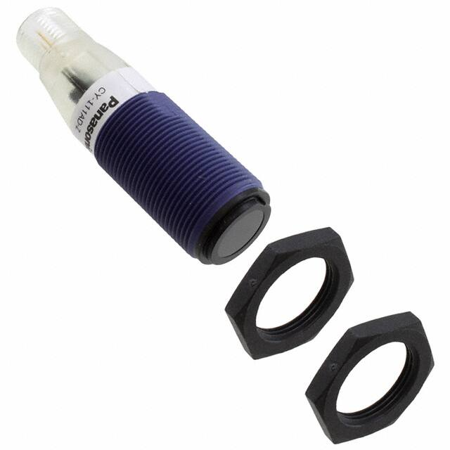

Cylindrical Photoelectric Sensor CY-100 SERIES Conforming to EMC Directive Listing (2 m cable length type only) Features • Wide product range Shape: Standard type Side view type Connector: 2 m cable length type M12 plug-in connector type • Diffuse reflective type sensor with sensitivity adjuster is available. • M18 thread size for convenient mounting • Strong resistance IP67 • Convenient universal sensor mounting stand is available. ORDER GUIDE 2 m cable length type Appearance Sensing range With polarizing (Note 2.3) filters 4m 13.12 ft 2m 6.56 ft 100 mm 0.33 ft With sensitivity adjuster Retroreflective 15 m 49.21 ft 600 mm 1.97 ft With polarizing (Note 2.3) filters 15 m 49.21 ft 4m 13.12 ft 2m 6.56 ft 100 mm 3.94 in With sensitivity adjuster Retroreflective Diffuse reflective Side view Thrubeam Diffuse reflective Standard Thrubeam Type 600 mm 23.62 in Model No. (Note 1) NPN output PNP output Output operation CY-111A CY-111A-P Light-ON CY-111B CY-111B-P Dark-ON CY-192A-Y CY-192A-P-Y Light-ON CY-192B-Y CY-192B-P-Y Dark-ON CY-191A-Y CY-191A-P-Y Light-ON CY-191B-Y CY-191B-P-Y Dark-ON CY-121A CY-121A-P Light-ON CY-121B CY-121B-P Dark-ON CY-122A CY-122A-P Light-ON CY-122B CY-122B-P Dark-ON CY-111VA CY-111VA-P Light-ON CY-111VB CY-111VB-P Dark-ON CY-192VA-Y CY-192VA-P-Y Light-ON CY-192VB-Y CY-192VB-P-Y Dark-ON CY-191VA-Y CY-191VA-P-Y Light-ON CY-191VB-Y CY-191VB-P-Y Dark-ON CY-121VA CY-121VA-P Light-ON CY-121VB CY-121VB-P Dark-ON CY-122VA CY-122VA-P Light-ON CY-122VB CY-122VB-P Dark-ON Notes: 1) The model No. with “E” shown on the label affixed to the thru-beam type sensor is the emitter, “D” shown on the label is the receiver. (e.g.) Emitter of CY-111A: CY-111E, Receiver of CY-111A: CY-111AD 2) The reflector is sold separately. 3) The sensing range of the retroreflective type sensor is specified for the RF-420 reflector (optional). M12 plug-in connector type M12 plug-in connector type is also available. When ordering this type, “-Z” for the M12 plug-in connector type to the model No. (e.g.) M12 plug-in connector type of CY-111A-P is “CY-111A-P-Z”. In case of the retroreflective type, M12 plug-in connector type of CY-19□-P-Y is “CY-19□-P-Z-Y”. 1 • Standard type • Side view type Cylindrical Photoelectric Sensor CY-100 SERIES ORDER GUIDE Mating cable (2 cables are required for the thru-beam type.) For M12 plug-in connector type Type Straight Elbow Model No. Mating cable • Straight type Description CN-24C-C2 Length: 2 m 6.56 ft CN-24C-C5 Length: 5 m 16.40 ft CN-24CL-C2 Length: 2 m 6.56 ft CN-24CL-C5 Length: 5 m 16.40 ft • Elbow type Clamping ring : ø14mm 0.55 in Cable outer : ø5.3mm 0.21 in OPTIONS Designation Sensor mounting bracket Universal sensor mounting stand Reflector Reflective tape Model No. MS-CY1-1 Material: Stainless steel MS-CY1-2 Material: Plastic, For beam axis alignment MS-AJ3 It can adjust the height of the sensor and reflector RF-420. (The thru-beam type sensor needs two brackets.) RF-420 50 × 50 mm 1.97 × 1.97 in RF-410 24 × 21 mm 0.94 × 0.83 in RF-40RL5 22 mm × 5 m 0.87 × 196.85 in, Thickness: 0.4 mm 0.02 in Universal sensor mounting stand Sensor mounting bracket Description • MS-CY1-1 Reflective tape Reflector • RF-410 • RF-420 • MS-AJ3 • MS-CY1-2 • RF-40RL5 WIRING DIAGRAMS Wiring diagram Emitter of thru-beam type Receiver of thru-beam / Reflective type NPN output type %URZQ 9    9LROHW ,QSXW ± WR9'&“%  %OXH 9 %URZQ 9  /RDG  %ODFN 2XWSXW  ± WR9'&“%  %OXH 9 Receiver of thru-beam / Reflective type Connector pin position M12 connector PNP output type %URZQ 9  %ODFN 2XWSXW  /RDG  %OXH 9  ± WR9'&“% 4 3 1 2 1 : +V 2 : Input (Only emitter of thru-beam type) 3:0V 4:O  utput (Only receiver of thru-beam type and reflective type) 2 Cylindrical Photoelectric Sensor CY-100 SERIES SPECIFICATIONS Thru-beam Retroreflective Type With polarizing filters Model No. Standard Item Diffuse reflective Side view Standard Side view Standard Side view With sensitivity adjuster Standard Side view Standard Side view Light-ON CY-111A□ CY-111VA□ CY-192A□ CY-192VA□ CY-191A□ CY-191VA□ CY-121A□ CY-121VA□ CY-122A□ CY-122VA□ Dark-ON CY-111B□ CY-111VB□ CY-192B□ CY-192VB□ CY-191B□ CY-191VB□ CY-121B□ CY-121VB□ CY-122B□ CY-122VB□ Sensing range 15 m 49.21 ft 4 m 13.12 ft (Note 2) Sensing object ø18 mm ø0.71 in or more opaque object (Setting distance between emitter and receiver: 15 m 49.21ft) ø50 mm ø1.97 in or more opaque, translucent or transparent object (Note 2, 4) 100 mm 3.94 in (Note 3) 2 m 6.56 ft (Note 2) ø50 mm ø1.97 in or more opaque, translucent, transparent or specular object (Note 2, 4) Opaque, translucent or transparent object (Note 4) – Hysteresis Supply voltage 600 mm 23.62 in (Note 3) 3 to 15 % of operation distance (Note 3) 12 to 24 V DC ±10 % Ripple P-P 10 % or less Current consumption Emitter: 35 mA or less Receiver: 35 mA or less Output NPN open-collector transistor PNP open-collector transistor • Maximum sink current: 100 mA • Maximum source current: 100 mA • Applied voltage: 24 V DC or less (between output and 0 V) • Applied voltage: 24 V DC or less (between output and +V) • Residual voltage: 1.5 V or less • Residual voltage: 1.5 V or less 35 mA or less Utilization category DC-12 or DC-13 Short-circuit protection Incorporated Response time Test input (emission halt) function Operation indicator Power indicator 1 ms or less – Incorporated Yellow LED (lights up when the output is ON) (incorporated on the receiver for thru-beam type) Green LED (lights up when the power is ON) (incorporated on the emitter) – Environmental resistance Pollution degree 3 (Industrial environment) Protection Ambient temperature IP67 (IEC) –25 to +55 °C –13 to +131 °F (No dew condensation or icing allowed), Storage: –40 to +70 °C –22 to +158 °F Ambient humidity 50 % RH (at +70 °C +158 °F) Ambient illuminance Incandescent light: 5,000 ℓx at the light-receiving face EMC EN 60947-5-2 Voltage withstandability 500 V AC for one min. between all supply terminals connected together and enclosure Vibration resistance 10 to 55 Hz frequency, 0.5 mm 0.02 in amplitude in X, Y and Z directions for 1.5 hours each 294 m/s2 acceleration (30 G approx.) in X, Y and Z directions for three times each Shock resistance Emitting element Peak emission wavelength Infrared LED (modulated) 890 nm 0.04 mil 875 nm 0.03 mil Material Cable extension 875 nm 0.03 mil 0.44 mm2 3-core cabtyre cable, 2 m 6.56 ft long Extension up to total 10 m 32.81 ft is possible with 0.34 mm2, or more, cable (thru-beam type: both emitter and receiver). Emitter/ Emitter/ Receiver: 65 g Receiver: 70 g approx. approx. 65 g approx. 70 g approx. 65 g approx. 70 g approx. 65 g approx. 70 g approx. 75 g approx. Emitter/ Emitter/ M12 plug-in connector type Receiver: 15 g Receiver: 20 g approx. approx. 15 g approx. 20 g approx. 15 g approx. 20 g approx. 15 g approx. 20 g approx. 25 g approx. 2 m cable length type Accessories Infrared LED (modulated) 665 nm 0.03 mil Enclosure: PBT, Lens: PMMA Cable (except for M12 plug-in connection type) Net weight (Note 5) Red LED (modulated) Nut: 4 pcs. Nut: 2 pcs. Notes: 1) Where measurement conditions have not been specified precisely, the conditions used were an ambient temperature of +23 °C +73.4 °F. 2) The sensing range and the sensing object of the retroreflective type sensor are specified for the RF-420 reflector (optional). 3) The sensing range and the hysteresis of the diffuse reflective type sensor are specified for white non-glossy paper (200 × 200 mm 7.87 × 7.87 in) as the object. 4) Make sure to confirm detection with an actual sensor before use for detection of the transparent object and the translucent object. 5) The weight includes the weight of nuts. 3 CY-100 SERIES Cylindrical Photoelectric Sensor DETECTION CURVES Thru-beam type in cm in cm 0.55 1,4 0.39 1 ø 0.49 in 5.91 15 ø 12 mm 10 15 0.39 0.59 -5.91 -15 49.21 ft 15 m A A=Sensing range Diffuse reflective type with adjustable sensitivity Diffuse reflective m 1.97 5 -0.39 -1 -0.55 -1,4 1,4 1 in 0,59 15 cm 2 3.94 in A 10 cm in cm 0.55 1.4 0.39 1 -0.39 -1 -0.55 -1.4 in 2.62 80 cm 23.62 in A 60 cm 1 Object 10 × 10 cm; 1 White 90%; 2 Grey 18% Retroreflective type with polarizing filters Retroreflective type ø of beam in cm 3.94 10 1.57 4 -1.57 -4 -3.94 -10 2 0.79 4 1.57 13.12 ft A 4m With reflector RF-420 m E/R in cm 2.36 6 1.57 4 0.79 2 -0.79 -2 -1.57 -4 -2.36 -6 0,2 0.79 A 2 1.18 3 0.39 m 6.56 ft 2m With reflector RF-420 10 cm -1 -1,4 PRECAUTIONS FOR PROPER USE • Never use this product as a sensing device for personnel protection. • In case of using sensing devices for personnel protection, use products which meet laws and standards, such as OSHA, ANSI or IEC etc., for personnel protection applicable in each region or country. Mounting • The tightening torque should be 3 N·m or less. • Use a cable with connector CN-24C(L)-C□ (optional) for M12 connector type. Tightening torque for connector part is 2 N·m or less. %RG\ 1XW 0RXQWLQJSODWH &DEOHZLWKFRQQHFWRU 1XW Mounting drawing with sensor or reflector RF-420 Wiring • Make sure that the power supply is off while wiring. • Verify that the supply voltage variation is within the rating. • If power is supplied from a commercial switching regulator, ensure that the frame ground (F.G.) terminal of the power supply is connected to an actual ground. • Ensure that an isolation transformer is utilized for the DC power supply. If an autotransformer is utilized, the main body or power supply may be damaged. • If the used power supply generates a surge, connect a surge absorber to the power supply to absorb the surge. • Do not use during the initial transient time (0.5 sec) after the power supply is switched on. • In case noise generating equipment (switching regulator, inverter motor, etc.) is used in the vicinity of this product, connect the frame ground (F.G.) terminal of the equipment to an actual ground. • Do not run the wires together with high-voltage lines or power lines or put them in the same raceway. This can cause malfunction due to induction. • Damage or burnout may result in case of short circuit of load or miswiring. • Make a cable length as short as possible to lessen noise pickup. Others • Our products have been developed / produced for industrial use only. • Take care that the sensor is not directly exposed to fluorescent lamp from a rapid-starter lamp or a high frequency lighting device, as it may affect the sensing performance. • Avoid using a product where there is excessive vapor, dust or corrosive gas, or in a place where it could be exposed directly to water or chemicals. • Take care that the sensor does not come in direct contact with water, oil, grease or organic solvents, such as, thinner, etc. • Do not use in an environment containing infammable or explosive gases. • Never disassemble or modify the product. 4 Cylindrical Photoelectric Sensor CY-100 SERIES DIMENSIONS (Unit: mm in) CY-1□ Sensor M18 2 m cable length type (mm in) b a M12 plug-in connector type (mm in) a b a b Standard type CY-111□/121□/192□ 46 1.81 28 1.10 60 2.36 28 1.10 Standard type CY-191□ 48 1.89 28 1.10 62 2.44 28 1.10 Side view type CY-111V□/121V□/191V□/192V□ 62 2.44 28 1.10 76 2.99 28 1.10 Standard type CY-122□ 62 2.44 44 1.73 76 2.99 44 1.73 Side view type CY-122V□ 78 3.07 44 1.73 92 3.62 44 1.73 CN-24C-C2 CN-24C-C5 ¡ ¡ CN-24CL-C2 CN-24CL-C5 Mating cable Mating cable 27 1.06 ø14 ø0.55 0× BK 3 BN / ¡ ¡ MS-CY1-2 Sensing mounting bracket 45 1.77 25 0.98 = 24 0.94 8 0.32 = = 6.5 0.26 27 1.06 = 8 0.32 = 10 0.39 55 2.17 5 0.20 1 0.04 6.5 0.26 15 0.59 20 0.79 19.5 0.77 6.5 0.26 MS-AJ3 Universal sensor mounting stand 53 2.09 ø6.5 ø0.26 36 1.42 12 0.47 19 0.75 M12 19 0.75 132 5.20 19 0.75 40 1.57 126 4.96 55 2.17 40 1.57 1.9 0.07 22.9 0.90 67 2.64 40 1.57 33 1.30 M4 76.5 3.01 5 5.7 0.22 3. Support for M12 rod 50 1.97 36 1.42 2. M12 rod 23 0.91 1. Ball-joint mounted fixing bracket CY-100 series or RF-420 ø18.5 ø0.73 BN ø18.2 ø0.72 20 0.79 = 16.5 0.65 28 1.10 1 2 Sensing mounting bracket 10 0.39 ø18.2 ø0.72 35 1.38 50 1.97 4 WH ø10 ø0.39 L = 2 or 5 m 6.56 or 16.40 ft 2.5 0.10 BK 3 1 2 MS-CY1-1 BU 4 WH L = 2 or 5 m 6.56 or 16.40 ft Connector pin position 38 1.50 BU M12 × 1 L   Connector pin position DIMENSIONS (Unit: mm in) 3.5 8 0.14 0.32 51.5 2.03 8 0.32 ø4.5 ø0.18 Reflector 9 0.35 ø7.5 ø0.30 4 0.16 7.5 0.30 24 0.94 = = 29 1.14 33 1.30 60 2.36 2 - ø4.5 ø0.18 47 1.85 69 2.72 51 2.01 35 1.38 2 - ø5.5 ø0.22 RF-410 21 0.83 Reflector 4 - R5 R0.20 45 1.77 RF-420 ø4.5 ø0.18 6

物料型号: - 标准型号:CY-111/121/192 - 侧视型号:CY-111Va/121Va/191V/192Va - 特定型号:CY-191
器件简介: - CY-100系列是圆柱形光电传感器,内置放大器,具有广泛的产品范围,包括标准型、侧视型和M12插头型。 - 提供漫反射型传感器,具有灵敏度调节器,以及M18螺纹方便安装。
引脚分配: - 发射端(直通型):棕色(+V),紫色(输入),蓝色(0V) - 接收端(PNP输出型):棕色(+V),黑色(输出至负载),蓝色(V) - 接收端(NPN输出型):黑色(输出),蓝色(0V)
参数特性: - 感应范围:从100mm到15m不等,具体取决于型号。 - 输出类型:NPN或PNP开集电极晶体管。 - 响应时间:1ms或更少。 - 电源电压:12到24V DC ±10%。 - 工作指示:黄LED(输出ON时亮起)。 - 电源指示:绿LED(电源ON时亮起)。
功能详解: - 提供了不同类型的传感器选项,包括内置放大器和电源分离型。 - 漫反射型传感器具有可调节的灵敏度。 - 直通型和反射型传感器具有不同的感应范围和对象。
应用信息: - 适用于工业用途,不适用于人员保护。 - 安装时扭矩应控制在3N·m或更少。 - 避免在有水、油、灰尘或腐蚀性气体的环境中使用。
封装信息: - 提供了详细的尺寸信息,包括标准型和侧视型传感器的尺寸。 - 还提供了M12插头型传感器的尺寸信息。
