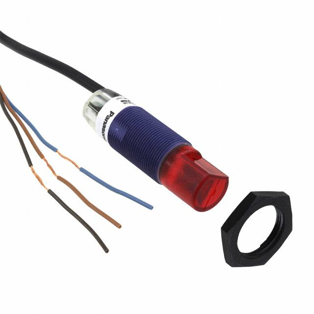

273 Cylindrical Photoelectric Sensor CY-100 SERIES FIBER SENSORS Related Information Amplifier Built-in ■■General terms and conditions.............. F-3 ■■Selection guide.............................. P.231~ ■■General precautions.................... P.1552~   Glossary of terms........................ P.1549~ LASER SENSORS PHOTOELECTRIC SENSORS Listing (2 m cable length type only) MICRO PHOTOELECTRIC SENSORS FEATURES AREA SENSORS • Wide product range Shape: Standard type Side view type Connector: 2 m (6.562 ft) cable length type M12 plug-in connector type • Diffuse reflective type sensor with sensitivity adjuster is available. • M18 thread size for convenient mounting • Strong resistance IP67 • Convenient universal sensor mounting stand is available. SAFETY LIGHT CURTAINS / SAFETY COMPONENTS PRESSURE / FLOW SENSORS INDUCTIVE PROXIMITY SENSORS PARTICULAR USE SENSORS SENSOR OPTIONS panasonic.net/id/pidsx/global SIMPLE WIRE-SAVING UNITS WIRE-SAVING SYSTEMS 2 m cable length type Type FA COMPONENTS MACHINE VISION SYSTEMS CY-100 EX-10 With polarizing (Note 2,3) filters 4m 13.123 ft 2m 6.562 ft 600 mm 23.622 in 15 m 49.213 ft With polarizing (Note 2,3) filters Side view 4m 13.123 ft 2m 6.562 ft 100 mm 3.937 in With sensitivity adjuster CX-400 Diffuse reflective EX-Z 15 m 49.213 ft Thrubeam UV CURING SYSTEMS Selection Guide Amplifier Built-in Power Supply Built-in Amplifierseparated Sensing range 100 mm 3.937 in With sensitivity adjuster Diffuse reflective ENERGY MANAGEMENT SOLUTIONS Standard PLC HUMAN MACHINE INTERFACES Appearance Thrubeam LASER MARKERS Retroreflective STATIC CONTROL DEVICES ORDER GUIDE Retroreflective MEASUREMENT SENSORS 600 mm 23.622 in Model No. (Note 1) NPN output PNP output Output operation CY-111A CY-111A-P Light-ON CY-111B CY-111B-P Dark-ON CY-192A-Y CY-192A-P-Y Light-ON CY-192B-Y CY-192B-P-Y Dark-ON CY-191A-Y CY-191A-P-Y Light-ON CY-191B-Y CY-191B-P-Y Dark-ON CY-121A CY-121A-P Light-ON CY-121B CY-121B-P Dark-ON CY-122A CY-122A-P Light-ON CY-122B CY-122B-P Dark-ON CY-111VA CY-111VA-P Light-ON CY-111VB CY-111VB-P Dark-ON CY-192VA-Y CY-192VA-P-Y Light-ON CY-192VB-Y CY-192VB-P-Y Dark-ON CY-191VA-Y CY-191VA-P-Y Light-ON CY-191VB-Y CY-191VB-P-Y Dark-ON CY-121VA CY-121VA-P Light-ON CY-121VB CY-121VB-P Dark-ON CY-122VA CY-122VA-P Light-ON CY-122VB CY-122VB-P Dark-ON Notes: 1) The model No. with “E” shown on the label affixed to the thru-beam type sensor is the emitter, “D” shown on the label is the receiver. (e.g.) 2) The reflector is sold separately. 3) The sensing range of the retroreflective type sensor is specified for the RF-420 reflector (optional). EX-20 EX-30 M12 plug-in connector type EX-40 M12 plug-in connector type is also available. When ordering this type, suffix “-Z” for the M12 plug-in connector type to the model No. (e.g.) M12 plug-in connector type of CY-111A-P is “CY-111A-P-Z”. In case of the retroreflective type, M12 plug-in connector type of CY-19□-P-Y is “CY-19□-P-Z-Y”. CX-440 EQ-30 EQ-500 MQ-W RX-LS200 RX RT-610 • Standard type • Side view type Cylindrical Photoelectric Sensor CY-100 SERIES ORDER GUIDE FIBER SENSORS For M12 plug-in connector type Straight Elbow Model No. • Straight type Description CN-24C-C2 Length: 2 m 6.562 ft CN-24C-C5 Length: 5 m 16.404 ft CN-24CL-C2 Length: 2 m 6.562 ft CN-24CL-C5 Length: 5 m 16.404 ft LASER SENSORS Mating cable Mating cable (2 cables are required for the thru-beam type.) Type • Elbow type Sensor mounting bracket Universal sensor mounting stand Reflector Reflective tape PHOTOELECTRIC SENSORS MICRO PHOTOELECTRIC SENSORS Clamping ring : ø14mm 0.551 in AREA SENSORS Cable outer : ø5.3mm 0.209 in SAFETY LIGHT CURTAINS / SAFETY COMPONENTS PRESSURE / FLOW SENSORS OPTIONS Designation 274 INDUCTIVE PROXIMITY SENSORS Model No. Description MS-CY1-1 Material: Stainless steel MS-CY1-2 Material: Plastic, For beam axis alignment MS-AJ3 It can adjust the height of the sensor and reflector RF-420. (The thru-beam type sensor needs two brackets.) RF-420 50 × 50 mm 1.969 × 1.969 in RF-410 24 × 21 mm 0.945 × 0.827 in RF-40RL5 22 mm × 5 m 0.866 × 196.850 in, Thickness: 0.4 mm 0.016 in Universal sensor mounting stand • MS-AJ3 PARTICULAR USE SENSORS • MS-CY1-1 SENSOR OPTIONS • MS-CY1-2 SIMPLE WIRE-SAVING UNITS WIRE-SAVING SYSTEMS MEASUREMENT SENSORS STATIC CONTROL DEVICES LASER MARKERS Reflective tape Reflector • RF-410 • RF-420 Sensor mounting bracket PLC • RF-40RL5 HUMAN MACHINE INTERFACES ENERGY MANAGEMENT SOLUTIONS FA COMPONENTS MACHINE VISION SYSTEMS UV CURING SYSTEMS WIRING DIAGRAMS Selection Guide Wiring diagram Amplifier Built-in Emitter of thru-beam type Receiver of thru-beam / Reflective type NPN output type %URZQ 9    9LROHW ,QSXW ± WR9'&“% Power Supply Built-in Amplifierseparated (Brown) +V 1 Load 4 (Black) Output + – EX-Z 12 to 24 V DC ±10 % CX-400 CY-100  %OXH 9 3 (Blue) 0 V EX-10 EX-20 Receiver of thru-beam / Reflective type Connector pin position M12 connector PNP output type %URZQ 9  %ODFN 2XWSXW  /RDG  %OXH 9 4  ± WR9'&“% 1 3 2 1 : +V 2 : Input (Only emitter of thru-beam type) 3:0V 4 : Output (Only receiver of thru-beam type and reflective type) EX-30 EX-40 CX-440 EQ-30 EQ-500 MQ-W RX-LS200 RX RT-610 275 Cylindrical Photoelectric Sensor SPECIFICATIONS FIBER SENSORS LASER SENSORS Thru-beam PHOTOELECTRIC SENSORS Standard Model No. 15 m 49.213 ft Sensing object ø18 mm ø0.709 in or more opaque object (Setting distance between emitter and receiver: 15 m 49.213ft) PLC HUMAN MACHINE INTERFACES ENERGY MANAGEMENT SOLUTIONS Selection Guide Amplifier Built-in Power Supply Built-in Amplifierseparated EX-Z CX-400 CY-100 EX-20 EX-30 CX-440 EQ-30 EQ-500 MQ-W RX-LS200 RX RT-610 Side view Opaque, translucent or transparent object (Note 4) 35 mA or less Incorporated Response time Operation indicator Power indicator 1 ms or less – Incorporated Yellow LED (lights up when the output is ON) (incorporated on the receiver for thru-beam type) Green LED (lights up when the power is ON) (incorporated on the emitter) – Pollution degree 3 (Industrial environment) Protection Ambient temperature IP67 (IEC) –25 to +55 °C –13 to +131 °F (No dew condensation or icing allowed), Storage: –40 to +70 °C –22 to +158 °F Ambient humidity 50 % RH (at +70 °C +158 °F) Ambient illuminance Incandescent light: 5,000 ℓx or less at the light-receiving face Voltage withstandability Vibration resistance 500 V AC for one min. between all supply terminals connected together and enclosure 10 to 55 Hz frequency, 0.5 mm 0.020 in double amplitude in X, Y and Z directions for 1.5 hours each 294 m/s2 acceleration (30 G approx.) in X, Y and Z directions three times each Shock resistance Emitting element Peak emission wavelength PNP open-collector transistor • Maximum source current: 100 mA • Applied voltage: 24 V DC or less (between output and +V) • Residual voltage: 1.5 V or less DC-12 or DC-13 Short-circuit protection Test input (emission halt) function 600 mm 23.622 in (Note 3) 12 to 24 V DC ±10 % Ripple P-P 10 % or less Utilization category Infrared LED (modulated) 890 nm 0.035 mil 875 nm 0.034 mil Material Red LED (modulated) Infrared LED (modulated) 665 nm 0.026 mil 875 nm 0.034 mil Enclosure: PBT, Lens: PMMA Cable (except for M12 plug-in connection type) Cable extension 0.44 mm2 3-core cabtyre cable, 2 m 6.562 ft long Extension up to total 10 m 32.808 ft is possible with 0.34 mm2, or more, cable (thru-beam type: both emitter and receiver). Emitter/ Emitter/ Receiver: 65 g Receiver: 70 g approx. approx. 65 g approx. 70 g approx. 65 g approx. 70 g approx. 65 g approx. 70 g approx. 75 g approx. Emitter/ Emitter/ M12 plug-in connector type Receiver: 15 g Receiver: 20 g approx. approx. 15 g approx. 20 g approx. 15 g approx. 20 g approx. 15 g approx. 20 g approx. 25 g approx. 2 m cable length type Accessories Standard 3 to 15 % of operation distance (Note 3) Output EX-40 Side view 100 mm 3.937 in (Note 3) – NPN open-collector transistor • Maximum sink current: 100 mA • Applied voltage: 24 V DC or less (between output and 0 V) • Residual voltage: 1.5 V or less Net weight (Note 5) Standard ø50 mm ø1.969 in or more opaque, translucent, transparent or specular object (Note 2, 4) Current consumption EX-10 Side view 2 m 6.562 ft (Note 2) Emitter: 35 mA or less Receiver: 35 mA or less Environmental resistance UV CURING SYSTEMS ø50 mm ø1.969 in or more opaque, translucent or transparent object (Note 2, 4) Supply voltage FA COMPONENTS MACHINE VISION SYSTEMS 4 m 13.123 ft (Note 2) Hysteresis STATIC CONTROL DEVICES LASER MARKERS Standard EMC Directive, RoHS Directive Sensing range WIRE-SAVING SYSTEMS MEASUREMENT SENSORS Side view CY-111B□ CY-111VB□ CY-192B□ CY-192VB□ CY-191B□ CY-191VB□ CY-121B□ CY-121VB□ CY-122B□ CY-122VB□ SAFETY LIGHT CURTAINS / SAFETY COMPONENTS SIMPLE WIRE-SAVING UNITS Standard Dark-ON CE marking directive compliance SENSOR OPTIONS Side view With sensitivity adjuster CY-111A□ CY-111VA□ CY-192A□ CY-192VA□ CY-191A□ CY-191VA□ CY-121A□ CY-121VA□ CY-122A□ CY-122VA□ Item PARTICULAR USE SENSORS Diffuse reflective With polarizing filters Light-ON AREA SENSORS INDUCTIVE PROXIMITY SENSORS Retroreflective Type MICRO PHOTOELECTRIC SENSORS PRESSURE / FLOW SENSORS CY-100 SERIES Nut: 4 pcs. Nut: 2 pcs. Notes: 1) Where measurement conditions have not been specified precisely, the conditions used were an ambient temperature of +23 °C +73.4 °F. 2) The sensing range and the sensing object of the retroreflective type sensor are specified for the RF-420 reflector (optional). 3) The sensing range and the hysteresis of the diffuse reflective type sensor are specified for white non-glossy paper (200 × 200 mm 7.874 × 7.874 in) as the object. 4) Make sure to confirm detection with an actual sensor before use for detection of the transparent object and the translucent object. 5) The weight includes the weight of nuts. Cylindrical Photoelectric Sensor CY-100 SERIES 276 DETECTION CURVES Thru-beam type in -5.906 -15 in cm 0.551 1.4 0.394 1 ø 0.472 in ø 12 mm 10 15 32.808 ft 49.213 ft 49.213 ft 15 m A A=Sensing range Diffuse reflective type with adjustable sensitivity Diffuse reflective cm 5.906 15 FIBER SENSORS m 1.969 5 -0.394 -1 -0.551 -1.4 3.937 in A 10 cm in 5.906 15 cm in 31.496 1.575 4 80 cm -1.575 -4 -0.394 -1 -0.551 -1.4 A 23.622 in 60 cm Object 10 × 10 cm; 1 White 90%; 2 Grey 18% • Never use this product as a sensing device for personnel protection. • In case of using sensing devices for personnel protection, use products which meet laws and standards, such as OSHA, ANSI or IEC etc., for personnel protection applicable in each region or country. Mounting • The tightening torque should be 3 N·m or less. • Use a cable with connector CN-24C(L)-C□ (optional) for M12 connector type. Tightening torque for connector part is 2 N·m or less. %RG\ 1XW 0RXQWLQJSODWH &DEOHZLWKFRQQHFWRU 1XW Mounting drawing with sensor or reflector RF-420 4 2 13.123 ft 6.562 ft -3.937 -10 A 13.123 ft 4m With reflector RF-420 PRECAUTIONS FOR PROPER USE PHOTOELECTRIC SENSORS ø of beam in cm 2.362 6 1.575 4 0.787 2 E/R in cm 3.937 10 in cm 0.551 1.4 0.394 1 LASER SENSORS Retroreflective type with polarizing filters Retroreflective type m -0.787 -2 -1.575 -4 -2.362 -6 MICRO PHOTOELECTRIC SENSORS 2 3 0.2 0.656 ft 6.562 ft 9.843 ft A m 6.562 ft 2m With reflector RF-420 Refer to p.1552~ for general precautions. Wiring • Make sure that the power supply is off while wiring. • Verify that the supply voltage variation is within the rating. • If power is supplied from a commercial switching regulator, ensure that the frame ground (F.G.) terminal of the power supply is connected to an actual ground. • Ensure that an isolation transformer is utilized for the DC power supply. If an autotransformer is utilized, the main body or power supply may be damaged. • If the used power supply generates a surge, connect a surge absorber to the power supply to absorb the surge. • Do not use during the initial transient time (0.5 sec) after the power supply is switched on. • In case noise generating equipment (switching regulator, inverter motor, etc.) is used in the vicinity of this product, connect the frame ground (F.G.) terminal of the equipment to an actual ground. • Do not run the wires together with high-voltage lines or power lines or put them in the same raceway. This can cause malfunction due to induction. • Damage or burnout may result in case of short circuit of load or miswiring. • Make a cable length as short as possible to lessen noise pickup. AREA SENSORS SAFETY LIGHT CURTAINS / SAFETY COMPONENTS PRESSURE / FLOW SENSORS INDUCTIVE PROXIMITY SENSORS PARTICULAR USE SENSORS SENSOR OPTIONS SIMPLE WIRE-SAVING UNITS WIRE-SAVING SYSTEMS MEASUREMENT SENSORS STATIC CONTROL DEVICES LASER MARKERS PLC HUMAN MACHINE INTERFACES ENERGY MANAGEMENT SOLUTIONS FA COMPONENTS MACHINE VISION SYSTEMS UV CURING SYSTEMS Others • This device has been developed / produced for industrial use only. • Take care that the sensor is not directly exposed to fluorescent lamp from a rapid-starter lamp or a high frequency lighting device, as it may affect the sensing performance. • Avoid using a product where there is excessive vapor, dust or corrosive gas, or in a place where it could be exposed directly to water or chemicals. • Take care that the sensor does not come in direct contact with water, oil, grease or organic solvents, such as, thinner, etc. • Do not use in an environment containing infammable or explosive gases. • Never disassemble or modify the product. Selection Guide Amplifier Built-in Power Supply Built-in Amplifierseparated EX-Z CX-400 CY-100 EX-10 EX-20 EX-30 EX-40 CX-440 EQ-30 EQ-500 MQ-W RX-LS200 RX RT-610 277 FIBER SENSORS LASER SENSORS Cylindrical Photoelectric Sensor CY-100 SERIES DIMENSIONS (Unit: mm in) CY-1□ Sensor PHOTOELECTRIC SENSORS M18 MICRO PHOTOELECTRIC SENSORS b a AREA SENSORS SAFETY LIGHT CURTAINS / SAFETY COMPONENTS PRESSURE / FLOW SENSORS 2 m cable length type (mm in) M12 plug-in connector type (mm in) a b a b Standard type CY-111□/121□/192□ 46 1.811 28 1.102 60 2.362 28 1.102 Standard type CY-191□ 48 1.890 28 1.102 62 2.441 28 1.102 Side view type CY-111V□/121V□/191V□/192V□ 62 2.441 28 1.102 76 2.992 28 1.102 Standard type CY-122□ 62 2.441 44 1.732 76 2.992 44 1.732 Side view type CY-122V□ 78 3.071 44 1.732 92 3.622 44 1.732 INDUCTIVE PROXIMITY SENSORS CN-24C-C2 CN-24C-C5 CN-24CL-C2 CN-24CL-C5 Mating cable ¡ ¡ 0î SENSOR OPTIONS 27 1.063 ø14 ø0.551 SIMPLE WIRE-SAVING UNITS WIRE-SAVING SYSTEMS Connector pin position STATIC CONTROL DEVICES BU / ¡ ¡ MS-CY1-1 MS-CY1-2 Sensing mounting bracket 2.5 0.098 ø18.2 ø0.717 35 1.378 = 15 0.591 Amplifierseparated 55 2.165 8 0.315 24 0.945 8 0.315 = = = 10 0.394 = 6.5 0.256 Selection Guide Power Supply Built-in ø18.2 ø0.717 25 0.984 = 1 0.039 Amplifier Built-in 45 1.772 27 1.063 28 1.102 6.5 0.256 BN 20 0.787 19.5 0.768 UV CURING SYSTEMS 50 1.969 1 2 Sensing mounting bracket 10 0.394 6.5 0.256 MACHINE VISION SYSTEMS BK 4 WH ø10 ø0.394 L = 2 or 5 m 6.562 or 16.404 ft 5 0.197 FA COMPONENTS BN 20 0.787 ENERGY MANAGEMENT SOLUTIONS BU 3 1 2 WH L = 2 or 5 m 6.562 or 16.404 ft Connector pin position 4 16.5 0.650 HUMAN MACHINE INTERFACES BK 3 LASER MARKERS M12 × 1 L   MEASUREMENT SENSORS PLC Mating cable 38 1.496 PARTICULAR USE SENSORS EX-Z EX-30 ø18.5 ø0.728 36 1.417 5.7 0.224 M4 3. Support for M12 rod 22.9 0.902 40 1.575 RX RT-610 76.5 3.012 19 0.748 132 5.197 55 2.165 126 4.961 19 0.748 M12 19 0.748 RX-LS200 40 1.575 MQ-W 50 1.969 EQ-500 40 1.575 EQ-30 33 1.299 CX-440 67 2.634 EX-40 53 2.087 ø6.5 ø0.256 36 1.417 EX-20 Universal sensor mounting stand 2. M12 rod 1.9 0.075 EX-10 MS-AJ3 1. Ball-joint mounted fixing bracket CY-100 series or RF-420 23 0.906 CY-100 12 0.472 CX-400 Cylindrical Photoelectric Sensor CY-100 SERIES DIMENSIONS (Unit: mm in) FIBER SENSORS 8 51.5 0.315 2.028 60 2.362 47 1.850 69 2.717 51 2.008 3.5 2 - ø4.5 ø0.177 ø4.5 ø0.177 Reflector 9 0.354 4 0.157 7.5 0.295 24 0.945 = = 29 1.142 LASER SENSORS PHOTOELECTRIC SENSORS ø7.5 ø0.295 MICRO PHOTOELECTRIC SENSORS 33 1.299 4 - R5 R0.197 35 1.378 2 - ø5.5 ø0.217 RF-410 21 0.827 Reflector 45 1.772 RF-420 8 0.138 0.315 278 ø4.5 ø0.177 AREA SENSORS SAFETY LIGHT CURTAINS / SAFETY COMPONENTS PRESSURE / FLOW SENSORS INDUCTIVE PROXIMITY SENSORS PARTICULAR USE SENSORS SENSOR OPTIONS SIMPLE WIRE-SAVING UNITS WIRE-SAVING SYSTEMS MEASUREMENT SENSORS STATIC CONTROL DEVICES LASER MARKERS PLC HUMAN MACHINE INTERFACES ENERGY MANAGEMENT SOLUTIONS FA COMPONENTS MACHINE VISION SYSTEMS UV CURING SYSTEMS Selection Guide Amplifier Built-in Power Supply Built-in Amplifierseparated EX-Z CX-400 CY-100 EX-10 EX-20 EX-30 EX-40 CX-440 EQ-30 EQ-500 MQ-W RX-LS200 RX RT-610
CY-121VA-P
物料型号: - 标准型号:CY-111/121/192 - 侧视型号:CY-111Va/121Va/191V/192Va - 特定型号:CY-191
器件简介: - CY-100系列是圆柱形光电传感器,内置放大器,具有广泛的产品范围,包括标准型、侧视型和M12插头型。 - 提供漫反射型传感器,具有灵敏度调节器,以及M18螺纹方便安装。
引脚分配: - 发射端(直通型):棕色(+V),紫色(输入),蓝色(0V) - 接收端(PNP输出型):棕色(+V),黑色(输出至负载),蓝色(V) - 接收端(NPN输出型):黑色(输出),蓝色(0V)
参数特性: - 感应范围:从100mm到15m不等,具体取决于型号。 - 输出类型:NPN或PNP开集电极晶体管。 - 响应时间:1ms或更少。 - 电源电压:12到24V DC ±10%。 - 工作指示:黄LED(输出ON时亮起)。 - 电源指示:绿LED(电源ON时亮起)。
功能详解: - 提供了不同类型的传感器选项,包括内置放大器和电源分离型。 - 漫反射型传感器具有可调节的灵敏度。 - 直通型和反射型传感器具有不同的感应范围和对象。
应用信息: - 适用于工业用途,不适用于人员保护。 - 安装时扭矩应控制在3N·m或更少。 - 避免在有水、油、灰尘或腐蚀性气体的环境中使用。
封装信息: - 提供了详细的尺寸信息,包括标准型和侧视型传感器的尺寸。 - 还提供了M12插头型传感器的尺寸信息。
