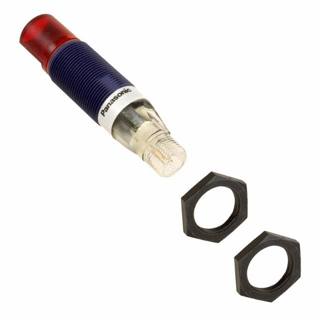

CY-121VA-Z
CY-121VA-Z
    NAIS(松下)
    SENSOR REFLECTIVE 100MM NPN OPEN
CY-121VA-Z 数据手册
