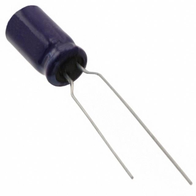

    1 µF 350 V 铝电解电容器 径向,Can 85°C 时为 2000 小时
ECA-2VM010 数据手册
Aluminum Electrolytic Capacitors (Radial Lead Type) Radial Lead Type Series : M Type : A Features ● Endurance : 85 °C 2000 h than series SU ● RoHS compliant ● Smaller Specifications Category temperature range –40 °C to + 85 °C –25 °C to +85 °C Rated voltage range 6.3 V.DC to 100 V.DC 160 V.DC to 450 V.DC Capacitance range 2.2 µF to 22000 µF 2.2 µF to 470 µF Capacitance tolerance ±20 % (120 Hz/+20 °C) I < 0.01 CV or 3 (µA) After 2 minutes (Whichever is greater) Leakage current Dissipation factor (tan d) I < 0.06 CV +10 (µA) After 2 minutes Please see the attached characteristics list After applying rated working voltage for 2000 hours at +85°C±2 °C, when the capacitors are restored to 20 °C, capacitors shall meet the following limits. Endurance Capacitance change Within ±20 % of the initial value < 150 % of the initial limit tan d DC leakage current Within the initial limit After storage for 1000 hours at +85 °C±2 °C with no voltage applied and then being stabilized at +20 °C, capacitors shall meet the limits specified in Endurance. (With voltage treatment) Shelf life Frequency correction factor for ripple current Frequency (Hz) 50, 60 120 1k 10 k to Correction factor 0.70 1.00 1.30 1.70 fd±0.05 Dimensions Sleeve Pressure relief 06.3 < < 08 010< + L✽ 14 min. 0D+0.5 3 min. F±0.5 – 0D+0.5 ✽ L < 16 : L±1.0 L > 20 : L±2.0 (Unit : mm) 0D 5 6.3 8 10 12.5 16 18 0d 0.5 0.5 0.6 0.6 0.6 0.8 0.8 F 2.0 2.5 3.5 5.0 5.0 7.5 7.5 Design and specifications are each subject to change without notice. Ask factory for the current technical specifications before purchase and/or use. Should a safety concern arise regarding this product, please be sure to contact us immediately. 05 Oct. 2016 Aluminum Electrolytic Capacitors (Radial Lead Type) Characteristics list Endurance : 85 °C 2000 h Case size (mm) Rated Cap. voltage (±20 %) (V.DC) (µF) 16 25 Min. Packaging Q'ty Lead space Lead dia. 0d Part No. Taping Taping Straight ✽B ✽i Straight Taping leads (pcs) (pcs) 5 11 0.5 2.0 5.0 2.5 ECA0JM221( ) 200 2000 470 6.3 11.2 380 0.28 0.5 2.5 5.0 2.5 ECA0JM471( ) 200 2000 8 11.5 580 0.28 0.6 3.5 5.0 ECA0JM102( ) 200 1000 2200 10 16 890 0.30 0.6 5.0 5.0 ECA0JM222( ) 200 500 3300 10 20 1020 0.32 0.6 5.0 5.0 ECA0JM332( ) 200 500 4700 12.5 20 1170 0.34 0.6 5.0 5.0 ECA0JM472( ) 200 500 6800 12.5 25 1270 0.38 0.6 5.0 5.0 ECA0JM682( ) 200 500 7.5 ECA0JM103( ) 100 250 ECA0JM153 100 10000 16 25 1450 0.46 0.8 7.5 15000 16 31.5 1700 0.56 0.8 7.5 22000 18 330 10 L Lead length (mm) 220 1000 6.3 0D Specification Ripple current tan d (120 Hz) (120 Hz) (+85 °C) (+20 °C) (mA r.m.s.) 240 0.28 6.3 ECA0JM223 35.5 1900 0.70 0.8 7.5 11.2 330 0.24 0.5 2.5 5.0 2.5 ECA1AM331( ) 50 200 2000 1000 10 12.5 630 0.24 0.6 5.0 5.0 ECA1AM102( ) 200 500 2200 10 20 920 0.26 0.6 5.0 5.0 ECA1AM222( ) 200 500 3300 12.5 20 1090 0.28 0.6 5.0 5.0 ECA1AM332( ) 200 500 4700 12.5 25 1200 0.30 0.6 5.0 5.0 ECA1AM472( ) 200 500 6800 16 25 1400 0.34 0.8 7.5 7.5 ECA1AM682( ) 100 250 10000 16 31.5 1600 0.42 0.8 7.5 ECA1AM103 100 15000 18 35.5 1850 0.52 0.8 7.5 ECA1AM153 50 10 5 11 30 0.20 0.5 2.0 5.0 2.5 ECA1CM100( ) 200 2000 22 5 11 75 0.20 0.5 2.0 5.0 2.5 ECA1CM220( ) 200 2000 33 5 11 110 0.20 0.5 2.0 5.0 2.5 ECA1CM330( ) 200 2000 47 5 11 130 0.20 0.5 2.0 5.0 2.5 ECA1CM470( ) 200 2000 100 5 11 180 0.20 0.5 2.0 5.0 2.5 ECA1CM101( ) 200 2000 220 6.3 11.2 280 0.20 0.5 2.5 5.0 2.5 ECA1CM221( ) 200 2000 470 8 11.5 440 0.20 0.6 3.5 5.0 ECA1CM471( ) 200 1000 1000 10 16 680 0.20 0.6 5.0 5.0 ECA1CM102( ) 200 500 2200 12.5 20 1000 0.22 0.6 5.0 5.0 ECA1CM222( ) 200 500 3300 12.5 25 1200 0.24 0.6 5.0 5.0 ECA1CM332( ) 200 500 4700 16 25 1360 0.26 0.8 7.5 7.5 ECA1CM472( ) 100 250 6800 16 31.5 1600 0.30 0.8 7.5 ECA1CM682 100 10000 18 35.5 1800 0.38 0.8 7.5 ECA1CM103 50 100 6.3 11.2 180 0.16 0.5 2.5 5.0 ECA1EM101( ) 200 2000 330 8 11.5 390 0.16 0.6 3.5 5.0 ECA1EM331( ) 200 1000 2.5 470 10 12.5 480 0.16 0.6 5.0 5.0 ECA1EM471( ) 200 500 1000 10 20 850 0.16 0.6 5.0 5.0 ECA1EM102( ) 200 500 2200 12.5 25 1200 0.18 0.6 5.0 5.0 ECA1EM222( ) 200 500 3300 16 25 1300 0.20 0.8 7.5 7.5 ECA1EM332( ) 100 250 4700 16 31.5 1500 0.22 0.8 7.5 ECA1EM472 100 6800 18 35.5 1750 0.26 0.8 7.5 ECA1EM682 50 · When requesting taped product, please put the letter “B” or “i” between the “( )”. Lead wire pitch ✽B=5 mm, 7.5 mm, i=2.5 mm. · Please refer to the page of “Taping dimensions”. Design and specifications are each subject to change without notice. Ask factory for the current technical specifications before purchase and/or use. Should a safety concern arise regarding this product, please be sure to contact us immediately. 05 Oct. 2016 Aluminum Electrolytic Capacitors (Radial Lead Type) Characteristics list Endurance : 85 °C 2000 h Case size (mm) Rated Cap. voltage (±20 %) (V.DC) (µF) 47 100 35 50 63 0D L 5 11 6.3 11.2 Specification Ripple current tan d (120 Hz) (120 Hz) (+85 °C) (+20 °C) (mA r.m.s.) 130 0.14 Lead length (mm) Min. Packaging Q'ty Lead space Lead dia. 0d Part No. Taping Taping Straight ✽B ✽i Straight Taping leads (pcs) (pcs) 0.5 2.0 5.0 2.5 ECA1VM470( ) 200 2000 210 0.14 0.5 2.5 5.0 2.5 ECA1VM101( ) 200 2000 220 8 11.5 350 0.14 0.6 3.5 5.0 ECA1VM221( ) 200 1000 330 10 12.5 440 0.14 0.6 5.0 5.0 ECA1VM331( ) 200 500 470 10 16 550 0.14 0.6 5.0 5.0 ECA1VM471( ) 200 500 1000 12.5 20 900 0.14 0.6 5.0 5.0 ECA1VM102( ) 200 500 2200 16 25 1250 0.16 0.8 7.5 7.5 ECA1VM222( ) 100 250 3300 16 31.5 1400 0.18 0.8 7.5 ECA1VM332 100 4700 18 35.5 1600 0.20 0.8 7.5 ECA1VM472 50 2.2 5 11 20 0.12 0.5 2.0 5.0 2.5 ECA1HM2R2( ) 200 2000 3.3 5 11 35 0.12 0.5 2.0 5.0 2.5 ECA1HM3R3( ) 200 2000 4.7 5 11 45 0.12 0.5 2.0 5.0 2.5 ECA1HM4R7( ) 200 2000 10 5 11 65 0.12 0.5 2.0 5.0 2.5 ECA1HM100( ) 200 2000 22 5 11 100 0.12 0.5 2.0 5.0 2.5 ECA1HM220( ) 200 2000 33 5 11 110 0.12 0.5 2.0 5.0 2.5 ECA1HM330( ) 200 2000 47 6.3 11.2 130 0.12 0.5 2.5 5.0 2.5 ECA1HM470( ) 200 2000 100 8 11.5 250 0.12 0.6 3.5 5.0 ECA1HM101( ) 200 1000 220 10 12.5 400 0.12 0.6 5.0 5.0 ECA1HM221( ) 200 500 330 10 16 500 0.12 0.6 5.0 5.0 ECA1HM331( ) 200 500 470 10 20 650 0.12 0.6 5.0 5.0 ECA1HM471( ) 200 500 5.0 ECA1HM102( ) 200 500 ECA1HM222 100 1000 12.5 25 1050 0.12 0.6 5.0 2200 16 31.5 1300 0.14 0.8 7.5 3300 18 35.5 1500 0.16 0.8 7.5 10 5 11 70 0.11 0.5 2.0 ECA1HM332 5.0 2.5 ECA1JM100( ) 50 200 2000 22 5 11 105 0.11 0.5 2.0 5.0 2.5 ECA1JM220( ) 200 2000 33 6.3 11.2 130 0.11 0.5 2.5 5.0 2.5 ECA1JM330( ) 200 2000 47 2.5 6.3 11.2 160 0.11 0.5 2.5 5.0 ECA1JM470( ) 200 2000 100 8 11.5 270 0.11 0.6 3.5 5.0 ECA1JM101( ) 200 1000 220 10 16 450 0.11 0.6 5.0 5.0 ECA1JM221( ) 200 500 330 10 20 550 0.11 0.6 5.0 5.0 ECA1JM331( ) 200 500 470 12.5 20 750 0.11 0.6 5.0 5.0 ECA1JM471( ) 200 500 7.5 ECA1JM102( ) 100 250 1000 16 25 1100 0.11 0.8 7.5 2200 18 35.5 1400 0.13 0.8 7.5 ECA1JM222 50 · When requesting taped product, please put the letter “B” or “i” between the “( )”. Lead wire pitch ✽B=5 mm, 7.5 mm, i=2.5 mm. · Please refer to the page of “Taping dimensions”. Design and specifications are each subject to change without notice. Ask factory for the current technical specifications before purchase and/or use. Should a safety concern arise regarding this product, please be sure to contact us immediately. 05 Oct. 2016 Aluminum Electrolytic Capacitors (Radial Lead Type) Characteristics list Endurance : 85 °C 2000 h Case size (mm) Rated Cap. voltage (±20 %) (V.DC) (µF) 2.2 5 11 5 11 40 200 0.10 Lead length (mm) Min. Packaging Q'ty Lead space Lead dia. 0d Part No. Taping Taping Straight ✽B ✽i Straight Taping leads (pcs) (pcs) 0.5 2.0 5.0 2.5 ECA2AM2R2( ) 200 2000 0.5 2.0 5.0 2.5 ECA2AM3R3( ) 200 2000 5 11 50 0.10 0.5 2.0 5.0 2.5 ECA2AM4R7( ) 200 2000 10 5 11 70 0.10 0.5 2.0 5.0 2.5 ECA2AM100( ) 200 2000 22 6.3 11.2 115 0.10 0.5 2.5 5.0 2.5 ECA2AM220( ) 200 2000 33 8 11.5 145 0.10 0.6 3.5 5.0 ECA2AM330( ) 200 1000 47 8 11.5 180 0.10 0.6 3.5 5.0 ECA2AM470( ) 200 1000 100 10 16 350 0.10 0.6 5.0 5.0 ECA2AM101( ) 200 500 220 12.5 20 550 0.10 0.6 5.0 5.0 ECA2AM221( ) 200 500 330 12.5 25 700 0.10 0.6 5.0 5.0 ECA2AM331( ) 200 500 470 16 25 900 0.10 0.8 7.5 7.5 ECA2AM471( ) 100 250 1000 18 ECA2AM102 35.5 1300 0.10 0.8 7.5 2.2 6.3 11.2 53 0.16 0.5 2.5 5.0 3.3 6.3 11.2 66 0.16 0.5 2.5 4.7 6.3 11.2 78 0.16 0.5 2.5 12.5 105 0.16 0.6 5.0 10 160 L 3.3 4.7 100 0D Specification Ripple current tan d (120 Hz) (120 Hz) (+85 °C) (+20 °C) (mA r.m.s.) 30 0.10 10 50 2.5 ECA2CM2R2( ) 200 2000 5.0 2.5 ECA2CM3R3( ) 200 2000 5.0 2.5 ECA2CM4R7( ) 200 2000 5.0 ECA2CM100( ) 200 500 22 10 16 175 0.16 0.6 5.0 5.0 ECA2CM220( ) 200 500 33 10 20 235 0.16 0.6 5.0 5.0 ECA2CM330( ) 200 500 47 12.5 20 320 0.16 0.6 5.0 5.0 ECA2CM470( ) 200 500 100 12.5 25 515 0.16 0.6 5.0 5.0 ECA2CM101( ) 200 500 220 16 31.5 830 0.16 0.8 7.5 ECA2CM221 100 330 18 31.5 1090 0.16 0.8 7.5 ECA2CM331 50 470 18 40 1440 0.16 0.8 7.5 50 0.18 0.5 2.5 5.0 2.5 ECA2DM2R2( ) 200 2000 2.5 ECA2CM471 50 2.2 6.3 11.2 3.3 6.3 11.2 62 0.18 0.5 2.5 5.0 ECA2DM3R3( ) 200 2000 4.7 8 11.5 86 0.18 0.6 3.5 5.0 ECA2DM4R7( ) 200 1000 10 10 12.5 100 0.18 0.6 5.0 5.0 ECA2DM100( ) 200 500 22 10 20 180 0.18 0.6 5.0 5.0 ECA2DM220( ) 200 500 33 10 20 220 0.18 0.6 5.0 5.0 ECA2DM330( ) 200 500 12.5 20 300 0.18 0.6 5.0 5.0 ECA2DM470( ) 200 500 100 16 25 475 0.18 0.8 7.5 7.5 ECA2DM101( ) 100 250 220 18 31.5 835 0.18 0.8 7.5 ECA2DM221 50 330 18 40 1140 0.18 0.8 7.5 ECA2DM331 50 47 · When requesting taped product, please put the letter “B” or “i” between the “( )”. Lead wire pitch ✽B=5 mm, 7.5 mm, i=2.5 mm. · Please refer to the page of “Taping dimensions”. Design and specifications are each subject to change without notice. Ask factory for the current technical specifications before purchase and/or use. Should a safety concern arise regarding this product, please be sure to contact us immediately. 05 Oct. 2016 Aluminum Electrolytic Capacitors (Radial Lead Type) Characteristics list Endurance : 85 °C 2000 h Case size (mm) Rated Cap. voltage (±20 %) (V.DC) (µF) 0D L 2.2 6.3 11.2 3.3 8 11.5 400 Lead space Lead dia. 0d Part No. Taping Taping Straight ✽B ✽i Straight Taping leads (pcs) (pcs) 0.5 2.5 5.0 ECA2EM2R2( ) 200 2000 0.6 3.5 5.0 ECA2EM3R3( ) 200 1000 2.5 86 0.18 0.6 3.5 5.0 ECA2EM4R7( ) 200 1000 16 110 0.18 0.6 5.0 5.0 ECA2EM100( ) 200 500 22 10 20 180 0.18 0.6 5.0 5.0 ECA2EM220( ) 200 500 33 12.5 20 250 0.18 0.6 5.0 5.0 ECA2EM330( ) 200 500 47 12.5 25 330 0.18 0.6 5.0 5.0 ECA2EM470( ) 200 500 8 11.5 100 16 31.5 530 0.18 0.8 7.5 ECA2EM101 100 220 18 40 930 0.18 0.8 7.5 ECA2EM221 50 2.2 8 11.5 55 0.20 0.6 3.5 5.0 ECA2VM2R2( ) 200 1000 3.3 8 11.5 60 0.20 0.6 3.5 5.0 ECA2VM3R3( ) 200 1000 10 10 12.5 10 20 65 0.20 0.6 5.0 5.0 ECA2VM4R7( ) 200 500 115 0.20 0.6 5.0 5.0 ECA2VM100( ) 200 500 22 12.5 20 195 0.20 0.6 5.0 5.0 ECA2VM220( ) 200 500 33 16 25 300 0.20 0.8 7.5 7.5 ECA2VM330( ) 100 250 47 16 25 325 0.20 0.8 7.5 7.5 ECA2VM470( ) 100 250 100 18 31.5 535 0.20 0.8 7.5 2.2 8 11.5 50 0.20 0.6 3.5 3.3 10 12.5 54 0.20 0.6 4.7 10 16 72 0.20 0.6 ECA2VM101 50 5.0 ECA2GM2R2( ) 200 1000 5.0 5.0 ECA2GM3R3( ) 200 500 5.0 5.0 ECA2GM4R7( ) 200 500 10 10 20 115 0.20 0.6 5.0 5.0 ECA2GM100( ) 200 500 22 12.5 25 215 0.20 0.6 5.0 5.0 ECA2GM220( ) 200 500 33 16 25 275 0.20 0.8 7.5 7.5 ECA2GM330( ) 100 250 47 16 31.5 350 0.20 0.8 7.5 ECA2GM470 100 100 450 0.18 Min. Packaging Q'ty 10 4.7 350 72 Lead length (mm) 10 4.7 250 Specification Ripple current tan d (120 Hz) (120 Hz) (+85 °C) (+20 °C) (mA r.m.s.) 50 0.18 18 40 600 0.20 0.8 7.5 2.2 10 12.5 44 0.20 0.6 5.0 3.3 10 16 60 0.20 0.6 4.7 10 20 79 0.20 0.6 12.5 20 130 0.20 10 ECA2GM101 50 5.0 ECA2WM2R2( ) 200 500 5.0 5.0 ECA2WM3R3( ) 200 500 5.0 5.0 ECA2WM4R7( ) 200 500 0.6 5.0 5.0 ECA2WM100( ) 200 500 7.5 ECA2WM220( ) 100 250 ECA2WM330 100 22 16 25 210 0.20 0.8 7.5 33 16 31.5 285 0.20 0.8 7.5 · When requesting taped product, please put the letter “B” or “i” between the “( )”. Lead wire pitch ✽B=5 mm, 7.5 mm, i=2.5 mm. · Please refer to the page of “Taping dimensions”. Design and specifications are each subject to change without notice. Ask factory for the current technical specifications before purchase and/or use. Should a safety concern arise regarding this product, please be sure to contact us immediately. 05 Oct. 2016
