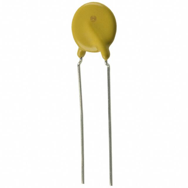

    贴片电容(MLCC) 径向 470pF ±5% 1KV SL/GP
ECC-A3A471JGE 数据手册
Discontinued High Voltage Ceramic Disc Capacitors (Low loss type) High Voltage Ceramic Disc Capacitors (Low loss type) KGE/Char. SL/GP, 1 to 6 kVDC KBP/Char. B/Y5P, 1 to 3 kVDC Series:KRP/Char. R/Y5R, 1 to 3 kVDC Series: Series: ■ Features ● Wide operating temperature range: (–25 to 105 °C or –25 to 125 °C) ● Improved Voltage vs.Temperature Rise ● Flame-retardant insulated coating ● Easy mounting through kinked leads and radial taping ■ Recommended Applications ● ● ● ● Snubber circuit for switching power supply Horizontal resonance circuitry for TVs and CRT displays Inverter type lighting apparatus Ballast circuit for LCD backlighting inverter (For series KGE) ● Other high voltage pulse and DC circuitry ■ Explanation of Part Numbers 1 2 3 4 5 6 7 8 9 10 11 12 E C K N 3 A 1 0 2 K B P Product Code Class Code Class 1 ECC Class 2 ECK Lead Style Code Style A Kinked Lead Bulk N Kinked Lead Taped Rated Voltage Nominal Capacitance Ex. Cap. Code Rated Volt. 470 47 pF 3A 1 kVDC 101 100 pF 3D 2 kVDC 102 1000 pF 3F 3 kVDC 222 2200 pF 3J 6 kVDC 472 4700 pF Cap. Tolerance Code Cap. Tol. D ±0.5 pF F ±1.0 pF J ±5 % K ±10 % Temp. Char. Code Char. G SL/GP B B/Y5P R R/Y5R Suffix ■ Specifications Characteristic Series KGE Series KBP, KRP Operating Temperature Range –25 to 105 °C –25 to 125 °C Rated Voltage 1 kVDC to 6 kVDC 1 kVDC to 3 kVDC Dielectric Withstanding Voltage Rated Voltage 1 to 3 kVDC: Rated Voltage 1 to 3 kVDC: 200 % of Rated Voltage 200 % of Rated Voltage for 1 to 5 seconds for 1 to 5 seconds Rated Voltage 6 kVDC: 150 % of Rated Voltage for 1 to 5 seconds Capacitance Within the specified tolerance, Within the specified tolerance, when measured at 1 MHz ± 20 %, when measured at 1 kHz ± 20 %,1 to 5 Vrms, and 20 °C 1 to 5 Vrms, and 20 °C Q or Dissipation Factor (tand) 30 pF or under Q > 400+20 C (C:Cap.pF) over 30 pF Q > 1000 at 1 MHz ± 20 %,1 to 5 Vrms. and 20 °C Insulation Resistance 10000 M 액 min. at 500 VDC 1 minute electrification Temperature Characteristics Temperature Coefficient: +350 to –1000 ppm/°C (Temperature Range:20 to 85°C) Series KBP : tand > 0.025 Series KRP : tand > 0.002 at 1 kHz ± 20 %,1 to 5 Vrms. and 20 °C Series KBP KRP Temp.Char max.Cap.Change B/Y5P ±10 % R/Y5R ±15 % Design and specifications are each subject to change without notice. Ask factory for the current technical specifications before purchase and/or use. Should a safety concern arise regarding this product, please be sure to contact us immediately. Temp. Range –25 to 85 °C –25 to 85 °C Feb. 2006 Discontinued High Voltage Ceramic Disc Capacitors (Low loss type) ■ Rated Voltage and Capacitance Range Series Name Temp. Char. Rated Voltage Capacitance Range in pF 100 1000 10 1 kVDC Series KBP Ballast circuit of LCD backlighting inverter 220 SL B 3 kVDC 150 6 kVDC 150 Snubber circuit of switching power supply 1 kVDC 5600 2 kVDC 5600 3 kVDC Series KRP Typical Applications 470 2 kVDC Series KGE 10000 R 2700 1 kVDC 4700 2 kVDC 4700 3 kVDC Snubber circuit of switching power supply Horizontal resonance circuit of TV and CRT display Snubber circuit of switching power supply 2200 ■ Dimensions “D” (Body Diameter) Cap. in pF 12 to 22 22 to 33 39 47 56 68 82 100 120 150 180 220 270 330 390 470 560 680 820 1000 1200 1500 1800 2200 2700 3300 3900 4700 5600 unit : mm KGE KBP 1 kV 2 kV 3 kV 6 kV 6.0 6.0 6.0 6.0 6.0 6.0 6.0 7.0 7.0 8.0 8.0 9.0 9.0 11.0 11.0 13.0 7.0 7.0 7.0 7.0 7.0 7.0 7.0 8.0 8.0 9.0 10.0 10.0 7.0 7.0 7.0 7.0 8.0 8.0 9.0 10.0 10.0 11.0 7.0 8.0 9.0 9.0 10.0 11.0 11.0 13.0 13.0 15.0 KRP 1 kV 2 kV 3 kV 1 kV 2 kV 3 kV 6.0 6.0 6.0 6.0 6.0 6.0 6.0 6.0 6.0 7.0 7.0 7.5 9.0 9.0 9.5 12.0 12.0 13.5 13.5 15.5 15.5 17.0 7.0 7.0 7.0 7.0 7.0 7.0 7.0 7.0 7.5 8.0 9.0 9.0 10.0 10.5 12.0 12.5 14.0 16.0 17.0 18.0 25.0 25.0 7.5 7.5 7.5 7.5 7.5 7.5 8.0 9.0 9.5 10.0 11.0 11.0 12.5 14.5 14.5 16.0 17.0 18.5 6.0 6.0 6.0 6.0 6.0 6.0 6.0 7.0 7.0 7.0 7.5 7.5 9.0 9.0 10.5 10.5 11.5 13.0 13.0 14.0 16.5 7.0 7.0 7.0 7.0 7.0 7.0 7.5 7.5 9.0 9.0 10.0 10.0 12.0 12.0 12.0 14.0 16.0 16.0 19.0 20.0 21.0 7.5 7.5 7.5 7.5 8.0 8.0 8.5 9.5 9.5 10.5 10.5 12.5 12.5 14.5 14.5 16.5 17.0 Design and specifications are each subject to change without notice. Ask factory for the current technical specifications before purchase and/or use. Should a safety concern arise regarding this product, please be sure to contact us immediately. Feb. 2006 Discontinued High Voltage Ceramic Disc Capacitors (Low loss type) ■ Dimensions in mm (not to scale) Standard lead styles are available in Kinked Lead and Kinked Lead Taping shown below. ● Kinked Lead Taping Type N0, N1 ● Kinked Lead Type D T ∆h2 ∆h1 4.0 max. D P P2 T e Note:Tolerance of Lead Space H0 20.0 min. F fd d±0.05 W W0 W1 W2 F L P1 Dim. F (Nominal) Tolerance of Dim. F 5.0 ±1.0 7.5 ±1.5 10.0 ±1.5 Unit (mm) fD0 t1 fd Taping Type t2 P0 Symbol P P0 F P1 P2 D W W0 W1 W2 H0 e fD0 fd t1 t2 T ∆h1, ∆h2 L Type N2 P2 D P F P1 P0 Same dimensions as Type N0, N1 except for special dimensions. N0 N1 N2 12.7±1.0 12.7±0.3 5.0±0.8 3.85±0.70 6.35±1.30 15.0±2.0 15.0±0.3 7.5±1.0 3.75±0.80 7.5±1.5 30.0±2.0 15.0±0.3 7.5±1.0 3.75±0.80 7.5±1.5 To comply with each individual specification 0.60±0.05 18.0+1.0 –0.5 10.0 min. 9.0±0.5 3.0 max. 18.0+2.0 –0 4.0 max. 4.0±0.2 0.65±0.05 0.6±0.3 1.5 max. 0.65±0.05 To comply with each individual specification 2.0 max. 11.0 max. ■ Minimum Quantity/Packing Unit Series / Type Temp.Char. SL/GP 1 to 6 kVDC Series KGE Temp.Char. B/Y5P 1 to 3 kVDC Series KBP Temp.Char. R/Y5R 1 to 3 kVDC Series KRP Minimum Packing Packing Quantity Quantity in Carton Part Number 12 to 150 to 12 to 100 to 180 to 12 to 100 to 5 to 100 to 120 pF 470 pF 82 pF 150 pF 220 pF 82 pF 150 pF 82 pF 150 pF 200 200 200 200 200 200 200 200 200 5000 4000 10000 4000 3000 4000 2000 3000 2000 Kinked Lead Bulk 1 kVDC ECCA3A첸첸첸첸GE Kinked Lead Bulk 2 kVDC ECCA3D첸첸첸첸GE Kinked Lead Bulk 3 kVDC ECCA3F첸첸첸첸GE Kinked Lead Bulk 6 kVDC ECCA3J첸첸첸첸GE 1 kVDC ECCN3A첸첸첸첸GE 12 to 470 pF 2000 10000 2 kVDC ECCN3D첸첸첸첸GE 12 to 220 pF 1000 5000 3 kVDC ECCN3F첸첸첸첸GE 12 to 150 pF 1000 5000 6 kVDC ECCN3J첸첸첸첸GE Kinked Lead Taped Type Kinked Lead Taped Type Kinked Lead Taped Type Kinked Lead Taped Type 365҂197҂126 358҂232҂305 Kinked Lead Bulk 1 kVDC ECKA3A첸첸첸KBP Kinked Lead Bulk 2 kVDC ECKA3D첸첸첸KBP Kinked Lead Bulk 3 kVDC ECKA3F첸첸첸KBP Kinked Lead Taped Type 1 kVDC ECKN3A첸첸첸KBP 5 to 150 pF 500 2500 100 to 680 pF 820 to 3900 pF 4700 to 5600 pF 100 to 560 pF 680 to 3900 pF 4700 to 5600 pF 100 to 390 pF 470 to 2200 pF 2700 pF 100 to 1000 pF 1200 to 3300 pF 3900 to 4700 pF 100 to 1800 pF 2200 to 3900 pF 100 to 1000 pF 1200 to 2700 pF 100 to 560 pF 680 to 3900 pF 4700 pF 100 to 390 pF 470 to 2700 pF 3300 to 4700 pF 100 to 330 pF 390 to 1500 pF 1800, 2200 pF 100 to 820 pF 1000 to 2200 pF 2700 to 3900 pF 200 200 200 200 200 100 200 200 100 2000 1000 500 1000 500 1000 500 200 200 200 200 200 100 200 200 200 2000 1000 500 5000 4000 2000 4000 2000 1000 4000 2000 1000 10000 5000 2500 5000 2500 5000 2500 5000 4000 2000 4000 2000 1000 4000 2000 1000 10000 5000 2500 Kinked Lead Taped Type Kinked Lead Taped Type 2 kVDC ECKN3D첸첸첸KBP 3 kVDC ECKN3F첸첸첸KBP Kinked Lead Bulk 1 kVDC ECKA3A첸첸첸KRP Kinked Lead Bulk 2 kVDC ECKA3D첸첸첸KRP Kinked Lead Bulk 3 kVDC ECKA3F첸첸첸KRP Kinked Lead Taped Type 1 kVDC ECKN3A첸첸첸KRP 2 kVDC ECKN3D첸첸첸KRP 100 to 1500 pF 1000 5000 3 kVDC ECKN3F첸첸첸KRP 100 to 820 pF 1000 5000 Kinked Lead Taped Type Kinked Lead Taped Type Carton L҂W҂H(mm) Design and specifications are each subject to change without notice. Ask factory for the current technical specifications before purchase and/or use. Should a safety concern arise regarding this product, please be sure to contact us immediately. 365҂197҂126 358҂232҂305 365҂197҂126 358҂232҂305 Feb. 2006 Discontinued High Voltage Ceramic Disc Capacitors (Low loss type) ■ Ratings and Characteristics ● Series KGE (Class 1, Temp. Char. SL/GP, 1 kVDC to 6 kVDC) Rated Volt. 1 kVDC 2 kVDC 3 kVDC Dimensions in mm Cap. Capacitance Tolerance D T in pF (%) max. max. 12 ±5, ±10 6.0 5.0 15 ±5, ±10 6.0 5.0 18 ±5, ±10 6.0 5.0 22 ±5, ±10 6.0 5.0 27 ±5, ±10 6.0 5.0 33 ±5, ±10 6.0 5.0 39 ±5, ±10 6.0 5.0 47 ±5, ±10 6.0 5.0 56 ±5, ±10 6.0 5.0 68 ±5, ±10 6.0 5.0 82 ±5, ±10 6.0 5.0 100 ±5, ±10 7.0 5.0 120 ±5, ±10 7.0 5.0 150 ±5, ±10 8.0 5.0 180 ±5, ±10 8.0 5.0 220 ±5, ±10 9.0 5.0 270 ±5, ±10 9.0 5.0 330 ±5, ±10 11.0 5.0 390 ±5, ±10 11.0 5.0 470 ±5, ±10 13.0 5.0 12 ±5, ±10 7.0 5.5 15 ±5, ±10 7.0 5.5 18 ±5, ±10 7.0 5.5 22 ±5, ±10 7.0 5.5 27 ±5, ±10 7.0 5.5 33 ±5, ±10 7.0 5.5 39 ±5, ±10 7.0 5.5 47 ±5, ±10 7.0 5.5 56 ±5, ±10 7.0 5.5 68 ±5, ±10 7.0 5.5 82 ±5, ±10 7.0 5.5 100 ±5, ±10 8.0 5.5 120 ±5, ±10 8.0 5.5 150 ±5, ±10 9.0 5.5 180 ±5, ±10 10.0 5.5 220 ±5, ±10 10.0 5.5 12 ±5, ±10 7.0 6.0 15 ±5, ±10 7.0 6.0 18 ±5, ±10 7.0 6.0 22 ±5, ±10 7.0 6.0 27 ±5, ±10 7.0 6.0 33 ±5, ±10 7.0 6.0 39 ±5, ±10 7.0 6.0 47 ±5, ±10 7.0 6.0 56 ±5, ±10 8.0 6.0 68 ±5, ±10 8.0 6.0 82 ±5, ±10 9.0 6.0 100 ±5, ±10 10.0 6.0 120 ±5, ±10 10.0 6.0 150 ±5, ±10 11.0 6.0 Kinked Lead Type (Bulk) Dimensions in mm Part Number F d ECCA3A120첸GE 5.0 0.60 ECCA3A150첸GE 5.0 0.60 ECCA3A180첸GE 5.0 0.60 ECCA3A220첸GE 5.0 0.60 ECCA3A270첸GE 5.0 0.60 ECCA3A330첸GE 5.0 0.60 ECCA3A390첸GE 5.0 0.60 ECCA3A470첸GE 5.0 0.60 ECCA3A560첸GE 5.0 0.60 ECCA3A680첸GE 5.0 0.60 ECCA3A820첸GE 5.0 0.60 ECCA3A101첸GE 5.0 0.60 ECCA3A121첸GE 5.0 0.60 ECCA3A151첸GE 5.0 0.60 ECCA3A181첸GE 5.0 0.60 ECCA3A221첸GE 5.0 0.60 ECCA3A271첸GE 5.0 0.60 ECCA3A331첸GE 5.0 0.60 ECCA3A391첸GE 5.0 0.60 ECCA3A471첸GE 7.5 0.65 ECCA3D120첸GE 7.5 0.65 ECCA3D150첸GE 7.5 0.65 ECCA3D180첸GE 7.5 0.65 ECCA3D220첸GE 7.5 0.65 ECCA3D270첸GE 7.5 0.65 ECCA3D330첸GE 7.5 0.65 ECCA3D390첸GE 7.5 0.65 ECCA3D470첸GE 7.5 0.65 ECCA3D560첸GE 7.5 0.65 ECCA3D680첸GE 7.5 0.65 ECCA3D820첸GE 7.5 0.65 ECCA3D101첸GE 7.5 0.65 ECCA3D121첸GE 7.5 0.65 ECCA3D151첸GE 7.5 0.65 ECCA3D181첸GE 7.5 0.65 ECCA3D221첸GE 7.5 0.65 ECCA3F120첸GE 7.5 0.65 ECCA3F150첸GE 7.5 0.65 ECCA3F180첸GE 7.5 0.65 ECCA3F220첸GE 7.5 0.65 ECCA3F270첸GE 7.5 0.65 ECCA3F330첸GE 7.5 0.65 ECCA3F390첸GE 7.5 0.65 ECCA3F470첸GE 7.5 0.65 ECCA3F560첸GE 7.5 0.65 ECCA3F680첸GE 7.5 0.65 ECCA3F820첸GE 7.5 0.65 ECCA3F101첸GE 7.5 0.65 ECCA3F121첸GE 7.5 0.65 ECCA3F151첸GE 7.5 0.65 Kinked Lead Taping Type Taped Dimensions in mm Part Number Type F d ECCN3A120첸GE N0 5.0 0.60 ECCN3A150첸GE N0 5.0 0.60 ECCN3A180첸GE N0 5.0 0.60 ECCN3A220첸GE N0 5.0 0.60 ECCN3A270첸GE N0 5.0 0.60 ECCN3A330첸GE N0 5.0 0.60 ECCN3A390첸GE N0 5.0 0.60 ECCN3A470첸GE N0 5.0 0.60 ECCN3A560첸GE N0 5.0 0.60 ECCN3A680첸GE N0 5.0 0.60 ECCN3A820첸GE N0 5.0 0.60 ECCN3A101첸GE N0 5.0 0.60 ECCN3A121첸GE N0 5.0 0.60 ECCN3A151첸GE N0 5.0 0.60 ECCN3A181첸GE N0 5.0 0.60 ECCN3A221첸GE N0 5.0 0.60 ECCN3A271첸GE N0 5.0 0.60 ECCN3A331첸GE N0 5.0 0.60 ECCN3A391첸GE N0 5.0 0.60 ECCN3A471첸GE N1 7.5 0.65 ECCN3D120첸GE N1 7.5 0.65 ECCN3D150첸GE N1 7.5 0.65 ECCN3D180첸GE N1 7.5 0.65 ECCN3D220첸GE N1 7.5 0.65 ECCN3D270첸GE N1 7.5 0.65 ECCN3D330첸GE N1 7.5 0.65 ECCN3D390첸GE N1 7.5 0.65 ECCN3D470첸GE N1 7.5 0.65 ECCN3D560첸GE N1 7.5 0.65 ECCN3D680첸GE N1 7.5 0.65 ECCN3D820첸GE N1 7.5 0.65 ECCN3D101첸GE N1 7.5 0.65 ECCN3D121첸GE N1 7.5 0.65 ECCN3D151첸GE N1 7.5 0.65 ECCN3D181첸GE N1 7.5 0.65 ECCN3D221첸GE N1 7.5 0.65 ECCN3F120첸GE N1 7.5 0.65 ECCN3F150첸GE N1 7.5 0.65 ECCN3F180첸GE N1 7.5 0.65 ECCN3F220첸GE N1 7.5 0.65 ECCN3F270첸GE N1 7.5 0.65 ECCN3F330첸GE N1 7.5 0.65 ECCN3F390첸GE N1 7.5 0.65 ECCN3F470첸GE N1 7.5 0.65 ECCN3F560첸GE N1 7.5 0.65 ECCN3F680첸GE N1 7.5 0.65 ECCN3F820첸GE N1 7.5 0.65 ECCN3F101첸GE N1 7.5 0.65 ECCN3F121첸GE N1 7.5 0.65 ECCN3F151첸GE N1 7.5 0.65 Note : 첸···Capacitance Tolerance Code J (± 5%) or K (± 10%) Design and specifications are each subject to change without notice. Ask factory for the current technical specifications before purchase and/or use. Should a safety concern arise regarding this product, please be sure to contact us immediately. Feb. 2006 Discontinued High Voltage Ceramic Disc Capacitors (Low loss type) ■ Ratings and Characteristics ● Series KGE (Class 1, Temp. Char. SL/GP, 1 to 6 kVDC) (Continuation) Rated Volt. 6 kVDC Dimensions in mm Cap. Capacitance Tolerance D T in pF (%) max. max. 5 ±0.5pF or ±1pF 7.0 6.0 7.0 6.0 6 ±0.5pF or ±1pF 7.0 6.0 7 ±0.5pF or ±1pF 7.0 6.0 8 ±0.5pF or ±1pF 7.0 6.0 9 ±0.5pF or ±1pF 7.0 6.0 10 ±0.5pF or ±1pF 12 ±5 or ±10 7.0 6.0 15 ±5 or ±10 7.0 6.0 18 ±5 or ±10 7.0 6.0 22 ±5 or ±10 7.0 6.0 27 ±5 or ±10 8.0 6.0 33 ±5 or ±10 8.0 6.0 39 ±5 or ±10 9.0 6.0 47 ±5 or ±10 9.0 6.0 56 ±5 or ±10 10.0 6.0 68 ±5 or ±10 11.0 6.0 82 ±5 or ±10 11.0 6.0 100 ±5 or ±10 13.0 6.0 120 ±5 or ±10 13.0 6.0 150 ±5 or ±10 15.0 6.0 Kinked Lead Type (Bulk) Dimensions in mm Part Number F d ECCA3J050첸GE 7.5 0.65 ECCA3J060첸GE 7.5 0.65 ECCA3J070첸GE 7.5 0.65 ECCA3J080첸GE 7.5 0.65 ECCA3J090첸GE 7.5 0.65 ECCA3J100첸GE 7.5 0.65 ECCA3J120첸GE 7.5 0.65 ECCA3J150첸GE 7.5 0.65 ECCA3J180첸GE 7.5 0.65 ECCA3J220첸GE 7.5 0.65 ECCA3J270첸GE 7.5 0.65 ECCA3J330첸GE 7.5 0.65 ECCA3J390첸GE 7.5 0.65 ECCA3J470첸GE 7.5 0.65 ECCA3J560첸GE 7.5 0.65 ECCA3J680첸GE 7.5 0.65 ECCA3J820첸GE 7.5 0.65 ECCA3J101첸GE 7.5 0.65 ECCA3J121첸GE 7.5 0.65 ECCA3J151첸GE 7.5 0.65 Kinked Lead Taping Type Taped Dimensions in mm Part Number Type F d ECCN3J050첸GE N1 7.5 0.65 ECCN3J060첸GE N1 7.5 0.65 ECCN3J070첸GE N1 7.5 0.65 ECCN3J080첸GE N1 7.5 0.65 ECCN3J090첸GE N1 7.5 0.65 ECCN3J100첸GE N1 7.5 0.65 ECCN3J120첸GE N1 7.5 0.65 ECCN3J150첸GE N1 7.5 0.65 ECCN3J180첸GE N1 7.5 0.65 ECCN3J220첸GE N1 7.5 0.65 ECCN3J270첸GE N1 7.5 0.65 ECCN3J330첸GE N1 7.5 0.65 ECCN3J390첸GE N1 7.5 0.65 ECCN3J470첸GE N1 7.5 0.65 ECCN3J560첸GE N1 7.5 0.65 ECCN3J680첸GE N1 7.5 0.65 ECCN3J820첸GE N1 7.5 0.65 ECCN3J101첸GE N1 7.5 0.65 ECCN3J121첸GE N1 7.5 0.65 ECCN3J151첸GE N2 7.5 0.65 Note : 첸···Capacitance Tolerance Code D (± 0.5pF) or F (± 1pF) or J (± 5%) or K (± 10%) ● Series KBP (Class 2, Temp. Char. B/Y5P, 1 to 3 kVDC) Dimensions in mm Kinked Lead Type (Bulk) Rated Cap. Capacitance Tolerance Dimensions in mm D T Volt. in pF Part Number (%) max. max. F d ECKA3A101KBP 100 ±10 6.0 4.5 5.0 0.60 ECKA3A121KBP 120 ±10 6.0 4.5 5.0 0.60 ECKA3A151KBP 150 ±10 6.0 4.5 5.0 0.60 ECKA3A181KBP 180 ±10 6.0 4.5 5.0 0.60 ECKA3A221KBP 220 ±10 6.0 4.5 5.0 0.60 ECKA3A271KBP 270 ±10 6.0 4.5 5.0 0.60 ECKA3A331KBP 330 ±10 6.0 4.5 5.0 0.60 ECKA3A391KBP 390 ±10 6.0 4.5 5.0 0.60 ECKA3A471KBP 470 ±10 6.0 4.5 5.0 0.60 ECKA3A561KBP 560 ±10 7.0 4.5 5.0 0.60 ECKA3A681KBP 680 ±10 7.0 4.5 5.0 0.60 1 kVDC ECKA3A821KBP 820 ±10 7.5 4.5 5.0 0.60 ECKA3A102KBP 1000 ±10 9.0 4.5 5.0 0.60 ECKA3A122KBP 1200 ±10 9.0 4.5 5.0 0.60 ECKA3A152KBP 1500 ±10 9.5 4.5 5.0 0.60 ECKA3A182KBP 1800 ±10 10.0 4.5 5.0 0.60 ECKA3A222KBP 2200 ±10 12.0 4.5 5.0 0.60 ECKA3A272KBP 2700 ±10 12.0 4.5 5.0 0.60 ECKA3A332KBP 10.0 0.65 3300 ±10 13.5 4.5 ECKA3A392KBP 10.0 0.65 3900 ±10 13.5 4.5 ECKA3A472KBP 10.0 0.65 4700 ±10 15.5 4.5 ECKA3A562KBP 10.0 0.65 5600 ±10 17.0 4.5 Kinked Lead Taping Type Taped Dimensions in mm Part Number Type F d ECKN3A101KBP N0 5.0 0.60 ECKN3A121KBP N0 5.0 0.60 ECKN3A151KBP N0 5.0 0.60 ECKN3A181KBP N0 5.0 0.60 ECKN3A221KBP N0 5.0 0.60 ECKN3A271KBP N0 5.0 0.60 ECKN3A331KBP N0 5.0 0.60 ECKN3A391KBP N0 5.0 0.60 ECKN3A471KBP N0 5.0 0.60 ECKN3A561KBP N0 5.0 0.60 ECKN3A681KBP N0 5.0 0.60 ECKN3A821KBP N0 5.0 0.60 ECKN3A102KBP N0 5.0 0.60 ECKN3A122KBP N0 5.0 0.60 ECKN3A152KBP N0 5.0 0.60 ECKN3A182KBP N0 5.0 0.60 ECKN3A222KBP N0 5.0 0.60 ECKN3A272KBP N0 5.0 0.60 ECKN3A332KBP N1 7.5 0.65 ECKN3A392KBP N1 7.5 0.65 ECKN3A472KBP N2 7.5 0.65 ECKN3A562KBP N2 7.5 0.65 Design and specifications are each subject to change without notice. Ask factory for the current technical specifications before purchase and/or use. Should a safety concern arise regarding this product, please be sure to contact us immediately. Feb. 2006 Discontinued High Voltage Ceramic Disc Capacitors (Low loss type) ■ Ratings and Characteristics ● Series KBP (Class 2, Temp. Char. B/Y5P, 1 to 3 kVDC) (Continuation) Dimensions in mm Kinked Lead Type (Bulk) Rated Cap. Capacitance Tolerance Dimensions in mm D T Volt. in pF Part Number (%) max. max. F d ECKA3D101KBP 100 ±10 7.0 5.0 7.5 0.65 ECKA3D121KBP 120 ±10 7.0 5.0 7.5 0.65 ECKA3D151KBP 150 ±10 7.0 5.0 7.5 0.65 ECKA3D181KBP 180 ±10 7.0 5.0 7.5 0.65 ECKA3D221KBP 220 ±10 7.0 5.0 7.5 0.65 ECKA3D271KBP 270 ±10 7.0 5.0 7.5 0.65 ECKA3D331KBP 330 ±10 7.0 5.0 7.5 0.65 ECKA3D391KBP 390 ±10 7.0 5.0 7.5 0.65 ECKA3D471KBP 470 ±10 7.5 5.0 7.5 0.65 ECKA3D561KBP 560 ±10 8.0 5.0 7.5 0.65 ECKA3D681KBP 680 ±10 9.0 5.0 7.5 0.65 2 kVDC ECKA3D821KBP 820 ±10 9.0 5.0 7.5 0.65 ECKA3D102KBP 1000 ±10 10.0 5.0 7.5 0.65 ECKA3D122KBP 1200 ±10 10.5 5.0 7.5 0.65 ECKA3D152KBP 1500 ±10 12.0 5.0 7.5 0.65 ECKA3D182KBP 1800 ±10 12.5 5.0 7.5 0.65 ECKA3D222KBP 10.0 0.65 2200 ±10 14.0 5.0 ECKA3D272KBP 10.0 0.65 2700 ±10 16.0 5.0 ECKA3D332KBP 10.0 0.65 3300 ±10 17.0 5.0 ECKA3D392KBP 10.0 0.65 3900 ±10 18.0 5.0 ECKA3D472KBP 10.0 0.65 4700 ±10 25.0 5.0 ECKA3D562KBP 10.0 0.65 5600 ±10 25.0 5.0 ECKA3F101KBP 100 ±10 7.5 6.0 7.5 0.65 ECKA3F121KBP 120 ±10 7.5 6.0 7.5 0.65 ECKA3F151KBP 150 ±10 7.5 6.0 7.5 0.65 ECKA3F181KBP 180 ±10 7.5 6.0 7.5 0.65 ECKA3F221KBP 220 ±10 7.5 6.0 7.5 0.65 ECKA3F271KBP 270 ±10 7.5 6.0 7.5 0.65 ECKA3F331KBP 330 ±10 8.0 6.0 7.5 0.65 ECKA3F391KBP 390 ±10 9.0 6.0 7.5 0.65 ECKA3F471KBP 470 ±10 9.5 6.0 7.5 0.65 3 kVDC ECKA3F561KBP 560 ±10 10.0 6.0 7.5 0.65 ECKA3F681KBP 680 ±10 11.0 6.0 7.5 0.65 ECKA3F821KBP 820 ±10 11.0 6.0 7.5 0.65 ECKA3F102KBP 1000 ±10 12.5 6.0 7.5 0.65 ECKA3F122KBP 10.0 0.65 1200 ±10 14.5 6.0 ECKA3F152KBP 10.0 0.65 1500 ±10 14.5 6.0 ECKA3F182KBP 10.0 0.65 1800 ±10 16.0 6.0 ECKA3F222KBP 10.0 0.65 2200 ±10 17.0 6.0 ECKA3F272KBP 10.0 0.65 2700 ±10 18.5 6.0 Kinked Lead Taping Type Taped Dimensions in mm Part Number Type F d ECKN3D101KBP N1 7.5 0.65 ECKN3D121KBP N1 7.5 0.65 ECKN3D151KBP N1 7.5 0.65 ECKN3D181KBP N1 7.5 0.65 ECKN3D221KBP N1 7.5 0.65 ECKN3D271KBP N1 7.5 0.65 ECKN3D331KBP N1 7.5 0.65 ECKN3D391KBP N1 7.5 0.65 ECKN3D471KBP N1 7.5 0.65 ECKN3D561KBP N1 7.5 0.65 ECKN3D681KBP N1 7.5 0.65 ECKN3D821KBP N1 7.5 0.65 ECKN3D102KBP N1 7.5 0.65 ECKN3D122KBP N1 7.5 0.65 ECKN3D152KBP N1 7.5 0.65 ECKN3D182KBP N1 7.5 0.65 ECKN3D222KBP N2 7.5 0.65 ECKN3D272KBP N2 7.5 0.65 ECKN3D332KBP N2 7.5 0.65 ECKN3D392KBP N2 7.5 0.65 —— — — — —— — — — ECKN3F101KBP N1 7.5 0.65 ECKN3F121KBP N1 7.5 0.65 ECKN3F151KBP N1 7.5 0.65 ECKN3F181KBP N1 7.5 0.65 ECKN3F221KBP N1 7.5 0.65 ECKN3F271KBP N1 7.5 0.65 ECKN3F331KBP N1 7.5 0.65 ECKN3F391KBP N1 7.5 0.65 ECKN3F471KBP N1 7.5 0.65 ECKN3F561KBF N1 7.5 0.65 ECKN3F681KBP N1 7.5 0.65 ECKN3F821KBP N1 7.5 0.65 ECKN3F102KBP N1 7.5 0.65 ECKN3F122KBP N1 7.5 0.65 ECKN3F152KBP N1 7.5 0.65 ECKN3F182KBP N2 7.5 0.65 ECKN3F222KBP N2 7.5 0.65 ECKN3F272KBP N2 7.5 0.65 Design and specifications are each subject to change without notice. Ask factory for the current technical specifications before purchase and/or use. Should a safety concern arise regarding this product, please be sure to contact us immediately. Feb. 2006 Discontinued High Voltage Ceramic Disc Capacitors (Low loss type) ■ Ratings and Characteristics ● Series KRP (Class 2, Temp. Char. R/Y5R, 1 to 3 kVDC) Dimensions in mm Kinked Lead Type (Bulk) Rated Cap. Capacitance Tolerance Dimensions in mm D T Volt. in pF Part Number (%) max. max. F d ECKA3A101KRP 100 ±10 6.0 4.5 5.0 0.60 ECKA3A121KRP 120 ±10 6.0 4.5 5.0 0.60 ECKA3A151KRP 150 ±10 6.0 4.5 5.0 0.60 ECKA3A181KRP 180 ±10 6.0 4.5 5.0 0.60 ECKA3A221KRP 220 ±10 6.0 4.5 5.0 0.60 ECKA3A271KRP 270 ±10 6.0 4.5 5.0 0.60 ECKA3A331KRP 330 ±10 6.0 4.5 5.0 0.60 ECKA3A391KRP 390 ±10 7.0 4.5 5.0 0.60 ECKA3A471KRP 470 ±10 7.0 4.5 5.0 0.60 ECKA3A561KRP 560 ±10 7.0 4.5 5.0 0.60 ECKA3A681KRP 1 kVDC 680 ±10 7.5 4.5 5.0 0.60 ECKA3A821KRP 820 ±10 7.5 4.5 5.0 0.60 ECKA3A102KRP 1000 ±10 9.0 4.5 5.0 0.60 ECKA3A122KRP 1200 ±10 9.0 4.5 5.0 0.60 ECKA3A152KRP 1500 ±10 10.5 4.5 5.0 0.60 ECKA3A182KRP 1800 ±10 10.5 4.5 5.0 0.60 ECKA3A222KRP 2200 ±10 11.5 4.5 5.0 0.60 ECKA3A272KRP 2700 ±10 13.0 4.5 7.5 0.65 ECKA3A332KRP 3300 ±10 13.0 4.5 7.5 0.65 ECKA3A392KRP 3900 ±10 14.0 4.5 7.5 0.65 ECKA3A472KRP 4700 ±10 16.5 4.5 7.5 0.65 ECKA3D101KRP 100 ±10 7.0 5.0 7.5 0.65 ECKA3D121KRP 120 ±10 7.0 5.0 7.5 0.65 ECKA3D151KRP 150 ±10 7.0 5.0 7.5 0.65 ECKA3D181KRP 180 ±10 7.0 5.0 7.5 0.65 ECKA3D221KRP 220 ±10 7.0 5.0 7.5 0.65 ECKA3D271KRP 270 ±10 7.0 5.0 7.5 0.65 ECKA3D331KRP 330 ±10 7.5 5.0 7.5 0.65 ECKA3D391KRP 390 ±10 7.5 5.0 7.5 0.65 ECKA3D471KRP 470 ±10 9.0 5.0 7.5 0.65 ECKA3D561KRP 560 ±10 9.0 5.0 7.5 0.65 ECKA3D681KRP 2 kVDC 680 ±10 10.0 5.0 7.5 0.65 ECKA3D821KRP 820 ±10 10.0 5.0 7.5 0.65 ECKA3D102KRP 1000 ±10 12.0 5.0 7.5 0.65 ECKA3D122KRP 1200 ±10 12.0 5.0 7.5 0.65 ECKA3D152KRP 1500 ±10 12.0 5.0 7.5 0.65 ECKA3D182KRP 10.0 0.65 1800 ±10 14.0 5.0 ECKA3D222KRP 10.0 0.65 2200 ±10 16.0 5.0 ECKA3D272KRP 10.0 0.65 2700 ±10 16.0 5.0 ECKA3D332KRP 10.0 0.65 3300 ±10 19.0 5.0 ECKA3D392KRP 10.0 0.65 3900 ±10 20.0 5.0 ECKA3D472KRP 10.0 0.65 4700 ±10 21.0 5.0 Kinked Lead Taping Type Taped Dimensions in mm Part Number Type F d ECKN3A101KRP N0 5.0 0.60 ECKN3A121KRP N0 5.0 0.60 ECKN3A151KRP N0 5.0 0.60 ECKN3A181KRP N0 5.0 0.60 ECKN3A221KRP N0 5.0 0.60 ECKN3A271KRP N0 5.0 0.60 ECKN3A331KRP N0 5.0 0.60 ECKN3A391KRP N0 5.0 0.60 ECKN3A471KRP N0 5.0 0.60 ECKN3A561KRP N0 5.0 0.60 ECKN3A681KRP N0 5.0 0.60 ECKN3A821KRP N0 5.0 0.60 ECKN3A102KRP N0 5.0 0.60 ECKN3A122KRP N0 5.0 0.60 ECKN3A152KRP N0 5.0 0.60 ECKN3A182KRP N0 5.0 0.60 ECKN3A222KRP N0 5.0 0.60 ECKN3A272KRP N1 7.5 0.65 ECKN3A332KRP N1 7.5 0.65 ECKN3A392KRP N1 7.5 0.65 —— — — — ECKN3D101KRP N1 7.5 0.65 ECKN3D121KRP N1 7.5 0.65 ECKN3D151KRP N1 7.5 0.65 ECKN3D181KRP N1 7.5 0.65 ECKN3D221KRP N1 7.5 0.65 ECKN3D271KRP N1 7.5 0.65 ECKN3D331KRP N1 7.5 0.65 ECKN3D391KRP N1 7.5 0.65 ECKN3D471KRP N1 7.5 0.65 ECKN3D561KRP N1 7.5 0.65 ECKN3D681KRP N1 7.5 0.65 ECKN3D821KRP N1 7.5 0.65 ECKN3D102KRP N1 7.5 0.65 ECKN3D122KRP N1 7.5 0.65 ECKN3D152KRP N1 7.5 0.65 —— — — — —— — — — —— — — — —— — — — —— — — — —— — — — Design and specifications are each subject to change without notice. Ask factory for the current technical specifications before purchase and/or use. Should a safety concern arise regarding this product, please be sure to contact us immediately. Feb. 2006 Discontinued High Voltage Ceramic Disc Capacitors (Low loss type) ■ Ratings and Characteristics ● Series KRP (Class 2, Temp. Char. R/Y5R, 1 to 3 kVDC) (Continuation) Dimensions in mm Kinked Lead Type (Bulk) Rated Cap. Capacitance Tolerance Dimensions in mm D T Volt. in pF Part Number (%) max. max. F d ECKA3F101KRP 100 ±10 7.5 5.5 7.5 0.65 ECKA3F121KRP 120 ±10 7.5 5.5 7.5 0.65 ECKA3F151KRP 150 ±10 7.5 5.5 7.5 0.65 ECKA3F181KRP 180 ±10 7.5 5.5 7.5 0.65 ECKA3F221KRP 220 ±10 8.0 5.5 7.5 0.65 ECKA3F271KRP 270 ±10 8.0 5.5 7.5 0.65 ECKA3F331KRP 330 ±10 8.5 5.5 7.5 0.65 ECKA3F391KRP 390 ±10 9.5 5.5 7.5 0.65 ECKA3F471KRP 3 kVDC 470 ±10 9.5 5.5 7.5 0.65 ECKA3F561KRP 560 ±10 10.5 5.5 7.5 0.65 ECKA3F681KRP 680 ±10 10.5 5.5 7.5 0.65 ECKA3F821KRP 820 ±10 12.5 5.5 7.5 0.65 ECKA3F102KRP 10.0 0.65 1000 ±10 12.5 5.5 ECKA3F122KRP 10.0 0.65 1200 ±10 14.5 5.5 ECKA3F152KRP 10.0 0.65 1500 ±10 14.5 5.5 ECKA3F182KRP 10.0 0.65 1800 ±10 16.5 5.5 ECKA3F222KRP 10.0 0.65 2200 ±10 17.0 5.5 Kinked Lead Taping Type Taped Dimensions in mm Part Number Type F d ECKN3F101KRP N1 7.5 0.65 ECKN3F121KRP N1 7.5 0.65 ECKN3F151KRP N1 7.5 0.65 ECKN3F181KRP N1 7.5 0.65 ECKN3F221KRP N1 7.5 0.65 ECKN3F271KRP N1 7.5 0.65 ECKN3F331KRP N1 7.5 0.65 ECKN3F391KRP N1 7.5 0.65 ECKN3F471KRP N1 7.5 0.65 ECKN3F561KRP N1 7.5 0.65 ECKN3F681KRP N1 7.5 0.65 ECKN3F821KRP N1 7.5 0.65 —— — — — —— — — — —— — — — —— — — — —— — — — ■ Typical Temperature Characteristics Series KBP (Char. B/Y5P) Series KGE (Char. SL/GP) Range : –25 to 85 °C ( Temp. ) max. Cap. Change : ±10 % Capacitance Change (%) Capacitance Change (%) (Temp. Coeff. : +350 to –1000 ppm/˚C) +10 +5 0 –5 –10 –15 –20 0 20 40 60 80 100 120 Temperature (°C) +20 +10 0 –10 –20 –30 –20 0 20 40 60 80 100 120 Temperature (°C) Series KRP (Char. R/Y5R) Capacitance Change (%) Range : –25 to 85 °C ( Temp. ) max. Cap. Change : ±15 % +20 +10 0 –10 –20 –30 –20 0 20 40 60 80 100 120 Temperature (°C) Design and specifications are each subject to change without notice. Ask factory for the current technical specifications before purchase and/or use. Should a safety concern arise regarding this product, please be sure to contact us immediately. Feb. 2006 Discontinued High Voltage Ceramic Disc Capacitors (Low loss type) ■ Characteristics of Voltage – Frequency Series KBP 1 kVDC Series KRP 1 kVDC 1000 1000 220 pF 470 pF 1000 pF 2200 pF 500 220 pF 470 pF Voltage (Vp-p) Voltage (Vp-p) 500 4700 pF 100 50 10 1000 pF 100 2200 pF 4700 pF 50 10 10 50 100 Frequency (kHZ) 500 1000 10 50 100 Frequency (kHZ) Series KBP 2 kVDC Voltage (Vp-p) 5000 1000 220 pF 470 pF 1000 pF 2200 pF 500 1000 500 220 pF 470 pF 1000 pF 4700 pF 100 2200 pF 4700 pF 100 10 50 100 Frequency (kHZ) 500 1000 10 50 100 Frequency (kHZ) Series KBP 3 kVDC 500 1000 Series KRP 3 kVDC 5000 5000 1000 Voltage (Vp-p) 220 pF 470 pF 1000 pF 2200 pF 500 100 1000 220 pF 470 pF 1000 pF 2200 pF 500 100 10 50 100 Frequency (kHZ) 500 1000 The graphs above show the maximum permissable voltage when using a capacitor with an AC sine wave voltage. When measuring this voltage in room temperature (25 °C), the capacitor self-heat generation will rise a maximum of 20 °C. When using a pulse voltage or an AC voltage other than a sine wave, confirm that the capacitor self-heat generation is less than 20 °C in an ambient room temperature of 25 °C. The self-heat generation temperature is the difference between the surface temperature and the ambient room temperature. As for the situation when the self-heat generation temperature is more than 25 °C, refer to the figure on the right. 10 50 100 Frequency (kHZ) 500 1000 Permission self generation of heat temperature vs. ambient temperature 25 Permission self generation of heat temperature (˚C) Voltage (Vp-p) 1000 Series KRP 2 kVDC 5000 Voltage (Vp-p) 500 20 15 10 5 0 20 40 60 80 100 120 ambient temperature (˚C) Design and specifications are each subject to change without notice. Ask factory for the current technical specifications before purchase and/or use. Should a safety concern arise regarding this product, please be sure to contact us immediately. Feb. 2006

物料型号: - 系列包括KGE、KBP和KRP,额定电压从1到6千伏直流(KGE系列),以及1到3千伏直流(KBP和KRP系列)。
器件简介: - 这些电容器设计用于承受高电压,具有低损耗特性。 - 它们具备宽工作温度范围,改进的电压-温度上升特性,阻燃绝缘涂层,以及易于安装的弯曲引线和径向引脚。
引脚分配: - 提供了不同尺寸和类型的引脚,包括弯曲引线(Kinked Lead)和胶带引线(Taped)。
参数特性: - 工作温度范围从-25°C到105°C或-25°C到125°C。 - 额定电压从1kVDC到6kVDC(KGE系列)和1kVDC到3kVDC(KBP和KRP系列)。 - 电容公差、介质耐压、电容值、品质因数(Q值或耗散因子tano)和绝缘电阻等参数均有详细说明。
功能详解: - 电容器适用于开关电源的消振电路、电视和CRT显示器的水平共振电路、逆变器型照明设备、液晶背光逆变器的镇流电路等。
应用信息: - KGE系列特别适用于液晶背光逆变器的镇流电路,而KBP和KRP系列适用于开关电源的消振电路等。
封装信息: - 提供了详细的尺寸信息,包括电容器的直径和高度,以及引脚的尺寸和公差。
注意事项: - 设计和规格如有变更,恕不另行通知。在购买和/或使用前,请向工厂询问当前的技术规格。 - 如果出现与产品相关的安全问题,请立即联系Panasonic。
