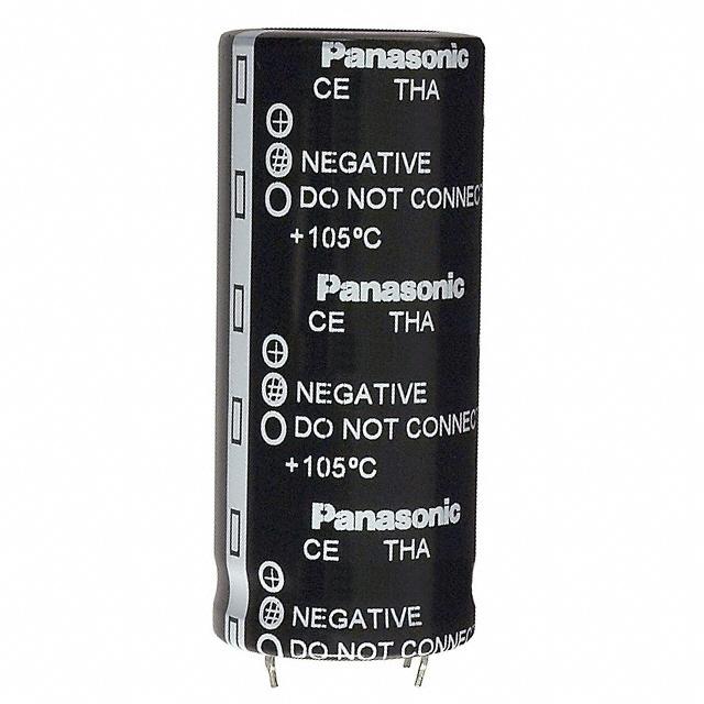

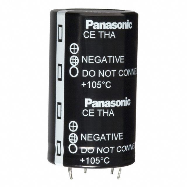

    2700 µF 200 V 铝电解电容器 径向,罐 - 卡入式 - 4 引线 80 毫欧 105°C 时为 3000 小时
ECE-T2DA272EA 数据手册
Panasonic Industrial Company T-HA Series Aluminum Electrolytic Capacitors 105°C, 3000 hours  Long Life - endurance rating of 3000 hours at 105°C  4 or 5 terminal mounting provides stability and keyed polarity RoHS  Extended higher CV ratings Compliant Rated Working Voltage: Operating Temperature: Nominal Capacitance: Capacitance Tolerance: Dissipation Factor: (120 Hz, +20°C) 16 ~ 250 VDC -40 ~ +105°C 820~250000µF 350 ~ 450 VDC -25 ~ +105°C 330~2200µF ± 20% 16 50 Working Voltage [V]: Max. D.F. (%): 25 40 35 35 50 30 63 25 100 20 160 ~ 450 15 (rated cap. [µF] - 33000 ) 1000 For capacitance values > 33000µF, add the value of: Leakage Current: Ripple Current Multipliers: 80 20 3¥CV (µA) max. after 5 minutes; C = Capacitance in µF, V = WV Frequency(Hz): 16~100WV: 160~450WV: 50 0.93 0.75 60 0.95 0.8 Endurance: 100~120 1.0 1.0 500 1.05 1.2 1k 1.08 1.25 10k 1.15 1.4 Ripple Current Ambient Temperature Factors** Temperature (°C): 105°C 85°C 70°C 60°C Multiplier: 1.0 1.7 2.0 2.2 ”45°C 2.35 3000 hours at +105°C with maximum specified ripple current (see page 4) **Use of temperature ripple current multipliers may limit life to the hours specified for the maximum operating temperature. Part Number System E C E T Series Code Terminals Prefix No. of Pins ECET 4 ECEP 5 1C 16 1E 25 1V 35 1H 50 RoHS compliant PVC sleeve and top plate is standard. A Capacitance Code Terminal Suffix Code Standard Extended Ratings Ratings Terminal Length & Type Diameter Code Dia. Code 35 E 40 F 50 H Voltage Code 1J 1K 2A 2D 2E 2V 2G 2W 63 80 100 200 250 350 400 450 6.3mm Snap-in (Standard): 4.0mm Snap-in (4 pin only): 4.0mm Straight with Standoff: A 4 E X 5 Y Dimensions in millimeters 4 Pin Mounting Style 60° 60° (+) + 30° 30° Isolate P.C. Pads T L Circuit Board Mounting Holes (-) Ø22.5±0.1 4 x Ø2.0±0.1 ØD 60° 5 Pin Mounting Style 60° (+) + 30° + (+) Isolate P.C. Pad (-) 60° (-) L Pin Dimensions 2.0 max. T 0.8 4.0 +0.2 -0.1 1.5±0.2 T = 6.3mm Length Snap-in Terminal Standard on 4 and 5 Pin Products 44 2.0 max. 0.8 +0.2 0.8 -0.1 Top of Capacitor Body 6.3±1.0 Ø25.0±0.1 5 x Ø2.0±0.1 ØD 3.5 Circuit Board Mounting Holes +0.2 -0.1 1.5 6.0±1 4.0±0.5 1.5±0.2 T = 4mm Length Snap-in Terminal Available on 4 Pin Product only 5.0 2.0 max. T = 4mm Length Straight Standoff Pin Terminal Available on 4 and 5 Pin Products Design and specifications are subject to change without notice. Contact the factory or your sales representative for technical specifications before purchase and/or use. When safety concerns arise, please contact Panasonic immediately for technical consultation. Panasonic Industrial Company T-HA Standard Ratings Cap. (µF) 39000 47000 56000 68000 82000 100000 120000 150000 180000 220000 250000 27000 33000 47000 56000 82000 100000 120000 150000 180000 18000 22000 27000 33000 39000 47000 56000 68000 82000 100000 10000 15000 18000 22000 27000 33000 39000 47000 56000 Max 105°C R.C. (Arms) Size (mm) DxL 120Hz 35 40 35 35 40 40 35 35 40 50 40 50 50 50 50 x x x x x x x x x x x x x x x 40 40 50 63 50 63 80 105 80 50 105 63 80 92 105 5.10 5.50 6.00 6.62 7.29 7.66 8.03 8.71 8.79 9.02 9.88 10.15 11.02 11.71 12.31 35 35 40 35 40 35 40 35 40 50 40 50 50 50 50 x x x x x x x x x x x x x x x 40 50 40 63 50 80 63 105 80 50 105 63 80 92 105 4.80 5.50 5.50 6.56 6.47 7.25 7.17 8.58 8.68 9.20 9.76 10.02 10.93 11.70 12.42 35 35 40 35 40 40 35 35 40 50 50 40 50 50 50 x x x x x x x x x x x x x x x 40 50 40 63 50 63 80 105 80 50 63 105 80 92 105 4.30 5.00 5.00 5.53 5.44 6.61 6.52 8.07 7.79 8.25 9.07 9.27 10.07 10.89 11.75 35 35 40 35 40 35 40 35 50 40 50 40 50 50 x x x x x x x x x x x x x x 40 50 40 63 50 80 63 105 50 80 63 105 80 92 4.00 4.80 4.80 5.27 5.15 6.16 6.05 7.23 7.75 7.55 8.40 8.18 9.19 9.79 20°C ESR (Ȏ, max.) 10kHz~ 120Hz 20kHz 16 VDC Working, 20 VDC Surge 5.87 0.022 0.020 6.33 0.020 0.018 6.90 0.019 0.017 7.61 0.017 0.015 8.38 0.015 0.014 8.81 0.017 0.015 9.23 0.015 0.013 10.02 0.014 0.012 10.11 0.014 0.012 10.37 0.015 0.014 11.36 0.013 0.012 11.67 0.014 0.013 12.67 0.013 0.012 13.47 0.012 0.011 14.16 0.011 0.010 25 VDC Working, 32 VDC Surge 5.52 0.018 0.017 6.33 0.018 0.016 6.33 0.018 0.016 7.54 0.017 0.015 7.44 0.015 0.014 8.34 0.015 0.013 8.25 0.014 0.013 9.87 0.013 0.012 9.98 0.013 0.012 10.58 0.016 0.015 11.22 0.012 0.010 11.52 0.015 0.013 12.57 0.013 0.012 13.46 0.012 0.011 14.28 0.010 0.009 35 VDC Working, 44 VDC Surge 4.95 0.028 0.021 5.75 0.023 0.017 5.75 0.023 0.017 6.36 0.025 0.018 6.26 0.020 0.015 7.60 0.019 0.014 7.50 0.019 0.014 9.28 0.017 0.013 8.96 0.018 0.013 9.49 0.021 0.016 10.43 0.019 0.014 10.66 0.016 0.012 11.58 0.017 0.013 12.52 0.015 0.011 13.51 0.013 0.010 50 VDC Working, 63 VDC Surge 4.60 0.033 0.025 5.52 0.022 0.018 5.52 0.022 0.018 6.06 0.020 0.016 5.92 0.016 0.013 7.08 0.015 0.012 6.96 0.015 0.012 8.31 0.013 0.010 8.91 0.018 0.014 8.68 0.014 0.011 9.66 0.016 0.013 9.41 0.012 0.010 10.57 0.014 0.011 11.26 0.012 0.009 Aluminum Electrolytic Capacitors Part numbers shown with 6.3mm Length Snap-in Terminals Panasonic Part Number 4 Pin Style 5 Pin Style ECET1CA393EA ECET1CA473FA ECET1CA563EA ECET1CA683EA ECET1CA683FA ECET1CA823FA ECET1CA104EA ECET1CA124EA ECET1CA124FA ECET1CA154FA ECET1EA273EA ECET1EA333EA ECET1EA333FA ECET1EA473EA ECET1EA473FA ECET1EA563EA ECET1EA563FA ECET1EA823EA ECET1EA823FA ECET1EA104FA ECET1VA183EA ECET1VA223EA ECET1VA223FA ECET1VA273EA ECET1VA273FA ECET1VA333FA ECET1VA393EA ECET1VA473EA ECET1VA473FA ECET1VA683FA ECET1HA103EA ECET1HA153EA ECET1HA153FA ECET1HA183EA ECET1HA223FA ECET1HA273EA ECET1HA273FA ECET1HA333EA ECET1HA393FA ECET1HA473FA ECEP1CA473FA ECEP1CA683FA ECEP1CA823FA ECEP1CA124FA ECEP1CA124HA ECEP1CA154FA ECEP1CA154HA ECEP1CA184HA ECEP1CA224HA ECEP1CA254HA ECEP1EA333FA ECEP1EA473FA ECEP1EA563FA ECEP1EA823FA ECEP1EA823HA ECEP1EA104FA ECEP1EA104HA ECEP1EA124HA ECEP1EA154HA ECEP1EA184HA ECEP1VA223FA ECEP1VA273FA ECEP1VA333FA ECEP1VA473FA ECEP1VA473HA ECEP1VA563HA ECEP1VA683FA ECEP1VA683HA ECEP1VA823HA ECEP1VA104HA ECEP1HA153FA ECEP1HA223FA ECEP1HA273FA ECEP1HA333HA ECEP1HA393FA ECEP1HA393HA ECEP1HA473FA ECEP1HA473HA ECEP1HA563HA Design and specifications are subject to change without notice. Contact the factory or your sales representative for technical specifications before purchase and/or use. When safety concerns arise, please contact Panasonic immediately for technical consultation. 45 Panasonic Industrial Company T-HA Standard Ratings (continued) Size (mm) DxL 68000 50 x 105 10.42 6800 12000 35 35 40 35 40 35 40 50 35 40 50 50 40 50 50 x x x x x x x x x x x x x x x 40 50 40 63 50 80 63 50 105 80 63 80 105 92 105 3.60 4.40 4.52 4.92 4.80 5.79 5.39 6.76 6.53 6.59 7.34 8.00 7.53 8.48 8.99 35 35 40 35 40 35 40 50 35 40 50 50 40 50 50 x x x x x x x x x x x x x x x 40 50 40 63 50 80 63 50 105 80 63 80 105 92 105 3.30 3.90 3.90 4.39 4.29 4.88 4.73 6.03 6.13 5.97 6.65 7.29 6.95 7.83 8.38 35 35 40 35 40 35 40 50 35 40 50 40 50 50 50 x x x x x x x x x x x x x x x 40 50 40 63 50 80 63 50 105 80 63 105 80 92 105 3.20 3.80 3.80 4.06 4.57 5.15 5.02 6.14 6.38 6.44 7.17 7.37 8.01 8.64 9.32 35 40 35 35 40 35 40 50 50 50 35 40 50 x x x x x x x x x x x x x 40 40 50 63 50 80 63 50 50 63 105 80 63 2.50 2.70 2.90 3.65 3.55 4.52 4.40 5.20 5.65 5.90 5.70 5.76 6.48 15000 18000 22000 27000 33000 39000 47000 4700 6800 8200 10000 12000 15000 18000 22000 27000 3300 4700 5600 6800 8200 10000 12000 15000 18000 22000 1200 1800 2200 2700 3300 3900 4700 46 Max 105°C R.C. (Arms) Cap. (µF) 120Hz 20°C ESR (ȍ, max.) 10kHz~ 120Hz 20kHz 50 VDC Working, 63 VDC Surge (continued) 11.98 0.011 0.009 63 VDC Working, 79 VDC Surge 4.14 0.049 0.037 5.06 0.028 0.023 5.20 0.030 0.026 5.66 0.024 0.021 5.52 0.027 0.023 6.66 0.022 0.019 6.20 0.023 0.020 7.77 0.019 0.016 7.51 0.017 0.014 7.58 0.017 0.014 8.44 0.017 0.014 9.20 0.015 0.013 8.66 0.014 0.012 9.75 0.014 0.012 10.34 0.012 0.010 80 VDC Working, 105 VDC Surge 3.80 0.049 0.037 4.49 0.041 0.031 4.49 0.041 0.031 5.05 0.036 0.027 4.93 0.036 0.027 5.61 0.031 0.024 5.44 0.033 0.025 6.93 0.035 0.026 7.05 0.024 0.018 6.87 0.025 0.019 7.65 0.028 0.021 8.38 0.026 0.019 7.99 0.019 0.014 9.00 0.022 0.016 9.64 0.018 0.014 100 VDC Working, 125 VDC Surge 3.68 0.075 0.053 4.37 0.053 0.040 4.37 0.053 0.040 4.67 0.044 0.033 5.26 0.037 0.027 5.92 0.030 0.023 5.77 0.030 0.023 7.06 0.030 0.023 7.34 0.025 0.019 7.41 0.021 0.016 8.25 0.022 0.017 8.48 0.017 0.012 9.21 0.019 0.014 9.94 0.017 0.012 10.72 0.015 0.011 200 VDC Working, 250 VDC Surge 3.50 0.133 0.066 3.78 0.129 0.077 4.06 0.098 0.059 5.11 0.080 0.048 4.97 0.086 0.052 6.33 0.065 0.039 6.16 0.070 0.042 7.28 0.075 0.045 7.91 0.064 0.038 8.26 0.064 0.038 7.98 0.046 0.028 8.06 0.049 0.030 9.07 0.053 0.032 Aluminum Electrolytic Capacitors Part numbers shown with 6.3mm Length Snap-in Terminals Panasonic Part Number 4 Pin Style 5 Pin Style ECEP1HA683HA ECET1JA682EA ECET1JA123EA ECET1JA123FA ECET1JA153EA ECET1JA153FA ECET1JA183EA ECET1JA183FA ECET1JA273EA ECET1JA273FA ECET1JA393FA ECET1KA472EA ECET1KA682EA ECET1KA682FA ECET1KA822EA ECET1KA822FA ECET1KA103EA ECET1KA103FA ECET1KA153EA ECET1KA153FA ECET1KA223FA ECET2AA332EA ECET2AA472EA ECET2AA472FA ECET2AA562EA ECET2AA682FA ECET2AA822EA ECET2AA822FA ECET2AA103EA ECET2AA123FA ECET2AA153FA ECET2DA122EA ECET2DA182FA ECET2DA222EA ECET2DA272EA ECET2DA272FA ECET2DA332EA ECET2DA332FA ECET2DA472EA ECET2DA472FA ECEP1JA123FA ECEP1JA153FA ECEP1JA183FA ECEP1JA223HA ECEP1JA273FA ECEP1JA273HA ECEP1JA333HA ECEP1JA393FA ECEP1JA393HA ECEP1JA473HA ECEP1KA682FA ECEP1KA822FA ECEP1KA103FA ECEP1KA123HA ECEP1KA153FA ECEP1KA153HA ECEP1KA183HA ECEP1KA223FA ECEP1KA223HA ECEP1KA273HA ECEP2AA472FA ECEP2AA682FA ECEP2AA822FA ECEP2AA822HA ECEP2AA123FA ECEP2AA123HA ECEP2AA153FA ECEP2AA153HA ECEP2AA183HA ECEP2AA223HA ECEP2DA182FA ECEP2DA272FA ECEP2DA332FA ECEP2DA332HA ECEP2DA392HX ECEP2DA392HA ECEP2DA472FA ECEP2DA472HX Design and specifications are subject to change without notice. Contact the factory or your sales representative for technical specifications before purchase and/or use. When safety concerns arise, please contact Panasonic immediately for technical consultation. Panasonic Industrial Company T-HA Standard Ratings (continued) Size (mm) DxL 4700 5600 50 40 50 50 50 50 x x x x x x 80 105 92 92 105 105 6.82 6.76 7.68 8.46 8.71 9.56 35 35 40 35 40 35 40 50 35 50 50 35 40 50 40 50 50 50 50 50 x x x x x x x x x x x x x x x x x x x x 40 50 40 63 50 80 63 50 105 50 63 105 80 63 105 80 92 92 105 105 2.20 2.30 2.66 2.57 3.15 3.75 3.68 4.35 4.80 4.80 4.98 4.86 4.86 5.48 5.61 6.10 6.67 6.93 7.03 7.67 35 35 40 35 40 50 35 40 35 40 50 40 50 50 50 x x x x x x x x x x x x x x x 40 50 40 63 50 50 80 63 105 80 63 105 80 92 105 2.00 2.15 2.30 2.65 2.65 3.56 3.22 3.22 4.78 3.75 4.16 5.23 5.69 6.34 7.03 35 40 35 40 35 40 50 35 40 50 35 40 50 40 50 50 x x x x x x x x x x x x x x x x 45 40 50 50 63 50 50 80 63 50 105 80 63 105 80 92 1.55 1.75 1.80 2.17 2.44 2.58 3.15 3.00 3.00 3.45 3.75 3.79 4.22 4.81 5.22 5.69 8200 820 1200 1500 1800 2200 2700 3300 3900 4300 4700 5600 470 680 820 1000 1200 1500 1800 2000 2200 390 470 560 680 820 1000 1200 1500 1600 Part numbers shown with 6.3mm Length Snap-in Terminals 20°C ESR (ȍ, max.) Panasonic Part Number 4 Pin Style 10kHz~ 120Hz 20kHz 5 Pin Style 200 VDC Working, 250 VDC Surge (continued) ECEP2DA472HA 9.55 0.053 0.032 ECET2DA562FA ECEP2DA562FA 9.46 0.041 0.025 ECEP2DA562HA 10.75 0.044 0.027 ECEP2DA682HX 11.84 0.034 0.020 ECEP2DA682HA 12.19 0.034 0.020 ECEP2DA822HA 13.38 0.028 0.016 250 VDC Working, 300 VDC Surge ECET2EA821EA 3.08 0.243 0.133 ECET2EA122EA 3.22 0.180 0.117 ECEP2EA122FA ECET2EA122FA 3.72 0.180 0.117 ECET2EA152EA 3.60 0.144 0.093 ECET2EA182FA ECEP2EA182FA 4.41 0.120 0.078 ECET2EA222EA 5.25 0.098 0.064 ECET2EA222FA ECEP2EA222FA 5.15 0.098 0.064 ECEP2EA222HA 6.09 0.098 0.064 ECET2EA272EA 6.72 0.080 0.052 ECEP2EA272HX 6.72 0.080 0.052 ECEP2EA272HA 6.97 0.080 0.052 ECET2EA332EA 6.80 0.065 0.042 ECET2EA332FA ECEP2EA332FA 6.80 0.065 0.042 ECEP2EA332HA 7.67 0.065 0.042 ECEP2EA392FA ECET2EA392FA 7.85 0.055 0.036 ECEP2EA392HA 8.54 0.055 0.036 ECEP2EA432HA 9.34 0.050 0.033 ECEP2EA472HX 9.70 0.046 0.030 ECEP2EA472HA 9.84 0.046 0.030 ECEP2EA562HA 10.74 0.039 0.025 350 VDC Working, 400 VDC Surge ECET2VA471EA 2.80 0.459 0.183 ECET2VA681EA 3.01 0.317 0.127 ECEP2VA681FA ECET2VA681FA 3.22 0.317 0.127 ECET2VA821EA 3.71 0.263 0.105 ECET2VA821FA ECEP2VA821FA 3.71 0.263 0.105 ECEP2VA102HA 4.98 0.216 0.086 ECET2VA122EA 4.51 0.180 0.072 ECET2VA122FA ECEP2VA122FA 4.51 0.180 0.072 ECET2VA152EA 6.69 0.144 0.057 ECET2VA152FA ECEP2VA152FA 5.25 0.144 0.057 ECEP2VA152HA 5.82 0.144 0.057 ECET2VA182FA ECEP2VA182FA 7.32 0.120 0.048 ECEP2VA182HA 7.97 0.120 0.048 ECEP2VA202HA 8.88 0.108 0.043 ECEP2VA222HA 9.84 0.098 0.039 400 VDC Working, 450 VDC Surge ECET2GA391EA 2.17 0.425 0.170 ECEP2GA471FA ECET2GA471FA 2.45 0.353 0.141 ECET2GA561EA 2.52 0.296 0.118 ECET2GA681FA ECEP2GA681FA 3.04 0.244 0.098 ECET2GA821EA 3.42 0.202 0.081 ECET2GA821FA ECEP2GA821FA 3.61 0.202 0.081 ECEP2GA821HA 4.41 0.202 0.081 ECET2GA102EA 4.20 0.166 0.066 ECET2GA102FA ECEP2GA102FA 4.20 0.166 0.066 ECEP2GA102HA 4.83 0.166 0.066 ECET2GA122EA 5.25 0.138 0.055 ECEP2GA122FA ECET2GA122FA 5.31 0.138 0.055 ECEP2GA122HA 5.91 0.152 0.061 ECET2GA152FA ECEP2GA152FA 6.73 0.111 0.044 ECEP2GA152HA 7.31 0.122 0.049 ECEP2GA162HA 7.97 0.114 0.046 Max 105°C R.C. (Arms) Cap. (µF) 6800 Aluminum Electrolytic Capacitors 120Hz Design and specifications are subject to change without notice. Contact the factory or your sales representative for technical specifications before purchase and/or use. When safety concerns arise, please contact Panasonic immediately for technical consultation. 47 Panasonic Industrial Company Aluminum Electrolytic Capacitors T-HA Standard Ratings (continued) Cap. (µF) Size (mm) DxL 1800 40 50 50 50 x x x x 105 80 105 92 35 35 40 35 40 40 50 35 50 50 35 40 50 40 50 50 50 50 x x x x x x x x x x x x x x x x x x 40 50 40 63 50 63 50 80 50 63 105 80 63 105 80 92 105 105 2200 330 470 560 680 820 1000 1200 1300 1500 1800 48 Part numbers shown with 6.3mm Length Snap-in Terminals Max 105°C R.C. (Arms) 20°C ESR (ȍ, max.) Panasonic Part Number 4 Pin Style 5 Pin Style 120Hz 10kHz~ 120Hz 20kHz 400 VDC Working, 450 VDC Surge (continued) ECET2GA182FA ECEP2GA182FA 5.06 7.08 0.101 0.041 ECEP2GA182HX 5.50 7.70 0.101 0.041 ECEP2GA182HA 6.48 9.07 0.101 0.041 ECEP2GA222HA 6.55 9.17 0.082 0.033 450 VDC Working, 500 VDC Surge ECET2WA331EA 1.37 1.92 0.502 0.176 ECET2WA471EA 1.74 2.44 0.353 0.123 ECEP2WA471FA ECET2WA471FA 1.68 2.35 0.353 0.123 ECET2WA561EA 2.15 3.01 0.296 0.104 ECEP2WA561FA ECET2WA561FA 2.10 2.94 0.296 0.104 ECEP2WA681FA ECET2WA681FA 2.50 3.50 0.244 0.085 ECEP2WA681HA 2.90 4.06 0.244 0.085 ECET2WA821EA 2.70 3.78 0.202 0.071 ECEP2WA821HX 3.42 4.79 0.222 0.079 ECEP2WA821HA 3.42 4.79 0.222 0.078 ECET2WA102EA 3.47 4.86 0.166 0.058 ECET2WA102FA ECEP2WA102FA 3.50 4.90 0.166 0.058 ECEP2WA102HA 3.74 5.24 0.172 0.065 ECEP2WA122FA ECET2WA122FA 4.33 6.06 0.138 0.048 ECEP2WA122HA 4.70 6.58 0.152 0.053 ECEP2WA132HA 5.18 7.25 0.140 0.049 ECEP2WA152HA 6.03 8.44 0.122 0.043 ECEP2WA182HA 6.23 8.72 0.101 0.036 Design and specifications are subject to change without notice. Contact the factory or your sales representative for technical specifications before purchase and/or use. When safety concerns arise, please contact Panasonic immediately for technical consultation.
