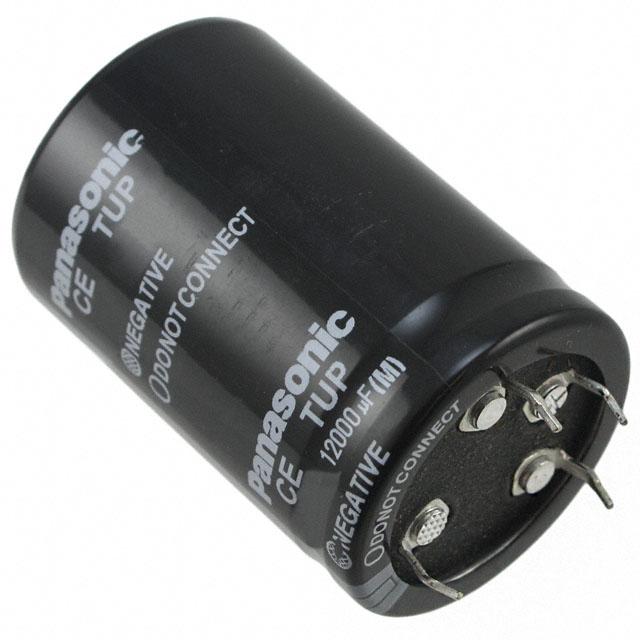

Panasonic Industrial Company T-UP Series Aluminum Electrolytic Capacitors 85°C, 3000 hours  4 or 5 terminal mounting provides stability and keyed polarity  Extended CV ratings  Can vent construction Rated Working Voltage: Operating Temperature: Nominal Capacitance: Capacitance Tolerance: Dissipation Factor: (120 Hz, +20°C) RoHS Compliant 6 ~ 250 VDC -40 ~ +85°C 200~270000µF 350 ~ 500 VDC -25 ~ +85°C 270~2700µF ± 20% 6 50 Working Voltage [V]: Max. D.F. (%): 25 40 35 35 50 30 63 25 00 20 60 ~ 500 5 (rated cap. [µF] - 33000 ) 000 For capacitance values > 33000µF, add the value of: Leakage Current: Ripple Current Multipliers: 80 20 3¥CV (µA) max. after 5 minutes; C = Capacitance in µF, V = WV Frequency(Hz): 16~100WV: 160~450WV: 50 0.93 0.75 Endurance: 60 0.95 0.8 100~120 1.0 1.0 500 1.05 1.2 1k 1.08 1.25 10k 1.15 1.4 Ripple Current Ambient Temperature Factors** Temperature (°C): 85°C 70°C 60°C Multiplier: 1.0 1.3 1.4 ”45°C 1.5 3000 hours at +85°C with maximum specified ripple current (see page 4) **Use of temperature ripple current multipliers may limit life to the hours specified for the maximum operating temperature. Part Number System E C E C Series Code Terminals Prefix No. of Pins ECEC 4 ECEP 5 1C 16 1E 25 1V 35 1H 50 RoHS compliant PVC sleeve and top plate is standard. P 1J 63 Capacitance Code Voltage Code 1K 2A 2C 2D 2E 2V 2G 2W 2H 80 100 160 200 250 350 400 450 500 Diameter Code Dia. Code 35 E 40 F 50 H Terminal Suffix Code Standard Extended Ratings Ratings Terminal Type 6.3mm Snap-in (Standard): 4.0mm Snap-in: 4.0mm Straight with Standoff: A 4 E X 5 Y Dimensions in millimeters 4 Pin Mounting Style 60° 60° (+) + 30° 30° Isolate P.C. Pads T L Circuit Board Mounting Holes (-) Ø22.5±0.1 4 x Ø2.0±0.1 ØD 60° 5 Pin Mounting Style 60° (+) + 30° + (+) Isolate P.C. Pad (-) 60° (-) L Pin Dimensions 2.0 max. T 0.8 4.0 +0.2 -0.1 1.5±0.2 T = 6.3mm Length Snap-in Terminal Standard on 4 and 5 Pin Products 24 2.0 max. 0.8 +0.2 0.8 -0.1 Top of Capacitor Body 6.3±1.0 Ø25.0±0.1 5 x Ø2.0±0.1 ØD 3.5 Circuit Board Mounting Holes +0.2 -0.1 1.5 6.0±1 4.0±0.5 1.5±0.2 T = 4mm Length Snap-in Terminal Available on 4 Pin Product only 5.0 2.0 max. T = 4mm Length Straight Standoff Pin Terminal Available on 4 and 5 Pin Products Design and specifications are subject to change without notice. Contact the factory or your sales representative for technical specifications before purchase and/or use. When safety concerns arise, please contact Panasonic immediately for technical consultation. Panasonic Industrial Company T-UP Standard Ratings Cap. (µF) 47000 56000 68000 82000 00000 20000 50000 80000 220000 270000 33000 39000 47000 56000 68000 82000 00000 20000 50000 80000 22000 27000 33000 39000 47000 56000 68000 82000 00000 20000 5000 8000 22000 27000 33000 39000 47000 56000 68000 Size (mm) DxL Max 85°C R.C. (Arms) 120Hz 35 40 35 35 40 35 40 35 40 50 50 40 50 50 50 x x x x x x x x x x x x x x x 40 40 50 63 50 80 63 05 80 50 63 05 80 92 05 7.47 9.05 9.05 0.02 0.29 .00 .36 2.8 2.42 3.7 4.40 4.85 5.69 6.73 7.79 35 40 35 35 40 35 40 50 35 40 50 50 40 50 50 x x x x x x x x x x x x x x x 40 40 50 63 50 80 63 50 05 80 63 80 05 92 05 6.84 8.00 8.00 8.85 8.96 0.43 0.25 2.29 .97 2.08 3.45 5.29 4.07 6.0 6.89 35 40 35 35 40 35 40 40 50 35 50 40 50 50 50 x x x x x x x x x x x x x x x 40 40 50 63 50 80 63 80 50 05 63 05 80 92 05 6.0 6.84 7.5 7.94 7.98 9.53 9.58 0.30 0.94 0.62 .93 2.02 3.06 3.97 4.86 35 40 35 35 40 35 40 50 40 35 50 40 50 50 x x x x x x x x x x x x x x 40 40 50 63 50 80 63 50 80 05 63 05 80 92 6.44 6.94 7.57 8.3 8.2 9.23 9.0 0.48 0.2 0.27 .54 .47 2.46 3.7 20°C ESR (Ȏ, max.) 10kHz~ 120Hz 20kHz 16 VDC Working, 20 VDC Surge 8.59 0.02 0.09 0.4 0.022 0.02 0.4 0.08 0.07 .52 0.06 0.05 .83 0.06 0.05 2.65 0.05 0.04 3.06 0.08 0.07 4.73 0.04 0.03 4.28 0.07 0.06 5.5 0.04 0.03 6.56 0.02 0.0 7.08 0.03 0.02 8.04 0.0 0.00 9.24 0.00 0.009 20.46 0.009 0.008 25 VDC Working, 32 VDC Surge 7.87 0.09 0.05 9.20 0.020 0.08 9.20 0.04 0.02 0.8 0.05 0.03 0.30 0.06 0.05 .99 0.03 0.0 .79 0.07 0.05 4.3 0.06 0.05 3.77 0.00 0.008 3.89 0.02 0.0 5.47 0.04 0.03 7.58 0.02 0.0 6.8 0.0 0.00 8.4 0.0 0.00 9.42 0.00 0.009 35 VDC Working, 44 VDC Surge 7.02 0.026 0.020 7.87 0.02 0.07 8.22 0.08 0.04 9.3 0.05 0.02 9.8 0.07 0.04 0.96 0.04 0.0 .02 0.06 0.03 .85 0.05 0.02 2.58 0.05 0.02 2.2 0.00 0.008 3.72 0.03 0.0 3.82 0.02 0.009 5.02 0.02 0.00 6.07 0.0 0.009 7.09 0.00 0.008 50 VDC Working, 63 VDC Surge 7.4 0.028 0.02 7.98 0.023 0.07 8.7 0.02 0.07 9.56 0.08 0.05 9.34 0.08 0.05 0.6 0.05 0.02 0.47 0.08 0.04 2.05 0.08 0.04 .64 0.05 0.02 .8 0.04 0.0 3.27 0.03 0.00 3.9 0.02 0.009 4.33 0.02 0.009 5.5 0.0 0.009 Aluminum Electrolytic Capacitors Part numbers shown with 6.3mm Length Snap-in Terminals Panasonic Part Number 4 Pin Style 5 Pin Style ECET1CP473EA ECET1CP563FA ECET1CP683EA ECET1CP823EA ECET1CP823FA ECET1CP104EA ECET1CP104FA ECET1CP124EA ECET1CP124FA ECET1CP184FA ECET1EP333EA ECET1EP393FA ECET1EP473EA ECET1EP563EA ECET1EP563FA ECET1EP683EA ECET1EP683FA ECET1EP104EA ECET1EP104FA ECET1EP154FA ECET1VP223EA ECET1VP273FA ECET1VP333EA ECET1VP393EA ECET1VP393FA ECET1VP473EA ECET1VP473FA ECET1VP563FA ECEP1CP563FA ECEP1CP823FA ECEP1CP104FA ECEP1CP124FA ECEP1CP124HA ECEP1CP154HA ECEP1CP184FA ECEP1CP184HA ECEP1CP224HA ECEP1CP274HA ECEP1EP393FA ECEP1EP563FA ECEP1EP683FA ECEP1EP823HA ECEP1EP104FA ECEP1EP104HA ECEP1EP124HA ECEP1EP154FA ECEP1EP154HA ECEP1EP184HA ECEP1VP273FA ECEP1VP393FA ECEP1VP473FA ECEP1VP563FA ECEP1VP563HA ECET1VP683EA ECET1VP823FA ECET1HP153EA ECET1HP183FA ECET1HP223EA ECET1HP273EA ECET1HP273FA ECET1HP333EA ECET1HP333FA ECET1HP393FA ECET1HP473EA ECET1HP563FA ECEP1VP683HA ECEP1VP823FA ECEP1VP823HA ECEP1VP104HA ECEP1VP124HA ECEP1HP183FA ECEP1HP273FA ECEP1HP333FA ECEP1HP333HA ECEP1HP393FA ECEP1HP473HA ECEP1HP563FA ECEP1HP563HA ECEP1HP683HA Design and specifications are subject to change without notice. Contact the factory or your sales representative for technical specifications before purchase and/or use. When safety concerns arise, please contact Panasonic immediately for technical consultation. 25 Panasonic Industrial Company T-UP Standard Ratings (continued) Cap. (µF) Size (mm) DxL Max 85°C R.C. (Arms) 82000 50 x 05 3.87 0000 2000 35 35 40 35 40 35 40 35 40 50 40 50 50 50 50 x x x x x x x x x x x x x x x 40 50 40 63 50 80 63 05 80 50 05 63 80 92 05 6.52 7.5 7.5 7.7 7.53 9.4 9.25 0.38 9.97 0.86 .76 .67 2.78 3.34 3.93 35 35 40 35 40 35 40 40 50 35 50 40 50 50 50 x x x x x x x x x x x x x x x 40 50 40 63 50 80 63 80 50 05 63 05 80 92 05 5.6 5.83 5.83 6.38 6.56 6.92 7.29 8.93 0.00 9.86 .08 .35 2.33 3.37 4.34 35 40 35 35 40 35 40 50 35 40 40 50 50 50 50 x x x x x x x x x x x x x x x 40 40 50 63 50 80 63 50 05 80 05 63 80 92 05 5.3 5.75 6.60 7.05 7.28 7.74 7.97 8.82 8.57 8.65 0.2 0.07 .00 .76 2.53 35 35 40 35 40 35 40 40 50 35 50 40 50 x x x x x x x x x x x x x 40 50 40 63 50 80 63 80 50 05 63 05 80 4.78 5.45 5.45 6.29 6.29 7.27 7.27 8.32 8.25 9.05 8.93 9.86 9.80 5000 5000 8000 27000 33000 47000 5000 56000 6800 8200 0000 2000 5000 8000 22000 27000 33000 39000 4700 5600 6800 8200 0000 2000 5000 8000 22000 27000 2200 2700 3300 3900 5600 6800 8200 0000 26 120Hz 20°C ESR (ȍ, max.) 10kHz~ 120Hz 20kHz 50 VDC Working, 63 VDC Surge (continued) 5.95 0.0 0.008 63 VDC Working, 79 VDC Surge 7.50 0.04 0.033 8.22 0.035 0.028 8.22 0.035 0.028 8.87 0.028 0.022 8.66 0.033 0.027 0.82 0.023 0.08 0.64 0.028 0.022 .94 0.05 0.02 .47 0.08 0.05 2.49 0.08 0.05 3.52 0.05 0.02 3.42 0.07 0.03 4.70 0.03 0.00 5.34 0.02 0.00 6.02 0.02 0.009 80 VDC Working, 05 VDC Surge 5.93 0.046 0.035 6.70 0.038 0.029 6.70 0.038 0.029 7.34 0.033 0.025 7.54 0.033 0.025 7.96 0.028 0.02 8.38 0.028 0.02 0.27 0.024 0.08 .50 0.023 0.07 .34 0.05 0.0 2.74 0.09 0.04 3.05 0.05 0.02 4.8 0.05 0.02 5.38 0.04 0.00 6.49 0.03 0.00 100 VDC Working, 25 VDC Surge 5.90 0.07 0.049 6.6 0.059 0.044 7.59 0.049 0.037 8. 0.040 0.030 8.37 0.040 0.030 8.90 0.033 0.025 9.7 0.033 0.025 0.4 0.033 0.025 9.86 0.028 0.02 9.95 0.028 0.02 .64 0.022 0.07 .58 0.022 0.07 2.65 0.08 0.04 3.52 0.05 0.0 4.4 0.04 0.00 160 VDC Working, 200 VDC Surge 6.69 0.098 0.049 7.63 0.080 0.044 7.63 0.080 0.044 8.8 0.065 0.036 8.8 0.065 0.036 0.8 0.055 0.030 0.8 0.055 0.030 .65 0.038 0.02 .55 0.038 0.02 2.67 0.032 0.07 2.50 0.026 0.04 3.80 0.022 0.02 3.72 0.022 0.02 Aluminum Electrolytic Capacitors Part numbers shown with 6.3mm Length Snap-in Terminals Panasonic Part Number 4 Pin Style 5 Pin Style ECEP1HP823HA ECET1JP103EA ECET1JP123EA ECET1JP123FA ECET1JP153EA ECET1JP153FA ECET1JP183EA ECET1JP183FA ECET1JP273EA ECET1JP273FA ECET1JP333FA ECET1KP682EA ECET1KP822EA ECET1KP822FA ECET1KP103EA ECET1KP103FA ECET1KP123EA ECET1KP123FA ECET1KP153FA ECEP1JP123FA ECEP1JP153FA ECEP1JP183FA ECEP1JP273FA ECEP1JP273HA ECEP1JP333FA ECEP1JP333HA ECEP1JP473HA ECEP1JP513HA ECEP1JP563HA ECEP1KP822FA ECEP1KP103FA ECEP1KP123FA ECEP1KP153FA ECEP1KP183HA ECET1KP223EA ECET1KP273FA ECET2AP472EA ECET2AP562FA ECET2AP682EA ECET2AP822EA ECET2AP822FA ECET2AP103EA ECET2AP103FA ECET2AP123EA ECET2AP123FA ECET2AP153FA ECET2CP222EA ECET2CP272EA ECET2CP272FA ECET2CP332EA ECET2CP332FA ECET2CP392EA ECET2CP392FA ECET2CP562FA ECEP2CP562HA ECET2CP682EA ECEP2CP822HA ECET2CP103FA ECEP1KP223HA ECEP1KP273FA ECEP1KP273HA ECEP1KP333HA ECEP1KP393HA ECEP2AP562FA ECEP2AP822FA ECEP2AP103FA ECEP2AP103HA ECEP2AP123FA ECEP2AP153FA ECEP2AP153HA ECEP2AP183HA ECEP2AP223HA ECEP2AP273HA ECEP2CP272FA ECEP2CP332FA ECEP2CP392FA ECEP2CP562FA ECEP2CP562HA ECEP2CP822HA ECEP2CP103FA ECEP2CP103HA Design and specifications are subject to change without notice. Contact the factory or your sales representative for technical specifications before purchase and/or use. When safety concerns arise, please contact Panasonic immediately for technical consultation. Panasonic Industrial Company T-UP Standard Ratings (continued) Part numbers shown with 6.3mm Length Snap-in Terminals 20°C ESR (ȍ, max.) Panasonic Part Number 4 Pin Style 10kHz~ 120Hz 20kHz 5 Pin Style 160 VDC Working, 200 VDC Surge (continued) ECEP2CP123HA 8.0 0.08 0.00 ECEP2CP153HA 9.74 0.04 0.008 200 VDC Working, 250 VDC Surge ECET2DP182EA 6.05 0.20 0.060 ECET2DP222EA 6.89 0.098 0.054 ECET2DP222FA ECEP2DP222FA 6.89 0.098 0.054 ECET2DP272EA 7.70 0.080 0.044 ECET2DP272FA ECEP2DP272FA 7.57 0.080 0.044 ECET2DP332EA 9.02 0.065 0.036 ECET2DP332FA ECEP2DP332FA 8.85 0.065 0.036 ECET2DP392EA 9.24 0.055 0.030 ECET2DP392FX ECEP2DP392FX 9.53 0.055 0.030 ECEP2DP392HA .5 0.055 0.030 ECEP2DP472FA ECET2DP472FA .73 0.046 0.025 ECEP2DP472HA 3.05 0.046 0.025 ECET2DP562EA 2.46 0.038 0.02 ECEP2DP562HA 3.40 0.038 0.02 ECET2DP682FA ECEP2DP682FA 2. 0.032 0.07 ECEP2DP682HA 5.97 0.032 0.07 ECEP2DP752HA 7.9 0.029 0.06 ECEP2DP822HX 8.23 0.026 0.04 ECEP2DP822HA 8.42 0.026 0.04 ECEP2DP103HA 9.84 0.02 0.0 250 VDC Working, 300 VDC Surge ECET2EP122EA 4.65 0.66 0.083 ECET2EP152EA 5.66 0.33 0.066 ECEP2EP152FA ECET2EP152FA 5.66 0.33 0.066 ECET2EP182EA 6.29 0. 0.055 ECET2EP182FA ECEP2EP182FA 6.29 0. 0.055 ECET2EP222EX 6.58 0.090 0.045 ECET2EP222EA 6.92 0.090 0.045 ECEP2EP222FA ECET2EP222FA 6.92 0.090 0.045 ECET2EP272EA 7.88 0.074 0.037 ECEP2EP272FX ECET2EP272FX 8.3 0.074 0.037 ECEP2EP272HA 9.48 0.074 0.037 ECET2EP332FA ECEP2EP332FA 9.80 0.060 0.030 ECEP2EP332HX 0. 0.060 0.060 ECEP2EP332HA 0.9 0.060 0.030 ECET2EP392EA 0.46 0.05 0.026 ECET2EP392FA ECEP2EP392FA 0.30 0.05 0.026 ECEP2EP392HA .47 0.05 0.026 ECET2EP472FA ECEP2EP472FA 2.43 0.042 0.02 ECEP2EP472HA 3.5 0.042 0.02 ECEP2EP562HX 4.59 0.036 0.08 ECEP2EP562HA 5.2 0.036 0.08 ECEP2EP682HA 7.02 0.029 0.05 ECEP2EP752HA 7.58 0.026 0.04 350 VDC Working, 400 VDC Surge ECET2VP471EA 3.36 0.388 0.75 ECET2VP681EA 4.4 0.366 0.65 ECET2VP681FA ECEP2VP681FA 4.4 0.366 0.65 ECET2VP102EA 5.32 0.249 0.2 ECET2VP102FA ECEP2VP102FA 5.32 0.249 0.2 ECET2VP122EA 6.9 0.207 0.093 ECET2VP122FA ECEP2VP122FA 6.9 0.207 0.093 ECEP2VP122HA 7.25 0.207 0.093 ECEP2VP152HA 8.4 0.66 0.075 ECET2VP182EA 8. 0.38 0.062 ECET2VP182FA ECEP2VP182FA 8.9 0.38 0.062 ECEP2VP182HA 9.65 0.38 0.062 Cap. (µF) Size (mm) DxL Max 85°C R.C. (Arms) 2000 5000 50 x 92 50 x 05 2.93 4.0 800 2200 35 35 40 35 40 35 40 35 40 50 40 50 35 50 40 50 50 50 50 50 x x x x x x x x x x x x x x x x x x x x 40 50 40 63 50 80 63 80 63 50 80 63 05 63 05 80 92 92 05 05 4.32 4.92 4.92 5.50 5.4 6.44 6.32 6.60 6.8 8.22 8.38 9.32 8.90 9.57 8.65 .4 2.28 3.02 3.6 4.7 40 50 40 63 50 63 80 63 80 63 50 80 50 63 05 80 63 05 80 80 92 05 05 3.32 4.04 4.04 4.49 4.49 4.70 4.94 4.94 5.63 5.8 6.77 7.00 7.22 7.79 7.47 7.36 8.9 8.88 9.65 0.42 0.80 2.6 2.56 40 50 40 63 50 80 63 50 63 05 80 80 2.40 2.96 2.96 3.80 3.80 4.42 4.42 5.8 6.0 5.79 5.85 6.89 2700 3300 3900 4700 5600 6800 7500 8200 0000 200 500 800 2200 2700 3300 3900 4700 5600 6800 7500 470 680 000 200 500 800 35 35 40 35 40 35 35 40 35 40 50 40 50 50 35 40 50 40 50 50 50 50 50 35 35 40 35 40 35 40 50 50 35 40 50 x x x x x x x x x x x x x x x x x x x x x x x x x x x x x x x x x x x 120Hz Aluminum Electrolytic Capacitors Design and specifications are subject to change without notice. Contact the factory or your sales representative for technical specifications before purchase and/or use. When safety concerns arise, please contact Panasonic immediately for technical consultation. 27 Panasonic Industrial Company Aluminum Electrolytic Capacitors T-UP Standard Ratings (continued) Cap. (µF) Size (mm) DxL 2200 40 x 05 50 x 92 50 x 05 2700 470 560 680 820 000 200 500 800 2200 2700 330 470 560 680 820 000 200 500 800 270 330 390 470 560 680 820 000 28 35 35 40 40 35 40 35 40 50 35 40 50 50 35 40 50 50 40 50 50 50 50 50 x x x x x x x x x x x x x x x x x x x x x x x 45 50 40 50 63 50 80 63 50 80 63 50 63 05 80 63 80 05 80 92 92 05 05 35 35 40 35 35 40 35 40 50 40 50 35 40 50 50 40 50 50 50 50 x x x x x x x x x x x x x x x x x x x x 40 50 40 63 80 50 80 63 50 80 63 05 80 63 80 05 80 92 92 05 35 40 35 35 40 40 50 35 50 50 35 40 50 50 x x x x x x x x x x x x x x 40 40 50 63 50 63 50 80 50 63 05 80 63 80 Part numbers shown with 6.3mm Length Snap-in Terminals Max 85°C R.C. (Arms) 20°C ESR (ȍ, max.) Panasonic Part Number 4 Pin Style 5 Pin Style 120Hz 10kHz~ 120Hz 20kHz 350 VDC Working, 400 VDC Surge (continued) ECEP2VP222FA ECET2VP222FA 6.9 9.67 0.3 0.05 ECEP2VP222HA 7.79 0.9 0.3 0.05 ECEP2VP272HA 8.80 2.32 0.092 0.04 400 VDC Working, 450 VDC Surge ECET2GP471EA 2.39 3.35 0.388 0.36 ECET2GP561EA 2.72 3.8 0.326 0.4 ECET2GP561FA ECEP2GP561FA 2.69 3.77 0.326 0.4 ECET2GP681FA ECEP2GP681FA 3.38 4.73 0.268 0.093 ECET2GP821EA 3.55 4.97 0.222 0.078 ECET2GP821FA ECEP2GP821FA 3.38 4.73 0.222 0.078 ECET2GP102EA 3.42 4.79 0.99 0.080 ECET2GP102FA ECEP2GP102FA 4.6 5.82 0.99 0.080 ECEP2GP102HA 4.76 6.66 0.99 0.080 ECET2GP122EA 4.52 6.33 0.52 0.053 ECEP2GP122FA ECET2GP122FA 4.52 6.33 0.52 0.053 ECEP2GP122HX 5.2 7.29 0.66 0.066 ECEP2GP122HA 5.47 7.66 0.66 0.066 ECET2GP152EA 5.44 7.62 0.22 0.043 ECEP2GP152FA ECET2GP152FA 5.50 7.70 0.22 0.043 ECEP2GP152HX 6.2 8.57 0.33 0.053 ECEP2GP152HA 6.47 9.06 0.33 0.053 ECEP2GP182FA ECET2GP182FA 6.53 9.4 0.0 0.035 ECEP2GP182HX 7.09 9.93 0. 0.044 ECEP2GP182HA 7.35 0.29 0. 0.044 ECEP2GP222HX 8.3 .38 0.090 0.036 ECEP2GP222HA 8.43 .80 0.090 0.036 ECEP2GP272HA 9.34 3.08 0.073 0.025 450 VDC Working, 500 VDC Surge ECET2WP331EA 2.0 2.8 0.553 0.249 ECET2WP471EA 2.53 3.54 0.423 0.233 ECEP2WP471FA ECET2WP471FA 2.53 3.54 0.423 0.233 ECET2WP561EA 2.90 4.06 0.355 0.95 ECET2WP681EA 3.7 4.44 0.293 0.6 ECEP2WP681FA ECET2WP681FA 3.5 4.4 0.293 0.6 ECET2WP821EA 3.78 5.29 0.243 0.33 ECEP2WP821FA ECET2WP821FA 3.70 5.8 0.243 0.33 ECEP2WP821HA 4.3 6.03 0.263 0.45 ECEP2WP102FA ECET2WP102FA 4.2 5.89 0.26 0.9 ECEP2WP102HA 4.96 6.94 0.26 0.9 ECET2WP122EA 4.80 6.72 0.66 0.09 ECEP2WP122FA ECET2WP122FA 4.84 6.78 0.66 0.09 ECEP2WP122HX 5.43 7.60 0.80 0.099 ECEP2WP122HA 5.7 7.99 0.80 0.099 ECEP2WP152FA ECET2WP152FA 5.8 8.3 0.33 0.073 ECEP2WP152HX 6.5 8.6 0.44 0.079 ECEP2WP152HA 6.55 9.7 0.44 0.079 ECEP2WP182HX 7.02 9.83 0.20 0.066 ECEP2WP182HA 7.36 0.30 0.20 0.066 500 VDC Working, 550 VDC Surge ECET2HP271EA .76 2.46 0.64 0.276 ECEP2HP331FA ECET2HP331FA 2.6 3.02 0.502 0.276 ECET2HP391EA 2.22 3. 0.425 0.234 ECET2HP471EA 2.58 3.6 0.353 0.94 ECEP2HP471FA ECET2HP471FA 2.70 3.78 0.353 0.94 ECEP2HP561FA ECET2HP561FA 3. 4.35 0.326 0.79 ECEP2HP561HA 3.52 4.93 0.355 0.95 ECET2HP681EA 3.2 4.49 0.244 0.34 ECEP2HP681HX 3.88 5.43 0.293 0.6 ECEP2HP681HA 4.07 5.70 0.293 0.6 ECET2HP821EA 3.97 5.56 0.202 0. ECEP2HP821FA ECET2HP821FA 3.88 5.43 0.222 0.22 ECEP2HP821HA 4.47 6.26 0.222 0.22 ECEP2HP102HA 5.05 7.07 0.99 0.09 Design and specifications are subject to change without notice. Contact the factory or your sales representative for technical specifications before purchase and/or use. When safety concerns arise, please contact Panasonic immediately for technical consultation. Panasonic Industrial Company Aluminum Electrolytic Capacitors T-UP Standard Ratings (continued) Cap. (µF) Size (mm) DxL 200 40 50 50 50 500 x x x x 05 80 92 05 Part numbers shown with 6.3mm Length Snap-in Terminals Max 85°C R.C. (Arms) 20°C ESR (ȍ, max.) Panasonic Part Number 4 Pin Style 5 Pin Style 120Hz 10kHz~ 120Hz 20kHz 500 VDC Working, 550 VDC Surge (continued) ECET2HP122FA ECEP2HP122FA 5.90 8.26 0.52 0.084 ECEP2HP122HX 5.35 7.49 0.66 0.09 ECEP2HP122HA 5.74 8.04 0.66 0.09 ECEP2HP152HA 6.65 9.3 0.44 0.079 Design and specifications are subject to change without notice. Contact the factory or your sales representative for technical specifications before purchase and/or use. When safety concerns arise, please contact Panasonic immediately for technical consultation. 29

物料型号:Panasonic工业公司生产的铝电解电容器,T-UP系列。
器件简介:该系列电容器设计用于在85°C下工作3000小时,具有4个或5个引脚的安装方式,提供稳定性和带键的极性。扩展的CV等级,可以进行排气构造。
引脚分配:提供了两种安装风格,4引脚和5引脚,每种风格都有详细的安装孔和引脚尺寸说明。
参数特性: - 额定工作电压范围从16VDC到500VDC。 - 工作温度范围从-40°C到+85°C。 - 标称电容值从1200μF到2700μF,以及从270μF到2700μF。 - 电容公差为±20%。 - 在120Hz和+20°C下,耗散因子(Dissipation Factor)的最大值根据工作电压和电容值有所不同。
功能详解:包括漏电流、纹波电流乘数、耐久性(3000小时在+85°C下,符合最大规定的纹波电流)等详细参数。
应用信息:文档提供了零件编号系统,包括RoHS兼容的PVC套筒和顶板。
封装信息:详细列出了不同电压代码、电容值、直径代码和引脚类型的编码方式。
