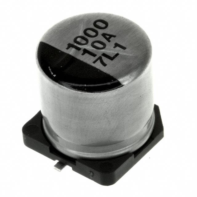

    470 µF 10 V 铝电解电容器 径向,Can - SMD 85°C 时为 2000 小时
ECE-V1AA471P 数据手册
Aluminum Electrolytic Capacitors/S Surface Mount Type Aluminum Electrolytic Capacitors Series: Type: Japan S V Surface mount type ■ Features ● Lifetime: 85 ûC 2000 h ● 5.5 mm (< f6.3) height ■ Recommended Applications ● AV (TV, Video, Audio), Personal Computer, Home appliance ■ Specifications Operating Temp. Range Ð40 to +85 ûC Rated W.V. Range 4 to 100 V.DC Nominal Cap. Range 0.1 to 1000 µF Capacitance Tolerance DC Leakage Current Dissipation Factor ±20 % (120 Hz/+20 ûC) W.V. (V) 4 6.3 10 16 25 f4~f6.3 0.35 0.26 (0.35) 0.20 (0.30) 0.16 (0.26) 0.14 D.F. f8~f10 0.40 0.35 0.26 0.20 0.16 Add 0.02 to D.F. for f3 case size. ( ) is applied to miniature Bi-polar Characteristics at Low Temperature ( Whichever, greater ) I < 0.01 CV or 3 (µA) after 2 minutes (Bi-polar: I < 0.02 CV or 6 (µA)) W.V. (V) D.F. W.V. (V) Ð25/+20 ûC Ð40/+20 ûC 4 7 15 6.3 0.52 6.3 4 8 10 0.40 10 3 6 16 0.32 16 2 4 25 0.28 25 2 4 35 0.24 35 2 3 35 0.12 0.14 50 0.12 0.12 63 3 4 100 3 4 50 0.24 50 2 3 63 100 Ñ Ñ 0.18 0.18 (120 Hz/+20 ûC) (max.) ( ) Impedance ratio at 120 Hz After applying rated working voltage for 2000 hours at +85 ûC and then being stabilized at +20 ûC, capacitors shall meet the following limits Endurance Shelf Life Resistance to Soldering Heat Capacitance change ±20 % of initial measured value (f3, 4 W.V. and miniature of 6.3 W.V.: 1000h±30 %) D.F. < 200 % of initial specified value DC leakage current < Initial specified value After storage for 1000 hours at +85 ûC with no voltage applied and then being stabilized at +20 ûC, capacitor shall meet the limits specified in ÒEnduranceÓ. (With voltage treatment) After reflow soldering (Refer to page 20 for recommendable temperature profile) and then being stabilized at +20 ûC, capacitor shall meet the following limits. Capacitance change D.F. DC leakage current ±10 % of initial measured value < Initial specified value < Initial specified value Design and Specifications are subject to change without notice. Ask factory for technical specifications before purchase and/or use. Whenever a doubt about safety issues arises from this product, please inform us immediately for technical consultation. Aluminum Electrolytic Capacitors/S ■ Explanation of Part Numbers ■ Marking ■ Dimensions in mm (not to scale) ± ± + + ± A B C D E F G (mm) D L A H 3.0 5.4 3.3 4.5 MAX 4.0 5.4 4.3 5.5 MAX 5.0 5.4 5.3 6.5 MAX 6.3 5.4 6.6 7.8 MAX 8.0 6.2 8.3 9.5 MAX 8.0 10.2 8.310.0 MAX 10.0 10.2 10.3 12.0 MAX ■ Case size/Ripple current ● Polarized ( ) is applied to miniature W.V. (V) Cap. (µF) 0.1 0.22 0.33 0.47 1.0 2.2 3.3 4.7 10 22 33 47 100 220 330 470 1000 (0R1) (R22) (R33) (R47) (010) (2R2) (3R3) (4R7) (100) (220) (330) (470) (101) (221) (331) (471) (102) 4 (0G) A B B C D W 0.55±0.1 0.65±0.1 0.65±0.1 0.65±0.1 0.65±0.1 0.90±0.2 0.90±0.2 P 0.6 1.0 1.5 1.8 2.2 3.1 4.6 K 0.35 +0.15 Ð0.20 0.35 +0.15 Ð0.20 +0.15 0.35 Ð0.20 +0.15 0.35 Ð0.20 0.35 +0.15 Ð0.20 0.70±0.2 0.70±0.2 (mA) r.m.s. (120 Hz/+85 ûC) 6.3 (0J) 19 26 34 61 82 I 1.5 1.8 2.2 2.6 3.4 3.4 3.5 10 (1A) B(A) 29(20) (B) (B) (22) C(B) C 46 (C) D 71 D E E 300 F F 380 G(F) G 700 G 16 (1C) 25 (1E) 35 (1V) A A A,B 12,22 B A,B 20,28 C 28 C (28) C(B) 39(28) D 55 D 43(29) (C) (35) D 65 E (43) D(C) 70(39) E 70 E(D) 200(70) F(E) 180(91) G(F) 250 F 280 G(F) 310(140) G 330 G(F) 380(320) 400(330) G 420 580 50 (1H) A,B 1,1 A,B 2,2 A,B 3,3 A,B 5,5 A,B 8,10 8 B 16 10 B 16 22 C 23 30 D 35 60 E 120 130 F(E) 110(65) 165 G(F) 130(110) 210(140) G 250 310 63 (1J) E F F 35 40 45 G 60 100 (2A) E F F G G 50 80 85 85 90 Size code Ripple current ● Bi-polar Cap. (µF) ( W.V. (V) 0.22 0.33 0.47 1.0 2.2 3.3 4.7 10 22 33 47 (R22) (R33) (R47) (010) (2R2) (3R3) (4R7) (100) (220) (330) (470) 6.3 (0J) C 29 D 46 ) shows W.V. and capacitance code. 10 (1A) B 25 D 43 16 (1C) B C D 20 25 39 25 (1E) B C D 12 21 28 35 (1V) B 12 C D 22 30 50 (1H) B 2 B 3 B 5 B 10 C 16 C* 21 D 31 Size code Ripple current * Part number is EEVNZ1H3R31 Design and Specifications are subject to change without notice. Ask factory for technical specifications before purchase and/or use. Whenever a doubt about safety issues arises from this product, please inform us immediately for technical consultation. Aluminum Electrolytic Capacitors/S ■ Standard Products Case size W.V. Cap. (±20%) (V) 4 6.3 10 Length Specification S i z e Ripple Code current (120Hz) (+85˚C) (mA) D.F. Part No. Life Time Min. Packaging Q'ty Taping (mm) (mm) 3 5.4 A 19 0.37 1000 ECEV0GS220SR 2000 33 4 5.4 B 26 0.35 1000 ECEV0GA330SR 2000 47 4 5.4 B 34 0.35 1000 ECEV0GA470SR 2000 100 4 5.4 B 61 0.35 1000 ECEV0GA101SR 1000 220 6.3 5.4 D 82 0.35 1000 ECEV0GA221SP 1000 22 3 5.4 A 20 0.35 1000 ECEV0JS220WR 2000 4 5.4 B 29 0.26 2000 ECEV0JA220SR 2000 (µF) 22 (pcs) (hours) 33 4 5.4 B 22 0.35 1000 ECEV0JA330WR 2000 47 5 5.4 C 46 0.26 2000 ECEV0JA470SR 1000 100 6.3 5.4 D 71 0.26 2000 ECEV0JA101SP 1000 330 8 6.2 E 300 0.35 2000 ECEV0JA331P 1000 500 470 8 10.2 F 380 0.35 2000 ECEV0JA471P 1000 10 10.2 G 700 0.35 2000 ECEV0JA102P 22 4 5.4 B 28 0.30 2000 ECEV1AA220WR 2000 33 4 5.4 B 29 0.30 2000 ECEV1AA330WR 2000 5 5.4 C 43 0.20 2000 ECEV1AA330SR 1000 47 5 5.4 C 43 0.30 2000 ECEV1AA470WR 1000 100 6.3 5.4 D 70 0.20 2000 ECEV1AA101SP 1000 220 8 6.2 E 250 0.26 2000 ECEV1AA221P 1000 330 8 10.2 F 330 0.26 2000 ECEV1AA331P 500 470 8 10.2 F 330 0.26 2000 ECEV1AA471UP 500 10 10.2 G 400 0.26 2000 ECEV1AA471P 500 1000 10 10.2 G 580 0.26 2000 ECEV1AA102P 10 3 5.4 A 20 0.18 1000 ECEV1CS100SR 4 5.4 B 28 0.16 2000 ECEV1CA100SR 2000 4 5.4 B 28 0.26 2000 ECEV1CA220WR 2000 22 16 Dia. 500 500 2000 5 5.4 C 39 0.16 2000 ECEV1CA220SR 1000 33 5 5.4 C 35 0.26 2000 ECEV1CA330WR 1000 47 5 5.4 C 39 0.26 2000 ECEV1CA470WR 1000 6.3 5.4 D 70 0.16 2000 ECEV1CA470SP 1000 6.3 5.4 D 70 0.26 2000 ECEV1CA101WP 1000 8 6.2 E 200 0.20 2000 ECEV1CA101P 1000 220 8 10.2 F 280 0.20 2000 ECEV1CA221P 500 330 8 10.2 F 320 0.20 2000 ECEV1CA331UP 500 10 10.2 G 380 0.20 2000 ECEV1CA331P 500 10 10.2 G 420 0.20 2000 ECEV1CA471P 500 100 470 The taping dimension are explained on p.00 of our Catalog. Please use it as a reference guide. Design and Specifications are subject to change without notice. Ask factory for technical specifications before purchase and/or use. Whenever a doubt about safety issues arises from this product, please inform us immediately for technical consultation. Aluminum Electrolytic Capacitors/S ■ Standard Products Case size W.V. Cap. (±20%) (V) 25 Length Specification S i z e Ripple Code current (120Hz) (+85˚C) (mA) D.F. Part No. Life Time Min. Packaging Q'ty Taping (mm) (mm) 3 5.4 A 12 0.16 1000 ECEV1ES4R7SR 2000 4 5.4 B 22 0.14 2000 ECEV1EA4R7SR 2000 10 5 5.4 C 28 0.14 2000 ECEV1EA100SR 1000 22 6.3 5.4 D 55 0.14 2000 ECEV1EA220SP 1000 33 6.3 5.4 D 65 0.14 2000 ECEV1EA330SP 1000 100 8 6.2 E 91 0.16 2000 ECEV1EA101UP 1000 8 10.2 F 180 0.16 2000 ECEV1EA101P 500 8 10.2 F 140 0.16 2000 ECEV1EA221UP 500 10 10.2 G 310 0.16 2000 ECEV1EA221P 2.2 3 5.4 A 8 0.14 1000 ECEV1VS2R2SR 2000 3.3 3 5.4 A 10 0.14 1000 ECEV1VS3R3SR 2000 4.7 4 5.4 B 22 0.12 2000 ECEV1VA4R7SR 2000 10 5 5.4 C 30 0.12 2000 ECEV1VA100SR 1000 22 6.3 5.4 D 60 0.12 2000 ECEV1VA220SP 1000 33 8 6.2 E 130 0.14 2000 ECEV1VA330P 1000 47 8 6.2 E 165 0.14 2000 ECEV1VA470P 1000 100 8 10.2 F 140 0.14 2000 ECEV1VA101UP 500 10 10.2 G 210 0.14 2000 ECEV1VA101P 500 10 10.2 G 310 0.14 2000 ECEV1VA221P 3 5.4 A 1 0.14 1000 ECEV1HS0R1SR 4 5.4 B 1 0.12 2000 ECEV1HA0R1SR 2000 3 5.4 A 2 0.14 1000 ECEV1HSR22SR 2000 4 5.4 B 2 0.12 2000 ECEV1HAR22SR 2000 3 5.4 A 3 0.14 1000 ECEV1HSR33SR 2000 4 5.4 B 3 0.12 2000 ECEV1HAR33SR 2000 3 5.4 A 5 0.14 1000 ECEV1HSR47SR 2000 4 5.4 B 5 0.12 2000 ECEV1HAR47SR 2000 3 5.4 A 8 0.14 1000 ECEV1HS010SR 2000 4 5.4 B 10 0.12 2000 ECEV1HA010SR 2000 2.2 4 5.4 B 16 0.12 2000 ECEV1HA2R2SR 2000 3.3 4 5.4 B 16 0.12 1000 ECEV1HA3R3SR 2000 4.7 5 5.4 C 23 0.12 2000 ECEV1HA4R7SR 1000 10 6.3 5.4 D 35 0.12 2000 ECEV1HA100SP 1000 22 8 6.2 E 120 0.12 2000 ECEV1HA220P 1000 33 8 6.2 E 65 0.12 2000 ECEV1HA330UP 1000 8 10.2 F 110 0.12 2000 ECEV1HA330P 500 8 10.2 F 110 0.12 2000 ECEV1HA470UP 500 10 10.2 G 130 0.12 2000 500 10 10.2 G 250 0.12 2000 ECEV1HA470P ECEV1HA101P (µF) 4.7 220 35 Dia. 220 0.1 0.22 0.33 0.47 1 50 47 100 (pcs) (hours) 500 500 2000 500 The taping dimension are explained on p.00 of our Catalog. Please use it as a reference guide. Design and Specifications are subject to change without notice. Ask factory for technical specifications before purchase and/or use. Whenever a doubt about safety issues arises from this product, please inform us immediately for technical consultation. Aluminum Electrolytic Capacitors/S Standard Products ■ W.V. Cap. (±20%) (V) (µF) 10 63 Specification S i z e Ripple current Code (120Hz) (+85ûC) (mm) (m A ) Length (mm) 8 6.2 E 35 D.F. Min.Packaging Q'ty Part No. Life Time Taping (pcs) (hours) 0.18 2000 ECEV1JA100P 1000 22 8 10.2 F 40 0.18 2000 ECEV1JA220P 500 33 8 10.2 F 45 0.18 2000 ECEV1JA330P 500 100 10 10.2 G 60 0.18 2000 ECEV1JA101P 500 8 6.2 E 50 0.18 2000 ECEV2AA3R3P 1000 500 3.3 4.7 100 Case size Dia. 8 10.2 F 80 0.18 2000 ECEV2AA4R7P 10 8 10.2 F 85 0.18 2000 ECEV2AA100P 500 22 10 10.2 G 85 0.18 2000 ECEV2AA220P 500 33 10 10.2 G 90 0.18 2000 ECEV2AA330P 500 The taping dimension are explained on p.24 of our Catalog. Please use it as a reference guide. ■ Standard Products(Bi-polar) Case size W.V. Cap. (±20%) (V) 6.3 10 Min. Packaging Q'ty Taping (mm) 5 5.4 C 29 0.52 ECEV0JA220NR 1000 47 6.3 5.4 D 46 0.52 ECEV0JA470NP 1000 (pcs) 10 4 5.4 B 25 0.40 ECEV1AA100NR 2000 33 6.3 5.4 D 43 0.40 ECEV1AA330NP 1000 10 4.7 10 2.2 50 Part No. D.F. (mm) 3.3 35 Specification S i z e Ripple current Code (120Hz) (+85∞ C) (m A ) 22 22 25 Length (µF) µ 4.7 16 Dia. 4.7 10 4 5.4 B 20 0.32 ECEV1CA4R7NR 2000 5 5.4 C 25 0.32 ECEV1CA100NP 1000 6.3 5.4 D 39 0.32 ECEV1CA220NP 1000 4.0 5.4 B 12 0.28 ECEV1EA3R3NR 2000 5 5.4 C 21 0.28 ECEV1EA4R7NR 1000 6.3 5.4 D 28 0.28 ECEV1EA100NP 1000 4 5.4 B 12 0.24 ECEV1VA2R2NR 2000 5 6.3 5.4 5.4 C D 22 30 0.24 0.24 ECEV1VA4R7NR ECEV1VA100NP 1000 1000 0.22 4 5.4 B 2 0.24 ECEV1HAR22NR 2000 0.33 4 5.4 B 3 0.24 ECEV1HAR33NR 2000 0.47 4 5.4 B 5 0.24 ECEV1HAR47NR 2000 1 4 5.4 B 10 0.24 ECEV1HA010NR 2000 1000 2.2 5 5.4 C 16 0.24 ECEV1HA2R2NR 3.3 5 5.4 C 21 0.24 EEVNZ1H3R3R 1000 4.7 6.3 5.4 D 31 0.24 ECEV1HA4R7NP 1000 Please use it as a reference guide. High temperature Load Life test : 85∞ C 2000h Design and Specifications are subject to change without notice. Ask factory for technical specifications before purchase and/or use. Whenever a doubt about safety issues arises from this product, please inform us immediately for technical consultation.
