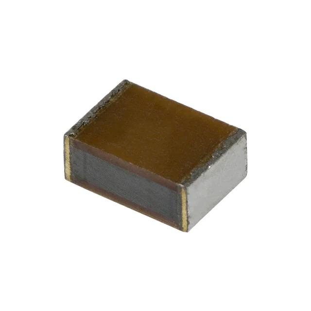

    薄膜电容 2820 82nF ±2% 7.10 x 5.00mm
ECH-U1823GC9 数据手册
Plastic Film Capacitors Stacked Metallized PPS Film Chip Capacitor Series : ECHU(C) Stacked metallized PPS film as dielectric with simple mold-less construction Features ● Small in size loss and excellent frequency characteristics ● For reflow soldering ● RoHS directive compliant ● Low Recommended applications ● Time-constant ● Filtering ● Oscillation and resonance circuit for LCD backlight inverter unit ● Resonance Explanation of part number 1 2 3 4 5 E C H U 1 Product code Dielectric & construction 6 8 9 10 11 C Rated voltage 1 7 Capacitance 100 V.DC Cap. Tol. G ±2 % J ±5 % Suffix Suffix Code Tape width 9 12 mm V 16 mm Specifications Category temp. range (Including temperature-rise on unit surface) Rated voltage Capacitance range – 55 °C to +105 °C 100 V.DC 0.010 µF to 0.22 µF (E12) Capacitance tolerance ±2 %(G), ±5 %(J) Dissipation factor (tan d) tan d < 0.6 % (20 °C, 1 kHz) Withstand voltage Between terminals : Rated volt. (V.DC)×150 %, 60 s Insulation resistance (IR) IR > 3000 MΩ (20 °C, 100 V.DC, 60 s) Reflow soldering : 260 °C max. and 95 sec max. at more than 220 °C (Temp. at capacitor surface) Soldering conditions ✽ In case of applying voltage in alternating current (50 Hz or 60 Hz sine wave) to a capacitor with DC rated voltage, please refer to the page of “Permissible voltage (R.M.S) in alternating current corresponding to DC rated voltage”. Design and specifications are each subject to change without notice. Ask factory for the current technical specifications before purchase and/or use. Should a safety concern arise regarding this product, please be sure to contact us immediately. 01 Feb. 2016 Plastic Film Capacitors Construction Dimensions Unit : mm (±0.4) ✽ W±0.3 H±0.2 (±0.3) ✽ (±0.4) ✽ L±0.2 Size code E1 E2 E3a E3 D1 D2 D3 D4 D5 Z Y Outer electrode Element (Stacked) 0.35±0.20 0.35±0.20 ✽ To be applied only for size code Z, Y L W H 4.8 4.8 4.8 4.8 6.0 6.0 6.0 6.0 6.0 7.1 7.1 3.3 3.3 3.3 3.3 4.1 4.1 4.1 4.1 4.1 5.0 6.3 1.4 2.0 2.4 2.8 1.8 2.0 2.4 2.8 3.2 ✽ ✽ ✽ Refer to the column “ Rating, Dimensions&Quantity” Taping specification for automatic mounting Refer to the page of taping specifications Rating · Dimensions · Quantity ● Capacitance tolerance : ±2 %(G), ±5 %(J) Capacitance (µF) Part No. 0.010 0.012 0.015 0.018 0.022 0.027 0.033 0.039 0.047 0.056 0.068 0.082 0.10 0.12 0.15 0.18 0.22 ECHU1103◻C9 ECHU1123◻C9 ECHU1153◻C9 ECHU1183◻C9 ECHU1223◻C9 ECHU1273◻C9 ECHU1333◻C9 ECHU1393◻C9 ECHU1473◻C9 ECHU1563◻C9 ECHU1683◻C9 ECHU1823◻C9 ECHU1104◻C9 ECHU1124◻C9 ECHU1154◻CV ECHU1184◻CV ECHU1224◻CV Rated voltage 100 V.DC Dimensions (mm) L W H 4.8 3.3 1.4 4.8 3.3 1.4 4.8 3.3 2.0 4.8 3.3 2.0 4.8 3.3 2.4 4.8 3.3 2.8 6.0 4.1 1.8 6.0 4.1 2.0 6.0 4.1 2.4 6.0 4.1 2.8 6.0 4.1 3.2 7.1 5.0 2.8 7.1 5.0 3.0 7.1 5.0 3.4 7.1 6.3 3.4 7.1 6.3 4.0 7.1 6.3 4.8 Size code E1 E1 E2 E2 E3a E3 D1 D2 D3 D4 D5 Z Z Z Y Y Y Q'ty 3000 2000 3000 2000 1500 1000 ✽ ◻ : Capacitance tolerance code Recommended for land dimensions Unit : mm Electrode Size code C Land A B E1, E2, E3a, E3 D1, D2, D3, D4, D5 Z Y Land dimensions Reflow soldering A B C 2.6 6.6 3.0 3.8 7.8 3.8 4.5 9.0 4.6 4.5 9.0 5.7 ✽ lt is not warrantable that you can mount the capacitor without trouble under all the mounting condition when “Recommender for Land dimensions” is adopted. Design and specifications are each subject to change without notice. Ask factory for the current technical specifications before purchase and/or use. Should a safety concern arise regarding this product, please be sure to contact us immediately. 01 Feb. 2016 *XLGHOLQHVDQGSUHFDXWLRQVUHJDUGLQJWKH WHFKQLFDOLQIRUPDWLRQDQGXVHRIRXUSURGXFWV GHVFULEHGLQWKLVRQOLQHFDWDORJ ‫ٹ‬,I\RXZDQWWRXVHRXUSURGXFWVGHVFULEHGLQWKLVRQOLQHFDWDORJIRUDSSOLFDWLRQVUHTXLULQJ VSHFLDOTXDOLWLHVRUUHOLDELOLW\RUIRUDSSOLFDWLRQVZKHUHWKHIDLOXUHRUPDOIXQFWLRQRIWKH SURGXFWVPD\GLUHFWO\MHRSDUGL]HKXPDQOLIHRUSRWHQWLDOO\FDXVHSHUVRQDOLQMXU\  HJDLUFUDIWDQGDHURVSDFHHTXLSPHQWWUDIILFDQGWUDQVSRUWDWLRQHTXLSPHQWFRPEXVWLRQ HTXLSPHQWPHGLFDOHTXLSPHQWDFFLGHQWSUHYHQWLRQDQWLFULPHHTXLSPHQWDQGRUVDIHW\ HTXLSPHQW LWLVQHFHVVDU\WRYHULI\ZKHWKHUWKHVSHFLILFDWLRQVRIRXUSURGXFWVILWWRVXFK DSSOLFDWLRQV3OHDVHHQVXUHWKDW\RXZLOODVNDQGFKHFNZLWKRXULQTXLU\GHVNDVWRZKHWKHU WKHVSHFLILFDWLRQVRIRXUSURGXFWVILWWRVXFKDSSOLFDWLRQVXVHEHIRUH\RXXVHRXUSURGXFWV ‫ٹ‬7KHTXDOLW\DQGSHUIRUPDQFHRIRXUSURGXFWVDVGHVFULEHGLQWKLVRQOLQHFDWDORJRQO\DSSO\ WRRXUSURGXFWVZKHQXVHGLQLVRODWLRQ7KHUHIRUHSOHDVHHQVXUH\RXHYDOXDWHDQGYHULI\ RXUSURGXFWVXQGHUWKHVSHFLILFFLUFXPVWDQFHVLQZKLFKRXUSURGXFWVDUHDVVHPEOHGLQ\RXU RZQSURGXFWVDQGLQZKLFKRXUSURGXFWVZLOODFWXDOO\EHXVHG ‫ٹ‬,I\RXXVHRXUSURGXFWVLQHTXLSPHQWWKDWUHTXLUHVDKLJKGHJUHHRIUHOLDELOLW\UHJDUGOHVV RIWKHDSSOLFDWLRQLWLVUHFRPPHQGHGWKDW\RXVHWXSSURWHFWLRQFLUFXLWVDQGUHGXQGDQF\ FLUFXLWVLQRUGHUWRHQVXUHVDIHW\RI\RXUHTXLSPHQW ‫ٹ‬7KHSURGXFWVDQGSURGXFWVSHFLILFDWLRQVGHVFULEHGLQWKLVRQOLQHFDWDORJDUHVXEMHFWWR FKDQJHIRULPSURYHPHQWZLWKRXWSULRUQRWLFH7KHUHIRUHSOHDVHEHVXUHWRUHTXHVWDQG FRQILUPWKHODWHVWSURGXFWVSHFLILFDWLRQVZKLFKH[SODLQWKHVSHFLILFDWLRQVRIRXUSURGXFWVLQ GHWDLOEHIRUH\RXILQDOL]HWKHGHVLJQRI\RXUDSSOLFDWLRQVSXUFKDVHRUXVHRXUSURGXFWV ‫ٹ‬7KHWHFKQLFDOLQIRUPDWLRQLQWKLVRQOLQHFDWDORJSURYLGHVH[DPSOHVRIRXUSURGXFWV  W\SLFDORSHUDWLRQVDQGDSSOLFDWLRQFLUFXLWV:HGRQRWJXDUDQWHHWKHQRQLQIULQJHPHQWRI WKLUGSDUW\ VLQWHOOHFWXDOSURSHUW\ULJKWVDQGZHGRQRWJUDQWDQ\OLFHQVHULJKWRULQWHUHVW LQRXULQWHOOHFWXDOSURSHUW\ ‫ٹ‬,IDQ\RIRXUSURGXFWVSURGXFWVSHFLILFDWLRQVDQGRUWHFKQLFDOLQIRUPDWLRQLQWKLVRQOLQH FDWDORJLVWREHH[SRUWHGRUSURYLGHGWRQRQUHVLGHQWVWKHODZVDQGUHJXODWLRQVRIWKH H[SRUWLQJFRXQWU\HVSHFLDOO\ZLWKUHJDUGWRVHFXULW\DQGH[SRUWFRQWUROVKDOOEHREVHUYHG 5HJDUGLQJWKH&HUWLILFDWHRI&RPSOLDQFHZLWK WKH(85R+6'LUHFWLYH5($&+5HJXODWLRQV! ‫ٹ‬7KHVZLWFKRYHUGDWHIRUFRPSOLDQFHZLWKWKH5R+6'LUHFWLYH5($&+5HJXODWLRQVYDULHV GHSHQGLQJRQWKHSDUWQXPEHURUVHULHVRIRXUSURGXFWV ‫ٹ‬:KHQ\RXXVHWKHLQYHQWRU\RIRXUSURGXFWVIRUZKLFKLWLVXQFOHDUZKHWKHUWKRVHSURGXFWV DUHFRPSOLDQWZLWKWKH5R+6'LUHFWLYH5($&+5HJXODWLRQSOHDVHVHOHFW6DOHV,QTXLU\LQWKH ZHEVLWHLQTXLU\IRUPDQGFRQWDFWXV :HGRQRWWDNHDQ\UHVSRQVLELOLW\IRUWKHXVHRIRXUSURGXFWVRXWVLGHWKHVFRSHRIWKH VSHFLILFDWLRQVGHVFULSWLRQVJXLGHOLQHVDQGSUHFDXWLRQVGHVFULEHGLQWKLVRQOLQHFDWDORJ $SU
