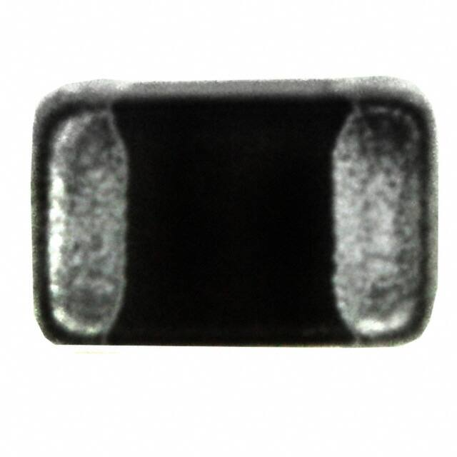

    贴片电容(MLCC) 0805 22µF ±20% 10V X5R
ECJ-2FB1A226M 数据手册
Multilayer Ceramic Capacitors(High Capacitance) Multilayer Ceramic Capacitors (High Capacitance) Series: ECJ ■ Features ■ Recommended Applications ● Small size and high capacitance ● Low ESR/ESL and excellent high-frequency characteristics ● Ideal alternative to TANTALUM CHIP CAPACITORS and ALUMINUM ELECTROLYTIC CAPACITORS ● RoHS compliant ● Class 2 (Hi-K Type) · Power supply circuitry decoupling applications DC-DC converter power supply circuitry of the high-speed LSI smoothing circuit ■ Handling Precautions ■ Packaging Specifications See Page 48 to 53 See Page 45, 46, 56 ■ Discontinued / Revised Part Numbers, Alternative Part Numbers See Page 54, 55 ■ Explanation of Part Numbers 1 2 3 4 5 6 7 8 9 10 11 12 E C J 1 V B 0 J 4 7 5 M Product Code (ECJ:Multilayer Ceramic Chip Capacitors) Packaging Rated Voltage Code Style Code Size Code Temperature Characteristic Code (Example) Capacitance Tolerance Code Nominal Capacitance ■ Construction 3 4 Name 1 Ceramic dielectric 2 Internal electrode 3 5 2 No 4 1 5 Terminal electrode Substrate electrode Intermediate electrode External electrode ■ Dimensions in mm (not to scale) Size Code Size (EIA) L W 0 0402 1 0603 2 T 0805 G L1 L2 3 L 1.00±0.05 1.00+0.15 –0.05 1.6±0.1 1.60±0.15 W 0.50±0.05 0.50+0.15 –0.05 0.8±0.1 0.80±0.15 2.0±0.1 1.25±0.10 2.00±0.15 2.0±0.2 2.00±0.15 1.25±0.15 1.25±0.20 1.25±0.15 3.20±0.15 1.60±0.15 3.2±0.2 1.6±0.2 1206 D M T 0.50±0.05 0.50+0.15 –0.05 0.8±0.1 0.80±0.15 0.85±0.10 1.25±0.10 1.25±0.15 1.25±0.20 0.85±0.10 0.85±0.10 1.15±0.10 1.6±0.2 0.85±0.10 1.15±0.10 Design and specifications are each subject to change without notice. Ask factory for the current technical specifications before purchase and/or use. Should a safety concern arise regarding this product, please be sure to contact us immediately. – EC2 – L1, L2 0.2±0.1 0.3±0.2 0.50±0.25 0.6±0.3 02 Dec. 2008 Multilayer Ceramic Capacitors(High Capacitance) ■ Packaging Styles and Standard Packaging Quantities Packaging Size Style Thickness Code Packaging Styles Paper taping E (Pitch : 2 mm) Paper taping V (Pitch : 4 mm) φ180 reel F Embossed taping (Pitch : 4 mm) Y Quantity : pcs./reel 0402 0603 0805 1206 T=0.5 T=0.8 T=0.85 T=1.25 T=0.85 T=1.15 T=1.6 10,000 — — — — — — — 4,000 4,000 — 4,000 — — — — — 3,000 — 3,000 — — — — — — — 2,000 φ330 reel and Bulk case Type : Please contact us. ■ Temperature Characteristics ● Class 2 Temperature Characteristic Code Temperature Characteristics B X7R X5R F Y5V B, X F Capacitance Change ±10 % ±15 % ±15 % +30, –80 % +22, –82 % Measurement Temperature Range –25 to 85 °C –55 to 125 °C –55 to 85 °C –25 to 85 °C –30 to 85 °C Reference Temperature 20 °C 25 °C 25 °C 20 °C 25 °C For applicable “Temperature Characteristics”, see the lists of standard products on page 6 to 7. ■ Rated Voltage Code Rated Voltage 1H DC 50 V 1E DC 25 V 1C DC 16 V 1A DC 10 V 0J DC 6.3 V ■ Nominal Capacitance Ex. 105 225 106 226 Nominal Capacitance 1,000,000 pF (1 µF) 2,200,000 pF (2.2 µF) 10,000,000 pF (10 µF) 22,000,000 pF (22 µF) ■ Capacitance Tolerance Class 2 Temperature Characteristics B, X7R, X5R F, Y5V Capacitance Tolerance Code K M Z Capacitance Tolerance ±10 % ±20 % +80, –20 % Design and specifications are each subject to change without notice. Ask factory for the current technical specifications before purchase and/or use. Should a safety concern arise regarding this product, please be sure to contact us immediately. – EC3 – 02 Dec. 2008 Multilayer Ceramic Capacitors(High Capacitance) ■ Specifications and Testing Methods Item Specification Test Method Operating Temperature Range Temp. Char. B, X7R : –55 to 125 °C Temp. Char. B, X5R : –55 to 85 °C Temp. Char. F, Y5V : –30 to 85 °C Dielectric Withstanding Voltage No dielectric breakdown and/or damage Test voltage : Rated voltage ҂250 % Duration:1 to 5 s. Charge / Discharge current: 50 mA max. Insulation Resistance (I.R.) 500/C (M액) min. Note : 100/C(M액)min. for DC 10 V max. C : Nominal Cap. in µF Measuring voltage : Rated voltage Duration : 60±5 s Charge / Discharge current: 50 mA max. Capacitance Within the specified tolerance Dissipation Factor (tan δ) 0.2 max. Please see the technical specifications for details. Measuring temperature: 20±2 °C Preconditioning: The capacitors shall be kept in temperature of 150 +0/–10 °C for 1 hour and subject to standard condition ✽ 48±4 hours before initial measurement. Nominal capacitance C 10 µF Measuring frequency 1 kHz±10 % 120 Hz±20 % Measuring voltage 1.0±0.2 Vrms 0.5±0.2 Vrms Temperature Temperature Characteristics Characteristics B : ±10 % X7R : ±15 % X5R : ±15 % F : +30, –80 % Y5V : +22, –82 % Maximum capacitance change at stages 1 to 5 Temp. Char. Stage 1 Stage 2 Stage 3 (Ref. Temp.) Stage 4 Stage 5 B, F X7R X5R Y5V 20 °C 25 °C 25 °C 25 °C –25 °C –55 °C –55 °C –30 °C 20 °C 25 °C 25 °C 25 °C 85 °C 125 °C 85 °C 20 °C 25 °C 25 °C 85 °C 25 °C See the technical specifications for details such as measuring voltage. Adhesion Terminal electrodes shall be free from peeling or signs of peeling. Applied force : 5 N Duration : 10 s Size : 0402 1.0 0.5 R0.5 PC boad Sample 1.0 Size : 0603 to 1206 Sample Unit : mm Appearance: No mechanical damage Capacitance change: Temp. Char. B, X7R, X5R: within ±12.5 % F, Y5V: within ±30 % Bending value :1 mm Bending speed : 1 mm/s 20 R340 45±2 Vibration Proof Appearance : No mechanical damage. Capacitance : Within the specified tolerance tanδ : Initial standard value 45±2 Bending Value Bending Strength Unit : mm Total amplitude : 1.5 mm Vibration frequency : 10 to 55 to 10 Hz for 1 min 3 perpendicular directions for 2 hours each, a total of 6 hours ✽Standard condition : Temperature 15 to 35 °C, Relative humidity 45 to 75 % Design and specifications are each subject to change without notice. Ask factory for the current technical specifications before purchase and/or use. Should a safety concern arise regarding this product, please be sure to contact us immediately. – EC4 – 02 Dec. 2008 Multilayer Ceramic Capacitors(High Capacitance) Item Specification Test Method Resistance to Soldering Heat Appearance : No mechanical damage Capacitance change : Temp. Char. B, X7R, X5R : within ±7.5 % F, Y5V : within ±20 % tanδ : Initial standard value IR : Initial standard value Withstand voltage : No dielectric breakdown or damage Soldering bath method Preconditioning : Heat treatment(✽1) Solder temperature : 270±5 °C Dipping period : 3.0±0.5 s Preheat condition : Order Temp. (°C) Size 0805 max. Size 1206 80 to 100 120 to 180s 300 to 360s 1 2 150 to 200 120 to 180s 300 to 360s Recovery (Standard condition) : 48±4 h Solderability More than 95 % of the soldered area of both terminal electrodes shall be covered with fresh solder. Soldering bath method Solder temperature : 230±5 °C Dipping period : 4±1 s Solder : H63A (JIS–Z–3282) Temperature Cycle Appearance : No mechanical damage Preconditioning : Heat treatment(✽1) Step 1: Minimum operating temp. 30±3 min Capacitance change : Step 2: Room temp. 3 min max. Temp. Char. B, X7R, X5R : within ±7.5 % Step 3: Maximum operating temp. 30±3 min F, Y5V : within ±20 % Step 4: Room temp. 3 min max. tanδ : Initial standard value Number of cycles : 5 cycles IR : Initial standard value Recovery(Standard condition) : 48±4 h Withstand voltage : No dielectric breakdown and/or damage Damp Heat Appearance : No mechanical damage (steady state) Capacitance change : Temp. Char. B, X7R, X5R : within ±20 % F, Y5V : within ±30 % tanδ : Temp. Char. B, X7R, X5R : 0.25 max. F, Y5V : 0.3 max. IR : 50/C (M액) min. Note : 10/C (M액) min. for rated vol. DC 10 V max. C:Nominal cap. in µF Please see the technical specifications for details. Preconditioning : Heat treatment(✽1) Temperature : 40±2 °C Relative humidity : 90 to 95 % Test period : 500+24/0 h Recovery(Standard condition) : 48±4 h Damp Heat Load Appearance : No mechanical damage Capacitance change : Temp. Char. B, X7R, X5R : within ±20 % F, Y5V : within ±30 % tanδ : Temp. Char. B, X7R, X5R : 0.25 max. F, Y5V : 0.3 max. IR : 25/C (M액) min. Note : 5/C (M액) min. for rated vol. DC 10 V max. C:Nominal cap. in µF Please see the technical specifications for details. Preconditioning : Voltage treatment(✽2) Temperature : 40±2 °C Relative humidity : 90 to 95 % Applied voltage : Rated voltage Charge/discharge current : 50 mA max. Test period : 500+24/0 h Recovery(Standard condition) : 48±4 h High Temperature Load Appearance : no mechanical damage Capacitance change : Temp. Char. B, X7R, X5R : within ±20 % F, Y5V : within ±30 % tanδ : Temp. Char. B, X7R, X5R : 0.25 max. F, Y5V : 0.3 max. IR : 50/C (M액) min. Note : 10/C (M액) min. for rated vol. DC 10 V max. C:Nominal cap. in µF Please see the technical specifications for details. Preconditioning : Voltage treatment(✽2) Temperature : Maximum operation temp. ±3 °C Applied voltage : (1)Rated voltage҂200 % (2)Rated voltage҂150 % (3)Rated voltage҂100 % Please see the technical specifications for details. Charge/discharge current : 50 mA max. Test period : 1000+48/0 h Recovery (Standard condition) : 48±4 h (✽1) Heat treatment : 1 h of heat treatment at 150+0/–10 °C followed by 48±4 h recovery under standard conditions. (✽2) Voltage treatment : 1 h of voltage treatment under the specified temperature and voltage for testing followed by 48±4 h of recovery under standard conditions. Design and specifications are each subject to change without notice. Ask factory for the current technical specifications before purchase and/or use. Should a safety concern arise regarding this product, please be sure to contact us immediately. – EC5 – 02 Dec. 2008 Multilayer Ceramic Capacitors(High Capacitance) ■ Standard Products for EIA Size “0402”, Taped Version ● Class 2 ◆ Temperature Characteristic Code : B (Temperature Characteristics : X5R) Rated Voltage Capaci- Capacitance tance (µF) Tolerance 1 ±10 %(K) 2.2 or ±20 %(M) 4.7 DC 16 V Dim. Temp. Char. Part No. T (mm) X5R ECJ0EB1C105M 0.5 ✽  DC 10 V Dim. Temp. Char. T Part No. (mm) X5R ECJ0EB1A105 0.5  DC 6.3 V Dim. Temp. Char. T Part No. (mm) X5R ECJ0EB0J105 0.5  ECJ0EB0J225M 0.5  ECJ0EB0J475M 0.5 ✽   : Capacitance tolerance code : “” for “K” or “M” Dimensional tolerance of L, W, T : ±0.05 mm for no mark, +0.15 –0.05 mm for “✽” mark. Standard packaging quantity of Packaging Style Code “E” (T = 0.5 mm) : 10,000 pcs./reel. Avoid flow soldering. ◆ Temperature Characteristic Code : F (Temperature Characteristics : F, Y5V) Rated Voltage DC 6.3 V Capaci- Capacitance Dim. Temp. Char. tance Part No. T (µF) Tolerance (mm) F Y5V 1 +80, –20 % (Z) ECJ0EF0J105Z 0.5   Standard packaging quantity of Packaging Style Code “E” (T = 0.5 mm): 10,000 pcs./reel. Recommend soldering method : Reflow soldering. ■ Standard Products for EIA Size “0603”, Taped Version ● Class 2 ◆ Temperature Characteristic Code : B (Temperature Characteristics : X5R) Rated Voltage DC 25 V Capaci- Capacitance Dim. Temp. Char. tance Part No. T Tolerance (µF) (mm) X5R ECJ1VB1E105 0.8 1  ±10 %(K) 2.2 or 4.7 ±20 %(M) 10 DC 16 V Dim. Temp. Char. Part No. T (mm) X5R ECJ1VB1C105 0.8  ECJ1VB1C225 ✽ 0.8  ECJ1VB1C475 ✽ 0.8 ✽✽  DC 10 V Dim. Temp. Char. Part No. T (mm) X5R ECJ1VB1A105 0.8  ECJ1VB1A225 ✽ 0.8  ECJ1VB1A475 ✽ 0.8  ECJ1VB1A106M ✽ 0.8 ✽✽   : Capacitance tolerance code : “” for “K” or “M” Standard packaging quantity of Packaging Style Code “V” (T = 0.8 mm): 4,000 pcs./reel. “✽” : Avoid flow soldering. “✽✽” : “L”, “W”, “T” Dimension Tolerance ±0.15 mm DC 6.3 V Dim. Temp. Char. Part No. T (mm) X5R ECJ1VB0J105 0.8  ECJ1VB0J225 0.8  ECJ1VB0J475 ✽ 0.8  ECJ1VB0J106M ✽ 0.8 ✽✽  ◆ Temperature Characteristic Code : F (Temperature Characteristics : F, Y5V) Rated Voltage DC 25 V Capaci- Capacitance Dim. Temp. Char. tance Part No. T F (µF) Tolerance (mm) +80, ECJ1VF1E105Z 0.8 1  2.2 –20 %(Z) DC 16 V Dim. Temp. Char. T Part No. F (mm) ECJ1VF1C105Z 0.8  DC 10 V DC 6.3 V Dim. Temp. Dim. Temp. Char. Char. T T Part No. Part No. (mm) F Y5V (mm) F Y5V ECJ1VF1A105Z 0.8   ECJ1VF1A225Z 0.8   ECJ1VF0J225Z 0.8   Standard packaging quantity of Packaging Style Code “V” (T = 0.8 mm): 4,000 pcs./reel. ■ Standard Products for EIA Size “0805”, Taped Version ● Class 2 ◆ Temperature Characteristic Code : B (Temperature Characteristics : B, X5R) Rated Voltage Capaci- Capacitance tance (µF) Tolerance 1 2.2 4.7 10 22 DC 25 V Dim. Temp. Char. Part No. T (mm) X5R ECJ2FB1E105 1.25 ✽  ±10 %(K) ECJ2FB1E225 1.25 ✽  or ECJ2FB1E475 1.25 ✽  ±20 %(M) DC 16 V Dim. Temp. Char. Part No. T (mm) X5R ECJ2FB1C105 1.25 ✽  ECJ2FB1C225 1.25 ✽  ECJ2FB1C475 1.25 ✽  ECJ2FB1C106 1.25 ✽✽  DC 10 V Dim. Part No. T (mm) ECJ2FB1A105 1.25 ECJ2FB1A225 1.25 ✽ ECJ2FB1A475 1.25 ✽ ECJ2FB1A106 1.25 ✽✽ ECJ2FB1A226M 1.25 ✽✽  : Capacitance tolerance code : “” for “K” or “M” Dimensional tolerance of L, W, T : ±0.1 mm for no mark, ±0.15 mm for “✽” mark, ±0.2 mm for “✽✽”mark. Standard packaging quantity of Packaging Style Code “F” (T = 1.25 mm): 3,000 pcs./reel. Avoid flow soldering. Temp. Char. B X5R   —  —  —  —  DC 6.3 V Dim. Temp. Char. Part No. T (mm) X5R ECJ2FB0J225 ECJ2FB0J475 ECJ2FB0J106 ECJ2FB0J226M 1.25 1.25 ✽ 1.25 ✽✽ 1.25 ✽✽     ◆ Temperature Characteristic Code : F (Temperature Characteristics : F, Y5V) Rated Voltage DC 50 V Capaci- Capacitance Dim. Temp. Char. tance Part No. T F (µF) Tolerance (mm) ECJ2FF1H105Z 1.25 ✽ 1  +80, 2.2 4.7 –20 %(Z) 10 DC 25 V Dim. Temp. Char. Part No. T F (mm) ECJ2FF1E105Z 1.25 ✽  ECJ2FF1E225Z 1.25 ✽  DC 16 V Dim. Part No. T (mm) ECJ2VF1C105Z 0.85 ECJGVF1C225Z 0.85 ECJGVF1C475Z 0.85 DC 10 V Temp. Dim. Temp. Char. Char. Part No. T F Y5V (mm) F Y5V       ECJGVF1A475Z 0.85   ECJ2FF1A106Z 1.25 ✽   Dimensional tolerance of L, W, T : L, W: ±0.15 mm / T : ±0.1 mm for no mark, ±0.15 mm for “✽”mark. Standard packaging quantity of Packaging Style Code “V” (T = 0.85 mm): 4,000 pcs./reel, “F” (T = 1.25 mm): 3,000 pcs./reel. Soldering method of dimension T > 1 mm: Avoid flow soldering. Design and specifications are each subject to change without notice. Ask factory for the current technical specifications before purchase and/or use. Should a safety concern arise regarding this product, please be sure to contact us immediately. – EC6 – 02 Dec. 2008 Multilayer Ceramic Capacitors(High Capacitance) ■ Standard Products for EIA Size “1206”, Taped Version ● Class 2 ◆ Temperature Characteristic Code : B (Temperature Characteristics : B, X7R, X5R) Rated Voltage CapaciCapacitance tance Tolerance (µF) 1 2.2 ±10 %(K) or 4.7 10 ±20 %(M) 22 DC 25 V Dim. Part No. T (mm) ECJ3YB1E105 1.6 ECJ3YB1E225 1.6 ECJ3YB1E475 1.6 ECJ3YB1E106 1.6 Temp. Char. B X7R X5R  — — —  — — — —    DC 16 V Dim. T Part No. (mm) ECJ3FB1C105 1.15 ✽ ECJ3YB1C225 1.6 ECJ3YB1C475 1.6 ECJ3YB1C106 1.6 ECJ3YB1C226M 1.6 Temp. Char. B X7R X5R   — — —   — — — — —    DC 10 V Dim. Temp. Char. T Part No. B X7R X5R (mm) ECJ3YB1A225 ECJ3YB1A475 ECJ3YB1A106 ECJ3YB1A226M 1.6 1.6 1.6 1.6  — — —  — — — DC 6.3 V Dim. Temp. Char. T Part No. (mm) X5R —  ECJ3YB0J475 1.6  ECJDV50J106M 0.85 ✽✽  ECJDV50J226M 0.85 ✽✽     : Capacitance tolerance code : “” for “K” or “M” Dimensional tolerance of L, W, T: ±0.2 mm for no mark, L, W: ±0.15 mm / T: ±0.1 mm for “✽” mark, L, W: ±0.2 mm / T: ±0.1 mm for “✽✽” mark. Standard packaging quantity of Packaging Style Code “V” (T = 0.85 mm) : 4,000 pcs./reel, “F” (T = 1.15 mm): 3,000 pcs./reel, “Y” (T = 1.6 mm): 2,000 pcs./reel Avoid flow soldering. ◆ High Temperature Series : Temperature Characteristic Code : B, X (Temperature Characteristics : B, Y7R) Rated Voltage DC 50 V DC 25 V Temp. CapaciDim. Dim. Temp. Capacitance Char. Char. tance Part No. T T Part No. Tolerance B Y7R B Y7R (mm) (mm) (µF) ECJ3YX1H105 1.6   ECJ3YB1E105 1.6   1 ±10 %(K) 2.2 or 4.7 ±20 %(M) 10 DC 16 V Dim. T Part No. (mm) ECJ3FB1C105 1.15 ✽ ECJ3YB1C225 1.6 ECJ3YX1C475 1.6 ECJ3YX1C106 1.6 Temp. Char. B Y7R         DC 10 V Dim. Temp. Char. T Part No. B Y7R (mm) ECJ3YB1A225 1.6    : Capacitance tolerance code : “” for “K” or “M” Dimensional tolerance of L, W, T:±0.2 mm for no mark, L, W: ±0.15 mm / T: ±0.1 mm for “✽” mark. Standard packaging quantity of Packaging Style Code “F” (T = 1.15 mm): 3,000 pcs./reel, “Y” (T = 1.6 mm): 2,000 pcs./reel Avoid flow soldering. ◆ Temperature Characteristic Code : F (Temperature Characteristics : F, Y5V) Rated Voltage DC 50 V CapaciDim. Temp. Capacitance Char. tance Part No. T Tolerance F (mm) (µF) ✽ ECJ3FF1H105Z 1.15 1  2.2 +80, 4.7 –20 %(Z) 10 22 DC 25 V Dim. T Part No. (mm) ECJ3FF1E105Z 1.15 ✽ ECJ3FF1E225Z 1.15 ✽ ECJ3FF1E475Z 1.15 ✽ ECJ3YF1E106Z 1.6 DC 16 V Dim. T Part No. F Y5V (mm)   ECJ3VF1C105Z 0.85 ✽   ECJ3VF1C225Z 0.85 ✽  — ECJ3FF1C475Z 1.15 ✽  — ECJMFF1C106Z 1.15 ✽✽ Temp. Char. Temp. Char. F Y5V         DC 10 V Dim. Temp. Char. T Part No. F Y5V (mm) ECJMFF1A106Z 1.15 ✽✽  ECJMFF1A226Z 1.15 ✽✽    Dimensional tolerance of L, W, T:±0.2 mm for no mark, L, W: ±0.15 mm / T: ±0.1 mm for “✽” mark, L, W: ±0.2 mm / T: ±0.1 mm for “✽✽”. Standard packaging quantity of Packaging Style Code “V” (T = 0.85 mm): 4,000 pcs./reel, “F” (T = 1.15 mm): 3,000 pcs./reel, “Y” (T = 1.6 mm): 2,000 pcs./reel Avoid flow soldering. Design and specifications are each subject to change without notice. Ask factory for the current technical specifications before purchase and/or use. Should a safety concern arise regarding this product, please be sure to contact us immediately. – EC7 – 02 Dec. 2008
