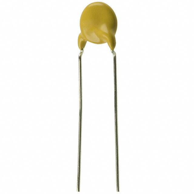

Ceramic Disc Capacitors (High Voltage) /KBP High Voltage Ceramic Disc Capacitors Rated 1 to 3 kVDC, Temp. Char. Y5P Hi Volt, Disc, Radial Leaded KPB ECK-D (KPB) Series: KBP ■ Recommended Applications • Snubber circuit of switching power supply • Horizontal resonance of TV and CRT display • Inverter lighting apparatus • High voltage and pulse circuit ■ Features • Wide operating temperature range: –25 to 125°C • Improved in “Voltage vs. Temperature Rise” through low loss ceramic dielectric materials applied • Temperature stable type (Char. B/Y5P) • Flame-retardant insulating coating applied ■ Explanation of Part Numbers 1 2 3 4 5 6 7 8 9 10 11 12 E C K D 3 D 2 2 2 K B P Style Rated Voltage Capacitance Tolerance Temperature Characteristics Suffix Product Code Nominal Capacitance ■ Specifications Operating temperature range –25 to 125°C (Including maximum temperature rise of +20°C Dissipation factor (tan δ) 0.025 max at 1 kHz±20%, 1 to 5 Vrms, and 20°C Rated voltage 1 kVDC, 2 kVDC, and 3 kVDC Insulation resistance Dielectric withstanding voltage 200% of the rated voltage for 1 to 5 seconds 10,000 MΩ min. at 500 VDC and 1 minute electrification Temperature characteristics Capacitance Within the specified tolerance, when measured at 1 kHz±20%, 1 to 5 Vrms and 20°C Capacitance change: ±10% max. over the temperature range of –25 to 85°C ■ Dimensions in mm (not to scale) ■ Typical Temperature Characteristics T max. 20 min. F 3 max. Capacitance Change (%) D max. +10 0 –10 –20 –20 0 20 40 Temperature (°C) d ± 0.05 Design and specifications are subject to change without notice. Ask factory for technical specifications before purchase and/or use. Whenever a doubt about safety issues arises from this product, please inform us immediately for technical consultation. 60 80 100 Ceramic Disc Capacitors (High Voltage) /KBP ■ Ratings and Characteristics Rated Voltage 1 kVDC 2 kVDC Straight Lead Type (Bulk) Dim. in mm Straight Lead Taped Type* Nom. Cap. (pF) Cap. Tol.** (%) D max. T max. Part No. F d Part No. 100 120 150 180 220 270 330 390 470 560 680 820 1000 1200 1500 1800 2200 2700 3300 3900 4700 5600 100 120 150 180 220 270 330 390 470 560 680 820 1000 1200 1500 1800 2200 2700 3300 3900 4700 5600 ±10 ±10 ±10 ±10 ±10 ±10 ±10 ±10 ±10 ±10 ±10 ±10 ±10 ±10 ±10 ±10 ±10 ±10 ±10 ±10 ±10 ±10 ±10 ±10 ±10 ±10 ±10 ±10 ±10 ±10 ±10 ±10 ±10 ±10 ±10 ±10 ±10 ±10 ±10 ±10 ±10 ±10 ±10 ±10 6.0 6.0 6.0 6.0 6.0 6.0 6.0 6.0 6.0 7.0 7.0 7.5 9.0 9.0 9.5 10.0 12.0 12.0 13.5 13.5 15.5 17.0 7.0 7.0 7.0 7.0 7.0 7.0 7.0 7.0 7.5 8.0 9.0 9.0 10.0 10.5 12.0 12.5 14.0 16.0 17.0 18.0 25.0 25.0 4.5 4.5 4.5 4.5 4.5 4.5 4.5 4.5 4.5 4.5 4.5 4.5 4.5 4.5 4.5 4.5 4.5 4.5 4.5 4.5 4.5 4.5 5.0 5.0 5.0 5.0 5.0 5.0 5.0 5.0 5.0 5.0 5.0 5.0 5.0 5.0 5.0 5.0 5.0 5.0 5.0 5.0 5.0 5.0 ECKD3A101KBP ECKD3A121KBP ECKD3A151KBP ECKD3A181KBP ECKD3A221KBP ECKD3A271KBP ECKD3A331KBP ECKD3A391KBP ECKD3A471KBP ECKD3A561KBP ECKD3A681KBP ECKD3A821KBP ECKD3A102KBP ECKD3A122KBP ECKD3A152KBP ECKD3A182KBP ECKD3A222KBP ECKD3A272KBP ECKD3A332KBP ECKD3A392KBP ECKD3A472KBP ECKD3A562KBP ECKD3D101KBP ECKD3D121KBP ECKD3D151KBP ECKD3D181KBP ECKD3D221KBP ECKD3D271KBP ECKD3D331KBP ECKD3D391KBP ECKD3D471KBP ECKD3D561KBP ECKD3D681KBP ECKD3D821KBP ECKD3D102KBP ECKD3D122KBP ECKD3D152KBP ECKD3D182KBP ECKD3D222KBP ECKD3D272KBP ECKD3D332KBP ECKD3D392KBP ECKD3D472KBP ECKD3D562KBP 5.0±1.0 5.0±1.0 5.0±1.0 5.0±1.0 5.0±1.0 5.0±1.0 5.0±1.0 5.0±1.0 5.0±1.0 5.0±1.0 5.0±1.0 5.0±1.0 5.0±1.0 5.0±1.0 5.0±1.0 5.0±1.0 5.0±1.0 5.0±1.0 10.0±1.5 10.0±1.5 10.0±1.5 10.0±1.5 7.5±1.5 7.5±1.5 7.5±1.5 7.5±1.5 7.5±1.5 7.5±1.5 7.5±1.5 7.5±1.5 7.5±1.5 7.5±1.5 7.5±1.5 7.5±1.5 7.5±1.5 7.5±1.5 7.5±1.5 7.5±1.5 10.0±1.5 10.0±1.5 10.0±1.5 10.0±1.5 10.0±1.5 10.0±1.5 0.60 0.60 0.60 0.60 0.60 0.60 0.60 0.60 0.60 0.60 0.60 0.60 0.60 0.60 0.60 0.60 0.60 0.60 0.60 0.60 0.60 0.65 0.60 0.60 0.60 0.60 0.60 0.60 0.60 0.60 0.60 0.60 0.60 0.60 0.60 0.60 0.60 0.65 0.65 0.65 0.65 0.65 0.80 0.80 ECKZ3A101KBP ECKZ3A121KBP ECKZ3A151KBP ECKZ3A181KBP ECKZ3A221KBP ECKZ3A271KBP ECKZ3A331KBP ECKZ3A391KBP ECKZ3A471KBP ECKZ3A561KBP ECKZ3A681KBP ECKZ3A821KBP ECKZ3A102KBP ECKZ3A122KBP ECKZ3A152KBP ECKZ3A182KBP ECKZ3A222KBP ECKZ3A272KBP ECKZ3A332KBP ECKZ3A392KBP ECKZ3A472KBP ECKZ3A562KBP ECKZ3D101KBP ECKZ3D121KBP ECKZ3D151KBP ECKZ3D181KBP ECKZ3D221KBP ECKZ3D271KBP ECKZ3D331KBP ECKZ3D391KBP ECKZ3D471KBP ECKZ3D561KBP ECKZ3D681KBP ECKZ3D821KBP ECKZ3D102KBP ECKZ3D122KBP ECKZ3D152KBP ECKZ3D182KBP ECKZ3D222KBP ECKZ3D272KBP ECKZ3D332KBP ECKZ3D392KBP — — Dim. in mm Crimped Lead Taped Type* Taped Dim. in mm Type F d Z0 Z0 Z0 Z0 Z0 Z0 Z0 Z0 Z0 Z0 Z0 Z0 Z0 Z0 Z0 Z0 Z0 Z0 Z1 Z1 Z2 Z2 Z1 Z1 Z1 Z1 Z1 Z1 Z1 Z1 Z1 Z1 Z1 Z1 Z1 Z1 Z1 Z1 Z2 Z2 Z2 Z2 — — 5.0 5.0 5.0 5.0 5.0 5.0 5.0 5.0 5.0 5.0 5.0 5.0 5.0 5.0 5.0 5.0 5.0 5.0 7.5 7.5 7.5 7.5 7.5 7.5 7.5 7.5 7.5 7.5 7.5 7.5 7.5 7.5 7.5 7.5 7.5 7.5 7.5 7.5 7.5 7.5 7.5 7.5 — — 0.60 0.60 0.60 0.60 0.60 0.60 0.60 0.60 0.60 0.60 0.60 0.60 0.60 0.60 0.60 0.60 0.60 0.60 0.65 0.65 0.65 0.65 0.65 0.65 0.65 0.65 0.65 0.65 0.65 0.65 0.65 0.65 0.65 0.65 0.65 0.65 0.65 0.65 0.65 0.65 0.65 0.65 — — Part No. ECKR3A101KBP ECKR3A121KBP ECKR3A151KBP ECKR3A181KBP ECKR3A221KBP ECKR3A271KBP ECKR3A331KBP ECKR3A391KBP ECKR3A471KBP ECKR3A561KBP ECKR3A681KBP ECKR3A821KBP ECKR3A102KBP ECKR3A122KBP ECKR3A152KBP ECKR3A182KBP ECKR3A222KBP ECKR3A272KBP ECKR3A332KBP ECKR3A392KBP ECKR3A472KBP ECKR3A562KBP ECKR3D101KBP ECKR3D121KBP ECKR3D151KBP ECKR3D181KBP ECKR3D221KBP ECKR3D271KBP ECKR3D331KBP ECKR3D391KBP ECKR3D471KBP ECKR3D561KBP ECKR3D681KBP ECKR3D821KBP ECKR3D102KBP ECKR3D122KBP ECKR3D152KBP ECKR3D182KBP ECKR3D222KBP ECKR3D272KBP ECKR3D332KBP ECKR3D392KBP — — Taped Dim. in mm Type F d R0 R0 R0 R0 R0 R0 R0 R0 R0 R0 R0 R0 R0 R0 R0 R0 R0 R0 R1 R1 R1 R1 R1 R1 R1 R1 R1 R1 R1 R1 R1 R1 R1 R1 R1 R1 R1 R1 R1 R1 R2 R2 — — 5.0 5.0 5.0 5.0 5.0 5.0 5.0 5.0 5.0 5.0 5.0 5.0 5.0 5.0 5.0 5.0 5.0 5.0 7.5 7.5 7.5 7.5 7.5 7.5 7.5 7.5 7.5 7.5 7.5 7.5 7.5 7.5 7.5 7.5 7.5 7.5 7.5 7.5 7.5 7.5 7.5 7.5 — — 0.60 0.60 0.60 0.60 0.60 0.60 0.60 0.60 0.60 0.60 0.60 0.60 0.60 0.60 0.60 0.60 0.60 0.60 0.65 0.65 0.65 0.65 0.65 0.65 0.65 0.65 0.65 0.65 0.65 0.65 0.65 0.65 0.65 0.65 0.65 0.65 0.65 0.65 0.65 0.65 0.65 0.65 — — ** Capacitance tolerance of ±5% is available on special order. (Continues on following page) Design and specifications are subject to change without notice. Ask factory for technical specifications before purchase and/or use. Whenever a doubt about safety issues arises from this product, please inform us immediately for technical consultation. Ceramic Disc Capacitors (High Voltage) /KBP ■ Ratings and Characteristics Rated Voltage 1 kVDC Straight Lead Type (Bulk) Dim. in mm Straight Lead Taped Type* Nom. Cap. (pF) Cap. Tol.** (%) D max. T max. Part No. F d Part No. 100 120 150 180 220 270 330 390 470 560 680 820 1000 1200 1500 1800 2200 2700 ±10 ±10 ±10 ±10 ±10 ±10 ±10 ±10 ±10 ±10 ±10 ±10 ±10 ±10 ±10 ±10 ±10 ±10 7.5 7.5 7.5 7.5 7.5 7.5 8.0 9.0 9.5 10.0 11.0 11.0 12.5 14.5 14.5 16.0 17.0 18.5 6.0 6.0 6.0 6.0 6.0 6.0 6.0 6.0 6.0 6.0 6.0 6.0 6.0 6.0 6.0 6.0 6.0 6.0 ECKD3F101KBP ECKD3F121KBP ECKD3F151KBP ECKD3F181KBP ECKD3F221KBP ECKD3F271KBP ECKD3F331KBP ECKD3F391KBP ECKD3F471KBP ECKD3F561KBP ECKD3F681KBP ECKD3F821KBP ECKD3F102KBP ECKD3F122KBP ECKD3F152KBP ECKD3F182KBP ECKD3F222KBP ECKD3F272KBP 7.5±1.5 7.5±1.5 7.5±1.5 7.5±1.5 7.5±1.5 7.5±1.5 7.5±1.5 7.5±1.5 7.5±1.5 7.5±1.5 7.5±1.5 7.5±1.5 7.5±1.5 10.0±1.5 10.0±1.5 10.0±1.5 10.0±1.5 10.0±1.5 0.65 0.65 0.65 0.65 0.65 0.65 0.65 0.65 0.65 0.65 0.65 0.65 0.65 0.65 0.65 0.65 0.65 0.65 ECKZ3F101KBP ECKZ3F121KBP ECKZ3F151KBP ECKZ3F181KBP ECKZ3F221KBP ECKZ3F271KBP ECKZ3F331KBP ECKZ3F391KBP ECKZ3F471KBP ECKZ3F561KBP ECKZ3F681KBP ECKZ3F821KBP ECKZ3F102KBP ECKZ3F122KBP ECKZ3F152KBP ECKZ3F182KBP ECKZ3F222KBP ECKZ3F272KBP Dim. in mm Crimped Lead Taped Type* Taped Dim. in mm Type F d Z1 Z1 Z1 Z1 Z1 Z1 Z1 Z1 Z1 Z1 Z1 Z1 Z1 Z1 Z1 Z2 Z2 Z2 7.5 7.5 7.5 7.5 7.5 7.5 7.5 7.5 7.5 7.5 7.5 7.5 7.5 7.5 7.5 7.5 7.5 7.5 0.65 0.65 0.65 0.65 0.65 0.65 0.65 0.65 0.65 0.65 0.65 0.65 0.65 0.65 0.65 0.65 0.65 0.65 Part No. ECKR3F101KBP ECKR3F121KBP ECKR3F151KBP ECKR3F181KBP ECKR3F221KBP ECKR3F271KBP ECKR3F331KBP ECKR3F391KBP ECKR3F471KBP ECKR3F561KBP ECKR3F681KBP ECKR3F821KBP ECKR3F102KBP ECKR3F122KBP ECKR3F152KBP ECKR3F182KBP ECKR3F222KBP ECKR3F272KBP ** Capacitance tolerance of ±5% is available on special order. Note: 1. In straight lead types (bulk), dimensions “F” (lead spacing)” of 5.0mm is available for rated “2 kVDC” and “3 kVDC” capacitors that are 11.0mm or less in the diameter on special order. 2. In straight lead and taped types, dimensions “F (lead spacing)” of 5.0mm is available for rated “2 kVDC” and “3 kVDC” capacitors that are 11.0mm or less in the diameter on special order. Design and specifications are subject to change without notice. Ask factory for technical specifications before purchase and/or use. Whenever a doubt about safety issues arises from this product, please inform us immediately for technical consultation. Taped Dim. in mm Type F d R1 R1 R1 R1 R1 R1 R1 R1 R1 R1 R1 R1 R1 R1 R1 R2 R2 R2 7.5 7.5 7.5 7.5 7.5 7.5 7.5 7.5 7.5 7.5 7.5 7.5 7.5 7.5 7.5 7.5 7.5 7.5 0.65 0.65 0.65 0.65 0.65 0.65 0.65 0.65 0.65 0.65 0.65 0.65 0.65 0.65 0.65 0.65 0.65 0.65

物料型号:KBP系列
器件简介:这是松下公司生产的高压陶瓷圆盘电容器,额定电压为1到3千伏直流电,具有Y5P温度特性的高电压电容器。
引脚分配:文档中未明确指出具体的引脚分配,但提到了径向引线类型。
参数特性: - 工作温度范围:-25至125°C - 损耗因数(tan δ):在1kHz、1到5Vrms和20°C下最大为0.025 - 额定电压:1 KVDC、2 KVDC和3 kVDC - 绝缘电阻:在500 VDC和1分钟下最小为10,000 MΩ - 介质耐电压:额定电压的200%,持续1到5秒 - 电容变化:在-25至85°C温度范围内,电容变化最大为±10%
功能详解:这些电容器推荐用于开关电源的消振电路、电视和CRT显示器的水平共振、逆变器照明设备以及高压和脉冲电路。
应用信息:适用于高电压和脉冲电路,如开关电源消振、电视和显示器共振、逆变器照明等。
封装信息:提供了不同额定电容值和容差的产品尺寸信息,包括直径(D max.)、总长度(T max.)和引线间距(F)。
