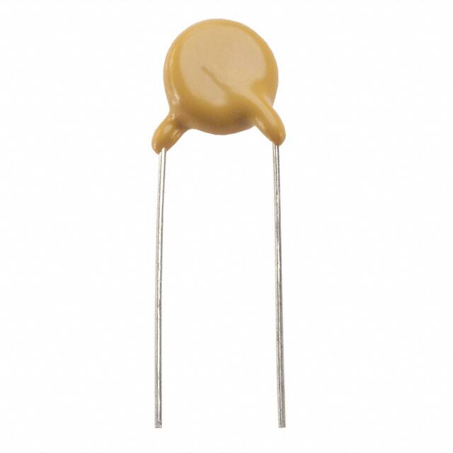

ECK-DNA102MB
ECK-DNA102MB
    NAIS(松下)
    插件,P=10mm
    贴片电容(MLCC) 径向 1nF ±20% 250V Y5P
ECK-DNA102MB 数据手册
Ceramic Disc Capacitors (Type NS-A) Ceramic Disc Capacitors for Safety Regulations Safety Reg. NS ECK-DNA/DNB Type: NS-A ■ Features • Type NS-A, a revised type designation from our previous type designation of NS for “Class II equipment,” is recognized and classified as SubClass Y1 Capacitor according to IEC384-14 2nd Edition by European Safety Regulations. • The Type NS-A is recognized by UL and CSA (UL 1414/250 VAC and CSA C22.2 No. 1). • The Type NS-A can bridge a “reinforced insulation” by a single capacitor in Class II equipment/apparatus of EN60065. ■ Explanation of Part Numbers 1 2 3 4 5 6 7 8 9 10 11 E C K D N A 2 2 2 M E Capacitance Tolerance Temperature Characteristics Product Code Style Type Designation Nominal Capacitance 12 Suffix Note: Suffix “NA” in the part number indicates type “NS-A”. ■ Specifications Operating temperature range –25 to 85°C Rated voltage Applicable standard Rated voltage UL 250 VAC CSA 125 VAC IEC 384-14 2nd. Ed. (EN 132 400) Sub-Class Y1 250 VAC SEV1016 (3300 to 4700 pF) 250 VAC BSI (BS415: 1990), VDE 560-2, SEV1016 (100 to 2200 pF) 400 VAC Dielectric withstanding voltage 4000 VAC (50/60 Hz) for 1 minute Capacitance Within the tolerance, when measured at 1 kHz ± 20%, 1 Vrms and 20°C Dissipation factor (tan δ) 0.025 max., when measured at 1 kHz ±20%, 1 Vrms and 20°C Insulation resistance 10,000 MΩ min. at 500 VDC and 1 minute electrification Temperature characteristics (Reference temperature: 20°C) T.C. B/Y5P/2B4 Capacitance Change ±10% max. Temperature Range –25 to 85°C E/Y5U/2E4 ±20/–55% max. –25 to 85°C Design and specifications are subject to change without notice. Ask factory for technical specifications before purchase and/or use. Whenever a doubt about safety issues arises from this product, please inform us immediately for technical consultation. Ceramic Disc Capacitors (Type NS-A) ■ Related Standards and Certificate Numbers (Type NS-A) Related Standard BS415: 1994 BS 415: 1990* EN132 400: 1994 BSI (UK) VDE (Germany) VDE 560-2*: 1970 EN 132 400: 1994 SEV 1016* b :1959 EN 132 400: 1994 EN 132 400: 1994 EN 132 400: 1994 EN 132 400: 1994 UL1414 CSA C22.2 No. 1 SEV (Switzerland) SEMKO (Sweden) FIMKO (Finland) NEMKO (Norway) DEMKO (Denmark) UL (USA) CSA (Canada) Certificate No. Sub-Class Rated Voltage 226319 226319 87469 87472 39482 39481 91, 1 10016, 04 95, 1 10016, 06 95, 1 10016, 06 9524071 183536-01 P95102393 304133 E62674 LR58064-11 Y1 — Y1 Y1 — — Y1 — — Y1 Y1 Y1 Y1 — — 250 VAC 400 VAC 250 VAC 250 VAC 400 VAC 400 VAC 250 VAC 400 VAC 250 VAC 250 VAC 250 VAC 250 VAC 250 VAC 250 VAC 125 VAC Dielectric Withstanding Voltage 4000 VAC 2000 VAC 4000 VAC 4000 VAC 2500 VAC 2500 VAC 4000 VAC 4000 VAC 4000 VAC 4000 VAC 4000 VAC 4000 VAC 4000 VAC 1500 VAC 1250 VAC * Type NS-A capacitor covers the previous recognitions of related safety standards with *. Rated Capacitance Type designation NS-A Sub-class and rated voltage according to EN132400 Y1-250V~ Recognized Marking (Logo or monogram) VDE SEV 560-2 EN132400 LL2 Plant code Date code Examples EECKDNB472ME as an example NEMKO DEMKO SEMKO UL FIMKO CSA B V † †† † 1500 pF, 2200 pF †† 3300 pF, 4700 pF ■ Marking Marking Items Manufacturer’s identification Applicable Temp. Char. Plant code Date code Design and specifications are subject to change without notice. Ask factory for technical specifications before purchase and/or use. Whenever a doubt about safety issues arises from this product, please inform us immediately for technical consultation. Ceramic Disc Capacitors (Type NS-A) ■ Dimensions in mm (not to scale) ■ Typical Temperature Characteristics 7.0 max. D max. Capacitance Change (%) 20 min. F 3.0 max. +20 0 B B char –20 –40 E char E –60 –80 d ± 0.05 –20 0 20 40 60 80 Temperature (°C) ■ Ratings and Characteristics Capacitance Part Number Nominal Capacitance (pF) Tolerance (%) Temperature Characteristics Dimensions in mm D max. ECKDNA101 B 100 ±10 or ±20 B/Y5P/2B4 11.0 ECKDNA221 B 220 ±10 or ±20 B/Y5P/2B4 11.0 ECKDNA331 B 330 ±10 or ±20 B/Y5P/2B4 11.0 ECKDNA471 B 470 ±10 or ±20 B/Y5P/2B4 11.0 F d 10.0 +1.5 –1.0 0.65 10.0 +1.5 –1.0 0.65 10.0 +1.5 –1.0 0.65 10.0 +1.5 –1.0 0.65 0.65 ECKDNA102 B 1000 ±10 or ±20 B/Y5P/2B4 11.0 10.0 +1.5 –1.0 ECKDNA152 B 1500 ±20 E/Y5U/2E4 11.0 10.0 +1.5 –1.0 0.65 ECKDNA222 B 2200 ±20 E/Y5U/2E4 11.0 10.0 +1.5 –1.0 0.65 ECKDNA332 B 3300 ±20 E/Y5U/2E4 13.0 10.0 +1.5 –1.0 0.65 ECKDNA472 B 4700 ±20 E/Y5U/2E4 16.0 10.0 +1.5 –1.0 0.65 * n Capacitance tolerance code, “K” for ±10% or “M” for ±20% ** Suffix “Y” indicates that the capacitors are recognized and classified as Sub-Class Y2 and X1 capacitors according to IEC384-14 2nd Ed. by European Safety Regulations. Design and specifications are subject to change without notice. Ask factory for technical specifications before purchase and/or use. Whenever a doubt about safety issues arises from this product, please inform us immediately for technical consultation. Ceramic Disc Capacitors (Type NS-B) Ceramic Disc Capacitors for Safety Regulations Safety Reg. NS ECK-DNA/DNB Type: NS-B ■ Features • Type NS-B, a revised type designation from our previous type designation of NS for “Class I Equipment,” is recognized and classified as SubClass Y2 capacitor according to IEC384-14 2nd Ed. by European Safety Regulations. • The Type NS-B is recognized by UL and CSA (UL1414/250 VAC and CSA C22.2 No.1). ■ Explanation of Part Numbers 1 2 3 4 5 6 7 8 9 10 11 E C K D N B 2 2 2 M E Capacitance Tolerance Temperature Characteristics Product Code Style Type Designation Nominal Capacitance 12 Suffix Note: Suffix “NB” in the part number indicates type “NS-B”. ■ Specifications Operating temperature range –25 to 85°C Rated voltage Applicable standard Rated voltage UL 250 VAC CSA 125 VAC IEC 384-14 2nd. Ed. (EN 132 400) Sub-Class Y1 250 VAC SEV1016 (3300 to 4700 pF) 250 VAC BSI (BS415: 1990), VDE 560-2, SEV1016 (100 to 2200 pF) 400 VAC Dielectric withstanding voltage 2600 VAC (50/60 Hz) for 1 minute Capacitance Within the tolerance, when measured at 1 kHz ± 20%, 1 Vrms and 20°C Dissipation factor (tan δ) 0.025 max., when measured at 1 kHz ±20%, 1 Vrms and 20°C Insulation resistance 10,000 MΩ min. at 500 VDC and 1 minute electrification Temperature characteristics (Reference temperature: 20°C) T.C. B/Y5P/2B4 Capacitance Change ±10% max. Temperature Range –25 to 85°C E/Y5U/2E4 ±20/–55% max. –25 to 85°C Design and specifications are subject to change without notice. Ask factory for technical specifications before purchase and/or use. Whenever a doubt about safety issues arises from this product, please inform us immediately for technical consultation. Ceramic Disc Capacitors (Type NS-B) ■ Related Standards and Certificate Numbers (Type NS-A) Related Standard BS415: 1994 BS 415: 1990* EN132 400: 1994 BSI (UK) VDE (Germany) VDE 560-2*: 1970 EN 132 400: 1994 SEV 1016* b :1959 EN 132 400: 1994 EN 132 400: 1994 EN 132 400: 1994 EN 132 400: 1994 UL1414 CSA C22.2 No. 1 SEV (Switzerland) SEMKO (Sweden) FIMKO (Finland) NEMKO (Norway) DEMKO (Denmark) UL (USA) CSA (Canada) Certificate No. Sub-Class Rated Voltage 226319 226319 87471 87470 39482 39481 95, 1 10015, 04 95, 1 10016, 06 95, 1 10016, 06 9524071 183536-02 P95102393 304133 E62674 LR58064-11 Y2 — Y2 Y2 — — Y2 — — Y2 Y2 Y2 Y2 — — 250 VAC 400 VAC 250 VAC 250 VAC 400 VAC 400 VAC 250 VAC 400 VAC 250 VAC 250 VAC 250 VAC 250 VAC 250 VAC 250 VAC 125 VAC Dielectric Withstanding Voltage 1500 VAC 2000 VAC 1500 VAC 1500 VAC 2500 VAC 2500 VAC 1500 VAC 2600 VAC 2600 VAC 1500 VAC 1500 VAC 1500 VAC 1500 VAC 1500 VAC 1250 VAC * Type NS-B capacitor covers the previous recognitions of related safety standards with *. Rated Capacitance Type designation NS-B Sub-class and rated voltage according to EN132400 Y1-250V~ Recognized Marking (Logo or monogram) VDE SEV 560-2 EN132400 LL2 Plant code Date code Examples EECKDNB472ME as an example NEMKO DEMKO SEMKO UL FIMKO CSA B V † †† † 1500 pF, 2200 pF †† 3300 pF, 4700 pF ■ Marking Marking Items Manufacturer’s identification Applicable Temp. Char. Plant code Date code Design and specifications are subject to change without notice. Ask factory for technical specifications before purchase and/or use. Whenever a doubt about safety issues arises from this product, please inform us immediately for technical consultation. Ceramic Disc Capacitors (Type NS-B) ■ Dimensions in mm (not to scale) ■ Typical Temperature Characteristics 7.0 max. D max. Capacitance Change (%) 20 min. F 3.0 max. +20 0 B B char –20 –40 E char E –60 –80 d ± 0.05 –20 0 20 40 60 80 Temperature (°C) ■ Ratings and Characteristics Capacitance Part Number Dimensions in mm Nominal Capacitance (pF) Tolerance (%) Temperature Characteristics D max. F d ECKDNB101 B 100 ±10 or ±20 B/Y5P/2B4 10.5 7.5 0.65 ECKDNB221 B 220 ±10 or ±20 B/Y5P/2B4 10.5 7.5 0.65 ECKDNB331 B 330 ±10 or ±20 B/Y5P/2B4 10.5 7.5 0.65 ECKDNB471 B 470 ±10 or ±20 B/Y5P/2B4 10.5 7.5 0.65 ECKDNB102 B 1000 ±10 or ±20 B/Y5P/2B4 10.5 7.5 0.65 ECKDNB152 B 1500 ±20 E/Y5U/2E4 10.5 7.5 0.65 ECKDNB222 B 2200 ±20 E/Y5U/2E4 10.5 7.5 0.65 ECKDNB332 B 3300 ±20 E/Y5U/2E4 13.0 10.0 0.65 ECKDNB472 B 4700 ±20 E/Y5U/2E4 16.0 10.0 0.65 * n Capacitance tolerance code, “K” for ±10% or “M” for ±20% ** Radial taped versions are available on request. Regarding previous recognized capacitors “Type NS” • Following previous recognized capacitors “Type NS” (4 items) in the table are applicable to UL (125V) and CSA. • Following capacitors “Type NS” (4 items) do not conform to “New European Safety Standards” based on IEC384-14, 2nd edition. Capacitance Nominal Capacitance (pF) Dimensions in mm Tolerance (%) Temperature Characteristics D max. F d 10000 ±20 E/Y5U/2E4 22.0 10.0 0.65 ECKDNS472ZV 4700 +80, –20 V/Z5V 12.0 7.5 0.65 ECKDNS103ZV 10000 +80, –20 V/Z5V 17.5 10.0 0.65 ECKDNS223ZV 22000 +80, –20 V/Z5V 24.0 10.0 0.65 Part Number ECKDNS103ME Design and specifications are subject to change without notice. Ask factory for technical specifications before purchase and/or use. Whenever a doubt about safety issues arises from this product, please inform us immediately for technical consultation.
