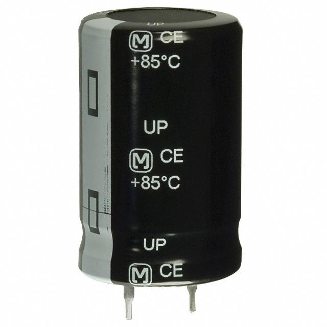

    3300 µF 50 V 铝电解电容器 径向,Can - 卡入式 100 毫欧 @ 120Hz 85°C 时为 2000 小时
ECO-S1HP332AA 数据手册
Large Can Aluminum Electrolytic Capacitors TS-UP Series two terminal snap-in  Compact size for general purpose and industrial applications  NEW: 500 WV ratings, 40mm diameter sizes, extended capacitance ratings  Wide range of case sizes including 20mm lengths for low profile applications  Can vent construction Rated Working Voltage: Operating Temperature: Nominal Capacitance: Dissipation Factor: (120 Hz, +20ºC) 350 ~ 500 VDC -25 ~ +85ºC 33 ~ 680µF (±20% tolerance) 16 ~ 250 VDC -40 ~ +85ºC 120 ~ 68000µF (±20% tolerance) 16 50 Working Voltage [V]: Max. D.F. (%): 25 40 35 35 63 25 80 20 100 20 160 ~ 500 15 (rated cap. [µF] - 33000 ) 1000 For capacitance values > 33000µF, add the value of: Endurance: 50 30 3000 hours* at +85ºC with maximum specified ripple current (see page 4) *2000 hours for 20mm diameter or 20mm length sizes Part Number System E C P Common Code/ Terminal Type Voltage Code Series ECOS 6.3mm Length Terminal (Standard) ECEC 4.0mm Length "Short" Terminal (See page 7) Capacitance Code A B C D E F Case Diameter Suffix, Top Vinyl Plate 25 ~ 50mm lengths With Plate A Without plate B 20mm length With Plate L Without plate G Extended Capacitance Ratings With plate X 20mm 22mm 25mm 30mm 35mm 40mm TS-UP Standard Ratings Cap. (µF) Size (mm) Max 85°C R.C. (A rms) DxL 120Hz 10k~100kHz Max. 20°C ESR (Ω) 120Hz 20kHz Panasonic Cap. Part Number (µF) ECOS1CP682AA ECOS1CP822AA ECOS1CP103AA ECOS1CP123AA ECOS1CP153AA ECOS1CP472BL ECOS1CP472BA ECOS1CP682BA ECOS1CP822BA ECOS1CP103BA ECOS1CP123BA ECOS1CP153BA ECOS1CP183BA ECOS1CP223BA ECOS1CP682CL ECOS1CP103CA ECOS1CP123CA ECOS1CP153CA ECOS1CP183CA ECOS1CP223CA ECOS1CP273CA ECOS1CP333CA ECOS1CP103DL ECOS1CP223DA ECOS1CP273DA ECOS1CP333DA ECOS1CP393DA ECOS1CP473DA ECOS1CP153EL ECOS1CP333EA ECOS1CP393EA ECOS1CP473EA ECOS1CP563EA ECOS1CP683EA ECOS1CP683FA ECOS1CP823FA 4700 5600 6800 8200 3300 3300 4700 5600 6800 8200 10000 12000 15000 4700 6800 8200 10000 12000 15000 18000 22000 6800 10000 12000 15000 18000 22000 27000 33000 10000 27000 33000 39000 47000 47000 56000 Size (mm) Max 85°C R.C. (A rms) DxL 8 20 20 20 20 20 22 22 22 22 22 22 22 22 22 25 25 25 25 25 25 25 25 30 30 30 30 30 30 35 35 35 35 35 35 40 40 x x x x x x x x x x x x x x x x x x x x x x x x x x x x x x x x x x x x 25 30 35 35 40 20 25 25 25 30 30 35 40 45 20 25 25 30 30 35 45 50 20 30 35 40 45 50 20 30 35 40 45 50 40 50 3.15 3.47 3.78 4.52 5.26 1.60 1.77 2.57 3.10 3.78 4.52 5.26 5.57 6.10 1.80 3.78 4.52 5.26 5.57 6.10 6.31 6.84 2.40 6.10 6.31 6.84 6.94 7.47 3.20 6.84 6.94 7.47 8.73 9.05 9.05 10.29 3.62 3.99 4.35 5.20 6.05 1.84 2.04 2.96 3.57 4.35 5.20 6.05 6.41 7.02 2.07 4.35 5.20 6.05 6.41 7.02 7.26 7.87 2.76 7.02 7.26 7.87 7.98 8.59 3.68 7.87 7.98 8.59 10.04 10.41 10.41 11.83 0.098 0.081 0.066 0.062 0.053 0.159 0.159 0.110 0.091 0.075 0.062 0.053 0.046 0.038 0.110 0.075 0.062 0.053 0.046 0.038 0.031 0.025 0.083 0.038 0.031 0.025 0.021 0.019 0.055 0.025 0.021 0.021 0.019 0.018 0.018 0.016 0.083 0.069 0.056 0.053 0.045 0.135 0.135 0.093 0.077 0.063 0.053 0.045 0.039 0.032 0.093 0.063 0.053 0.045 0.039 0.032 0.026 0.021 0.070 0.032 0.026 0.021 0.018 0.017 0.047 0.021 0.018 0.019 0.018 0.017 0.017 0.015 10k~100kHz Multipliers: Page 7 Max. 20°C ESR (Ω) 120Hz 20kHz Panasonic Part Number 25 VDC Working, 32 VDC Surge 16 VDC Working, 20 VDC Surge 6800 8200 10000 12000 15000 4700 4700 6800 8200 10000 12000 15000 18000 22000 6800 10000 12000 15000 18000 22000 27000 33000 10000 22000 27000 33000 39000 47000 15000 33000 39000 47000 56000 68000 68000 82000 120Hz Ripple Current 20 20 20 20 22 22 22 22 22 22 22 22 22 25 25 25 25 25 25 25 25 30 30 30 30 30 30 30 30 35 35 35 35 35 40 40 x x x x x x x x x x x x x x x x x x x x x x x x x x x x x x x x x x x x 25 30 35 40 20 25 25 25 30 30 35 40 50 20 25 25 30 35 40 45 50 20 25 30 30 35 40 45 50 20 35 40 45 50 40 50 3.05 3.36 3.47 3.57 1.60 1.68 2.39 2.86 3.47 3.57 3.78 4.10 4.63 1.80 3.47 3.57 3.78 4.10 4.63 5.47 6.10 2.30 3.78 4.10 4.63 5.47 6.10 6.21 6.84 2.70 6.21 6.84 7.36 8.00 8.00 8.96 3.51 3.86 3.99 4.11 1.84 1.93 2.75 3.29 3.99 4.11 4.35 4.72 5.32 2.07 3.99 4.11 4.35 4.72 5.32 6.29 7.02 2.65 4.35 4.72 5.32 6.29 7.02 7.14 7.87 3.11 7.14 7.87 8.46 9.20 9.20 10.30 0.113 0.095 0.078 0.065 0.176 0.161 0.113 0.095 0.078 0.065 0.058 0.048 0.039 0.123 0.078 0.065 0.058 0.048 0.039 0.035 0.029 0.078 0.058 0.048 0.039 0.035 0.029 0.023 0.020 0.061 0.025 0.020 0.019 0.017 0.017 0.016 0.090 0.076 0.062 0.052 0.141 0.129 0.090 0.076 0.062 0.052 0.046 0.039 0.031 0.099 0.062 0.052 0.046 0.039 0.031 0.028 0.023 0.062 0.046 0.039 0.031 0.028 0.023 0.019 0.017 0.049 0.020 0.017 0.017 0.015 0.015 0.015 ECOS1EP472AA ECOS1EP562AA ECOS1EP682AA ECOS1EP822AA ECOS1EP332BL ECOS1EP332BA ECOS1EP472BA ECOS1EP562BA ECOS1EP682BA ECOS1EP822BA ECOS1EP103BA ECOS1EP123BA ECOS1EP153BA ECOS1EP472CL ECOS1EP682CA ECOS1EP822CA ECOS1EP103CA ECOS1EP123CA ECOS1EP153CA ECOS1EP183CA ECOS1EP223CA ECOS1EP682DL ECOS1EP103DA ECOS1EP123DA ECOS1EP153DA ECOS1EP183DA ECOS1EP223DA ECOS1EP273DA ECOS1EP333DA ECOS1EP103EL ECOS1EP273EA ECOS1EP333EA ECOS1EP393EA ECOS1EP473EA ECOS1EP473FA ECOS1EP563FA Design and specifications are subject to change without notice. Ask factory for technical specifications before purchase and/or use. Whenever a doubt about safety arises from this product, please contact us immediately for technical consultation. Large Can Aluminum Electrolytic Capacitors TS-UP Standard Ratings (continued) Cap. Size (mm) Max 85°C R.C. (A rms) (µF) DxL 120Hz 10k~100kHz Max. 20°C ESR (Ω) 120Hz 20kHz Panasonic Cap. Part Number (µF) ECOS1VP332AA ECOS1VP392AA ECOS1VP472AA ECOS1VP562AA ECOS1VP222BL ECOS1VP222BA ECOS1VP332BA ECOS1VP392BA ECOS1VP472BA ECOS1VP562BA ECOS1VP682BA ECOS1VP822BA ECOS1VP103BA ECOS1VP332CL ECOS1VP472CA ECOS1VP562CA ECOS1VP682CA ECOS1VP822CA ECOS1VP103CA ECOS1VP123CA ECOS1VP153CA ECOS1VP472DL ECOS1VP103DA ECOS1VP123DA ECOS1VP153DA ECOS1VP183DA ECOS1VP223DA ECOS1VP682EL ECOS1VP103EA ECOS1VP123EA ECOS1VP153EA ECOS1VP183EA ECOS1VP223EA ECOS1VP273EA ECOS1VP333EA ECOS1VP273FA ECOS1VP393FA 2200 2700 3300 3900 1500 1500 2200 2700 3300 3900 4700 5600 6800 2200 3300 3900 4700 5600 6800 8200 10000 3300 4700 5600 6800 8200 10000 12000 15000 4700 10000 12000 15000 18000 22000 18000 27000 20 20 20 20 22 22 22 22 22 22 22 22 22 25 25 25 25 25 25 25 25 30 30 30 30 30 30 30 30 35 35 35 35 35 35 40 40 x x x x x x x x x x x x x x x x x x x x x x x x x x x x x x x x x x x x x 25 30 35 40 20 25 25 25 30 30 35 40 50 20 25 25 30 35 40 45 50 20 25 30 30 35 40 45 50 20 30 35 40 45 50 40 50 ECOS1JP222AA ECOS1JP272AA ECOS1JP102BL ECOS1JP102BA ECOS1JP152BA ECOS1JP182BA ECOS1JP222BA ECOS1JP272BA ECOS1JP332BA ECOS1JP392BA ECOS1JP472BA ECOS1JP152CL ECOS1JP222CA ECOS1JP272CA ECOS1JP332CA ECOS1JP392CA ECOS1JP472CA ECOS1JP562CA ECOS1JP682CA ECOS1JP222DL ECOS1JP332DA ECOS1JP392DA ECOS1JP472DA ECOS1JP562DA ECOS1JP682DA ECOS1JP822DA ECOS1JP332EL ECOS1JP472EA ECOS1JP562EA ECOS1JP682EA ECOS1JP822EA ECOS1JP103EA ECOS1JP123EA ECOS1JP123FA ECOS1JP153FA 1200 1500 1800 680 680 1000 1200 1500 1800 2200 2700 3300 1000 1500 1800 2200 2700 3300 3900 4700 1500 2200 2700 3300 3900 4700 5600 6800 2200 5600 6800 8200 8200 10000 20 20 20 22 22 22 22 22 22 22 22 22 25 25 25 25 25 25 25 25 30 30 30 30 30 30 30 30 35 35 35 35 40 40 x x x x x x x x x x x x x x x x x x x x x x x x x x x x x x x x x x 30 35 40 20 25 25 25 30 35 40 45 50 20 25 30 30 35 40 45 50 20 25 30 30 35 40 45 50 20 35 40 50 40 50 Size (mm) Max 85°C R.C. (A rms) DxL 35 VDC Working, 44 VDC Surge 3300 3900 4700 5600 2200 2200 3300 3900 4700 5600 6800 8200 10000 3300 4700 5600 6800 8200 10000 12000 15000 4700 10000 12000 15000 18000 22000 6800 10000 12000 15000 18000 22000 27000 33000 27000 39000 20 20 20 20 22 22 22 22 22 22 22 22 22 25 25 25 25 25 25 25 25 30 30 30 30 30 30 35 35 35 35 35 35 35 35 40 40 x x x x x x x x x x x x x x x x x x x x x x x x x x x x x x x x x x x x x 25 30 35 40 20 25 25 25 30 30 35 40 45 20 25 25 30 35 40 45 50 20 30 35 40 45 50 20 25 30 30 35 40 45 50 40 50 2.73 2.94 3.26 3.36 1.40 1.52 2.29 2.71 3.26 3.36 3.68 4.00 4.42 1.70 3.26 3.36 3.68 4.00 4.42 5.05 5.57 2.00 4.42 5.05 5.57 5.68 6.10 2.40 4.42 5.05 5.57 5.68 6.10 6.84 7.15 6.84 7.98 2200 2700 1000 1000 1500 1800 2200 2700 3300 3900 4700 1500 2200 2700 3300 3900 4700 5600 6800 2200 3300 3900 4700 5600 6800 8200 3300 4700 5600 6800 8200 10000 12000 12000 15000 20 20 22 22 22 22 22 22 22 22 22 25 25 25 25 25 25 25 25 30 30 30 30 30 30 30 35 35 35 35 35 35 35 40 40 x x x x x x x x x x x x x x x x x x x x x x x x x x x x x x x x x x x 35 40 20 25 25 25 30 35 40 45 50 20 25 30 30 35 40 45 50 20 25 30 30 35 40 45 20 25 30 30 35 40 50 40 50 2.52 3.73 1.20 1.20 1.72 2.06 2.52 3.73 4.10 4.44 4.86 1.30 2.52 3.73 4.10 4.44 4.86 5.36 5.84 1.50 4.10 4.44 4.86 5.36 5.84 6.00 1.70 4.86 5.36 5.84 6.00 6.52 7.15 7.15 7.53 3.14 3.38 3.75 3.86 1.61 1.75 2.63 3.12 3.75 3.86 4.23 4.60 5.08 1.96 3.75 3.86 4.23 4.60 5.08 5.81 6.41 2.30 5.08 5.81 6.41 6.53 7.02 2.76 5.08 5.81 6.41 6.53 7.02 7.87 8.22 7.87 9.18 0.111 0.094 0.078 0.080 0.181 0.166 0.111 0.094 0.078 0.080 0.066 0.057 0.050 0.121 0.078 0.080 0.066 0.057 0.050 0.044 0.036 0.088 0.050 0.044 0.036 0.030 0.026 0.071 0.050 0.044 0.036 0.030 0.026 0.021 0.018 0.021 0.017 0.083 0.070 0.058 0.060 0.136 0.124 0.083 0.070 0.058 0.060 0.049 0.042 0.037 0.090 0.058 0.060 0.049 0.042 0.037 0.033 0.027 0.066 0.037 0.033 0.027 0.023 0.020 0.053 0.037 0.033 0.027 0.023 0.020 0.017 0.014 0.017 0.014 0.151 0.123 0.381 0.332 0.221 0.184 0.151 0.123 0.105 0.098 0.081 0.254 0.151 0.123 0.105 0.098 0.081 0.068 0.061 0.173 0.105 0.098 0.081 0.068 0.061 0.051 0.126 0.081 0.068 0.061 0.051 0.041 0.035 0.035 0.033 0.113 0.092 0.286 0.249 0.166 0.138 0.113 0.092 0.079 0.073 0.061 0.191 0.113 0.092 0.079 0.073 0.061 0.051 0.046 0.130 0.079 0.073 0.061 0.051 0.046 0.038 0.094 0.061 0.051 0.046 0.038 0.033 0.028 0.028 0.027 10k~100kHz Max. 20°C ESR (Ω) 120Hz 20kHz Panasonic Part Number 50 VDC Working, 63 VDC Surge 63 VDC Working, 79 VDC Surge 2.90 4.29 1.38 1.38 1.98 2.37 2.90 4.29 4.72 5.11 5.59 1.50 2.90 4.29 4.72 5.11 5.59 6.16 6.72 1.73 4.72 5.11 5.59 6.16 6.72 6.90 1.96 5.59 6.16 6.72 6.90 7.50 8.22 8.22 8.66 120Hz 2.26 2.52 2.73 2.75 1.20 1.24 1.82 2.23 2.73 2.75 3.03 3.42 3.85 1.40 2.73 2.75 3.03 3.42 3.85 4.41 4.97 1.70 3.03 3.42 3.85 4.41 4.97 5.58 6.44 2.10 4.97 5.58 6.44 6.94 7.57 6.94 8.80 2.60 2.90 3.14 3.16 1.38 1.43 2.09 2.56 3.14 3.16 3.48 3.93 4.43 1.61 3.14 3.16 3.48 3.93 4.43 5.07 5.72 1.96 3.48 3.93 4.43 5.07 5.72 6.42 7.41 2.42 5.72 6.42 7.41 7.98 8.71 7.98 10.12 0.151 0.123 0.100 0.085 0.254 0.221 0.151 0.123 0.100 0.085 0.071 0.059 0.049 0.173 0.100 0.085 0.071 0.059 0.049 0.040 0.036 0.116 0.071 0.059 0.049 0.040 0.036 0.032 0.028 0.081 0.036 0.032 0.028 0.023 0.021 0.023 0.018 0.113 0.092 0.075 0.064 0.191 0.166 0.113 0.092 0.075 0.064 0.053 0.044 0.037 0.130 0.075 0.064 0.053 0.044 0.037 0.030 0.027 0.087 0.053 0.044 0.037 0.030 0.027 0.024 0.021 0.061 0.027 0.024 0.021 0.018 0.017 0.017 0.015 ECOS1HP222AA ECOS1HP272AA ECOS1HP332AA ECOS1HP392AA ECOS1HP152BL ECOS1HP152BA ECOS1HP222BA ECOS1HP272BA ECOS1HP332BA ECOS1HP392BA ECOS1HP472BA ECOS1HP562BA ECOS1HP682BA ECOS1HP222CL ECOS1HP332CA ECOS1HP392CA ECOS1HP472CA ECOS1HP562CA ECOS1HP682CA ECOS1HP822CA ECOS1HP103CA ECOS1HP332DL ECOS1HP472DA ECOS1HP562DA ECOS1HP682DA ECOS1HP822DA ECOS1HP103DA ECOS1HP123DA ECOS1HP153DA ECOS1HP472EL ECOS1HP103EA ECOS1HP123EA ECOS1HP153EA ECOS1HP183EA ECOS1HP223EA ECOS1HP183FA ECOS1HP273FA 80 VDC Working, 100 VDC Surge 2.08 2.26 2.52 1.00 1.02 1.51 1.81 2.26 2.52 2.73 2.78 3.21 1.20 2.26 2.52 2.73 2.78 3.21 3.59 4.09 1.40 2.73 2.78 3.21 3.59 4.09 4.55 5.16 1.70 4.55 5.16 5.83 5.83 6.56 2.39 2.60 2.90 1.15 1.17 1.74 2.08 2.60 2.90 3.14 3.20 3.69 1.38 2.60 2.90 3.14 3.20 3.69 4.13 4.70 1.61 3.14 3.20 3.69 4.13 4.70 5.23 5.93 1.96 5.23 5.93 6.70 6.70 7.54 0.221 0.177 0.147 0.439 0.390 0.265 0.221 0.177 0.147 0.121 0.098 0.085 0.298 0.177 0.147 0.121 0.098 0.085 0.077 0.063 0.199 0.121 0.098 0.085 0.077 0.063 0.056 0.046 0.136 0.056 0.046 0.038 0.038 0.033 0.166 0.133 0.111 0.329 0.293 0.199 0.166 0.133 0.111 0.090 0.074 0.064 0.224 0.133 0.111 0.090 0.074 0.064 0.057 0.048 0.149 0.090 0.074 0.064 0.057 0.048 0.042 0.035 0.102 0.042 0.035 0.029 0.029 0.025 ECOS1KP122AA ECOS1KP152AA ECOS1KP182AA ECOS1KP681BL ECOS1KP681BA ECOS1KP102BA ECOS1KP122BA ECOS1KP152BA ECOS1KP182BA ECOS1KP222BA ECOS1KP272BA ECOS1KP332BA ECOS1KP102CL ECOS1KP152CA ECOS1KP182CA ECOS1KP222CA ECOS1KP272CA ECOS1KP332CA ECOS1KP392CA ECOS1KP472CA ECOS1KP152DL ECOS1KP222DA ECOS1KP272DA ECOS1KP332DA ECOS1KP392DA ECOS1KP472DA ECOS1KP562DA ECOS1KP682DA ECOS1KP222EL ECOS1KP562EA ECOS1KP682EA ECOS1KP822EA ECOS1KP822FA ECOS1KP103FA Design and specifications are subject to change without notice. Ask factory for technical specifications before purchase and/or use. Whenever a doubt about safety arises from this product, please contact us immediately for technical consultation. 9 Large Can Aluminum Electrolytic Capacitors TS-UP Standard Ratings (continued) Cap. (µF) Size (mm) Max 85°C R.C. (A rms) DxL 120Hz 10k~100kHz Max. 20°C ESR (Ω) 120Hz 20kHz Size (mm) Max 85°C R.C. (A rms) Panasonic Cap. Part Number (µF) ECOS2AP561AA ECOS2AP821AA ECOS2AP102AA ECOS2AP122AA ECOS2AP471BL ECOS2AP471BA ECOS2AP561BA ECOS2AP681BA ECOS2AP102BA ECOS2AP122BA ECOS2AP152BA ECOS2AP182BA ECOS2AP222BA ECOS2AP681CL ECOS2AP102CA ECOS2AP122CA ECOS2AP152CA ECOS2AP182CA ECOS2AP222CA ECOS2AP272CA ECOS2AP332CA ECOS2AP102DL ECOS2AP152DA ECOS2AP182DA ECOS2AP222DA ECOS2AP272DA ECOS2AP332DA ECOS2AP392DA ECOS2AP472DA ECOS2AP152EL ECOS2AP222EA ECOS2AP272EA ECOS2AP392EA ECOS2AP472EA ECOS2AP562EA ECOS2AP682EA ECOS2AP562FA ECOS2AP822FA 330 390 220 220 270 330 390 470 560 560 680 680 820 820 1000 270 390 470 560 560 680 820 1000 1000 1200 1500 390 680 820 820 1000 1000 1200 1500 1800 2200 560 1000 1200 1500 1500 1800 2200 2200 2700 20 20 22 22 22 22 22 22 22 22 22 22 22 22 22 25 25 25 25 25 25 25 25 25 25 25 30 30 30 30 30 30 30 30 30 30 35 35 35 35 35 35 35 35 35 x x x x x x x x x x x x x x x x x x x x x x x x x x x x x x x x x x x x x x x x x x x x x 30 35 20 25 25 25 25 30 30 35 35 40 40 45 45 20 25 25 25 30 30 35 40 45 50 50 20 25 25 30 30 35 35 45 50 50 20 30 30 30 35 35 40 45 50 ECOS2DP271AA ECOS2DP331AA ECOS2DP471AX ECOS2DP151BL ECOS2DP151BA ECOS2DP221BA ECOS2DP271BA ECOS2DP331BX ECOS2DP391BA ECOS2DP471BA ECOS2DP561BA ECOS2DP681BA ECOS2DP221CL ECOS2DP391CA ECOS2DP471CA ECOS2DP561CX ECOS2DP681CA ECOS2DP821CA ECOS2DP102CX ECOS2DP102CA ECOS2DP331DL ECOS2DP561DA ECOS2DP681DA ECOS2DP821DX ECOS2DP821DA ECOS2DP102DX 180 220 120 120 150 180 220 270 330 390 470 150 270 330 390 390 470 470 560 560 680 680 220 390 470 470 560 20 20 22 22 22 22 22 22 22 22 22 25 25 25 25 25 25 25 25 25 25 25 30 30 30 30 30 x x x x x x x x x x x x x x x x x x x x x x x x x x x 30 35 20 25 25 25 25 30 35 40 45 20 25 30 30 35 35 40 40 45 45 50 20 25 25 30 30 DxL 100 VDC Working, 125 VDC Surge 560 820 1000 1200 470 470 560 680 1000 1200 1500 1800 2200 680 1000 1200 1500 1800 2200 2700 3300 1000 1500 1800 2200 2700 3300 3900 4700 1500 2200 2700 3900 4700 5600 6800 5600 8200 20 20 20 20 22 22 22 22 22 22 22 22 22 25 25 25 25 25 25 25 25 30 30 30 30 30 30 30 30 35 35 35 35 35 35 35 40 40 x x x x x x x x x x x x x x x x x x x x x x x x x x x x x x x x x x x x x x 25 30 35 40 20 25 25 25 30 35 40 45 50 20 25 30 30 35 40 45 50 20 25 30 30 35 40 45 50 20 25 30 35 40 45 50 40 50 270 330 470 150 150 220 270 330 390 470 560 680 220 390 470 560 680 820 1000 1000 330 560 680 820 820 1000 20 20 20 22 22 22 22 22 22 22 22 22 25 25 25 25 25 25 25 25 30 30 30 30 30 30 x x x x x x x x x x x x x x x x x x x x x x x x x x 30 35 40 20 25 25 25 25 30 35 40 45 20 25 30 30 35 45 45 50 20 25 30 30 35 35 1.35 1.59 1.96 2.31 1.00 1.11 1.32 1.61 1.96 2.31 2.57 2.84 3.14 1.10 1.96 2.31 2.57 2.84 3.14 3.71 4.06 1.20 2.57 2.84 3.14 3.71 4.06 4.54 5.13 1.50 3.14 3.71 4.54 5.13 5.75 6.60 5.75 7.28 1.55 1.83 2.25 2.66 1.15 1.28 1.52 1.85 2.25 2.66 2.96 3.27 3.61 1.27 2.25 2.66 2.96 3.27 3.61 4.27 4.67 1.38 2.96 3.27 3.61 4.27 4.67 5.22 5.90 1.73 3.61 4.27 5.22 5.90 6.61 7.59 6.61 8.37 0.385 0.263 0.216 0.180 0.459 0.459 0.385 0.317 0.216 0.193 0.155 0.129 0.121 0.366 0.216 0.180 0.155 0.138 0.121 0.104 0.090 0.249 0.155 0.138 0.121 0.104 0.090 0.077 0.071 0.177 0.121 0.104 0.081 0.071 0.059 0.049 0.059 0.040 0.250 0.171 0.140 0.117 0.298 0.298 0.250 0.206 0.140 0.126 0.101 0.084 0.078 0.238 0.140 0.117 0.101 0.090 0.078 0.068 0.059 0.162 0.101 0.090 0.078 0.068 0.059 0.050 0.049 0.115 0.078 0.068 0.052 0.049 0.041 0.037 0.044 0.030 10 1.97 2.18 2.59 0.91 0.99 1.46 1.97 2.18 2.35 2.59 3.40 3.75 1.22 2.35 2.59 3.40 3.75 4.10 4.55 4.55 1.40 3.40 3.75 4.10 4.10 4.55 0.614 0.553 0.388 1.326 1.216 0.829 0.614 0.553 0.468 0.388 0.326 0.268 0.904 0.468 0.388 0.326 0.268 0.222 0.199 0.199 0.603 0.326 0.268 0.222 0.222 0.199 0.276 0.249 0.175 0.597 0.547 0.373 0.276 0.249 0.210 0.175 0.147 0.121 0.407 0.210 0.175 0.147 0.121 0.100 0.090 0.090 0.271 0.147 0.121 0.100 0.100 0.090 10k~100kHz Max. 20°C ESR (Ω) 120Hz 20kHz Panasonic Part Number 160 VDC Working, 200 VDC Surge 200 VDC Working, 250 VDC Surge 1.41 1.56 1.85 0.65 0.71 1.04 1.41 1.56 1.68 1.85 2.43 2.68 0.87 1.68 1.85 2.43 2.68 2.93 3.25 3.25 1.00 2.43 2.68 2.93 2.93 3.25 120Hz 1.45 1.62 0.75 0.91 1.19 1.45 1.62 2.11 2.25 2.25 2.50 2.50 2.50 2.75 3.00 0.87 1.62 2.11 2.25 2.25 2.50 2.75 3.00 3.00 3.25 3.73 1.10 2.50 2.75 2.75 3.00 3.00 3.25 3.73 4.20 4.78 1.30 3.00 3.25 3.73 3.73 4.20 4.78 4.78 5.45 2.03 2.27 1.05 1.27 1.67 2.03 2.27 2.95 3.15 3.15 3.50 3.50 3.50 3.85 4.20 1.22 2.27 2.95 3.15 3.15 3.50 3.85 4.20 4.20 4.55 5.22 1.54 3.50 3.85 3.85 4.20 4.20 4.55 5.22 5.88 6.69 1.82 4.20 4.55 5.22 5.22 5.88 6.69 6.69 7.63 0.553 0.468 0.980 0.829 0.675 0.553 0.468 0.423 0.355 0.355 0.293 0.293 0.243 0.263 0.216 0.798 0.468 0.423 0.355 0.355 0.293 0.263 0.216 0.232 0.207 0.166 0.595 0.293 0.263 0.263 0.232 0.232 0.207 0.166 0.138 0.105 0.414 0.232 0.207 0.166 0.166 0.138 0.113 0.113 0.092 0.276 0.234 0.490 0.414 0.338 0.276 0.234 0.212 0.178 0.178 0.146 0.146 0.121 0.131 0.108 0.399 0.234 0.212 0.178 0.178 0.146 0.131 0.108 0.128 0.114 0.091 0.298 0.146 0.131 0.131 0.128 0.128 0.114 0.091 0.083 0.053 0.207 0.128 0.114 0.091 0.091 0.083 0.073 0.073 0.060 ECOS2CP331AA ECOS2CP391AA ECOS2CP221BL ECOS2CP221BA ECOS2CP271BA ECOS2CP331BA ECOS2CP391BX ECOS2CP471BA ECOS2CP561BX ECOS2CP561BA ECOS2CP681BX ECOS2CP681BA ECOS2CP821BX ECOS2CP821BA ECOS2CP102BX ECOS2CP271CL ECOS2CP391CA ECOS2CP471CA ECOS2CP561CX ECOS2CP561CA ECOS2CP681CX ECOS2CP821CA ECOS2CP102CX ECOS2CP102CA ECOS2CP122CA ECOS2CP152CX ECOS2CP391DL ECOS2CP681DA ECOS2CP821DX ECOS2CP821DA ECOS2CP102DX ECOS2CP102DA ECOS2CP122DA ECOS2CP152DA ECOS2CP182DA ECOS2CP222DX ECOS2CP561EL ECOS2CP102EA ECOS2CP122EA ECOS2CP152EX ECOS2CP152EA ECOS2CP182EX ECOS2CP222EX ECOS2CP222EA ECOS2CP272EA 250 VDC Working, 300 VDC Surge 1.07 1.17 0.45 0.71 0.89 1.07 1.17 1.31 1.75 1.91 2.11 0.65 1.31 1.75 1.91 1.91 2.11 2.11 2.25 2.25 2.50 2.50 0.87 1.91 2.11 2.11 2.25 1.50 1.64 0.63 0.99 1.25 1.50 1.64 1.83 2.45 2.67 2.95 0.91 1.83 2.45 2.67 2.67 2.95 2.95 3.15 3.15 3.50 3.50 1.22 2.67 2.95 2.95 3.15 0.921 0.754 1.658 1.520 1.216 0.921 0.754 0.614 0.553 0.468 0.388 1.326 0.614 0.502 0.468 0.468 0.388 0.388 0.326 0.326 0.268 0.268 0.829 0.425 0.353 0.388 0.326 0.368 0.301 0.663 0.608 0.486 0.368 0.301 0.246 0.221 0.187 0.155 0.531 0.246 0.201 0.187 0.187 0.155 0.155 0.130 0.130 0.107 0.107 0.332 0.170 0.141 0.155 0.130 ECOS2EP181AA ECOS2EP221AA ECOS2EP121BL ECOS2EP121BA ECOS2EP151BA ECOS2EP181BA ECOS2EP221BX ECOS2EP271BA ECOS2EP331BA ECOS2EP391BA ECOS2EP471BA ECOS2EP151CL ECOS2EP271CA ECOS2EP331CA ECOS2EP391CX ECOS2EP391CA ECOS2EP471CX ECOS2EP471CA ECOS2EP561CX ECOS2EP561CA ECOS2EP681CX ECOS2EP681CA ECOS2EP221DL ECOS2EP391DA ECOS2EP471DX ECOS2EP471DA ECOS2EP561DX Design and specifications are subject to change without notice. Ask factory for technical specifications before purchase and/or use. Whenever a doubt about safety arises from this product, please contact us immediately for technical consultation. Large Can Aluminum Electrolytic Capacitors TS-UP Standard Ratings (continued) Cap. Size (mm) Max. 85°C R.C. (A rms) Max. 20°C ESR (Ω) Size (mm) Max. 85°C R.C. (A rms) Panasonic Cap. Part Number (µF) DxL Max. 20°C ESR (Ω) Panasonic (µF) DxL 1000 30 x 40 3.25 4.55 0.199 0.090 ECOS2DP102DA 560 30 x 35 2.25 3.15 0.326 0.130 1200 30 x 40 3.50 4.90 0.166 0.075 ECOS2DP122DX 680 30 x 35 2.25 3.15 0.268 0.107 ECOS2EP681DX 1200 30 x 45 3.50 4.90 0.166 0.075 ECOS2DP122DA 680 30 x 40 2.50 3.50 0.268 0.107 ECOS2EP681DA 1500 30 x 45 3.87 5.42 0.144 0.072 ECOS2DP152DX 820 30 x 40 2.50 3.50 0.222 0.089 ECOS2EP821DX 1500 30 x 50 3.87 5.42 0.144 0.072 ECOS2DP152DA 820 30 x 45 2.77 3.88 0.222 0.089 ECOS2EP821DA 1800 30 x 50 4.32 6.05 0.120 0.060 ECOS2DP182DX 1000 30 x 45 3.32 4.65 0.182 0.073 ECOS2EP102DX 470 35 x 20 1.30 1.82 0.459 0.206 ECOS2DP471EL 1000 30 x 50 3.32 4.65 0.199 0.090 ECOS2EP102DA 820 35 x 25 2.93 4.10 0.243 0.109 ECOS2DP821EA 330 35 x 20 1.10 1.54 0.553 0.221 ECOS2EP331EL 1000 35 x 30 3.25 4.55 0.199 0.090 ECOS2DP102EA 560 35 x 25 2.25 3.15 0.326 0.130 ECOS2EP561EA 1200 35 x 30 3.50 4.90 0.166 0.075 ECOS2DP122EX 680 35 x 30 2.50 3.50 0.268 0.107 ECOS2EP681EA 1200 35 x 35 3.50 4.90 0.166 0.075 ECOS2DP122EA 820 35 x 30 2.77 3.88 0.222 0.089 ECOS2EP821EX 1500 35 x 35 3.87 5.42 0.144 0.072 ECOS2DP152EX 820 35 x 35 2.77 3.88 0.243 0.109 ECOS2EP821EA 120Hz 10k~100kHz 120Hz 20kHz 200 VDC Working, 250 VDC Surge (continued) 120Hz 10k~100kHz 120Hz 20kHz Part Number 250 VDC Working, 300 VDC Surge (continued) ECOS2EP561DA 1500 35 x 40 3.87 5.42 0.144 0.072 ECOS2DP152EA 1000 35 x 35 3.32 4.65 0.199 0.090 ECOS2EP102EX 1800 35 x 40 4.32 6.05 0.120 0.060 ECOS2DP182EX 1000 35 x 40 3.32 4.65 0.199 0.099 ECOS2EP102EA 1800 35 x 45 4.32 6.05 0.120 0.060 ECOS2DP182EA 1200 35 x 40 3.53 4.94 0.166 0.083 ECOS2EP122EX 2200 35 x 45 4.92 6.89 0.098 0.054 ECOS2DP222EX 1200 35 x 45 3.53 4.94 0.166 0.083 ECOS2EP122EA 2200 35 x 50 4.92 6.89 0.098 0.054 ECOS2DP222EA 1500 35 x 50 4.04 5.66 0.133 0.066 ECOS2EP152EA 2200 40 x 40 4.92 6.89 0.098 0.054 ECOS2DP222FA 1500 40 x 40 4.04 5.66 0.133 0.066 ECOS2EP152FA 2700 40 x 50 5.41 7.57 0.080 0.044 ECOS2DP272FA 1800 40 x 50 4.49 6.29 0.111 0.055 ECOS2EP182FA 82 20 x 30 0.83 1.16 2.022 0.708 ECOS2VP820AA 68 20 x 30 0.76 1.06 2.438 0.853 ECOS2TP680AA 100 20 x 35 0.91 1.27 1.658 0.580 ECOS2VP101AA 82 20 x 30 0.83 1.16 2.022 0.708 ECOS2TP820AA 82 22 x 25 0.83 1.16 2.022 0.708 ECOS2VP820BA 100 20 x 35 0.92 1.29 1.658 0.580 ECOS2TP101AA 100 22 x 30 0.91 1.27 1.658 0.580 ECOS2VP101BA 120 20 x 40 1.02 1.43 1.382 0.553 ECOS2TP121AA 120 22 x 30 1.00 1.40 1.382 0.484 ECOS2VP121BA 47 22 x 20 0.25 0.35 4.233 1.481 ECOS2TP470BL 150 22 x 35 1.12 1.57 1.105 0.387 ECOS2VP151BA 68 22 x 25 0.76 1.06 2.438 0.853 ECOS2TP680BA 180 22 x 40 1.22 1.71 0.921 0.322 ECOS2VP181BA 82 22 x 25 0.83 1.16 2.022 0.708 ECOS2TP820BA 220 22 x 45 1.44 2.02 0.754 0.264 ECOS2VP221BA 100 22 x 30 0.92 1.29 1.658 0.580 ECOS2TP101BA 120 25 x 25 1.00 1.40 1.382 0.484 ECOS2VP121CA 120 22 x 35 1.02 1.43 1.382 0.553 ECOS2TP121BA 150 25 x 25 1.12 1.57 1.105 0.387 ECOS2VP151CX 150 22 x 35 1.16 1.62 1.105 0.442 ECOS2TP151BX 150 25 x 30 1.12 1.57 1.105 0.387 ECOS2VP151CA 150 22 x 40 1.16 1.62 1.105 0.442 ECOS2TP151BA 180 25 x 30 1.22 1.71 0.921 0.322 ECOS2VP181CX 180 22 x 40 1.44 2.02 0.921 0.368 ECOS2TP181BX 180 25 x 35 1.22 1.71 0.921 0.322 ECOS2VP181CA 180 22 x 45 1.44 2.02 0.921 0.368 ECOS2TP181BA 220 25 x 35 1.44 2.02 0.754 0.264 ECOS2VP221CX 220 22 x 45 1.49 2.09 0.829 0.373 ECOS2TP221BX 220 25 x 40 1.44 2.02 0.754 0.264 ECOS2VP221CA 220 22 x 50 1.49 2.09 0.829 0.373 ECOS2TP221BA 270 25 x 40 1.66 2.32 0.614 0.215 ECOS2VP271CX 68 25 x 20 0.35 0.49 2.926 1.024 ECOS2TP680CL 330 25 x 50 1.88 2.63 0.502 0.176 ECOS2VP331CA 100 25 x 25 0.92 1.29 1.658 0.580 ECOS2TP101CA 350 VDC Working, 400 VDC Surge 385 VDC Working, 435 VDC Surge 390 25 x 50 2.06 2.88 0.425 0.149 ECOS2VP391CX 120 25 x 25 1.02 1.43 1.382 0.553 ECOS2TP121CX 150 30 x 25 1.12 1.57 1.105 0.387 ECOS2VP151DA 120 25 x 30 1.02 1.43 1.382 0.553 ECOS2TP121CA 180 30 x 25 1.22 1.71 0.921 0.322 ECOS2VP181DA 150 25 x 30 1.16 1.62 1.105 0.442 ECOS2TP151CA 220 30 x 25 1.44 2.02 0.754 0.264 ECOS2VP221DX 180 25 x 30 1.44 2.02 0.921 0.368 ECOS2TP181CX 220 30 x 30 1.44 2.02 0.754 0.264 ECOS2VP221DA 180 25 x 35 1.44 2.02 0.921 0.368 ECOS2TP181CA 270 30 x 30 1.66 2.32 0.614 0.215 ECOS2VP271DX 220 25 x 40 1.49 2.09 0.829 0.373 ECOS2TP221CA 270 30 x 35 1.66 2.32 0.614 0.215 ECOS2VP271DA 270 25 x 45 1.67 2.34 0.675 0.304 ECOS2TP271CA 330 30 x 35 1.88 2.63 0.502 0.176 ECOS2VP331DX 330 25 x 50 1.90 2.66 0.553 0.249 ECOS2TP331CX 330 30 x 40 1.88 2.63 0.502 0.176 ECOS2VP331DA 100 30 x 20 0.47 0.66 1.989 0.696 ECOS2TP101DL 390 30 x 40 2.06 2.88 0.425 0.149 ECOS2VP391DX 150 30 x 25 1.16 1.62 1.105 0.442 ECOS2TP151DA 390 30 x 45 2.06 2.88 0.468 0.164 ECOS2VP391DA 180 30 x 25 1.44 2.02 0.921 0.368 ECOS2TP181DX 470 30 x 50 2.40 3.36 0.388 0.136 ECOS2VP471DA 180 30 x 30 1.44 2.02 0.921 0.368 ECOS2TP181DA 560 30 x 50 2.60 3.64 0.326 0.114 ECOS2VP561DX 220 30 x 30 1.49 2.09 0.829 0.373 ECOS2TP221DA 220 35 x 25 1.44 2.02 0.754 0.264 ECOS2VP221EA 270 30 x 35 1.67 2.34 0.675 0.304 ECOS2TP271DA 270 35 x 25 1.66 2.32 0.614 0.215 ECOS2VP271EX 330 30 x 40 1.90 2.66 0.553 0.249 ECOS2TP331DA 270 35 x 30 1.66 2.32 0.614 0.215 ECOS2VP271EA 390 30 x 45 2.13 2.98 0.468 0.210 ECOS2TP391DA 330 35 x 30 1.88 2.63 0.502 0.176 ECOS2VP331EA 470 30 x 50 2.39 3.35 0.388 0.175 ECOS2TP471DA 390 35 x 30 2.06 2.88 0.425 0.149 ECOS2VP391EX 150 35 x 20 0.60 0.84 1.326 0.531 ECOS2TP151EL 390 35 x 35 2.06 2.88 0.425 0.149 ECOS2VP391EA 270 35 x 25 1.67 2.34 0.675 0.304 ECOS2TP271EX 470 35 x 35 2.40 3.36 0.353 0.123 ECOS2VP471EX 270 35 x 30 1.67 2.34 0.675 0.304 ECOS2TP271EA 470 35 x 40 2.40 3.36 0.353 0.123 ECOS2VP471EA 330 35 x 30 1.90 2.66 0.553 0.249 ECOS2TP331EX 560 35 x 40 2.60 3.64 0.296 0.104 ECOS2VP561EX 330 35 x 35 1.90 2.66 0.553 0.249 ECOS2TP331EA 560 35 x 45 2.60 3.64 0.296 0.104 ECOS2VP561EA 390 35 x 35 2.13 2.98 0.468 0.210 ECOS2TP391EX 680 35 x 45 2.96 4.14 0.293 0.117 ECOS2VP681EX 390 35 x 40 2.13 2.98 0.468 0.210 ECOS2TP391EA 680 35 x 50 2.96 4.14 0.293 0.117 ECOS2VP681EA 470 35 x 40 2.39 3.35 0.388 0.175 ECOS2TP471EX 820 35 x 50 3.55 4.97 0.243 0.097 ECOS2VP821EX 470 35 x 45 2.39 3.35 0.388 0.175 ECOS2TP471EA 680 40 x 40 2.96 4.14 0.293 0.117 ECOS2VP681FA 560 35 x 45 2.69 3.77 0.326 0.147 ECOS2TP561EX 1000 40 x 50 3.80 5.32 0.199 0.080 ECOS2VP102FA 560 35 x 50 2.69 3.77 0.326 0.147 ECOS2TP561EA 680 35 x 50 3.00 4.20 0.268 0.121 ECOS2TP681EX Design and specifications are subject to change without notice. Ask factory for technical specifications before purchase and/or use. Whenever a doubt about safety arises from this product, please contact us immediately for technical consultation. 11 Large Can Aluminum Electrolytic Capacitors TS-UP Standard Ratings (continued) Cap. Size (mm) Max. 85°C R.C. (A rms) 120Hz Max. 20°C ESR (Ω) Cap. (µF) DxL 0.708 ECOS2GP820AA 56 20 x 30 0.70 0.98 2.960 1.184 ECOS2WP560AA 1.658 0.580 ECOS2GP101AA 82 20 x 35 0.83 1.16 2.022 0.809 ECOS2WP820AA 1.43 1.382 0.484 ECOS2GP121AA 33 22 x 20 0.20 0.28 6.028 2.411 ECOS2WP330BL 0.35 3.527 1.235 ECOS2GP470BL 33 22 x 25 0.41 0.57 6.028 2.411 ECOS2WP330BA DxL 10k~100kHz 120Hz 82 20 x 30 0.83 1.16 2.022 100 20 x 35 0.92 1.29 120 20 x 40 1.02 47 22 x 20 0.25 20kHz Size (mm) Max. 85°C R.C. (A rms) Max. 20°C ESR (Ω) Panasonic Part Number (µF) 400 VDC Working, 450 VDC Surge 120Hz 10k~100kHz 120Hz 20kHz Panasonic Part Number 450 VDC Working, 500 VDC Surge 47 22 x 25 0.47 0.66 3.527 1.235 ECOS2GP470BA 47 22 x 25 0.59 0.83 4.233 1.693 ECOS2WP470BA 68 22 x 25 0.69 0.97 2.438 0.853 ECOS2GP680BA 56 22 x 25 0.70 0.98 2.960 1.184 ECOS2WP560BA 82 22 x 25 0.83 1.16 2.022 0.708 ECOS2GP820BA 82 22 x 30 0.83 1.16 2.022 0.809 ECOS2WP820BA 100 22 x 30 0.92 1.29 1.658 0.580 ECOS2GP101BA 100 22 x 35 0.93 1.30 1.658 0.663 ECOS2WP101BA 120 22 x 35 1.02 1.43 1.382 0.484 ECOS2GP121BA 120 22 x 40 1.04 1.46 1.382 0.553 ECOS2WP121BA 150 22 x 40 1.16 1.62 1.105 0.387 ECOS2GP151BA 150 22 x 50 1.19 1.67 1.105 0.442 ECOS2WP151BA 180 22 x 45 1.44 2.02 0.921 0.322 ECOS2GP181BA 47 25 x 20 0.29 0.41 4.233 1.693 ECOS2WP470CL 220 22 x 50 1.49 2.09 0.754 0.264 ECOS2GP221BA 82 25 x 25 0.83 1.16 2.022 0.809 ECOS2WP820CA 68 25 x 20 0.35 0.49 2.926 1.024 ECOS2GP680CL 120 25 x 30 1.04 1.46 1.382 0.553 ECOS2WP121CA 100 25 x 25 0.92 1.29 1.658 0.580 ECOS2GP101CA 150 25 x 40 1.19 1.67 1.105 0.442 ECOS2WP151CA 120 25 x 25 1.02 1.43 1.382 0.484 ECOS2GP121CX 180 25 x 40 1.35 1.89 0.921 0.368 ECOS2WP181CX 150 25 x 30 1.16 1.62 1.105 0.387 ECOS2GP151CA 180 25 x 45 1.35 1.89 0.921 0.368 ECOS2WP181CA 180 25 x 30 1.44 2.02 0.921 0.322 ECOS2GP181CX 220 25 x 45 1.55 2.17 0.754 0.301 ECOS2WP221CX 180 25 x 35 1.44 2.02 0.921 0.322 ECOS2GP181CA 220 25 x 50 1.55 2.17 0.754 0.301 ECOS2WP221CA 220 25 x 40 1.49 2.09 0.754 0.264 ECOS2GP221CA 68 30 x 20 0.38 0.53 2.926 1.170 ECOS2WP680DL 270 25 x 45 1.67 2.34 0.675 0.236 ECOS2GP271CA 120 30 x 25 1.04 1.46 1.382 0.553 ECOS2WP121DA 100 30 x 20 0.47 0.66 1.989 0.696 ECOS2GP101DL 150 30 x 30 1.19 1.67 1.105 0.442 ECOS2WP151DA 150 30 x 25 1.16 1.62 1.105 0.387 ECOS2GP151DA 180 30 x 30 1.35 1.89 0.921 0.368 ECOS2WP181DX 220 30 x 30 1.49 2.09 0.754 0.264 ECOS2GP221DA 180 30 x 35 1.35 1.89 0.921 0.368 ECOS2WP181DA 270 30 x 35 1.67 2.34 0.675 0.236 ECOS2GP271DA 220 30 x 35 1.55 2.17 0.754 0.301 ECOS2WP221DX 330 30 x 40 1.90 2.66 0.553 0.193 ECOS2GP331DA 220 30 x 40 1.55 2.17 0.754 0.301 ECOS2WP221DA 390 30 x 45 2.13 2.98 0.468 0.164 ECOS2GP391DA 270 30 x 45 1.78 2.49 0.675 0.270 ECOS2WP271DA 150 35 x 20 0.60 0.84 1.326 0.464 ECOS2GP151EL 330 30 x 50 2.01 2.81 0.553 0.249 ECOS2WP331DA 270 35 x 30 1.67 2.34 0.675 0.236 ECOS2GP271EA 100 35 x 20 0.52 0.73 1.989 0.796 ECOS2WP101EL 330 35 x 30 1.90 2.66 0.553 0.193 ECOS2GP331EX 180 35 x 25 1.35 1.89 0.921 0.368 ECOS2WP181EA 330 35 x 35 1.90 2.66 0.553 0.193 ECOS2GP331EA 220 35 x 30 1.55 2.17 0.754 0.301 ECOS2WP221EA 390 35 x 35 2.13 2.98 0.468 0.164 ECOS2GP391EX 270 35 x 30 1.78 2.49 0.614 0.246 ECOS2WP271EX 390 35 x 40 2.13 2.98 0.468 0.164 ECOS2GP391EA 270 35 x 35 1.78 2.49 0.675 0.270 ECOS2WP271EA 470 35 x 40 2.39 3.35 0.388 0.136 ECOS2GP471EX 330 35 x 35 2.01 2.81 0.553 0.221 ECOS2WP331EX 470 35 x 45 2.39 3.35 0.388 0.136 ECOS2GP471EA 330 35 x 40 2.01 2.81 0.553 0.249 ECOS2WP331EA 560 35 x 45 2.69 3.77 0.326 0.114 ECOS2GP561EX 390 35 x 45 2.24 3.14 0.510 0.255 ECOS2WP391EA 560 35 x 50 2.69 3.77 0.326 0.114 ECOS2GP561EA 470 35 x 45 2.53 3.54 0.423 0.233 ECOS2WP471EX 680 35 x 50 3.00 4.20 0.268 0.094 ECOS2GP681EX 470 35 x 50 2.53 3.54 0.423 0.233 ECOS2WP471EA 560 40 x 40 2.69 3.77 0.326 0.114 ECOS2GP561FA 470 40 x 40 2.53 3.54 0.423 0.233 ECOS2WP471FA 820 40 x 50 3.38 4.73 0.222 0.078 ECOS2GP821FA 680 40 x 50 3.15 4.41 0.293 0.161 ECOS2WP681FA 500 VDC Working, 550 VDC Surge 12 47 22 x 25 0.63 0.88 3.527 1.411 ECOS2HP470BA 56 22 x 30 0.70 0.98 2.960 1.184 ECOS2HP560BA 68 22 x 35 0.78 1.09 2.438 0.975 ECOS2HP680BA 82 22 x 40 0.88 1.23 2.022 0.809 ECOS2HP820BA 100 22 x 45 0.99 1.39 1.658 0.663 ECOS2HP101BA 120 22 x 50 1.13 1.58 1.382 0.553 ECOS2HP121BA 68 25 x 25 0.78 1.09 2.438 0.975 ECOS2HP680CA 82 25 x 30 0.88 1.23 2.022 0.809 ECOS2HP820CA 100 25 x 35 0.99 1.39 1.658 0.663 ECOS2HP101CA 120 25 x 40 1.13 1.58 1.382 0.553 ECOS2HP121CA 150 25 x 45 1.29 1.80 1.105 0.442 ECOS2HP151CA 180 25 x 50 1.38 1.93 0.921 0.368 ECOS2HP181CA 120 30 x 30 1.13 1.58 1.382 0.553 ECOS2HP121DA 150 30 x 35 1.29 1.80 1.105 0.442 ECOS2HP151DA 180 30 x 40 1.38 1.93 0.921 0.368 ECOS2HP181DA 220 30 x 45 1.50 2.10 0.754 0.339 ECOS2HP221DA 150 35 x 25 1.20 1.68 1.105 0.442 ECOS2HP151EA 180 35 x 30 1.36 1.90 0.921 0.368 ECOS2HP181EA 220 35 x 35 1.54 2.16 0.754 0.301 ECOS2HP221EA 270 35 x 40 1.76 2.46 0.614 0.276 ECOS2HP271EA 330 35 x 45 1.99 2.79 0.502 0.251 ECOS2HP331EA 390 35 x 50 2.22 3.11 0.425 0.234 ECOS2HP391EA 330 40 x 40 2.16 3.02 0.502 0.276 ECOS2HP331FA 470 40 x 50 2.70 3.78 0.353 0.194 ECOS2HP471FA Design and specifications are subject to change without notice. Ask factory for technical specifications before purchase and/or use. Whenever a doubt about safety arises from this product, please contact us immediately for technical consultation.
