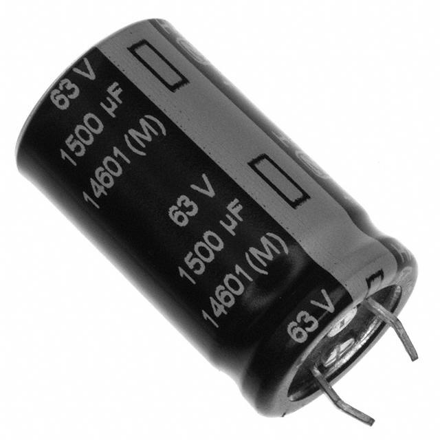

    820 µF 80 V 铝电解电容器 径向,Can - 卡入式 222 毫欧 @ 120Hz 105°C 时为 3000 小时
ECO-S1KA821AA 数据手册
Large Can Aluminum Electrolytic Capacitors TS-HA Series two terminal snap-in  3000 hour* life at 105ºC with high ripple current capability  Wide range of case sizes including 20mm, low profile lengths  NEW: 40mm diameter sizes through 100WV.  Can vent construction Rated Working Voltage: Operating Temperature: Nominal Capacitance: Dissipation Factor: (120 Hz, +20ºC) 10 ~ 250 VDC -40 ~ +105ºC 68 ~ 68000µF (±20% tolerance) Working Voltage [V]: Max. D.F. (%): 10 55 385 ~ 450 VDC -25 ~ +105ºC 33 ~ 470µF (±20% tolerance) 16 45 25 35 50 25 63 20 80 17 100 - 450 15 (rated cap. [µF] - 33000) 1000 For capacitance values > 33000µF, add the value of: Endurance: 35 30 3000 hours* at +105ºC with maximum specified ripple current (see page 4) *2000 hours for 20mm diameter or 20mm length sizes Part Number System E C A Voltage Code Common Code/ Terminal Type Series ECOS 6.3mm Length Terminal (Standard) ECEC 4mm Length "Short" Terminal (See page 7) Capacitance Code A B C D E F Case Diameter 20mm 22mm 25mm 30mm 35mm 40mm A B L G Top Vinyl Plate 25 ~ 50mm lengths With Plate Without plate 20mm length With Plate Without plate Ripple Current Multipliers: Page 7 TS-HA Standard Ratings Cap. (µF) Size (mm) Max 105°C R.C. (A rms) DxL 120Hz 10k~100kHz 20°C ESR (Ω, max.) 120Hz 20kHz Cap. (µF) ECOS1AA682AA ECOS1AA822AA ECOS1AA103AA ECOS1AA123AA ECOS1AA153AA ECOS1AA472BA ECOS1AA682BA ECOS1AA103BA ECOS1AA123BA ECOS1AA153BA ECOS1AA183BA ECOS1AA223BA ECOS1AA273BA ECOS1AA153CA ECOS1AA183CA ECOS1AA223CA ECOS1AA273CA ECOS1AA333CA ECOS1AA393CA ECOS1AA223DA ECOS1AA273DA ECOS1AA333DA ECOS1AA393DA ECOS1AA473DA ECOS1AA563DA ECOS1AA273EA ECOS1AA333EA ECOS1AA393EA ECOS1AA473EA ECOS1AA563EA ECOS1AA683EA ECOS1AA623FA ECOS1AA823FA 6800 8200 10000 3300 3300 4700 6800 8200 10000 12000 15000 18000 4700 10000 12000 15000 18000 22000 27000 6800 12000 15000 18000 22000 27000 33000 39000 10000 18000 22000 27000 33000 39000 47000 56000 47000 20 20 20 22 22 22 22 22 22 22 22 22 25 25 25 25 25 25 25 30 30 30 30 30 30 30 30 35 35 35 35 35 35 35 35 40 30 35 40 20 25 25 25 30 30 35 40 45 20 25 30 35 40 45 50 20 25 30 30 35 40 45 50 20 25 30 30 35 40 45 50 40 2.20 2.40 2.60 1.30 1.30 1.52 2.20 2.40 2.60 2.90 3.20 3.50 1.60 2.60 2.90 3.20 3.50 3.80 4.20 1.80 2.90 3.20 3.50 3.80 4.20 4.70 5.10 2.40 3.50 3.80 4.20 4.70 5.10 5.50 6.00 5.50 2.53 2.76 2.99 1.50 1.50 1.75 2.53 2.76 2.99 3.34 3.68 4.03 1.84 2.99 3.34 3.68 4.03 4.37 4.83 2.07 3.34 3.68 4.03 4.37 4.83 5.41 5.87 2.76 4.03 4.37 4.83 5.41 5.87 6.33 6.90 6.33 0.085 0.071 0.066 0.216 0.176 0.123 0.085 0.071 0.066 0.055 0.046 0.040 0.152 0.066 0.055 0.046 0.040 0.033 0.028 0.105 0.055 0.046 0.040 0.033 0.028 0.023 0.022 0.071 0.040 0.033 0.028 0.023 0.022 0.020 0.019 0.020 0.068 0.057 0.053 0.173 0.141 0.099 0.068 0.057 0.053 0.044 0.037 0.034 0.121 0.053 0.044 0.037 0.034 0.028 0.025 0.084 0.044 0.037 0.034 0.028 0.025 0.020 0.020 0.057 0.034 0.028 0.025 0.020 0.020 0.018 0.017 0.018 ECOS1CA682AA ECOS1CA822AA ECOS1CA103AA ECOS1CA332BL ECOS1CA332BA ECOS1CA472BA ECOS1CA682BA ECOS1CA822BA ECOS1CA103BA ECOS1CA123BA ECOS1CA153BA ECOS1CA183BA ECOS1CA472CL ECOS1CA103CA ECOS1CA123CA ECOS1CA153CA ECOS1CA183CA ECOS1CA223CA ECOS1CA273CA ECOS1CA682DL ECOS1CA123DA ECOS1CA153DA ECOS1CA183DA ECOS1CA223DA ECOS1CA273DA ECOS1CA333DA ECOS1CA393DA ECOS1CA103EL ECOS1CA183EA ECOS1CA223EA ECOS1CA273EA ECOS1CA333EA ECOS1CA393EA ECOS1CA473EA ECOS1CA563EA ECOS1CA473FA 68000 40 x 50 7.29 8.38 0.015 0.014 ECOS1CA683FA Size (mm) Max 105°C R.C. (A rms) DxL 10 VDC Working, 13 VDC Surge 6800 8200 10000 12000 15000 4700 6800 10000 12000 15000 18000 22000 27000 15000 18000 22000 27000 33000 39000 22000 27000 33000 39000 47000 56000 27000 33000 39000 47000 56000 68000 62000 82000 20 20 20 20 20 22 22 22 22 22 22 22 22 25 25 25 25 25 25 30 30 30 30 30 30 35 35 35 35 35 35 40 40 x x x x x x x x x x x x x x x x x x x x x x x x x x x x x x x x x 25 30 30 35 40 25 25 25 30 35 40 45 50 25 30 35 40 45 50 25 30 35 40 45 50 25 30 30 35 40 50 40 50 1.30 1.60 1.80 2.20 2.30 0.85 1.30 1.80 2.20 2.30 2.40 2.60 3.10 2.30 2.40 2.60 3.10 3.40 3.70 2.60 3.10 3.40 3.70 4.20 5.00 3.10 3.40 3.70 4.20 5.00 5.50 5.42 7.36 1.50 1.84 2.07 2.53 2.65 0.98 1.50 2.07 2.53 2.65 2.76 2.99 3.57 2.65 2.76 2.99 3.57 3.91 4.26 2.99 3.57 3.91 4.26 4.83 5.75 3.57 3.91 4.26 4.83 5.75 6.33 6.23 8.46 0.110 0.091 0.075 0.062 0.053 0.159 0.110 0.075 0.062 0.053 0.044 0.038 0.033 0.053 0.044 0.038 0.033 0.027 0.025 0.038 0.033 0.027 0.025 0.023 0.022 0.033 0.027 0.025 0.023 0.022 0.021 0.023 0.018 0.093 0.077 0.063 0.053 0.045 0.135 0.093 0.063 0.053 0.045 0.038 0.032 0.028 0.045 0.038 0.032 0.028 0.023 0.021 0.032 0.028 0.023 0.021 0.020 0.019 0.028 0.023 0.021 0.020 0.021 0.020 0.022 0.017 20°C ESR (Ω, max.) Panasonic Part Number 120Hz 10k~100kHz 120Hz 20kHz Panasonic Part Number 16 VDC Working, 20 VDC Surge x x x x x x x x x x x x x x x x x x x x x x x x x x x x x x x x x x x x Design and specifications are subject to change without notice. Ask factory for technical specifications before purchase and/or use. Whenever a doubt about safety arises from this product, please contact us immediately for technical consultation. 15 Large Can Aluminum Electrolytic Capacitors TS-HA Standard Ratings (continued) Cap. (µF) Size (mm) Max 105°C R.C. (A rms) DxL 120Hz 10k~100kHz 20°C ESR (Ω, max.) 120Hz 20kHz Panasonic Cap. Part Number (µF) Size (mm) Max 105°C R.C. (A rms) ECOS1EA472AA ECOS1EA562AA ECOS1EA682AA ECOS1EA222BL ECOS1EA222BA ECOS1EA332BA ECOS1EA472BA ECOS1EA562BA ECOS1EA682BA ECOS1EA822BA ECOS1EA103BA ECOS1EA123BA ECOS1EA332CL ECOS1EA682CA ECOS1EA822CA ECOS1EA103CA ECOS1EA123CA ECOS1EA153CA ECOS1EA183CA ECOS1EA472DL ECOS1EA822DA ECOS1EA103DA ECOS1EA123DA ECOS1EA153DA ECOS1EA183DA ECOS1EA223DA ECOS1EA682EL ECOS1EA123EA ECOS1EA153EA ECOS1EA183EA ECOS1EA223EA ECOS1EA273EA ECOS1EA333EA ECOS1EA333FA ECOS1EA473FA 3300 3900 4700 1500 1500 2200 3300 3900 4700 5600 6800 8200 2200 4700 5600 6800 8200 10000 12000 3300 5600 6800 8200 10000 12000 15000 4700 8200 10000 12000 15000 18000 22000 22000 27000 20 20 20 22 22 22 22 22 22 22 22 22 25 25 25 25 25 25 25 30 30 30 30 30 30 30 35 35 35 35 35 35 35 40 40 x x x x x x x x x x x x x x x x x x x x x x x x x x x x x x x x x x x 30 35 40 20 25 25 25 30 35 35 40 50 20 25 30 35 40 45 50 20 25 30 30 35 40 45 20 25 30 30 35 40 50 40 50 1.90 2.00 2.20 1.10 1.10 1.48 1.90 2.00 2.20 2.40 2.60 2.90 1.40 2.20 2.40 2.60 2.90 3.20 3.50 1.70 2.40 2.60 2.90 3.20 3.50 3.90 2.00 2.90 3.20 3.50 3.90 4.30 5.00 5.00 5.44 ECOS1HA182AA ECOS1HA222AA ECOS1HA272AA ECOS1HA102BL ECOS1HA102BA ECOS1HA152BA ECOS1HA182BA ECOS1HA222BA ECOS1HA272BA ECOS1HA332BA ECOS1HA392BA ECOS1HA472BA ECOS1HA562BA ECOS1HA152CL ECOS1HA272CA ECOS1HA332CA ECOS1HA392CA ECOS1HA472CA ECOS1HA562CA ECOS1HA682CA ECOS1HA222DL ECOS1HA392DA ECOS1HA472DA ECOS1HA562DA ECOS1HA682DA ECOS1HA822DA ECOS1HA103DA ECOS1HA332EL ECOS1HA472EA ECOS1HA562EA ECOS1HA682EA ECOS1HA822EA ECOS1HA103EA ECOS1HA123EA ECOS1HA153EA ECOS1HA153FA ECOS1HA223FA 1200 1500 1800 680 680 1000 1200 1500 1800 2200 2700 3300 1000 1800 2200 2700 3300 3900 4700 1500 2700 3300 3900 4700 5600 6800 2200 3300 3900 4700 5600 6800 8200 10000 12000 15000 20 20 20 22 22 22 22 22 22 22 22 22 25 25 25 25 25 25 25 30 30 30 30 30 30 30 35 35 35 35 35 35 35 35 40 40 x x x x x x x x x x x x x x x x x x x x x x x x x x x x x x x x x x x x 30 35 40 20 25 25 25 30 30 35 40 50 20 25 30 35 40 45 50 20 25 30 35 40 45 50 20 25 30 30 35 40 45 50 40 50 1.40 1.50 1.70 0.90 0.90 1.17 1.40 1.50 1.70 2.00 2.20 2.50 1.20 1.70 2.00 2.20 2.50 2.70 3.00 1.30 2.20 2.50 2.70 3.00 3.30 3.60 1.50 2.50 2.70 3.00 3.30 3.60 3.90 4.40 4.52 4.80 DxL 25 VDC Working, 32 VDC Surge 4700 5600 6800 2200 2200 3300 4700 5600 6800 8200 10000 12000 3300 6800 8200 10000 12000 15000 18000 4700 8200 10000 12000 15000 18000 22000 6800 12000 15000 18000 22000 27000 33000 33000 47000 20 20 20 22 22 22 22 22 22 22 22 22 25 25 25 25 25 25 25 30 30 30 30 30 30 30 35 35 35 35 35 35 35 40 40 x x x x x x x x x x x x x x x x x x x x x x x x x x x x x x x x x x x 30 35 40 20 25 25 25 30 30 35 40 45 20 25 30 35 40 45 50 20 25 30 30 35 40 45 20 25 30 35 35 45 50 40 50 2.00 2.20 2.40 1.30 1.30 1.62 2.00 2.20 2.40 2.70 3.00 3.20 1.60 2.40 2.70 3.00 3.20 3.60 3.90 1.80 2.70 3.00 3.20 3.60 3.90 4.30 2.30 3.20 3.60 3.90 4.30 4.80 5.50 5.50 6.47 1800 2200 2700 1000 1000 1500 1800 2200 2700 3300 3900 4700 5600 1500 2700 3300 3900 4700 5600 6800 2200 3900 4700 5600 6800 8200 10000 3300 4700 5600 6800 8200 10000 12000 15000 15000 22000 20 20 20 22 22 22 22 22 22 22 22 22 22 25 25 25 25 25 25 25 30 30 30 30 30 30 30 35 35 35 35 35 35 35 35 40 40 x x x x x x x x x x x x x x x x x x x x x x x x x x x x x x x x x x x x x 30 35 40 20 25 25 25 30 30 35 40 45 50 20 25 30 35 40 40 50 20 25 30 35 40 45 50 20 25 30 30 35 40 45 50 40 50 1.50 1.70 1.80 0.90 0.90 1.25 1.50 1.70 1.80 2.00 2.20 2.50 2.80 1.20 1.80 2.00 2.20 2.50 2.80 3.30 1.40 2.20 2.50 2.80 3.30 3.60 4.00 1.70 2.50 2.80 3.30 3.60 4.00 4.50 4.80 4.80 5.15 2.30 2.53 2.76 1.50 1.50 1.86 2.30 2.53 2.76 3.11 3.45 3.68 1.84 2.76 3.11 3.45 3.68 4.14 4.49 2.07 3.11 3.45 3.68 4.14 4.49 4.95 2.65 3.68 4.14 4.49 4.95 5.52 6.33 6.33 7.44 0.106 0.089 0.073 0.241 0.241 0.161 0.106 0.089 0.073 0.061 0.051 0.044 0.161 0.073 0.061 0.051 0.044 0.036 0.030 0.113 0.061 0.051 0.044 0.036 0.030 0.025 0.080 0.044 0.036 0.030 0.025 0.021 0.018 0.018 0.015 0.079 0.067 0.055 0.181 0.181 0.121 0.079 0.067 0.055 0.045 0.039 0.033 0.121 0.055 0.045 0.039 0.035 0.031 0.027 0.085 0.045 0.039 0.035 0.031 0.027 0.022 0.060 0.035 0.031 0.027 0.022 0.019 0.016 0.016 0.014 16 0.129 0.105 0.086 0.265 0.232 0.155 0.129 0.105 0.086 0.070 0.064 0.053 0.050 0.177 0.086 0.070 0.064 0.053 0.050 0.046 0.121 0.064 0.053 0.050 0.046 0.038 0.033 0.085 0.053 0.050 0.046 0.038 0.033 0.028 0.022 0.022 0.016 0.097 0.079 0.064 0.199 0.174 0.116 0.097 0.079 0.064 0.053 0.048 0.040 0.038 0.133 0.064 0.053 0.048 0.040 0.038 0.035 0.090 0.048 0.040 0.038 0.035 0.029 0.025 0.064 0.040 0.038 0.035 0.029 0.025 0.022 0.018 0.018 0.013 10k~100kHz 20°C ESR (Ω, max.) 120Hz 20kHz Panasonic Part Number 35 VDC Working, 44 VDC Surge 50 VDC Working, 63 VDC Surge 1.73 1.96 2.07 1.04 1.04 1.44 1.73 1.96 2.07 2.30 2.53 2.88 3.22 1.38 2.07 2.30 2.53 2.88 3.22 3.80 1.61 2.53 2.88 3.22 3.80 4.14 4.60 1.96 2.88 3.22 3.80 4.14 4.60 5.18 5.52 5.52 5.92 120Hz 2.19 2.30 2.53 1.27 1.27 1.70 2.19 2.30 2.53 2.76 2.99 3.34 1.61 2.53 2.76 2.99 3.34 3.68 4.03 1.96 2.76 2.99 3.34 3.68 4.03 4.49 2.30 3.34 3.68 4.03 4.49 4.95 5.75 5.75 6.26 0.121 0.111 0.088 0.287 0.287 0.196 0.121 0.111 0.088 0.074 0.061 0.051 0.196 0.088 0.074 0.061 0.051 0.041 0.035 0.131 0.074 0.061 0.051 0.041 0.035 0.030 0.095 0.051 0.041 0.035 0.030 0.028 0.023 0.023 0.020 0.090 0.083 0.066 0.216 0.216 0.147 0.090 0.083 0.066 0.056 0.046 0.038 0.147 0.066 0.056 0.046 0.038 0.031 0.026 0.098 0.056 0.046 0.038 0.031 0.026 0.022 0.071 0.038 0.031 0.026 0.022 0.021 0.017 0.017 0.015 ECOS1VA332AA ECOS1VA392AA ECOS1VA472AA ECOS1VA152BL ECOS1VA152BA ECOS1VA222BA ECOS1VA332BA ECOS1VA392BA ECOS1VA472BA ECOS1VA562BA ECOS1VA682BA ECOS1VA822BA ECOS1VA222CL ECOS1VA472CA ECOS1VA562CA ECOS1VA682CA ECOS1VA822CA ECOS1VA103CA ECOS1VA123CA ECOS1VA332DL ECOS1VA562DA ECOS1VA682DA ECOS1VA822DA ECOS1VA103DA ECOS1VA123DA ECOS1VA153DA ECOS1VA472EL ECOS1VA822EA ECOS1VA103EA ECOS1VA123EA ECOS1VA153EA ECOS1VA183EA ECOS1VA223EA ECOS1VA223FA ECOS1VA273FA 63 VDC Working, 79 VDC Surge 1.61 1.73 1.96 1.04 1.04 1.35 1.61 1.73 1.96 2.30 2.53 2.88 1.38 1.96 2.30 2.53 2.88 3.11 3.45 1.50 2.53 2.88 3.11 3.45 3.80 4.14 1.73 2.88 3.11 3.45 3.80 4.14 4.49 5.06 5.20 5.52 0.235 0.188 0.157 0.463 0.414 0.282 0.235 0.188 0.157 0.128 0.104 0.090 0.315 0.157 0.128 0.104 0.090 0.077 0.063 0.210 0.104 0.090 0.077 0.063 0.053 0.049 0.143 0.090 0.077 0.063 0.053 0.049 0.040 0.033 0.030 0.027 0.176 0.141 0.117 0.347 0.311 0.211 0.176 0.141 0.117 0.096 0.078 0.068 0.236 0.117 0.096 0.078 0.068 0.057 0.048 0.157 0.078 0.068 0.057 0.048 0.040 0.037 0.107 0.068 0.057 0.048 0.040 0.037 0.030 0.028 0.026 0.023 ECOS1JA122AA ECOS1JA152AA ECOS1JA182AA ECOS1JA681BL ECOS1JA681BA ECOS1JA102BA ECOS1JA122BA ECOS1JA152BA ECOS1JA182BA ECOS1JA222BA ECOS1JA272BA ECOS1JA332BA ECOS1JA102CL ECOS1JA182CA ECOS1JA222CA ECOS1JA272CA ECOS1JA332CA ECOS1JA392CA ECOS1JA472CA ECOS1JA152DL ECOS1JA272DA ECOS1JA332DA ECOS1JA392DA ECOS1JA472DA ECOS1JA562DA ECOS1JA682DA ECOS1JA222EL ECOS1JA332EA ECOS1JA392EA ECOS1JA472EA ECOS1JA562EA ECOS1JA682EA ECOS1JA822EA ECOS1JA103EA ECOS1JA123FA ECOS1JA153FA Design and specifications are subject to change without notice. Ask factory for technical specifications before purchase and/or use. Whenever a doubt about safety arises from this product, please contact us immediately for technical consultation. Large Can Aluminum Electrolytic Capacitors TS-HA Standard Ratings (continued) Cap. (µF) Size (mm) Max 105°C R.C. (A rms) DxL 120Hz 10k~100kHz 20°C ESR (Ω, max.) 120Hz 20kHz Size (mm) Max 105°C R.C. (A rms) Panasonic Cap. Part Number (µF) ECOS1KA821AA ECOS1KA102AA ECOS1KA122AA ECOS1KA471BL ECOS1KA471BA ECOS1KA681BA ECOS1KA821BA ECOS1KA102BA ECOS1KA122BA ECOS1KA152BA ECOS1KA182BA ECOS1KA222BA ECOS1KA681CL ECOS1KA102CA ECOS1KA122CA ECOS1KA152CA ECOS1KA182CA ECOS1KA222CA ECOS1KA272CA ECOS1KA332CA ECOS1KA102DL ECOS1KA182DA ECOS1KA222DA ECOS1KA272DA ECOS1KA332DA ECOS1KA392DA ECOS1KA472DA ECOS1KA152EL ECOS1KA222EA ECOS1KA272EA ECOS1KA332EA ECOS1KA392EA ECOS1KA472EA ECOS1KA562EA ECOS1KA682EA ECOS1KA682FA ECOS1KA822FA 560 820 1000 330 330 470 560 820 1000 1200 1500 470 820 1000 1200 1500 1800 2200 680 1200 1500 1800 2200 2700 3300 1000 1500 1800 2200 2700 3300 3900 4700 4700 6800 20 20 20 22 22 22 22 22 22 22 22 25 25 25 25 25 25 25 30 30 30 30 30 30 30 35 35 35 35 35 35 35 35 40 40 x x x x x x x x x x x x x x x x x x x x x x x x x x x x x x x x x x x 30 35 40 20 25 25 25 30 35 40 45 20 25 30 35 40 45 50 20 25 30 35 40 45 50 20 25 30 30 35 40 45 50 40 50 ECOS2CA221AA ECOS2CA271AA ECOS2CA331AA ECOS2CA391AA ECOS2CA151BL ECOS2CA151BA ECOS2CA221BA ECOS2CA271BA ECOS2CA331BA ECOS2CA391BA ECOS2CA471BA ECOS2CA561BA ECOS2CA681BA ECOS2CA221CL ECOS2CA391CA ECOS2CA471CA ECOS2CA561CA ECOS2CA681CA ECOS2CA821CA ECOS2CA102CA ECOS2CA122CA ECOS2CA331DL ECOS2CA561DA ECOS2CA681DA ECOS2CA821DA ECOS2CA102DA ECOS2CA122DA ECOS2CA152DA ECOS2CA182DA ECOS2CA471EL ECOS2CA152EA ECOS2CA182EA ECOS2CA222EA 220 270 330 100 100 150 220 270 330 390 470 560 150 270 330 390 470 560 680 820 220 390 470 560 680 820 1000 1200 330 820 1000 1200 1500 20 20 20 22 22 22 22 22 22 22 22 22 25 25 25 25 25 25 25 25 30 30 30 30 30 30 30 30 35 35 35 35 35 x x x x x x x x x x x x x x x x x x x x x x x x x x x x x x x x x 30 35 40 20 25 25 25 30 30 35 40 45 20 25 25 30 35 35 40 50 20 25 25 30 30 35 45 50 20 30 35 40 50 DxL 80 VDC Working, 100 VDC Surge 820 1000 1200 470 470 680 820 1000 1200 1500 1800 2200 680 1000 1200 1500 1800 2200 2700 3300 1000 1800 2200 2700 3300 3900 4700 1500 2200 2700 3300 3900 4700 5600 6800 6800 8200 20 20 20 22 22 22 22 22 22 22 22 22 25 25 25 25 25 25 25 25 30 30 30 30 30 30 30 35 35 35 35 35 35 35 35 40 40 x x x x x x x x x x x x x x x x x x x x x x x x x x x x x x x x x x x x x 30 35 40 20 25 25 25 30 30 35 40 45 20 25 25 30 35 35 45 50 20 25 30 35 40 45 50 20 25 30 30 35 40 45 50 40 50 220 270 330 390 150 150 220 270 330 390 470 560 680 220 390 470 560 680 820 1000 1200 330 560 680 820 1000 1200 1500 1800 470 1500 1800 2200 20 20 20 20 22 22 22 22 22 22 22 22 22 25 25 25 25 25 25 25 25 30 30 30 30 30 30 30 30 35 35 35 35 x x x x x x x x x x x x x x x x x x x x x x x x x x x x x x x x x 25 30 35 40 20 25 25 25 30 30 35 40 45 20 25 30 30 35 40 45 50 20 25 30 30 35 40 45 50 20 35 40 50 1.20 1.30 1.50 0.80 0.80 1.00 1.20 1.30 1.50 1.70 1.80 2.10 1.00 1.30 1.50 1.70 1.80 2.10 2.40 2.60 1.20 1.80 2.10 2.40 2.60 3.00 3.30 1.40 2.10 2.40 2.60 3.00 3.30 3.70 3.90 3.90 4.29 1.38 1.50 1.73 0.92 0.92 1.15 1.38 1.50 1.73 1.96 2.07 2.42 1.15 1.50 1.73 1.96 2.07 2.42 2.76 2.99 1.38 2.07 2.42 2.76 2.99 3.45 3.80 1.61 2.42 2.76 2.99 3.45 3.80 4.26 4.49 4.49 4.93 0.222 0.182 0.166 0.459 0.388 0.268 0.222 0.182 0.166 0.133 0.111 0.090 0.317 0.182 0.166 0.133 0.111 0.090 0.074 0.065 0.216 0.111 0.090 0.074 0.065 0.060 0.049 0.155 0.090 0.074 0.065 0.060 0.049 0.050 0.041 0.041 0.036 0.145 0.119 0.116 0.298 0.272 0.188 0.145 0.119 0.116 0.093 0.077 0.063 0.206 0.119 0.116 0.093 0.077 0.063 0.055 0.049 0.140 0.077 0.063 0.055 0.049 0.045 0.037 0.108 0.063 0.055 0.049 0.045 0.037 0.038 0.031 0.031 0.027 1.40 1.54 1.68 1.82 0.77 0.85 1.26 1.54 1.68 1.82 1.96 2.10 2.38 1.05 1.82 1.96 2.10 2.38 2.80 3.08 3.22 1.40 2.10 2.38 2.80 3.08 3.22 3.50 3.78 1.61 3.50 3.78 4.06 0.829 0.675 0.653 0.468 1.437 1.216 0.829 0.675 0.553 0.553 0.529 0.385 0.317 0.980 0.553 0.459 0.385 0.317 0.263 0.216 0.180 0.553 0.385 0.317 0.263 0.216 0.180 0.166 0.138 0.459 0.166 0.138 0.113 0.373 0.304 0.294 0.210 0.647 0.547 0.373 0.304 0.249 0.249 0.238 0.173 0.143 0.441 0.249 0.206 0.173 0.143 0.118 0.108 0.090 0.249 0.173 0.143 0.118 0.108 0.090 0.083 0.083 0.206 0.083 0.069 0.057 10k~100kHz 20°C ESR (Ω, max.) 120Hz 20kHz Panasonic Part Number 100 VDC Working, 125 VDC Surge 160 VDC Working, 200 VDC Surge 1.00 1.10 1.20 1.30 0.55 0.61 0.90 1.10 1.20 1.30 1.40 1.50 1.70 0.75 1.30 1.40 1.50 1.70 2.00 2.20 2.30 1.00 1.50 1.70 2.00 2.20 2.30 2.50 2.70 1.15 2.50 2.70 2.90 120Hz 1.10 1.40 1.70 0.80 0.80 0.92 1.10 1.40 1.70 1.80 2.10 1.00 1.40 1.70 1.80 2.10 2.30 2.60 1.10 1.80 2.10 2.30 2.60 2.90 3.20 1.20 2.10 2.30 2.60 2.90 3.20 3.60 3.80 3.80 4.57 1.65 2.10 2.55 1.20 1.20 1.38 1.65 2.10 2.55 2.70 3.15 1.50 2.10 2.55 2.70 3.15 3.45 3.90 1.65 2.70 3.15 3.45 3.90 4.35 4.80 1.80 3.15 3.45 3.90 4.35 4.80 5.40 5.70 5.70 6.86 0.296 0.202 0.182 0.653 0.553 0.388 0.296 0.202 0.182 0.152 0.122 0.459 0.202 0.182 0.152 0.122 0.111 0.090 0.317 0.152 0.122 0.111 0.090 0.080 0.075 0.216 0.122 0.111 0.090 0.080 0.075 0.064 0.053 0.053 0.037 0.178 0.121 0.109 0.392 0.332 0.233 0.178 0.121 0.109 0.091 0.073 0.275 0.121 0.109 0.091 0.079 0.072 0.059 0.190 0.091 0.079 0.072 0.059 0.052 0.053 0.129 0.079 0.072 0.059 0.052 0.053 0.045 0.040 0.040 0.027 ECOS2AA561AA ECOS2AA821AA ECOS2AA102AA ECOS2AA331BL ECOS2AA331BA ECOS2AA471BA ECOS2AA561BA ECOS2AA821BA ECOS2AA102BA ECOS2AA122BA ECOS2AA152BA ECOS2AA471CL ECOS2AA821CA ECOS2AA102CA ECOS2AA122CA ECOS2AA152CA ECOS2AA182CA ECOS2AA222CA ECOS2AA681DL ECOS2AA122DA ECOS2AA152DA ECOS2AA182DA ECOS2AA222DA ECOS2AA272DA ECOS2AA332DA ECOS2AA102EL ECOS2AA152EA ECOS2AA182EA ECOS2AA222EA ECOS2AA272EA ECOS2AA332EA ECOS2AA392EA ECOS2AA472EA ECOS2AA472FA ECOS2AA682FA 200 VDC Working, 250 VDC Surge 1.00 1.10 1.20 0.50 0.50 0.68 1.00 1.10 1.20 1.30 1.40 1.50 0.65 1.10 1.20 1.30 1.40 1.50 1.70 2.00 0.87 1.30 1.40 1.50 1.70 2.00 2.20 2.30 1.10 2.00 2.20 2.30 2.50 1.40 1.54 1.68 0.70 0.70 0.95 1.40 1.54 1.68 1.82 1.96 2.10 0.91 1.54 1.68 1.82 1.96 2.10 2.38 2.80 1.22 1.82 1.96 2.10 2.38 2.80 3.08 3.22 1.54 2.80 3.08 3.22 3.50 0.754 0.614 0.502 1.989 1.658 1.105 0.754 0.614 0.502 0.425 0.353 0.296 1.326 0.614 0.502 0.425 0.353 0.296 0.244 0.222 0.904 0.425 0.353 0.296 0.244 0.222 0.199 0.166 0.603 0.222 0.199 0.166 0.144 0.339 0.276 0.226 0.895 0.746 0.497 0.339 0.276 0.226 0.191 0.159 0.133 0.597 0.276 0.226 0.191 0.159 0.133 0.110 0.111 0.407 0.191 0.159 0.133 0.110 0.111 0.099 0.083 0.271 0.111 0.099 0.083 0.072 ECOS2DA221AA ECOS2DA271AA ECOS2DA331AA ECOS2DA101BL ECOS2DA101BA ECOS2DA151BA ECOS2DA221BA ECOS2DA271BA ECOS2DA331BA ECOS2DA391BA ECOS2DA471BA ECOS2DA561BA ECOS2DA151CL ECOS2DA271CA ECOS2DA331CA ECOS2DA391CA ECOS2DA471CA ECOS2DA561CA ECOS2DA681CA ECOS2DA821CA ECOS2DA221DL ECOS2DA391DA ECOS2DA471DA ECOS2DA561DA ECOS2DA681DA ECOS2DA821DA ECOS2DA102DA ECOS2DA122DA ECOS2DA331EL ECOS2DA821EA ECOS2DA102EA ECOS2DA122EA ECOS2DA152EA Design and specifications are subject to change without notice. Ask factory for technical specifications before purchase and/or use. Whenever a doubt about safety arises from this product, please contact us immediately for technical consultation. 17 Large Can Aluminum Electrolytic Capacitors TS-HA Standard Ratings (continued) Cap. (µF) Size (mm) Max 105°C R.C. (A rms) DxL 120Hz 10k~100kHz 20°C ESR (Ω, max.) 120Hz 20kHz Size (mm) Max 105°C R.C. (A rms) Panasonic Cap. Part Number (µF) ECOS2EA181AA ECOS2EA221AA ECOS2EA680BL ECOS2EA680BA ECOS2EA101BA ECOS2EA151BA ECOS2EA181BA ECOS2EA221BA ECOS2EA271BA ECOS2EA331BA ECOS2EA391BA ECOS2EA101CL ECOS2EA181CA ECOS2EA221CA ECOS2EA271CA ECOS2EA331CA ECOS2EA391CA ECOS2EA471CA ECOS2EA561CA ECOS2EA151DL ECOS2EA271DA ECOS2EA331DA ECOS2EA391DA ECOS2EA471DA ECOS2EA561DA ECOS2EA681DA ECOS2EA821DA ECOS2EA221EL ECOS2EA471EA ECOS2EA561EA ECOS2EA681EA ECOS2EA821EA ECOS2EA102EA ECOS2EA122EA 56 68 82 33 56 68 82 100 120 150 47 68 82 100 120 150 180 220 68 150 180 220 270 330 100 180 220 270 330 390 470 20 20 20 22 22 22 22 22 22 22 25 25 25 25 25 25 25 25 30 30 30 30 30 30 35 35 35 35 35 35 35 x x x x x x x x x x x x x x x x x x x x x x x x x x x x x x x 30 35 40 20 25 30 35 35 35 50 20 25 25 30 30 40 45 50 20 30 35 40 45 50 20 25 30 35 40 45 50 ECOS2GA560AA ECOS2GA680AA ECOS2GA820AA ECOS2GA330BL ECOS2GA330BA ECOS2GA470BA ECOS2GA560BA ECOS2GA680BA ECOS2GA820BA ECOS2GA101BA ECOS2GA121BA ECOS2GA151BA ECOS2GA470CL ECOS2GA680CA ECOS2GA820CA ECOS2GA101CA ECOS2GA121CA ECOS2GA151CA ECOS2GA181CA ECOS2GA221CA ECOS2GA680DL ECOS2GA121DA ECOS2GA151DA ECOS2GA181DA ECOS2GA221DA ECOS2GA271DA ECOS2GA331DA ECOS2GA101EL ECOS2GA181EA ECOS2GA221EA ECOS2GA271EA ECOS2GA331EA ECOS2GA391EA ECOS2GA471EA 56 68 82 100 120 150 68 100 120 150 180 220 100 150 180 220 270 330 150 220 270 330 390 22 22 22 22 22 22 25 25 25 25 25 25 30 30 30 30 30 30 35 35 35 35 35 x x x x x x x x x x x x x x x x x x x x x x x 25 30 35 40 45 50 25 30 35 40 45 50 25 30 35 40 45 50 25 30 35 40 50 DxL 250 VDC Working, 300 VDC Surge 180 220 68 68 100 150 180 220 270 330 390 100 180 220 270 330 390 470 560 150 270 330 390 470 560 680 820 220 470 560 680 820 1000 1200 20 20 22 22 22 22 22 22 22 22 22 25 25 25 25 25 25 25 25 30 30 30 30 30 30 30 30 35 35 35 35 35 35 35 x x x x x x x x x x x x x x x x x x x x x x x x x x x x x x x x x x 35 40 20 25 25 25 30 30 35 40 45 20 25 25 30 35 35 45 50 20 25 25 30 35 35 45 50 20 30 30 35 40 45 50 56 68 82 33 33 47 56 68 82 100 120 150 47 68 82 100 120 150 180 220 68 120 150 180 220 270 330 100 180 220 270 330 390 470 20 20 20 22 22 22 22 22 22 22 22 22 25 25 25 25 25 25 25 25 30 30 30 30 30 30 30 35 35 35 35 35 35 35 x x x x x x x x x x x x x x x x x x x x x x x x x x x x x x x x x x 30 35 40 20 25 25 25 30 35 35 40 50 20 25 25 30 35 40 45 50 20 25 30 35 40 45 50 20 25 30 35 40 45 50 0.90 1.00 0.40 0.40 0.55 0.75 0.90 1.00 1.10 1.20 1.30 0.50 0.90 1.00 1.10 1.20 1.30 1.40 1.50 0.65 1.10 1.20 1.30 1.40 1.50 1.70 2.00 0.87 1.40 1.50 1.70 2.00 2.20 2.30 1.26 1.40 0.56 0.56 0.77 1.05 1.26 1.40 1.54 1.68 1.82 0.70 1.26 1.40 1.54 1.68 1.82 1.96 2.10 0.91 1.54 1.68 1.82 1.96 2.10 2.38 2.80 1.22 1.96 2.10 2.38 2.80 3.08 3.22 0.921 0.754 2.926 2.438 1.658 1.105 0.921 0.754 0.614 0.502 0.425 1.989 0.921 0.754 0.614 0.502 0.425 0.353 0.296 1.326 0.614 0.502 0.425 0.353 0.296 0.244 0.202 0.904 0.353 0.296 0.244 0.202 0.199 0.166 0.461 0.377 1.463 1.219 0.829 0.553 0.461 0.377 0.307 0.251 0.213 0.995 0.461 0.377 0.307 0.251 0.213 0.176 0.148 0.663 0.307 0.251 0.213 0.176 0.148 0.122 0.101 0.452 0.176 0.148 0.122 0.101 0.099 0.083 18 0.71 0.78 0.90 0.28 0.42 0.60 0.71 0.78 0.90 0.97 1.05 1.15 0.35 0.78 0.90 0.97 1.05 1.15 1.33 1.54 0.49 1.05 1.15 1.33 1.54 1.68 1.89 0.66 1.33 1.54 1.68 1.89 2.17 2.45 2.368 1.950 1.617 5.024 4.521 2.822 2.368 1.950 1.617 1.326 1.105 0.884 3.527 1.950 1.617 1.326 1.105 0.884 0.737 0.603 2.438 1.105 0.884 0.737 0.603 0.491 0.402 1.658 0.737 0.603 0.491 0.402 0.340 0.282 0.829 0.683 0.566 1.758 1.582 0.988 0.829 0.683 0.566 0.464 0.387 0.309 1.235 0.683 0.566 0.464 0.387 0.309 0.258 0.211 0.853 0.387 0.309 0.258 0.211 0.172 0.161 0.580 0.258 0.211 0.172 0.161 0.136 0.127 10k~100kHz 120Hz 20kHz Panasonic Part Number 385 VDC Working, 435 VDC Surge 400 VDC Working, 450 VDC Surge 0.51 0.56 0.64 0.20 0.30 0.43 0.51 0.56 0.64 0.69 0.75 0.82 0.25 0.56 0.64 0.69 0.75 0.82 0.95 1.10 0.35 0.75 0.82 0.95 1.10 1.20 1.35 0.47 0.95 1.10 1.20 1.35 1.55 1.75 120Hz 20°C ESR (Ω, max.) 0.51 0.56 0.64 0.20 0.51 0.56 0.64 0.69 0.75 0.82 0.25 0.56 0.64 0.69 0.75 0.82 0.95 1.10 0.35 0.82 0.95 1.10 1.20 1.35 0.47 0.95 1.10 1.20 1.35 1.55 1.75 0.71 0.78 0.90 0.28 0.71 0.78 0.90 0.97 1.05 1.15 0.35 0.78 0.90 0.97 1.05 1.15 1.33 1.54 0.49 1.15 1.33 1.54 1.68 1.89 0.66 1.33 1.54 1.68 1.89 2.17 2.45 2.368 1.950 1.617 5.024 2.368 1.950 1.617 1.326 1.105 0.884 3.527 1.950 1.617 1.326 1.105 0.884 0.737 0.603 2.438 0.884 0.737 0.603 0.491 0.402 1.658 0.737 0.603 0.491 0.402 0.340 0.282 0.829 0.683 0.566 1.758 0.829 0.683 0.566 0.464 0.387 0.309 1.235 0.683 0.566 0.464 0.387 0.309 0.258 0.211 0.853 0.309 0.258 0.211 0.172 0.161 0.580 0.258 0.211 0.172 0.161 0.136 0.127 ECOS2TA560AA ECOS2TA680AA ECOS2TA820AA ECOS2TA330BL ECOS2TA560BA ECOS2TA680BA ECOS2TA820BA ECOS2TA101BA ECOS2TA121BA ECOS2TA151BA ECOS2TA470CL ECOS2TA680CA ECOS2TA820CA ECOS2TA101CA ECOS2TA121CA ECOS2TA151CA ECOS2TA181CA ECOS2TA221CA ECOS2TA680DL ECOS2TA151DA ECOS2TA181DA ECOS2TA221DA ECOS2TA271DA ECOS2TA331DA ECOS2TA101EL ECOS2TA181EA ECOS2TA221EA ECOS2TA271EA ECOS2TA331EA ECOS2TA391EA ECOS2TA471EA 450 VDC Working, 500 VDC Surge 0.40 0.50 0.56 0.64 0.72 0.79 0.50 0.64 0.72 0.79 0.87 1.00 0.64 0.79 0.87 1.00 1.17 1.38 0.79 1.00 1.17 1.38 1.55 0.56 0.70 0.78 0.90 1.01 1.11 0.70 0.90 1.01 1.11 1.22 1.40 0.90 1.11 1.22 1.40 1.64 1.93 1.11 1.40 1.64 1.93 2.17 2.368 1.950 1.617 1.326 1.105 0.884 1.950 1.326 1.105 0.884 0.737 0.678 1.326 0.884 0.737 0.678 0.614 0.502 0.884 0.678 0.614 0.502 0.425 0.947 0.780 0.647 0.531 0.442 0.354 0.780 0.531 0.442 0.354 0.295 0.271 0.531 0.354 0.295 0.271 0.246 0.201 0.354 0.271 0.246 0.201 0.170 ECOS2WA560BA ECOS2WA680BA ECOS2WA820BA ECOS2WA101BA ECOS2WA121BA ECOS2WA151BA ECOS2WA680CA ECOS2WA101CA ECOS2WA121CA ECOS2WA151CA ECOS2WA181CA ECOS2WA221CA ECOS2WA101DA ECOS2WA151DA ECOS2WA181DA ECOS2WA221DA ECOS2WA271DA ECOS2WA331DA ECOS2WA151EA ECOS2WA221EA ECOS2WA271EA ECOS2WA331EA ECOS2WA391EA Design and specifications are subject to change without notice. Ask factory for technical specifications before purchase and/or use. Whenever a doubt about safety arises from this product, please contact us immediately for technical consultation.
ECO-S1KA821AA
物料型号:文档列出了Panasonic品牌的TS-HA系列大型铝电解电容器的型号和规格。
器件简介:这些电容器是两端子快插式,具有高耐纹波电流能力和在105ºC下长达3000小时的寿命。提供了包括20mm、40mm直径在内的多种尺寸。
引脚分配:文档中提到了不同的端子类型和尺寸,例如6.3mm长度的标准端子和4mm长度的“短”端子。
参数特性:包括额定工作电压、工作温度范围、标称电容值以及在不同频率下的耗散因数(Dissipation Factor)。
功能详解:文档提供了电容器的详细规格,如在不同电容值下的105ºC最大纹波电流(Max. 105°C R.C.)和20ºC下的最大等效串联电阻(ESR)。
应用信息:虽然文档没有直接提供应用信息,但从电容器的特性可以推断它们适用于需要高耐温和高纹波电流的应用场合。
封装信息:列出了不同尺寸的电容器的封装信息,包括直径和长度。
