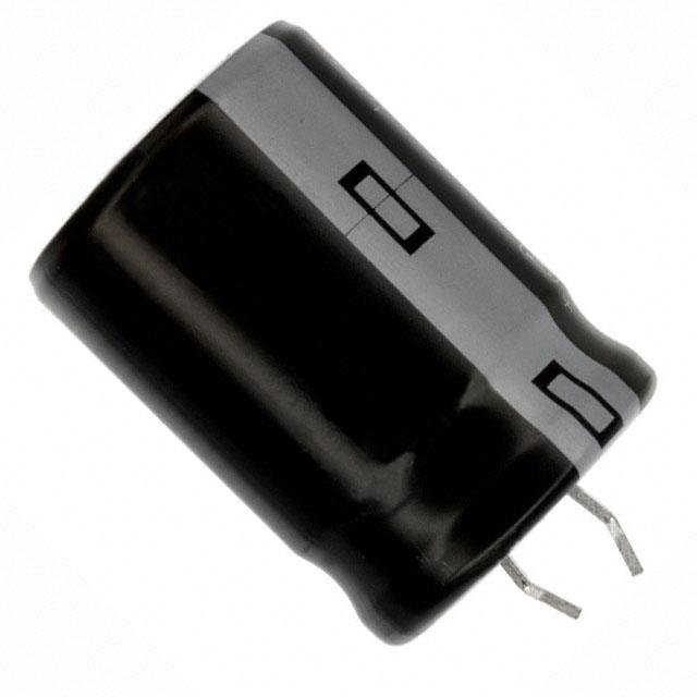

    820 µF 80 V 铝电解电容器 径向,Can - 卡入式 222 毫欧 @ 120Hz 105°C 时为 3000 小时
ECO-S1KA821BA 数据手册
Panasonic Industrial Company TS-HA/HB Series Aluminum Electrolytic Capacitors 105°C, 3000 hours  Long 3000 hour life at 105°C with high ripple current capability  2 and 3 pin versions available  Can vent construction Rated Working Voltage: Operating Temperature: Nominal Capacitance: Capacitance Tolerance: Dissipation Factor: (120 Hz, +20°C) RoHS Compliant 0 ~ 250 VDC -40 ~ +05°C 80~68000µF 385 ~ 450 VDC -25 ~ +05°C 82~560µF ± 20% Working Voltage [V]: Max. D.F. (%): 0 55 6 45 25 35 35 30 50 25 80 7 00 ~ 450 5 (rated cap. [µF] - 33000 ) 000 For capacitance values > 33000µF, add the value of: Leakage Current: Ripple Current Multipliers: 63 20 3¥CV (µA) max. after 5 minutes; C = Capacitance in µF, V = WV Frequency(Hz): 16~100WV: 160~450WV: 50 0.93 0.75 Endurance: 60 0.95 0.8 100~120 1.0 1.0 500 1.05 1.2 1k 1.08 1.25 10k 1.15 1.4 Ripple Current Ambient Temperature Factors** Temperature (°C): 105°C 85°C 70°C 60°C Multiplier: 1.0 1.7 2.0 2.2 ”45°C 2.35 3000 hours* at +05°C with maximum specified ripple current (see page 4) *2000 hours for 20mm length sizes **Use of temperature ripple current multipliers may limit life to the hours specified for the maximum operating temperature. Part Number System E C A B Terminal Style Prefix Length # of Pins ECOS 6.3mm 2 ECEC 4.0mm 2 ECE3 4.0mm 3 Capacitance Code Series Code A 0 C 6 A X L E 25 V 35 RoHS compliant PVC sleeve and top plate is standard. PET sleeve is available without top plate. Suffix Standard Ratings Extended CV Ratings 20mm Length Ratings Diameter Code Diameter B 22 C 25 D 30 E 35 Voltage Code J K 2A 2C 2D 2E 2T 2G 2W 63 80 00 60 200 250 385 400 450 H 50 Circuit Board Mounting Holes 10.0±0.1 2 Pin Mounting Style T L+2 max. 2 x Ø2.0±0.1 D+1 max. Circuit Board Mounting Holes 10.0±0.1 Ø2.0±0.1 3 Pin Mounting Style 4.75±0.1 3.3±0.1 T L+2 max. D+1 max. Ø2.0±0.1 Ø2.5 min. Pin Dimensions 2.0 max. 0.8 4.0 +0.2 -0.1 6.3±1.0 1.5±0.2 "T" 6.3mm Length: Standard on 2 Pin Mounting Style 2.0 max. +0.2 0.8 -0.1 Top of Capacitor Body 3.5 4.0±0.5 1.5±0.2 4mm Length: Standard on 3 Pin, Available on 2 Pin Mounting Styles Design and specifications are subject to change without notice. Contact the factory or your sales representative for technical specifications before purchase and/or use. When safety concerns arise, please contact Panasonic immediately for technical consultation. 37 Panasonic Industrial Company TS-HA Standard Ratings Cap. (µF) 0000 2000 5000 8000 22000 27000 33000 39000 47000 56000 68000 3300 4700 6800 8200 0000 2000 5000 8000 22000 27000 33000 39000 47000 56000 2200 3300 4700 5600 6800 38 Size (mm) DxL 22 22 22 25 22 25 22 25 30 22 25 30 35 25 30 35 25 30 35 30 35 30 35 35 x x x x x x x x x x x x x x x x x x x x x x x x 25 30 35 25 40 30 45 35 25 50 40 30 25 45 35 30 50 40 30 45 35 50 40 50 22 25 22 30 22 22 25 35 22 25 30 22 25 30 22 25 30 35 25 30 35 25 30 35 30 35 30 35 35 35 x x x x x x x x x x x x x x x x x x x x x x x x x x x x x x 20 20 25 20 30 30 25 20 35 30 25 40 35 30 45 40 30 25 45 35 30 50 40 30 45 35 50 40 45 50 22 25 22 30 22 22 25 35 x x x x x x x x 20 20 25 20 30 30 25 20 Max 105°C R.C. (Arms) 20°C ESR (Ȏ, max.) 120Hz 10kHz~ 120Hz 20kHz 10 VDC Working, 3 VDC Surge .80 2.07 0.075 0.063 2.20 2.53 0.062 0.053 2.30 2.65 0.053 0.045 2.30 2.65 0.053 0.045 2.40 2.76 0.044 0.038 2.40 2.76 0.044 0.038 2.60 2.99 0.038 0.032 2.60 2.99 0.038 0.032 2.60 2.99 0.038 0.032 3.0 3.57 0.033 0.028 3.0 3.57 0.033 0.028 3.0 3.57 0.033 0.028 3.0 3.57 0.033 0.028 3.40 3.9 0.027 0.023 3.40 3.9 0.027 0.023 3.40 3.9 0.027 0.023 3.70 4.26 0.025 0.02 3.70 4.26 0.025 0.02 3.70 4.26 0.025 0.02 4.20 4.83 0.023 0.020 4.20 4.83 0.023 0.020 5.00 5.75 0.022 0.09 5.00 5.75 0.022 0.02 5.50 6.33 0.02 0.020 16 VDC Working, 20 VDC Surge .30 .50 0.26 0.73 .60 .84 0.52 0.2 2.20 2.53 0.085 0.068 .80 2.07 0.05 0.084 2.40 2.76 0.07 0.057 2.60 2.99 0.066 0.053 2.60 2.99 0.066 0.053 2.40 2.76 0.07 0.057 2.90 3.34 0.055 0.044 2.90 3.34 0.055 0.044 2.90 3.34 0.055 0.044 3.20 3.68 0.046 0.037 3.20 3.68 0.046 0.037 3.20 3.68 0.046 0.037 3.50 4.03 0.040 0.034 3.50 4.03 0.040 0.034 3.50 4.03 0.040 0.034 3.50 4.03 0.040 0.034 3.80 4.37 0.033 0.028 3.80 4.37 0.033 0.028 3.80 4.37 0.033 0.028 4.20 4.83 0.028 0.025 4.20 4.83 0.028 0.025 4.20 4.83 0.028 0.025 4.70 5.4 0.023 0.020 4.70 5.4 0.023 0.020 5.0 5.87 0.022 0.020 5.0 5.87 0.022 0.020 5.50 6.33 0.020 0.08 6.00 6.90 0.09 0.07 25 VDC Working, 32 VDC Surge .30 .50 0.24 0.8 .60 .84 0.6 0.2 2.00 2.30 0.06 0.079 .80 2.07 0.3 0.085 2.20 2.53 0.089 0.067 2.40 2.76 0.073 0.055 2.40 2.76 0.073 0.055 2.30 2.65 0.080 0.060 Aluminum Electrolytic Capacitors Part numbers shown with 2 pins Panasonic Part Number (By Terminal Length) 6.3mm Length Terminal 4.0mm Length Terminal ECOS1AA103BA ECOS1AA123BA ECOS1AA153BA ECOS1AA153CA ECOS1AA183BA ECOS1AA183CA ECOS1AA223BA ECOS1AA223CA ECOS1AA223DA ECOS1AA273BA ECOS1AA273CA ECOS1AA273DA ECOS1AA273EA ECOS1AA333CA ECOS1AA333DA ECOS1AA333EA ECOS1AA393CA ECOS1AA393DA ECOS1AA393EA ECOS1AA473DA ECOS1AA473EA ECOS1AA563DA ECOS1AA563EA ECOS1AA683EA ECEC1AA103BA ECEC1AA123BA ECEC1AA153BA ECEC1AA153CA ECEC1AA183BA ECEC1AA183CA ECEC1AA223BA ECEC1AA223CA ECEC1AA223DA ECEC1AA273BA ECEC1AA273CA ECEC1AA273DA ECEC1AA273EA ECEC1AA333CA ECEC1AA333DA ECEC1AA333EA ECEC1AA393CA ECEC1AA393DA ECEC1AA393EA ECEC1AA473DA ECEC1AA473EA ECEC1AA563DA ECEC1AA563EA ECEC1AA683EA ECOS1CA332BL ECOS1CA472CL ECOS1CA682BA ECOS1CA682DL ECOS1CA822BA ECOS1CA103BA ECOS1CA103CA ECOS1CA103EL ECOS1CA123BA ECOS1CA123CA ECOS1CA123DA ECOS1CA153BA ECOS1CA153CA ECOS1CA153DA ECOS1CA183BA ECOS1CA183CA ECOS1CA183DA ECOS1CA183EA ECOS1CA223CA ECOS1CA223DA ECOS1CA223EA ECOS1CA273CA ECOS1CA273DA ECOS1CA273EA ECOS1CA333DA ECOS1CA333EA ECOS1CA393DA ECOS1CA393EA ECOS1CA473EA ECOS1CA563EA ECEC1CA332BL ECEC1CA472CL ECEC1CA682BA ECEC1CA682DL ECEC1CA822BA ECEC1CA103BA ECEC1CA103CA ECEC1CA103EL ECEC1CA123BA ECEC1CA123CA ECEC1CA123DA ECEC1CA153BA ECEC1CA153CA ECEC1CA153DA ECEC1CA183BA ECEC1CA183CA ECEC1CA183DA ECEC1CA183EA ECEC1CA223CA ECEC1CA223DA ECEC1CA223EA ECEC1CA273CA ECEC1CA273DA ECEC1CA273EA ECEC1CA333DA ECEC1CA333EA ECEC1CA393DA ECEC1CA393EA ECEC1CA473EA ECEC1CA563EA ECOS1EA222BL ECOS1EA332CL ECOS1EA472BA ECOS1EA472DL ECOS1EA562BA ECOS1EA682BA ECOS1EA682CA ECOS1EA682EL ECEC1EA222BL ECEC1EA332CL ECEC1EA472BA ECEC1EA472DL ECEC1EA562BA ECEC1EA682BA ECEC1EA682CA ECEC1EA682EL Design and specifications are subject to change without notice. Contact the factory or your sales representative for technical specifications before purchase and/or use. When safety concerns arise, please contact Panasonic immediately for technical consultation. Panasonic Industrial Company Aluminum Electrolytic Capacitors TS-HA Standard Ratings (continued) Cap. (µF) Size (mm) DxL 8200 22 25 30 22 25 30 22 25 30 35 25 30 35 25 30 35 30 35 35 35 x x x x x x x x x x x x x x x x x x x x 35 30 25 40 35 30 45 40 30 25 45 35 30 50 40 35 45 35 45 50 22 25 22 30 22 22 25 35 22 25 30 22 25 30 22 25 30 35 25 30 35 25 30 35 30 35 35 35 x x x x x x x x x x x x x x x x x x x x x x x x x x x x 20 20 25 20 30 35 25 20 35 30 25 40 35 30 50 40 30 25 45 35 30 50 40 30 45 35 40 50 0000 2000 5000 8000 22000 27000 33000 500 2200 3300 3900 4700 5600 6800 8200 0000 2000 5000 8000 22000 000 500 800 2200 2700 3300 3900 4700 22 25 22 22 30 22 25 22 25 35 22 25 30 22 25 x x x x x x x x x x x x x x x 20 20 25 30 20 30 25 35 30 20 40 35 25 45 40 Part numbers shown with 2 pins Max 105°C R.C. (Arms) 20°C ESR (ȍ, max.) Panasonic Part Number (By Terminal Length) 6.3mm Length Terminal 120Hz 10kHz~ 120Hz 20kHz 4.0mm Length Terminal 25 VDC Working, 32 VDC Surge (continued) ECOS1EA822BA ECEC1EA822BA 2.70 3. 0.06 0.045 ECEC1EA822CA ECOS1EA822CA 2.70 3. 0.06 0.045 ECOS1EA822DA ECEC1EA822DA 2.70 3. 0.06 0.045 ECOS1EA103BA ECEC1EA103BA 3.00 3.45 0.05 0.039 ECOS1EA103CA ECEC1EA103CA 3.00 3.45 0.05 0.039 ECOS1EA103DA ECEC1EA103DA 3.00 3.45 0.05 0.039 ECOS1EA123BA ECEC1EA123BA 3.20 3.68 0.044 0.033 ECOS1EA123CA ECEC1EA123CA 3.20 3.68 0.044 0.035 ECEC1EA123DA ECOS1EA123DA 3.20 3.68 0.044 0.035 ECEC1EA123EA ECOS1EA123EA 3.20 3.68 0.044 0.035 ECOS1EA153CA ECEC1EA153CA 3.60 4.4 0.036 0.03 ECOS1EA153DA ECEC1EA153DA 3.60 4.4 0.036 0.03 ECOS1EA153EA ECEC1EA153EA 3.60 4.4 0.036 0.03 ECOS1EA183CA ECEC1EA183CA 3.90 4.49 0.030 0.027 ECOS1EA183DA ECEC1EA183DA 3.90 4.49 0.030 0.027 ECOS1EA183EA ECEC1EA183EA 3.90 4.49 0.030 0.027 ECEC1EA223DA ECOS1EA223DA 4.30 4.95 0.025 0.022 ECOS1EA223EA ECEC1EA223EA 4.30 4.95 0.025 0.022 ECOS1EA273EA ECEC1EA273EA 4.80 5.52 0.02 0.09 ECOS1EA333EA ECEC1EA333EA 5.50 6.33 0.08 0.06 35 VDC Working, 44 VDC Surge ECOS1VA152BL ECEC1VA152BL .0 .27 0.287 0.26 ECOS1VA222CL ECEC1VA222CL .40 .6 0.96 0.47 ECOS1VA332BA ECEC1VA332BA .90 2.9 0.2 0.090 ECOS1VA332DL ECEC1VA332DL .70 .96 0.3 0.098 ECOS1VA392BA ECEC1VA392BA 2.00 2.30 0. 0.083 ECOS1VA472BA ECEC1VA472BA 2.20 2.53 0.088 0.066 ECOS1VA472CA ECEC1VA472CA 2.20 2.53 0.088 0.066 ECOS1VA472EL ECEC1VA472EL 2.00 2.30 0.095 0.07 ECOS1VA562BA ECEC1VA562BA 2.40 2.76 0.074 0.056 ECOS1VA562CA ECEC1VA562CA 2.40 2.76 0.074 0.056 ECOS1VA562DA ECEC1VA562DA 2.40 2.76 0.074 0.056 ECOS1VA682BA ECEC1VA682BA 2.60 2.99 0.06 0.046 ECOS1VA682CA ECEC1VA682CA 2.60 2.99 0.06 0.046 ECOS1VA682DA ECEC1VA682DA 2.60 2.99 0.06 0.046 ECOS1VA822BA ECEC1VA822BA 2.90 3.34 0.05 0.038 ECOS1VA822CA ECEC1VA822CA 2.90 3.34 0.05 0.038 ECOS1VA822DA ECEC1VA822DA 2.90 3.34 0.05 0.038 ECOS1VA822EA ECEC1VA822EA 2.90 3.34 0.05 0.038 ECOS1VA103CA ECEC1VA103CA 3.20 3.68 0.04 0.03 ECOS1VA103DA ECEC1VA103DA 3.20 3.68 0.04 0.03 ECOS1VA103EA ECEC1VA103EA 3.20 3.68 0.04 0.03 ECOS1VA123CA ECEC1VA123CA 3.50 4.03 0.035 0.026 ECOS1VA123DA ECEC1VA123DA 3.50 4.03 0.035 0.026 ECOS1VA123EA ECEC1VA123EA 3.50 4.03 0.035 0.026 ECOS1VA153DA ECEC1VA153DA 3.90 4.49 0.030 0.022 ECEC1VA153EA ECOS1VA153EA 3.90 4.49 0.030 0.022 ECEC1VA183EA ECOS1VA183EA 4.30 4.95 0.028 0.02 ECEC1VA223EA ECOS1VA223EA 5.00 5.75 0.023 0.07 50 VDC Working, 63 VDC Surge ECEC1HA102BL ECOS1HA102BL 0.90 .04 0.265 0.99 ECOS1HA152CL ECEC1HA152CL .20 .38 0.77 0.33 ECEC1HA182BA ECOS1HA182BA .50 .73 0.29 0.097 ECEC1HA222BA ECOS1HA222BA .70 .96 0.05 0.079 ECOS1HA222DL ECEC1HA222DL .40 .6 0.2 0.090 ECOS1HA272BA ECEC1HA272BA .80 2.07 0.086 0.064 ECEC1HA272CA ECOS1HA272CA .80 2.07 0.086 0.064 ECEC1HA332BA ECOS1HA332BA 2.00 2.30 0.070 0.053 ECOS1HA332CA ECEC1HA332CA 2.00 2.30 0.070 0.053 ECEC1HA332EL ECOS1HA332EL .70 .96 0.085 0.064 ECOS1HA392BA ECEC1HA392BA 2.20 2.53 0.064 0.048 ECOS1HA392CA ECEC1HA392CA 2.20 2.53 0.064 0.048 ECOS1HA392DA ECEC1HA392DA 2.20 2.53 0.064 0.048 ECOS1HA472BA ECEC1HA472BA 2.50 2.88 0.053 0.040 ECOS1HA472CA ECEC1HA472CA 2.50 2.88 0.053 0.040 Design and specifications are subject to change without notice. Contact the factory or your sales representative for technical specifications before purchase and/or use. When safety concerns arise, please contact Panasonic immediately for technical consultation. 39 Panasonic Industrial Company Aluminum Electrolytic Capacitors TS-HA Standard Ratings (continued) Cap. (µF) Size (mm) DxL 4700 30 35 22 25 30 35 25 30 35 30 35 30 35 35 35 x x x x x x x x x x x x x x x 30 25 50 40 35 30 50 40 30 45 35 50 40 45 50 22 25 22 22 30 22 25 22 25 35 22 25 30 22 25 30 35 25 30 35 25 30 35 30 35 30 35 35 35 x x x x x x x x x x x x x x x x x x x x x x x x x x x x x 20 20 25 30 20 30 25 35 30 20 40 35 25 50 40 30 25 45 35 30 50 40 30 45 35 50 40 45 50 5600 6800 8200 0000 2000 5000 680 000 200 500 800 2200 2700 3300 3900 4700 5600 6800 8200 0000 470 560 820 000 200 500 800 2200 40 22 25 22 22 25 30 22 25 22 25 35 22 25 30 22 25 30 35 x x x x x x x x x x x x x x x x x x 20 20 25 30 25 20 30 25 35 30 20 40 35 25 45 35 30 25 Part numbers shown with 2 pins Max 105°C R.C. (Arms) 20°C ESR (ȍ, max.) Panasonic Part Number (By Terminal Length) 6.3mm Length Terminal 120Hz 10kHz~ 120Hz 20kHz 4.0mm Length Terminal 50 VDC Working, 63 VDC Surge (continued) ECOS1HA472DA ECEC1HA472DA 2.50 2.88 0.053 0.040 ECOS1HA472EA ECEC1HA472EA 2.50 2.88 0.053 0.040 ECOS1HA562BA ECEC1HA562BA 2.80 3.22 0.050 0.038 ECOS1HA562CA ECEC1HA562CA 2.80 3.22 0.050 0.038 ECOS1HA562DA ECEC1HA562DA 2.80 3.22 0.050 0.038 ECOS1HA562EA ECEC1HA562EA 2.80 3.22 0.050 0.038 ECOS1HA682CA ECEC1HA682CA 3.30 3.80 0.046 0.035 ECOS1HA682DA ECEC1HA682DA 3.30 3.80 0.046 0.035 ECEC1HA682EA ECOS1HA682EA 3.30 3.80 0.046 0.035 ECOS1HA822DA ECEC1HA822DA 3.60 4.4 0.038 0.029 ECOS1HA822EA ECEC1HA822EA 3.60 4.4 0.038 0.029 ECOS1HA103DA ECEC1HA103DA 4.00 4.60 0.033 0.025 ECOS1HA103EA ECEC1HA103EA 4.00 4.60 0.033 0.025 ECEC1HA123EA ECOS1HA123EA 4.50 5.8 0.028 0.022 ECEC1HA153EA ECOS1HA153EA 4.80 5.52 0.022 0.08 63 VDC Working, 79 VDC Surge ECOS1JA681BL ECEC1JA681BL 0.90 .04 0.463 0.347 ECOS1JA102CL ECEC1JA102CL .20 .38 0.35 0.236 ECOS1JA122BA ECEC1JA122BA .40 .6 0.235 0.76 ECOS1JA152BA ECEC1JA152BA .50 .73 0.88 0.4 ECOS1JA152DL ECEC1JA152DL .30 .50 0.20 0.57 ECOS1JA182BA ECEC1JA182BA .70 .96 0.57 0.7 ECEC1JA182CA ECOS1JA182CA .70 .96 0.57 0.7 ECEC1JA222BA ECOS1JA222BA 2.00 2.30 0.28 0.096 ECEC1JA222CA ECOS1JA222CA 2.00 2.30 0.28 0.096 ECEC1JA222EL ECOS1JA222EL .50 .73 0.43 0.07 ECEC1JA272BA ECOS1JA272BA 2.20 2.53 0.04 0.078 ECEC1JA272CA ECOS1JA272CA 2.20 2.53 0.04 0.078 ECEC1JA272DA ECOS1JA272DA 2.20 2.53 0.04 0.078 ECEC1JA332BA ECOS1JA332BA 2.50 2.88 0.090 0.068 ECEC1JA332CA ECOS1JA332CA 2.50 2.88 0.090 0.068 ECEC1JA332DA ECOS1JA332DA 2.50 2.88 0.090 0.068 ECEC1JA332EA ECOS1JA332EA 2.50 2.88 0.090 0.068 ECEC1JA392CA ECOS1JA392CA 2.70 3. 0.077 0.057 ECEC1JA392DA ECOS1JA392DA 2.70 3. 0.077 0.057 ECEC1JA392EA ECOS1JA392EA 2.70 3. 0.077 0.057 ECEC1JA472CA ECOS1JA472CA 3.00 3.45 0.063 0.048 ECEC1JA472DA ECOS1JA472DA 3.00 3.45 0.063 0.048 ECEC1JA472EA ECOS1JA472EA 3.00 3.45 0.063 0.048 ECEC1JA562DA ECOS1JA562DA 3.30 3.80 0.053 0.040 ECEC1JA562EA ECOS1JA562EA 3.30 3.80 0.053 0.040 ECEC1JA682DA ECOS1JA682DA 3.60 4.4 0.049 0.037 ECEC1JA682EA ECOS1JA682EA 3.60 4.4 0.049 0.037 ECEC1JA822EA ECOS1JA822EA 3.90 4.49 0.040 0.030 ECOS1JA103EA ECEC1JA103EA 4.40 5.06 0.033 0.028 80 VDC Working, 00 VDC Surge ECEC1KA471BL ECOS1KA471BL 0.80 0.92 0.459 0.298 ECEC1KA681CL ECOS1KA681CL .00 .5 0.37 0.206 ECOS1KA821BA ECEC1KA821BA .20 .38 0.222 0.45 ECOS1KA102BA ECEC1KA102BA .30 .50 0.82 0.9 ECEC1KA102CA ECOS1KA102CA .30 .50 0.82 0.9 ECOS1KA102DL ECEC1KA102DL .20 .38 0.26 0.40 ECOS1KA122BA ECEC1KA122BA .50 .73 0.66 0.6 ECEC1KA122CA ECOS1KA122CA .50 .73 0.66 0.6 ECEC1KA152BA ECOS1KA152BA .70 .96 0.33 0.093 ECOS1KA152CA ECEC1KA152CA .70 .96 0.33 0.093 ECOS1KA152EL ECEC1KA152EL .40 .6 0.55 0.08 ECOS1KA182BA ECEC1KA182BA .80 2.07 0. 0.077 ECOS1KA182CA ECEC1KA182CA .80 2.07 0. 0.077 ECOS1KA182DA ECEC1KA182DA .80 2.07 0. 0.077 ECOS1KA222BA ECEC1KA222BA 2.0 2.42 0.090 0.063 ECOS1KA222CA ECEC1KA222CA 2.0 2.42 0.090 0.063 ECOS1KA222DA ECEC1KA222DA 2.0 2.42 0.090 0.063 ECOS1KA222EA ECEC1KA222EA 2.0 2.42 0.090 0.063 Design and specifications are subject to change without notice. Contact the factory or your sales representative for technical specifications before purchase and/or use. When safety concerns arise, please contact Panasonic immediately for technical consultation. Panasonic Industrial Company Aluminum Electrolytic Capacitors TS-HA/HB Standard Ratings (continued) Cap. (µF) Size (mm) DxL 2700 25 30 35 25 30 35 30 35 30 35 35 35 x x x x x x x x x x x x 45 35 30 50 40 30 45 35 50 40 45 50 22 25 22 30 22 25 22 25 35 22 25 30 22 25 30 35 25 30 35 25 30 35 30 35 30 35 35 35 x x x x x x x x x x x x x x x x x x x x x x x x x x x x 20 20 25 20 30 25 35 30 20 40 35 25 45 40 30 25 45 35 30 50 40 30 45 35 50 40 45 50 3300 3900 4700 5600 6800 330 470 560 680 820 000 200 500 800 2200 2700 3300 3900 4700 470 560 680 820 000 200 500 800 2200 2700 390 470 22 22 22 25 22 25 22 25 30 35 25 30 35 30 35 30 35 35 35 x x x x x x x x x x x x x x x x x x x 30 35 40 30 45 35 50 40 30 25 45 35 30 40 30 45 35 45 50 22 x 30 25 x 25 22 x 35 Part numbers shown with 2 pins Max 105°C R.C. (Arms) 20°C ESR (ȍ, max.) Panasonic Part Number (By Terminal Length) 6.3mm Length Terminal 4.0mm Length Terminal 120Hz 10kHz~ 120Hz 20kHz 80 VDC Working, 00 VDC Surge (continued) ECEC1KA272CA ECOS1KA272CA 2.40 2.76 0.074 0.055 ECEC1KA272DA ECOS1KA272DA 2.40 2.76 0.074 0.055 ECEC1KA272EA ECOS1KA272EA 2.40 2.76 0.074 0.055 ECEC1KA332CA ECOS1KA332CA 2.60 2.99 0.065 0.049 ECEC1KA332DA ECOS1KA332DA 2.60 2.99 0.065 0.049 ECEC1KA332EA ECOS1KA332EA 2.60 2.99 0.065 0.049 ECEC1KA392DA ECOS1KA392DA 3.00 3.45 0.060 0.045 ECEC1KA392EA ECOS1KA392EA 3.00 3.45 0.060 0.045 ECEC1KA472DA ECOS1KA472DA 3.30 3.80 0.049 0.037 ECEC1KA472EA ECOS1KA472EA 3.30 3.80 0.049 0.037 ECEC1KA562EA ECOS1KA562EA 3.70 4.26 0.050 0.038 ECOS1KA682EA ECEC1KA682EA 3.90 4.49 0.04 0.03 100 VDC Working, 25 VDC Surge ECOS2AA331BL ECEC2AA331BL 0.80 .20 0.653 0.392 ECOS2AA471CL ECEC2AA471CL .00 .50 0.459 0.275 ECOS2AA561BA ECEC2AA561BA .0 .65 0.296 0.78 ECOS2AA681DL ECEC2AA681DL .0 .65 0.37 0.90 ECOS2AA821BA ECEC2AA821BA .40 2.0 0.202 0.2 ECOS2AA821CA ECEC2AA821CA .40 2.0 0.202 0.2 ECOS2AA102BA ECEC2AA102BA .70 2.55 0.82 0.09 ECEC2AA102CA ECOS2AA102CA .70 2.55 0.82 0.09 ECEC2AA102EL ECOS2AA102EL .20 .80 0.26 0.29 ECOS2AA122BA ECEC2AA122BA .80 2.70 0.52 0.09 ECOS2AA122CA ECEC2AA122CA .80 2.70 0.52 0.09 ECOS2AA122DA ECEC2AA122DA .80 2.70 0.52 0.09 ECOS2AA152BA ECEC2AA152BA 2.0 3.5 0.22 0.073 ECOS2AA152CA ECEC2AA152CA 2.0 3.5 0.22 0.079 ECOS2AA152DA ECEC2AA152DA 2.0 3.5 0.22 0.079 ECOS2AA152EA ECEC2AA152EA 2.0 3.5 0.22 0.079 ECOS2AA182CA ECEC2AA182CA 2.30 3.45 0. 0.072 ECOS2AA182DA ECEC2AA182DA 2.30 3.45 0. 0.072 ECOS2AA182EA ECEC2AA182EA 2.30 3.45 0. 0.072 ECOS2AA222CA ECEC2AA222CA 2.60 3.90 0.090 0.059 ECOS2AA222DA ECEC2AA222DA 2.60 3.90 0.090 0.059 ECOS2AA222EA ECEC2AA222EA 2.60 3.90 0.090 0.059 ECOS2AA272DA ECEC2AA272DA 2.90 4.35 0.080 0.052 ECOS2AA272EA ECEC2AA272EA 2.90 4.35 0.080 0.052 ECOS2AA332DA ECEC2AA332DA 3.20 4.80 0.075 0.053 ECOS2AA332EA ECEC2AA332EA 3.20 4.80 0.075 0.053 ECOS2AA392EA ECEC2AA392EA 3.60 5.40 0.064 0.045 ECOS2AA472EA ECEC2AA472EA 3.80 5.70 0.053 0.040 160 VDC Working, 200 VDC Surge ECEC2CB471BA ECOS2CB471BA .40 .96 0.423 0.90 ECEC2CB561BA ECOS2CB561BA .50 2.0 0.355 0.60 ECEC2CB681BA ECOS2CB681BA .70 2.38 0.293 0.32 ECEC2CB681CA ECOS2CB681CA .70 2.38 0.293 0.32 ECEC2CB821BA ECOS2CB821BA 2.00 2.80 0.243 0.09 ECOS2CB821CA ECEC2CB821CA 2.00 2.80 0.243 0.09 ECOS2CB102BA ECEC2CB102BA 2.20 3.08 0.99 0.090 ECEC2CB102CA ECOS2CB102CA 2.20 3.08 0.99 0.090 ECOS2CB102DA ECEC2CB102DA 2.20 3.08 0.99 0.090 ECEC2CB102EA ECOS2CB102EA 2.20 3.08 0.99 0.090 ECEC2CB122CA ECOS2CB122CA 2.30 3.22 0.80 0.090 ECEC2CB122DA ECOS2CB122DA 2.30 3.22 0.80 0.090 ECEC2CB122EA ECOS2CB122EA 2.30 3.22 0.80 0.090 ECEC2CB152DA ECOS2CB152DA 2.50 3.50 0.44 0.072 ECOS2CB152EA ECEC2CB152EA 2.50 3.50 0.44 0.072 ECOS2CB182DA ECEC2CB182DA 2.70 3.78 0.29 0.064 ECOS2CB182EA ECEC2CB182EA 2.70 3.78 0.29 0.064 ECOS2CB222EA ECEC2CB222EA 2.90 4.06 0.05 0.063 ECEC2CB272EA ECOS2CB272EA 3.0 4.34 0.086 0.052 200 VDC Working, 250 VDC Surge ECEC2DB391BA ECOS2DB391BA .30 .82 0.50 0.230 ECEC2DB391CA ECOS2DB391CA .30 .82 0.50 0.230 ECEC2DB471BA ECOS2DB471BA .40 .96 0.423 0.90 Design and specifications are subject to change without notice. Contact the factory or your sales representative for technical specifications before purchase and/or use. When safety concerns arise, please contact Panasonic immediately for technical consultation. 41 Panasonic Industrial Company Aluminum Electrolytic Capacitors TS-HB Standard Ratings (continued) Cap. (µF) Size (mm) DxL 470 560 25 22 25 30 22 25 25 30 35 25 30 35 30 35 30 35 35 35 x x x x x x x x x x x x x x x x x x 30 40 30 25 45 35 45 30 25 50 35 30 40 35 50 40 45 50 22 22 22 22 25 22 30 22 25 30 25 35 25 30 35 30 35 30 35 35 35 x x x x x x x x x x x x x x x x x x x x x 25 30 35 40 30 45 25 50 40 30 45 25 50 40 30 45 35 50 40 45 50 680 820 000 200 500 800 2200 80 220 270 330 390 470 560 680 820 000 200 500 82 00 390 470 560 22 22 25 22 25 22 25 30 22 25 30 25 30 35 25 35 30 35 30 35 35 82 00 22 x 30 22 x 30 20 50 80 220 270 330 42 x x x x x x x x x x x x x x x x x x x x x 30 30 25 35 30 40 30 25 45 35 30 45 30 25 50 30 45 35 50 45 50 Part numbers shown with 2 pins Max 105°C R.C. (Arms) 20°C ESR (ȍ, max.) Panasonic Part Number (By Terminal Length) 6.3mm Length Terminal 4.0mm Length Terminal 120Hz 10kHz~ 120Hz 20kHz 200 VDC Working, 250 VDC Surge (continued) ECOS2DB471CA ECEC2DB471CA .40 .96 0.423 0.90 ECOS2DB561BA ECEC2DB561BA .50 2.0 0.355 0.60 ECEC2DB561CA ECOS2DB561CA .50 2.0 0.355 0.60 ECEC2DB561DA ECOS2DB561DA .50 2.0 0.355 0.60 ECEC2DB681BA ECOS2DB681BA .70 2.38 0.293 0.32 ECEC2DB681CA ECOS2DB681CA .70 2.38 0.293 0.32 ECOS2DB821CA ECEC2DB821CA 2.00 2.80 0.263 0.8 ECOS2DB821DA ECEC2DB821DA 2.00 2.80 0.263 0.8 ECEC2DB821EA ECOS2DB821EA 2.00 2.80 0.263 0.8 ECOS2DB102CA ECEC2DB102CA 2.20 3.08 0.26 0.08 ECOS2DB102DA ECEC2DB102DA 2.20 3.08 0.26 0.08 ECOS2DB102EA ECEC2DB102EA 2.20 3.08 0.26 0.08 ECOS2DB122DA ECEC2DB122DA 2.30 3.22 0.93 0.097 ECEC2DB122EA ECOS2DB122EA 2.30 3.22 0.93 0.097 ECOS2DB152DA ECEC2DB152DA 2.50 3.50 0.55 0.077 ECOS2DB152EA ECEC2DB152EA 2.50 3.50 0.55 0.077 ECOS2DB182EA ECEC2DB182EA 2.70 3.78 0.29 0.077 ECOS2DB222EA ECEC2DB222EA 2.90 4.06 0.05 0.063 250 VDC Working, 300 VDC Surge ECOS2EB181BA ECEC2EB181BA 0.90 .26 0.92 0.46 ECOS2EB221BA ECEC2EB221BA .00 .40 0.754 0.377 ECEC2EB271BA ECOS2EB271BA .0 .54 0.64 0.307 ECOS2EB331BA ECEC2EB331BA .20 .68 0.502 0.25 ECOS2EB331CA ECEC2EB331CA .20 .68 0.502 0.25 ECOS2EB391BA ECEC2EB391BA .30 .82 0.425 0.23 ECOS2EB391DA ECEC2EB391DA .30 .82 0.425 0.23 ECEC2EB471BA ECOS2EB471BA .40 .96 0.353 0.76 ECEC2EB471CA ECOS2EB471CA .40 .96 0.353 0.76 ECEC2EB471DA ECOS2EB471DA .40 .96 0.353 0.76 ECEC2EB561CA ECOS2EB561CA .50 2.0 0.296 0.48 ECOS2EB561EA ECEC2EB561EA .50 2.0 0.296 0.48 ECOS2EB681CA ECEC2EB681CA .70 2.38 0.244 0.34 ECOS2EB681DA ECEC2EB681DA .70 2.38 0.244 0.34 ECOS2EB681EA ECEC2EB681EA .70 2.38 0.244 0.34 ECOS2EB821DA ECEC2EB821DA 2.00 2.80 0.202 0. ECOS2EB821EA ECEC2EB821EA 2.00 2.80 0.202 0. ECEC2EB102DA ECOS2EB102DA 2.20 3.08 0.99 0.09 ECOS2EB102EA ECEC2EB102EA 2.20 3.08 0.99 0.09 ECEC2EB122EA ECOS2EB122EA 2.30 3.22 0.66 0.099 ECOS2EB152EA ECEC2EB152EA 2.50 3.50 0.44 0.093 385 VDC Working, 425 VDC Surge ECEC2TB820BA ECOS2TB820BA 0.64 0.90 2.022 0.809 ECEC2TB101BA ECOS2TB101BA 0.69 0.97 .658 0.663 ECOS2TB101CA ECEC2TB101CA 0.69 0.97 .658 0.663 ECOS2TB121BA ECEC2TB121BA 0.75 .05 .382 0.553 ECEC2TB121CA ECOS2TB121CA 0.75 .05 .382 0.553 ECEC2TB151BA ECOS2TB151BA 0.82 .5 .05 0.442 ECEC2TB151CA ECOS2TB151CA 0.82 .5 .05 0.442 ECOS2TB151DA ECEC2TB151DA 0.82 .5 .05 0.442 ECOS2TB181BA ECEC2TB181BA 0.95 .33 0.92 0.368 ECOS2TB181CA ECEC2TB181CA 0.95 .33 0.92 0.368 ECOS2TB181DA ECEC2TB181DA 0.95 .33 0.92 0.368 ECOS2TB221CA ECEC2TB221CA .0 .54 0.754 0.30 ECEC2TB221DA ECOS2TB221DA .0 .54 0.829 0.332 ECOS2TB221EA ECEC2TB221EA .0 .54 0.829 0.332 ECOS2TB271CA ECEC2TB271CA .20 .68 0.675 0.270 ECOS2TB271EA ECEC2TB271EA .20 .68 0.675 0.270 ECOS2TB331DA ECEC2TB331DA .35 .89 0.553 0.22 ECOS2TB331EA ECEC2TB331EA .35 .89 0.553 0.22 ECOS2TB391DA ECEC2TB391DA .55 2.7 0.50 0.204 ECOS2TB471EA ECEC2TB471EA .75 2.45 0.423 0.22 ECOS2TB561EA ECEC2TB561EA .80 2.52 0.355 0.78 400 VDC Working, 450 VDC Surge ECEC2GB820BA ECOS2GB820BA 0.64 0.90 2.022 0.708 ECOS2GB101BA ECEC2GB101BA 0.69 0.97 .658 0.580 Design and specifications are subject to change without notice. Contact the factory or your sales representative for technical specifications before purchase and/or use. When safety concerns arise, please contact Panasonic immediately for technical consultation. Panasonic Industrial Company Aluminum Electrolytic Capacitors TS-HB Standard Ratings (continued) Cap. (µF) Size (mm) DxL 00 20 25 22 25 22 25 30 22 25 30 25 30 35 25 30 35 30 35 30 35 35 35 x x x x x x x x x x x x x x x x x x x x x 25 35 30 40 30 25 45 35 30 45 30 25 50 35 30 45 35 50 40 45 50 22 25 22 25 22 25 30 22 25 30 25 30 35 25 30 35 30 35 30 35 35 35 x x x x x x x x x x x x x x x x x x x x x x 30 25 35 30 40 30 25 45 40 30 45 30 25 50 40 30 45 35 50 40 45 50 50 80 220 270 330 390 470 560 00 20 50 80 220 270 330 390 470 560 82 00 20 50 80 220 270 330 390 470 22 25 22 25 22 25 30 22 25 30 35 25 30 25 30 35 30 35 30 35 35 35 x x x x x x x x x x x x x x x x x x x x x x 30 25 35 30 40 35 25 50 40 30 25 45 35 50 40 30 45 35 50 40 45 50 Part numbers shown with 2 pins Max 105°C R.C. (Arms) 20°C ESR (ȍ, max.) Panasonic Part Number (By Terminal Length) 6.3mm Length Terminal 4.0mm Length Terminal 120Hz 10kHz~ 120Hz 20kHz 400 VDC Working, 450 VDC Surge (continued) ECOS2GB101CA ECEC2GB101CA 0.69 0.97 .658 0.580 ECOS2GB121BA ECEC2GB121BA 0.75 .05 .382 0.484 ECEC2GB121CA ECOS2GB121CA 0.75 .05 .382 0.484 ECOS2GB151BA ECEC2GB151BA 0.82 .5 .05 0.387 ECOS2GB151CA ECEC2GB151CA 0.82 .5 .05 0.387 ECOS2GB151DA ECEC2GB151DA 0.82 .5 .05 0.387 ECOS2GB181BA ECEC2GB181BA 0.95 .33 0.92 0.322 ECOS2GB181CA ECEC2GB181CA 0.95 .33 0.92 0.322 ECOS2GB181DA ECEC2GB181DA 0.95 .33 0.92 0.322 ECEC2GB221CA ECOS2GB221CA .0 .54 0.754 0.264 ECEC2GB221DA ECOS2GB221DA .0 .54 0.754 0.264 ECOS2GB221EA ECEC2GB221EA .0 .54 0.754 0.264 ECOS2GB271CA ECEC2GB271CA .20 .68 0.64 0.25 ECEC2GB271DA ECOS2GB271DA .20 .68 0.64 0.25 ECEC2GB271EA ECOS2GB271EA .20 .68 0.64 0.25 ECOS2GB331DA ECEC2GB331DA .35 .89 0.502 0.20 ECEC2GB331EA ECOS2GB331EA .35 .89 0.502 0.20 ECEC2GB391DA ECOS2GB391DA .55 2.7 0.425 0.70 ECEC2GB391EA ECOS2GB391EA .55 2.7 0.425 0.70 ECEC2GB471EA ECOS2GB471EA .75 2.45 0.353 0.4 ECEC2GB561EA ECOS2GB561EA .80 2.52 0.296 0.8 420 VDC Working, 470 VDC Surge ECOS2SB101BA ECEC2SB101BA 0.64 0.90 .824 0.82 ECOS2SB101CA ECEC2SB101CA 0.64 0.90 .824 0.82 ECOS2SB121BA ECEC2SB121BA 0.72 .0 .520 0.684 ECOS2SB121CA ECEC2SB121CA 0.72 .0 .520 0.684 ECOS2SB151BA ECEC2SB151BA 0.79 . .26 0.547 ECOS2SB151CA ECEC2SB151CA 0.79 . .26 0.547 ECOS2SB151DA ECEC2SB151DA 0.79 . .26 0.547 ECOS2SB181BA ECEC2SB181BA 0.87 .22 .03 0.456 ECOS2SB181CA ECEC2SB181CA 0.87 .22 .03 0.456 ECOS2SB181DA ECEC2SB181DA 0.87 .22 .03 0.456 ECOS2SB221CA ECEC2SB221CA .00 .40 0.829 0.373 ECOS2SB221DA ECEC2SB221DA .00 .40 0.829 0.373 ECEC2SB221EA ECOS2SB221EA .00 .40 0.829 0.373 ECEC2SB271CA ECOS2SB271CA .9 .67 0.675 0.304 ECEC2SB271DA ECOS2SB271DA .9 .67 0.675 0.304 ECEC2SB271EA ECOS2SB271EA .9 .67 0.675 0.304 ECEC2SB331DA ECOS2SB331DA .38 .93 0.553 0.249 ECEC2SB331EA ECOS2SB331EA .38 .93 0.553 0.249 ECEC2SB391DA ECOS2SB391DA .55 2.7 0.468 0.20 ECEC2SB391EA ECOS2SB391EA .55 2.7 0.468 0.20 ECOS2SB471EA ECEC2SB471EA .74 2.44 0.388 0.75 ECEC2SB561EA ECOS2SB561EA .90 2.66 0.326 0.47 450 VDC Working, 500 VDC Surge ECOS2WB820BA ECEC2WB820BA 0.56 0.78 2.022 0.708 ECOS2WB820CA ECEC2WB820CA 0.56 0.78 2.022 0.708 ECEC2WB101BA ECOS2WB101BA 0.64 0.90 .658 0.580 ECEC2WB101CA ECOS2WB101CA 0.64 0.90 .658 0.580 ECOS2WB121BA ECEC2WB121BA 0.72 .0 .382 0.484 ECEC2WB121CA ECOS2WB121CA 0.72 .0 .382 0.484 ECOS2WB121DA ECEC2WB121DA 0.72 .0 .382 0.484 ECEC2WB151BA ECOS2WB151BA 0.79 . .05 0.387 ECEC2WB151CA ECOS2WB151CA 0.79 . .05 0.387 ECEC2WB151DA ECOS2WB151DA 0.79 . .05 0.387 ECEC2WB151EA ECOS2WB151EA 0.79 . .05 0.387 ECEC2WB181CA ECOS2WB181CA 0.87 .22 0.92 0.322 ECEC2WB181DA ECOS2WB181DA 0.87 .22 0.92 0.322 ECOS2WB221CA ECEC2WB221CA .00 .40 0.754 0.264 ECOS2WB221DA ECEC2WB221DA .00 .40 0.754 0.264 ECOS2WB221EA ECEC2WB221EA .00 .40 0.754 0.264 ECEC2WB271DA ECOS2WB271DA .9 .67 0.64 0.25 ECEC2WB271EA ECOS2WB271EA .9 .67 0.64 0.25 ECEC2WB331DA ECOS2WB331DA .38 .93 0.502 0.76 ECEC2WB331EA ECOS2WB331EA .38 .93 0.502 0.76 ECEC2WB391EA ECOS2WB391EA .55 2.7 0.425 0.49 ECOS2WB471EA ECEC2WB471EA .74 2.44 0.353 0.23 Design and specifications are subject to change without notice. Contact the factory or your sales representative for technical specifications before purchase and/or use. When safety concerns arise, please contact Panasonic immediately for technical consultation. 43
