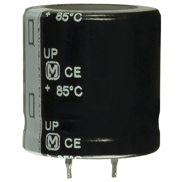

ECO-S2AP222DA 数据手册
Aluminum Electrolytic Capacitors TS-UP Series 85°C, 3000 hours Compact size for general purpose and industrial applications RoHS 2 and 3 pin versions available Compliant 20mm lengths for low profile applications Rated Working Voltage: Operating Temperature: Nominal Capacitance: Capacitance Tolerance: Dissipation Factor: (120 Hz, +20°C) 350 ~ 450 VDC -25 ~ +85°C 33 ~ 820µF 16 ~ 250 VDC -40 ~ +85°C 120 ~ 68000µF ± 20% 16 50 Working Voltage [V]: Max. D.F. (%): 25 40 35 35 50 30 63 25 100 20 160 ~ 450 15 (rated cap. [µF] - 33000 ) 1000 For capacitance values > 33000µF, add the value of: Leakage Current: Ripple Current Multipliers: 80 20 3√CV (µA) max. after 5 minutes; C = Capacitance in µF, V = WV Frequency(Hz): 16~100WV: 160~450WV: 50 0.93 0.75 Endurance: 60 0.95 0.8 100~120 1.0 1.0 500 1.05 1.2 1k 1.08 1.25 10k 1.15 1.4 Ripple Current Ambient Temperature Factors** Temperature (°C): 85°C 70°C 60°C Multiplier: 1.0 1.3 1.4 3000 hours* at +85°C with maximum specified ripple current (see page 4) *2000 hours for 20mm length sizes **Use of temperature ripple current multipliers may limit life to the hours specified for the maximum operating temperature. Part Number System E C E C RoHS compliant PVC sleeve and top plate is standard. PET sleeve is available without top plate. P Series Code Terminal Style Prefix Length # of Pins 2 ECEC 4.0mm 2 ECOS 6.3mm Capacitance Code A X L Suffix Standard Ratings Extended CV Ratings 20mm Length Ratings Diameter Diameter Code 22 B 25 C 30 D 35 E Voltage Code 1C 16 1E 25 1V 35 1H 50 1J 63 1K 2A 2C 2D 2E 2V 2T 2G 2S 2W 80 100 160 200 250 350 385 400 420 450 Dimensions in millimeters Circuit Board Mounting Holes 10.0±0.1 2 Pin Mounting Style D+1 max. T L+2 max. 2 x Ø2.0±0.1 Circuit Board Mounting Holes 10.0±0.1 Ø2.0±0.1 3 Pin Mounting Style (Optional) 4.75±0.1 3.3±0.1 T L+2 max. D+1 max. Pin Dimensions Ø2.0±0.1 Ø2.5 min. 2.0 max. 2.0 max. 0.8 +0.2 0.8 -0.1 3.5 Top of Capacitor Body 4.0±0.5 4.0 +0.2 -0.1 6.3±1.0 1.5±0.2 1.5±0.2 4mm Length: Standard on 2 Pin, Available on 3 Pin Mounting Styles 14 6.3mm Length: Available on 2 Pin Mounting Style Only ≤45°C 1.5 Aluminum Electrolytic Capacitors TS-UP Standard Ratings Cap. (µF) Size (mm) DxL Max 85°C R.C. (Arms) 120Hz 10kHz~ 4700 22 22 22 25 22 22 25 30 22 25 22 25 35 22 25 22 25 30 25 30 25 30 35 30 35 30 35 35 35 20 25 25 20 25 30 25 20 30 25 35 30 20 40 30 45 35 30 45 35 50 40 30 45 35 50 40 45 50 1.60 1.77 2.57 1.80 3.10 3.78 3.78 2.40 4.52 4.52 5.26 5.26 3.20 5.57 5.57 6.10 6.10 6.10 6.31 6.31 6.84 6.84 6.84 6.94 6.94 7.47 7.47 8.73 9.05 20 25 25 20 25 30 25 20 30 25 35 30 25 20 40 35 30 50 40 30 45 35 50 40 45 35 50 40 45 50 1.60 1.68 2.39 1.80 2.86 3.47 3.47 2.30 3.57 3.57 3.78 3.78 3.78 2.70 4.10 4.10 4.10 4.63 4.63 4.63 5.47 5.47 6.10 6.10 6.21 6.21 6.84 6.84 7.36 8.00 6800 8200 10000 12000 15000 18000 22000 27000 33000 39000 47000 56000 68000 3300 4700 5600 6800 8200 10000 12000 15000 18000 22000 27000 33000 39000 47000 22 22 22 25 22 22 25 30 22 25 22 25 30 35 22 25 30 22 25 30 25 30 25 30 30 35 30 35 35 35 x x x x x x x x x x x x x x x x x x x x x x x x x x x x x x x x x x x x x x x x x x x x x x x x x x x x x x x x x x x 20°C ESR (Ω, max.) 120Hz 20kHz 16 VDC Working, 20 VDC Surge 1.84 0.159 0.135 2.04 0.159 0.135 2.96 0.110 0.093 2.07 0.110 0.093 3.57 0.091 0.077 4.35 0.075 0.063 4.35 0.075 0.063 2.76 0.083 0.070 5.20 0.062 0.053 5.20 0.062 0.053 6.05 0.053 0.045 6.05 0.053 0.045 3.68 0.055 0.047 6.41 0.046 0.039 6.41 0.046 0.039 7.02 0.038 0.032 7.02 0.038 0.032 7.02 0.038 0.032 7.26 0.031 0.026 7.26 0.031 0.026 7.87 0.025 0.021 7.87 0.025 0.021 7.87 0.025 0.021 7.98 0.021 0.018 7.98 0.021 0.018 8.59 0.019 0.017 8.59 0.021 0.019 10.04 0.019 0.018 10.41 0.018 0.017 25 VDC Working, 32 VDC Surge 1.84 0.176 0.141 1.93 0.161 0.129 2.75 0.113 0.090 2.07 0.123 0.099 3.29 0.095 0.076 3.99 0.078 0.062 3.99 0.078 0.062 2.65 0.078 0.062 4.11 0.065 0.052 4.11 0.065 0.052 4.35 0.058 0.046 4.35 0.058 0.046 4.35 0.058 0.046 3.11 0.061 0.049 4.72 0.048 0.039 4.72 0.048 0.039 4.72 0.048 0.039 5.32 0.039 0.031 5.32 0.039 0.031 5.32 0.039 0.031 6.29 0.035 0.028 6.29 0.035 0.028 7.02 0.029 0.023 7.02 0.029 0.023 7.14 0.023 0.019 7.14 0.025 0.020 7.87 0.020 0.017 7.87 0.020 0.017 8.46 0.019 0.017 9.20 0.017 0.015 15 Part numbers shown with 2 pins Panasonic Part Number (By Terminal Length) 6.3mm Length Terminal 4.0mm Length Terminal ECOS1CP472BL ECOS1CP472BA ECOS1CP682BA ECOS1CP682CL ECOS1CP822BA ECOS1CP103BA ECOS1CP103CA ECOS1CP103DL ECOS1CP123BA ECOS1CP123CA ECOS1CP153BA ECOS1CP153CA ECOS1CP153EL ECOS1CP183BA ECOS1CP183CA ECOS1CP223BA ECOS1CP223CA ECOS1CP223DA ECOS1CP273CA ECOS1CP273DA ECOS1CP333CA ECOS1CP333DA ECOS1CP333EA ECOS1CP393DA ECOS1CP393EA ECOS1CP473DA ECOS1CP473EA ECOS1CP563EA ECOS1CP683EA ECEC1CP472BL ECEC1CP472BA ECEC1CP682BA ECEC1CP682CL ECEC1CP822BA ECEC1CP103BA ECEC1CP103CA ECEC1CP103DL ECEC1CP123BA ECEC1CP123CA ECEC1CP153BA ECEC1CP153CA ECEC1CP153EL ECEC1CP183BA ECEC1CP183CA ECEC1CP223BA ECEC1CP223CA ECEC1CP223DA ECEC1CP273CA ECEC1CP273DA ECEC1CP333CA ECEC1CP333DA ECEC1CP333EA ECEC1CP393DA ECEC1CP393EA ECEC1CP473DA ECEC1CP473EA ECEC1CP563EA ECEC1CP683EA ECOS1EP332BL ECOS1EP332BA ECOS1EP472BA ECOS1EP472CL ECOS1EP562BA ECOS1EP682BA ECOS1EP682CA ECOS1EP682DL ECOS1EP822BA ECOS1EP822CA ECOS1EP103BA ECOS1EP103CA ECOS1EP103DA ECOS1EP103EL ECOS1EP123BA ECOS1EP123CA ECOS1EP123DA ECOS1EP153BA ECOS1EP153CA ECOS1EP153DA ECOS1EP183CA ECOS1EP183DA ECOS1EP223CA ECOS1EP223DA ECOS1EP273DA ECOS1EP273EA ECOS1EP333DA ECOS1EP333EA ECOS1EP393EA ECOS1EP473EA ECEC1EP332BL ECEC1EP332BA ECEC1EP472BA ECEC1EP472CL ECEC1EP562BA ECEC1EP682BA ECEC1EP682CA ECEC1EP682DL ECEC1EP822BA ECEC1EP822CA ECEC1EP103BA ECEC1EP103CA ECEC1EP103DA ECEC1EP103EL ECEC1EP123BA ECEC1EP123CA ECEC1EP123DA ECEC1EP153BA ECEC1EP153CA ECEC1EP153DA ECEC1EP183CA ECEC1EP183DA ECEC1EP223CA ECEC1EP223DA ECEC1EP273DA ECEC1EP273EA ECEC1EP333DA ECEC1EP333EA ECEC1EP393EA ECEC1EP473EA Aluminum Electrolytic Capacitors TS-UP Standard Ratings (continued) Cap. (µF) Size (mm) DxL 2200 22 22 22 25 22 22 25 30 22 25 22 25 35 22 25 22 25 30 35 25 30 35 25 30 35 30 35 30 35 35 35 x x x x x x x x x x x x x x x x x x x x x x x x x x x x x x x 20 25 25 20 25 30 25 20 30 25 35 30 20 40 35 45 40 30 25 45 35 30 50 40 30 45 35 50 40 45 50 22 22 22 25 22 22 25 30 22 25 22 25 30 35 22 25 30 22 25 30 25 30 25 30 35 30 35 30 35 35 35 x x x x x x x x x x x x x x x x x x x x x x x x x x x x x x x 20 25 25 20 25 30 25 20 30 25 35 30 25 20 40 35 30 50 40 30 45 35 50 40 30 45 35 50 40 45 50 3300 3900 4700 5600 6800 8200 10000 12000 15000 18000 22000 27000 33000 1500 2200 2700 3300 3900 4700 5600 6800 8200 10000 12000 15000 18000 22000 Part numbers shown with 2 pins Max 85°C R.C. (Arms) 20°C ESR (Ω, max.) Panasonic Part Number (By Terminal Length) 6.3mm Length Terminal 4.0mm Length Terminal 120Hz 10kHz~ 120Hz 20kHz 35 VDC Working, 44 VDC Surge (continued) ECOS1VP222BL ECEC1VP222BL 1.40 1.61 0.181 0.136 ECOS1VP222BA ECEC1VP222BA 1.52 1.75 0.166 0.124 ECOS1VP332BA ECEC1VP332BA 2.29 2.63 0.111 0.083 ECOS1VP332CL ECEC1VP332CL 1.70 1.96 0.121 0.090 ECOS1VP392BA ECEC1VP392BA 2.71 3.12 0.094 0.070 ECOS1VP472BA ECEC1VP472BA 3.26 3.75 0.078 0.058 ECOS1VP472CA ECEC1VP472CA 3.26 3.75 0.078 0.058 ECOS1VP472DL ECEC1VP472DL 2.00 2.30 0.088 0.066 ECOS1VP562BA ECEC1VP562BA 3.36 3.86 0.080 0.060 ECOS1VP562CA ECEC1VP562CA 3.36 3.86 0.080 0.060 ECOS1VP682BA ECEC1VP682BA 3.68 4.23 0.066 0.049 ECOS1VP682CA ECEC1VP682CA 3.68 4.23 0.066 0.049 ECOS1VP682EL ECEC1VP682EL 2.40 2.76 0.071 0.053 ECEC1VP822BA ECOS1VP822BA 4.00 4.60 0.057 0.042 ECEC1VP822CA ECOS1VP822CA 4.00 4.60 0.057 0.042 ECEC1VP103BA ECOS1VP103BA 4.42 5.08 0.050 0.037 ECEC1VP103CA ECOS1VP103CA 4.42 5.08 0.050 0.037 ECEC1VP103DA ECOS1VP103DA 4.42 5.08 0.050 0.037 ECEC1VP103EA ECOS1VP103EA 4.42 5.08 0.050 0.037 ECEC1VP123CA ECOS1VP123CA 5.05 5.81 0.044 0.033 ECEC1VP123DA ECOS1VP123DA 5.05 5.81 0.044 0.033 ECEC1VP123EA ECOS1VP123EA 5.05 5.81 0.044 0.033 ECOS1VP153CA ECEC1VP153CA 5.57 6.41 0.036 0.027 ECOS1VP153DA ECEC1VP153DA 5.57 6.41 0.036 0.027 ECOS1VP153EA ECEC1VP153EA 5.57 6.41 0.036 0.027 ECEC1VP183DA ECOS1VP183DA 5.68 6.53 0.030 0.023 ECOS1VP183EA ECEC1VP183EA 5.68 6.53 0.030 0.023 ECOS1VP223DA ECEC1VP223DA 6.10 7.02 0.026 0.020 ECOS1VP223EA ECEC1VP223EA 6.10 7.02 0.026 0.020 ECOS1VP273EA ECEC1VP273EA 6.84 7.87 0.021 0.017 ECEC1VP333EA ECOS1VP333EA 7.15 8.22 0.018 0.014 50 VDC Working, 63 VDC Surge ECOS1HP152BL ECEC1HP152BL 1.20 1.38 0.254 0.191 ECOS1HP152BA ECEC1HP152BA 1.24 1.43 0.221 0.166 ECEC1HP222BA ECOS1HP222BA 1.82 2.09 0.151 0.113 ECOS1HP222CL ECEC1HP222CL 1.40 1.61 0.173 0.130 ECEC1HP272BA ECOS1HP272BA 2.23 2.56 0.123 0.092 ECOS1HP332BA ECEC1HP332BA 2.73 3.14 0.100 0.075 ECEC1HP332CA ECOS1HP332CA 2.73 3.14 0.100 0.075 ECEC1HP332DL ECOS1HP332DL 1.70 1.96 0.116 0.087 ECEC1HP392BA ECOS1HP392BA 2.75 3.16 0.085 0.064 ECOS1HP392CA ECEC1HP392CA 2.75 3.16 0.085 0.064 ECEC1HP472BA ECOS1HP472BA 3.03 3.48 0.071 0.053 ECOS1HP472CA ECEC1HP472CA 3.03 3.48 0.071 0.053 ECOS1HP472DA ECEC1HP472DA 3.03 3.48 0.071 0.053 ECOS1HP472EL ECEC1HP472EL 2.10 2.42 0.081 0.061 ECOS1HP562BA ECEC1HP562BA 3.42 3.93 0.059 0.044 ECOS1HP562CA ECEC1HP562CA 3.42 3.93 0.059 0.044 ECOS1HP562DA ECEC1HP562DA 3.42 3.93 0.059 0.044 ECEC1HP682BA ECOS1HP682BA 3.85 4.43 0.049 0.037 ECEC1HP682CA ECOS1HP682CA 3.85 4.43 0.049 0.037 ECEC1HP682DA ECOS1HP682DA 3.85 4.43 0.049 0.037 ECEC1HP822CA ECOS1HP822CA 4.41 5.07 0.040 0.030 ECEC1HP822DA ECOS1HP822DA 4.41 5.07 0.040 0.030 ECEC1HP103CA ECOS1HP103CA 4.97 5.72 0.036 0.027 ECEC1HP103DA ECOS1HP103DA 4.97 5.72 0.036 0.027 ECOS1HP103EA ECEC1HP103EA 4.97 5.72 0.036 0.027 ECEC1HP123DA ECOS1HP123DA 5.58 6.42 0.032 0.024 ECEC1HP123EA ECOS1HP123EA 5.58 6.42 0.032 0.024 ECEC1HP153DA ECOS1HP153DA 6.44 7.41 0.028 0.021 ECEC1HP153EA ECOS1HP153EA 6.44 7.41 0.028 0.021 ECEC1HP183EA ECOS1HP183EA 6.94 7.98 0.023 0.018 ECEC1HP223EA ECOS1HP223EA 7.57 8.71 0.021 0.017 16 Aluminum Electrolytic Capacitors TS-UP Standard Ratings (continued) Cap. (µF) Size (mm) DxL 1000 22 22 22 25 22 22 25 30 22 25 22 25 30 35 22 25 30 22 25 30 35 25 30 35 25 30 35 30 35 35 35 1500 1800 2200 2700 3300 3900 4700 5600 6800 8200 10000 12000 680 1000 1200 1500 1800 2200 2700 3300 3900 4700 5600 6800 8200 22 22 22 25 22 22 25 30 22 25 22 25 30 35 22 25 30 22 25 30 25 30 25 30 30 35 30 35 35 x x x x x x x x x x x x x x x x x x x x x x x x x x x x x x x x x x x x x x x x x x x x x x x x x x x x x x x x x x x x 20 25 25 20 25 30 25 20 35 30 40 30 25 20 45 35 30 50 40 30 25 45 35 30 50 40 30 45 35 40 50 20 25 25 20 25 30 25 20 35 30 40 30 25 20 45 35 30 50 40 30 45 35 50 40 45 35 50 40 50 Max 85°C R.C. (Arms) 20°C ESR (Ω, max.) 120Hz 10kHz~ 120Hz 20kHz 63 VDC Working, 79 VDC Surge 1.20 1.38 0.381 0.286 1.20 1.38 0.332 0.249 1.72 1.98 0.221 0.166 1.30 1.50 0.254 0.191 2.06 2.37 0.184 0.138 2.52 2.90 0.151 0.113 2.52 2.90 0.151 0.113 1.50 1.73 0.173 0.130 3.73 4.29 0.123 0.092 3.73 4.29 0.123 0.092 4.10 4.72 0.105 0.079 4.10 4.72 0.105 0.079 4.10 4.72 0.105 0.079 1.70 1.96 0.126 0.094 4.44 5.11 0.098 0.073 4.44 5.11 0.098 0.073 4.44 5.11 0.098 0.073 4.86 5.59 0.081 0.061 4.86 5.59 0.081 0.061 4.86 5.59 0.081 0.061 4.86 5.59 0.081 0.061 5.36 6.16 0.068 0.051 5.36 6.16 0.068 0.051 5.36 6.16 0.068 0.051 5.84 6.72 0.061 0.046 5.84 6.72 0.061 0.046 5.84 6.72 0.061 0.046 6.00 6.90 0.051 0.038 6.00 6.90 0.051 0.038 6.52 7.50 0.041 0.033 7.15 8.22 0.035 0.028 80 VDC Working, 100 VDC Surge 1.00 1.15 0.439 0.329 1.02 1.17 0.390 0.293 1.51 1.74 0.265 0.199 1.20 1.38 0.298 0.224 1.81 2.08 0.221 0.166 2.26 2.60 0.177 0.133 2.26 2.60 0.177 0.133 1.40 1.61 0.199 0.149 2.52 2.90 0.147 0.111 2.52 2.90 0.147 0.111 2.73 3.14 0.121 0.090 2.73 3.14 0.121 0.090 2.73 3.14 0.121 0.090 1.70 1.96 0.136 0.102 2.78 3.20 0.098 0.074 2.78 3.20 0.098 0.074 2.78 3.20 0.098 0.074 3.21 3.69 0.085 0.064 3.21 3.69 0.085 0.064 3.21 3.69 0.085 0.064 3.59 4.13 0.077 0.057 3.59 4.13 0.077 0.057 4.09 4.70 0.063 0.048 4.09 4.70 0.063 0.048 4.55 5.23 0.056 0.042 4.55 5.23 0.056 0.042 5.16 5.93 0.046 0.035 5.16 5.93 0.046 0.035 5.83 6.70 0.038 0.029 17 Part numbers shown with 2 pins Panasonic Part Number (By Terminal Length) 4.0mm Length Terminal 6.3mm Length Terminal ECOS1JP102BL ECOS1JP102BA ECOS1JP152BA ECOS1JP152CL ECOS1JP182BA ECOS1JP222BA ECOS1JP222CA ECOS1JP222DL ECOS1JP272BA ECOS1JP272CA ECOS1JP332BA ECOS1JP332CA ECOS1JP332DA ECOS1JP332EL ECOS1JP392BA ECOS1JP392CA ECOS1JP392DA ECOS1JP472BA ECOS1JP472CA ECOS1JP472DA ECOS1JP472EA ECOS1JP562CA ECOS1JP562DA ECOS1JP562EA ECOS1JP682CA ECOS1JP682DA ECOS1JP682EA ECOS1JP822DA ECOS1JP822EA ECOS1JP103EA ECOS1JP123EA ECEC1JP102BL ECEC1JP102BA ECEC1JP152BA ECEC1JP152CL ECEC1JP182BA ECEC1JP222BA ECEC1JP222CA ECEC1JP222DL ECEC1JP272BA ECEC1JP272CA ECEC1JP332BA ECEC1JP332CA ECEC1JP332DA ECEC1JP332EL ECEC1JP392BA ECEC1JP392CA ECEC1JP392DA ECEC1JP472BA ECEC1JP472CA ECEC1JP472DA ECEC1JP472EA ECEC1JP562CA ECEC1JP562DA ECEC1JP562EA ECEC1JP682CA ECEC1JP682DA ECEC1JP682EA ECEC1JP822DA ECEC1JP822EA ECEC1JP103EA ECEC1JP123EA ECOS1KP681BL ECOS1KP681BA ECOS1KP102BA ECOS1KP102CL ECOS1KP122BA ECOS1KP152BA ECOS1KP152CA ECOS1KP152DL ECOS1KP182BA ECOS1KP182CA ECOS1KP222BA ECOS1KP222CA ECOS1KP222DA ECOS1KP222EL ECOS1KP272BA ECOS1KP272CA ECOS1KP272DA ECOS1KP332BA ECOS1KP332CA ECOS1KP332DA ECOS1KP392CA ECOS1KP392DA ECOS1KP472CA ECOS1KP472DA ECOS1KP562DA ECOS1KP562EA ECOS1KP682DA ECOS1KP682EA ECOS1KP822EA ECEC1KP681BL ECEC1KP681BA ECEC1KP102BA ECEC1KP102CL ECEC1KP122BA ECEC1KP152BA ECEC1KP152CA ECEC1KP152DL ECEC1KP182BA ECEC1KP182CA ECEC1KP222BA ECEC1KP222CA ECEC1KP222DA ECEC1KP222EL ECEC1KP272BA ECEC1KP272CA ECEC1KP272DA ECEC1KP332BA ECEC1KP332CA ECEC1KP332DA ECEC1KP392CA ECEC1KP392DA ECEC1KP472CA ECEC1KP472DA ECEC1KP562DA ECEC1KP562EA ECEC1KP682DA ECEC1KP682EA ECEC1KP822EA Aluminum Electrolytic Capacitors TS-UP Standard Ratings (continued) Cap. (µF) Size (mm) DxL 470 22 22 22 22 25 22 25 30 22 25 22 25 30 35 22 25 30 22 25 30 35 25 30 35 25 30 30 35 30 35 35 35 x x x x x x x x x x x x x x x x x x x x x x x x x x x x x x x x 20 25 25 25 20 30 25 20 35 30 40 30 25 20 45 35 30 50 40 30 25 45 35 30 50 40 45 35 50 40 45 50 22 22 22 22 25 22 25 22 25 22 25 30 22 25 30 25 35 25 30 35 25 30 35 30 35 30 35 35 35 x x x x x x x x x x x x x x x x x x x x x x x x x x x x x 25 25 25 25 25 30 25 35 25 40 30 25 45 35 30 40 30 50 35 30 50 45 35 50 35 50 40 45 50 560 680 1000 1200 1500 1800 2200 2700 3300 3900 4700 5600 6800 220 270 330 390 470 560 680 820 1000 1200 1500 1800 2200 2700 Max 85°C R.C. (Arms) 20°C ESR (Ω, max.) 120Hz 10kHz~ 120Hz 20kHz 100 VDC Working, 125 VDC Surge 1.00 1.15 0.459 0.298 1.11 1.28 0.459 0.298 1.32 1.52 0.385 0.250 1.61 1.85 0.317 0.206 1.10 1.27 0.366 0.238 1.96 2.25 0.216 0.140 1.96 2.25 0.216 0.140 1.20 1.38 0.249 0.162 2.31 2.66 0.193 0.126 2.31 2.66 0.180 0.117 2.57 2.96 0.155 0.101 2.57 2.96 0.155 0.101 2.57 2.96 0.155 0.101 1.50 1.73 0.177 0.115 2.84 3.27 0.129 0.084 2.84 3.27 0.138 0.090 2.84 3.27 0.138 0.090 3.14 3.61 0.121 0.078 3.14 3.61 0.121 0.078 3.14 3.61 0.121 0.078 3.14 3.61 0.121 0.078 3.71 4.27 0.104 0.068 3.71 4.27 0.104 0.068 3.71 4.27 0.104 0.068 4.06 4.67 0.090 0.059 4.06 4.67 0.090 0.059 4.54 5.22 0.077 0.050 4.54 5.22 0.081 0.052 5.13 5.90 0.071 0.049 5.13 5.90 0.071 0.049 5.75 6.61 0.059 0.041 6.60 7.59 0.049 0.037 160 VDC Working, 200 VDC Surge 0.91 1.27 0.829 0.414 1.19 1.67 0.675 0.338 1.45 2.03 0.553 0.276 1.62 2.27 0.468 0.234 1.62 2.27 0.468 0.234 2.11 2.95 0.423 0.212 2.11 2.95 0.423 0.212 2.25 3.15 0.355 0.178 2.25 3.15 0.355 0.178 2.50 3.50 0.293 0.146 2.50 3.50 0.293 0.146 2.50 3.50 0.293 0.146 2.75 3.85 0.263 0.131 2.75 3.85 0.263 0.131 2.75 3.85 0.263 0.131 3.00 4.20 0.216 0.108 3.00 4.20 0.232 0.128 3.25 4.55 0.207 0.114 3.25 4.55 0.207 0.114 3.25 4.55 0.207 0.114 3.73 5.22 0.166 0.091 3.73 5.22 0.166 0.091 3.73 5.22 0.166 0.091 4.20 5.88 0.138 0.083 4.20 5.88 0.138 0.083 4.78 6.69 0.105 0.053 4.78 6.69 0.113 0.073 4.78 6.69 0.113 0.073 5.45 7.63 0.092 0.060 18 Part numbers shown with 2 pins Panasonic Part Number (By Terminal Length) 4.0mm Length Terminal 6.3mm Length Terminal ECOS2AP471BL ECOS2AP471BA ECOS2AP561BA ECOS2AP681BA ECOS2AP681CL ECOS2AP102BA ECOS2AP102CA ECOS2AP102DL ECOS2AP122BA ECOS2AP122CA ECOS2AP152BA ECOS2AP152CA ECOS2AP152DA ECOS2AP152EL ECOS2AP182BA ECOS2AP182CA ECOS2AP182DA ECOS2AP222BA ECOS2AP222CA ECOS2AP222DA ECOS2AP222EA ECOS2AP272CA ECOS2AP272DA ECOS2AP272EA ECOS2AP332CA ECOS2AP332DA ECOS2AP392DA ECOS2AP392EA ECOS2AP472DA ECOS2AP472EA ECOS2AP562EA ECOS2AP682EA ECEC2AP471BL ECEC2AP471BA ECEC2AP561BA ECEC2AP681BA ECEC2AP681CL ECEC2AP102BA ECEC2AP102CA ECEC2AP102DL ECEC2AP122BA ECEC2AP122CA ECEC2AP152BA ECEC2AP152CA ECEC2AP152DA ECEC2AP152EL ECEC2AP182BA ECEC2AP182CA ECEC2AP182DA ECEC2AP222BA ECEC2AP222CA ECEC2AP222DA ECEC2AP222EA ECEC2AP272CA ECEC2AP272DA ECEC2AP272EA ECEC2AP332CA ECEC2AP332DA ECEC2AP392DA ECEC2AP392EA ECEC2AP472DA ECEC2AP472EA ECEC2AP562EA ECEC2AP682EA ECOS2CP221BA ECOS2CP271BA ECOS2CP331BA ECOS2CP391BX ECOS2CP391CA ECOS2CP471BA ECOS2CP471CA ECOS2CP561BA ECOS2CP561CX ECOS2CP681BA ECOS2CP681CX ECOS2CP681DA ECOS2CP821BA ECOS2CP821CA ECOS2CP821DA ECOS2CP102CX ECOS2CP102EA ECOS2CP122CA ECOS2CP122DA ECOS2CP122EA ECOS2CP152CX ECOS2CP152DA ECOS2CP152EA ECOS2CP182DA ECOS2CP182EX ECOS2CP222DX ECOS2CP222EX ECOS2CP222EA ECOS2CP272EA ECEC2CP221BA ECEC2CP271BA ECEC2CP331BA ECEC2CP391BX ECEC2CP391CA ECEC2CP471BA ECEC2CP471CA ECEC2CP561BA ECEC2CP561CX ECEC2CP681BA ECEC2CP681CX ECEC2CP681DA ECEC2CP821BA ECEC2CP821CA ECEC2CP821DA ECEC2CP102CX ECEC2CP102EA ECEC2CP122CA ECEC2CP122DA ECEC2CP122EA ECEC2CP152CX ECEC2CP152DA ECEC2CP152EA ECEC2CP182DA ECEC2CP182EX ECEC2CP222DX ECEC2CP222EX ECEC2CP222EA ECEC2CP272EA Aluminum Electrolytic Capacitors TS-UP Standard Ratings (continued) Cap. (µF) Size (mm) DxL 150 22 22 22 25 22 22 30 22 25 22 25 35 22 25 30 22 25 30 25 30 30 35 25 25 30 30 35 30 30 35 35 30 30 35 35 30 35 35 35 35 220 270 330 390 470 560 680 820 1000 1200 1500 1800 2200 120 150 180 220 270 330 390 470 22 22 22 25 22 22 30 22 25 22 25 35 22 25 25 30 22 25 25 30 30 x x x x x x x x x x x x x x x x x x x x x x x x x x x x x x x x x x x x x x x x x x x x x x x x x x x x x x x x x x x x x 20 25 25 20 25 25 20 30 25 35 30 20 40 30 25 45 35 30 45 30 35 25 45 50 35 40 30 40 45 30 35 45 50 35 40 50 40 45 45 50 20 25 25 20 25 25 20 30 25 35 30 20 40 30 35 25 45 35 40 25 30 Max 85°C R.C. (Arms) 20°C ESR (Ω, max.) 120Hz 10kHz~ 120Hz 20kHz 200 VDC Working, 250 VDC Surge 0.65 0.91 1.326 0.597 0.71 0.99 1.216 0.547 1.04 1.46 0.829 0.373 0.87 1.22 0.904 0.407 1.41 1.97 0.614 0.276 1.56 2.18 0.553 0.249 1.00 1.40 0.603 0.271 1.68 2.35 0.468 0.210 1.68 2.35 0.468 0.210 1.85 2.59 0.388 0.175 1.85 2.59 0.388 0.175 1.30 1.82 0.459 0.206 2.43 3.40 0.326 0.147 2.43 3.40 0.326 0.147 2.43 3.40 0.326 0.147 2.68 3.75 0.268 0.121 2.68 3.75 0.268 0.121 2.68 3.75 0.268 0.121 2.93 4.10 0.222 0.100 2.93 4.10 0.222 0.100 2.93 4.10 0.222 0.100 2.93 4.10 0.222 0.100 3.25 4.55 0.199 0.090 3.25 4.55 0.199 0.090 3.25 4.55 0.199 0.090 3.25 4.55 0.199 0.090 3.25 4.55 0.199 0.090 3.50 4.90 0.166 0.075 3.50 4.90 0.166 0.075 3.50 4.90 0.166 0.075 3.50 4.90 0.166 0.075 3.87 5.42 0.144 0.072 3.87 5.42 0.144 0.072 3.87 5.42 0.144 0.072 3.87 5.42 0.144 0.072 4.32 6.05 0.120 0.060 4.32 6.05 0.120 0.060 4.32 6.05 0.120 0.060 4.92 6.89 0.098 0.054 4.92 6.89 0.098 0.054 250 VDC Working, 300 VDC Surge 0.45 0.63 1.658 0.663 0.71 0.99 1.520 0.608 0.89 1.25 1.216 0.486 0.65 0.91 1.326 0.531 1.07 1.50 0.921 0.368 1.17 1.64 0.754 0.301 0.87 1.22 0.829 0.332 1.31 1.83 0.614 0.246 1.31 1.83 0.614 0.246 1.75 2.45 0.553 0.221 1.75 2.45 0.502 0.201 1.10 1.54 0.553 0.221 1.91 2.67 0.468 0.187 1.91 2.67 0.468 0.187 1.91 2.67 0.468 0.187 1.91 2.67 0.425 0.170 2.11 2.95 0.388 0.155 2.11 2.95 0.388 0.155 2.11 2.95 0.388 0.155 2.11 2.95 0.353 0.141 2.11 2.95 0.388 0.155 19 Part numbers shown with 2 pins Panasonic Part Number (By Terminal Length) 4.0mm Length Terminal 6.3mm Length Terminal ECOS2DP151BL ECOS2DP151BA ECOS2DP221BA ECOS2DP221CL ECOS2DP271BA ECOS2DP331BX ECOS2DP331DL ECOS2DP391BA ECOS2DP391CA ECOS2DP471BA ECOS2DP471CA ECOS2DP471EL ECOS2DP561BA ECOS2DP561CX ECOS2DP561DA ECOS2DP681BA ECOS2DP681CA ECOS2DP681DA ECOS2DP821CA ECOS2DP821DX ECOS2DP821DA ECOS2DP821EA ECOS2DP102CX ECOS2DP102CA ECOS2DP102DX ECOS2DP102DA ECOS2DP102EA ECOS2DP122DX ECOS2DP122DA ECOS2DP122EX ECOS2DP122EA ECOS2DP152DX ECOS2DP152DA ECOS2DP152EX ECOS2DP152EA ECOS2DP182DX ECOS2DP182EX ECOS2DP182EA ECOS2DP222EX ECOS2DP222EA ECEC2DP151BL ECEC2DP151BA ECEC2DP221BA ECEC2DP221CL ECEC2DP271BA ECEC2DP331BX ECEC2DP331DL ECEC2DP391BA ECEC2DP391CA ECEC2DP471BA ECEC2DP471CA ECEC2DP471EL ECEC2DP561BA ECEC2DP561CX ECEC2DP561DA ECEC2DP681BA ECEC2DP681CA ECEC2DP681DA ECEC2DP821CA ECEC2DP821DX ECEC2DP821DA ECEC2DP821EA ECEC2DP102CX ECEC2DP102CA ECEC2DP102DX ECEC2DP102DA ECEC2DP102EA ECEC2DP122DX ECEC2DP122DA ECEC2DP122EX ECEC2DP122EA ECEC2DP152DX ECEC2DP152DA ECEC2DP152EX ECEC2DP152EA ECEC2DP182DX ECEC2DP182EX ECEC2DP182EA ECEC2DP222EX ECEC2DP222EA ECOS2EP121BL ECOS2EP121BA ECOS2EP151BA ECOS2EP151CL ECOS2EP181BA ECOS2EP221BX ECOS2EP221DL ECOS2EP271BA ECOS2EP271CA ECOS2EP331BA ECOS2EP331CA ECOS2EP331EL ECOS2EP391BA ECOS2EP391CX ECOS2EP391CA ECOS2EP391DA ECOS2EP471BA ECOS2EP471CX ECOS2EP471CA ECOS2EP471DX ECOS2EP471DA ECEC2EP121BL ECEC2EP121BA ECEC2EP151BA ECEC2EP151CL ECEC2EP181BA ECEC2EP221BX ECEC2EP221DL ECEC2EP271BA ECEC2EP271CA ECEC2EP331BA ECEC2EP331CA ECEC2EP331EL ECEC2EP391BA ECEC2EP391CX ECEC2EP391CA ECEC2EP391DA ECEC2EP471BA ECEC2EP471CX ECEC2EP471CA ECEC2EP471DX ECEC2EP471DA Aluminum Electrolytic Capacitors TS-UP Standard Ratings (continued) Cap. Size (mm) (µF) DxL 560 680 820 1000 1200 1500 82 100 120 150 180 220 270 330 390 470 560 680 820 25 25 30 30 35 25 25 30 30 35 30 30 35 35 30 30 35 35 35 35 35 22 22 22 25 22 25 25 30 22 25 25 30 22 25 30 30 35 25 30 30 35 35 25 30 30 35 25 30 30 35 35 30 35 35 30 35 35 35 35 35 x x x x x x x x x x x x x x x x x x x x x x x x x x x x x x x x x x x x x x x x x x x x x x x x x x x x x x x x x x x x x Part numbers shown with 2 pins Max 85°C R.C. (Arms) 120Hz 40 45 30 35 25 45 50 35 40 30 40 45 30 35 45 50 35 40 40 45 50 2.25 2.25 2.25 2.25 2.25 2.50 2.50 2.50 2.50 2.50 2.50 2.77 2.77 2.77 3.32 3.32 3.32 3.32 3.53 3.53 4.04 25 30 30 25 35 25 30 25 40 30 35 25 45 40 25 30 25 40 30 35 25 30 50 35 40 30 50 40 45 30 35 50 35 40 50 40 45 45 50 50 0.83 0.91 1.00 1.00 1.12 1.12 1.12 1.12 1.22 1.22 1.22 1.22 1.44 1.44 1.44 1.44 1.44 1.66 1.66 1.66 1.66 1.66 1.88 1.88 1.88 1.88 2.06 2.06 2.06 2.06 2.06 2.40 2.40 2.40 2.60 2.60 2.60 2.96 2.96 3.55 20°C ESR (Ω, max.) Panasonic Part Number (By Terminal Length) 4.0mm Length Terminal 6.3mm Length Terminal 10kHz~ 120Hz 20kHz 250 VDC Working, 300 VDC Surge (continued) ECOS2EP561CX ECEC2EP561CX 3.15 0.326 0.130 ECOS2EP561CA ECEC2EP561CA 3.15 0.326 0.130 ECOS2EP561DX ECEC2EP561DX 3.15 0.326 0.130 ECOS2EP561DA ECEC2EP561DA 3.15 0.326 0.130 ECOS2EP561EA ECEC2EP561EA 3.15 0.326 0.130 ECOS2EP681CX ECEC2EP681CX 3.50 0.268 0.107 ECOS2EP681CA ECEC2EP681CA 3.50 0.268 0.107 ECOS2EP681DX ECEC2EP681DX 3.50 0.268 0.107 ECOS2EP681DA ECEC2EP681DA 3.50 0.268 0.107 ECOS2EP681EA ECEC2EP681EA 3.50 0.268 0.107 ECOS2EP821DX ECEC2EP821DX 3.50 0.222 0.089 ECOS2EP821DA ECEC2EP821DA 3.88 0.222 0.089 ECOS2EP821EX ECEC2EP821EX 3.88 0.222 0.089 ECOS2EP821EA ECEC2EP821EA 3.88 0.243 0.109 ECEC2EP102DX ECOS2EP102DX 4.65 0.182 0.073 ECOS2EP102DA ECEC2EP102DA 4.65 0.199 0.090 ECOS2EP102EX ECEC2EP102EX 4.65 0.199 0.090 ECOS2EP102EA ECEC2EP102EA 4.65 0.199 0.099 ECOS2EP122EX ECEC2EP122EX 4.94 0.166 0.083 ECOS2EP122EA ECEC2EP122EA 4.94 0.166 0.083 ECOS2EP152EA ECEC2EP152EA 5.66 0.133 0.066 350 VDC Working, 400 VDC Surge ECOS2VP820BA ECEC2VP820BA 1.16 2.022 0.708 ECOS2VP101BA ECEC2VP101BA 1.27 1.658 0.580 ECOS2VP121BA ECEC2VP121BA 1.40 1.382 0.484 ECOS2VP121CA ECEC2VP121CA 1.40 1.382 0.484 ECOS2VP151BA ECEC2VP151BA 1.57 1.105 0.387 ECEC2VP151CX ECOS2VP151CX 1.57 1.105 0.387 ECEC2VP151CA ECOS2VP151CA 1.57 1.105 0.387 ECOS2VP151DA ECEC2VP151DA 1.57 1.105 0.387 ECOS2VP181BA ECEC2VP181BA 1.71 0.921 0.322 ECOS2VP181CX ECEC2VP181CX 1.71 0.921 0.322 ECOS2VP181CA ECEC2VP181CA 1.71 0.921 0.322 ECOS2VP181DA ECEC2VP181DA 1.71 0.921 0.322 ECOS2VP221BA ECEC2VP221BA 2.02 0.754 0.264 ECOS2VP221CA ECEC2VP221CA 2.02 0.754 0.264 ECOS2VP221DX ECEC2VP221DX 2.02 0.754 0.264 ECOS2VP221DA ECEC2VP221DA 2.02 0.754 0.264 ECOS2VP221EA ECEC2VP221EA 2.02 0.754 0.264 ECOS2VP271CX ECEC2VP271CX 2.32 0.614 0.215 ECOS2VP271DX ECEC2VP271DX 2.32 0.614 0.215 ECOS2VP271DA ECEC2VP271DA 2.32 0.614 0.215 ECOS2VP271EX ECEC2VP271EX 2.32 0.614 0.215 ECOS2VP271EA ECEC2VP271EA 2.32 0.614 0.215 ECOS2VP331CA ECEC2VP331CA 2.63 0.502 0.176 ECOS2VP331DX ECEC2VP331DX 2.63 0.502 0.176 ECEC2VP331DA ECOS2VP331DA 2.63 0.502 0.176 ECEC2VP331EA ECOS2VP331EA 2.63 0.502 0.176 ECOS2VP391CX ECEC2VP391CX 2.88 0.425 0.149 ECOS2VP391DX ECEC2VP391DX 2.88 0.425 0.149 ECOS2VP391DA ECEC2VP391DA 2.88 0.468 0.164 ECOS2VP391EX ECEC2VP391EX 2.88 0.425 0.149 ECOS2VP391EA ECEC2VP391EA 2.88 0.425 0.149 ECOS2VP471DA ECEC2VP471DA 3.36 0.388 0.136 ECOS2VP471EX ECEC2VP471EX 3.36 0.353 0.123 ECOS2VP471EA ECEC2VP471EA 3.36 0.353 0.123 ECOS2VP561DX ECEC2VP561DX 3.64 0.326 0.114 ECOS2VP561EX ECEC2VP561EX 3.64 0.296 0.104 ECOS2VP561EA ECEC2VP561EA 3.64 0.296 0.104 ECOS2VP681EX ECEC2VP681EX 4.14 0.293 0.117 ECOS2VP681EA ECEC2VP681EA 4.14 0.293 0.117 ECOS2VP821EX ECEC2VP821EX 4.97 0.243 0.097 20 Aluminum Electrolytic Capacitors TS-UP Standard Ratings (continued) Cap. (µF) 68 82 100 120 150 180 220 270 330 390 470 560 47 68 82 100 120 150 180 220 270 330 390 470 560 680 Size (mm) DxL 22 25 22 22 25 22 25 22 25 30 22 25 30 22 25 30 25 30 35 30 35 30 35 30 35 35 x x x x x x x x x x x x x x x x x x x x x x x x x x 25 20 25 30 25 35 30 40 30 25 45 35 30 50 40 30 45 35 30 40 35 45 40 50 45 50 22 22 22 25 22 22 25 30 22 25 22 25 30 35 22 25 25 22 25 30 25 30 35 30 35 35 30 35 35 35 35 35 35 35 x x x x x x x x x x x x x x x x x x x x x x x x x x x x x x x x x x 20 25 25 20 25 30 25 20 35 25 40 30 25 20 45 30 35 50 40 30 45 35 30 40 30 35 45 35 40 40 45 45 50 50 Max 85°C R.C. (Arms) 20°C ESR (Ω, max.) 120Hz 10kHz~ 120Hz 20kHz 385 VDC Working, 435 VDC Surge 0.76 1.06 2.438 0.853 0.35 0.49 2.926 1.024 0.83 1.16 2.022 0.708 0.92 1.29 1.658 0.580 0.92 1.29 1.658 0.580 1.02 1.43 1.382 0.553 1.02 1.43 1.382 0.553 1.16 1.62 1.105 0.442 1.16 1.62 1.105 0.442 1.16 1.62 1.105 0.442 1.44 2.02 0.921 0.368 1.44 2.02 0.921 0.368 1.44 2.02 0.921 0.368 1.49 2.09 0.829 0.373 1.49 2.09 0.829 0.373 1.49 2.09 0.829 0.373 1.67 2.34 0.675 0.304 1.67 2.34 0.675 0.304 1.67 2.34 0.675 0.304 1.90 2.66 0.553 0.249 1.90 2.66 0.553 0.249 2.13 2.98 0.468 0.210 2.13 2.98 0.468 0.210 2.39 3.35 0.388 0.175 2.39 3.35 0.388 0.175 2.69 3.77 0.326 0.147 400 VDC Working, 450 VDC Surge 0.25 0.35 3.527 1.235 0.47 0.66 3.527 1.235 0.69 0.97 2.438 0.853 0.35 0.49 2.926 1.024 0.83 1.16 2.022 0.708 0.92 1.29 1.658 0.580 0.92 1.29 1.658 0.580 0.47 0.66 1.989 0.696 1.02 1.43 1.382 0.484 1.02 1.43 1.382 0.484 1.16 1.62 1.105 0.387 1.16 1.62 1.105 0.387 1.16 1.62 1.105 0.387 0.60 0.84 1.326 0.464 1.44 2.02 0.921 0.322 1.44 2.02 0.921 0.322 1.44 2.02 0.921 0.322 1.49 2.09 0.754 0.264 1.49 2.09 0.754 0.264 1.49 2.09 0.754 0.264 1.67 2.34 0.675 0.236 1.67 2.34 0.675 0.236 1.67 2.34 0.675 0.236 1.90 2.66 0.553 0.193 1.90 2.66 0.553 0.193 1.90 2.66 0.553 0.193 2.13 2.98 0.468 0.164 2.13 2.98 0.468 0.164 2.13 2.98 0.468 0.164 2.39 3.35 0.388 0.136 2.39 3.35 0.388 0.136 2.69 3.77 0.326 0.114 2.69 3.77 0.326 0.114 3.00 4.20 0.268 0.094 21 Part numbers shown with 2 pins Panasonic Part Number (By Terminal Length) 4.0mm Length Terminal 6.3mm Length Terminal ECOS2TP680BA ECOS2TP680CL ECOS2TP820BA ECOS2TP101BA ECOS2TP101CA ECOS2TP121BA ECOS2TP121CA ECOS2TP151BA ECOS2TP151CA ECOS2TP151DA ECOS2TP181BA ECOS2TP181CA ECOS2TP181DA ECOS2TP221BA ECOS2TP221CA ECOS2TP221DA ECOS2TP271CA ECOS2TP271DA ECOS2TP271EA ECOS2TP331DA ECOS2TP331EA ECOS2TP391DA ECOS2TP391EA ECOS2TP471DA ECOS2TP471EA ECOS2TP561EA ECEC2TP680BA ECEC2TP680CL ECEC2TP820BA ECEC2TP101BA ECEC2TP101CA ECEC2TP121BA ECEC2TP121CA ECEC2TP151BA ECEC2TP151CA ECEC2TP151DA ECEC2TP181BA ECEC2TP181CA ECEC2TP181DA ECEC2TP221BA ECEC2TP221CA ECEC2TP221DA ECEC2TP271CA ECEC2TP271DA ECEC2TP271EA ECEC2TP331DA ECEC2TP331EA ECEC2TP391DA ECEC2TP391EA ECEC2TP471DA ECEC2TP471EA ECEC2TP561EA ECOS2GP470BL ECOS2GP470BA ECOS2GP680BA ECOS2GP680CL ECOS2GP820BA ECOS2GP101BA ECOS2GP101CA ECOS2GP101DL ECOS2GP121BA ECOS2GP121CX ECOS2GP151BA ECOS2GP151CA ECOS2GP151DA ECOS2GP151EL ECOS2GP181BA ECOS2GP181CX ECOS2GP181CA ECOS2GP221BA ECOS2GP221CA ECOS2GP221DA ECOS2GP271CA ECOS2GP271DA ECOS2GP271EA ECOS2GP331DA ECOS2GP331EX ECOS2GP331EA ECOS2GP391DA ECOS2GP391EX ECOS2GP391EA ECOS2GP471EX ECOS2GP471EA ECOS2GP561EX ECOS2GP561EA ECOS2GP681EX ECEC2GP470BL ECEC2GP470BA ECEC2GP680BA ECEC2GP680CL ECEC2GP820BA ECEC2GP101BA ECEC2GP101CA ECEC2GP101DL ECEC2GP121BA ECEC2GP121CX ECEC2GP151BA ECEC2GP151CA ECEC2GP151DA ECEC2GP151EL ECEC2GP181BA ECEC2GP181CX ECEC2GP181CA ECEC2GP221BA ECEC2GP221CA ECEC2GP221DA ECEC2GP271CA ECEC2GP271DA ECEC2GP271EA ECEC2GP331DA ECEC2GP331EX ECEC2GP331EA ECEC2GP391DA ECEC2GP391EX ECEC2GP391EA ECEC2GP471EX ECEC2GP471EA ECEC2GP561EX ECEC2GP561EA ECEC2GP681EX Aluminum Electrolytic Capacitors TS-UP Standard Ratings (continued) Cap. (µF) Size (mm) DxL 82 100 22 22 25 22 25 22 25 30 22 25 30 25 30 35 25 30 35 30 35 30 35 35 35 x x x x x x x x x x x x x x x x x x x x x x x 30 30 25 35 30 40 30 25 45 35 30 45 30 25 50 35 30 45 35 50 40 45 50 22 22 22 25 22 30 22 25 22 35 22 25 30 22 25 30 25 25 30 30 35 25 25 30 30 35 30 35 35 30 35 35 35 35 35 x x x x x x x x x x x x x x x x x x x x x x x x x x x x x x x x x x x 20 25 25 20 25 20 30 25 35 20 40 30 25 50 40 30 40 45 30 35 25 45 50 35 40 30 45 30 35 50 35 40 45 45 50 120 150 180 220 270 330 390 470 560 33 47 56 68 82 100 120 150 180 220 270 270 330 390 470 Max 85°C R.C. (Arms) 20°C ESR (Ω, max.) 120Hz 10kHz~ 120Hz 20kHz 420 VDC Working, 470 VDC Surge 0.83 1.16 2.426 0.849 0.92 1.29 1.989 0.696 0.92 1.29 1.989 0.696 1.02 1.43 1.658 0.580 1.02 1.43 1.658 0.580 1.16 1.62 1.326 0.464 1.16 1.62 1.326 0.464 1.16 1.62 1.326 0.464 1.44 2.02 1.105 0.387 1.44 2.02 1.105 0.387 1.44 2.02 1.105 0.387 1.49 2.09 0.904 0.316 1.49 2.09 0.904 0.316 1.49 2.09 0.904 0.316 1.67 2.34 0.737 0.258 1.67 2.34 0.737 0.258 1.67 2.34 0.737 0.258 1.90 2.66 0.603 0.211 1.90 2.66 0.603 0.211 2.13 2.98 0.510 0.179 2.13 2.98 0.510 0.179 2.39 3.35 0.423 0.148 2.69 3.77 0.355 0.124 450 VDC Working, 500 VDC Surge 0.20 0.28 6.028 2.411 0.41 0.57 6.028 2.411 0.59 0.83 4.233 1.693 0.29 0.41 4.233 1.693 0.70 0.98 2.960 1.184 0.38 0.53 2.926 1.170 0.83 1.16 2.022 0.809 0.83 1.16 2.022 0.809 0.93 1.30 1.658 0.663 0.52 0.73 1.989 0.796 1.04 1.46 1.382 0.553 1.04 1.46 1.382 0.553 1.04 1.46 1.382 0.553 1.19 1.67 1.105 0.442 1.19 1.67 1.105 0.442 1.19 1.67 1.105 0.442 1.35 1.89 0.921 0.368 1.35 1.89 0.921 0.368 1.35 1.89 0.921 0.368 1.35 1.89 0.921 0.368 1.35 1.89 0.921 0.368 1.55 2.17 0.754 0.301 1.55 2.17 0.754 0.301 1.55 2.17 0.754 0.301 1.55 2.17 0.754 0.301 1.55 2.17 0.754 0.301 1.78 2.49 0.675 0.270 1.78 2.49 0.614 0.246 1.78 2.49 0.675 0.270 2.01 2.81 0.553 0.249 2.01 2.81 0.553 0.221 2.01 2.81 0.553 0.249 2.24 3.14 0.510 0.255 2.53 3.54 0.423 0.233 2.53 3.54 0.423 0.233 22 Part numbers shown with 2 pins Panasonic Part Number (By Terminal Length) 4.0mm Length Terminal 6.3mm Length Terminal ECOS2SP820BA ECOS2SP101BA ECOS2SP101CA ECOS2SP121BA ECOS2SP121CA ECOS2SP151BA ECOS2SP151CA ECOS2SP151DA ECOS2SP181BA ECOS2SP181CA ECOS2SP181DA ECOS2SP221CA ECOS2SP221DA ECOS2SP221EA ECOS2SP271CA ECOS2SP271DA ECOS2SP271EA ECOS2SP331DA ECOS2SP331EA ECOS2SP391DA ECOS2SP391EA ECOS2SP471EA ECOS2SP561EA ECEC2SP820BA ECEC2SP101BA ECEC2SP101CA ECEC2SP121BA ECEC2SP121CA ECEC2SP151BA ECEC2SP151CA ECEC2SP151DA ECEC2SP181BA ECEC2SP181CA ECEC2SP181DA ECEC2SP221CA ECEC2SP221DA ECEC2SP221EA ECEC2SP271CA ECEC2SP271DA ECEC2SP271EA ECEC2SP331DA ECEC2SP331EA ECEC2SP391DA ECEC2SP391EA ECEC2SP471EA ECEC2SP561EA ECOS2WP330BL ECOS2WP330BA ECOS2WP470BA ECOS2WP470CL ECOS2WP560BA ECOS2WP680DL ECOS2WP820BA ECOS2WP820CA ECOS2WP101BA ECOS2WP101EL ECOS2WP121BA ECOS2WP121CA ECOS2WP121DA ECOS2WP151BA ECOS2WP151CA ECOS2WP151DA ECOS2WP181CX ECOS2WP181CA ECOS2WP181DX ECOS2WP181DA ECOS2WP181EA ECOS2WP221CX ECOS2WP221CA ECOS2WP221DX ECOS2WP221DA ECOS2WP221EA ECOS2WP271DA ECOS2WP271EX ECOS2WP271EA ECOS2WP331DA ECOS2WP331EX ECOS2WP331EA ECOS2WP391EA ECOS2WP471EX ECOS2WP471EA ECEC2WP330BL ECEC2WP330BA ECEC2WP470BA ECEC2WP470CL ECEC2WP560BA ECEC2WP680DL ECEC2WP820BA ECEC2WP820CA ECEC2WP101BA ECEC2WP101EL ECEC2WP121BA ECEC2WP121CA ECEC2WP121DA ECEC2WP151BA ECEC2WP151CA ECEC2WP151DA ECEC2WP181CX ECEC2WP181CA ECEC2WP181DX ECEC2WP181DA ECEC2WP181EA ECEC2WP221CX ECEC2WP221CA ECEC2WP221DX ECEC2WP221DA ECEC2WP221EA ECEC2WP271DA ECEC2WP271EX ECEC2WP271EA ECEC2WP331DA ECEC2WP331EX ECEC2WP331EA ECEC2WP391EA ECEC2WP471EX ECEC2WP471EA
ECO-S2AP222DA
物料型号:Panasonic TS-UP系列
器件简介:这是一系列铝电解电容器,设计用于一般用途和工业应用,具有85°C的工作温度和3000小时的寿命。这些电容器有2针和3针版本,提供20mm长度以适应低剖面应用,并且符合RoHS标准。
引脚分配:电容器有2针和3针两种安装方式,其中3针版本为可选配置。具体的引脚分配和尺寸在文档中有详细说明。
参数特性: - 额定工作电压:16VDC至450VDC - 工作温度范围:-40°C至+85°C - 标称电容值:从120μF至68000μF - 电容公差:±20% - 损耗因子(在120Hz,+20°C):最大值为50% - 漏电流:根据电容值和工作电压,按照公式3CV(A)最大值,5分钟后计算
功能详解:电容器设计用于在规定的工作条件下提供稳定的电能存储和滤波功能。
应用信息:适用于一般用途和工业应用,特别是需要在高温环境下稳定工作的场合。
封装信息:提供RoHS合规的PVC套管和顶板作为标准配置,也提供不带顶板的PET套管。电容器的直径和长度有多种规格,以适应不同的电路板安装需求。
