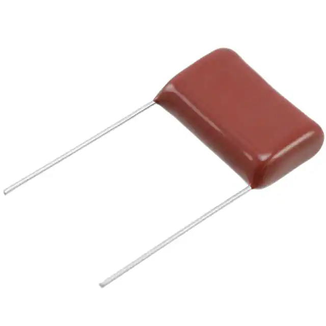

    薄膜电容 径向 1µF ±5% 26.00 x 8.50mm
ECQ-E4105JFW 数据手册
Plastic Film Capacitors Metallized Polyester Film Capacitor Type: ECQE(F) Non-inductive construction using metallized Polyester film with flame retardant epoxy resin coating ■Features • Self-healing property • Excellent electrical characteristics • Flame retardant epoxy resin coating • RoHS directive compliant ■Recommended Applications • General purpose usage ❈Please contact us when applications are CD , ignitor etc. ■Explanation of Part Numbers 1 2 3 4 E C Q E Product code 5 6 7 8 9 10 Dielectric & construction Rated volt. 100 VDC 250 VDC 400 VDC 630 VDC 10 12 1A 2A Capacitance 1000 VDC 1250 VDC 125 VAC 250 VAC Cap. Tol. Suffix J K ±5 % ±10 % ● Explanation of Part Number for Odd Size Taping C Product code Q E Dielectric & construction 12 F 1 2 4 6 E 11 Suffix Blank B W 3 6 9 Suffix Lead Form Straight Crimped lead Crimped taping (Ammo) Crimped taping (Ammo) Crimped taping (Reel) R Rated volt. Capacitance F Suffix Cap. Tol. Suffix ■Specifications Category temp. range (Including temperature-rise on unit surface) Rated voltage Capacitance range Capacitance tolerance Dissipation factor (tan ) Withstand voltage Insulation resistance (IR) 100 VDC, 250 VDC,400 VDC, 630 VDC, 1000 VDC, 1250 VDC, – 40 ˚C to + 105 ˚C 125 VAC, 250 VAC – 40 ˚C to + 85 ˚C 100 VDC, 250 VDC, 400 VDC, 630 VDC, 1000 VDC, 1250 VDC, (Derating of rated voltage by 1.25 %/˚C at more than 85 ˚C) 125 VAC, 250 VAC 0.0010 µF to 10 µF (E12) ±5 %(J), ±10 %(K) tan < =1.0 % (20 ˚C, 1 kHz) • Rated volt. 100 V to 630 VDC Between terminals : Rated volt.(VDC)✕150 % 60 s • Rated volt. 1000 VDC, 1250 VDC Between terminals : Rated volt. (VDC)✕175 % 2 s to 5 s or 1000 VAC 60 s Between terminals to enclosure : 1500 VAC 60 s • Rated volt. 125 VAC, 250 VAC Between terminals : Rated volt.(VAC)✕230 % 60 s Between terminals to enclosure : 1500 VAC 60 s >9000 MΩ (20 ˚C, 100 VDC, 60 s) 100 V to 630 VDC: C< = 0.33 µF : IR= >3000 MΩ . µF C > 0.33 µF : IR= > 1000 VDC, 1250 VDC: IR=10000 MΩ (20 ˚C, 100 VDC, 60 s) >2000 MΩ (20 ˚C, 500 VDC, 60 s) IR= >2000 MΩ 125 VAC, 250 VAC: C< (20 ˚C, 500 VDC, 60 s) = 0.47 µF : IR= >3000 MΩ . µF (20 ˚C, 100 VDC, 60 s) C > 0.47 µF : IR= ❈ In case of applying voltage in alternating current (50 Hz or 60 Hz sine wave) to a capacitor with DC rated voltage, please refer to the page of “Permissible voltage (R.M.S) in alternating current corresponding to DC rated voltage”. ❈ Voltage to be applied to ECQE1A (F) & ECQE2A (F) is only sine wave (50 Hz or 60 Hz). Design, Specifications are subject to change without notice. Ask factory for technical specifications before purchase and/or use. Whenever a doubt about safety arises from this product, please inform us immediately for technical consultation without fail. Plastic Film Capacitors ■Dimensions in mm (not to scale) ■Packaging Specifications for Bulk Package Packing quantity:100 pcs./bag ■Taping Specifications for Automatic Insertion ●Taping style ❈Refer to the page of taping specifications. ●Packaging Specifications Type Rated volt. 100 VDC 250 VDC 400 VDC ECQE (F) 630 VDC 1000 VDC 1250 VDC 125 VAC 250 VAC Cap. range (µF) 0.56 to 0.68 0.56 to 0.68 0.82 to 1.0 1.2 to 3.3 1.2 to 3.3 0.010 to 0.27 0.33 0.39 to 1.5 0.010 to 0.33 0.39 to 1.5 0.010 to 0.10 0.12 to 0.47 0.010 to 0.10 0.010 to 0.10 0.12 to 0.47 0.0010 to 0.033 0.039 to 0.047 0.056 to 0.22 0.010 to 0.047 0.0010 to 0.047 0.056 to 0.22 0.0010 to 0.10 0.0010 to 0.022 0.010 to 0.15 0.18 to 0.47 0.010 to 0.22 0.27 to 0.47 0.010 to 0.033 0.010 to 0.047 0.056 to 0.22 ●Lead Spacing Taping style AD AS AB ○ ○ B C Packing D suffix E ○ ○ ○ ○ ○ ○ ○ ○ ○ ○ ○ ○ ○ ○ ○ ○ ○ ○ ○ ○ ○ ○ ○ ○ ○ ○ ○ ○ Ammo Reel Ammo Ammo Ammo Ammo Ammo Ammo Ammo Ammo Ammo Ammo Reel Ammo Ammo Ammo Ammo Ammo Reel Ammo Ammo Ammo Ammo Ammo Ammo Ammo Ammo Ammo Ammo Ammo ( ( ( ( R( ( ( ( R( R( ( ( ( R( R( ( ( ( ( R( R( R( R( ( ( R( R( ( R( R( ) F3 ) F9 ) F3 ) F3 )F ) F3 ) F3 ) F3 )F )F ) F3 ) F3 ) F9 )F )F ) F3 ) F3 ) F3 ) F9 )F )F )F )F ) F6 ) F3 )F )F ) F6 )F )F Design, Specifications are subject to change without notice. Ask factory for technical specifications before purchase and/or use. Whenever a doubt about safety arises from this product, please inform us immediately for technical consultation without fail. Style AD AB B C D E Lead Spacing 5.0 mm 5.0 mm 5.0 mm 5.0 mm 7.5 mm 7.5 mm ❈See the column “Rating, Dimensions & Quantity Box” for packing quantity. Plastic Film Capacitors ■Rating, Dimensions & Quantity/Ammo Box ●Rated voltage : 100 VDC, Capacitance tolerance : ± 5 %(J), ±10 %(K) Cap. (µF) Part No ECQE1564MF( ECQE1684MF( ECQE1824MF( ECQE1105MF( ECQE1125MF( ECQE1155MF( ECQE1185MF( ECQE1225MF( ECQE1275MF( ECQE1335MF( ECQE1395MF( ECQE1475MF( ECQE1565MF( ECQE1685MF( ECQE1825MF( ECQE1106MF( ▲ ▲ ) ) ) ) ) ) ) ) ) ) ) ) ) ) ) ) 0.56 0.68 0.82 1.0 1.2 1.5 1.8 2.2 2.7 3.3 3.9 4.7 5.6 6.8 8.2 10.0 Quantity Dimensions (mm) L max. 12.0 12.0 12.0 12.0 18.5 18.5 18.5 18.5 18.5 18.5 26.0 26.0 26.0 26.0 26.0 26.0 T max. 5.5 6.0 6.0 6.7 5.5 6.0 6.5 7.0 8.0 8.5 7.0 7.5 8.3 9.0 10.0 11.5 H max. F S G max. Straight Crimped lead Straight Crimped lead Straight 10.9 15.9 10.0 10.0 1.0 11.9 16.9 10.0 10.0 1.0 13.5 18.5 10.0 10.0 1.0 14.0 19.0 10.0 10.0 1.0 12.8 17.8 15.0 10.0 1.0 13.4 18.4 15.0 10.0 1.0 14.4 19.4 15.0 10.0 1.0 15.0 20.0 15.0 10.0 1.0 15.8 20.8 15.0 10.0 1.0 16.5 21.5 15.0 10.0 1.0 16.4 21.4 22.5 15.0 1.0 17.0 22.0 22.5 15.0 1.0 17.5 22.5 22.5 15.0 1.0 18.5 23.5 22.5 15.0 1.0 20.0 25.0 22.5 15.0 1.5 21.0 26.0 22.5 15.0 1.5 ød 0.60 0.60 0.60 0.60 0.60 0.80 0.80 0.80 0.80 0.80 0.80 0.80 0.80 0.80 0.80 0.80 Ammo Ammo Ammo 5 mm 5 mm 7.5 mm 500 — — 1000 600 500 — 400 — 500 400 — Style N, style D: 0.056 µF to 1.0 µF Style T, style B: 1.2 µF to 10.0 µF Suffix for lead crimped or taped type Cap. tol. code ■Rating, Dimensions & Quantity/Ammo Box ● Rated voltage : 250 VDC, Capacitance tolerance : ±5 %(J), ±10 %(K) Cap. (µF) Part No ECQE2103MF( ECQE2123MF( ECQE2153MF( ECQE2183MF( ECQE2223MF( ECQE2273MF( ECQE2333MF( ECQE2393MF( ECQE2473MF( ECQE2563MF( ECQE2683MF( ECQE2823MF( ECQE2104MF( ECQE2124MF( ECQE2154MF( ECQE2184MF( ECQE2224MF( ECQE2274MF( ECQE2334MF( ECQE2394MF( ECQE2474MF( ECQE2564MF( ECQE2684MF( ECQE2824MF( ECQE2105MF( ECQE2125MF( ECQE2155MF( ECQE2185MF( ECQE2225MF( ECQE2275MF( ECQE2335MF( ECQE2395MF( ECQE2475MF( ECQE2565MF( ECQE2685MF( ECQE2825MF( ECQE2106MF( ▲ ) ) ) ) ) ) ) ) ) ) ) ) ) ) ) ) ) ) ) ) ) ) ) ) ) ) ) ) ) ) ) ) ) ) ) ) ) 0.010 0.012 0.015 0.018 0.022 0.027 0.033 0.039 0.047 0.056 0.068 0.082 0.10 0.12 0.15 0.18 0.22 0.27 0.33 0.39 0.47 0.56 0.68 0.82 1.0 1.2 1.5 1.8 2.2 2.7 3.3 3.9 4.7 5.6 6.8 8.2 10.0 Quantity Dimensions (mm) L max. 10.3 10.3 10.3 10.3 10.3 10.3 10.3 10.3 10.3 10.3 10.3 10.3 10.3 10.3 10.3 12.0 12.0 12.0 12.0 18.5 18.5 18.5 18.5 18.5 18.5 18.5 18.5 26.0 26.0 26.0 26.0 26.0 26.0 31.0 31.0 31.0 31.0 T max. 4.3 4.4 4.4 4.4 4.4 4.4 4.5 4.5 4.5 4.8 4.5 4.9 5.8 6.0 6.0 5.0 5.5 6.0 6.5 4.9 5.3 5.5 6.0 6.5 7.4 8.0 9.0 7.5 8.5 9.4 10.3 11.0 12.0 11.8 13.0 14.3 15.9 H max. F S G max. Straight Crimped lead Straight Crimped lead Straight 7.4 7.5 7.5 7.5 7.5 7.5 7.5 7.5 7.5 7.9 7.5 8.0 8.4 9.0 10.8 10.3 10.5 11.5 12.0 12.0 12.5 13.0 13.5 14.5 15.0 15.9 16.8 15.5 16.3 17.0 18.0 20.5 21.5 21.0 22.4 23.5 25.8 ▲ Suffix for lead crimped or taped type Cap. tol. code 12.4 12.5 12.5 12.5 12.5 12.5 12.5 12.5 12.5 12.9 12.5 13.0 13.4 14.0 15.8 15.3 15.5 16.5 17.0 17.0 17.5 18.0 18.5 19.5 20.0 20.9 21.8 20.5 21.3 22.0 23.0 25.5 26.5 26.0 27.4 28.5 30.8 7.5 7.5 7.5 7.5 7.5 7.5 7.5 7.5 7.5 7.5 7.5 7.5 7.5 7.5 7.5 10.0 10.0 10.0 10.0 15.0 15.0 15.0 15.0 15.0 15.0 15.0 15.0 22.5 22.5 22.5 22.5 22.5 22.5 27.5 27.5 27.5 27.5 7.5 7.5 7.5 7.5 7.5 7.5 7.5 7.5 7.5 7.5 7.5 7.5 7.5 7.5 7.5 10.0 10.0 10.0 10.0 10.0 10.0 10.0 10.0 10.0 10.0 10.0 10.0 15.0 15.0 15.0 15.0 15.0 15.0 22.5 22.5 22.5 22.5 1.0 1.0 1.0 1.0 1.0 1.0 1.0 1.0 1.0 1.0 1.0 1.0 1.0 1.0 1.0 1.0 1.0 1.0 1.0 1.0 1.0 1.0 1.0 1.0 1.0 1.0 1.0 1.0 1.0 1.0 1.5 1.5 1.5 1.5 1.5 1.5 1.5 ød 0.60 0.60 0.60 0.60 0.60 0.60 0.60 0.60 0.60 0.60 0.60 0.60 0.60 0.60 0.60 0.60 0.60 0.60 0.60 0.60 0.60 0.60 0.80 0.80 0.80 0.80 0.80 0.80 0.80 0.80 0.80 0.80 0.80 0.80 0.80 0.80 0.80 Ammo Ammo Ammo 5 mm 5 mm 7.5 mm 1000 — 500 1000 500 500 400 400 300 — — — Style N, Style D: 0.010 µF to 0.33 µF Style T, Style B: 0.39 µF to 10.0 µF Design, Specifications are subject to change without notice. Ask factory for technical specifications before purchase and/or use. Whenever a doubt about safety arises from this product, please inform us immediately for technical consultation without fail. 1000 Plastic Film Capacitors ■Rating, Dimensions & Quantity/Ammo Box ●Rated voltage : 400 VDC, Capacitance tolerance : ±5 %(J), ±10 %(K) Part No. Cap. (µF) L max. T max. Dimensions (mm) F H max. Quantity. S G max. Straight Crimped lead Straight Crimped lead Straight φd ECQE4103□F( ) 0.010 10.3 4.3 7.4 12.4 7.5 7.5 1.0 0.60 ECQE4123□F( ) 0.012 10.3 4.4 7.5 12.5 7.5 7.5 1.0 0.60 ECQE4153□F( ) 0.015 10.3 4.4 7.5 12.5 7.5 7.5 1.0 0.60 ECQE4183□F( ) 0.018 10.3 4.4 7.5 12.5 7.5 7.5 1.0 0.60 ECQE4223□F( ) 0.022 10.3 4.8 7.9 12.9 7.5 7.5 1.0 0.60 ECQE4273□F( ) 0.027 10.3 5.5 8.0 13.0 7.5 7.5 1.0 0.60 ECQE4333□F( ) 0.033 10.3 6.0 9.0 14.0 7.5 7.5 1.0 0.60 ECQE4393□F( ) 0.039 12.0 4.9 8.0 13.0 10.0 10.0 1.0 0.60 ECQE4473□F( ) 0.047 12.0 5.0 8.3 13.3 10.0 10.0 1.0 0.60 ECQE4563□F( ) 0.056 12.0 5.0 10.0 15.0 10.0 10.0 1.0 0.60 ECQE4683□F( ) 0.068 12.0 5.4 10.5 15.5 10.0 10.0 1.0 0.60 ECQE4823□F( ) 0.082 12.0 5.8 11.0 16.0 10.0 10.0 1.0 0.60 ECQE4104□F( ) 0.10 12.0 6.3 12.0 17.0 10.0 10.0 1.0 0.60 ECQE4124□F( ) 0.12 18.5 5.0 10.0 15.0 15.0 10.0 1.0 0.60 ECQE4154□F( ) 0.15 18.5 5.0 12.4 17.4 15.0 10.0 1.0 0.60 ECQE4184□F( ) 0.18 18.5 5.4 12.5 17.5 15.0 10.0 1.0 0.60 ECQE4224□F( ) 0.22 18.5 5.9 13.0 18.0 15.0 10.0 1.0 0.60 ECQE4274□F( ) 0.27 18.5 6.5 14.3 19.3 15.0 10.0 1.0 0.80 ECQE4334□F( ) 0.33 18.5 7.0 14.9 19.9 15.0 10.0 1.0 0.80 ECQE4394□F( ) 0.39 18.5 7.5 15.4 20.4 15.0 10.0 1.0 0.80 ECQE4474□F( ) 0.47 18.5 7.8 17.0 22.0 15.0 10.0 1.0 0.80 ECQE4564□F( ) 0.56 26.0 6.5 16.0 21.0 22.5 15.0 1.0 0.80 ECQE4684□F( ) 0.68 26.0 7.0 16.5 21.5 22.5 15.0 1.0 0.80 ECQE4824□F( ) 0.82 26.0 7.9 17.3 22.3 22.5 15.0 1.0 0.80 ECQE4105□F( ) 1.0 26.0 8.5 18.0 23.0 22.5 15.0 1.0 0.80 ECQE4125□F( ) 1.2 26.0 9.5 18.9 23.9 22.5 15.0 1.0 0.80 ECQE4155□F( ) 1.5 31.0 9.5 19.0 24.0 27.5 22.5 1.0 0.80 ECQE4185□F( ) 1.8 31.0 11.0 20.5 25.5 27.5 22.5 1.5 0.80 ) 2.2 31.0 11.0 22.0 27.0 27.5 22.5 1.5 0.80 ECQE4225□F( ▲ ▲ Suffix for lead crimped or taped type Cap. tol. code Standard Odd size Odd size 5 mm 5 mm 7.5 mm 1000 − 500 500 500 400 − − Style N,style D:0.010 µF to 0.10 µF Style T,style B:0.12 µF to 2.2 µF Design, Specifications are subject to change without notice. Ask factory for technical specifications before purchase and/or use. Whenever a doubt about safety arises from this product, please inform us immediately for technical consultation without fail. 1000 − Plastic Film Capacitors ●Rated voltage : 630 VDC, Capacitance tolerance : ±5 %(J), ±10 %(K) Dimensions (mm) Cap. Part No. F S G max. H max. max. max. (µF) T L Straight Crimped lead Straight Crimped lead Straight Quantity. φd ECQE6102□F( ) 0.0010 10.0 4.5 9.5 14.5 7.5 7.5 1.0 0.60 ECQE6122□F( ) 0.0012 10.0 4.5 10.0 15.0 7.5 7.5 1.0 0.60 ECQE6152□F( ) 0.0015 10.0 4.5 10.0 15.0 7.5 7.5 1.0 0.60 ECQE6182□F( ) 0.0018 10.0 4.5 10.0 15.0 7.5 7.5 1.0 0.60 ECQE6222□F( ) 0.0022 10.0 4.5 10.0 15.0 7.5 7.5 1.0 0.60 ECQE6272□F( ) 0.0027 10.0 4.5 10.0 15.0 7.5 7.5 1.0 0.60 ECQE6332□F( ) 0.0033 10.0 4.5 10.0 15.0 7.5 7.5 1.0 0.60 ECQE6392□F( ) 0.0039 10.0 4.5 10.0 15.0 7.5 7.5 1.0 0.60 ECQE6472□F( ) 0.0047 12.0 4.5 10.0 15.0 10.0 10.0 1.0 0.60 ECQE6562□F( ) 0.0056 12.0 4.5 10.0 15.0 10.0 10.0 1.0 0.60 ECQE6682□F( ) 0.0068 12.0 4.9 10.0 15.0 10.0 10.0 1.0 0.60 ECQE6822□F( ) 0.0082 12.0 4.5 10.0 15.0 10.0 10.0 1.0 0.60 ECQE6103□F( ) 0.010 12.0 4.5 7.5 12.5 10.0 10.0 1.0 0.60 ECQE6123□F( ) 0.012 12.0 4.5 7.8 12.8 10.0 10.0 1.0 0.60 ECQE6153□F( ) 0.015 12.0 5.0 8.2 13.2 10.0 10.0 1.0 0.60 ECQE6183□F( ) 0.018 12.0 4.9 10.0 15.0 10.0 10.0 1.0 0.60 ECQE6223□F( ) 0.022 12.0 5.3 10.5 15.5 10.0 10.0 1.0 0.60 ECQE6273□F( ) 0.027 12.0 5.5 10.9 15.9 10.0 10.0 1.0 0.60 ECQE6333□F( ) 0.033 12.0 6.0 11.9 16.9 10.0 10.0 1.0 0.60 ECQE6393□F( ) 0.039 12.0 6.0 13.4 18.4 10.0 10.0 1.0 0.60 ECQE6473□F( ) 0.047 12.0 6.5 13.5 18.5 10.0 10.0 1.0 0.60 ECQE6563□F( ) 0.056 18.5 5.4 10.5 15.5 15.0 10.0 1.0 0.60 ECQE6683□F( ) 0.068 18.5 5.8 11.0 16.0 15.0 10.0 1.0 0.60 ECQE6823□F( ) 0.082 18.5 6.5 12.0 17.0 15.0 10.0 1.0 0.60 ECQE6104□F( ) 0.10 18.5 6.3 14.0 19.0 15.0 10.0 1.0 0.60 ECQE6124□F( ) 0.12 18.5 6.3 14.5 19.5 15.0 10.0 1.0 0.80 ECQE6154□F( ) 0.15 18.5 7.5 15.4 20.4 15.0 10.0 1.0 0.80 ECQE6184□F( ) 0.18 18.5 8.0 16.0 21.0 15.0 10.0 1.0 0.80 ECQE6224□F( ) 0.22 18.5 9.0 16.5 21.5 15.0 10.0 1.0 0.80 ECQE6274□F( ) 0.27 26.0 7.0 16.5 21.5 22.5 15.0 1.0 0.80 ECQE6334□F( ) 0.33 26.0 7.8 17.0 22.0 22.5 15.0 1.0 0.80 ECQE6394□F( ) 0.39 26.0 8.5 17.9 22.9 22.5 15.0 1.0 0.80 ECQE6474□F( ) 0.47 26.0 9.3 18.5 23.5 22.5 15.0 1.0 0.80 ECQE6564□F( ) 0.56 26.0 10.0 20.0 25.0 22.5 15.0 1.5 0.80 ECQE6684□F( ) 0.68 26.0 11.5 21.0 26.0 22.5 15.0 1.5 0.80 ECQE6824□F( ) 0.82 31.0 11.3 20.5 25.5 27.5 22.5 1.5 0.80 ECQE6105□F( ) 1.0 31.0 12.5 21.9 26.9 27.5 22.5 1.5 0.80 ECQE6125□F( ) 1.2 31.0 13.5 23.0 28.0 27.5 22.5 1.5 0.80 ECQE6155□F( ) 1.5 31.0 15.3 24.7 29.7 27.5 22.5 1.5 0.80 ECQE6185□F( ) 1.8 31.0 16.8 27.0 32.0 27.5 22.5 1.5 0.80 ) 2.2 31.0 19.5 29.0 34.0 27.5 22.5 1.5 0.80 ECQE6225□F( ▲ ▲ Suffix for lead crimped or taped type. Cap. tol. code Standard Odd size Odd size 5 mm 5 mm 7.5 mm 1500 1000 − 1000 500 1000 500 500 400 400 300 − − − Style N,style D:0.0010 µF to 0.047 µF Style T,style B:0.056 µF to 2.2 µF Design, Specifications are subject to change without notice. Ask factory for technical specifications before purchase and/or use. Whenever a doubt about safety arises from this product, please inform us immediately for technical consultation without fail. Plastic Film Capacitors ■Rating, Dimensions & Quantity/Ammo Box ●Rated voltage : 1000 VDC, Note) 125 VAC, Capacitance tolerance : ±5 %(J), ±10 %(K) Quantity Dimensions (mm) Part No. Cap. (µF) L max. T max. ECQE10102MF( ) 0.0010 15.5 6.0 11.0 16.0 12.5 10.0 1.0 0.60 ECQE10122MF( ) 0.0012 15.5 6.0 11.0 16.0 12.5 10.0 1.0 0.60 ECQE10152MF( ) 0.0015 15.5 6.0 11.0 16.0 12.5 10.0 1.0 0.60 ECQE10182MF( ) 0.0018 15.5 6.0 11.0 16.0 12.5 10.0 1.0 0.60 ECQE10222MF( ) 0.0022 15.5 6.0 11.5 16.5 12.5 10.0 1.0 0.60 ECQE10272MF( ) 0.0027 15.5 6.5 12.0 17.0 12.5 10.0 1.0 0.60 ECQE10332MF( ) 0.0033 15.5 6.0 11.5 16.5 12.5 10.0 1.0 0.60 ECQE10392MF( ) 0.0039 15.5 6.5 12.0 17.0 12.5 10.0 1.0 0.60 ECQE10472MF( ) 0.0047 15.5 7.0 12.5 17.5 12.5 10.0 1.0 0.60 ECQE10562MF( ) 0.0056 15.5 7.5 13.0 18.0 12.5 10.0 1.0 0.60 ECQE10682MF( ) 0.0068 15.5 7.0 12.5 17.5 12.5 10.0 1.0 0.60 ECQE10822MF( ) 0.0082 15.5 6.5 12.0 17.0 12.5 12.5 1.0 0.60 ECQE10103MF( ) 0.010 15.5 6.0 11.0 16.0 12.5 12.5 1.0 0.60 ECQE10123MF( ) 0.012 15.5 6.0 12.0 17.0 12.5 12.5 1.0 0.60 ECQE10153MF( ) 0.015 15.5 7.0 12.5 17.5 12.5 12.5 1.0 0.60 ECQE10183MF( ) 0.018 15.5 7.5 13.0 20.0 12.5 12.5 1.0 0.80 ECQE10223MF( ) 0.022 15.5 7.5 15.5 22.5 12.5 12.5 1.0 0.80 ECQE10273MF( ) 0.027 21.0 6.0 13.0 18.0 17.5 12.5 1.0 0.80 ECQE10333MF( ) 0.033 21.0 6.5 14.0 19.0 17.5 12.5 1.0 0.80 ECQE10393MF( ) 0.039 21.0 7.0 14.5 19.5 17.5 12.5 1.0 0.80 ECQE10473MF( ) 0.047 21.0 7.5 15.5 20.5 17.5 12.5 1.0 0.80 ECQE10563MF( ) 0.056 21.0 7.5 17.0 22.0 17.5 12.5 1.0 0.80 ECQE10683MF( ) 0.068 21.0 8.5 18.0 23.0 17.5 12.5 1.0 0.80 ECQE10823MF( ) 0.082 21.0 9.0 18.5 23.5 17.5 12.5 1.0 0.80 ECQE10104MF( ) 0.10 21.0 10.0 20.0 25.0 17.5 12.5 1.0 0.80 ECQE10124MF( ) 0.12 26.0 9.0 18.5 23.5 22.5 17.5 1.0 0.80 ECQE10154MF( ) 0.15 26.0 10.0 20.0 25.0 22.5 17.5 1.5 0.80 ECQE10184MF( ) 0.18 26.0 10.5 22.0 27.0 22.5 17.5 1.5 0.80 ECQE10224MF( ) 0.22 26.0 12.0 23.0 28.0 22.5 17.5 1.5 0.80 H F S G Straight Crimped lead Straight Crimped lead Straight max. max. Suffix for lead crimped or taped type. Cap. tol. code ød Ammo 7.5 mm 500 400 500 400 500 400 300 — Style D: 0.0010 µF to 0.022 µF Style B: 0.027 µF to 0.22 µF Note) This type has two rated voltage, one is DC rated voltage another is AC rated voltage.. DC rated voltage is 1000 V, AC rated voltage is 125 V. Making for rated voltage is「1000 V, 125 V 」 When capacitors use in secondary side of power source, and in case of applying voltage in altering current (50 Hz or 60 Hz sine wave) to a capacitor, please refer to the page of ''Permissible voltage (R.M.S) in altering current corresponding to DC rated voltage''. When capacitors use in primary side of power source, the rated voltage is shown 125 VAC. Voltage to be applied to capacitors in only sine wave (50 Hz or 60 Hz). AC rated capacitors complying with clause 1 of ''Electrical Appliance and Material Safety Law''. And not complying with clause 2 of ''Electrical Appliance and Material Safety Law'', in this case please use ECQUL type or ECQUG type Design, Specifications are subject to change without notice. Ask factory for technical specifications before purchase and/or use. Whenever a doubt about safety arises from this product, please inform us immediately for technical consultation without fail. Plastic Film Capacitors ■Rating, Dimensions & Quantity/Ammo Box ●Rated voltage : 1250 VDC, Note) 125 VAC, Capacitance tolerance : ±5 %(J), ±10 %(K) Quantity Dimensions (mm) Part No. Cap. (µF) L max. T max. ECQE12102MF( ) 0.0010 15.5 6.0 11.0 16.0 12.5 10.0 1.0 0.60 ECQE12122MF( ) 0.0012 15.5 6.0 11.0 16.0 12.5 10.0 1.0 0.60 ECQE12152MF( ) 0.0015 15.5 6.0 11.0 16.0 12.5 10.0 1.0 0.60 ECQE12182MF( ) 0.0018 15.5 6.0 11.0 16.0 12.5 10.0 1.0 0.60 ECQE12222MF( ) 0.0022 15.5 6.0 11.5 16.5 12.5 10.0 1.0 0.60 ECQE12272MF( ) 0.0027 15.5 6.5 12.0 17.0 12.5 10.0 1.0 0.60 ECQE12332MF( ) 0.0033 15.5 6.0 11.5 16.5 12.5 10.0 1.0 0.60 ECQE12392MF( ) 0.0039 15.5 6.5 12.0 17.0 12.5 10.0 1.0 0.60 ECQE12472MF( ) 0.0047 15.5 7.0 12.5 17.5 12.5 10.0 1.0 0.60 ECQE12562MF( ) 0.0056 15.5 7.5 13.0 18.0 12.5 10.0 1.0 0.60 ECQE12682MF( ) 0.0068 15.5 7.5 15.0 20.0 12.5 10.0 1.0 0.60 ECQE12822MF( ) 0.0082 21.0 5.0 12.0 17.0 17.5 12.5 1.0 0.60 ECQE12103MF( ) 0.010 21.0 5.0 12.5 17.5 17.5 12.5 1.0 0.60 ECQE12123MF( ) 0.012 21.0 5.5 13.0 18.0 17.5 12.5 1.0 0.60 ECQE12153MF( ) 0.015 21.0 6.0 13.5 18.5 17.5 12.5 1.0 0.60 ECQE12183MF( ) 0.018 21.0 6.5 14.5 19.5 17.5 12.5 1.0 0.80 ECQE12223MF( ) 0.022 21.0 7.0 15.0 20.0 17.5 12.5 1.0 0.80 ECQE12273MF( ) 0.027 26.0 6.0 15.5 20.5 22.5 17.5 1.0 0.80 ECQE12333MF( ) 0.033 26.0 6.5 16.0 21.0 22.5 17.5 1.0 0.80 ECQE12393MF( ) 0.039 26.0 7.0 16.5 21.5 22.5 17.5 1.0 0.80 ECQE12473MF( ) 0.047 26.0 8.0 17.0 22.0 22.5 17.5 1.0 0.80 ECQE12563MF( ) 0.056 31.0 7.5 17.0 22.0 27.5 22.5 1.0 0.80 ECQE12683MF( ) 0.068 31.0 8.0 17.5 22.5 27.5 22.5 1.0 0.80 ECQE12823MF( ) 0.082 31.0 9.0 18.5 23.5 27.5 22.5 1.0 0.80 ECQE12104MF( ) 0.10 31.0 10.0 19.5 24.5 27.5 22.5 1.0 0.80 ECQE12124MF( ) 0.12 31.0 11.5 20.5 25.5 27.5 22.5 1.5 0.80 ECQE12154MF( ) 0.15 31.0 12.0 23.0 28.0 27.5 22.5 1.5 0.80 ECQE12184MF( ) 0.18 31.0 13.0 24.5 29.5 27.5 22.5 1.5 0.80 ECQE12224MF( ) 0.22 31.0 14.5 26.5 31.5 27.5 22.5 1.5 0.80 H max. F S G max. Straight Crimped lead Straight Crimped lead Straight Suffix for lead crimped or taped type. Cap. tol. code ød Ammo 7.5 mm 500 400 500 Style D: 0.0010 µF to 0.0068 µF Style B: 0.0082 µF to 0.22 µF Note) This type has two rated voltage, one is DC rated voltage another is AC rated voltage.. DC rated voltage is 1250 V, AC rated voltage is 125 V. Making for rated voltage is「1250 V, 125 V 」 When capacitors use in secondary side of power source, and in case of applying voltage in altering current (50 Hz or 60 Hz sine wave) to a capacitor, please refer to the page of ''Permissible voltage (R.M.S) in altering current corresponding to DC rated voltage''. When capacitors use in primary side of power source, the rated voltage is shown 125 VAC. Voltage to be applied to capacitors in only sine wave (50 Hz or 60 Hz). AC rated capacitors complying with clause 1 of ''Electrical Appliance and Material Safety Law''. And not complying with clause 2 of ''Electrical Appliance and Material Safety Law'', in this case please use ECQUL type or ECQUG type Design, Specifications are subject to change without notice. Ask factory for technical specifications before purchase and/or use. Whenever a doubt about safety arises from this product, please inform us immediately for technical consultation without fail. Plastic Film Capacitors ■Rating, Dimensions & Quantity/Ammo Box ●Rated voltage : 125 VAC, Capacitance tolerance : ±5 %(J), ±10 %(K) ●Noise suppression Capacitors (Across-the-line) Dimensions (mm) H max. F Quantity Cap. (µF) L max. T max. ECQE1A103□F( ) 0.010 10.5 4.5 7.5 12.5 7.5 7.5 1.0 0.60 ECQE1A123□F( ) 0.012 10.5 4.4 7.5 12.5 7.5 7.5 1.0 0.60 ECQE1A153□F( ) 0.015 10.5 4.4 7.5 12.5 7.5 7.5 1.0 0.60 ECQE1A183□F( ) 0.018 10.5 4.4 7.5 12.5 7.5 7.5 1.0 0.60 ECQE1A223□F( ) 0.022 10.5 4.4 7.5 12.5 7.5 7.5 1.0 0.60 ECQE1A273□F( ) 0.027 10.5 4.4 7.5 12.5 7.5 7.5 1.0 0.60 ECQE1A333□F( ) 0.033 10.5 4.5 7.8 12.8 7.5 7.5 1.0 0.60 ECQE1A393□F( ) 0.039 10.5 4.5 7.8 12.8 7.5 7.5 1.0 0.60 ECQE1A473□F( ) 0.047 10.5 5.5 8.0 13.0 7.5 7.5 1.0 0.60 ECQE1A563□F( ) 0.056 10.5 5.9 8.5 13.5 7.5 7.5 1.0 0.60 ECQE1A683□F( ) 0.068 10.5 6.3 9.4 14.4 7.5 7.5 1.0 0.60 ECQE1A823□F( ) 0.082 10.5 6.5 9.8 14.8 7.5 7.5 1.0 0.60 ECQE1A104□F( ) 0.10 10.5 6.5 11.8 16.8 7.5 7.5 1.0 0.60 ECQE1A124□F( ) 0.12 12.5 5.9 11.5 16.5 10.0 10.0 1.0 0.60 ECQE1A154□F( ) 0.15 12.5 6.5 12.0 17.0 10.0 10.0 1.0 0.60 ECQE1A184□F( ) 0.18 12.5 7.0 12.5 17.5 10.0 10.0 1.0 0.60 ECQE1A224□F( ) 0.22 12.5 7.5 13.4 18.4 10.0 10.0 1.0 0.60 ECQE1A274□F( ) 0.27 18.5 6.3 12.0 17.0 15.0 10.0 1.0 0.60 ECQE1A334□F( ) 0.33 18.5 6.9 12.5 17.5 15.0 10.0 1.0 0.60 ECQE1A394□F( ) 0.39 18.5 7.4 13.0 18.0 15.0 10.0 1.0 0.60 ECQE1A474□F( ) 0.47 18.5 7.5 15.3 20.3 15.0 10.0 1.0 0.60 ECQE1A564P( )( ) 0.56 26.0 6.0 13.5 18.5 22.5 7.5 1.0 0.80 ECQE1A684P( )( ) 0.68 26.0 6.5 14.5 19.5 22.5 7.5 1.0 0.80 ECQE1A824P( )( ) 0.82 26.0 7.0 15.0 20.0 22.5 7.5 1.0 0.80 ECQE1A105P( )( ) 1.0 26.0 8.0 15.5 20.5 22.5 7.5 1.0 0.80 ECQE1A125P( )( ) 1.2 26.0 8.5 16.5 21.5 22.5 7.5 1.0 0.80 ECQE1A155P( )( ) 1.5 26.0 9.5 17.5 22.5 22.5 7.5 1.0 0.80 ECQE1A185P( )( ) 1.8 26.0 10.5 18.0 23.0 22.5 7.5 1.5 0.80 ECQE1A225P( )( ) 2.2 26.0 12.0 20.0 25.0 22.5 7.5 1.5 0.80 Part No. S G max. Straight Crimped lead Straight Crimped lead Straight MF( ) φd Standard Odd size Odd size 5 mm 5 mm 7.5 mm 1000 − 500 500 600 500 − ❈Please consult us about Crimed lead type of 0.56 µF to 2.2 µF. Notice for AC rated AC rated capacitors complying with clause 1 of ''Electrical Appliance and Material Safety Law''. As for clause 2 of ''Electrical Appliance and Material Safety Law'', please use ECQUL type or ECQUG type. When using these capacitors as a across-the-line capacitor, it shall be required to follow either item 1. or item 2. condition. 1. Capacitor shall be connected in parallel with varistor (Specified varistor voltage in table 1.) 2. Voltage applied for capacitor shall not exceed other than specified in table 1, when using these capacitors. Cap. Rated Voltage Varistor voltage Pulse voltage 125 VAC 250 V 250 V0–P Design, Specifications are subject to change without notice. Ask factory for technical specifications before purchase and/or use. Whenever a doubt about safety arises from this product, please inform us immediately for technical consultation without fail. 400 400 Cap. tol. code Table 1 500 500 − Style N,style D:0.010 µF to 0.22 µF Style T,style B:0.27 µF to 0.47 µF Suffix for lead crimped or taped type. 1000 300 200 Plastic Film Capacitors ●Rated voltage : 250 VAC, Capacitance tolerance : ±5 %(J), ±10 %(K) Noise suppression Capacitors (Across-the-line) Dimensions (mm) F H max. Quantity Cap. (µF) L max. T max. ECQE2A103□F( ) 0.010 12.5 5.5 10.8 15.8 10.0 10.0 1.0 0.60 ECQE2A123□F( ) 0.012 12.5 6.0 11.5 16.5 10.0 10.0 1.0 0.60 ECQE2A153□F( ) 0.015 12.5 6.3 9.9 14.9 10.0 10.0 1.0 0.60 ECQE2A183□F( ) 0.018 12.5 6.0 11.9 16.9 10.0 10.0 1.0 0.60 ECQE2A223□F( ) 0.022 12.5 6.0 11.5 16.5 10.0 10.0 1.0 0.60 ECQE2A273□F( ) 0.027 12.5 5.5 10.9 15.9 10.0 10.0 1.0 0.60 ECQE2A333□F( ) 0.033 12.5 6.0 11.9 16.9 10.0 10.0 1.0 0.60 ECQE2A393□F( ) 0.039 12.5 6.0 13.4 18.4 10.0 10.0 1.0 0.60 ECQE2A473□F( ) 0.047 12.5 6.5 14.4 19.4 10.0 10.0 1.0 0.60 ECQE2A563□F( ) 0.056 18.5 5.4 10.5 15.5 15.0 10.0 1.0 0.60 ECQE2A683□F( ) 0.068 18.5 5.8 11.0 16.0 15.0 10.0 1.0 0.60 ECQE2A823□F( ) 0.082 18.5 6.3 12.0 17.0 15.0 10.0 1.0 0.60 ECQE2A104□F( ) 0.10 18.5 6.3 14.0 19.0 15.0 10.0 1.0 0.60 ECQE2A124□F( ) 0.12 18.5 6.8 14.5 19.5 15.0 10.0 1.0 0.80 ECQE2A154□F( ) 0.15 18.5 7.5 15.4 20.4 15.0 10.0 1.0 0.80 ECQE2A184□F( ) 0.18 18.5 8.0 16.0 21.0 15.0 10.0 1.0 0.80 ECQE2A224□F( ) 0.22 18.5 9.0 16.9 21.9 15.0 10.0 1.0 0.80 ECQE2A274□F( ) 0.27 26.0 7.0 16.5 21.5 22.5 15.0 1.0 0.80 ECQE2A334□F( ) 0.33 26.0 7.8 17.0 22.0 22.5 15.0 1.0 0.80 ECQE2A394□F( ) 0.39 26.0 8.5 17.9 22.9 22.5 15.0 1.0 0.80 ECQE2A474□F( ) 0.47 26.0 9.3 18.5 23.5 22.5 15.0 1.0 0.80 ECQE2A564P( )( ) 0.56 26.0 10.0 20.0 ─ 22.5 ─ 1.0 0.80 ECQE2A684P( )( ) 0.68 26.0 11.5 21.0 ─ 22.5 ─ 1.0 0.80 ECQE2A824P( )( ) 0.82 26.0 13.0 22.5 ─ 22.5 ─ 1.0 0.80 ECQE2A105P( )( ) 1.0 31.0 12.5 21.9 ─ 27.5 ─ 1.5 0.80 ECQE2A125P( )( ) 1.2 31.0 13.5 23.0 ─ 27.5 ─ 1.5 0.80 Part No. S G max. Straight Crimped lead Straight Crimped lead Straight φd ECQE2A155P( )( ) 1.5 31.0 15.3 24.7 ─ 27.5 ─ 1.5 0.80 ECQE2A185P( )( ) 1.8 31.0 16.8 27.0 ─ 27.5 ─ 1.5 0.80 ECQE2A225P( )( ) 2.2 31.0 19.5 29.0 ─ 27.5 ─ 1.5 0.80 MF( ) Standard Odd size 5 mm 7.5 mm 500 1000 500 400 300 − Style D:0.010 µF to 0.047 µF Style B:0.056 µF to 0.47 µF Suffix for lead crimped or taped type. Cap. tol. code ❈Please consult us about Crimed lead type of 0.56 µF to 2.2 µF. Notice for AC rated AC rated capacitors complying with clause 1 of ''Electrical Appliance and Material Safety Law''. As for clause 2 of ''Electrical Appliance and Material Safety Law'', please use ECQUL type or ECQUG type. When using these capacitors as a across-the-line capacitor, it shall be required to follow either item 1. or item 2. condition. 1. Capacitor shall be connected in parallel with varistor (Specified varistor voltage in table 1.) 2. Voltage applied for capacitor shall not exceed other than specified in table 1, when using these capacitors. Table 1 Cap. Rated Voltage Varistor voltage Pulse voltage 250 VAC 470 V 630 V0–P Design, Specifications are subject to change without notice. Ask factory for technical specifications before purchase and/or use. Whenever a doubt about safety arises from this product, please inform us immediately for technical consultation without fail. −
ECQ-E4105JFW
物料型号:Panasonic Metallized Polyester Film Capacitor,型号为ECQE(F)。
器件简介:这些是采用金属化聚酯薄膜制成的非感性构造电容器,具有阻燃环氧树脂涂层。
引脚分配:提供了直引脚(Straight)、卷曲引脚(Crimped lead)等不同形式的引脚分配
参数特性: - 工作温度范围:-40°C至+105°C(某些额定电压为-40°C至+85°C)。 - 额定电压:涵盖100 VDC至1250 VDC,以及125 VAC和250 VAC。 - 电容范围:从0.0010μF至10μF(E12)。 - 电容公差:±5%(J)和±10%(K)。 - 损耗因子(tan δ):在20°C,1kHz时小于1.0%。
功能详解:电容器具有自愈特性和优异的电气特性,符合RoHS指令。
应用信息:推荐用于一般用途,但对于某些应用(如CD、点火器等)建议联系Panasonic。
封装信息:提供了详细的尺寸信息和包装规格,包括直插、卷曲引脚(Ammo)和自动插入(Taping)等封装风格。
注意事项:设计和规格如有变更,不另行通知。在购买和/或使用前,请向工厂咨询技术规格。如果对这个产品的安全性有任何疑问,请立即联系我们进行技术咨询。
