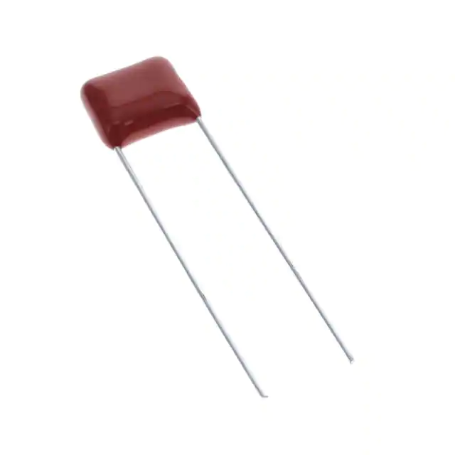

    薄膜电容 径向 1.5nF ±10% -
ECQ-E6152KF 数据手册
Plastic Film Capacitors Metallized Polyester Film Capacitor Type: ECQE(F) Non-inductive construction using metallized Polyester film with flame retardant epoxy resin coating ■Features • Self-healing property • Excellent electrical characteristics • Flame retardant epoxy resin coating • RoHS directive compliant ■Recommended Applications • General purpose usage ❈Please contact us when applications are CD , ignitor etc. ■Explanation of Part Numbers 1 2 3 4 E C Q E Product code 5 6 7 8 9 10 11 12 F Dielectric & construction Rated volt. 1 2 4 6 100 VDC 250 VDC 400 VDC 630 VDC 10 12 1A 2A Capacitance 1000 VDC 1250 VDC 125 VAC 250 VAC Cap. Tol. Suffix J K ±5 % ±10 % Suffix Blank B Z 3 6 Suffix Lead Form Straight Crimped lead Cut lead Crimped taping (Ammo) Crimped taping (Ammo) ● Explanation of Part Number for Odd Size Taping E C Product code Q E Dielectric & construction R Rated volt. Capacitance F Suffix Cap. Tol. Suffix ■Specifications Category temp. range (Including temperature-rise on unit surface) Rated voltage Capacitance range Capacitance tolerance Dissipation factor (tan ) Withstand voltage Insulation resistance (IR) 100 VDC, 250 VDC,400 VDC, 630 VDC, 1000 VDC, 1250 VDC, – 40 ˚C to + 105 ˚C 125 VAC, 250 VAC – 40 ˚C to + 105 ˚C 100 VDC, 250 VDC, 400 VDC, 630 VDC, 1000 VDC, 1250 VDC, (Derating of rated voltage by 1.25 %/˚C at more than 85 ˚C) 125 VAC, 250 VAC 0.0010 µF to 10 µF (E12) ±5 %(J), ±10 %(K) tan < =1.0 % (20 ˚C, 1 kHz) • Rated volt. 100 V to 630 VDC Between terminals : Rated volt.(VDC)✕150 % 60 s • Rated volt. 1000 VDC, 1250 VDC Between terminals : Rated volt. (VDC)✕175 % 2 s to 5 s or 1000 VAC 60 s Between terminals to enclosure : 1500 VAC 60 s • Rated volt. 125 VAC, 250 VAC Between terminals : Rated volt.(VAC)✕230 % 60 s Between terminals to enclosure : 1500 VAC 60 s >9000 MΩ (20 ˚C, 100 VDC, 60 s) 100 V to 630 VDC: C< = 0.33 µF : IR= >3000 MΩ . µF C > 0.33 µF : IR= > 1000 VDC, 1250 VDC: IR=10000 MΩ (20 ˚C, 100 VDC, 60 s) >2000 MΩ (20 ˚C, 500 VDC, 60 s) IR= >2000 MΩ 125 VAC, 250 VAC: C< (20 ˚C, 500 VDC, 60 s) = 0.47 µF : IR= >3000 MΩ . µF (20 ˚C, 100 VDC, 60 s) C > 0.47 µF : IR= ❈ In case of applying voltage in alternating current (50 Hz or 60 Hz sine wave) to a capacitor with DC rated voltage, please refer to the page of “Permissible voltage (R.M.S) in alternating current corresponding to DC rated voltage”. ❈ Voltage to be applied to ECQE1A (F) & ECQE2A (F) is only sine wave (50 Hz or 60 Hz). Design, Specifications are subject to change without notice. Ask factory for technical specifications before purchase and/or use. Whenever a doubt about safety arises from this product, please inform us immediately for technical consultation without fail. − FC32 − Plastic Film Capacitors ■Dimensions in mm (not to scale) Cut lead ■Packaging Specifications for Bulk Package Packing quantity:100 pcs./bag ■Taping Specifications for Automatic Insertion Metallized Film ●Taping style ❈Refer to the page of taping specifications. ●Packaging Specifications Type Rated volt. 100 VDC 250 VDC 400 VDC ECQE (F) 630 VDC 1000 VDC 1250 VDC 125 VAC 250 VAC Cap. range (µF) 0.56 to 0.68 0.82 to 1.0 1.2 to 3.3 1.2 to 3.3 0.010 to 0.27 0.33 0.39 to 1.5 0.010 to 0.33 0.39 to 1.5 0.010 to 0.10 0.12 to 0.47 0.010 to 0.10 0.12 to 0.47 0.0010 to 0.033 0.039 to 0.047 0.056 to 0.22 0.0010 to 0.047 0.056 to 0.22 0.010 to 0.10 0.0010 to 0.022 0.010 to 0.068 0.010 to 0.068 0.010 to 0.033 0.010 to 0.047 0.056 to 0.22 ●Lead Spacing Taping style AD AS AB ○ B C Packing D suffix E ○ ○ ○ ○ ○ ○ ○ ○ ○ ○ ○ ○ ○ ○ ○ ○ ○ ○ ○ ○ ○ ○ ○ ○ Ammo Ammo Ammo Ammo Ammo Ammo Ammo Ammo Ammo Ammo Ammo Ammo Ammo Ammo Ammo Ammo Ammo Ammo Ammo Ammo Ammo Ammo Ammo Ammo Ammo ( ( ( R( ( ( ( R( R( ( ( R( R( ( ( ( R( R( R( R( ( R( ( R( R( ) F3 ) F3 ) F3 )F ) F3 ) F3 ) F3 )F )F ) F3 ) F3 )F )F ) F3 ) F3 ) F3 )F )F )F )F ) F6 )F ) F6 )F )F Design, Specifications are subject to change without notice. Ask factory for technical specifications before purchase and/or use. Whenever a doubt about safety arises from this product, please inform us immediately for technical consultation without fail. − FC33 − Style AD AB B C D E Lead Spacing 5.0 mm 5.0 mm 5.0 mm 5.0 mm 7.5 mm 7.5 mm ❈See the column “Rating, Dimensions & Quantity Box” for packing quantity. Plastic Film Capacitors ■Rating, Dimensions & Quantity/Ammo Box ●Rated voltage : 100 VDC, Capacitance tolerance : ± 5 %(J), ±10 %(K) Part No. ECQE1564□F( ECQE1684□F( ECQE1824□F( ECQE1105□F( ECQE1125□F( ECQE1155□F( ECQE1185□F( ECQE1225□F( ECQE1275□F( ECQE1335□F( ECQE1395□F( ECQE1475□F( ECQE1565□F( ECQE1685□F( ECQE1825□F( ECQE1106□F( ▲ ) ) ) ) ) ) ) ) ) ) ) ) ) ) ) ) ▲ Dimensions (mm) Cap. (µF) L 0.56 0.68 0.82 1.0 1.2 1.5 1.8 2.2 2.7 3.3 3.9 4.7 5.6 6.8 8.2 10.0 12.0 12.0 12.0 12.0 18.5 18.5 18.5 18.5 18.5 18.5 26.0 26.0 26.0 26.0 26.0 26.0 max. T max. 5.5 6.0 6.0 6.7 5.5 6.0 6.5 7.0 8.0 8.5 7.0 7.5 8.3 9.0 10.0 11.5 H max. Straight Crimped lead 10.9 15.9 11.9 16.9 13.5 18.5 14.0 19.0 12.8 17.8 13.4 18.4 14.4 19.4 15.0 20.0 15.8 20.8 16.5 21.5 16.4 21.4 17.0 22.0 17.5 22.5 18.5 23.5 20.0 25.0 21.0 26.0 F Straight 10.0 10.0 10.0 10.0 15.0 15.0 15.0 15.0 15.0 15.0 22.5 22.5 22.5 22.5 22.5 22.5 S G max. Crimped lead Straight 10.0 1.0 10.0 1.0 10.0 1.0 10.0 1.0 10.0 1.0 10.0 1.0 10.0 1.0 10.0 1.0 10.0 1.0 10.0 1.0 15.0 1.0 15.0 1.0 15.0 1.0 15.0 1.0 15.0 1.5 15.0 1.5 ød 0.60 0.60 0.60 0.60 0.60 0.80 0.80 0.80 0.80 0.80 0.80 0.80 0.80 0.80 0.80 0.80 Min. order Q'ty Taping Standard 5 mm Odd size 5 mm 500 − Odd size 7.5 mm Bulk − 1,000 600 500 500 500 − 400 − 400 − style D: 0.056 µF to 1.0 µF style B: 1.2 µF to 10.0 µF Suffix for lead crimped or taped type Cap. tol. code ■Rating, Dimensions & Quantity/Ammo Box ● Rated voltage : 250 VDC, Capacitance tolerance : ±5 %(J), ±10 %(K) Cap. (µF) Part No. ECQE2103□F( ECQE2123□F( ECQE2153□F( ECQE2183□F( ECQE2223□F( ECQE2273□F( ECQE2333□F( ECQE2393□F( ECQE2473□F( ECQE2563□F( ECQE2683□F( ECQE2823□F( ECQE2104□F( ECQE2124□F( ECQE2154□F( ECQE2184□F( ECQE2224□F( ECQE2274□F( ECQE2334□F( ECQE2394□F( ECQE2474□F( ECQE2564□F( ECQE2684□F( ECQE2824□F( ECQE2105□F( ECQE2125□F( ECQE2155□F( ECQE2185□F( ECQE2225□F( ECQE2275□F( ECQE2335□F( ECQE2395□F( ECQE2475□F( ECQE2565□F( ECQE2685□F( ECQE2825□F( ECQE2106□F( ▲ ▲ ) 0.010 ) 0.012 ) 0.015 ) 0.018 ) 0.022 ) 0.027 ) 0.033 ) 0.039 ) 0.047 ) 0.056 ) 0.068 ) 0.082 ) 0.10 ) 0.12 ) 0.15 ) 0.18 ) 0.22 ) 0.27 ) 0.33 ) 0.39 ) 0.47 ) 0.56 ) 0.68 ) 0.82 ) 1.0 ) 1.2 ) 1.5 ) 1.8 ) 2.2 ) 2.7 ) 3.3 ) 3.9 ) 4.7 ) 5.6 ) 6.8 ) 8.2 )10.0 Dimensions (mm) L max. 10.3 10.3 10.3 10.3 10.3 10.3 10.3 10.3 10.3 10.3 10.3 10.3 10.3 10.3 10.3 12.0 12.0 12.0 12.0 18.5 18.5 18.5 18.5 18.5 18.5 18.5 18.5 26.0 26.0 26.0 26.0 26.0 26.0 31.0 31.0 31.0 31.0 T max. 4.3 4.4 4.4 4.4 4.4 4.4 4.5 4.5 4.5 4.8 4.5 4.9 5.8 6.0 6.0 5.0 5.5 6.0 6.5 4.9 5.3 5.5 6.0 6.5 7.4 8.0 9.0 7.5 8.5 9.4 10.3 11.0 12.0 11.8 13.0 14.3 15.9 H max. F S G max. Straight Crimped lead Straight Crimped lead Straight 7.4 7.5 7.5 7.5 7.5 7.5 7.5 7.5 7.5 7.9 7.5 8.0 8.4 9.0 10.8 10.3 10.5 11.5 12.0 12.0 12.5 13.0 13.5 14.5 15.0 15.9 16.8 15.5 16.3 17.0 18.0 20.5 21.5 21.0 22.4 23.5 25.8 12.4 12.5 12.5 12.5 12.5 12.5 12.5 12.5 12.5 12.9 12.5 13.0 13.4 14.0 15.8 15.3 15.5 16.5 17.0 17.0 17.5 18.0 18.5 19.5 20.0 20.9 21.8 20.5 21.3 22.0 23.0 25.5 26.5 26.0 27.4 28.5 30.8 7.5 7.5 7.5 7.5 7.5 7.5 7.5 7.5 7.5 7.5 7.5 7.5 7.5 7.5 7.5 10.0 10.0 10.0 10.0 15.0 15.0 15.0 15.0 15.0 15.0 15.0 15.0 22.5 22.5 22.5 22.5 22.5 22.5 27.5 27.5 27.5 27.5 Suffix for lead crimped or taped type Cap. tol. code 7.5 7.5 7.5 7.5 7.5 7.5 7.5 7.5 7.5 7.5 7.5 7.5 7.5 7.5 7.5 10.0 10.0 10.0 10.0 10.0 10.0 10.0 10.0 10.0 10.0 10.0 10.0 15.0 15.0 15.0 15.0 15.0 15.0 22.5 22.5 22.5 22.5 1.0 1.0 1.0 1.0 1.0 1.0 1.0 1.0 1.0 1.0 1.0 1.0 1.0 1.0 1.0 1.0 1.0 1.0 1.0 1.0 1.0 1.0 1.0 1.0 1.0 1.0 1.0 1.0 1.0 1.0 1.5 1.5 1.5 1.5 1.5 1.5 1.5 ød 0.60 0.60 0.60 0.60 0.60 0.60 0.60 0.60 0.60 0.60 0.60 0.60 0.60 0.60 0.60 0.60 0.60 0.60 0.60 0.60 0.60 0.60 0.80 0.80 0.80 0.80 0.80 0.80 0.80 0.80 0.80 0.80 0.80 0.80 0.80 0.80 0.80 Min. order Q'ty Taping Standard 5 mm Odd size 7.5 mm Bulk 1000 − 1000 500 1000 500 500 500 400 400 300 − − − Style D: 0.010 µF to 0.33 µF Style B: 0.39 µF to 10.0 µF Design, Specifications are subject to change without notice. Ask factory for technical specifications before purchase and/or use. Whenever a doubt about safety arises from this product, please inform us immediately for technical consultation without fail. − FC34 − Odd size 5 mm Plastic Film Capacitors ■Rating, Dimensions & Quantity/Ammo Box ●Rated voltage : 400 VDC, Capacitance tolerance : ±5 %(J), ±10 %(K) Dimensions (mm) L max. T max. ECQE4103□F( ) 0.010 10.3 4.3 7.4 12.4 7.5 7.5 1.0 0.60 ECQE4123□F( ) 0.012 10.3 4.4 7.5 12.5 7.5 7.5 1.0 0.60 ECQE4153□F( ) 0.015 10.3 4.4 7.5 12.5 7.5 7.5 1.0 0.60 ECQE4183□F( ) 0.018 10.3 4.4 7.5 12.5 7.5 7.5 1.0 0.60 ECQE4223□F( ) 0.022 10.3 4.8 7.9 12.9 7.5 7.5 1.0 0.60 ECQE4273□F( ) 0.027 10.3 5.5 8.0 13.0 7.5 7.5 1.0 0.60 ECQE4333□F( ) 0.033 10.3 6.0 9.0 14.0 7.5 7.5 1.0 0.60 ECQE4393□F( ) 0.039 12.0 4.9 8.0 13.0 10.0 10.0 1.0 0.60 ECQE4473□F( ) 0.047 12.0 5.0 8.3 13.3 10.0 10.0 1.0 0.60 ECQE4563□F( ) 0.056 12.0 5.0 10.0 15.0 10.0 10.0 1.0 0.60 ECQE4683□F( ) 0.068 12.0 5.4 10.5 15.5 10.0 10.0 1.0 0.60 ECQE4823□F( ) 0.082 12.0 5.8 11.0 16.0 10.0 10.0 1.0 0.60 ECQE4104□F( ) 0.10 12.0 6.3 12.0 17.0 10.0 10.0 1.0 0.60 ECQE4124□F( ) 0.12 18.5 5.0 10.0 15.0 15.0 10.0 1.0 0.60 ECQE4154□F( ) 0.15 18.5 5.0 12.4 17.4 15.0 10.0 1.0 0.60 ECQE4184□F( ) 0.18 18.5 5.4 12.5 17.5 15.0 10.0 1.0 0.60 ECQE4224□F( ) 0.22 18.5 5.9 13.0 18.0 15.0 10.0 1.0 0.60 ECQE4274□F( ) 0.27 18.5 6.5 14.3 19.3 15.0 10.0 1.0 0.80 ECQE4334□F( ) 0.33 18.5 7.0 14.9 19.9 15.0 10.0 1.0 0.80 ECQE4394□F( ) 0.39 18.5 7.5 15.4 20.4 15.0 10.0 1.0 0.80 ECQE4474□F( ) 0.47 18.5 7.8 17.0 22.0 15.0 10.0 1.0 0.80 ECQE4564□F( ) 0.56 26.0 6.5 16.0 21.0 22.5 15.0 1.0 0.80 ECQE4684□F( ) 0.68 26.0 7.0 16.5 21.5 22.5 15.0 1.0 0.80 ECQE4824□F( ) 0.82 26.0 7.9 17.3 22.3 22.5 15.0 1.0 0.80 ECQE4105□F( ) 1.0 26.0 8.5 18.0 23.0 22.5 15.0 1.0 0.80 ECQE4125□F( ) 1.2 26.0 9.5 18.9 23.9 22.5 15.0 1.0 0.80 ECQE4155□F( ) 1.5 31.0 9.5 19.0 24.0 27.5 22.5 1.0 0.80 ECQE4185□F( ) 1.8 31.0 11.0 20.5 25.5 27.5 22.5 1.5 0.80 ) 2.2 31.0 11.0 22.0 27.0 27.5 22.5 1.5 0.80 ECQE4225□F( ▲ H max. F S G max. Straight Crimped lead Straight Crimped lead Straight ▲ Suffix for lead crimped or taped type Cap. tol. code φd Min. order Q'ty Taping Standard 5 mm Odd size 7.5 mm − 1000 Bulk 1000 500 500 500 500 400 − − style D:0.010 µF to 0.10 µF style B:0.12 µF to 2.2 µF Design, Specifications are subject to change without notice. Ask factory for technical specifications before purchase and/or use. Whenever a doubt about safety arises from this product, please inform us immediately for technical consultation without fail. − FC35 − Odd size 5 mm − Metallized Film Cap. (µF) Part No. Plastic Film Capacitors ●Rated voltage : 630 VDC, Capacitance tolerance : ±5 %(J), ±10 %(K) Dimensions (mm) Cap. Part No. H max. F S G max. max. max. (µF) T L Straight Crimped lead Straight Crimped lead Straight φd ECQE6102□F( ) 0.0010 10.0 4.5 9.5 14.5 7.5 5.0 1.0 0.60 ECQE6122□F( ) 0.0012 10.0 4.5 10.0 15.0 7.5 5.0 1.0 0.60 ECQE6152□F( ) 0.0015 10.0 4.5 10.0 15.0 7.5 5.0 1.0 0.60 ECQE6182□F( ) 0.0018 10.0 4.5 10.0 15.0 7.5 5.0 1.0 0.60 ECQE6222□F( ) 0.0022 10.0 4.5 10.0 15.0 7.5 5.0 1.0 0.60 ECQE6272□F( ) 0.0027 10.0 4.5 10.0 15.0 7.5 5.0 1.0 0.60 ECQE6332□F( ) 0.0033 10.0 4.5 10.0 15.0 7.5 5.0 1.0 0.60 ECQE6392□F( ) 0.0039 10.0 4.5 10.0 15.0 7.5 5.0 1.0 0.60 ECQE6472□F( ) 0.0047 12.0 4.5 10.0 15.0 10.0 7.5 1.0 0.60 ECQE6562□F( ) 0.0056 12.0 4.5 10.0 15.0 10.0 7.5 1.0 0.60 ECQE6682□F( ) 0.0068 12.0 4.9 10.0 15.0 10.0 7.5 1.0 0.60 ECQE6822□F( ) 0.0082 12.0 4.5 10.0 15.0 10.0 7.5 1.0 0.60 ECQE6103□F( ) 0.010 12.0 4.5 7.5 12.5 10.0 10.0 1.0 0.60 ECQE6123□F( ) 0.012 12.0 4.5 7.8 12.8 10.0 10.0 1.0 0.60 ECQE6153□F( ) 0.015 12.0 5.0 8.2 13.2 10.0 10.0 1.0 0.60 ECQE6183□F( ) 0.018 12.0 4.9 10.0 15.0 10.0 10.0 1.0 0.60 ECQE6223□F( ) 0.022 12.0 5.3 10.5 15.5 10.0 10.0 1.0 0.60 ECQE6273□F( ) 0.027 12.0 5.5 10.9 15.9 10.0 10.0 1.0 0.60 ECQE6333□F( ) 0.033 12.0 6.0 11.9 16.9 10.0 10.0 1.0 0.60 ECQE6393□F( ) 0.039 12.0 6.0 13.4 18.4 10.0 10.0 1.0 0.60 ECQE6473□F( ) 0.047 12.0 6.5 13.5 18.5 10.0 10.0 1.0 0.60 ECQE6563□F( ) 0.056 18.5 5.4 10.5 15.5 15.0 10.0 1.0 0.60 ECQE6683□F( ) 0.068 18.5 5.8 11.0 16.0 15.0 10.0 1.0 0.60 ECQE6823□F( ) 0.082 18.5 6.5 12.0 17.0 15.0 10.0 1.0 0.60 ECQE6104□F( ) 0.10 18.5 6.3 14.0 19.0 15.0 10.0 1.0 0.60 ECQE6124□F( ) 0.12 18.5 6.3 14.5 19.5 15.0 10.0 1.0 0.80 ECQE6154□F( ) 0.15 18.5 7.5 15.4 20.4 15.0 10.0 1.0 0.80 ECQE6184□F( ) 0.18 18.5 8.0 16.0 21.0 15.0 10.0 1.0 0.80 ECQE6224□F( ) 0.22 18.5 9.0 16.5 21.5 15.0 10.0 1.0 0.80 ECQE6274□F( ) 0.27 26.0 7.0 16.5 21.5 22.5 15.0 1.0 0.80 ECQE6334□F( ) 0.33 26.0 7.8 17.0 22.0 22.5 15.0 1.0 0.80 ECQE6394□F( ) 0.39 26.0 8.5 17.9 22.9 22.5 15.0 1.0 0.80 ECQE6474□F( ) 0.47 26.0 9.3 18.5 23.5 22.5 15.0 1.0 0.80 ECQE6564□F( ) 0.56 26.0 10.0 20.0 25.0 22.5 15.0 1.5 0.80 ECQE6684□F( ) 0.68 26.0 11.5 21.0 26.0 22.5 15.0 1.5 0.80 ECQE6824□F( ) 0.82 31.0 11.3 20.5 25.5 27.5 22.5 1.5 0.80 ECQE6105□F( ) 1.0 31.0 12.5 21.9 26.9 27.5 22.5 1.5 0.80 ECQE6125□F( ) 1.2 31.0 13.5 23.0 28.0 27.5 22.5 1.5 0.80 ECQE6155□F( ) 1.5 31.0 15.3 24.7 29.7 27.5 22.5 1.5 0.80 ECQE6185□F( ) 1.8 31.0 16.8 27.0 32.0 27.5 22.5 1.5 0.80 ) 2.2 31.0 19.5 29.0 34.0 27.5 22.5 1.5 0.80 ECQE6225□F( ▲ ▲ Min. order Q'ty Taping Standard Odd size Odd size 5 mm 5 mm 7.5 mm Bulk 1000 − 1000 500 1000 500 500 500 400 400 300 − − − style D:0.010 µF to 0.047 µF style B:0.0010 µF to 0.0082 µF, 0.056 µF to 2.2 µF Suffix for lead crimped or taped type. Cap. tol. code Design, Specifications are subject to change without notice. Ask factory for technical specifications before purchase and/or use. Whenever a doubt about safety arises from this product, please inform us immediately for technical consultation without fail. − FC36 − Plastic Film Capacitors ■Rating, Dimensions & Quantity/Ammo Box ●Rated voltage : 1000 VDC, Note) 125 VAC, Capacitance tolerance : ±5 %(J), ±10 %(K) Min. order Q'ty Dimensions (mm) H F S max. L max. T max. G max. Straight Crimped lead Straight Crimped lead Straight ød ECQE10103□F( ) 0.010 15.5 6.0 11.0 16.0 12.5 12.5 1.0 0.60 ECQE10123□F( ) 0.012 15.5 6.0 12.0 17.0 12.5 12.5 1.0 0.60 ECQE10153□F( ) 0.015 15.5 7.0 12.5 17.5 12.5 12.5 1.0 0.60 ECQE10183□F( ) 0.018 15.5 7.5 13.0 20.0 12.5 12.5 1.0 0.80 ECQE10223□F( ) 0.022 15.5 7.5 15.5 22.5 12.5 12.5 1.0 0.80 ECQE10273□F( ) 0.027 21.0 6.0 13.0 18.0 17.5 12.5 1.0 0.80 ECQE10333□F( ) 0.033 21.0 6.5 14.0 19.0 17.5 12.5 1.0 0.80 ECQE10393□F( ) 0.039 21.0 7.0 14.5 19.5 17.5 12.5 1.0 0.80 ECQE10473□F( ) 0.047 21.0 7.5 15.5 20.5 17.5 12.5 1.0 0.80 ECQE10563□F( ) 0.056 21.0 7.5 17.0 22.0 17.5 12.5 1.0 0.80 ECQE10683□F( ) 0.068 21.0 8.5 18.0 23.0 17.5 12.5 1.0 0.80 ECQE10823□F( ) 0.082 21.0 9.0 18.5 23.5 17.5 12.5 1.0 0.80 ECQE10104□F( ) 0.10 21.0 10.0 20.0 25.0 17.5 12.5 1.0 0.80 ECQE10124□F( ) 0.12 26.0 9.0 18.5 23.5 22.5 17.5 1.0 0.80 ECQE10154□F( ) 0.15 26.0 10.0 20.0 25.0 22.5 17.5 1.5 0.80 ECQE10184□F( ) 0.18 26.0 10.5 22.0 27.0 22.5 17.5 1.5 0.80 ) 0.22 26.0 12.0 23.0 28.0 22.5 17.5 1.5 0.80 ECQE10224□F( ▲ Taping 7.5 mm Bulk 500 400 500 500 400 300 − ▲ Suffix for lead crimped or taped type. Cap. tol. code Style D: 0.010 µF to 0.022 µF Style B: 0.027 µF to 0.22 µF Note) This type has two rated voltage, one is DC rated voltage another is AC rated voltage.. DC rated voltage is 1000 V, AC rated voltage is 125 V. Making for rated voltage is「1000 V, 125 V 」 When capacitors use in secondary side of power source, and in case of applying voltage in altering current (50 Hz or 60 Hz sine wave) to a capacitor, please refer to the page of ''Permissible voltage (R.M.S) in altering current corresponding to DC rated voltage''. When capacitors use in primary side of power source, the rated voltage is shown 125 VAC. Voltage to be applied to capacitors in only sine wave (50 Hz or 60 Hz). AC rated capacitors complying with clause 1 of ''Electrical Appliance and Material Safety Law''. And not complying with clause 2 of ''Electrical Appliance and Material Safety Law'', in this case please use ECQUL type or ECQUG type Design, Specifications are subject to change without notice. Ask factory for technical specifications before purchase and/or use. Whenever a doubt about safety arises from this product, please inform us immediately for technical consultation without fail. − FC37 − Metallized Film Cap. (µF) Part No. Plastic Film Capacitors ■Rating, Dimensions & Quantity/Ammo Box ●Rated voltage : 1250 VDC, Note) 125 VAC, Capacitance tolerance : ±5 %(J), ±10 %(K) Cap. (µF) Part No. L max. T max. Dimensions (mm) H max. F Min. order Q'ty S G max. Straight Crimped lead Straight Crimped lead Straight ød ECQE12102□F( ) 0.0010 15.5 6.0 11.0 16.0 12.5 10.0 1.0 0.60 ECQE12122□F( ) 0.0012 15.5 6.0 11.0 16.0 12.5 10.0 1.0 0.60 ECQE12152□F( ) 0.0015 15.5 6.0 11.0 16.0 12.5 10.0 1.0 0.60 ECQE12182□F( ) 0.0018 15.5 6.0 11.0 16.0 12.5 10.0 1.0 0.60 ECQE12222□F( ) 0.0022 15.5 6.0 11.5 16.5 12.5 10.0 1.0 0.60 ECQE12272□F( ) 0.0027 15.5 6.5 12.0 17.0 12.5 10.0 1.0 0.60 ECQE12332□F( ) 0.0033 15.5 6.0 11.5 16.5 12.5 10.0 1.0 0.60 ECQE12392□F( ) 0.0039 15.5 6.5 12.0 17.0 12.5 10.0 1.0 0.60 ECQE12472□F( ) 0.0047 15.5 7.0 12.5 17.5 12.5 10.0 1.0 0.60 ECQE12562□F( ) 0.0056 15.5 7.5 13.0 18.0 12.5 10.0 1.0 0.60 ECQE12682□F( ) 0.0068 15.5 7.5 15.0 20.0 12.5 10.0 1.0 0.60 ECQE12822□F( ) 0.0082 21.0 5.0 12.0 17.0 17.5 12.5 1.0 0.60 ECQE12103□F( ) 0.010 21.0 5.0 12.5 17.5 17.5 12.5 1.0 0.60 ECQE12123□F( ) 0.012 21.0 5.5 13.0 18.0 17.5 12.5 1.0 0.60 ECQE12153□F( ) 0.015 21.0 6.0 13.5 18.5 17.5 12.5 1.0 0.60 ECQE12183□F( ) 0.018 21.0 6.5 14.5 19.5 17.5 12.5 1.0 0.80 ECQE12223□F( ) 0.022 21.0 7.0 15.0 20.0 17.5 12.5 1.0 0.80 ECQE12273□F( ) 0.027 26.0 6.0 15.5 20.5 22.5 17.5 1.0 0.80 ECQE12333□F( ) 0.033 26.0 6.5 16.0 21.0 22.5 17.5 1.0 0.80 ECQE12393□F( ) 0.039 26.0 7.0 16.5 21.5 22.5 17.5 1.0 0.80 ECQE12473□F( ) 0.047 26.0 8.0 17.0 22.0 22.5 17.5 1.0 0.80 ECQE12563□F( ) 0.056 31.0 7.5 17.0 22.0 27.5 22.5 1.0 0.80 ECQE12683□F( ) 0.068 31.0 8.0 17.5 22.5 27.5 22.5 1.0 0.80 ECQE12823□F( ) 0.082 31.0 9.0 18.5 23.5 27.5 22.5 1.0 0.80 ECQE12104□F( ) 0.10 31.0 10.0 19.5 24.5 27.5 22.5 1.0 0.80 ECQE12124□F( ) 0.12 31.0 11.5 20.5 25.5 27.5 22.5 1.5 0.80 ECQE12154□F( ) 0.15 31.0 12.0 23.0 28.0 27.5 22.5 1.5 0.80 ECQE12184□F( ) 0.18 31.0 13.0 24.5 29.5 27.5 22.5 1.5 0.80 ) 0.22 31.0 14.5 26.5 31.5 27.5 22.5 1.5 0.80 ECQE12224□F( ▲ Taping 7.5 mm Bulk 500 400 500 500 ▲ Suffix for lead crimped or taped type. Cap. tol. code Style D: 0.0010 µF to 0.0068 µF Style B: 0.0082 µF to 0.22 µF Note) This type has two rated voltage, one is DC rated voltage another is AC rated voltage.. DC rated voltage is 1250 V, AC rated voltage is 125 V. Making for rated voltage is「1250 V, 125 V 」 When capacitors use in secondary side of power source, and in case of applying voltage in altering current (50 Hz or 60 Hz sine wave) to a capacitor, please refer to the page of ''Permissible voltage (R.M.S) in altering current corresponding to DC rated voltage''. When capacitors use in primary side of power source, the rated voltage is shown 125 VAC. Voltage to be applied to capacitors in only sine wave (50 Hz or 60 Hz). AC rated capacitors complying with clause 1 of ''Electrical Appliance and Material Safety Law''. And not complying with clause 2 of ''Electrical Appliance and Material Safety Law'', in this case please use ECQUL type or ECQUG type Design, Specifications are subject to change without notice. Ask factory for technical specifications before purchase and/or use. Whenever a doubt about safety arises from this product, please inform us immediately for technical consultation without fail. − FC38 − Plastic Film Capacitors ■Rating, Dimensions & Quantity/Ammo Box ●Rated voltage : 125 VAC, Capacitance tolerance : ±5 %(J), ±10 %(K) ●Noise suppression Capacitors (Across-the-line) Cap. (µF) L max. T max. Dimensions (mm) H max. F S G max. Straight Crimped lead Straight Crimped lead Straight φd ECQE1A103□F( ) 0.010 10.5 4.5 7.5 12.5 7.5 7.5 1.0 0.60 ECQE1A123□F( ) 0.012 10.5 4.4 7.5 12.5 7.5 7.5 1.0 0.60 ECQE1A153□F( ) 0.015 10.5 4.4 7.5 12.5 7.5 7.5 1.0 0.60 ECQE1A183□F( ) 0.018 10.5 4.4 7.5 12.5 7.5 7.5 1.0 0.60 ECQE1A223□F( ) 0.022 10.5 4.4 7.5 12.5 7.5 7.5 1.0 0.60 ECQE1A273□F( ) 0.027 10.5 4.4 7.5 12.5 7.5 7.5 1.0 0.60 ECQE1A333□F( ) 0.033 10.5 4.5 7.8 12.8 7.5 7.5 1.0 0.60 ECQE1A393□F( ) 0.039 10.5 4.5 7.8 12.8 7.5 7.5 1.0 0.60 ECQE1A473□F( ) 0.047 10.5 5.5 8.0 13.0 7.5 7.5 1.0 0.60 ECQE1A563□F( ) 0.056 10.5 5.9 8.5 13.5 7.5 7.5 1.0 0.60 ECQE1A683□F( ) 0.068 10.5 6.3 9.4 14.4 7.5 7.5 1.0 0.60 MF( ) Min. order Q'ty Taping Standard 5 mm Odd size Odd size 5 mm 7.5 mm Bulk 1000 1000 500 − 500 style D:0.010 µF to 0.068 µF Suffix for lead crimped or taped type. Cap. tol. code Notice for AC rated AC rated capacitors complying with clause 1 of ''Electrical Appliance and Material Safety Law''. As for clause 2 of ''Electrical Appliance and Material Safety Law'', please use ECQUL type or ECQUG type. When using these capacitors as a across-the-line capacitor, it shall be required to follow either item 1. or item 2. condition. 1. Capacitor shall be connected in parallel with varistor (Specified varistor voltage in table 1.) 2. Voltage applied for capacitor shall not exceed other than specified in table 1, when using these capacitors. Table 1 Cap. Rated Voltage Varistor voltage Pulse voltage 125 VAC 250 V 250 V0–P Design, Specifications are subject to change without notice. Ask factory for technical specifications before purchase and/or use. Whenever a doubt about safety arises from this product, please inform us immediately for technical consultation without fail. − FC39 − Metallized Film Part No. Plastic Film Capacitors ●Rated voltage : 250 VAC, Capacitance tolerance : ±5 %(J), ±10 %(K) Noise suppression Capacitors (Across-the-line) Cap. (µF) Part No. L max. T max. Dimensions (mm) H max. F S G max. Straight Crimped lead Straight Crimped lead Straight φd 5 mm ECQE2A103□F( ) 0.010 12.5 5.5 10.8 15.8 10.0 10.0 1.0 0.60 ECQE2A123□F( ) 0.012 12.5 6.0 11.5 16.5 10.0 10.0 1.0 0.60 ECQE2A153□F( ) 0.015 12.5 6.3 9.9 14.9 10.0 10.0 1.0 0.60 ECQE2A183□F( ) 0.018 12.5 6.0 11.9 16.9 10.0 10.0 1.0 0.60 ECQE2A223□F( ) 0.022 12.5 6.0 11.5 16.5 10.0 10.0 1.0 0.60 ECQE2A273□F( ) 0.027 12.5 5.5 10.9 15.9 10.0 10.0 1.0 0.60 ECQE2A333□F( ) 0.033 12.5 6.0 11.9 16.9 10.0 10.0 1.0 0.60 ECQE2A393□F( ) 0.039 12.5 6.0 13.4 18.4 10.0 10.0 1.0 0.60 ECQE2A473□F( ) 0.047 12.5 6.5 14.4 19.4 10.0 10.0 1.0 0.60 ECQE2A563□F( ) 0.056 18.5 5.4 10.5 15.5 15.0 10.0 1.0 0.60 ECQE2A683□F( ) 0.068 18.5 5.8 11.0 16.0 15.0 10.0 1.0 0.60 ECQE2A823□F( ) 0.082 18.5 6.3 12.0 17.0 15.0 10.0 1.0 0.60 ECQE2A104□F( ) 0.10 18.5 6.3 14.0 19.0 15.0 10.0 1.0 0.60 ECQE2A124□F( ) 0.12 18.5 6.8 14.5 19.5 15.0 10.0 1.0 0.80 ECQE2A154□F( ) 0.15 18.5 7.5 15.4 20.4 15.0 10.0 1.0 0.80 ECQE2A184□F( ) 0.18 18.5 8.0 16.0 21.0 15.0 10.0 1.0 0.80 ECQE2A224□F( ) 0.22 18.5 9.0 16.9 21.9 15.0 10.0 1.0 0.80 ECQE2A274□F( ) 0.27 26.0 7.0 16.5 21.5 22.5 15.0 1.0 0.80 ECQE2A334□F( ) 0.33 26.0 7.8 17.0 22.0 22.5 15.0 1.0 0.80 ECQE2A394□F( ) 0.39 26.0 8.5 17.9 22.9 22.5 15.0 1.0 0.80 ECQE2A474□F( ) 0.47 26.0 9.3 18.5 23.5 22.5 15.0 1.0 0.80 ECQE2A564P( )( ) 0.56 26.0 10.0 20.0 ─ 22.5 ─ 1.0 0.80 ECQE2A684P( )( ) 0.68 26.0 11.5 21.0 ─ 22.5 ─ 1.0 0.80 ECQE2A824P( )( ) 0.82 26.0 13.0 22.5 ─ 22.5 ─ 1.0 0.80 ECQE2A105P( )( ) 1.0 31.0 12.5 21.9 ─ 27.5 ─ 1.5 0.80 ECQE2A125P( )( ) 1.2 31.0 13.5 23.0 ─ 27.5 ─ 1.5 0.80 ECQE2A155P( )( ) 1.5 31.0 15.3 24.7 ─ 27.5 ─ 1.5 0.80 ECQE2A185P( )( ) 1.8 31.0 16.8 27.0 ─ 27.5 ─ 1.5 0.80 ECQE2A225P( )( ) 2.2 31.0 19.5 29.0 ─ 27.5 ─ 1.5 0.80 MF( ) Min. order Q'ty Taping Bulk Standard Odd size 7.5 mm 500 1000 500 400 300 − − Style D:0.010 µF to 0.047 µF Style B:0.056 µF to 0.47 µF Suffix for lead crimped or taped type. Cap. tol. code ❈Please consult us about Crimed lead type of 0.56 µF to 2.2 µF. Notice for AC rated AC rated capacitors complying with clause 1 of ''Electrical Appliance and Material Safety Law''. As for clause 2 of ''Electrical Appliance and Material Safety Law'', please use ECQUL type or ECQUG type. When using these capacitors as a across-the-line capacitor, it shall be required to follow either item 1. or item 2. condition. 1. Capacitor shall be connected in parallel with varistor (Specified varistor voltage in table 1.) 2. Voltage applied for capacitor shall not exceed other than specified in table 1, when using these capacitors. Table 1 Cap. Rated Voltage Varistor voltage Pulse voltage 250 VAC 470 V 630 V0–P Design, Specifications are subject to change without notice. Ask factory for technical specifications before purchase and/or use. Whenever a doubt about safety arises from this product, please inform us immediately for technical consultation without fail. − FC40 − 500 ECQE(F) Type 100VDC Series (Metallized Polyester Film) Erectrical Characteristics Temperature Characteristics 10 Frequency Characteristics at 1kHz 10 Capacitance change (%) Capacitance change (%) 10uF 1.0uF 4.7uF 10uF 5 0 -5 -10 4.7uF 5 1.0uF 0 -5 -10 -60 -40 -20 0 20 40 60 80 100 1 10 Temperature (Degree C) 10000 at 1kHz 10 8 6 4 2 1.0uF 4.7uF 10uF 8 10uF 4.7uF 6 1.0uF 4 2 0 0 -60 -40 -20 0 20 40 60 80 1 100 10 Temperature (Degree C) 100 1000 10000 1000 10000 Frequency (kHz) at DC100V 10000 Insuration resistance (ohm) 1.E+12 1000 Frequency (kHz) Dissipation factor (%) Dissipation factor (%) 10 100 1.E+11 1.E+10 1.0uF 1.E+09 4.7uF 10uF 1.E+08 1.E+07 Impedance (ohm) 1000 100 1.0uF 10 4.7uF 10uF 1 0.1 1.E+06 0.01 -60 -40 -20 0 20 40 60 Temperature (Degree C) 80 100 1 10 100 Frequency (kHz) ECQE(F) Type 100VDC Series (Metallized Polyester Film) Applicable Specifications Permissible Current Permissible Voltage (at sinewave) 4.5 100 4 10uF Permissible Voltage (Vrms) Permissible Current (Arms) 3.5 4.7uF 3 2.5 2.2uF 2 1.0uF 1.5 10 1.0uF 1 2.2uF 4.7uF 1 10uF 0.5 0.1 0 10 100 1000 10 100 Frequency (kHz) Pulse Handling Capability (dV/dt) (Max 10000cycles) Rating Capacitance Voltage Value(uF) Code 1000 Frequency (kHz) Voltage Derating by Temperature 120 Current(o-p) dV/dt(V/us) (A) From 0.56uF to 10uF 564 684 824 105 125 155 185 225 275 335 395 475 565 685 825 106 22 11 6 12.32 15.0 18.0 22.0 13.2 17.1 19.8 24.2 29.7 36.3 23.4 28.2 33.6 40.8 49.2 60.0 100 80 Rated Voltage (VDC) 100VDC 0.56 0.68 0.82 1.00 1.20 1.50 1.80 2.20 2.70 3.30 3.90 4.70 5.60 6.80 8.20 10.00 60 40 20 0 -60 -40 -20 0 20 40 60 80 100 120 Surface Temperature of Capacitor(Degree C) * Please consult Panasonic if your condition exceeds the above spec. ECQE(F) Type 250VDC Series (Metallized Polyester Film) Erectrical Characteristics Temperature Characteristics at 1kHz 10 Capacitance change (%) 10 Capacitance change (%) Frequency Characteristics 0.01uF 0.1uF 1.0uF 10uF 5 0 -5 -10 10uF 5 1.0uF 0.1uF 0 0.01uF -5 -10 -60 -40 -20 0 20 40 60 80 100 1 10 Temperature (Degree C) 100 1000 10000 Frequency (kHz) 10 8 8 Dissipation factor (%) Dissipation factor (%) at 1kHz 10 6 4 0.01uF 0.1uF 1.0uF 10uF 2 0 10uF 6 1.0uF 0.1uF 4 0.01uF 2 0 -60 -40 -20 0 20 40 60 80 100 1 10 100 1000 10000 Frequency (kHz) Temperature (Degree C) at DC100V 0.01uF 10000 1000 1.E+11 0.1uF 1.E+10 1.0uF 1.E+09 10uF 1.E+08 Impedance (ohm) Insuration resistance (ohm) 1.E+12 0.01uF 100 0.1uF 10 1.0uF 10uF 1 0.1 1.E+07 0.01 1.E+06 -60 -40 -20 0 20 40 60 Temperature (Degree C) 80 100 1 10 100 1000 Frequency (kHz) 10000 100000 ECQE(F) Type 250VDC Series (Metallized Polyester Film) Applicable Specifications Permissible Current Permissible Voltage (at sinewave) 5 100 10uF Permissible Voltage (Vrms) Permissible Current (Arms) 4 4.7uF 3 2.2uF 2 1.0uF 0.01uF 10 0.022uF 0.047uF 0.10uF 1 0.22uF 0.47uF 0.22uF 0 10 100 4.7uF 1000 2.2uF 10 100 Voltage Derating by Temperature (Max 10000cycles) 103 153 223 333 473 683 104 154 224 334 474 684 105 155 225 335 475 685 106 dV/dt(V/us) 48 33 18 10 8 300 Current(o-p) (A) 0.48 0.72 1.06 1.58 2.26 3.26 4.80 7.20 7.26 10.89 8.46 12.24 18.00 27.00 22.00 33.00 47.00 54.40 80.00 From 0.01uF to 10uF 250 Rated Voltage (VDC) 250VDC 0.010 0.015 0.022 0.033 0.047 0.068 0.100 0.150 0.220 0.330 0.470 0.680 1.000 1.500 2.200 3.300 4.700 6.800 10.000 Code 1000 Frequency (kHz) Pulse Handling Capability (dV/dt) Capacitance Value(uF) 1.0uF 1 Frequency (kHz) Rating Voltage 0.47uF 10uF 0.10uF 0.047u 0.022u 0.01uF 200 150 100 50 0 -60 -40 -20 0 20 40 60 80 100 120 Surface Temperature of Capacitor(Degree C) * Please consult Panasonic if your condition exceeds the above spec. ECQE(F) Type 400VDC Series (Metallized Polyester Film) Erectrical Characteristics Temperature Characteristics at 1kHz 10 Capacitance change (%) Capacitance change (%) 10 Frequency Characteristics 0.01uF 0.1uF 1.0uF 2.2uF 5 0 -5 -10 2.2uF 5 1.0uF 0.1uF 0 0.01uF -5 -10 -60 -40 -20 0 20 40 60 80 100 1 10 100 1000 10000 Frequency (kHz) Temperature (Degree C) 10 8 8 Dissipation factor (%) Dissipation factor (%) at 1kHz 10 6 4 0.01uF 0.1uF 1.0uF 2.2uF 2 0 2.2uF 6 1.0uF 4 0.1uF 0.01uF 2 0 -60 -40 -20 0 20 40 60 80 100 1 10 100 1000 10000 Frequency (kHz) Temperature (Degree C) at DC100V 1.E+13 Insuration resistance (ohm) 10000 1.E+12 1.E+11 0.1uF 1.E+10 1.0uF 1.E+09 2.2uF Impedance (ohm) 1000 0.01uF 100 0.01uF 0.1uF 10 1.0uF 2.2uF 1 0.1 1.E+08 0.01 1.E+07 -60 -40 -20 0 20 40 60 Temperature (Degree C) 80 100 1 10 100 1000 Frequency (kHz) 10000 100000 ECQE(F) Type 400VDC Series (Metallized Polyester Film) Applicable Specifications Permissible Current Permissible Voltage (at sinewave) 3 100 2.2uF Permissible Voltage (Vrms) Permissible Current (Arms) 2.5 1.0uF 2 1.5 0.47uF 1 0.22uF 0.01uF 10 0.022uF 0.047uF 0.1uF 0.22uF 0.47uF 0.1uF 0.5 0.047uF 1.0uF 0.022uF 0.01uF 2.2uF 1 0 10 100 1000 10 100 Frequency (kHz) Frequency (kHz) Pulse Handling Capability (dV/dt) Voltage Derating by Temperature (Max 10000cycles) 400VDC Capacitance Value(uF) 0.010 0.015 0.022 0.033 0.047 0.068 0.100 0.150 0.220 0.330 0.470 0.680 1.000 1.200 2.200 Code 103 153 223 333 473 683 104 154 224 334 474 684 105 155 225 dV/dt(V/us) 131 78 37 22 18 500 Current(o-p) (A) 1.31 1.97 2.88 4.32 3.67 5.30 7.80 5.55 8.14 12.21 17.39 14.96 22.00 27.00 39.60 From 0.01uF to 2.2uF 400 Rated Voltage (VDC) Rating Voltage 1000 300 200 100 0 -60 -40 -20 0 20 40 60 80 100 120 Surface Temperature of Capacitor(Degree C) * Please consult Panasonic if your condition exceeds the above spec. ECQE(F) Type 630VDC Series (Metallized Polyester Film) Erectrical Characteristics Temperature Characteristics Frequency Characteristics at 1kHz 10 0.01uF 0.1uF 1.0uF 2.2uF 5 Capacitance change (%) Capacitance change (%) 10 0 -5 2.2uF 5 1.0uF 0.1uF 0 0.01uF -5 -10 -10 -60 -40 -20 0 20 40 60 80 1 100 10 Temperature (Degree C) 100 1000 10000 Frequency (kHz) 10 8 8 Dissipation factor (%) Dissipation factor (%) at 1kHz 10 6 4 0.01uF 0.1uF 1.0uF 2.2uF 2 0 2.2uF 6 1.0uF 4 0.1uF 0.01uF 2 0 -60 -40 -20 0 20 40 60 80 100 1 10 Temperature (Degree C) 1000 10000 Frequency (kHz) at DC100V 10000 Insuration resistance (ohm) 1.E+13 100 1.E+12 1.E+11 0.1uF 1.E+10 1.0uF 1.E+09 2.2uF Impedance (ohm) 1000 0.01uF 1.E+08 0.01uF 0.1uF 100 1.0uF 10 2.2uF 1 0.1 1.E+07 0.01 -60 -40 -20 0 20 40 60 Temperature (Degree C) 80 100 1 10 100 1000 Frequency (kHz) 10000 100000 ECQE(F) Type 630VDC Series (Metallized Polyester Film) Applicable Specifications Permissible Current Permissible Voltage (at sinewave) 100 5 2.2uF Permissible Voltage (Vrms) Permissible Current (Arms) 4 3 1.0uF 2 0.47uF 0.01uF 0.022uF 10 0.047uF 0.1uF 0.22uF 0.22uF 1 0.47uF 0.1uF 1.0uF 0.047uF 2.2uF 0.022uF 0.01uF 0 10 100 1 1000 10 100 Frequency (kHz) Frequency (kHz) Pulse Handling Capability (dV/dt) Voltage Derating by Temperature (Max 10000cycles) 630VDC Capacitance Value(uF) 0.010 0.015 0.022 0.033 0.047 0.068 0.100 0.150 0.220 0.330 0.470 0.680 1.000 1.500 2.200 Code 103 153 223 333 473 683 104 154 224 334 474 684 105 155 225 dV/dt(V/us) 273 116 63 48 800 Current(o-p) (A) 2.73 4.10 6.01 9.01 12.83 7.89 11.60 17.40 25.52 20.79 29.61 42.84 48.00 72.00 105.60 700 From 0.01uF to 2.2uF 600 Rated Voltage (VDC) Rating Voltage 1000 500 400 300 200 100 0 -60 -40 -20 0 20 40 60 80 100 120 Surface Temperature of Capacitor(Degree C) * Please consult Panasonic if your condition exceeds the above spec. ECQE(F) Type 125VAC Series (Metallized Polyester Film) Erectrical Characteristics Temperature Characteristics 10 Capacitance change (%) 10 Capacitance change (%) Frequency Characteristics at 1kHz 0.01uF 0.047uF 0.1uF 0.47uF 5 0 -5 0.47uF 5 0.1uF 0.047uF 0 0.01uF -5 -10 -10 -60 -40 -20 0 20 40 60 80 1 100 10 Temperature (Degree C) 1000 10000 Frequency (kHz) at 1kHz 10 8 Dissipation factor (%) Dissipation factor (%) 10 100 6 4 0.01uF 0.047uF 0.1uF 0.47uF 2 0 8 6 0.47uF 0.1uF 4 0.047uF 0.01uF 2 0 1 10 100 1000 10000 Frequency (kHz) Temperature (Degree C) at DC100V 10000 1.E+12 1000 0.01uF 0.047uF 1.E+11 0.1uF 1.E+10 0.47uF 1.E+09 1.E+08 Impedance (ohm) Insuration resistance (ohm) 1.E+13 0.01uF 100 0.047uF 0.1uF 10 0.47uF 1 0.1 1.E+07 0.01 -60 -40 -20 0 20 40 60 Temperature (Degree C) 80 100 1 10 100 1000 Frequency (kHz) 10000 100000 ECQE(F) Type 250VAC Series (Metallized Polyester Film) Erectrical Characteristics Temperature Characteristics 10 Capacitance change (%) Capacitance change (%) 10 Frequency Characteristics at 1kHz 0.01uF 0.047uF 0.1uF 0.47uF 5 0 -5 0.47uF 5 0.1uF 0.047uF 0 0.01uF -5 -10 -10 -60 -40 -20 0 20 40 60 80 100 1 10 100 Temperature (Degree C) 10000 Frequency (kHz) at 1kHz 10 8 Dissipation factor (%) Dissipation factor (%) 10 1000 6 4 0.01uF 0.047uF 0.1uF 0.47uF 2 0 8 6 0.47uF 0.1uF 4 0.047uF 0.01uF 2 0 -60 -40 -20 0 20 40 60 80 100 1 10 100 1000 10000 Frequency (kHz) Temperature (Degree C) at DC100V 10000 1.E+12 1000 0.01uF 1.E+11 0.047uF 0.1uF 1.E+10 0.47uF 1.E+09 1.E+08 Impedance (ohm) Insuration resistance (ohm) 1.E+13 0.01uF 100 0.047uF 0.1uF 10 0.47uF 1 0.1 1.E+07 0.01 -60 -40 -20 0 20 40 60 Temperature (Degree C) 80 100 1 10 100 1000 Frequency (kHz) 10000 100000
ECQ-E6152KF
1. 物料型号:文档中提到了多种型号,例如“ECQE(F)”,并且根据不同的额定电压和电容值有详细的型号列表。
2. 器件简介:这是Panasonic的金属化聚酯膜电容器,具有非感性结构、自愈特性、优异的电气特性、阻燃环氧树脂涂层,并且符合RoHS指令。
3. 引脚分配:文档中提到了不同的引脚形式,包括直引脚、卷曲引脚(Crimped lead)和自动插入卷曲引脚(Taping)等。
4. 参数特性:包括工作温度范围、额定电压、电容范围、电容公差、损耗因子(tan δ)、耐压、绝缘电阻等。
5. 功能详解:文档提供了电容器的电气特性图表,包括温度特性、频率特性、脉冲处理能力和电压降额随温度变化等。
6. 应用信息:推荐用于一般用途,但特别指出在某些应用(如CD、点火器等)时请联系厂家。
7. 封装信息:提供了详细的封装尺寸和包装规格,包括散装包装数量和卷带规格。
