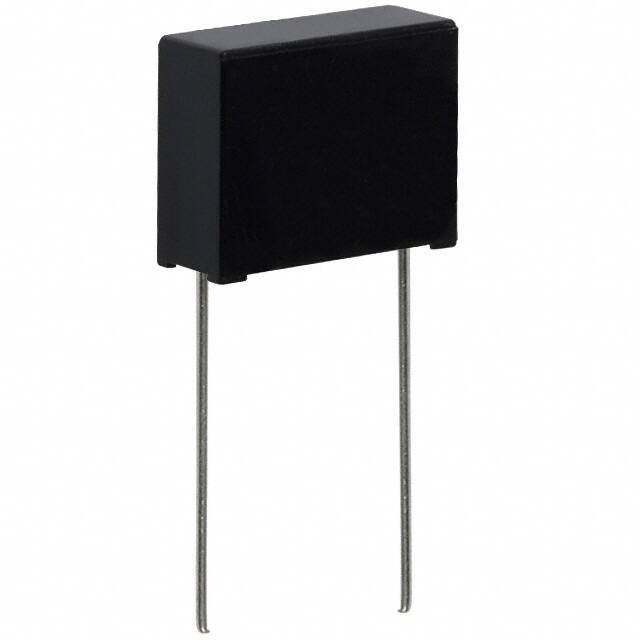

    薄膜电容 径向 56nF ±20% 17.50 x 7.00mm
ECQ-U2A563MV 数据手册
Panasonic Plastic Film Capacitors Interference Suppression Capacitor Metallized Polyester Type: ECQUV [Class X2] In accordance with UL/CSA and European safety regulations class X2 Features  •Compact •Overvoltage stress withstanding •Flame-retardant plastic case and non combustible resin Recommended Applications  Interference suppressors • Explanation of Part Numbers 1 2 3 4 5 6 E C Q U 2 A Product code Dielectric & construction 7 Rated voltage 8 9 10 11 V Capacitance Cap. Tol. Suffix K ±10% M ±20% ■Applicable Standard & Approval Number UL CSA SEMKO DEMKO NEMKO FIMKO VDE SEV Across-The-Line Capacitors Antenna-Coupling and Line-By-Pass Components UL 1283 Electromagnetic Interference Filters CSA C22.2 No.0, No.1 Across-the-line , Antenna-Isolation and line-by-pass capacitor UL 1414 IEC 384-14, 1993 EN 132400 Class X2 (0.001 to 1.0µF) Reg.No. 9642002/01-02 Ref.No. 304897 Ref.No. P96102878 Reg.No. 192438-01...02 File No. 4811. 6-4670-8101 Ref.No. 95, 7 71017, 02 File No. E62674 File No. E79502 File No. LR35752 Class Y2 (0.001 to 0.0068µF) Reg.No. 9642002/01-02 Ref.No. 304897 Ref.No. P96102878 Reg.No. 192438-01...02 File No. 4811. 6-4670-8102 Ref.No. 95, 7 71017, 03 .✕... When applying for the agency, please apply with not part cord but type designation and rating such as “ECQUV,0.1 µF”. ■Specifications Category temp. range – 40 to + 85˚C Rated voltage 250VAC (UL1414:125VAC) Capacitance range Capacitance tolerance 0.001 to 1.0µF(E12) ± 10%(K), ± 20%(M) Dissipation factor 1.0%max.(20˚C, 1kHz) Withstand voltage Between terminals : C = 0.0068µF : 1500VAC, 2121VDC 60s C > 0.0068µF : 1000VAC, 1768VDC 60s Between terminals to enclosure : 2000 VAC 60s Insulation resistance C< = 0.33µF : 15000MΩ min. (20˚C 100 VDC 60s) C > 0.33µF : 5000MΩ . µF min. 2000MΩ min. (20˚C 500VDC 60s) < Design, Specifications are subject to change without notice. Ask factory for technical specifications before purchase and/or use. Whenever a doubt about safety arises from this product, please inform us immediately for technical consultation without fail. Panasonic Plastic Film Capacitors ■Dimensions in mm (not to scale) Type 1 L Markong example Type 2 T T B side A side STYLE 1 0.001 to0.0068µF .001µF K ECQ-UV (250V/UL 1283) (125V/UL 1414) 40/085/21 2 0.0082 to 0.047µF .01µF K ECQ-UV (250V/UL 1283) (125V/UL 1414) 40/085/21 .056µF K 250V~ X2 ECQ-UV (250V/UL 1283) (125V/UL 1414) 40/085/21 C side 250V~X2 GPF 132400 MKT LL2 V 250V~X2 DE GPF 132400 MKT V DE H CASE : Either type 1 or type 2 20min. d±0.05 F±0.4 d±0.05 Solder-plated copper-clad steel wire 3 0.056 to 0.22µF A Q ECQ-UV 4 0.27 to 1.0µF B C LL2 GPF 132400 MKT LL2 V DE .27µF K 250V~ X2 V DE GPF 132400 MKT LL2 (250V/UL 1283) (125V/UL 1414) Date code 40/085/21 Note:Only±10% as cap.tol. to be marked as “K” (Tolerance of the lead exit point) ■Rating & Dimensions ● Capacitance tolerance : ± 10% (K), ± 2 0% (M) Part No. Cap. (µF) ECQU2A102 MV ECQU2A122 MV ECQU2A152 MV ECQU2A182 MV ECQU2A222 MV ECQU2A272 MV ECQU2A332 MV ECQU2A392 MV ECQU2A472 MV ECQU2A562 MV ECQU2A682 MV ECQU2A822 MV ECQU2A103 MV ECQU2A123 MV ECQU2A153 MV ECQU2A183 MV ECQU2A223 MV ECQU2A273 MV ECQU2A333 MV ECQU2A393 MV ECQU2A473 MV ECQU2A563 MV ECQU2A683 MV ECQU2A823 MV ECQU2A104 MV ECQU2A124 MV ECQU2A154 MV ECQU2A184 MV ECQU2A224 MV ECQU2A274 MV ECQU2A334 MV ECQU2A394 MV ECQU2A474 MV ECQU2A564 MV ECQU2A684 MV ECQU2A824 MV ECQU2A105 MV  0.001 0.0012 0.0015 0.0018 0.0022 0.0027 0.0033 0.0039 0.0047 0.0056 0.0068 0.0082 0.01 0.012 0.015 0.018 0.022 0.027 0.033 0.039 0.047 0.056 0.068 0.082 0.1 0.12 0.15 0.18 0.22 0.27 0.33 0.39 0.47 0.56 0.68 0.82 1.0 Dimensions (mm) L± 0.5 17.5 17.5 17.5 17.5 17.5 17.5 17.5 17.5 17.5 17.5 17.5 17.5 17.5 17.5 17.5 17.5 17.5 17.5 17.5 17.5 17.5 17.5 17.5 17.5 17.5 25.5 25.5 25.5 25.5 30.5 30.5 30.5 30.5 30.5 30.5 30.5 30.5 T± 0.5 4.0 4.0 4.0 4.0 4.0 4.0 4.0 4.0 4.0 4.0 4.0 4.0 4.0 4.0 4.0 4.5 4.5 4.5 4.5 5.5 5.5 7.0 7.0 8.0 8.0 6.5 6.5 8.5 8.5 10.0 10.0 12.0 12.0 13.5 13.5 16.5 16.5 H± 0.5 10.5 10.5 10.5 10.5 10.5 10.5 10.5 10.5 10.5 10.5 10.5 10.5 10.5 10.5 10.5 10.5 10.5 13.0 13.0 12.5 12.5 14.0 14.0 15.0 15.0 16.5 16.5 17.0 17.0 18.0 18.0 20.0 20.0 23.5 23.5 26.5 26.5 F 15.0 15.0 15.0 15.0 15.0 15.0 15.0 15.0 15.0 15.0 15.0 15.0 15.0 15.0 15.0 15.0 15.0 15.0 15.0 15.0 15.0 15.0 15.0 15.0 15.0 22.5 22.5 22.5 22.5 27.5 27.5 27.5 27.5 27.5 27.5 27.5 27.5 ød 0.60 0.60 0.60 0.60 0.60 0.60 0.60 0.60 0.60 0.60 0.60 0.60 0.60 0.60 0.60 0.60 0.60 0.60 0.60 0.60 0.60 0.60 0.60 0.60 0.80 0.80 0.80 0.80 0.80 0.80 0.80 0.80 0.80 0.80 0.80 0.80 0.80 Cap. tol. code Design, Specifications are subject to change without notice. Ask factory for technical specifications before purchase and/or use. Whenever a doubt about safety arises from this product, please inform us immediately for technical consultation without fail. P ± 0 0.5 0 ± 0.5 0 ± 0.5 0 ± 0.5 0 ± 0.5 0 ± 0.5 0 ± 0.5 0 ± 0.5 0 ± 0.5 0 ± 0.5 0 ± 0.5 0 ± 0.5 0 ± 0.5 0 ± 0.5 0 ± 0.5 0 ± 0.5 0 ± 0.5 0 ± 0.5 0 ± 0.5 0 ± 0.5 0 ± 0.5 0 ± 0.5 0 ± 0.5 0 ± 0.5 0 ± 0.5 0 ± 0.5 0 ± 0.5 0 ± 0.5 0 ± 0.5 0 ± 0.75 0 ± 0.75 0 ± 0.75 0 ± 0.75 0 ± 0.75 0 ± 0.75 0 ± 0.75 0 ± 0.75 Q +1.4 –0.6 1.3 1.3 1.3 1.3 1.3 1.3 1.3 1.3 1.3 1.3 1.3 1.3 1.3 1.3 1.3 1.3 1.3 1.3 1.3 1.3 1.3 1.3 1.3 1.3 1.3 1.5 1.5 1.5 1.5 1.5 1.5 1.5 1.5 1.5 1.5 1.5 1.5
ECQ-U2A563MV
1. 物料型号:松下塑料薄膜电容器,型号为ECQUV。 2. 器件简介:该电容器具有紧凑设计、耐过电压应力、阻燃塑料外壳和不可燃树脂。 3. 引脚分配:文档中未明确提供引脚分配信息,但提到了电容器的端点公差。 4. 参数特性: - 工作温度范围:-40至+85°C。 - 额定电压:250VAC(UL1414标准为125VAC)。 - 电容范围:0.001至1.0微法拉(E12系列)。 - 电容公差:±10%(K级),±20%(M级)。 - 损耗因子:最大1.0%(20°C,1kHz)。 - 耐压电压:C≤0.0068微法拉时1500VAC/2121VDC 60秒,C>0.0068微法拉时1000VAC/1768VDC 60秒。 - 绝缘电阻:C≤0.33微法拉至少15000MΩ,C>0.33微法拉至少5000MΩ。 5. 功能详解:适用于干扰抑制器、电磁干扰滤波器、天线耦合和线路旁路组件。 6. 应用信息:推荐用于干扰抑制器。 7. 封装信息:提供了两种类型的封装尺寸,以及标记示例和尺寸公差。
