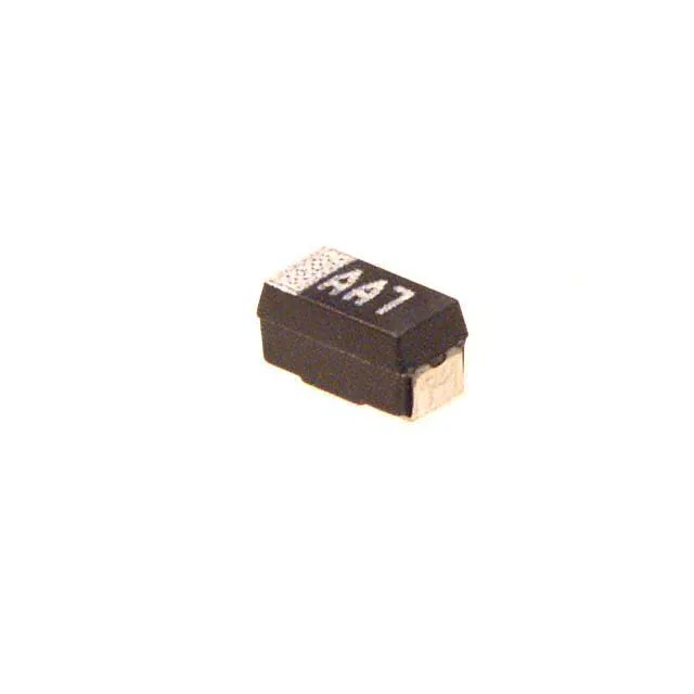

ECS-T1AY106R
ECS-T1AY106R
    NAIS(松下)
    1206(3216公制)
    钽电容 1206 10µF ±20% 10V - 3.20 x 1.60mm 1.60mm
ECS-T1AY106R 数据手册
Tantalum Solid Electrolytic Capacitors/TE Surface Mount Type Series: TE Type : T ■ Features Japan China Standard ■ Specifications Category temp. range -55 to 125°C 4 to 35 V .DC 0.15 to 330 µ F ±20 % (120Hz/20°C) Rated W.V. Range Nominal Cap. Range Capacitance Tolerance DC Leakage Current I < 0.01 CV or 0.5(µA) after 2 minutes application of rated working voltage at 20°C (whichever is greater) Please see the attached standard products list Resistance to Soldering Heat The capacitor shall withstand dipping into solder for 5±1 seconds at 260 ±5°C After 500 hours exposure at 40 °C and 90 to 95 % R.H. without load, the capacitor shall meet the following limits. Capacitance change ±10% of initial measured value Moisture Resistance < initial specified value, miniatured size: < 150% of initial specified value. tanδ DC leakage current < initial specified value After 2000 hours application of rated DC working voltage at 85°C or derated voltage at 125°C, the capacitor shall meet the following limits. Capacitance change ±10% of initial measured value Endurance tanδ < initial specified value DC leakage current < 125 % of initial specified value tanδ Polarity bar (+ side) ● Size X,C,V,D ❉ (for 6.3W.V. abbreviated to 6 V) Polarity Bar(+side) W.V.(V) L P 6.8 W Cap.(µF) (-) (+ ) 35 V Multiplier 105 106 107 2nd code 5 6 7 (Ex.) A6: 1.0 x 10 6 pF(1.0µF) J5: 2.2 x 10 5 pF(0.22µF) Cap. code W.V.code Dimensions in mm (not to scale) H ● Size Y ■ W.V. code W.V. (V) 4 6.3 10 16 20 25 code G J A C D E Capacitance code Capacitance(µF) 1 1.5 2.2 3.3 4.7 1st code A E J N S P w1 W2 Marking W2 ■ EIA code Size code L ±0.2 W1±0.2 W2±0.1 H±0.2 P±0.3 Y 3216 1.2 0.8 1.6 1.6 3.2 X 2.2 3528 0.8 1.9 2.8 3.5 C 2.2 6032 1.3 2.5 3.2 6.0 V 2.4 5846 1.3 3.2 4.6 5.8 D 2.4 7343 1.3 2.8 4.3 7.3 ❉ Each case side has different tereminal configuration ■ Case size W.V.(V.DC) 4(0G) 6.3(0J) 10(1A) 16(1C) 20(1D) 25(1E) Cap.(µF) Standard Miniature Standard Miniature Standard Miniature Standard Miniature Standard Miniature Standard Miniature 0.15 to 0.33 0.47 (474) 0.68 (684) 1.0 (105) 1.5 (155) 2.2 (225) 3.3 (335) 4.7 (475) 6.8 (685) 10 (106) 15 (156) 22 (226) 33 (336) 47 (476) 68 (686) 100 (107) 150 (157) 220 (227) 330 (337) Y Y Y Y Y Y X X C C D,V D,V D Y X C Y Y Y Y X X C C D,V D,V D Y Y X X C C Y Y Y Y X X C C D,V D,V D Y X X C Y Y Y Y Y X X C C D,V D,V D Y X C Y Y X X X C C D,V D,V Y Y X C Y Y X X X C C D,V D Y 35(1H) Standard Y Y Y Y X X X C C D,V D D D D Note : 1. ( )indicates the W.V. and capacitance code. 2. When selecting W.V. refer to page 20. 3. We recommend current sizes shown in the above table for new design, but conventional case size is available on request. 4. Other rating upon request (voltage, capacitance, tolerance, size) Rev.02/04 Design, Specifications are subject to change without notice. Ask factory for technical specifications before purchase and/or use. Whenever a doubt about safety arises from this product, please inform us immediately for technical consulation without fail.  EE27  Ta . TE Tantalum Solid Electrolytic Capacitors/TE ■ Standard Products Case Size W.V. Cap. (±20%) (V) (µF) Size Code L.C (µA) (mm) Part No. tan δ ESR (120Hz) (100kHz) (20°C) (20°C) (Ω) Min.Packaging Q'ty Taping (pcs) 4.7 3.2x1.6x1.6 Y 0.5 0.06 8.0 ECST0GY475R 2000 6.8 Y 0.5 0.06 6.0 ECST0GY685R 2000 3.2x1.6x1.6 10 3.2x1.6x1.6 Y 0.5 0.06 4.0 ECST0GY106R 2000 15 3.2x1.6x1.6 Y 0.6 0.06 4.0 ECST0GY156R 2000 22 3.2x1.6x1.6 Y 0.9 0.06 3.5 ECST0GY226R 2000 3.5x2.8x1.9 X 0.9 0.06 3.0 ECST0GX226R 2000 33 3.5x2.8x1.9 X 1.4 0.06 2.8 ECST0GX336R 2000 47 3.5x2.8x1.9 X 1.9 0.06 2.4 ECST0GX476R 2000 6.0x3.2x2.5 C 1.9 0.06 1.8 ECST0GC476R 750 68 6.0x3.2x2.5 C 2.8 0.06 1.6 ECST0GC686R 750 100 6.0x3.2x2.5 C 4.0 0.08 1.2 ECST0GC107R 750 5.8x4.6x3.2 V 4.0 0.08 1.0 ECST0GV107R 500 7.3x4.3x2.8 D 4.0 0.08 0.8 ECST0GD107R 750 4 150 5.8x4.6x3.2 V 6.0 0.08 1.0 ECST0GV157R 500 7.3x4.3x2.8 D 6.0 0.08 0.8 ECST0GD157R 750 220 7.3x4.3x2.8 D 8.8 0.12 0.7 ECST0GD227R 750 330 7.3x4.3x2.8 D 13.2 0.14 0.7 ECST0GD337R 750 3.3 3.2x1.6x1.6 Y 0.5 0.04 7.0 ECST0JY335R 2000 4.7 3.2x1.6x1.6 Y 0.5 0.06 6.0 ECST0JY475R 2000 6.8 3.2x1.6x1.6 Y 0.5 0.06 5.0 ECST0JY685R 2000 10 3.2x1.6x1.6 Y 0.7 0.06 4.0 ECST0JY106R 2000 15 3.2x1.6x1.6 Y 1.0 0.06 3.5 ECST0JY156R 2000 3.5x2.8x1.9 X 1.0 0.06 2.5 ECST0JX156R 2000 22 3.2x1.6x1.6 Y 1.4 0.08 3.0 ECST0JY226R 2000 3.5x2.8x1.9 X 1.4 0.06 2.5 ECST0JX226R 2000 33 3.5x2.8x1.9 X 2.1 0.06 2.2 ECST0JX336R 2000 6.0x3.2x2.5 C 2.1 0.06 1.8 ECST0JC336R 750 3.5x2.8x1.9 X 3.0 0.06 2.0 ECST0JX476R 2000 6.3 47 68 100 10 LxWxH Specification 6.0x3.2x2.5 C 3.0 0.06 1.6 ECST0JC476R 750 6.0x3.2x2.5 C 4.3 0.06 1.2 ECST0JC686R 750 5.8x4.6x3.2 V 4.3 0.06 1.0 ECST0JV686R 500 7.3x4.3x2.8 D 4.3 0.06 0.8 ECST0JD686R 750 6.0x3.2x2.5 C 6.3 0.08 1.2 ECST0JC107R 750 5.8x4.6x3.2 V 6.3 0.08 1.0 ECST0JV107R 500 7.3x4.3x2.8 D 6.3 0.08 0.8 ECST0JD107R 750 150 7.3x4.3x2.8 D 9.5 0.08 0.7 ECST0JD157R 750 220 7.3x4.3x2.8 D 13.9 0.12 0.7 ECST0JD227R 750 2.2 3.2x1.6x1.6 Y 0.5 0.04 7.0 ECST1AY225R 2000 3.3 3.2x1.6x1.6 Y 0.5 0.04 5.5 ECST1AY335R 2000 4.7 3.2x1.6x1.6 Y 0.5 0.06 5.0 ECST1AY475R 2000 6.8 3.2x1.6x1.6 Y 0.7 0.06 4.0 ECST1AY685R 2000 10 3.2x1.6x1.6 Y 1.0 0.06 3.0 ECST1AY106R 2000 3.5x2.8x1.9 X 1.0 0.06 2.5 ECST1A X106R 2000 15 3.5x2.8x1.9 X 1.5 0.06 2.8 ECST1AX156R 2000 22 3.5x2.8x1.9 X 2.2 0.06 2.4 ECST1AX226R 2000 6.0x3.2x2.5 C 2.2 0.06 1.8 ECST1AC226R 750 Design, Specifications are subject to change without notice. Ask factory for technical specifications before purchase and/or use. Whenever a doubt about safety arises from this product, please inform us immediately for technical consulation without fail.  EE28  Tantalum Solid Electrolytic Capacitors/TE ■ Standard Products W.V. Cap. (±20%) (V) (µF) 33 47 10 Size Code L.C (µA) (mm) Part No. ESR tan δ (120Hz) (100kHz) (20°C) (20°C) (Ω) Min.Packaging Q'ty Taping (pcs) 3.5x2.8x1.9 X 3.3 0.08 1.8 ECST1AX336R 2000 6.0x3.2x2.5 C 3.3 0.06 1.6 ECST1AC336R 750 6.0x3.2x2.5 C 4.7 0.06 1.2 ECST1AC476R 750 5.8x4.6x3.2 V 4.7 0.06 1.0 ECST1 AV476R 500 7.3x4.3x2.8 D 4.7 0.06 0.8 ECST1AD476R 750 5.8x4.6x3.2 V 6.8 0.06 1.0 ECST1A V686R 500 7.3x4.3x2.8 D 6.8 0.06 0.8 ECST1AD686R 750 100 7.3x4.3x2.8 D 10.0 0.08 0.7 ECST1AD107R 750 150 7.3x4.3x2.8 D 15.0 0.10 0.7 ECST1AD157R 750 1 3.2x1.6x1.6 Y 0.5 0.04 10.0 ECST1CY105R 2000 1.5 3.2x1.6x1.6 Y 0.5 0.04 8.0 ECST1CY155R 2000 2.2 3.2x1.6x1.6 Y 0.5 0.04 6.0 ECST1CY225R 2000 3.3 3.2x1.6x1.6 Y 0.6 0.04 5.0 ECST1CY335R 2000 4.7 3.2x1.6x1.6 Y 0.8 0.06 4.0 ECST1CY475R 2000 6.8 3.2x1.6x1.6 Y 1.1 0.08 5.0 ECST1CY685R 2000 3.5x2.8x1.9 X 1.1 0.06 2.5 ECST1CX685R 2000 3.5x2.8x1.9 X 1.6 0.06 2.8 ECST1CX106R 2000 15 3.5x2.8x1.9 X 2.4 0.06 2.5 ECST1CX156R 2000 6.0x3.2x2.5 C 2.4 0.06 1.8 ECST1CC156R 750 22 6.0x3.2x2.5 C 3.6 0.06 1.6 ECST1CC226R 750 33 6.0x3.2x2.5 C 5.3 0.06 1.2 ECST1CC336R 750 16 47 68 5.8x4.6x3.2 V 5.3 0.06 1.0 ECST1CV336R 500 7.3x4.3x2.8 D 5.3 0.06 0.8 ECST1CD336R 750 5.8x4.6x3.2 V 7.6 0.06 1.0 ECST1CV476R 500 7.3x4.3x2.8 D 7.6 0.06 0.8 ECST1CD476R 750 7.3x4.3x2.8 D 10.9 0.06 0.7 ECST1CD686R 750 0.68 3.2x1.6x1.6 Y 0.5 0.04 12.0 ECST1DY684R 2000 1.5 3.2x1.6x1.6 Y 0.5 0.04 6.5 ECST1DY155R 2000 2.2 3.2x1.6x1.6 Y 0.5 0.04 6.0 ECST1DY225R 2000 3.3 3.2x1.6x1.6 Y 0.7 0.04 5.5 ECST1DY335R 2000 3.5x2.8x1.9 X 0.7 0.04 3.0 ECST1DX335R 2000 4.7 3.2x1.6x1.6 Y 1.0 0.08 5.0 ECST1DY475R 2000 3.5x2.8x1.9 X 1.0 0.06 3.0 ECST1DX475R 2000 6.8 3.5x2.8x1.9 X 1.4 0.06 2.5 ECST1DX685R 2000 3.5x2.8x1.9 X 2.0 0.06 2.1 ECST1DX106R 2000 6.0x3.2x2.5 C 2.0 0.06 1.8 ECST1DC106R 750 15 6.0x3.2x2.5 C 3.0 0.06 1.7 ECST1DC156R 750 22 6.0x3.2x2.5 C 4.4 0.08 1.2 ECST1DC226R 750 5.8x4.6x3.2 V 4.4 0.06 1.0 ECST1DV226R 500 7.3x4.3x2.8 D 4.4 0.06 0.8 ECST1DD226R 750 5.8x4.6x3.2 V 6.6 0.06 0.9 ECST1DV336R 500 7.3x4.3x2.8 D 6.6 0.06 0.7 ECST1DD336R 750 10 33 25 LxWxH Specification 68 10 20 Case Size 0.47 3.2x1.6x1.6 Y 0.5 0.04 14.0 ECST1EY474R 2000 1 3.2x1.6x1.6 Y 0.5 0.04 8.0 ECST1EY105R 2000 1.5 3.2x1.6x1.6 Y 0.5 0.04 7.5 ECST1EY155R 2000 Design, Specifications are subject to change without notice. Ask factory for technical specifications before purchase and/or use. Whenever a doubt about safety arises from this product, please inform us immediately for technical consulation without fail.  EE29  Ta . TE Tantalum Solid Electrolytic Capacitors/TE ■ Standard Products W.V. Cap. (±20%) (V) (µF) 2.2 25 LxWxH Specification Size Code L.C (µA) (mm) Part No. tan δ ESR (120Hz) (100kHz) (20°C) (20°C) (Ω) Min.Packaging Q'ty Taping (pcs) 3.2x1.6x1.6 Y 0.6 0.06 7.0 ECST1EY225R 2000 3.5x2.8x1.9 X 0.6 0.04 4.5 ECST1EX225R 2000 3.3 3.5x2.8x1.9 X 0.9 0.04 3.5 ECST1EX335R 2000 4.7 3.5x2.8x1.9 X 1.2 0.06 2.8 ECST1EX475R 2000 6.8 6.0x3.2x2.5 C 1.7 0.06 1.9 ECST1EC685R 750 10 6.0x3.2x2.5 C 2.5 0.06 1.5 ECST1EC106R 750 15 5.8x4.6x3.2 V 3.8 0.06 1.2 ECST1EV156R 500 7.3x4.3x2.8 D 3.8 0.06 1.0 ECST1ED156R 750 7.3x4.3x2.8 D 5.5 0.06 0.7 ECST1ED226R 750 0.15 3.2x1.6x1.6 Y 0.5 0.04 19.0 ECST1VY154R 2000 22 35 Case Size 0.22 3.2x1.6x1.6 Y 0.5 0.04 18.0 ECST1VY224R 2000 0.33 3.2x1.6x1.6 Y 0.5 0.04 15.0 ECST1VY334R 2000 0.47 3.2x1.6x1.6 Y 0.5 0.04 12.0 ECST1VY474R 2000 ECST1VY684R 2000 0.68 3.2x1.6x1.6 Y 0.5 0.04 8.0 1 3.2x1.6x1.6 Y 0.5 0.04 7.5 ECST1VY105R 2000 1.5 3.5x2.8x1.9 X 0.6 0.04 5.0 ECST1VX155R 2000 2.2 3.5x2.8x1.9 X 0.8 0.04 4.0 ECST1VX225R 2000 3.3 3.5x2.8x1.9 X 1.2 0.04 3.5 ECST1VX335R 2000 4.7 6.0x3.2x2.5 C 1.7 0.06 2.0 ECST1VC475R 750 6.8 6.0x3.2x2.5 C 2.4 0.06 1.8 ECST1VC685R 750 5.8x4.6x3.2 V 3.5 0.06 1.2 ECST1VV106R 500 7.3x4.3x2.8 D 3.5 0.06 1.0 ECST1VD106R 750 7.3x4.3x2.8 D 5.3 0.06 0.8 ECST1VD156R 750 10 15 Design, Specifications are subject to change without notice. Ask factory for technical specifications before purchase and/or use. Whenever a doubt about safety arises from this product, please inform us immediately for technical consulation without fail.  EE30 
