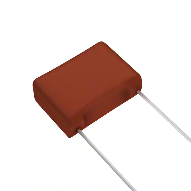

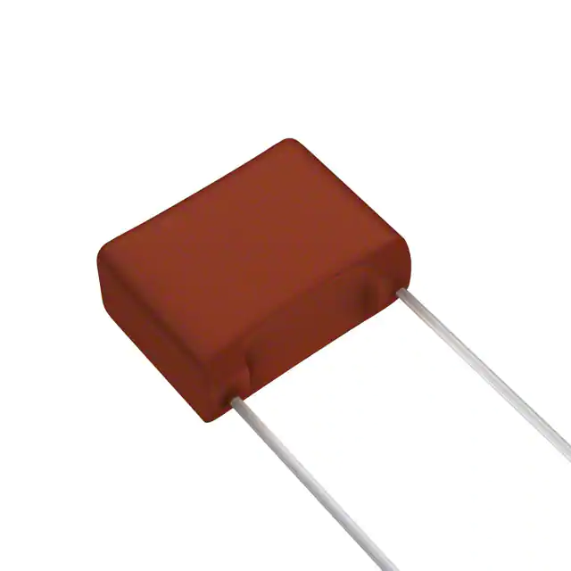

    薄膜电容 径向 270nF ±5% 18.20 x 7.80mm
