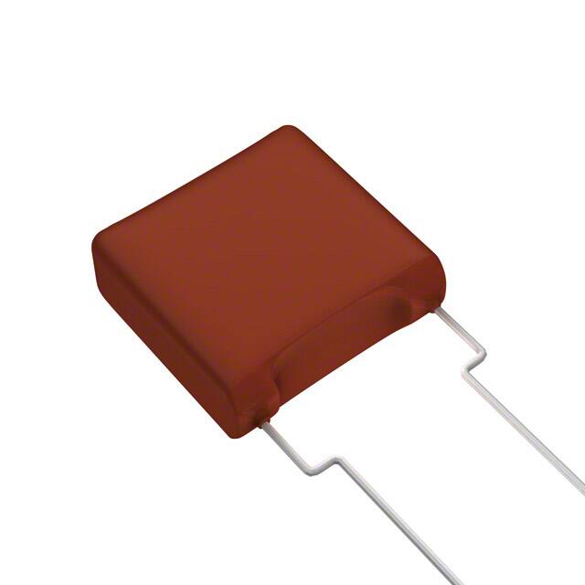

    薄膜电容 径向 270nF ±5% 18.20 x 7.80mm
ECW-FA2J274JB 数据手册
Plastic Film Capacitors Metallized Polypropylene Film Capacitor Type : ECWF(A) Non-inductive construction using metallized polypropylene film with flame retardant epoxy resin coating. Features ● Small size frequency characteristics ● Low loss ● Low Hum Sound Noise ● 85 degree C , 85 %RH , 500 V.DC , 500 hours (630 V.DC) ● RoHS directive compliant ● Excellent Recommended applications ● 250 ● 450 V.DC, 630 V.DC : High frequency and high current circuits V.DC : Active filter circuits Explanation of part number ● 250 V.DC, 450 V.DC (Bulk) 1 2 3 4 E C W F Product code Dielectric & construction 5 6 Rated voltage 2W 9 10 11 12 Capacitance 250 V.DC 450 V.DC Cap. Tol. Suffix Suffix H ±3 % Code J ±5 % Blank Straight J ±5 % B Crimped lead K ±10 % Q Crimped lead C Cut lead Lead Form V.DC, 450 V.DC (Odd size taping) 1 2 3 4 E C W F Product code ● 630 8 A 2 ● 250 7 Dielectric & construction 5 6 7 8 9 10 11 R Rated voltage Capacitance 12 A Suffix Cap. Tol. Suffix 10 11 12 V.DC (Bulk, Odd size taping) 1 2 3 4 5 6 7 E C W F A 2 J Product code Dielectric & construction 8 9 J Rated voltage 2J 630 V.DC Capacitance J ±5 % Cap. Tol. Code Suffix Lead Form Blank Straight B Crimped lead Q Crimped lead C Cut lead 4 Odd size taping Design and specifications are each subject to change without notice. Ask factory for the current technical specifications before purchase and/or use. Should a safety concern arise regarding this product, please be sure to contact us immediately. 01 Feb. 2016 Plastic Film Capacitors Specifications Category temp. range (Including temperature-rise on unit surface) Rated voltage Capacitance range Capacitance tolerance Dissipation factor (tan d) Withstand voltage Insulation resistance (IR) – 40 °C to +105 °C 250 V.DC 450 V.DC (Derating of rated voltage by 1.25%/°C at more than 85 °C) Peak to peak voltage applied on the capacitor should be less than 240 Vp-p, and zero to peak voltage should be less than 450 Vo-p. 630 V.DC (Derating of rated voltage by 1.0%/°C at more than 85 °C) 250 V.DC 0.1 μF to 6.8 μF 450 V.DC 0.1 μF to 4.7 μF 630 V.DC 0.1 μF to 2.2 μF 250 V.DC ±3 %(H), ±5 %(J) 450 V.DC ±5 %(J), ±10 %(K) 630 V.DC ±5 %(J) tan d < 0.1 % (20 °C, 1 kHz) Between terminals : Rated volt. (V.DC)×150 %, 60 s C < 0.33 μF : IR > 9000 MΩ 250 V.DC (20 °C, 100 V.DC, 60 s) C > 0.33 μF : IR > 3000 MΩ ∙ μF C < 0.33 μF : IR > 30000 MΩ 450 V.DC (20 °C, 100 V.DC, 60 s) C > 0.33 μF : IR > 10000 MΩ ∙ μF C < 0.33 μF : IR > 9000 MΩ 630 V.DC (20 °C, 500 V.DC, 60 s) C > 0.33 μF : IR > 3000 MΩ ∙ μF ✽ In case of applying voltage in alternating current (50 Hz or 60 Hz sine wave) to a capacitor with DC rated voltage, please refer to the page of “Permissible voltage (R.M.S) in alternating current corresponding to DC rated voltage”. Dimensions Straight Crimped lead (Suffix B) Crimped lead (Suffix Q) L max. L max. Cut lead (Suffix C) 4.5±0.5 4.5±0.5 0d±0.05 Copper-wire or Copper-clad steel-wire Marking 4.5±0.5 Marking H max. H max. Marking F±1.0 25 min. G max. Marking H max. T max. L max. S±0.8 S±0.8 Style B Style D Unit : mm Packaging specifications for bulk package ● Packing quantity : 100 pcs./bag Design and specifications are each subject to change without notice. Ask factory for the current technical specifications before purchase and/or use. Should a safety concern arise regarding this product, please be sure to contact us immediately. 01 Feb. 2016 Plastic Film Capacitors Taping specifications for automatic insertion style Style E P P H1 Style D P F F H0 H0 H0 F Style F H1 H1 ● Taping P0 P0 P0 ✽ Refer to the page of taping specifications. ● Packaging ● Lead specifications Taping style Rated voltage Capacitance range Type (V.DC) (μF) AD AS B C D E F ◯ 0.10 to 0.47 250 ◯ 0.56 to 3.9 ◯ 0.10 to 0.47 ECWF(A) 450 ◯ 0.56 to 2.2 ◯ 630 0.10 to 0.68 Packing Ammo suffix R( ) A Style D E F spacing Lead spacing 7.5 mm 7.5 mm 7.5 mm J4 Rating · Dimensions · Quantity ● Rated voltage : 250 V.DC, Capacitance tolerance : ± 3 %(H), ±5 %(J) Cap. (μF) Part No. ECWF2104◻A( ECWF2124◻A( ECWF2154◻A( ECWF2184◻A( ECWF2224◻A( ECWF2274◻A( ECWF2334◻A( ECWF2394◻A( ECWF2474◻A( ECWF2564◻A( ECWF2684◻A( ECWF2824◻A( ECWF2105◻A( ECWF2125◻A( ECWF2155◻A( ECWF2185◻A( ECWF2225◻A( ECWF2275◻A( ECWF2335◻A( ECWF2395◻A( ECWF2475◻A( ECWF2565◻A( ECWF2685◻A( ) ) ) ) ) ) ) ) ) ) ) ) ) ) ) ) ) ) ) ) ) ) ) 0.10 0.12 0.15 0.18 0.22 0.27 0.33 0.39 0.47 0.56 0.68 0.82 1.0 1.2 1.5 1.8 2.2 2.7 3.3 3.9 4.7 5.6 6.8 L max. T max. 13.0 13.0 13.0 13.0 13.0 13.0 13.0 13.0 13.0 18.1 18.1 18.1 18.1 18.8 18.8 18.8 18.8 23.8 23.8 23.8 23.8 23.8 23.8 5.0 5.3 5.6 5.9 6.3 6.8 7.3 7.8 8.4 6.9 7.4 8.0 8.5 9.5 10.5 11.4 12.6 11.4 12.5 13.5 14.8 16.2 17.8 Straight – 13.3 14.6 15.6 16.5 17.6 17.2 18.3 19.3 20.6 21.9 23.5 Dimensions (mm) H max. F S G max. Crimped lead Crimped lead Crimped lead Crimped lead Straight Straight (Suffix B) (Suffix Q) (Suffix B) (Suffix Q) 14.1 14.1 7.5 10.0 14.4 14.4 7.5 10.0 14.7 14.7 7.5 10.0 15.1 15.1 7.5 10.0 15.4 15.4 7.5 10.0 15.9 15.9 7.5 10.0 – – 16.4 16.4 7.5 10.0 16.9 16.9 7.5 10.0 17.6 17.6 7.5 10.0 16.4 18.4 7.5 15.0 17.0 19.0 7.5 15.0 17.6 19.6 7.5 15.0 18.3 20.3 15.0 7.5 15.0 1.5 19.6 21.6 15.0 7.5 15.0 1.5 20.6 22.6 15.0 7.5 15.0 1.5 21.5 23.5 15.0 7.5 15.0 1.5 22.6 24.6 15.0 7.5 15.0 1.5 22.2 24.2 20.0 12.5 20.0 1.5 23.3 25.3 20.0 12.5 20.0 1.5 24.3 26.3 20.0 12.5 20.0 1.5 25.6 27.6 20.0 12.5 20.0 1.5 26.9 28.9 20.0 12.5 20.0 1.5 28.5 30.5 20.0 12.5 20.0 1.5 fd 0.6 0.6 0.6 0.6 0.6 0.6 0.6 0.6 0.6 0.8 0.8 0.8 0.8 0.8 0.8 0.8 0.8 0.8 0.8 0.8 0.8 0.8 0.8 Min. order Q'ty Taping Bulk 7.5 mm 1300 1200 1100 1000 900 800 700 400 500 300 200 300 200 – ✽ ◻ : Capacitance tolerance code ( ) : Suffix for lead crimped Design and specifications are each subject to change without notice. Ask factory for the current technical specifications before purchase and/or use. Should a safety concern arise regarding this product, please be sure to contact us immediately. 01 Feb. 2016 Plastic Film Capacitors Rating · Dimensions · Quantity ● Rated voltage : 450 V.DC, Capacitance tolerance : ± 5 %(J), ±10 %(K) Cap. (μF) Part No. ECWF2W104◻A( ECWF2W124◻A( ECWF2W154◻A( ECWF2W184◻A( ECWF2W224◻A( ECWF2W274◻A( ECWF2W334◻A( ECWF2W394◻A( ECWF2W474◻A( ECWF2W564◻A( ECWF2W684◻A( ECWF2W824◻A( ECWF2W105◻A( ECWF2W125◻A( ECWF2W155◻A( ECWF2W185◻A( ECWF2W225◻A( ECWF2W275◻A( ECWF2W335◻A( ECWF2W395◻A( ECWF2W475◻A( ) ) ) ) ) ) ) ) ) ) ) ) ) ) ) ) ) ) ) ) ) 0.10 0.12 0.15 0.18 0.22 0.27 0.33 0.39 0.47 0.56 0.68 0.82 1.0 1.2 1.5 1.8 2.2 2.7 3.3 3.9 4.7 L max. T max. 13.0 13.0 13.0 13.0 13.0 13.0 13.0 13.0 13.0 18.1 18.1 18.1 18.1 18.8 18.8 18.8 18.8 26.3 26.3 26.3 26.3 5.1 5.4 5.7 6.1 6.5 7.0 7.6 8.1 8.7 7.0 7.5 8.2 9.3 9.7 10.7 11.6 12.8 10.6 11.7 12.6 13.8 Straight – 11.5 12.1 12.7 12.6 14.7 15.8 16.7 17.9 16.5 17.5 18.4 19.6 Dimensions (mm) H max. S F Crimped lead Crimped lead Crimped lead Crimped lead G max. (Suffix B) (Suffix Q) (Suffix B) (Suffix Q) 14.3 14.3 7.5 10.0 1.5 14.5 14.5 7.5 10.0 1.5 14.9 14.9 7.5 10.0 1.5 15.2 15.2 7.5 10.0 1.5 15.6 15.6 7.5 10.0 1.5 – 16.1 16.1 7.5 10.0 1.5 16.7 16.7 7.5 10.0 1.5 17.2 17.2 7.5 10.0 1.5 17.9 17.9 7.5 10.0 1.5 16.5 18.5 15.0 7.5 15.0 1.5 17.1 19.1 15.0 7.5 15.0 1.5 17.7 19.7 15.0 7.5 15.0 1.5 17.6 19.6 15.0 7.5 15.0 1.5 19.7 21.7 15.0 7.5 15.0 1.5 20.8 22.8 15.0 7.5 15.0 1.5 21.7 23.7 15.0 7.5 15.0 1.5 22.9 24.9 15.0 7.5 15.0 1.5 21.5 23.5 22.5 15.0 22.5 1.5 22.5 24.5 22.5 15.0 22.5 1.5 23.4 25.4 22.5 15.0 22.5 1.5 24.6 26.6 22.5 15.0 22.5 1.5 fd 0.6 0.6 0.6 0.6 0.6 0.6 0.6 0.6 0.6 0.8 0.8 0.8 0.8 0.8 0.8 0.8 0.8 0.8 0.8 0.8 0.8 Min. order Q'ty Taping Bulk 7.5 mm 1200 1000 800 600 400 500 300 200 – ✽ ◻ : Capacitance tolerance code ( ) : Suffix for lead crimped ● Rated voltage : 630 V.DC, Capacitance tolerance : ± 5 %(J) Cap. (μF) L max. T max. Part No. ECWFA2J104J( ECWFA2J124J( ECWFA2J154J( ECWFA2J184J( ECWFA2J224J( ECWFA2J274J( ECWFA2J334J( ECWFA2J394J( ECWFA2J474J( ECWFA2J564J( ECWFA2J684J( ECWFA2J824J( ECWFA2J105J( ECWFA2J125J( ECWFA2J155J( ECWFA2J185J( ECWFA2J225J( ) ) ) ) ) ) ) ) ) ) ) ) ) ) ) ) ) 0.10 0.12 0.15 0.18 0.22 0.27 0.33 0.39 0.47 0.56 0.68 0.82 1.0 1.2 1.5 1.8 2.2 18.2 18.2 18.2 18.2 18.2 18.2 18.2 18.2 18.2 18.2 18.2 26.0 26.0 26.0 26.0 26.0 26.0 5.2 5.5 6.0 6.5 7.1 7.8 8.5 9.2 10.0 10.9 12.0 10.1 11.1 12.1 13.5 14.8 16.3 Straight 10.4 10.8 11.2 11.7 12.3 12.9 13.6 14.3 15.1 16.0 17.1 15.3 16.2 17.2 18.6 19.8 21.4 Dimensions (mm) H max. S F Crimped lead Crimped lead Crimped lead Crimped lead G max. (Suffix B) (Suffix Q) (Suffix B) (Suffix Q) 15.4 15.4 15.0 7.5 15.0 1.5 15.8 15.8 15.0 7.5 15.0 1.5 16.2 16.2 15.0 7.5 15.0 1.5 16.7 16.7 15.0 7.5 15.0 1.5 17.3 17.3 15.0 7.5 15.0 1.5 17.9 17.9 15.0 7.5 15.0 1.5 18.6 18.6 15.0 7.5 15.0 1.5 19.3 19.3 15.0 7.5 15.0 1.5 20.1 20.1 15.0 7.5 15.0 1.5 21.0 21.0 15.0 7.5 15.0 1.5 22.1 22.1 15.0 7.5 15.0 1.5 20.3 22.3 22.5 15.0 22.5 1.5 21.2 23.2 22.5 15.0 22.5 1.5 22.2 24.2 22.5 15.0 22.5 1.5 23.6 25.6 22.5 15.0 22.5 1.5 24.8 26.8 22.5 15.0 22.5 1.5 26.4 28.4 22.5 15.0 22.5 1.5 fd 0.6 0.6 0.6 0.6 0.6 0.6 0.6 0.6 0.6 0.6 0.6 0.8 0.8 0.8 0.8 0.8 0.8 Min. order Q'ty Taping Bulk Crimped 7.5 mm Straight lead 600 500 400 1000 1000 300 200 − 800 600 500 400 600 500 ✽ ( ) : Suffix for lead crimped Design and specifications are each subject to change without notice. Ask factory for the current technical specifications before purchase and/or use. Should a safety concern arise regarding this product, please be sure to contact us immediately. 01 Feb. 2016

物料型号:ECWF(A)系列,包括不同额定电压和电容值的型号。
器件简介:这是Panasonic生产的金属化聚丙烯薄膜电容器,具有阻燃环氧树脂涂层的非感性结构。
引脚分配:提供了直引脚、压接引脚和剪切引脚的选项,具体分配根据电容器的型号和封装而变化。
参数特性: - 工作温度范围:-40°C 至 +105°C - 额定电压:250V.DC、450V.DC(85°C以上每摄氏度降低额定电压1.25%)、630V.DC(85°C以上每摄氏度降低额定电压1.0%) - 电容范围:从0.1μF至6.8μF,具体取决于额定电压 - 电容公差:±3%(H)、±5%(J)、±10%(K) - 损耗角正切:在20°C和1kHz时为0.1%
功能详解:这些电容器适用于高频和高电流电路(250V.DC和630V.DC)、有源滤波电路(450V.DC)。
应用信息:推荐用于高频和高电流电路、有源滤波电路。
封装信息:提供了直引脚、压接引脚和剪切引脚的不同封装选项,具体尺寸和标记方式在文档中有详细说明。
