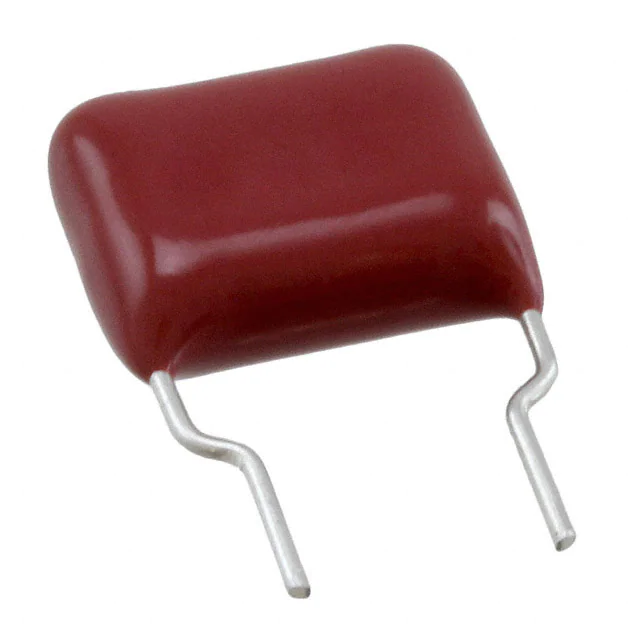

    薄膜电容 径向 1.8µF ±5% 17.50 x 10.10mm
ECW-FD2W185J4 数据手册
Plastic Film Capacitors Metallized Polypropylene Film Capacitor ECWFD series Non-inductive construction using metallized polypropylene film with flame retardant epoxy resin coating Features ● Small size ● Excellent frequency characteristics ● Low loss ● Flame-retardant epoxy resin coating ● Low hum sound noise ● RoHS compliant Recommended applications ● Active filter circuit ● High frequency circuit Explanation of part number ■ Standard product 1 2 3 4 5 E C W F D Product code 6 Dielectric & construction 7 8 Rated voltage 9 10 Capacitance 2 3 4 5 E C W F D Product code 12 Cap. Tol. Suffix Code R.voltage [DC] Code Cap. Tol. Code 2W 450 V J ±5 % Blank Straight 2J 630 V K ±10 % B Crimped lead Q Crimped lead C Cut lead 3 Crimped taping (Ammo) 4 Odd size taping ■ Short lead space product 450 V (0.47 μF, 0.68 μF, 1.0 μF), 630 V (1.0 μF) 1 11 6 Dielectric & construction 7 Rated voltage 8 9 10 Capacitance 11 12 Cap. Tol. Suffix Lead form Code R.voltage [DC] Code Cap. Tol. Code 2W 450 V P ±5 %(J) 1 Straight 2J 630 V Q ±10 %(K) B Crimped lead Q Crimped lead Design and specifications are each subject to change without notice. Ask factory for the current technical specifications before purchase and/or use. Should a safety concern arise regarding this product, please be sure to contact us immediately. Lead form C Cut lead 3 Crimped taping (Ammo) 4 Odd size taping 31-Jul-19 ECWFD series Specifications Category temp. range (Including temperature-rise on unit surface) 450 V 630 V −40 ℃ to +110 ℃ −40 ℃ to +105 ℃ Peak to peak voltage applied on the capacitor should be less than 240 Vp-p, and zero to peak voltage should be less than 450 Vo-p. (Derating of rated voltage by 0.62 %/°C at more than 85 °C) Peak to peak voltage applied on the capacitor should be less than 400 Vp-p, and zero to peak voltage should be less than 630 Vo-p. (Derating of rated voltage by 1.0%/°C at more than 85 °C) 0.1 μF to 4.7 μF 0.01 μF to 4.7 μF ±5% (J), ±10 % (K) tan δ ≦ 0.1 % (20 °C, 1 kHz) Between terminals : Rated voltage (V)×150 % 60 s  C ≦ 0.33 μF:IR ≧ 30,000 MΩ (20 °C, 100 V, 60 s)  C > 0.33 μF:IR ≧ 10,000 MΩ・μF  C ≦ 0.33 μF:IR ≧ 9,000 MΩ (20 °C, 500 V , 60 s)  C > 0.33 μF:IR ≧ 3,000 MΩ・μF 450 V Rated voltage [DC] 630 V 450 V 630 V Capacitance range Capacitance tolerance Dissipation factor (tan δ) Withstand voltage 450 V Insulation resistance (IR) 630 V *: In case of applying voltage in alternating current (50 Hz or 60 Hz sine wave) to a capacitor with DC rated voltage, please refer to the page of “Permissible voltage (R.M.S) in alternating current corresponding to DC rated voltage”. Dimensions Marking Marking ød±0.05 Copper-clad steel-wire Marking H max. L max. 4.5±0.5 25 min. F±1.0 L max. Cut lead(Suffix C) 4.5±0.5 Marking Crimped lead (Suffix Q) 4.5±0.5 H max. T max. Type D H max. L max. G max. Crimped lead (Suffix B) Type B Straight S±0.8 S±0.8 Packaging specifications for bulk package ■ Packing quantity : 100 pcs./bag Taping specifications for automatic insertion ■ Taping style P P0 P0 Unit:mm P P0 F H0 H1* F H0 F H0 H0 F H1 Style F P H1 Style E P H1 Style AB P0 AB 12.7 12.7 5.0 16.0 34.0 Style E 30.0 15.0 7.5 16.0 44.0 F 15.0 15.0 7.5 16.0 44.0 *:max. *: H1 dimension is based on insertion machine “Panasert RH series” made by Panasonic. Consult with Panasonic technical staff when using other insertion machines. ■ Packaging specifications Series R. voltage (V) [DC] 450 ECWFD 630 Capacitance range (μF) 0.10 to 0.39 0.47, 0.68, 1.0 0.10 to 0.39 0.47, 0.68, 1.0 0.47 to 2.2 0.047 to 0.22 0.27 to 0.82 1 ● Lead spacing AB 〇 〇 Taping style E 〇 〇 〇 F Packing suffix Style Lead spacing Crimped taping 3 P3/Q3 4 P4/Q4 4 4 4 P4/Q4 AB E F 5.0 7.5 7.5 〇 〇 Odd size taping 〇 Odd size taping Unit:mm See the column “Rating ·Dimensions · Quantity” for packaging quantity Design and specifications are each subject to change without notice. Ask factory for the current technical specifications before purchase and/or use. Should a safety concern arise regarding this product, please be sure to contact us immediately. 31-Jul-19 ECWFD series Rating · Dimensions · Quantity ■ Rated voltage [DC] : 450 V, Capacitance tolerance : ±5 %(J), ± 10 %(K) Dimensions (mm) Part No. Cap. (μF) L H max. T max. max. Straight Min. order Q'ty (PCS) S Crimped lead (Suffix B) Crimped lead (Suffix Q) F Crimped lead (Suffix B) Crimped lead (Suffix Q) G max. Taping ød Bulk Standard 5.0 mm Odd size 7.5 mm 1500 1400 ECWFD2W104□( ) 0.10 12.6 4.5 13.9 13.9 7.5 10.0 0.6 ECWFD2W124□( ) 0.12 12.6 4.6 14.0 14.0 7.5 10.0 0.6 ECWFD2W154□( ) 0.15 12.6 4.6 14.1 14.1 7.5 10.0 0.6 ECWFD2W184□( ) 0.18 12.6 4.8 14.3 14.3 7.5 10.0 ECWFD2W224□( ) 0.22 12.6 5.0 14.6 14.6 7.5 10.0 ECWFD2W274□( ) 0.27 12.6 5.3 15.0 15.0 7.5 10.0 0.6 1300 ECWFD2W334□( ) 0.33 12.6 5.6 15.4 15.4 7.5 10.0 0.6 1200 1100 ECWFD2W394□( ) 0.39 12.6 6.0 15.7 15.7 7.5 10.0 0.6 1100 1000 0.47 12.6 6.5 11.2 16.2 16.2 10.0 7.5 10.0 1.5 0.6 1000 900 ECWFD2W474□( ) 0.47 17.5 5.8 9.0 14.0 16.0 15.0 7.5 15.0 1.5 0.8 ECWFD2W564□( ) 0.56 17.5 6.2 9.4 14.4 16.4 15.0 7.5 15.0 1.5 0.8 – 500 0.68 12.6 7.7 12.4 17.4 17.4 10.0 7.5 10.0 1.5 0.6 800 700 ECWFD2W684□( ) 0.68 17.5 6.7 9.9 14.9 16.9 15.0 7.5 15.0 1.5 0.8 ECWFD2W824□( ) 0.82 17.5 7.2 10.4 15.4 17.4 15.0 7.5 15.0 1.5 0.8 – 400 1.0 12.6 9.2 13.9 18.9 18.9 10.0 7.5 10.0 1.5 0.6 ECWFD2W105□( ) 1.0 17.5 7.8 11.0 16.0 18.0 15.0 7.5 15.0 1.5 0.8 ECWFD2W125□( ) 1.2 17.5 8.5 11.6 16.6 18.6 15.0 7.5 15.0 1.5 0.8 ECWFD2W155□( ) 1.5 17.5 9.3 12.5 17.5 19.5 15.0 7.5 15.0 1.5 0.8 ECWFD2W185□( ) 1.8 17.5 10.1 13.3 18.3 20.3 15.0 7.5 15.0 1.5 0.8 ECWFD2W225□( ) 2.2 17.5 11.1 14.3 19.3 21.3 15.0 7.5 15.0 1.5 0.8 ECWFD2W275□( ) 2.7 25.3 9.0 13.7 18.7 20.7 22.5 15.0 22.5 1.5 0.8 ECWFD2W335□( ) 3.3 25.3 9.8 14.6 19.6 21.6 22.5 15.0 22.5 1.5 0.8 ECWFD2W395□( ) 3.9 25.3 10.7 15.4 20.4 22.4 22.5 15.0 22.5 1.5 0.8 ECWFD2W475□( ) 4.7 25.3 11.7 16.4 21.4 23.4 22.5 15.0 22.5 1.5 0.8 ECWFD2W474P( ) ECWFD2W474Q( ) ECWFD2W684P( ) ECWFD2W684Q( ) ECWFD2W105P( ) ECWFD2W105Q( ) *□:Capacitance tolerance code *( ):Suffix for lead crimped – – – 0.6 0.6 1400 1300 Straight Crimped lead – 1200 1000 1000 700 600 400 300 – 200 – 800 600 600 Note) Part number marked with bold is short lead space product. Design and specifications are each subject to change without notice. Ask factory for the current technical specifications before purchase and/or use. Should a safety concern arise regarding this product, please be sure to contact us immediately. 31-Jul-19 ECWFD series Rating · Dimensions · Quantity ■ Rated voltage [DC] : 630 V, Capacitance tolerance : ±5 %(J), ± 10 %(K) Dimensions (mm) Part No. Cap. (μF) L H max. T max. max. Straight Crimped lead (Suffix B) Min. order Q'ty (PCS) S Crimped lead (Suffix Q) F Crimped lead (Suffix B) Crimped lead (Suffix Q) G max. Taping ød ECWFD2J103□( ) 0.01 12.6 4.9 8.0 8.0 7.5 10.0 0.6 ECWFD2J123□( ) 0.012 12.6 5.2 8.2 8.2 7.5 10.0 0.6 ECWFD2J153□( ) 0.015 12.6 5.6 8.6 8.6 7.5 10.0 0.6 ECWFD2J183□( ) 0.018 12.6 5.9 9.0 9.0 7.5 10.0 ECWFD2J223□( ) 0.022 12.6 6.4 9.4 9.4 7.5 10.0 ECWFD2J273□( ) 0.027 12.6 6.9 9.9 9.9 7.5 10.0 0.6 ECWFD2J333□( ) 0.033 12.6 7.5 10.5 10.5 7.5 10.0 0.6 ECWFD2J393□( ) 0.039 12.6 8.0 11.0 11.0 7.5 10.0 0.6 ECWFD2J473□( ) 0.047 12.6 4.4 12.8 12.8 7.5 10.0 0.6 ECWFD2J563□( ) 0.056 12.6 4.7 13.1 13.1 7.5 10.0 0.6 ECWFD2J683□( ) 0.068 12.6 5.0 13.4 13.4 7.5 10.0 0.6 ECWFD2J823□( ) 0.082 12.6 5.4 13.7 13.7 ECWFD2J104□( ) 0.10 12.6 5.8 14.2 14.2 ECWFD2J124□( ) 0.12 12.6 6.2 14.6 14.6 7.5 10.0 0.6 ECWFD2J154□( ) 0.15 12.6 6.8 15.2 15.2 7.5 10.0 0.6 ECWFD2J184□( ) 0.18 12.6 7.4 15.7 15.7 7.5 10.0 0.6 ECWFD2J224□( ) 0.22 12.6 8.1 16.4 16.4 7.5 10.0 0.6 ECWFD2J274□( ) 0.27 17.8 6.0 11.0 16.0 18.0 15.0 7.5 15.0 1.5 0.8 ECWFD2J334□( ) 0.33 17.8 6.6 11.5 16.5 18.5 15.0 7.5 15.0 1.5 0.8 ECWFD2J394□( ) 0.39 17.8 7.1 12.0 17.0 19.0 15.0 7.5 15.0 1.5 0.8 ECWFD2J474□( ) 0.47 17.8 7.8 12.7 17.7 19.7 15.0 7.5 15.0 1.5 0.8 ECWFD2J564□( ) 0.56 17.8 8.4 13.3 18.3 20.3 15.0 7.5 15.0 1.5 0.8 ECWFD2J684□( ) 0.68 17.8 9.3 14.2 19.2 21.2 15.0 7.5 15.0 1.5 0.8 ECWFD2J824□( ) 0.82 17.8 10.2 15.1 20.1 22.1 15.0 7.5 15.0 1.5 0.8 1.0 17.8 11.2 16.1 21.1 23.1 15.0 7.5 15.0 1.5 0.8 ECWFD2J105□( ) 1.0 25.3 8.4 13.5 18.5 20.5 22.5 15.0 22.5 1.5 0.8 ECWFD2J125□( ) 1.2 25.3 9.2 14.3 19.3 21.3 22.5 15.0 22.5 1.5 0.8 ECWFD2J155□( ) 1.5 25.3 10.3 15.5 20.5 22.5 22.5 15.0 22.5 1.5 0.8 ECWFD2J185□( ) 1.8 25.3 11.2 16.5 21.5 23.5 22.5 15.0 22.5 1.5 0.8 ECWFD2J225□( ) 2.2 25.3 12.4 17.7 22.7 24.7 22.5 15.0 22.5 1.5 0.8 ECWFD2J275□( ) 2.7 25.3 13.8 19.2 24.2 26.2 22.5 15.0 22.5 1.5 0.8 ECWFD2J335□( ) 3.3 25.3 15.3 20.7 25.7 27.7 22.5 15.0 22.5 1.5 0.8 ECWFD2J395□( ) 3.9 25.3 16.6 22.1 27.1 29.1 22.5 15.0 22.5 1.5 0.8 ECWFD2J475□( ) 4.7 25.3 18.3 23.9 28.9 30.9 22.5 15.0 22.5 1.5 0.8 ECWFD2J105P( ) ECWFD2J105Q( ) *□:Capacitance tolerance code *( ):Suffix for lead crimped - - - - 7.5 10.0 7.5 10.0 - 0.6 0.6 0.6 - 0.6 Bulk Odd size 7.5 mm Straight Crimped lead - - 1000 1300 1200 1000 - 900 700 500 1000 400 300 1000 200 800 – 900 600 800 500 700 400 300 600 500 400 Note) Part number marked with bold is short lead space product. Design and specifications are each subject to change without notice. Ask factory for the current technical specifications before purchase and/or use. Should a safety concern arise regarding this product, please be sure to contact us immediately. 31-Jul-19 Guidelines and precautions regarding the technical information and use of our products described in this online catalog. ■ If you want to use our products described in this online catalog for applications requiring special qualities or reliability, or for applications where the failure or malfunction of the products may directly jeopardize human life or potentially cause personal injury (e.g. aircraft and aerospace equipment, traffic and transportation equipment, combustion equipment, medical equipment, accident prevention, anti-crime equipment, and/or safety equipment), it is necessary to verify whether the specifications of our products fit to such applications. Please ensure that you will ask and check with our inquiry desk as to whether the specifications of our products fit to such applications use before you use our products. ■ The quality and performance of our products as described in this online catalog only apply to our products when used in isolation. Therefore, please ensure you evaluate and verify our products under the specific circumstances in which our products are assembled in your own products and in which our products will actually be used. ■ If you use our products in equipment that requires a high degree of reliability, regardless of the application, it is recommended that you set up protection circuits and redundancy circuits in order to ensure safety of your equipment. ■ The products and product specifications described in this online catalog are subject to change for improvement without prior notice. Therefore, please be sure to request and confirm the latest product specifications which explain the specifications of our products in detail, before you finalize the design of your applications, purchase, or use our products. ■ The technical information in this online catalog provides examples of our products' typical operations and application circuits. We do not guarantee the non-infringement of third party's intellectual property rights and we do not grant any license, right, or interest in our intellectual property. ■ If any of our products, product specifications and/or technical information in this online catalog is to be exported or provided to non-residents, the laws and regulations of the exporting country, especially with regard to security and export control, shall be observed. ■ The switchover date for compliance with the RoHS Directive/REACH Regulations varies depending on the part number or series of our products. ■ When you use the inventory of our products for which it is unclear whether those products are compliant with the RoHS Directive/REACH Regulation, please select "Sales Inquiry" in the website inquiry form and contact us. We do not take any responsibility for the use of our products outside the scope of the specifications, descriptions, guidelines and precautions described in this online catalog. 16-Apr-21 Plastic Film Capacitors PRECAUTION AND WARNING ● Please consult us in case that demand the specification of our company without fail and do the confirmation of the use condition and that exceeds the entry value and be indistinct when you use it. ● The film capacitors contain a film based dielectric which may be flammable under certain operating conditions. When in use, they can either emit smoke and/or ignite should the product be defective. It is recommended covering the surrounding resin with flame-resistant materials or case as needed particularly. ● In the event of troubles of other parts on the circuit such as shortening and opening, provide with proper means for preventing excessive voltage, current or temperature exceeding the rating from being applied to the film capacitor. ● Prior to use, please make sure that failure of the film capacitors does not have any negative effects on other preventing electronic circuit components and devices that would possibly cause damage. Proper safety measures should be taken using fail-safe protective circuit designs to help prevent other devices of becoming unsafe. Example: a . State in which basic performance of automobiles (run, turn and stop) b . False operations c . Smoke emission/ignitions ● The Film Capacitor listed in this catalog(except for automotive series) are designed and manufactured specifically for general electronic devices, including audio-video equipment, home appliance, office equipment and data communication equipment etc.. Accordingly, it is strongly recommended that the user contact us in advance it the parts are to be used for the following devices(items 1 -12), which require having advanced security measures. The capacitor for automotive can be used for automobiles such as xEV. (1) Transport equipment (motor vehicles, airplanes, trains, ships, traffic signal controllers) (2) Medical equipment (life-support equipment, pacemakers for the heart, dialysis controllers) (3) Aircraft equipment, Aerospace Equipment (airplanes, artificial satellites, rockets, etc.) (4) Submarine equipment (submarine repeating equipment, etc.) (5) Generation control equipment (equipment for atomic/hydraulic/heat power plants) (6) Information processing equipment (large scale computer system) (7) Electric heating appliance, Burning apparatus (8) Rotary motion equipment (9) Security systems (10) Robots (11) Lighting equipment (12) And any similar types of equipment ● If used in a specific appliance that requires an extremely high reliability directly relating with any life-supporting equipment like electronic aviation controllers, automotive driving controllers and engine controllers, please consult us and use within the conditions designated in the specification. However the chip type capacitor should not be used in these appliances. Note: 1. Technical information in this catalog is intended to convey examples of typical performances and/or applications, and is not intended to convey patents rights, if any. 2. For the products, which are controlled items subject to the Foreign Exchange and Foreign Trade Control Law, the export permission according to the Law is necessary. 3. Note of ozone depleting substances of class1 (ODS) under the Montreal Protocol is used in manufacturing process of Device Solutions Business Division, Panasonic Industry Co., Ltd. 2022/4/1 Plastic Film Capacitors    Guidelines and precautions (Common) 1. Operating voltage For the film capacitor varies the maximum applicable voltage depending on the applied voltage waveform, current waveform, frequency, ambient temperature (capacitor surface temperature), capacitance value, etc. Use within the specified values by checking the voltage waveform, current waveform, and frequency applied to both ends of the capacitor prior to use. (In the case of high frequency, the permissible voltage varies with the type of the capacitor. For details please see the relevant specifications.) 1.1 Rated voltage (Note 1) ・ The rated voltage refers to the maximum voltagethat can be applied continuously within the category temperature range. If used beyond the rating, it may induce insulation breakdown of the film and cause short circuit. The product lifetime abut the maximum rated condition depends on the kind of the capacitor. ・ In a metalized capacitor, which has a self-healing action, short circuit or other failure may not occur immediately after application of a voltage over the rated voltage, but the insulation resistance is lowered, and it may lead to smoke or fire depending on the circuit conditions. ・ A noise suppression capacitor ( AC rated voltage) should not be used at high frequency circuit. Smoke and ignition may be caused by conditions for use. ・ The rated voltage of the capacitor for electronic appliance is usually indicated in the DC voltage except for special purposes. 1.2 Derating of rated voltage where operating temperature is high In film capacitors, the usable upper limit temperature (the capacitor surface temperature) is determined by the kind of dielectric materials. When used beyond the rated upper limit temperature (usable upper limit temperature), it is necessary to voltage derate the in certain types (models), while other types (models) cannot be used beyond the rated upper limit temperature. Be sure to confirm the type of capacitors before using, and when using beyond the rated upper limit temperature, be sure to reduce the voltage and make sure the capacitor surface temperature is within the usable upper limit temperature as below. When using at high frequency, however, since the capacitor itself has its own temperature rise, and hence the following derating ratio cannot be applied. <Rated upper limit temperature, Upper category temperature, and derating ratio of upper category temperature by types in DC use>(Example) Type Dielectric Polyester (PET) Polypropylene (PP) Polyethylene naphthalate (PPS) Polyphenylene sulfide (PPS) Acrylic resin ECQE(F) ECQE(B) ECQE(T) ECWF(A) Rated voltage DC250 V ECWF(L) ECWH(A) ECWH(C) ECWF(A) Rated voltage DC450 V ECWF(A) Rated voltage DC630 V ECWH(V) ECWFE Rated voltage DC450 V ECWFD Rated voltage DC630 V ECWFE Rated voltage DC630 V ECWFD Rated voltage DC450 V ECWFG Rated voltage DC630 V ECWU(X) ECWU(C) ECWU(V16) ECHU(X) Rated voltage DC16 V ECHU(X) Rated voltage DC50 V (Capacitance 0.0001 μF to 0.10 μF) ECHU(X) Rated voltage DC50 V (Capacitance 0.12 μF to 0.22 μF) ECHU(C) ECPU(A) Rated upper limit temperature Upper category temperature Rated voltage by the temperature beyond Rated upper limit temperature 85℃ 105℃ 1.25 %/℃ 105℃ 105℃ No need derating of rated voltage 85℃ 105℃ 1.25 %/℃ 85℃ 105℃ 1.0 %/℃ 85℃ 85℃ 105℃ 85℃ 85℃ 110℃ 110℃ 105℃ 125℃ 85℃ 0.62 %/℃ 1.0 %/℃ No need derating of rated voltage 125℃ 125℃ No need derating of rated voltage 105℃ 125℃ 1.25 %/℃ 105℃ 85℃ 105℃ 85℃ No need derating of rated voltage 1.25 %/℃ No need derating of rated voltage No need derating of rated voltage ・ The AC rated voltage items are unnecessary for voltage derating by the temperature. Rated upper limit temperature :The upper limit temperature which can't reduce the voltage and can use continuously. (including own temperature rise) Upper category temperature :The upper limit temperature which can reduce the voltage and use continuously. (including own temperature rise) 2022/1/14 Plastic Film Capacitors Percentage to the rated. Volt (Example) Derating of rated voltage to operating temperature. Rated upper limit temperature 85℃, Upper category temperature 105℃, Derating of rated voltage to which is 1.25 %/℃ at more than 85 ℃ Cap. Surface Temp.(℃) 1.3 Permissible voltage (R.M.S) in current corresponding to DC Rated voltage ・ A noise suppression capacitor ( AC rated voltage) should be used at the primay side power supplies.The design which premised on use by 50Hz or 60Hz sine wave. ・ In case of applying voltage in alternating current (50Hz or 60Hz sine wave) to a capacitor, permissible voltage(R.M.S). The capacitor of DC rating should not be used at the primary side power supplies. 1.4 Derating of rated voltage when using at high frequency When using at high frequency, there is a risk of thermal runaway (smoke, fire) due to self heat generation in the capacitor. Derate the operating voltage according to the example below. For use at high frequency, we recommend ECHU(X)/(C), ECWF(A)/(L), and ECWH(A)/(C)/(V) types. <Derating example of operating voltage> Capacitor used Operating frequency Permissible current (entry the value from specification) V= I 2πfC = : ECWF2154JA (250 V.DC, 0.15 μF) : 40 kHz (sine wave) : 40 kHz 2.0 Arms 2.0 2×3.14×40×103×0.15×10-6 = 53 Vrms Therefore, the operating voltage at sine wave 40 kHz is lower than to 53 Vrms (derating ratio 58%), as compared with AC permitted voltage of 125 Vrms at commercial frequency. (It is necessary to derate until the self heating temperature rise of the capacitor is below the specified value.) 〈Caution〉 (1) Use the peak value (Vo-p) of the Pulse voltage applied between the both terminals of the capacitor within the DC rated voltage. (2) When using at high frequency, it may lead to breakdown due to withstand voltage deterioration by self heat generation. Therefore, measure the self heating temperature rise value of the capacitor, and make sure it is within the specified. (3) Protection for safety should be required in the case of the voltage over the rated voltage (permitted voltage) may be applied to the capacitor due to abnormal action such as trouble elsewhere in the circuit. 2. Permitted current Film capacitors are low in internal impedance, and hence a very large current may flow depending on the circuit. In particular, when turning power switch on and off, make sure a very high pulse current may flow. When a current exceeding the permissible range flows into capacitor, this can cause the capacitance value to deteriorate or an open circuit condition, temperature rise occurs due to self heat generation, this cause can deterioration of withstand voltage and result in short circuit, possibly leading to smoke or fire. In the application, make sure current is within permissible current or self heating temperature is within permissible self heating temperature rise limit shown on each delivery specifications. 2.1 Permissible current The permissible current must be considered by dividing into pulse current (peak current) and continuous current (rms current) depending on the breakdown mode, and when using, therefore, make sure the both currents are within the permissible values. 2022/1/14 Plastic Film Capacitors 2.2 Permissible current to operating frequency The film capacitor varies in the frequency characteristic of the dissipation factor (tanδ) depending on the dissipation factor, and hence the permissible rms current for operating frequency differs depending on the capacitor type. In particular, when operating at high frequency, the dissipation factor (tanδ) increases, and when using over the permissible current, it may include the thermal runaway, possibly leading to smoke or fire. Shown below are typical examples of permissible current by frequency (rms value) of the ECQE(F) type using polyester film and ECWF(A) type using polypropylene film. For detail inquire us by presenting the operating conditions, or make sure the own temperature rise of the capacitor and the capacitor surface temperature are within the permissible range in the worst operating conditions. 2.3 The capacitance and the permissible currents The permissible rms current varies with the capacitance value. The permissible current (rms) values by the frequencies and by the capacitance of representative types are shown below. In actual use, inquire us for detail by measuring the voltage and current waveforms, ambient temperature, and own temperature rise. Type Rated voltage : ECQE(F)(Polyester) : 250 V.DC ⇒ Type Rated voltage 150 Vrms 60Hz (at sine wave) Operating temp. : -40 to 85℃ (Cap. surface) (Note) The graphs illustrated are for reference only. Waveform of current and temperature rise of capacitor are key factors to determine permissible current. For actual application, consult our sales representative or sales office. 10.0μF 4.5 4.0 3.5 4.7μF 3.0 2.5 2.2μF 2.0 1.0 1.0μF 1.5 0.22μF 0.47μF 0.10μF 0.047μF 0.010μF 0.022μF 100 0.5 0.0 10 125 Vrms 60Hz (at sine wave) Operating temp. : -40 to 85℃ (Cap. surface) Frequency (kHz) 50 Permissible Current (Arms) Permissible Current (Arms) 5.0 : ECWF(A)(Polypropylene) : 250 V.DC ⇒ 50 100 Frequency (kHz) 2.4 Permissible current to pulse current ・ When used in switching circuits or snubber circuits a momentary high current pulse may cause local heat generation. This causing the capacitance value to deteriorate or an open circuit condition. Local heat generation may also induce smoke or fire. The pulse permissible current (10000 times) isobtained by the product of dV/dt (V/μs) value that is entering to the specification and capacitance (μF). ・ The dV/dt (V/μs) value of a film capacitor is determined by the element structure, and in the metalized type, in particular, the internal evaporated electrode and external takeout electrode are connected by metalized contact (metal spraying), and hence due caution is needed because the upper limit of dV/dt value is low. ・ The dV/dt values corresponding to rated voltage and capacitance value of representative types are shown in page 6. When used in a high current pulse circuit, check the pulse permissible current (Ao-p). Please contact with us, If pulses are applied more than 10,000 times. <How to determine pulse permissible current> When voltage V(V) is applied to capacitor C (F for farad), the electric charge Q(C) is expressed in formula ①. Q=C・V ‥‥‥‥ ① The charging current I(A)flow in the capacitor at this time is expressed in formula ②. I=dQ/dt ‥‥‥‥ ② Differentiating both sides of formula ① by timet and putting into formula ② yields formula ③. dQ/dt = C ・ dV/dt I = C ・ dV/dt ‥‥‥‥ ③ Therefore, the pulse current is determined as theproduct of the capacitance value C (μF) and voltage change dV/dt per μs. (Example) In the case of ECQE4224KF (permissible dV/dt) Rated voltage : 400 V.DC Capacitance : 0.22 µF Permissible dV/dt value : 37 Pulse permissible current : 0.22(μF)×37 ≒ 8Ao-p (however, number of repetitions is 10,000 times or less), that is, momentary pulse current can be used up to 8 Ao-p. Make sure the rms current is within the permissible value. 2022/1/14 Plastic Film Capacitors [ECQE (F) Permissible dV/dt value] Capacitance (μF) 103 (0.010) 123 (0.012) 153 (0.015) 183 (0.018) 223 (0.022) 273 (0.027) 333 (0.033) 393 (0.039) 473 (0.047) 563 (0.056) 683 (0.068) 823 (0.082) 104 (0.10) 124 (0.12) 154 (0.15) 184 (0.18) 224 (0.22) 274 (0.27) 334 (0.33) 394 (0.39) 474 (0.47) 564 (0.56) 684 (0.68) 824 (0.82) 105 (1.0) 125 (1.2) 155 (1.5) 185 (1.8) 225 (2.2) 275 (2.7) 335 (3.3) 395 (3.9) 475 (4.7) 565 (5.6) 685 (6.8) 825 (8.2) 106 (10.0) ECQE(F) 100 V.DC ECQE(F) 250 V.DC Type ECQE(F) 400 V.DC ECQE(F) 630 V.DC 131 273 *(7.5P) 48 *(10.0P) 78 *(10.0P) 116 *(7.5P) 33 *(15.0P) 37 *(10.0P) *(15.0P) 22 18 *(15.0P) 11 6 *(22.5P) 22 *(10.0P) *(15.0P) 63 10 *(22.5P) 18 *(27.5P) 48 *(27.5P) *(22.5P) 8 *(22.5P) *(27.5P) Caution : Protective means for safety should be provided in case the pulse and rms current may exceed the permissible values due to abnormal action such trouble elsewhere in the circuit. *: Asterisk denotes the lead pitch. The value of dV/dt is mainly determined by the lead spacing (element width) and element sectional area. 3. Operating temperature range 3.1 Own temperature rise When the film capacitor is used in an AC circuit, especially in high frequency application, the capacitorgenerates heat by itself from the flow of current. If the self heat generation is large, the capacitor may deteriorate, and smoke or fire may be occur. Check the self heating temperature rise value in actual conditions of use, and use within the limit specified. Measure the own temperature rise value in indoor, wind-free condition. ※ The details of self heating temperature rise value are described in the specification. (Please contact us details as the specifies value varies by each type.) 3.2 Operating temperature range The operating temperature range of the film capacitors varies with the dielectric material (kind of films), and the usable temperature range is specified in the each model. It must be noted, however, that the temperature range mentioned in the catalogue is the surface temperature of the film capacitor, not the ambient temperature of the capacitor. In actual use, make sure the sum of the ambient temperature +capacitor’s self heating temperature rise value (within specified value), that is, the capacitor surface temperature should be within the rated operating temperature. 〈Caution〉 When used above the specified operating temperature, dissipation factor (tanδ) increase, and the self heat generation may exceed the permissible value, possibly causing deterioration of dielectric film, short circuit, andsmoke or fire. If there is cooling plate of other part or any resistance heated to high temperature near the film capacitor, the capacitor may be locally heated by the radiation heat, exceeding the operating temperature range, and smoke or fire may be caused. Check the capacitor surface temperature at the heat source side. 2022/1/14 Plastic Film Capacitors 4. Other cautions 4.1 Flame retardation The dielectric film is not a flame retardant material. In the ECQE , ECWF, and ECWH types, flame retardant epoxy resin (94V-0) is used in the coating resin. 4.2 Environments of use 4.2-1 When used in humid environments When used for a long period in humidenvironments, the elements absorb moisture through the coating with the passing of the time. The water oxidizes the electrode (evaporated film and metalized contact), and leads to trouble. Also, make sure the capacitance value can be very large depending on type of the capacitor. 4.2-2 When using in high temperature environment When ECQUG is used in high temperature environment (more than 70℃), it may be possible to cause leaking oil from the capacitor. However, the quality and reliability of the capacitor is not affected by the leaking oil. But, please don't use the part which may cause a point of tact obstacle by oil and this condenser by a same set. 4.2-3 Cautions on gas atmosphere When using in the oxidizing gas such as hydrogen chloride, hydrogen sulfide and sulfurous acid, the evaporated electrode (Aluminum) or metalized contact (zinc compound) may be oxidized, may result in smoke or fire. Avoid such atmosphere. 4.2-4 When using by resin coating ・ When using resin coating or resin potting components to improve humidity resistance or gas resistance, or to fix parts in place. Please contact with us. ・ The solvent or the constituent in the resin may permeate into the metalized contact or electrode (aluminum foil or evaporated film) to deteriorate characteristics. ・ When hardening the resin, chemical reaction heat (curing heat generation) occurs, which may adversely affect the capacitor. ・ In the case of the lead type capacitors, be sure to test and evaluate enough for the thermal stress to the capacitor. 4.2-5 Other ・ When using in the following conditions, the characteristic may be deterioration. Please don't use at such conditions. The place that took water or oil. The place that exposed to the direct sunlight. The place that radiated ozone, ultraviolet rays and radiation rays. ・ Please consider so that dust doesn't collect. That will be the cause of the characteristic deterioration (short circuit, etc.). 4.3 Changes in capacitance value over time ・ The capacitor characteristics change characteristic depending on its ambient conditions and environmental conditions. In natural conditions, there is a certain capacitance change due to the humidity of the circumstance. The degree of such capacitance changes varies with the dielectric material, coating material, and structure.Therefore, we ship considering these changes, but we only guarantee capacitance value until delivery (without each arrangements.) ・ For use in a circuit where time constant and capacitanceprecision are required, use the products of polypropylene film ECWFD/(A)/(L) , ECWH(A) or film ECHU(X)/(C) which vary less with time. 4.4 Hum (Buzz) Hum produced by capacitors due to mechanical vibration of the film is caused by the coulomb force which exists between electrodes of opposite polarity. A louder hum is produced when applied voltage waveform has distortion, and/or higher frequency component, etc. Although Hum does not spoil characteristics of capacitors, when being used around the audio frequency, please check it. 4.5 Storing method, storing conditions ・ It must be noted that the solderbility of the external electrodemay deterioratedwhen stored in an atmosphere filled with moisture, dust, or a reactive oxidizing gas (hydrogen chloride, hydrogen sulfide, sulfuric acid). ・ Should not location with particularly high temperature and high humidity, and store in conditions not exceeding 35 ℃ and 85 % RH. ・ When it is kept for a long term, the solderbility of the external electrode may deteriorate for oxidation of electrode surface. So our recommend keeping-period is within 6month. Further, it's different in the condition depending on the items, so please inquire for details. 2022/1/14 Plastic Film Capacitors 4.6 Handling pre cautions ・ Sudden charging or discharging may causedeterioration of capacitor such as shorting and opening due to charging or discharging current. When charging or discharging, pass through a resistance of 20 to 1000 Ω/V or more. ・ When connecting multiple film capacitors in parallel inwithstandvoltagetestorlifetest,connecta resistance of 20 to 1000 Ω/V or more in series to each capacitor. ・ Be careful not to scratch the capacitor surface with sharp edges (such as screwdriver, soldering iron, pincers, chassis). Don’t apply excessive load to the lead wire (at the time of re-processing of lead wire, etc.). ・ If the capacitor is dropped by mistake, its characteristics may be damaged. Don’t use such a capacitor. (If reusing, check the quality sufficiently.) ・ In the case of leaded type capacitor, be careful not to apply excessive force to the lead wire root area, which may cause cracking or separation in the coating resin near the root area. ・ No dust or water should be permitted to remain on the surface of capacitor terminals as this may cause electrical leakage or corrosion. ・ When used for noise suppression between lines and between line to earth when voltage is more than 30VAC and more than 45VDC, covering peripheral resin part by flame retardant material or flame retardant case (for avoiding fire) is recommended. ・ Chip type capacitor is developed assuming normal use of surface mounting parts.Abnormal use (ex: piling up two capacitors, mounting capacitor in upright position, etc.) should not be permitted.Please consult us in advance if used in different way from normal. 4.7 Additional points ・ The precautions in using film capacitors follow the JEITA RCR-2350 D “Safety Application Guide for fixd plastic film capacitors for use in electronic equipment”. Please refer to the above guideline. ・ Product specifications, materials and other points mentioned in the catalog may be changed without notification. (Note 1) Rated voltage The maximum voltage that can be applied continuously in spite of temperature is called as the rated voltage in our company. It's different from the standards of JIS and IEC. * Definition of our company The maximum voltagethat can be applied continuously within the category temperature range. * Even when needing derating voltage at high temperature, the voltage after derating is called the rated voltage. Therefore the maximum voltage that can be applied continuously at upper category temperature is being also called the rated voltage. 2022/1/14 Plastic Film Capacitors   Guidelines and precautions (Lead type) (Target product : ECQE, ECWF, ECWH, ECQU) 1. Soldering The heat resisting temperature of the film capacitor varies with the type of dielectric film, structure of the capacitor, manufacturing method, etc.. When mounting, set the mounting temperature so that the capacitor inside (element) temperature is be lower than the mounting heat resisting temperature given below. If the capacitors go through the high temperature both after soldering , be sure to check the temperature till decreasing. Thermocouple (ø0.1) (Measuring point B:Capacitor inside(Element) Metal spray layer Capacitor Thermocouple (ø0.1) (Measuring point A:Capacitor inside(Metal spray layer) Dielectric Mounting heat resisting temperature Type ECWF(L) 400 V / 0.022 μF to 0.11 μF, 630 V / 0.01 μF to 0.043 μF ECWF(A) ECWF(L) 400 V / 0.12 μF to 2.4 μF, 630 V / 0.047 μF to 1.3 μF ECWFE 630 V, ECWFG 630 V ECWH(A) , ECWH(V), ECWFD 630 V ECWH(C) ECWFD 450 V ECQUA, ECWFE 450 V ECQE(F) ECQE(B), ECQE(T), ECQUL, ECQUG Polypropylene Polyester Measuring point A Measuring point B 135℃ 125℃ 145℃ 125℃ 135℃ 140℃ 135℃ 125℃ ― 160℃ 125℃ 125℃ ― ― 120℃ ― <Cautions for mounting> ・ Solder within the following temperature condition range. (Dipping times is within twice, the second dipping should be carried after the capacitor itself has returned to the normal temeprerature) (Example) Notice) The soldering condition shows one example. The temperature of the capacitors depend on several parameters for example soldering machine size , machine structure, temperature control method, etc.. Should measure the temperature of the capacitors and confirm the temperature under the above table. 400 Solder temperature(℃) 380 360 340 Conditions 320 300 P. W. Board 280 260 240 Soldering iron Dip soldering 220 0 1 2 3 4 5 6 7 Soldering time (s) 8 Thickness t = 0.8mm or more Pre-heating Measurement temperature 120 ℃ within 1 minute (Back side of the P. W. Board around the capacitor) Capacitor Raised from P,W. board (Crimped lead)  ・ The film capacitor has lower mounting heatresistingtemperature than other capacitors, therefore the following cautions are needed. ・ Avoid passing through an adhesive curing oven. After adhesive curing, the capacitor should be inserted in the P.W. board and solder. (When passing an adhesive curing oven, breakage of coating resin or deterioration in capacitor characteristic may be caused.) ・ Avoid reflow soldering. (When use in reflow soldering, breakage of coating resin or deterioration in capacitor characteristic may be caused.) Capacitor ・ When using in multilayer Printed wiring board, or in the case Thermocouple (ø0.1) of a capacitor with a copper lead wire, please contact with us. (In the case of copper lead wire, the thermal conductivity of the copper wire is high, and the internal temperature of the capacitor rises rapidly and may exceed the mounting heat resisting temperature.) Part of measuring P.W. board 30-Sep-19 Plastic Film Capacitors 2. Washing the mounted boards The film capacitor varies significantly in the effect of washing depending on the structure and material, and generally it is less affected by CFC or alcohol derivative washing solvent, and is likely to be affected by highly polar solvent. The lead type film capacitor is coated with an epoxy resin excellent in chemical resistance, and is hardly affected by detergent, but it is recommended to be washed for short duration. Applicability of detergents in film capacitors is listed for reference. <List of applicability of detergents> Box type ECWFE Lead type Washing condition ECWFG ECQUA ECQUL ECQUG Ethanol Alcohol Ultrasonic washing or immersion washing for 5 min Isopropyl alcohol (IPA) Ultrasonic washing or immersion washing for 5 min 〇 〇 〇 〇 〇 〇 〇 〇 〇 〇 〇 〇 〇 〇 〇 〇 〇 〇 〇 ― 〇 ― 〇 〇 〇 〇 〇 〇 〇 〇 〇 〇 FRW-17 Ultrasonic washing for 5 min, 60 ℃ Silicon ⇒ FRW-1NUltrasonic washing for 5 min, 60 ℃ Solvent ⇒ FRW-100Steam drying for 1 min, 100 ℃ Halogen HCFC141b-MS Ultrasonic washing or immersion washing for 5 min P3 Cold cleaner 225S Petroleum hydrocarbon Ultrasonic washing for 5 min 60 ℃ ⇒ IPA ultrasonic rinsing for 5 min at ordinary temperature ⇒ hot air drying for 5 min, 40 ℃ Toluene Ultrasonic washing or immersion washing for 5 min Terpene Cleaner EC-7 Terpene Spray washing for 5 min at ordinary temperature ⇒ purified water spraying for 5 min, 50℃ ⇒ hot air drying for 5 min, 80℃ Purified water Ultrasonic washing for 5 min 60 ℃ ⇒ wind-free dryingfor 5 min, 85 ℃ Clean through 750H Ultrasonic washing for 5 min, 60 ℃ ⇒ purified water ultrasonic washing for 5 min, 60 ℃ ⇒ hot air drying for 5 min, 85 ℃ Clean through 750L Ultrasonic washing for 5 min, 60 ℃ ⇒ purified water ultrasonic washing for 5 min, 60 ℃ ⇒ hot air drying for 5 min, 85 ℃ Water Clean through 710M Ultrasonic washing for 5 min, 60 ℃ ⇒ purified water ultrasonic washing for 5 min, 60 ℃ Surface active agent ⇒ hot air drying for 5 min, 85 ℃ Clean through LC-841 Ultrasonic washing for 5 min, 60 ℃ ⇒ purified water ultrasonic washing for 5 min, 60 ℃ ⇒ hot air drying for 5 min, 85 ℃ Pine alpha ST-100S Ultrasonic washing for 5 min, 60 ℃ ⇒ purified water ultrasonic washing for 5 min, 60 ℃ ⇒ hot air drying for 5 min, 85 ℃ Aqua cleaner 210SET Shower washing for 1 min, 60 ℃ ⇒ purified water ultrasonic washing for 5 min, 60 ℃ ⇒ hot air drying for 5 min, 85 ℃ <Wash-free flux> Washfree Low residue flux ULF-500VS Inactivated flux AM-173 ○ Washing enabled   × Washing disabled   ― Not confirmed 30-Sep-19 Plastic Film Capacitors 3. Temperature measuring in soldering of film capacitor When using film capacitor of low heat resisting temperature in mounting, measure the element temperature profile in mounting in the following manner, and make sure the soldering is done below the heat resisting temperature. <Preparation of measuring sample> Open a hole of about Φ0.3 mm to 0.8 mm in the top of the capacitor to the middle of the element, and insert thermocouple (ø0.1T wire), and fix with adhesive. <Measurement of temperature profile> As shown below, connect a thermocouple (3 - 4 )m of same type as the thermocouple attached to the capacitor, to the thermocouple of the capacitor as shown below. Mount the sample on the mounting printed wiring board, and pass into the soldering andmountingprocess,andmeasurethe temperature profile. Capacitor (Fine wire) Thermocouple Measurement instrument ø0.1 3 to 4 m P.W. board 4. Capacitor for prevention of AC power supply (across the line) noise ・ When using a capacitor across the line as means for prevention of noise, not only is the supply voltage is always applied, but also abnormal surge such as lightning is applied, which may lead to smoke or fire. Therefore, the across-the-line capacitors are strictly regulated in safety standard in each nation, and it is necessary to use the product conforming to the standard. For using across the line in Japan, use the following models or the above overseas authorized ones. ECQE(F) ECQE(F) ECQE(F)/(B)/(T) ECQE(F)/(T) : 1000 V.DC (125 V.AC) rating : 1250 V.DC (125 V.AC) rating : 125 V.AC (1A) rating : 250 V.AC (2A) rating However, when using the ECQE(F)1A/2A, ECQE(B)1A , ECQE(T)1A/2A rating model as across-the-line capacitor, at least one of the following conditions must be satisfied. (1) A varistor with the voltage of the value or lessshown in the following table should be connected to the capacitor in parallel. (2) A pulse voltage more than the value shown in the table below should not be applied across the capacitor. Note : When using together with varistor, check the varistor specification, and select the one free from surge deterioration. Cap. rated voltage 125 V.AC (1A) 250 V.AC (2A) Varistor voltage 250 V 470 V Pulse voltage 250 Vo-p 630 Vo-p When Safety standard approval capacitor is used for necessary equipment, please use items of the following table. <Representative examples of models authorized in major safety standards in the world> Shape Plastic case type Plastic case type Plastic case type Type ECQUA ECQUL ECQUG Standard UL 60384-14(USA), CSA E60384-14(Canada), EN 60384-14(Europe) UL 60384-14(USA), CSA E60384-14(Canada), EN 60384-14(Europe) UL 60384-14(USA), CSA E60384-14(Canada), EN 60384-14(Europe) * Please contact us about CQC (China). ・ In the case of the voltage dropper usage, when an abnormal voltage of the surge voltage etc. is applied the capacitance decrease is caused, such as the fuse function in the capacitor operates.In the worst case, the capacitor does not work as voltage dropper. So, please notice an abnormal voltage. At that time, high voltage may be applied to the load side. Therefore, please provide protective means for safety. ■ AEC-Q200 compliant The products are tested based on all or part of the test conditions and methods defined in AEC-Q200. Please consult with Panasonic for the details of the product specification and specific evaluation test results, etc., and please review and approve Panasonic's product specification before ordering. 30-Sep-19
ECW-FD2W185J4
物料型号:Panasonic INDUSTRY的塑料薄膜电容器,型号为ECWFD系列。
器件简介:这是一系列金属化聚丙烯薄膜电容器,采用非电感构造,使用具有阻燃环氧树脂涂层的金属化聚丙烯薄膜制成。
引脚分配:电容器有多种引脚形式,包括直插式、卷曲引脚、剪切引脚和卷曲胶带(Ammo)等。
参数特性: - 工作温度范围:450V产品为-40°C至+110°C,630V产品为40°C至+105°C。 - 额定直流电压:450V或630V,具体电压值根据电容值和温度进行降额。 - 电容范围:从0.1μF到4.7μF不等,具体取决于额定电压。 - 电容公差:±5%(J)或±10%(K)。 - 损耗因子(tan δ):在20°C和1kHz时为0.1%。 - 绝缘电阻:在20°C、100V下,电容值小于0.33μF的电容器IR≥30,000 MΩ,大于0.33μF的IR≥10,000 MΩ。
功能详解:电容器具有小尺寸、优异的频率特性、低损耗、阻燃环氧树脂涂层、低噪声等优点,适用于主动滤波电路和高频电路。
应用信息:推荐用于主动滤波电路和高频电路。
封装信息:提供了多种封装尺寸和引脚规格,包括卷曲引脚、直插式、剪切引脚等,以及对应的尺寸和标记信息。
注意事项:设计和规格如有变更,不另行通知。在购买和/或使用前,请向工厂咨询当前的技术规格。如果出现与产品相关的安全问题,请立即与我们联系。
