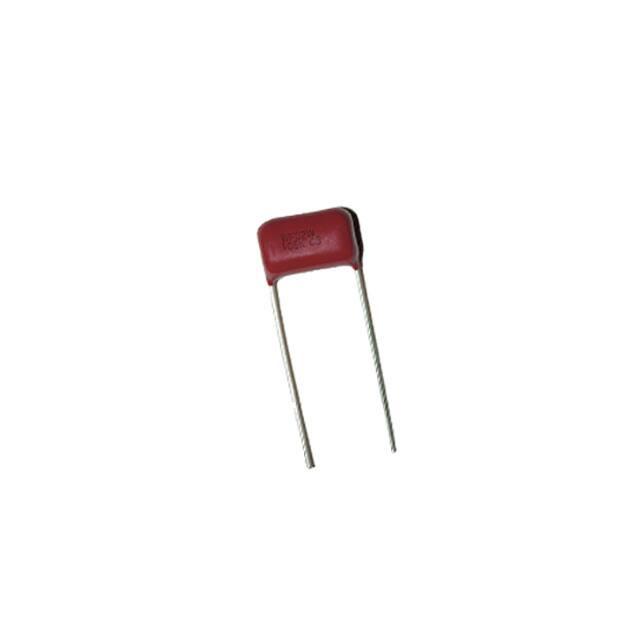

    CAP FILM 3.3UF 5% 450VDC RADIAL
ECW-FD2W335JC 数据手册
Plastic Film Capacitors Metallized Polypropylene Film Capacitor ECWFD series Non-inductive construction using metallized polypropylene film with flame retardant epoxy resin coating Features ● High safety (with safety function) ● Small size ● Excellent frequency characteristics ● Low loss ● Flame-retardant epoxy resin coating ● Low hum sound noise ● RoHS compliant Recommended applications ● Active filter circuit ● High frequency circuit Explanation of part number ■ Standard product 1 2 3 4 5 E C W F D Product code 6 Dielectric & construction 7 8 Rated voltage 9 10 Capacitance 2 3 4 5 E C W F D Product code 12 Cap. Tol. Suffix Code R.voltage [DC] Code Cap. Tol. Code 2W 450 V J ±5 % Blank Straight 2J 630 V K ±10 % B Crimped lead Q Crimped lead ■ Short lead space product 450 V (0.47 μF, 0.68 μF, 1.0 μF), 630 V (1.0 μF) 1 11 6 Dielectric & construction 7 Rated voltage 8 9 10 Capacitance Code C Cut lead 3 Crimped taping (Ammo) 4 Odd size taping 11 12 Cap. Tol. Suffix Cap. Tol. Lead form Code R.voltage [DC] 2W 450 V P ±5 %(J) 1 Straight 2J 630 V Q ±10 %(K) B Crimped lead Q Crimped lead Design and specifications are each subject to change without notice. Ask factory for the current technical specifications before purchase and/or use. Should a safety concern arise regarding this product, please be sure to contact us immediately. Code Lead form C Cut lead 3 Crimped taping (Ammo) 4 Odd size taping 03-Apr-23 ECWFD series Specifications Category temp. range (Including temperature-rise on unit surface) 450 V 630 V −40 ℃ to +110 ℃ −40 ℃ to +105 ℃ Peak to peak voltage applied on the capacitor should be less than 240 Vp-p, and zero to peak voltage should be less than 450 Vo-p. (Derating of rated voltage by 0.62 %/°C at more than 85 °C) Peak to peak voltage applied on the capacitor should be less than 400 Vp-p, and zero to peak voltage should be less than 630 Vo-p. (Derating of rated voltage by 1.0%/°C at more than 85 °C) 0.1 μF to 4.7 μF 0.01 μF to 4.7 μF ±5% (J), ±10 % (K) tan δ ≦ 0.1 % (20 °C, 1 kHz) Between terminals : Rated voltage (V)×150 % 60 s  C ≦ 0.33 μF:IR ≧ 30,000 MΩ (20 °C, 100 V, 60 s)  C > 0.33 μF:IR ≧ 10,000 MΩ・μF  C ≦ 0.33 μF:IR ≧ 9,000 MΩ (20 °C, 500 V , 60 s)  C > 0.33 μF:IR ≧ 3,000 MΩ・μF 450 V Rated voltage [DC] 630 V 450 V 630 V Capacitance range Capacitance tolerance Dissipation factor (tan δ) Withstand voltage 450 V Insulation resistance (IR) 630 V *: In case of applying voltage in alternating current (50 Hz or 60 Hz sine wave) to a capacitor with DC rated voltage, please refer to the page of “Permissible voltage (R.M.S) in alternating current corresponding to DC rated voltage”. Dimensions Marking Marking ød±0.05 Copper-clad steel-wire Marking H max. L max. 4.5±0.5 25 min. F±1.0 L max. Cut lead(Suffix C) 4.5±0.5 Marking Crimped lead (Suffix Q) 4.5±0.5 H max. T max. Type D H max. L max. G max. Crimped lead (Suffix B) Type B Straight S±0.8 S±0.8 Packaging specifications for bulk package ■ Packing quantity : 100 pcs./bag Taping specifications for automatic insertion ■ Taping style P P0 P0 Unit:mm P P0 F H0 H1* F H0 F H0 H0 F H1 Style F P H1 Style E P H1 Style AB P0 AB 12.7 12.7 5.0 16.0 34.0 Style E 30.0 15.0 7.5 16.0 44.0 F 15.0 15.0 7.5 16.0 44.0 *:max. * Please check the product drawing for the shape of the lead wire forming. The above diagram shows the taping dimensions, and the lead wire forming shape is an example. * H1 dimension is based on insertion machine “Panasert RH series” made by Panasonic. Consult with Panasonic technical staff when using other insertion machines. ■ Packaging specifications Series R. voltage (V) [DC] 450 ECWFD 630 Capacitance range (μF) 0.10 to 0.39 0.47, 0.68, 1.0 0.10 to 0.39 0.47, 0.68, 1.0 0.47 to 2.2 0.047 to 0.22 0.27 to 0.82 1 ● Lead spacing AB 〇 〇 Taping style E 〇 〇 〇 F Packing suffix Style Lead spacing Crimped taping 3 P3/Q3 4 P4/Q4 4 4 4 P4/Q4 AB E F 5.0 7.5 7.5 〇 〇 Odd size taping 〇 Odd size taping Unit:mm See the column “Rating ·Dimensions · Quantity” for packaging quantity Design and specifications are each subject to change without notice. Ask factory for the current technical specifications before purchase and/or use. Should a safety concern arise regarding this product, please be sure to contact us immediately. 03-Apr-23 ECWFD series Rating · Dimensions · Quantity ■ Rated voltage [DC] : 450 V, Capacitance tolerance : ±5 %(J), ± 10 %(K) Dimensions (mm) Part No. Cap. (μF) L H max. T max. max. Straight Min. order Q'ty (PCS) S Crimped lead (Suffix B) Crimped lead (Suffix Q) F Crimped lead (Suffix B) Crimped lead (Suffix Q) G max. Taping ød Bulk Standard 5.0 mm Odd size 7.5 mm 1500 1400 ECWFD2W104□( ) 0.10 12.6 4.5 13.9 13.9 7.5 10.0 0.6 ECWFD2W124□( ) 0.12 12.6 4.6 14.0 14.0 7.5 10.0 0.6 ECWFD2W154□( ) 0.15 12.6 4.6 14.1 14.1 7.5 10.0 0.6 ECWFD2W184□( ) 0.18 12.6 4.8 14.3 14.3 7.5 10.0 ECWFD2W224□( ) 0.22 12.6 5.0 14.6 14.6 7.5 10.0 ECWFD2W274□( ) 0.27 12.6 5.3 15.0 15.0 7.5 10.0 0.6 1300 ECWFD2W334□( ) 0.33 12.6 5.6 15.4 15.4 7.5 10.0 0.6 1200 1100 ECWFD2W394□( ) 0.39 12.6 6.0 15.7 15.7 7.5 10.0 0.6 1100 1000 0.47 12.6 6.5 11.2 16.2 16.2 10.0 7.5 10.0 1.5 0.6 1000 900 ECWFD2W474□( ) 0.47 17.5 5.8 9.0 14.0 16.0 15.0 7.5 15.0 1.5 0.8 ECWFD2W564□( ) 0.56 17.5 6.2 9.4 14.4 16.4 15.0 7.5 15.0 1.5 0.8 – 500 0.68 12.6 7.7 12.4 17.4 17.4 10.0 7.5 10.0 1.5 0.6 800 700 ECWFD2W684□( ) 0.68 17.5 6.7 9.9 14.9 16.9 15.0 7.5 15.0 1.5 0.8 ECWFD2W824□( ) 0.82 17.5 7.2 10.4 15.4 17.4 15.0 7.5 15.0 1.5 0.8 – 400 1.0 12.6 9.2 13.9 18.9 18.9 10.0 7.5 10.0 1.5 0.6 ECWFD2W105□( ) 1.0 17.5 7.8 11.0 16.0 18.0 15.0 7.5 15.0 1.5 0.8 ECWFD2W125□( ) 1.2 17.5 8.5 11.6 16.6 18.6 15.0 7.5 15.0 1.5 0.8 ECWFD2W155□( ) 1.5 17.5 9.3 12.5 17.5 19.5 15.0 7.5 15.0 1.5 0.8 ECWFD2W185□( ) 1.8 17.5 10.1 13.3 18.3 20.3 15.0 7.5 15.0 1.5 0.8 ECWFD2W225□( ) 2.2 17.5 11.1 14.3 19.3 21.3 15.0 7.5 15.0 1.5 0.8 ECWFD2W275□( ) 2.7 25.3 9.0 13.7 18.7 20.7 22.5 15.0 22.5 1.5 0.8 ECWFD2W335□( ) 3.3 25.3 9.8 14.6 19.6 21.6 22.5 15.0 22.5 1.5 0.8 ECWFD2W395□( ) 3.9 25.3 10.7 15.4 20.4 22.4 22.5 15.0 22.5 1.5 0.8 ECWFD2W475□( ) 4.7 25.3 11.7 16.4 21.4 23.4 22.5 15.0 22.5 1.5 0.8 ECWFD2W474P( ) ECWFD2W474Q( ) ECWFD2W684P( ) ECWFD2W684Q( ) ECWFD2W105P( ) ECWFD2W105Q( ) *□:Capacitance tolerance code *( ):Suffix for lead crimped – – – 0.6 0.6 1400 1300 Straight Crimped lead – 1200 1000 1000 700 600 400 300 – 200 – 800 600 600 Note) Part number marked with bold is short lead space product. Design and specifications are each subject to change without notice. Ask factory for the current technical specifications before purchase and/or use. Should a safety concern arise regarding this product, please be sure to contact us immediately. 03-Apr-23 ECWFD series Rating · Dimensions · Quantity ■ Rated voltage [DC] : 630 V, Capacitance tolerance : ±5 %(J), ± 10 %(K) Dimensions (mm) Part No. Cap. (μF) L H max. T max. max. Straight Crimped lead (Suffix B) Min. order Q'ty (PCS) S Crimped lead (Suffix Q) F Crimped lead (Suffix B) Crimped lead (Suffix Q) G max. Taping ød ECWFD2J103□( ) 0.01 12.6 4.9 8.0 8.0 7.5 10.0 0.6 ECWFD2J123□( ) 0.012 12.6 5.2 8.2 8.2 7.5 10.0 0.6 ECWFD2J153□( ) 0.015 12.6 5.6 8.6 8.6 7.5 10.0 0.6 ECWFD2J183□( ) 0.018 12.6 5.9 9.0 9.0 7.5 10.0 ECWFD2J223□( ) 0.022 12.6 6.4 9.4 9.4 7.5 10.0 ECWFD2J273□( ) 0.027 12.6 6.9 9.9 9.9 7.5 10.0 0.6 ECWFD2J333□( ) 0.033 12.6 7.5 10.5 10.5 7.5 10.0 0.6 ECWFD2J393□( ) 0.039 12.6 8.0 11.0 11.0 7.5 10.0 0.6 ECWFD2J473□( ) 0.047 12.6 4.4 12.8 12.8 7.5 10.0 0.6 ECWFD2J563□( ) 0.056 12.6 4.7 13.1 13.1 7.5 10.0 0.6 ECWFD2J683□( ) 0.068 12.6 5.0 13.4 13.4 7.5 10.0 0.6 ECWFD2J823□( ) 0.082 12.6 5.4 13.7 13.7 ECWFD2J104□( ) 0.10 12.6 5.8 14.2 14.2 ECWFD2J124□( ) 0.12 12.6 6.2 14.6 14.6 7.5 10.0 0.6 ECWFD2J154□( ) 0.15 12.6 6.8 15.2 15.2 7.5 10.0 0.6 ECWFD2J184□( ) 0.18 12.6 7.4 15.7 15.7 7.5 10.0 0.6 ECWFD2J224□( ) 0.22 12.6 8.1 16.4 16.4 7.5 10.0 0.6 ECWFD2J274□( ) 0.27 17.8 6.0 11.0 16.0 18.0 15.0 7.5 15.0 1.5 0.8 ECWFD2J334□( ) 0.33 17.8 6.6 11.5 16.5 18.5 15.0 7.5 15.0 1.5 0.8 ECWFD2J394□( ) 0.39 17.8 7.1 12.0 17.0 19.0 15.0 7.5 15.0 1.5 0.8 ECWFD2J474□( ) 0.47 17.8 7.8 12.7 17.7 19.7 15.0 7.5 15.0 1.5 0.8 ECWFD2J564□( ) 0.56 17.8 8.4 13.3 18.3 20.3 15.0 7.5 15.0 1.5 0.8 ECWFD2J684□( ) 0.68 17.8 9.3 14.2 19.2 21.2 15.0 7.5 15.0 1.5 0.8 ECWFD2J824□( ) 0.82 17.8 10.2 15.1 20.1 22.1 15.0 7.5 15.0 1.5 0.8 1.0 17.8 11.2 16.1 21.1 23.1 15.0 7.5 15.0 1.5 0.8 ECWFD2J105□( ) 1.0 25.3 8.4 13.5 18.5 20.5 22.5 15.0 22.5 1.5 0.8 ECWFD2J125□( ) 1.2 25.3 9.2 14.3 19.3 21.3 22.5 15.0 22.5 1.5 0.8 ECWFD2J155□( ) 1.5 25.3 10.3 15.5 20.5 22.5 22.5 15.0 22.5 1.5 0.8 ECWFD2J185□( ) 1.8 25.3 11.2 16.5 21.5 23.5 22.5 15.0 22.5 1.5 0.8 ECWFD2J225□( ) 2.2 25.3 12.4 17.7 22.7 24.7 22.5 15.0 22.5 1.5 0.8 ECWFD2J275□( ) 2.7 25.3 13.8 19.2 24.2 26.2 22.5 15.0 22.5 1.5 0.8 ECWFD2J335□( ) 3.3 25.3 15.3 20.7 25.7 27.7 22.5 15.0 22.5 1.5 0.8 ECWFD2J395□( ) 3.9 25.3 16.6 22.1 27.1 29.1 22.5 15.0 22.5 1.5 0.8 ECWFD2J475□( ) 4.7 25.3 18.3 23.9 28.9 30.9 22.5 15.0 22.5 1.5 0.8 ECWFD2J105P( ) ECWFD2J105Q( ) *□:Capacitance tolerance code *( ):Suffix for lead crimped - - - - 7.5 10.0 7.5 10.0 - 0.6 0.6 0.6 - 0.6 Bulk Odd size 7.5 mm Straight Crimped lead - - 1000 1300 1200 1000 - 900 700 500 1000 400 300 1000 200 800 – 900 600 800 500 700 400 300 600 500 400 Note) Part number marked with bold is short lead space product. Design and specifications are each subject to change without notice. Ask factory for the current technical specifications before purchase and/or use. Should a safety concern arise regarding this product, please be sure to contact us immediately. 03-Apr-23 Safety and Legal Matters to Be Observed Safety and Legal Matters to Be Observed  Product specifications and applications ■ Please be advised that this product and product specifications are subject to change without notice for improvement purposes. Therefore, please request and confirm the latest delivery specifications that explain the specifications in detail before the final design, or purchase or use of the product, regardless of the application. In addition, do not use this product in any way that deviates from the contents of the company's delivery specifications.   ■ Unless otherwise specified in this catalog or the delivery specifications, this product is intended for use in general electronic equipment (AV products, home appliances, commercial equipment, office equipment, information and communication equipment, etc.). When this product is used for the following special cases, please separately discuss the delivery specifications suited to each application with the company. These include applications requiring special quality and reliability, wherein their failures or malfunctions may directly threaten human life or cause harm to the human body (e.g.: space/aircraft equipment, transportation/traffic equipment, combustion equipment, medical equipment, disaster prevention/crime prevention equipment, safety equipment, etc.).    Safety design and product evaluation ■ Please ensure safety through protection circuits, redundant circuits, etc., in the customer's system design so that a defect in our company's product will not endanger human life or cause other serious damage. ■ This catalog shows the quality and performance of individual parts. The durability of parts varies depending on the usage environment and conditions. Therefore, please ensure to evaluate and confirm the state of each part after it has been mounted in your product in the actual operating environment before use. If you have any doubts about the safety of this product, then please notify us immediately, and be sure to conduct a technical review including the above protection circuits and redundant circuits at your company.  Laws / Regulations / Intellectual property ■ The transportation of dangerous goods as designated by UN numbers, UN classifications, etc., does not apply to this product. In addition, when exporting products, product specifications, and technical information described in this catalog, please comply with the laws and regulations of the countries to which the products are exported, especially those concerning security export control. ■ Each model of this product complies with the RoHS Directive (Restriction of the use of hazardous substances in electrical and electronic equipment) (2011/65/EU and (EU) 2015/863). The date of compliance with the RoHS Directive and REACH Regulation varies depending on the product model. Further, if you are using product models in stock and are not sure whether or not they comply with the RoHS Directive or REACH Regulation, please contact us by selecting "Sales Inquiry" from the inquiry form. ■ During the manufacturing process of this product and any of its components and materials to be used, Panasonic does not intentionally use ozone-depleting substances stipulated in the Montreal Protocol and specific bromine-based flame retardants such as PBBs (Poly-Brominated Biphenyls) / PBDEs (Poly-Brominated Diphenyl Ethers). In addition, the materials used in this product are all listed as existing chemical substances based on the Act on the Regulation of Manufacture and Evaluation of Chemical Substances. ■ With regard to the disposal of this product, please confirm the disposal method in each country and region where it is incorporated into your company's product and used.   ■ The technical information contained in this catalog is intended to show only typical operation and application circuit examples of this product. This catalog does not guarantee that such information does not infringe upon the intellectual property rights of Panasonic or any third party, nor imply that the license of such rights has been granted. Panasonic Industry will assume no liability whatsoever if the use of our company's products deviates from the contents of this catalog or does not comply with the precautions. Please be advised of these restrictions. 30-Jun-23 Matters to Be Observed When Using This Product Matters to Be Observed When Using This Product (Film capacitor)  Use environments ■ This product is intended for standard general-purpose use in electronic equipment, and is not designed for use in specific environments described below. Using the product in such specific environments or service conditions, therefore, may affect the performance of the product. Please check the performance and reliability of the product first before using the product. (1) The product characteristics may deteriorate in environments where the product is exposed to water, oil, direct sunlight, ozone, UV-rays, radiant rays, etc. Do not use the product in these environments. (2) High-humidity environment: When the capacitor is used in a high-humidity environment for a long period, moisture permeates its outer case reaching internal elements as time goes by. This moisture oxidizes a film deposit or spraying of metal, thus causing the capacitor problems. As a result of moisture absorption, some types capacitors may have their capacitances increased. (3) High temperature: There are cases where oil leaks from an ECQUG type capacitor used under high-temperature conditions (70°C or higher). However, it rarely happens and does not affect the quality and reliability of the capacitor at all. Nevertheless, avoid such a configuration in which the product and a component that may have a contact failure caused by oil are incorporated together in the same circuit set. If you have any question, please feel free to contact us. (4) Gaseous atmosphere: Avoid using the capacitor in an oxidizing gas, such as a hydrogen chloride gas, hydrogen sulfide gas, and sulfurous acid gas. Using the capacitor in such a gaseous atmosphere results in oxidized film deposit (aluminum) or spraying of metal (zinc) that may cause an ignition or smoking incident. (5) Resin coat: If you intend to coat the capacitor with a resin for the purpose of improving its resistance to moisture and gas or fixing a component, make separate inquiries to us about the matter. A chemical solvent included in the resin permeates the metal sprayed parts or electrode (film deposit), which may cause the degradation of the capacitor characteristics. When curing resin, the resin generates chemical reaction heat (curing heat), which may have a negative influence on the capacitor. When embedding the whole capacitor completely with a resin, sufficiently analyze/assess the effects of the thermomechanical stress created by thermal expansion/shrinkage. (6) See to it that no dust gets deposited on the product. Dust deposition on the product causes current leakage, etc., leading to a degradation of the product characteristics.  Cleaning conditions ■ The effects of cleaning processes on the capacitor vary widely, depending on its structure and materials. Generally speaking, the capacitor is hardly susceptible to a CFC-based solvent and an alcohol-based solvent but is affected by a solvent with high polarity in some cases. In many cases, the capacitor with leads is covered with an outer casing made of an epoxy resin highly resistant to chemicals and is therefore barely affected by a cleaner. We nevertheless advise you to clean the capacitor as quickly as possible. A chip-type laminated film capacitor (ECHU, ECWU, ECPU) is not protected with an outer jacket. During cleaning processes, solder flux or a cleaner deposited on an element of the capacitor, may be activated and flow into the capacitor, causing a problem. ■ Ultrasonic cleaning may cause some problems, depending on the cleaner used and ultrasonic power output. Such problems include peeling of protective film, separation of an electrode due to resonance, and degraded capacitor characteristics. Make sufficient examinations/confirmations before carrying out ultrasonic cleaning. ■ As a result of strict regulations on CFC-based and chlorine-based solvents, cleaners not containing such solvents have come into wide use. Some such alternative cleaners are, however, still harmful to the chip-type laminated film capacitor and could be harmful under improper cleaning conditions. Examine the cleaner sufficiently before using it. If you intend to use an alternative cleaner, please contact us in advance. Cleaning methods using an alternative cleaner include a method in which a high-pressure spray of cleaner (water) hits against the board. In this case, the water pressure may cause the protective film to peel off from the element surface. Research the cleaning method before executing it. ■ Dry the cleaned capacitor sufficiently so that no cleaner remains thereon. An insufficient drying process allows the cleaner to remain on the element surface, in which case measurement of the insulation resistance of the capacitor may indicate an apparent drop in the insulation resistance. ■ A recommended cleaner is isopropyl alcohol (IPA), which is a general industrial reagent. Recommended cleaning conditions include a cleaning temperature of 50°C and a cleaning time of 5 minutes or shorter, which apply equally to immersion cleaning, vapor cleaning, and ultrasonic cleaning. ■ A list of cleaners that can be or cannot be used to clean the capacitor is shown on the next page. See the list for your reference. If you are not clear about whether or not a cleaner can be used to clean the capacitor, make sure to contact us. 30-Jun-23 Matters to Be Observed When Using This Product Cleaning conditions Solvent-based Retail product* Ethanol Ultrasonic cleaning or immersion cleaning for 5 minutes ○ ○ ○ Isopropyl alcohol (IPA) Ultrasonic cleaning or immersion cleaning for 5 minutes ○ ○ ○ Silicon-based FRW-17: ultrasonic cleaning at 60 ℃ for 5 minutes → FRW-1N: ultrasonic cleaning at 60 ℃ for 5 minutes → FRW-100: vapor drying at 100 ℃ for 1 minute ○ ○ ○ Halogen-based HCFC141b-MS Ultrasonic cleaning or immersion cleaning for 5 minutes ○ ○ ○ P3 Cold Cleaner 225S Ultrasonic cleaning at 60 ℃ for 5 minutes → Ultrasonic rinsing with IPA at ordinary temperature for 5 minutes → Hot air drying at 40 ℃ for 5 minutes ○ ○ ○ Toluene Ultrasonic cleaning or immersion cleaning for 5 minutes × ○ ○ Terpene Cleaner EC-7 Spray cleaning at ordinary temperature for 5 minutes → Spray rinsing with pure water at 50 ℃ for 5 minutes → Hot air drying at 80 ℃ for 5 minutes × ○ ○ Ultrasonic cleaning at 60 ℃ for 5 minutes → Non-blow drying at 85 ℃ for 5 minutes × ○ ○ Cleanthrough 750H Ultrasonic cleaning at 60 ℃ for 5 minutes → Ultrasonic rinsing with pure water at 60 ℃ for 5 minutes → Hot air drying at 85 ℃ for 5 minutes × ○ ○ Cleanthrough 750L Ultrasonic cleaning at 60 ℃ for 5 minutes → Ultrasonic rinsing with pure water at 60 ℃ for 5 minutes → Hot air drying at 85 ℃ for 5 minutes × ○ ― × ○ ― Cleanthrough LC-841 Ultrasonic cleaning at 60 ℃ for 5 minutes → Ultrasonic rinsing with pure water at 60 ℃ for 5 minutes → Hot air drying at 85 ℃ for 5 minutes × ○ ○ Pine Alpha ST-100S Ultrasonic cleaning at 60 ℃ for 5 minutes → Ultrasonic rinsing with pure water at 60 ℃ for 5 minutes → Hot air drying at 85 ℃ for 5 minutes × ○ ○ Aqua Cleaner 210SET Shower cleaning at 60 ℃ for 1 minute → Ultrasonic rinsing with pure water at 60 ℃ for 5 minutes → Hot air drying at 85 ℃ for 5 minutes × ○ ○ Alcohol-based Petroleum-based Hydrocarbon Terpene-based Pure water Water-based Chip type Lead type Surfactant * Retail product: ECWFE, ECWFG Uncleaned Low-residue flux ULF-500VS ○ ○ ○ Non-active flux AM-173 ○ ○ ○ ○ cleaner can be used, × cleaner cannot be used, ― unconfirmed 30-Jun-23 Matters to Be Observed When Using This Product  Response to anomalies and handling conditions ■ A dielectric film is not a fire-resistant material. In contrast, an ECQE type metallized polyester capacitor and ECWF type/ ECWH type metallized polypropylene capacitors each have an outer casing made of a fire-resistant epoxy resin (UL94 V-0). ■ Because the capacitor described herein is made of a combustible material, it may generate smoke or even ignite when exposed to excessive heat. We therefore recommend you cover the capacitor with a fire-resistant material or fire-resistant case. When you use the capacitor at an operating voltage of 30 V AC or higher or 45 V DC or higher, to prevent noise between a line and the ground or between different lines, we recommend you cover a resin component near the capacitor with a fire-resistant material or fire-resistant case (to prevent a fire accident).   ■ When a different component in the same circuit has short-circuited or developed an open failure, see to it that a voltage or current higher than the rated voltage or current or excessive heat is not applied to the capacitor. We define the maximum voltage that can be applied consecutively regardless of temperature, as rated voltage*1. Be careful with the fact, however, that this rated voltage is different from rated voltages defined in JIS, IEC, etc.*2 *1 Definition of the rated voltage by our company We define the maximum voltage that can be applied continuously within the entire category temperature range, as the rated voltage. In a high-temperature condition where voltage reduction is necessary, a reduced maximum voltage is referred to as the rated voltage. Therefore, the maximum voltage that can be applied continuously at the category upper limit temperature is also referred to as the rated voltage. *2 Definition of the rated voltage by JIS and IEC JIS and IEC define the maximum voltage that can be applied continuously within a temperature range from the category lower limit temperature to the rated temperature, as the rated voltage. According to JIS and IEC, the maximum voltage that can be applied continuously at the category upper limit temperature is referred to as the category voltage. In a temperature range from the rated temperature to the category upper limit temperature, voltage reduction is necessary in some cases, where a reduced maximum voltage is referred to as temperature-dependent reduced voltage. ■ Current that charges or discharges from the capacitor in a rapid charge or discharge causes short-circuit failure, open failure, etc., thus leading to the degradation of the capacitor characteristics. Make sure that the capacitor is charged or discharges with a resistance of 20 Ω/V to 1000 Ω/V or more in series. In a withstand voltage test, service life test, etc., where numbers of the capacitors are connected in parallel, each capacitor must have a resistance of 20 Ω/V to 1000 Ω/V or more connected in series thereto. ■ Make sure that a sharp element (a screw driver, solder iron, tweezers, a chassis edge, etc.) does not hit the capacitor surface. Do not apply an unnecessarily heavy load to the leads (for example, by reworking the leads). ■ Accidentally dropping the capacitor on the floor may damage its characteristics. Do not use a capacitor when this happens. If you still use such a dropped capacitor, check its quality first. ■ Be careful not to apply excessive force to the base of the leads of a lead-type capacitor. It causes the exterior resin near the base to crack. ■ The chip-type capacitor has been developed under the assumption that it will be used as an ordinary surface-mounted component. Avoid using a capacitor in an unusual configuration (e.g., stacking the capacitors in two layers, setting the capacitor in a standing position, etc.). When you intend to use the capacitor in an unusual configuration, please contact us in advance. ■ Take care to prevent water or dust from adhering to the terminal surface of the capacitor. Water or dust on the terminal causes current leakage, corrosion, etc. ■ The capacitor emits a humming sound created by mechanical vibration of the dielectric film caused by a coulomb force between the positive and negative electrodes. In particular, the humming sound, in the form of a sound wave containing a source voltage distortion or harmonic component, is heard as a high-tone sound. From the viewpoint of electrical characteristics, it poses no problem. However, when the capacitor is used at a frequency close to the audible frequency, check the humming sound. ■ When the capacitor is used as a capacitor for preventing noise from an AC power supply (across-the-line capacitor), a source voltage is constantly applied to the capacitor and a surge voltage, such as a lightning surge, is applied to the capacitor as well. This may cause the capacitor to ignite or generate smoke. For such capacitors inserted between power lines, strict safety standards are set by individual countries, using products conforming to the safety standards is mandatory. When you are looking for across-the-line capacitors for use in domestic equipment, use capacitors conforming to overseas certification standards or capacitors listed below. ECQE(F) ECQE(F) : Rating 1000 V DC (125 V AC) : Rating 1250 V DC (125 V AC) ECQE(F)/(B)/(T) ECQE(F)/(T) : Rating 125 V AC (1A) : Rating 250 V AC (2A) 30-Jun-23 Matters to Be Observed When Using This Product ■ When ECQE(F)1A /2A, ECQE(B)1A, and ECQE(T)1A /2A are used as across-the-line capacitors, they must satisfy at least one of the following conditions. (1) A varistor with a varistor voltage specified in the following table or lower is connected in parallel with the capacitor. (2) No pulse voltage higher than the pulse voltage specified in the following table is applied across both ends of the capacitor. ■ When using a varistor together with the capacitor, confirm the varistor with the delivery specification sheet and use a varistor with no sign of surge-caused deterioration. Capacitor rated voltage 125 V.AC (1A) 250 V.AC (2A) Varistor voltage 250 V 470 V Pulse voltage 250 Vo-p 630 Vo-p ■ When using the capacitor in equipment requiring capacitors conforming to overseas certification standards, use capacitors (typical types) listed in the following table. To know about CQC standards in China, make an inquiry with us. Shape Resin case Resin case Resin case Type ECQUA ECQUL ECQUG Certification standards UL 60384-14(US), CSA E60384-14(CA), EN 60384-14(EU) UL 60384-14(US), CSA E60384-14(CA), EN 60384-14(EU) UL 60384-14(US), CSA E60384-14(CA), EN 60384-14(EU) ■ Using the capacitor as a voltage dropper may result in a reduction in the capacitance. For example, when an abnormal voltage, such as surge voltage, is applied to the capacitor, a fuse inside the capacitor is activated, which reduces its capacitance. In a worst-case scenario, the capacitor no longer functions as a voltage dropper. Observe the capacitor carefully to see if any abnormal voltage is applied thereto. Such abnormal voltage to the capacitor may generate high voltage applied to the circuit load. To deal with such a problem, provide the circuit with a safety protection means.  Reliability and product life ■ Capacitor characteristics change, depending on ambient environment conditions under which the capacitor operates. Even when the capacitor is just left as it is, humidity in the air can infiltrate the capacitor and cause a slight change in its capacitance. An extent to which the capacitance changes in this situation varies depending on a dielectric material, an outer casing material, a structure, etc. We take these characteristics changes into consideration before shipping out the capacitor. However, unless a separate agreement is made, our guarantee for the specified capacitance value will be effective only up to the delivery date. ■ When using a capacitor in a circuit that requires precise capacitor elements, such as time constant, use polypropylene-based capacitors with less time-dependent change, such as ECWFD, ECWF(A)、ECWF(L), ECWH(A), PPS-based ECHU(X), and ECHU(C). ■ A product conforming to "AEC-Q200" refers to a product having passed some or all of the evaluation test items defined in AEC-Q200. To know the detailed specifications of individual products or specific evaluation test scores, please contact us. We issue a delivery specification sheet for each product ordered. Please confirm with the sheet when you place an order with us.   Circuit design (working voltage) ■ The maximum working voltage applicable to a capacitor varies, depending on the voltage waveform, current waveform, frequency, ambient temperature (surface temperature), capacitance, etc. When using a capacitor, check the voltage waveform and current waveform applied across both terminals of the capacitor and the operating frequency and make sure that these are within specified values. When the frequency is high, some product types take different allowable voltages. You can confirm detailed information about this matter on delivery specification sheets. ■ The rated voltage is the maximum voltage that can be applied continuously within the category temperature range. Operating the capacitor with a voltage higher than the rated voltage leads to dielectric breakdown of the capacitor film, which may cause a short-circuit failure. Service lives of capacitors operating at the maximum rated voltages vary, depending on their types. ■ When a voltage higher than the rated voltage is applied to the capacitor, it does not cause a short circuit failure immediately because of the self-recovery ability of the capacitor, however, a drop in the insulation resistance may occur, which can lead to smoke generation or ignition under certain circuit conditions. ■ Do not use a noise-preventing capacitor (AC rated voltage type) in a high-frequency circuit. It may cause smoke generation or ignition under certain service conditions. Rated voltages of capacitors for electronic equipment, except that of a special types, are usually indicated as DC voltage. 30-Jun-23 Matters to Be Observed When Using This Product ■ The capacitor has an upper limit service temperature (surface temperature) determined in accordance with the type of a dielectric material making up the capacitor. When using the capacitor at a temperature higher than the rated temperature, confirm the following classification table because some types capacitors require voltage reduction. Even when the capacitor can be used at a temperature higher than the rated temperature, make sure that voltage reduction is carried out to keep the surface temperature equal to or lower than an upper limit service temperature specified in the following table. A capacitor used at a high frequency shows a self-temperature rise. A voltage reduction rate shown in the following table, therefore, cannot be applied in this case. The AC rated voltage type capacitor does not need a temperature-dependent voltage reduction. Dielectric material Polyester (PET) Polypropylene (PP) Polyethylene naphthalate (PEN) Polyphenylene sulfide (PPS) Acrylic resin Type ECQE(F) ECQE(B) ECQE(T) ECWF(A) Rating 250 V DC ECWF(L) ECWH(A) ECWH(C) ECWF(A) Rating 450 V DC ECWF(A) Rating 630 V DC ECWH(V) ECWFE Rating 450 V DC ECWFD Rating 630 V DC ECWFE Rating 630 V DC ECWFD Rating 450 V DC ECWFG Rating 630 V DC ECWU(X) ECWU(C) ECWU(V16) ECHU(X) Rating 16 V DC ECHU(X) Rating 50 V DC (0.0001 μF to 0.10 μF) ECHU(X) Rating 50 V DC (0.12 μF to 0.22 μF) ECHU(C) ECPU(A) Rated temperat ure Category upper limit temperature (maximum service temperature) Rated voltage in a temperature range equal to or higher than the rated temperature (voltage reduction rate) 85 ℃ 105 ℃ 1.25%/ ℃ 105 ℃ 105 ℃ Voltage reduction is unnecessary. 85 ℃ 105 ℃ 1.25%/ ℃ 85 ℃ 105 ℃ 1.0%/ ℃ 85 ℃ 85 ℃ 105 ℃ 85 ℃ 85 ℃ 110 ℃ 110 ℃ 105 ℃ 125 ℃ 85 ℃ 0.62%/ ℃ 1.0%/ ℃ Voltage reduction is unnecessary. 125 ℃ 125 ℃ Voltage reduction is unnecessary. 105 ℃ 125 ℃ 1.25%/ ℃ 105 ℃ 85 ℃ 105 ℃ 85 ℃ Voltage reduction is unnecessary. 1.25%/ ℃ Voltage reduction is unnecessary. Voltage reduction is unnecessary. ※Rated temperature: upper limit temperature that can be used continuously without involving voltage reduction (which includes the self-temperature rise value) ※Category upper limit temperature: upper limit temperature that can be used continuously when voltage reduction is implemented (which includes the self-temperature rise value) Percentage (%) for rated voltage at a working temperature equal to or lower than the rated temperature When the rated temperature is 85 ℃ and the category upper limit temperature is 105 ℃, voltage reduction is carried out at a reduction rate of 1.25 %/ ℃ in a temperature range of 85 ℃ or higher. 100 90 80 70 60 50 -40 -30 -20 -10 0 10 20 30 40 50 60 70 80 90 100 Temperature of the capacitor wall (℃) 30-Jun-23 Matters to Be Observed When Using This Product ■ Use the noise-preventing capacitor (AC rated voltage type) on the primary power circuit. This capacitor is designed on the assumption that a 50 Hz or 60 Hz sine wave voltage is applied to the capacitor. When using a capacitor with a DC rated voltage type in an AC circuit, see "Voltage at Which DC Rated Voltage Type Capacitor Can be Used in AC Circuit. " Do not use this type of capacitor on the primary power circuit. ■ When a capacitor is used at a high frequency, its self-heating poses a risk of thermal runaway (smoke generation, ignition). Reduce the working voltage according to the example shown below. For capacitors used at a high frequency, we recommend ECHU(X)/(C), ECWF(A)/(L), and ECWH(A)/(C)/(V). Capacitor: ECWF2154JA (250 V DC, 0.15 μF) Working frequency: 40 kHz (sine wave) Allowable current value (entered in the delivery specification sheet): 2.0 Arms at 40 kHz V= I 2πfC = 2.0 2×3.14×40×103×0.15×10-6 = 53 Vrms According to the above equation, the AC working voltage (50 Hz or 60 Hz sine wave voltage) of ECWF(A) operating at 40 kHz and 53 Vrms is calculated at 125 Vrms. This indicates that using ECWF(A) at a high frequency causes its allowable voltage to drop. Note that this equation cannot be applied to a working voltage not in a sine waveform, in which case please contact with us. ■ Make sure that the peak value of a pulse voltage (Vo-p) applied across both ends of the capacitor is equal to or lower than the rated DC voltage. When the capacitor is used at a high frequency, its self-heating impairs the voltage endurance characteristics and may lead to destruction of the capacitor. Measure the self-temperature rise value of the capacitor and keep it equal to or lower than the specified value. ■ When a voltage higher than the rated voltage (allowable voltage) is applied to the capacitor as a result of unusual circuit behavior caused by a failure of a different component, provide the capacitor with a means of safety protection.   Circuit design (working current) ■ Because of its low internal impedance, the capacitor carries an extremely large current flow, depending on the circuit in which the capacitor is incorporated. Particularly, a high pulse current could flow through the capacitor when the power supply is turned on or off. Make sure to check whether a high pulse current is flowing through the capacitor. When the capacitor is used in a high-frequency circuit, such as an inverter circuit and switching circuit, a large current may flow through the capacitor. Be careful in such cases. ■ A current flow exceeding the allowable current value may put the capacitor in a low-capacitance or open state or cause the capacitor to generate heat. This may result in degraded voltage endurance performance or short circuit, thus leading to smoke generation, ignition, etc. When using the capacitor, keep a capacitor current and temperature equal to or lower than the allowable current value and self-temperature rise value specified in the delivery specification sheet. ■ It is necessary that the allowable current in breakdown mode be examined in terms of both pulse current (peak current) and continuous current (RMS current). Confirm that both pulse current and continuous current are equal to or lower than the allowable current value and then use the capacitor. ■ The frequency characteristics of the loss tangent (tanδ) of a capacitor vary depending on the type of a dielectric material used. For this reason, a different allowable RMS current for a given working frequency shows depending on the product type. When a capacitor is used at a high frequency, in particular, its loss tangent (tanδ) gets larger, a current flow larger than the RMS current causes the capacitor to thermally runaway, which may lead to smoke generation or ignition. Using the capacitor at a high frequency, therefore, requires special caution. Please let us know the operating conditions for the capacitor to give you detailed advice. Otherwise, keep the self-temperature rise value and surface temperature of the capacitor within the allowable range even in the most unfavorable operation conditions. 30-Jun-23 Matters to Be Observed When Using This Product ■ The RMS current (effective current) varies depending on the capacitance. The following graphs show allowable RMS currents (effective currents) of typical capacitor types by frequency/capacitance. When actually using these capacitors, measure their voltage/current waveforms and ambient temperatures/self-temperature rise values and give us these measurements with your inquires. Type: ECQE(F) (Polyester) Type: ECWF(A) (Polypropylene) Rating: 250 V DC -> 150 Vrms (sine wave) 60 Hz Rating: 250 V DC -> 125 Vrms (sine wave) 60 Hz Temperature: -40 ℃ to 85 ℃ (capacitor wall temperature) Temperature: -40 ℃ to 85 ℃ (capacitor wall temperature) 10.0μF 4.5 4.0 3.5 4.7μF 3.0 2.5 2.2μF 2.0 1.0μF 1.0 1.5 0.22μF 0.5 0.0 10 50 Frequency (kHz) 100 0.47μF 0.10μF 0.047μF 0.010μF 0.022μF Allowable current value (Arms) Allowable current value (Arms) 5.0 50 100 Frequency (kHz) ■ When the capacitor is used in a switching circuit or snubber circuit, an instantaneous flow of large pulse current causes the capacitor to locally generate heat. As a result, the film deposit scatters off, which may decreases the capacitance of the capacitor or put the capacitor in an open state. This local heating may trigger a smoke generation or ignition incident. ■ A pulse current value (10000 times) can be given as the product of dV/dt (V/µs) and a capacitance (µF) that are specified in the delivery specification sheet. dV/dt is determined by the element structure. ■ When the capacitor is used in a large-current pulse circuit, keep the pulse current value within the allowable pulse current (Ao-p). When applying a pulse current 10000 times or more, please contact us to discuss the matter separately. 30-Jun-23 Matters to Be Observed When Using This Product ■ When a voltage V (V) is applied to a capacitor C (farad or F), a charge quantity Q (C) is given as Q = C・V. At this time, a charge current I (A) flowing through the capacitor is given as I = dQ/dt. It follows, therefore, that a pulse current I (A) is given as the product of a capacitance C (µF) and a voltage variation per time dV/dt, that is, I = C・dV/dt. Capacitance (μF) 103 123 153 183 223 273 333 393 473 563 683 823 (0.010) (0.012) (0.015) (0.018) (0.022) (0.027) (0.033) (0.039) (0.047) (0.056) (0.068) (0.082) 104 124 154 184 224 274 334 394 474 564 684 824 (0.10) (0.12) (0.15) (0.18) (0.22) (0.27) (0.33) (0.39) (0.47) (0.56) (0.68) (0.82) 105 (1.0) 125 (1.2) 155 (1.5) 185 (1.8) 225 (2.2) 275 (2.7) 335 (3.3) 395 (3.9) 475 (4.7) 565 (5.6) 685 (6.8) 825 (8.2) 106 (10.0) Type ECQE(F) 100 V DC ECQE(F) 250 V DC ECQE(F) 400 V DC ECQE(F) 630 V DC 131 273 48 78 116 33 37 63 22 18 22 48 18 11 10 6 8 From the above table, which indicates that the allowable dV/dt value of ECQE4224KF (rated voltage 400 V DC, capacitance 0.22 µF) is 37, the allowable pulse current value of ECQE4224KF is calculated at 8 Ao-p.Ensure, however, that the RMS current value is equal to or lower than the allowable RMS current value. 30-Jun-23 Matters to Be Observed When Using This Product ■ When a voltage V (V) is applied to a capacitor C (farad or F), the charge quantity Q (C) is given as Q = C・V. At this time, the charge current I (A) flowing through the capacitor is given as I = dQ/dt. It follows, therefore, that the pulse current I (A) is given as the product of the capacitance C (µF) and the voltage variation per time dV/dt, that is, I = C・dV/dt. Capacitance (μF) 103 123 153 183 223 273 333 393 473 563 683 823 (0.010) (0.012) (0.015) (0.018) (0.022) (0.027) (0.033) (0.039) (0.047) (0.056) (0.068) (0.082) 104 124 154 184 224 274 334 394 474 564 684 824 (0.10) (0.12) (0.15) (0.18) (0.22) (0.27) (0.33) (0.39) (0.47) (0.56) (0.68) (0.82) 105 (1.0) 125 (1.2) 155 (1.5) 185 (1.8) 225 (2.2) 275 (2.7) 335 (3.3) 395 (3.9) 475 (4.7) 565 (5.6) 685 (6.8) 825 (8.2) 106 (10.0) Type ECQE(F) 100 V DC ECQE(F) 250 V DC ECQE(F) 400 V DC ECQE(F) 630 V DC 131 273 48 78 116 33 37 63 22 18 22 48 18 11 10 6 8 From the above table, which indicates that the allowable dV/dt value of ECQE4224KF (rated voltage 400 V DC, capacitance 0.22 µF) is 37, the allowable pulse current value of ECQE4224KF is calculated at 8 Ao-p. Ensure, however, that the RMS current value is equal to or lower than the allowable RMS current value. 30-Jun-23 Matters to Be Observed When Using This Product   Circuit design (working temperature) ■ When the capacitor is used in an AC circuit, especially in a high-frequency circuit, the capacitor generates heat because of the alternating current flowing therethrough. If this self-heating by the capacitor is excessive, the capacitor may deteriorate or generate smoke or even ignite. Confirm the self-temperature rise value of the capacitor under the actual service condition and use the capacitor at the self-temperature rise value equal to or lower than the specified self-temperature rise value. Measure the self-temperature rise value at room temperature in a windless condition. Refer to the delivery specification sheet to check detailed information on the self-temperature rise value. The specified self-temperature rise value varies depending on capacitor types. For more detailed information about this matter, please contact us. ■ Because the working temperature range of a capacitor varies depending on dielectric materials (film types), the working temperature range in which the capacitor can be used is specified for each capacitor type. Note, however, that working temperature ranges listed in a catalog are surface temperatures which are different from ambient temperatures. When using the capacitor, make sure that (ambient temperature + self-temperature rise value (within the specified value)), that is, the surface temperature of the capacitor is within the working temperature range. ■ If the capacitor is used in a temperature condition above the working temperature range, its loss tangent (tan δ) gets larger, inducing self-heating, which leads to exceeding the allowable value. As a result, the dielectric film deteriorates which can cause a short circuit failure that may lead to smoke generation or ignition. When a heat dissipation plate of a different component or resistance generating high heat is present near the capacitor, radiant heat from such an element is applied to a part of the capacitor, in which case the temperature of the capacitor can exceed the working temperature range and smoke generation or ignition may occur. Make sure to check the surface temperature of elements that serve as a heat source.   Board design ■ The chip-type laminated film capacitor is mounted directly on the board without a lead interposed between the capacitor and the board. Because of this configuration, if the thermal expansion coefficient of the capacitor and that of the board differ widely, due to temperature change, etc., after chip mounting, it creates mechanical stress which is applied to the capacitor. This deforms the capacitor body or cracks its soldered part, thus impairing its performance. Examine and check the capacitor sufficiently before mounting it on the board. In particular, when using a ceramic board, please contact us before mounting the capacitor. Type Item Thermal expansion coefficient (×10-6/°C) Chip-type laminated film capacitor ECHU(X)/(C) ECWU(X)/(C) ECPU(A) (PPS film) (PEN film) (Plastic film) 22 10 70 Resin board Ceramic board Paper phenol Paper epoxy Glass epoxy Alumina 1 ~ 30 1 ~ 15 1 ~ 25 7~8 ■ Radiant heat from a heat-carrying component present near the capacitor may raise the temperature of the capacitor above the category temperature range. Be careful in such cases. The chip-type capacitor does not have the outer casing that the lead-type capacitor has. If an exposed part of a live component is present near the capacitor, a short circuit may be created through the capacitor. Exercise special caution when determining the location of the capacitor. ■ If the land area of the capacitor is large, a tombstone phenomenon (chip rising) is likely to occur when the volume of solder is not proper. Give each type of capacitor recommended land dimensions as much as possible, even though it is disadvantageous from the viewpoint of ensuring the mounter has sufficient mount clearance.   Mounting conditions (chip-type) * Target capacitors: ECHU, ECWU, and ECPU ■ In the flow soldering process, a chip component is dipped in melted solder and resulting in a high temperature of the component. The film capacitor has low resistance to heat. Avoid soldering it using the flow soldering process. Applying heat directly to a capacitor from the lower surface of the printed board for repair work (using a hot plate, etc.) may result in the degradation of the capacitor. This process must also be avoided. 30-Jun-23 Matters to Be Observed When Using This Product ■ Reflow soldering is a soldering method in which the proper amount of solder paste is deposited on the fitting land of the surface-mounted board, the chip-type laminated film capacitor is placed on the land, and heat is applied to the capacitor to melt the solder. We recommend the temperature profile shown in the following table for the reflow soldering process. Note, however, that more than two reflow soldering cycles are not allowed and that the second reflow cycle must be carried out after the capacitor temperature returns to normal temperature following the end of the first reflow cycle. Item Soldering condition The capacitor and the board are heated in a heat-resistant furnace or an infrared furnace. Component surface temperature (°C) Soldering Mater to note Soldering: 235°C, 5 sec. at maximum 300 250 ≥220°C, 30 sec. at maximum Preheating 150°C to 180°C 200 150 60 sec. to 120 100 50 0 The capacitor temperature varies depending on the type of the board material and the heat source. Use a glass epoxy board of 115 mm by 50 mm and 0.8 t as the standard board to check the capacitor temperature. Time (s) ■ Because the chip-type laminated film capacitor is not protected with an outer casing, an activator (halogen, etc.) in solder paste may corrode the inner deposit electrode, which leads to the degradation of the capacitor characteristics, such as a drop in the capacitance and an increase in the loss tangent (tanδ). Use solder paste with halogen content of 0.1 wt%. ■ When cleaning the capacitor right after soldering it, make sure that its surface temperature is 60 ℃ or lower. ■ Maximum surface temperatures capacitors reach during the reflow process are as follows: 260 ℃ at ECHU(X)/(C), 250 ℃ at ECWU(X)/(C), and 240 ℃ at ECPU(A). A surface temperature higher than these temperatures causes a capacitor problems with its appearance and electrical characteristics, in which case the reliability of the capacitor cannot be guaranteed. ■ ECWU(X)/(C) and ECPU(A) are put in moisture proofing packages. Once the package is unsealed, the capacitor absorbs moisture and its resistance to soldering heat drops. Check the note on the package that gives you the instructions you should follow after unsealing the package. Specific instructions to follow after unsealing the package are stated in the delivery specification sheet. ■ When using a solder iron, sufficiently preheat the board land with the iron tip and then carry out soldering work. Do not put the iron tip directly on the body or electrode of a chip-type laminated film capacitor. Particularly, do not bring the iron tip into contact with a side face (sectional surface) of the capacitor. A hot solder iron coming in contact with such parts may cause the degradation of the capacitor characteristics, such as lower insulation resistance and short circuit. ECWU(X)/(C) ECPU(A) 260℃ max.-4s max. 280℃ max.-4s max. 280 270 260 250 240 0 1 2 3 4 Soldering time (s) : Specification range 5 280 270 260 250 240 0 1 2 3 4 5 Soldering time (s) : Specification range Solder iron tip temperature (°C) ECHU(X)/(C) 270℃ max.-4s max. Solder iron tip temperature (°C) Solder iron tip temperature (°C) Solder iron use condition ■ Avoid mounting a number of chip-type laminated film capacitors on a board using a solder iron. This process makes temperature control difficult and may lead to the degradation of the capacitor characteristics. Avoid reusing a capacitor (component) once removed with a solder iron. 280 270 260 250 240 0 1 2 3 4 5 Soldering time (s) : Specification range Solder iron wattage: 30 W 30-Jun-23 Matters to Be Observed When Using This Product   Mounting conditions (lead-type) * Target capacitors: ECQE, ECWF, ECWH, and ECQU ■ The heat-resistant temperature of a capacitor varies Thermocouple (ø 0.1) Capacitor depending on the type of a dielectric film used and on (measurement position B: capacitor element interior) the structure and manufacturing method of the capacitor. Metal When mounting the capacitor on a board, set the mounting Thermocouple (ø 0.1) temperature such that the internal temperature of the (measurement position A: metal-sprayed part) capacitor (see the figure on the right) is equal to or lower than the mounting heat-resistant temperature listed in the following table. When a capacitor is sent through a high-temperature atmosphere after being subjected to the (flow) soldering process, check the mounting temperature including the temperature of the capacitor in the high-temperature atmosphere. Polypropylenebased Polyester-based Mounting heat-resistant temperature (peak value) Type Measurement position A Measurement position B ECWF(L) 400 V / 0.022 μF to 0.11 μF, ECWF(L) 630 V / 0.01 μF to 0.043 μF, ECWF(A) 135 ℃ 125 ℃ ECWF(L) 400 V / 0.12 μF to 2.4 μF, ECWF(L) 630 V / 0.047 μF to 1.3 μF, ECWFE 630 V, ECWFG 630 V 145 ℃ 125 ℃ ECWH(A), ECWH(V), ECWFD 630 V ECWH(C) ECWFD 450 V ECQUA, ECWFE 450 V ECQE(F) ECQE(B), ECQE(T), ECQUL, ECQUG 135 ℃ 140 ℃ 135 ℃ 125 ℃ ― 160 ℃ 125 ℃ 125 ℃ ― ― 120 ℃ ― ■ Set temperature conditions for soldering within the ranges shown in the graph on the right (make sure to confirm that the set temperature conditions are equal to or lower than the mounting heat-resistant temperature because temperature conditions vary significantly depending on the equipment structure). Carry out no more than two soldering cycles and in such a way that the second soldering cycle is only carried out after the capacitor temperature returns to a normal temperature following the end of the first cycle. Printed circuit board Board thickness of 0.8 mm or more Preheating At 120 ℃ or less for 1 minute or less (the preheating time and final temperature reached around the land on the back of the board) Capacitor body There is a certain type of capacitor that must be lifted upward from the printed board. (processed product) 400 380 Soldering temperature (°C) Dielectric material Solder iron 360 340 320 300 Solder dipping 280 260 240 220 0 1 2 3 4 5 6 7 8 Soldering time (s) ■ Since the mounting heat-resistant temperature of the capacitor is low, avoid running the capacitor through an adhesive curing oven for fixing chip components. In the oven, the capacitor is exposed to heat higher than the mounting heat-resistant temperature, which causes the dielectric film to thermally shrink, thus causing a short failure. ■ When a film capacitor is used with chip components, mount the film capacitor and solder it after the adhesive has cured. ■ Do not perform reflow soldering for the capacitor. During reflow soldering, if heat higher than the mounting heat-resistant temperature is applied to the capacitor, it could damage the exterior resin and impair the capacitor characteristics. 30-Jun-23 Matters to Be Observed When Using This Product ■ When the capacitor is mounted on a multilayer board or has copper leads, the internal temperature of the capacitor readily increases because of the high heat conductivity of the copper leads, and therefore the capacitor temperature may rise above the mounting heat-resistant temperature. In such a case, contact us for some advice. ■ Excessive heat stress that is applied to the capacitor during the mounting process causes the dielectric film to thermally shrink, which may make the connection of the metal-sprayed part unstable. Current flowing through the capacitor in this state may reduce its capacitance and put it in open mode. When the capacitor is laid down on its side on the board, solder the capacitor so that a thermocouple inserted between the capacitor and the board shows 125 ℃ or lower. Thermocouple (ø 0.1) Measurement point Capacitor Printed circuit board   Mounting conditions (temperature measurement) ■ When using a chip-type capacitor, measure the temperature profile of the mounted capacitor by the following method so that the capacitor is soldered at a temperature equal to or lower than the heat-resistant temperature. Bond a thermocouple (ø 0.1 T) to the upper surface of the capacitor with an adhesive. As shown in the following diagram, connect the same type of thermocouple (3 m to 4 m) as the thermocouple bonded to the capacitor, to the measuring device. Mount the sample capacitor on the board, subject the capacitor to the soldering process, and measure the temperature profile of the capacitor. Adhesive Measuring device Thermocouple Capacitor 3 m to 4 m ■ When using a lead-type capacitor with a low mounting heat-resistant temperature, measure the temperature profile of the mounted capacitor by the following method so that the capacitor is soldered at a temperature equal to or lower than the heat-resistant temperature. Drill a hole of 0.3 mm to 0.8 mm in diameter on the top of the capacitor, the hole being deep enough to reach the central part of the capacitor, and insert a thermocouple (ø 0.1 T) in the hole, affix the thermocouple with an adhesive. As shown in the following diagram, connect the same type of thermocouple (3 m to 4 m) as the thermocouple bonded to the capacitor, to the measuring device. Mount the sample capacitor on the board, subject the capacitor to the soldering process, and measure the temperature profile of the capacitor. Thermocouple Capacitor (thin wire) ø 0.1 Measuring device 3 m to 4 m Circuit board 30-Jun-23 Matters to Be Observed When Using This Product / Reference information   Storage conditions ■ Do not store the capacitor in a place where moisture, dust, or corrosive gas (hydrogen chloride, hydrogen sulfide, sulfur dioxide, ammonia, etc.) is present. It may impair the solderability of the external electrodes. ■ Avoid a high-temperature/high-humidity place and keep the capacitor in a place where the temperature/humidity condition is controlled at 35 ℃ and 85%RH or lower. ■ A capacitor kept in storage for a long period will have oxidized leads surface resulting in lower solderability. Make the storage period as short as possible (about 6 months). Storage conditions vary depending on capacitor types. For more detailed information, please contact us. Reference information  Guidelines Before using the capacitor, make sure to acquire our delivery specification sheet and confirm service conditions. If you find measurement values exceeding specified values in the specification sheet or have any question, feel free to contact us. We also advise you to refer to RCR-1001B "Safety Application Guide on Components for Use in Electronic and Electrical Equipment" and JEITA RCR-2350D "Safety Application Guide for Fixed Plastic Film Capacitors for Use in Electronic Equipment." 31-May-23
ECW-FD2W335JC
物料型号:ECWFD系列,包括不同额定电压和电容值的型号。
器件简介:这是一系列使用金属化聚丙烯薄膜制成的非感性构造电容器,具有高安全性(带安全功能)、小尺寸、优异的频率特性、低损耗、阻燃环氧树脂涂层、低噪音以及符合RoHS标准等特点。
引脚分配:根据产品代码,引脚形式有直引脚、压接引脚、剪切引脚和奇数尺寸胶带等。
参数特性: - 工作温度范围:-40℃至+110℃(450V)和-40℃至+105℃(630V)。 - 额定直流电压:450V和630V,具有不同的峰峰电压限制。 - 电容范围:450V为0.1μF至4.7μF,630V为0.01μF至4.7μF。 - 电容公差:±5%(J)和±10%(K)。 - 损耗因子(tan δ):在20°C,1kHz时不超过0.1%。
功能详解:这些电容器适用于主动滤波电路和高频电路,具有优异的频率特性和低损耗,适合在要求严格的电子设备中使用。
应用信息:推荐用于需要高安全性和可靠性的应用场合,如电源滤波、信号耦合等。
封装信息:提供了详细的尺寸信息,包括直引脚、压接引脚和剪切引脚等不同封装类型的尺寸。
