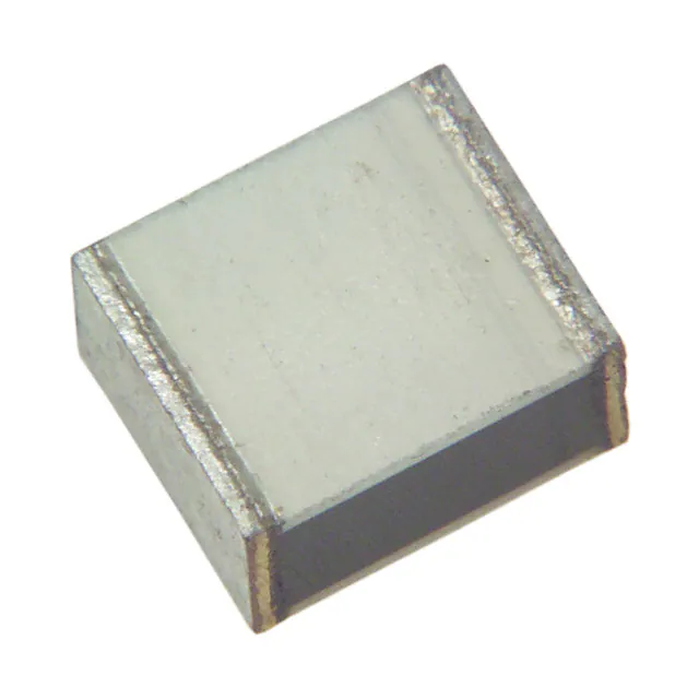

    薄膜电容 2416 68nF ±10% 6.00 x 4.10mm
ECW-U2683KC9 数据手册
Plastic Film Capacitors Stacked Metallized PEN Film Chip Capacitor ECWU(C) series Stacked metallized PEN film as dielectric with simple mold-less construction. Features ● Small in size ● For reflow soldering ● RoHS compliant Recommended applications ● General purpose (Coupling, By-pass) Explanation of part number 1 2 3 4 E C W U Product code 5 6 7 8 9 10 11 C Dielectric & construction Cap. Tol. Capacitance Rated voltage Suffix 1 R. voltage [DC] Code Cap. Tol. 1 100 V J ±5 % 9 12 mm 2 250 V K ±10 % V 16 mm 2 3 4 5 6 7 8 9 10 11 E C W U 1 1 0 4 V 3 3 Dielectric & construction Rated voltage Capacitance Code R. voltage [DC] 1 100 V 1 2 3 4 5 6 7 E C W U C 2 J Product code Dielectric & construction Suffix 2 Code 1 Product code 12 Suffix 1 Suffix Small size 8 Rated voltage Code Tape width Cap. Tol. Tape width ±5 % 12 mm 10 11 12 J V Cap. Tol. Suffix 2 9 Capacitance Code R. voltage [DC] Code Cap. Tol. 2J 630 V J ±5 % Code Tape width V 16 mm Specifications Category temp. range (Including temperature-rise on unit surface) Rated voltage [DC] Capacitance range Capacitance tolerance Dissipation factor (tan δ) Withstand voltage Insulation resistance (IR) Soldering conditions −55 ℃ to +125 ℃ 100 V, 250 V, 630 V (Derating of rated voltage by 1.25 %/℃ more than 85 ℃) 100 V 0.012 μF to 1.0 μF (E12) 250 V 0.0010 μF to 0.12 μF (E12) 630 V 0.022 μF, 0.027 μF, 0.033 μF 100 V ±5 %(J), ±10 %(K) (C ≧ 0.18 μF : ±10 %(K) Only) 250 V ±5 %(J)、±10 %(K) 630 V ±5 %(J) tan δ ≦ 1.0 % (20 ℃, 1 kHz) Between terminals: Rated voltage (V) × 150 % 60 s C ≦ 0.33 μF 100 V, 250 V, 630 V : IR ≧ 3000 MΩ (20 ℃, 100 V, 60 s) C > 0.33 μF 100 V : IR ≧ 1000 MΩ∙μF (20 °C, 100 V, 60 s) Reflow soldering:250 ℃ max. and 60 s max. at more than 220 ℃ 100 V 250 V (Temp. at capacitor surface) Reflow soldering:250 ℃ max. and 60 s to 150 s. at more than 217 ℃ 630 V (Temp. at cap. surface) * In case of applying voltage in alternating current (50 Hz or 60 Hz sine wave) to a capacitor with DC rated voltage,   please refer to the page of “Permissible voltage (R.M.S) in alternating current corresponding to DC rated voltage”. *Please consult us for capacitance range between 0.15 μF and 1.0 μF. (250 V [DC]) Design and specifications are each subject to change without notice. Ask factory for the current technical specifications before purchase and/or use. Should a safety concern arise regarding this product, please be sure to contact us immediately. 01-Oct-17 Plastic Film Capacitors Construction ECWU(C) series Dimensions (±0.5)*2 (±0.4)*1 L±0.2 H±0.2 (±0.3)*3 (±0.4)*3 W±0.3 Element (Stacked) 0.35±0.20 0.35±0.20 Outer electrode *1: To be applied only for size code Z、X. *2: To be applied only for size code V. *3: To be applied only for size code B, Z, X, V . Size code E1 E2 E3a E3 D1 D2 D3 D4 D5 B Z X V L 4.8 4.8 4.8 4.8 6.0 6.0 6.0 6.0 6.0 6.0 7.1 7.7 9.8 Unit : mm W 3.3 3.3 3.3 3.3 4.1 4.1 4.1 4.1 4.1 5.0 5.0 5.5 6.3 * Refer to the column H 1.4 2.0 2.4 2.8 1.8 2.0 2.4 2.8 3.2 * “Rating, Dimensions & Quantity”. Taping specification for automatic mounting ■ Refer to the page of taping specifications Rating · Dimensions · Quantity ■ Capacitance tolerance:±5 %(J), ±10 %(K) Capacitance (μF) 0.0010 0.0012 0.0015 0.0018 0.0022 0.0027 0.0033 0.0039 0.0047 0.0056 0.0068 0.0082 0.010 0.012 0.015 0.018 0.022 0.027 0.033 0.039 0.047 0.056 0.068 0.082 0.10 0.12 0.15 0.18 0.22 0.27 0.33 0.39 0.47 0.56 0.68 0.82 1.0 Rated voltage 100 V Part No. Rated voltage 250 V Dimensions(mm) L W H Size Q'ty code (PCS) Please use 0.001 μF to 0.01 μF rating ECWU(X) ECWU1123□C9 ECWU1153□C9 ECWU1183□C9 ECWU1223□C9 ECWU1273□C9 ECWU1333□C9 ECWU1393□C9 ECWU1473□C9 ECWU1563□C9 ECWU1683□C9 ECWU1823□C9 ECWU1104□C9 ECWU1104V33 ECWU1124□C9 ECWU1154□C9 ECWU1184KC9 ECWU1224KC9 ECWU1274KC9 ECWU1334KC9 ECWU1394KCV ECWU1474KCV ECWU1564KCV ECWU1684KCV ECWU1824KCV ECWU1105KCV * □:Capacitance tolerance 4.8 4.8 4.8 4.8 4.8 4.8 4.8 4.8 4.8 4.8 4.8 6.0 4.8 6.0 6.0 7.1 7.1 7.1 7.1 7.7 7.7 9.8 9.8 9.8 9.8 3.3 3.3 3.3 3.3 3.3 3.3 3.3 3.3 3.3 3.3 3.3 4.1 3.3 4.1 4.1 5.0 5.0 5.0 5.0 5.5 5.5 6.3 6.3 6.3 6.3 1.4 1.4 1.4 1.4 1.4 1.4 1.4 2.0 2.0 2.4 2.8 1.8 2.8 2.4 2.8 2.0 2.4 2.9 3.5 3.4 4.0 3.0 3.6 4.3 5.1 E1 E1 E1 E1 E1 E1 E1 E2 E2 E3a E3 D1 E3 D3 D4 Z Z Z Z x x V V V V 3000 2000 3000 2000 Part No. Dimensions(mm) L W H Size Q'ty code (PCS) ECWU2102□C9 ECWU2122□C9 ECWU2152□C9 ECWU2182□C9 ECWU2222□C9 ECWU2272□C9 ECWU2332□C9 ECWU2392□C9 ECWU2472□C9 ECWU2562□C9 ECWU2682□C9 ECWU2822□C9 ECWU2103□C9 ECWU2123□C9 ECWU2153□C9 ECWU2183□C9 ECWU2223□C9 ECWU2273□C9 ECWU2333□C9 ECWU2393□C9 ECWU2473□C9 ECWU2563□C9 ECWU2683□C9 ECWU2823□C9 4.8 4.8 4.8 4.8 4.8 4.8 4.8 4.8 4.8 4.8 4.8 4.8 4.8 4.8 4.8 4.8 4.8 4.8 4.8 6.0 6.0 6.0 6.0 6.0 3.3 3.3 3.3 3.3 3.3 3.3 3.3 3.3 3.3 3.3 3.3 3.3 3.3 3.3 3.3 3.3 3.3 3.3 3.3 4.1 4.1 4.1 4.1 5.0 1.4 1.4 1.4 1.4 1.4 1.4 1.4 1.4 1.4 1.4 1.4 1.4 1.4 1.4 1.4 2.0 2.0 2.4 2.8 2.0 2.4 2.8 3.2 3.2 E1 E1 E1 E1 E1 E1 E1 E1 E1 E1 E1 E1 E1 E1 E1 E2 E2 E3a E3 D2 D3 D4 D5 B ECWU2104□C9 6.0 5.0 3.8 B ECWU2124□C9 6.0 5.0 4.5 B 3000 2000 3000 2000 1500 1500 1000 Design and specifications are each subject to change without notice. Ask factory for the current technical specifications before purchase and/or use. Should a safety concern arise regarding this product, please be sure to contact us immediately. 01-Oct-17 Plastic Film Capacitors ECWU(C) series Rating · Dimensions · Quantity ■ Capacitance tolerance:±5 %(J) Rated voltage 630 V Capacitance(μF) Part No. L Dimensions(mm) W H Size code 0.022 ECWUC2J223JV 7.1 6.3 3.6 Y 0.027 ECWUC2J273JV 7.1 6.3 4.1 Y 0.033 ECWUC2J333JV 7.1 6.3 5.1 Y Q'ty (PCS) 1000 Recommended for land dimensions Unit : mm Electrode Land A B C Size code E1, E2, E3a, E3 D1, D2, D3, D4, D5 B Z Y X V Land dimensions Reflow soldering A B C 2.6 6.6 3.0 3.8 7.8 3.8 3.8 7.8 4.6 4.5 9.0 4.6 4.5 9.0 5.7 5.1 9.7 5.0 7.2 11.9 5.7 * lt is not warrantable that you can mount the capacitor without trouble under all the mounting condition when “Recommender for Land dimensions” is adopted. Design and specifications are each subject to change without notice. Ask factory for the current technical specifications before purchase and/or use. Should a safety concern arise regarding this product, please be sure to contact us immediately. 01-Oct-17 *XLGHOLQHVDQGSUHFDXWLRQVUHJDUGLQJWKH WHFKQLFDOLQIRUPDWLRQDQGXVHRIRXUSURGXFWV GHVFULEHGLQWKLVRQOLQHFDWDORJ ‫ٹ‬,I\RXZDQWWRXVHRXUSURGXFWVGHVFULEHGLQWKLVRQOLQHFDWDORJIRUDSSOLFDWLRQVUHTXLULQJ VSHFLDOTXDOLWLHVRUUHOLDELOLW\RUIRUDSSOLFDWLRQVZKHUHWKHIDLOXUHRUPDOIXQFWLRQRIWKH SURGXFWVPD\GLUHFWO\MHRSDUGL]HKXPDQOLIHRUSRWHQWLDOO\FDXVHSHUVRQDOLQMXU\  HJDLUFUDIWDQGDHURVSDFHHTXLSPHQWWUDIILFDQGWUDQVSRUWDWLRQHTXLSPHQWFRPEXVWLRQ HTXLSPHQWPHGLFDOHTXLSPHQWDFFLGHQWSUHYHQWLRQDQWLFULPHHTXLSPHQWDQGRUVDIHW\ HTXLSPHQW LWLVQHFHVVDU\WRYHULI\ZKHWKHUWKHVSHFLILFDWLRQVRIRXUSURGXFWVILWWRVXFK DSSOLFDWLRQV3OHDVHHQVXUHWKDW\RXZLOODVNDQGFKHFNZLWKRXULQTXLU\GHVNDVWRZKHWKHU WKHVSHFLILFDWLRQVRIRXUSURGXFWVILWWRVXFKDSSOLFDWLRQVXVHEHIRUH\RXXVHRXUSURGXFWV ‫ٹ‬7KHTXDOLW\DQGSHUIRUPDQFHRIRXUSURGXFWVDVGHVFULEHGLQWKLVRQOLQHFDWDORJRQO\DSSO\ WRRXUSURGXFWVZKHQXVHGLQLVRODWLRQ7KHUHIRUHSOHDVHHQVXUH\RXHYDOXDWHDQGYHULI\ RXUSURGXFWVXQGHUWKHVSHFLILFFLUFXPVWDQFHVLQZKLFKRXUSURGXFWVDUHDVVHPEOHGLQ\RXU RZQSURGXFWVDQGLQZKLFKRXUSURGXFWVZLOODFWXDOO\EHXVHG ‫ٹ‬,I\RXXVHRXUSURGXFWVLQHTXLSPHQWWKDWUHTXLUHVDKLJKGHJUHHRIUHOLDELOLW\UHJDUGOHVV RIWKHDSSOLFDWLRQLWLVUHFRPPHQGHGWKDW\RXVHWXSSURWHFWLRQFLUFXLWVDQGUHGXQGDQF\ FLUFXLWVLQRUGHUWRHQVXUHVDIHW\RI\RXUHTXLSPHQW ‫ٹ‬7KHSURGXFWVDQGSURGXFWVSHFLILFDWLRQVGHVFULEHGLQWKLVRQOLQHFDWDORJDUHVXEMHFWWR FKDQJHIRULPSURYHPHQWZLWKRXWSULRUQRWLFH7KHUHIRUHSOHDVHEHVXUHWRUHTXHVWDQG FRQILUPWKHODWHVWSURGXFWVSHFLILFDWLRQVZKLFKH[SODLQWKHVSHFLILFDWLRQVRIRXUSURGXFWVLQ GHWDLOEHIRUH\RXILQDOL]HWKHGHVLJQRI\RXUDSSOLFDWLRQVSXUFKDVHRUXVHRXUSURGXFWV ‫ٹ‬7KHWHFKQLFDOLQIRUPDWLRQLQWKLVRQOLQHFDWDORJSURYLGHVH[DPSOHVRIRXUSURGXFWV  W\SLFDORSHUDWLRQVDQGDSSOLFDWLRQFLUFXLWV:HGRQRWJXDUDQWHHWKHQRQLQIULQJHPHQWRI WKLUGSDUW\ VLQWHOOHFWXDOSURSHUW\ULJKWVDQGZHGRQRWJUDQWDQ\OLFHQVHULJKWRULQWHUHVW LQRXULQWHOOHFWXDOSURSHUW\ ‫ٹ‬,IDQ\RIRXUSURGXFWVSURGXFWVSHFLILFDWLRQVDQGRUWHFKQLFDOLQIRUPDWLRQLQWKLVRQOLQH FDWDORJLVWREHH[SRUWHGRUSURYLGHGWRQRQUHVLGHQWVWKHODZVDQGUHJXODWLRQVRIWKH H[SRUWLQJFRXQWU\HVSHFLDOO\ZLWKUHJDUGWRVHFXULW\DQGH[SRUWFRQWUROVKDOOEHREVHUYHG 5HJDUGLQJWKH&HUWLILFDWHRI&RPSOLDQFHZLWK WKH(85R+6'LUHFWLYH5($&+5HJXODWLRQV! ‫ٹ‬7KHVZLWFKRYHUGDWHIRUFRPSOLDQFHZLWKWKH5R+6'LUHFWLYH5($&+5HJXODWLRQVYDULHV GHSHQGLQJRQWKHSDUWQXPEHURUVHULHVRIRXUSURGXFWV ‫ٹ‬:KHQ\RXXVHWKHLQYHQWRU\RIRXUSURGXFWVIRUZKLFKLWLVXQFOHDUZKHWKHUWKRVHSURGXFWV DUHFRPSOLDQWZLWKWKH5R+6'LUHFWLYH5($&+5HJXODWLRQSOHDVHVHOHFW6DOHV,QTXLU\LQWKH ZHEVLWHLQTXLU\IRUPDQGFRQWDFWXV :HGRQRWWDNHDQ\UHVSRQVLELOLW\IRUWKHXVHRIRXUSURGXFWVRXWVLGHWKHVFRSHRIWKH VSHFLILFDWLRQVGHVFULSWLRQVJXLGHOLQHVDQGSUHFDXWLRQVGHVFULEHGLQWKLVRQOLQHFDWDORJ 2FW 3ODVWLF)LOP&DSDFLWRUV 35(&$87,21$1':$51,1* ‫ ٴ‬3OHDVHFRQVXOWXVLQFDVHWKDWGHPDQGWKHVSHFLILFDWLRQRIRXUFRPSDQ\ZLWKRXWIDLODQGGRWKHFRQILUPDWLRQRI WKHXVHFRQGLWLRQDQGWKDWH[FHHGVWKHHQWU\YDOXHDQGEHLQGLVWLQFWZKHQ\RXXVHLW ‫ ٴ‬7KHILOPFDSDFLWRUVFRQWDLQDILOPEDVHGGLHOHFWULFZKLFKPD\EHIODPPDEOHXQGHUFHUWDLQRSHUDWLQJFRQGLWLRQV :KHQLQXVHWKH\FDQHLWKHUHPLWVPRNHDQGRULJQLWHVKRXOGWKHSURGXFWEHGHIHFWLYH,WLVUHFRPPHQGHG FRYHULQJWKHVXUURXQGLQJUHVLQZLWKIODPHUHVLVWDQWPDWHULDOVRUFDVHDVQHHGHGSDUWLFXODUO\ ‫ ٴ‬,QWKHHYHQWRIWURXEOHVRIRWKHUSDUWVRQWKHFLUFXLWVXFKDVVKRUWHQLQJDQGRSHQLQJSURYLGHZLWKSURSHUPHDQV IRUSUHYHQWLQJH[FHVVLYHYROWDJHFXUUHQWRUWHPSHUDWXUHH[FHHGLQJWKHUDWLQJIURPEHLQJDSSOLHGWRWKHILOP FDSDFLWRU ‫ ٴ‬3ULRUWRXVHSOHDVHPDNHVXUHWKDWIDLOXUHRIWKHILOPFDSDFLWRUVGRHVQRWKDYHDQ\QHJDWLYHHIIHFWVRQRWKHU VXUURXQGLQJHOHFWURQLFFLUFXLWFRPSRQHQWVDQGGHYLFHVWKDWZRXOGSRVVLEO\FDXVHGDPDJH3URSHUVDIHW\ PHDVXUHVVKRXOGEHWDNHQXVLQJIDLOVDIHSURWHFWLYHFLUFXLWGHVLJQVWRKHOSSUHYHQWRWKHUGHYLFHVRIEHFRPLQJ XQVDIH ([DPSOH D6WDWHLQZKLFKEDVLFSHUIRUPDQFHRIDXWRPRELOHV UXQWXUQDQGVWRS  E)DOVHRSHUDWLRQV F6PRNHHPLVVLRQLJQLWLRQV ‫ ٴ‬7KH)LOP&DSDFLWRUOLVWHGLQWKLVFDWDORJ H[FHSWIRUDXWRPRWLYHVHULHV DUHGHVLJQHGDQGPDQXIDFWXUHG VSHFLILFDOO\IRUJHQHUDOHOHFWURQLFGHYLFHVLQFOXGLQJDXGLRYLGHRHTXLSPHQWKRPHDSSOLDQFHRIILFHHTXLSPHQW DQGGDWDFRPPXQLFDWLRQHTXLSPHQWHWF$FFRUGLQJO\LWLVVWURQJO\UHFRPPHQGHGWKDWWKHXVHUFRQWDFWXVLQ DGYDQFHLWWKHSDUWVDUHWREHXVHGIRUWKHIROORZLQJGHYLFHV LWHPV ZKLFKUHTXLUHKDYLQJDGYDQFHG VHFXULW\PHDVXUHV7KHFDSDFLWRUIRUDXWRPRWLYHFDQEHXVHGIRUDXWRPRELOHVVXFKDV[(9  7UDQVSRUW(TXLSPHQW PRWRUYHKLFOHVDLUSODQHVWUDLQVVKLSVWUDIILFVLJQDOFRQWUROOHUV  0HGLFDO(TXLSPHQW OLIHVXSSRUWHTXLSPHQWSDFHPDNHUVIRUWKHKHDUWGLDO\VLVFRQWUROOHUV  $LUFUDIW(TXLSPHQW$HURVSDFH(TXLSPHQW DLUSODQHVDUWLILFLDOVDWHOOLWHVURFNHWVHWF  6XEPDULQH(TXLSPHQW VXEPDULQHUHSHDWLQJHTXLSPHQWHWF  *HQHUDWLRQ&RQWURO(TXLSPHQW HTXLSPHQWIRUDWRPLFK\GUDXOLFKHDWSRZHUSODQWV  ,QIRUPDWLRQ3URFHVVLQJ(TXLSPHQW ODUJHVFDOHFRPSXWHUV\VWHP  (OHFWULF+HDWLQJ$SSOLDQFH%XUQLQJ$SSDUDWXV  5RWDU\0RWLRQ(TXLSPHQW  6HFXULW\6\VWHPV  5RERWV  /LJKWLQJ(TXLSPHQW  $QGDQ\VLPLODUW\SHVRIHTXLSPHQW ‫ ٴ‬,IXVHGLQDVSHFLILFDSSOLDQFHWKDWUHTXLUHVDQH[WUHPHO\KLJKUHOLDELOLW\GLUHFWO\UHODWLQJZLWKDQ\OLIHVXSSRUWLQJ HTXLSPHQWOLNHHOHFWURQLFDYLDWLRQFRQWUROOHUVDXWRPRWLYHGULYLQJFRQWUROOHUVDQGHQJLQHFRQWUROOHUVSOHDVH FRQVXOWXVDQGXVHZLWKLQWKHFRQGLWLRQVGHVLJQDWHGLQWKHVSHFLILFDWLRQ+RZHYHUWKHFKLSW\SHFDSDFLWRUVKRXOG QRWEHXVHGLQWKHVHDSSOLDQFHV 1RWH ‫؝‬7HFKQLFDOLQIRUPDWLRQLQWKLVFDWDORJLVLQWHQGHGWRFRQYH\H[DPSOHVRIW\SLFDOSHUIRUPDQFHVDQGRU DSSOLFDWLRQVDQGLVQRWLQWHQGHGWRFRQYH\SDWHQWVULJKWVLIDQ\ ‫)؝‬RUWKHSURGXFWVZKLFKDUHFRQWUROOHGLWHPVVXEMHFWWRWKH)RUHLJQ([FKDQJHDQG)RUHLJQ7UDGH&RQWURO/DZ WKHH[SRUWSHUPLVVLRQDFFRUGLQJWRWKH/DZLVQHFHVVDU\ ‫؝‬1RWHRIR]RQHGHSOHWLQJVXEVWDQFHVRIFODVV 2'6 XQGHUWKH0RQWUHDO3URWRFROLVXVHGLQPDQXIDFWXULQJ SURFHVVRI'HYLFH6ROXWLRQV%XVLQHVV'LYLVLRQ3DQDVRQLF&RUSRUDWLRQ 6HS 3ODVWLF)LOP&DSDFLWRUV *XLGHOLQHVDQGSUHFDXWLRQV &RPPRQ 7DUJHWSURGXFW(&4(岝(&:)岝(&:+岝(&48岝(&+8岝(&:8岝(&38 2SHUDWLQJYROWDJH )RUWKHILOPFDSDFLWRUYDULHVWKHPD[LPXPDSSOLFDEOHYROWDJHGHSHQGLQJRQWKHDSSOLHGYROWDJHZDYHIRUPFXUUHQW ZDYHIRUPIUHTXHQF\DPELHQWWHPSHUDWXUH FDSDFLWRUVXUIDFHWHPSHUDWXUH FDSDFLWDQFHYDOXHHWF8VHZLWKLQ WKHVSHFLILHGYDOXHVE\FKHFNLQJWKHYROWDJHZDYHIRUPFXUUHQWZDYHIRUPDQGIUHTXHQF\DSSOLHGWRERWKHQGVRI WKHFDSDFLWRUSULRUWRXVH ,QWKHFDVHRIKLJKIUHTXHQF\WKHSHUPLVVLEOHYROWDJHYDULHVZLWKWKHW\SHRIWKH FDSDFLWRU)RUGHWDLOVSOHDVHVHHWKHUHOHYDQWVSHFLILFDWLRQV   5DWHGYROWDJH 1RWH ‫ ٴ‬7KHUDWHGYROWDJHUHIHUVWRWKHPD[LPXPYROWDJHWKDWFDQEHDSSOLHGFRQWLQXRXVO\ZLWKLQWKHFDWHJRU\ WHPSHUDWXUHUDQJH,IXVHGEH\RQGWKHUDWLQJLWPD\LQGXFHLQVXODWLRQEUHDNGRZQRIWKHILOPDQGFDXVHVKRUW FLUFXLW7KHSURGXFWOLIHWLPHDEXWWKHPD[LPXPUDWHGFRQGLWLRQGHSHQGVRQWKHNLQGRIWKHFDSDFLWRU ‫ ٴ‬,QDPHWDOL]HGFDSDFLWRUZKLFKKDVDVHOIKHDOLQJDFWLRQVKRUWFLUFXLWRURWKHUIDLOXUHPD\QRWRFFXU LPPHGLDWHO\DIWHUDSSOLFDWLRQRIDYROWDJHRYHUWKHUDWHGYROWDJHEXWWKHLQVXODWLRQUHVLVWDQFHLVORZHUHGDQG LWPD\OHDGWRVPRNHRUILUHGHSHQGLQJRQWKHFLUFXLWFRQGLWLRQV ‫ ٴ‬$QRLVHVXSSUHVVLRQFDSDFLWRU $&UDWHGYROWDJH VKRXOGQRWEHXVHGDWKLJKIUHTXHQF\FLUFXLW 6PRNHDQGLJQLWLRQPD\EHFDXVHGE\FRQGLWLRQVIRUXVH ‫ ٴ‬7KHUDWHGYROWDJHRIWKHFDSDFLWRUIRUHOHFWURQLFDSSOLDQFHLVXVXDOO\LQGLFDWHGLQWKH'&YROWDJHH[FHSWIRU VSHFLDOSXUSRVHV   'HUDWLQJRIUDWHGYROWDJHZKHUHRSHUDWLQJWHPSHUDWXUHLVKLJK ,QILOPFDSDFLWRUVWKHXVDEOHXSSHUOLPLWWHPSHUDWXUH WKHFDSDFLWRUVXUIDFHWHPSHUDWXUH LVGHWHUPLQHGE\ WKHNLQGRIGLHOHFWULFPDWHULDOV :KHQXVHGEH\RQGWKHUDWHGXSSHUOLPLWWHPSHUDWXUH XVDEOHXSSHUOLPLWWHPSHUDWXUH LWLVQHFHVVDU\WR YROWDJHGHUDWHWKHLQFHUWDLQW\SHV PRGHOV ZKLOHRWKHUW\SHV PRGHOV FDQQRWEHXVHGEH\RQGWKHUDWHG XSSHUOLPLWWHPSHUDWXUH%HVXUHWRFRQILUPWKHW\SHRIFDSDFLWRUVEHIRUHXVLQJDQGZKHQXVLQJEH\RQGWKH UDWHGXSSHUOLPLWWHPSHUDWXUHEHVXUHWRUHGXFHWKHYROWDJHDQGPDNHVXUHWKHFDSDFLWRUVXUIDFH WHPSHUDWXUHLVZLWKLQWKHXVDEOHXSSHUOLPLWWHPSHUDWXUHDVEHORZ:KHQXVLQJDWKLJKIUHTXHQF\KRZHYHU VLQFHWKHFDSDFLWRULWVHOIKDVLWVRZQWHPSHUDWXUHULVHDQGKHQFHWKHIROORZLQJGHUDWLQJUDWLRFDQQRWEH DSSOLHG 6HS 3ODVWLF)LOP&DSDFLWRUV ٛ5DWHGXSSHUOLPLWWHPSHUDWXUH8SSHUFDWHJRU\WHPSHUDWXUHDQGGHUDWLQJUDWLRRIXSSHUFDWHJRU\ WHPSHUDWXUHE\W\SHVLQ'&XVHٜ‫[(ق‬DPSOH‫ك‬ 5DWHGXSSHU 5DWHGYROWDJHE\WKH 8SSHUFDWHJRU\ OLPLW WHPSHUDWXUHEH\RQG5DWHG WHPSHUDWXUH WHPSHUDWXUH XSSHUOLPLWWHPSHUDWXUH 7\SH 'LHOHFWULF (&4( ) 3RO\HVWHU 3(7 ٦ ٦ ٦ ٦ ٦ 1RQHHGGHUDWLQJRIUDWHG YROWDJH ٦ ٦ ٦ ٦ ٦ ٦ ٦ ٦ ٦ ٦ ٦ ٦ (&:8 ; ٦ ٦ 1RQHHGGHUDWLQJRIUDWHG YROWDJH (&:8 & ٦ ٦ ٦ ٦ ٦ 1RQHHGGHUDWLQJRIUDWHG YROWDJH ٦ ٦ 1RQHHGGHUDWLQJRIUDWHG YROWDJH ٦ ٦ ٦ (&+8 & ٦ ٦ 1RQHHGGHUDWLQJRIUDWHG YROWDJH (&38 $ ٦ ٦ 1RQHHGGHUDWLQJRIUDWHG YROWDJH (&4( % (&4( 7 (&:) $ UDWHGYROWDJH'&9 (&:) / (&:+ $ (&:+ & (&:) $ UDWHGYROWDJH'&9 3RO\SURS\OHQH 33 (&:) $ UDWHGYROWDJH'&9 (&:+ 9 (&:)(岜UDWHGYROWDJH'&9 (&:)'岜UDWHGYROWDJH'&9 (&:)(岜UDWHGYROWDJH'&9 (&:)'岜UDWHGYROWDJH'&9 (&:)*岜UDWHGYROWDJH'&9 SRO\HWK\OHQH QDSKWKDODWH 336 (&:8 9 (&+8 ; UDWHGYROWDJH'&9 (&+8 ; UDWHGYROWDJH'&9 ‫ق‬FDSDFLWDQFH̭)‫ك)̭ع‬ (&+8 ; UDWHGYROWDJH'&9 SRO\SKHQ\OHQH VXOILGH 336 ‫ق‬FDSDFLWDQFH̭)‫ك)̭ع‬ $FU\OLFUHVLQ 嵣 7KH$&UDWHGYROWDJHLWHPVDUHXQQHFHVVDU\IRUYROWDJHGHUDWLQJE\WKHWHPSHUDWXUH 5DWHGXSSHUOLPLWWHPSHUDWXUH7KHXSSHUOLPLWWHPSHUDWXUHZKLFKFDQ WUHGXFHWKHYROWDJHDQGFDQXVH FRQWLQXRXVO\ LQFOXGLQJRZQWHPSHUDWXUHULVH 8SSHUFDWHJRU\WHPSHUDWXUH7KHXSSHUOLPLWWHPSHUDWXUHZKLFKFDQUHGXFHWKHYROWDJHDQGXVH FRQWLQXRXVO\ LQFOXGLQJRZQWHPSHUDWXUHULVH ‫[( ە‬DPSOH 'HUDWLQJRIUDWHGYROWDJHWRRSHUDWLQJWHPSHUDWXUH5DWHGXSSHUOLPLWWHPSHUDWXUH٦8SSHU 9ROW 3HUFHQWDJHWRWKHUDWHG FDWHJRU\WHPSHUDWXUH٦'HUDWLQJRIUDWHGYROWDJHWRZKLFKLV٦DWPRUHWKDQ٦ &DS6XUIDFH7HPS ٦ 6HS 3ODVWLF)LOP&DSDFLWRUV   3HUPLVVLEOHYROWDJH 506 LQFXUUHQWFRUUHVSRQGLQJWR'&5DWHG9ROWDJH ‫ ٴ‬$QRLVHVXSSUHVVLRQFDSDFLWRU $&UDWHGYROWDJH VKRXOGEHXVHGDWWKHSULPD\VLGHSRZHUVXSSOLHV 7KHGHVLJQZKLFKSUHPLVHGRQXVHE\+]RU+]VLQHZDYH ‫ ٴ‬,QFDVHRIDSSO\LQJYROWDJHLQDOWHUQDWLQJFXUUHQW +]RU+]VLQHZDYH WRDFDSDFLWRUSHUPLVVLEOH YROWDJH 506 7KHFDSDFLWRURI'&UDWLQJVKRXOGQRWEHXVHGDWWKHSULPDU\VLGHSRZHUVXSSOLHV   'HUDWLQJRIUDWHGYROWDJHZKHQXVLQJDWKLJKIUHTXHQF\ :KHQXVLQJDWKLJKIUHTXHQF\WKHUHLVDULVNRIWKHUPDOUXQDZD\ VPRNHILUH GXHWRVHOIKHDWJHQHUDWLRQLQ WKHFDSDFLWRU'HUDWHWKHRSHUDWLQJYROWDJHDFFRUGLQJWRWKHH[DPSOHEHORZ )RUXVHDWKLJKIUHTXHQF\ZHUHFRPPHQG(&+8 ;  & (&:) $  / DQG(&:+ $  &  9 W\SHV ٛ'HUDWLQJH[DPSOHRIRSHUDWLQJYROWDJHٜ &DSDFLWRUXVHG(&:)-$ 9'&̭) 2SHUDWLQJIUHTXHQF\N+] VLQHZDYH 3HUPLVVLEOHFXUUHQW HQWU\WKHYDOXHIURPVSHFLILFDWLRQ N+]$UPV , 9   9UPV ̱I&¼¼¼¼¼ 7KHUHIRUHWKHRSHUDWLQJYROWDJHDWVLQHZDYHN+]LVORZHUWKDQWR9UPV GHUDWLQJUDWLR DV FRPSDUHGZLWK$&SHUPLWWHGYROWDJHRI9UPVDWFRPPHUFLDOIUHTXHQF\ ,WLVQHFHVVDU\WRGHUDWHXQWLOWKHVHOIKHDWLQJWHPSHUDWXUHULVHRIWKHFDSDFLWRULVEHORZWKHVSHFLILHGYDOXH 1RWHV  8VHWKHSHDNYDOXH 9RS RIWKH3XOVHYROWDJHDSSOLHGEHWZHHQWKHERWKWHUPLQDOVRIWKHFDSDFLWRU ZLWKLQWKH'&UDWHGYROWDJH  :KHQXVLQJDWKLJKIUHTXHQF\LWPD\OHDGWREUHDNGRZQGXHWRZLWKVWDQGYROWDJHGHWHULRUDWLRQE\VHOI KHDWJHQHUDWLRQ7KHUHIRUHPHDVXUHWKHVHOIKHDWLQJWHPSHUDWXUHULVHYDOXHRIWKHFDSDFLWRUDQGPDNH VXUHLWLVZLWKLQWKHVSHFLILHG  3URWHFWLRQIRUVDIHW\VKRXOGEHUHTXLUHGLQWKHFDVHRIWKHYROWDJHRYHUWKHUDWHGYROWDJH SHUPLWWHG YROWDJH PD\EHDSSOLHGWRWKHFDSDFLWRUGXHWRDEQRUPDODFWLRQVXFKDVWURXEOHHOVHZKHUHLQWKHFLUFXLW  3HUPLWWHGFXUUHQW )LOPFDSDFLWRUVDUHORZLQLQWHUQDOLPSHGDQFHDQGKHQFHDYHU\ODUJHFXUUHQWPD\IORZGHSHQGLQJRQWKHFLUFXLW ,QSDUWLFXODUZKHQWXUQLQJSRZHUVZLWFKRQDQGRIIPDNHVXUHDYHU\KLJKSXOVHFXUUHQWPD\IORZ :KHQDFXUUHQWH[FHHGLQJWKHSHUPLVVLEOHUDQJHIORZVLQWRFDSDFLWRUWKLVFDQFDXVHWKHFDSDFLWDQFHYDOXHWR GHWHULRUDWHRUDQRSHQFLUFXLWFRQGLWLRQWHPSHUDWXUHULVHRFFXUVGXHWRVHOIKHDWJHQHUDWLRQWKLVFDXVHFDQ GHWHULRUDWLRQRIZLWKVWDQGYROWDJHDQGUHVXOWLQVKRUWFLUFXLWSRVVLEO\OHDGLQJWRVPRNHRUILUH ,QWKHDSSOLFDWLRQPDNHVXUHFXUUHQWLVZLWKLQSHUPLVVLEOHFXUUHQWRUVHOIKHDWLQJWHPSHUDWXUHLVZLWKLQ SHUPLVVLEOHVHOIKHDWLQJWHPSHUDWXUHULVHOLPLWVKRZQRQHDFKGHOLYHU\VSHFLILFDWLRQV   3HUPLVVLEOHFXUUHQW 7KHSHUPLVVLEOHFXUUHQWPXVWEHFRQVLGHUHGE\GLYLGLQJLQWRSXOVHFXUUHQW SHDNFXUUHQW DQGFRQWLQXRXV FXUUHQW UPVFXUUHQW GHSHQGLQJRQWKHEUHDNGRZQPRGHDQGZKHQXVLQJWKHUHIRUHPDNHVXUHWKHERWK FXUUHQWVDUHZLWKLQWKHSHUPLVVLEOHYDOXHV   3HUPLVVLEOHFXUUHQWWRRSHUDWLQJIUHTXHQF\ 7KHILOPFDSDFLWRUYDULHVLQWKHIUHTXHQF\FKDUDFWHULVWLFRIWKHGLVVLSDWLRQIDFWRU WDQ̥ GHSHQGLQJRQWKH GLVVLSDWLRQIDFWRUDQGKHQFHWKHSHUPLVVLEOHUPVFXUUHQWIRURSHUDWLQJIUHTXHQF\GLIIHUVGHSHQGLQJRQWKH FDSDFLWRUW\SH,QSDUWLFXODUZKHQRSHUDWLQJDWKLJKIUHTXHQF\WKHGLVVLSDWLRQIDFWRU WDQ̥ LQFUHDVHVDQG ZKHQXVLQJRYHUWKHSHUPLVVLEOHFXUUHQWLWPD\LQFOXGHWKHWKHUPDOUXQDZD\SRVVLEO\OHDGLQJWRVPRNHRU ILUH6KRZQEHORZDUHW\SLFDOH[DPSOHVRISHUPLVVLEOHFXUUHQWE\IUHTXHQF\ UPVYDOXH RIWKH(&4( ) W\SH XVLQJSRO\HVWHUILOPDQG(&:) $ W\SHXVLQJSRO\SURS\OHQHILOP)RUGHWDLOLQTXLUHXVE\SUHVHQWLQJWKH RSHUDWLQJFRQGLWLRQVRUPDNHVXUHWKHRZQWHPSHUDWXUHULVHRIWKHFDSDFLWRUDQGWKHFDSDFLWRUVXUIDFH WHPSHUDWXUHDUHZLWKLQWKHSHUPLVVLEOHUDQJHLQWKHZRUVWRSHUDWLQJFRQGLWLRQV 6HS 3ODVWLF)LOP&DSDFLWRUV   7KHFDSDFLWDQFHDQGWKHSHUPLVVLEOHFXUUHQWV 7KHSHUPLVVLEOHUPVFXUUHQWYDULHVZLWKWKHFDSDFLWDQFHYDOXH7KHSHUPLVVLEOHFXUUHQW UPV YDOXHVE\WKH IUHTXHQFLHVDQGE\WKHFDSDFLWDQFHRIUHSUHVHQWDWLYHW\SHVDUHVKRZQEHORZ,QDFWXDOXVHLQTXLUHXVIRU GHWDLOE\PHDVXULQJWKHYROWDJHDQGFXUUHQWZDYHIRUPVDPELHQWWHPSHUDWXUHDQGRZQWHPSHUDWXUHULVH 7\SH(&4( )  3RO\HVWHU 7\SH(&:) $  3RO\SURS\OHQH 5DWHG9ROWDJH9'&‫ܒ‬9UPV+] DWVLQHZDYH 5DWHG9ROWDJH9'&‫ܒ‬9UPV+] DWVLQHZDYH 2SHUDWLQJWHPS ٦WR٦ &DSVXUIDFH  2SHUDWLQJWHPS ٦WR٦ &DSVXUIDFH  㻝㻜㻚㻜䃛㻲 㻠㻚㻡 㻠㻚㻜 㻟㻚㻡 㻠㻚㻣䃛㻲 㻟㻚㻜 㻞㻚㻡 㻞㻚㻞䃛㻲 㻞㻚㻜 㻝㻚㻜 㻝㻚㻜䃛㻲 㻝㻚㻡 㻜㻚㻞㻞䃛㻲 㻜㻚㻡 㻜㻚㻠㻣䃛㻲 㻜㻚㻝㻜䃛㻲 㻜㻚㻜㻠㻣䃛㻲 㻜㻚㻜㻝㻜䃛㻲 㻜㻚㻜㻞㻞䃛㻲 㻜㻚㻜 㻝㻜 㻡㻜 ‫ص‬ )UHTXHQF\‫ۚق‬+]‫ك‬ 㻝㻜㻜 1RWH ‫ ص‬ಅ 3HUPLVVLEOH&XUUHQW ઍ ਗ਼ ૴ க ‫ق‬$UPV‫ص ك‬ ‫ ص‬ಅ ઍ ਗ਼3HUPLVVLEOH&XUUHQW ૴ க ‫ق‬$UPV‫ص ك‬ 㻡㻚㻜 ‫ص‬ 7KHJUDSKVLOOXVWUDWHGDUH IRUUHIHUHQFHRQO\ :DYHIRUPRIFXUUHQWDQG WHPSHUDWXUHULVHRI FDSDFLWRUDUHNH\IDFWRUV WRGHWHUPLQHSHUPLVVLEOH FXUUHQW)RUDFWXDO DSSOLFDWLRQFRQVXOWRXU VDOHVUHSUHVHQWDWLYHRU 㻡㻜 ‫ص‬ 㻝㻜㻜 )UHTXHQF\‫ۚق‬+]‫ك‬ VDOHVRIILFH ‫ص‬   3HUPLVVLEOHFXUUHQWWRSXOVHFXUUHQW ‫ ٴ‬:KHQXVHGLQVZLWFKLQJFLUFXLWVRUVQXEEHUFLUFXLWVDPRPHQWDU\KLJKFXUUHQWSXOVHPD\FDXVHORFDOKHDW JHQHUDWLRQ7KLVFDXVLQJWKHFDSDFLWDQFHYDOXHWRGHWHULRUDWHRUDQRSHQFLUFXLWFRQGLWLRQ /RFDOKHDWJHQHUDWLRQPD\DOVRLQGXFHVPRNHRUILUH 7KHSXOVHSHUPLVVLEOHFXUUHQW WLPHV LVREWDLQHGE\WKHSURGXFWRIG9GW 9̭V YDOXHWKDWLVHQWHULQJ WRWKHVSHFLILFDWLRQDQGFDSDFLWDQFH ̭)  ‫ ٴ‬7KHG9GW 9̭V YDOXHRIDILOPFDSDFLWRULVGHWHUPLQHGE\WKHHOHPHQWVWUXFWXUHDQGLQWKHPHWDOL]HGW\SH LQSDUWLFXODUWKHLQWHUQDOHYDSRUDWHGHOHFWURGHDQGH[WHUQDOWDNHRXWHOHFWURGHDUHFRQQHFWHGE\PHWDOL]HG FRQWDFW PHWDOVSUD\LQJ DQGKHQFHGXHFDXWLRQLVQHHGHGEHFDXVHWKHXSSHUOLPLWRIG9GWYDOXHLVORZ ‫ ٴ‬7KHG9GWYDOXHVFRUUHVSRQGLQJWRUDWHGYROWDJHDQGFDSDFLWDQFHYDOXHRIUHSUHVHQWDWLYHW\SHVDUHVKRZQLQ SDJH:KHQXVHGLQDKLJKFXUUHQWSXOVHFLUFXLWFKHFNWKHSXOVHSHUPLVVLEOHFXUUHQW $RS  ‫ ٴ‬3OHDVHFRQWDFWZLWKXV,ISXOVHVDUHDSSOLHGPRUHWKDQWLPHV +RZWRGHWHUPLQHSXOVHSHUPLVVLEOHFXUUHQW! ‫ ٴ‬:KHQYROWDJH9 9 LVDSSOLHGWRFDSDFLWRU& )IRUIDUDG WKHHOHFWULFFKDUJH4 & LVH[SUHVVHGLQIRUPXOD岜⋇ 4 &9⋇ ‫ ٴ‬7KHFKDUJLQJFXUUHQW, $ IORZLQWKHFDSDFLWRUDWWKLVWLPHLVH[SUHVVHGLQIRUPXOD⋈ , G4GW⋈ ‫' ٴ‬LIIHUHQWLDWLQJERWKVLGHVRIIRUPXOD⋇E\WLPHWDQGSXWWLQJLQWRIRUPXOD⋈\LHOGVIRUPXOD⋉ G4GW &G9GW , &G9GW⋉ ‫ ٴ‬7KHUHIRUHWKHSXOVHFXUUHQWLVGHWHUPLQHGDVWKHSURGXFWRIWKHFDSDFLWDQFHYDOXH& ̭) DQGYROWDJHFKDQJH G9GWSHṶV SURGXFWRIWKHFDSDFLWDQFHYDOXH& ̭) DQG YROWDJHFKDQJHG9GWSHṶV  ([DPSOH ,QWKHFDVHRI(&4(.) SHUPLVVLEOHG9GW 5DWHGYROWDJH9'& &DSDFLWDQFH̭) SHUPLVVLEOHG9GWYDOXH SXOVHSHUPLVVLEOHFXUUHQW ̭) ¼‫ܠ‬$RS KRZHYHUQXPEHURIUHSHWLWLRQVLVWLPHVRUOHVV WKDWLVPRPHQWDU\SXOVHFXUUHQWFDQEHXVHGXSWR $RS 0DNHVXUHWKHUPVFXUUHQWLVZLWKLQWKHSHUPLVVLEOHYDOXH 6HS 3ODVWLF)LOP&DSDFLWRUV >(&4( ) 3HUPLVVLEOHG9GWYDOXHZLWKLQSXOVHV!@ 7\SH  &DS̭) (&4( ) (&4( ) 9'& 9'&    ‫ك‬                       ‫ك‬   3          3               3 岜‫كق‬ 岜‫كق‬ 3 岜‫كق‬         3   3             3 3   8QLW‫؟‬9̭V (&4( ) 9'& (&4( ) 9'&   3 3  3  3  3  3  3  3  3 &DXWLRQ 3URWHFWLYHPHDQVIRUVDIHW\VKRXOGEHSURYLGHGLQFDVHWKHSXOVHDQGUPVFXUUHQWPD\H[FHHGWKH $VWHULVNGHQRWHVWKHOHDGSLWFK 7KHYDOXHRIG9GWLVPDLQO\GHWHUPLQHGE\WKHOHDGVSDFLQJ HOHPHQWZLGWK DQGHOHPHQWVHFWLRQDODUHD  2SHUDWLQJWHPSHUDWXUHUDQJH   2ZQWHPSHUDWXUHULVH :KHQWKHILOPFDSDFLWRULVXVHGLQDQ$&FLUFXLWHVSHFLDOO\LQKLJKIUHTXHQF\DSSOLFDWLRQWKH FDSDFLWRUJHQHUDWHVKHDWE\LWVHOIIURPWKHIORZRIFXUUHQW,IWKHVHOIKHDWJHQHUDWLRQLVODUJHWKHFDSDFLWRU PD\GHWHULRUDWHDQGVPRNHRUILUHPD\EHRFFXU&KHFNWKHVHOIKHDWLQJWHPSHUDWXUHULVHYDOXHLQDFWXDO FRQGLWLRQVRIXVHDQGXVHZLWKLQWKHOLPLWVSHFLILHG 0HDVXUHWKHRZQWHPSHUDWXUHULVHYDOXHLQLQGRRUZLQGIUHHFRQGLWLRQ 7KHGHWDLOVRIVHOIKHDWLQJWHPSHUDWXUHULVHYDOXHDUHGHVFULEHGLQWKHVSHFLILFDWLRQ 3OHDVHFRQWDFWXVGHWDLOV DVWKHVSHFLILHVYDOXHYDULHVE\HDFKW\SH   2SHUDWLQJWHPSHUDWXUHUDQJH 7KHRSHUDWLQJWHPSHUDWXUHUDQJHRIWKHILOPFDSDFLWRUVYDULHVZLWKWKHGLHOHFWULFPDWHULDO NLQGRIILOPV DQG WKHXVDEOHWHPSHUDWXUHUDQJHLVVSHFLILHGLQWKHHDFKPRGHO ,WPXVWEHQRWHGKRZHYHUWKDWWKHWHPSHUDWXUHUDQJHPHQWLRQHGLQWKHFDWDORJXHLVWKHVXUIDFH WHPSHUDWXUHRIWKHILOPFDSDFLWRUQRWWKHDPELHQWWHPSHUDWXUHRIWKHFDSDFLWRU ,QDFWXDOXVHPDNHVXUHWKHVXPRIWKHDPELHQWWHPSHUDWXUHFDSDFLWRUbVVHOIKHDWLQJWHPSHUDWXUHULVH YDOXH ZLWKLQVSHFLILHGYDOXH WKDWLVWKHFDSDFLWRUVXUIDFHWHPSHUDWXUHVKRXOGEHZLWKLQWKHUDWHGRSHUDWLQJ WHPSHUDWXUH 6HS 3ODVWLF)LOP&DSDFLWRUV &DXWLRQ :KHQXVHGDERYHWKHVSHFLILHGRSHUDWLQJWHPSHUDWXUHGLVVLSDWLRQIDFWRU WDQ̥ LQFUHDVHDQGWKHVHOIKHDW JHQHUDWLRQPD\H[FHHGWKHSHUPLVVLEOHYDOXHSRVVLEO\FDXVLQJGHWHULRUDWLRQRIGLHOHFWULFILOPVKRUWFLUFXLW DQGVPRNHRUILUH ,IWKHUHLVFRROLQJSODWHRIRWKHUSDUWRUDQ\UHVLVWDQFHKHDWHGWRKLJKWHPSHUDWXUHQHDUWKHILOPFDSDFLWRU WKHFDSDFLWRUPD\EHORFDOO\KHDWHGE\WKHUDGLDWLRQKHDWH[FHHGLQJWKHRSHUDWLQJWHPSHUDWXUHUDQJHDQG VPRNHRUILUHPD\EHFDXVHG &KHFNWKHFDSDFLWRUVXUIDFHWHPSHUDWXUHDWWKHKHDWVRXUFHVLGH  2WKHUFDXWLRQV   )ODPHUHWDUGDWLRQ ‫ ٴ‬7KHGLHOHFWULFILOPLVQRWDIODPHUHWDUGDQWPDWHULDO ‫ ٴ‬,QWKH(&4((&:)DQG(&:+W\SHVIODPHUHWDUGDQWHSR[\UHVLQ 9 LVXVHGLQWKHFRDWLQJUHVLQ   (QYLURQPHQWVRIXVH ‫؝‬   :KHQXVHGLQKXPLGHQYLURQPHQWV :KHQXVHGIRUDORQJSHULRGLQKXPLGHQYLURQPHQWVWKHHOHPHQWVDEVRUEPRLVWXUHWKURXJKWKHFRDWLQJ ZLWKWKHSDVVLQJRIWKHWLPH7KHZDWHUR[LGL]HVWKHHOHFWURGH HYDSRUDWHGILOPDQGPHWDOL]HGFRQWDFW  DQGOHDGVWRWURXEOH$OVRPDNHVXUHWKHFDSDFLWDQFHYDOXHFDQEHYHU\ODUJHGHSHQGLQJRQW\SHRIWKH FDSDFLWRU   :KHQXVLQJLQKLJKWHPSHUDWXUHHQYLURQPHQW ‫؝‬ :KHQ(&48*LVXVHGLQKLJKWHPSHUDWXUHHQYLURQPHQW PRUHWKDQ٦ LWPD\EHSRVVLEOHWRFDXVH OHDNLQJRLOIURPWKHFDSDFLWRU+RZHYHUWKHTXDOLW\DQGUHOLDELOLW\RIWKHFDSDFLWRULVQRWDIIHFWHGE\WKH OHDNLQJRLO%XWSOHDVHGRQ WXVHWKHSDUWZKLFKPD\FDXVHDSRLQWRIWDFWREVWDFOHE\RLODQGWKLV FRQGHQVHUE\DVDPHVHW ‫؝‬   &DXWLRQVRQJDVDWPRVSKHUH :KHQXVLQJLQWKHR[LGL]LQJJDVVXFKDVK\GURJHQFKORULGHK\GURJHQVXOILGHDQGVXOIXURXVDFLGWKH HYDSRUDWHGHOHFWURGH $OXPLQXP RUPHWDOL]HGFRQWDFW ]LQF岜FRPSRXQG PD\EHR[LGL]HGPD\UHVXOWLQ VPRNHRUILUH$YRLGVXFKDWPRVSKHUH   :KHQXVLQJE\UHVLQFRDWLQJ ‫؝‬ :KHQXVLQJUHVLQFRDWLQJRUUHVLQSRWWLQJFRPSRQHQWVWRLPSURYHKXPLGLW\UHVLVWDQFHRUJDVUHVLVWDQFH RUWRIL[SDUWVLQSODFH3OHDVHFRQWDFWZLWKXV ‫ ٴ‬7KHVROYHQWRUWKHFRQVWLWXHQWLQWKHUHVLQPD\SHUPHDWHLQWRWKHPHWDOL]HGFRQWDFWRUHOHFWURGH DOXPLQXPIRLORUHYDSRUDWHGILOP WRGHWHULRUDWHFKDUDFWHULVWLFV ‫ ٴ‬:KHQKDUGHQLQJWKHUHVLQFKHPLFDOUHDFWLRQKHDW FXULQJKHDWJHQHUDWLRQ RFFXUVZKLFKPD\DGYHUVHO\ DIIHFWWKHFDSDFLWRU ‫ ٴ‬,QWKHFDVHRIWKHOHDGW\SHFDSDFLWRUVEHVXUHWRWHVWDQGHYDOXDWHHQRXJKIRUWKHWKHUPDOVWUHVVWRWKH FDSDFLWRU ‫؝‬   2WKHU ‫ ٴ‬:KHQXVLQJLQWKHIROORZLQJFRQGLWLRQVWKHFKDUDFWHULVWLFPD\EHGHWHULRUDWLRQ3OHDVHGRQ WXVHDWVXFK FRQGLWLRQV ҩ7KHSODFHWKDWWRRNZDWHURURLO ҩ7KHSODFHWKDWH[SRVHGWRWKHGLUHFWVXQOLJKW ҩ7KHSODFHWKDWUDGLDWHGR]RQHXOWUDYLROHWUD\VDQGUDGLDWLRQUD\V ‫ ٴ‬3OHDVHFRQVLGHUVRWKDWGXVWGRHVQ WFROOHFW7KDWZLOOEHWKHFDXVHRIWKHFKDUDFWHULVWLFGHWHULRUDWLRQ VKRUWFLUFXLWHWF    &KDQJHVLQFDSDFLWDQFHYDOXHRYHUWLPH ‫ ٴ‬7KHFDSDFLWRUFKDUDFWHULVWLFVFKDQJHFKDUDFWHULVWLFGHSHQGLQJRQLWVDPELHQWFRQGLWLRQVDQG HQYLURQPHQWDOFRQGLWLRQV,QQDWXUDOFRQGLWLRQVWKHUHLVDFHUWDLQFDSDFLWDQFHFKDQJHGXHWRWKH KXPLGLW\RIWKHFLUFXPVWDQFH7KHGHJUHHRIVXFKFDSDFLWDQFHFKDQJHVYDULHVZLWKWKHGLHOHFWULFPDWHULDO FRDWLQJPDWHULDODQGVWUXFWXUH7KHUHIRUHZHVKLSFRQVLGHULQJWKHVHFKDQJHVEXWZHRQO\JXDUDQWHH FDSDFLWDQFHYDOXHXQWLOGHOLYHU\ ZLWKRXWHDFKDUUDQJHPHQWV ‫) ٴ‬RUXVHLQDFLUFXLWZKHUHWLPHFRQVWDQWDQGFDSDFLWDQFHSUHFLVLRQDUHUHTXLUHGXVHWKHSURGXFWVRI SRO\SURS\OHQHILOP(&:)' $  / (&:+ $ RUILOP(&+8 ;  & ZKLFKYDU\OHVVZLWKWLPH 6HS 3ODVWLF)LOP&DSDFLWRUV   +XP %X]] ‫ ٴ‬+XPSURGXFHGE\FDSDFLWRUVGXHWRPHFKDQLFDOYLEUDWLRQRIWKHILOPLVFDXVHGE\WKHFRXORPEIRUFH ZKLFKH[LVWVEHWZHHQHOHFWURGHVRIRSSRVLWHSRODULW\$ORXGHUKXPLVSURGXFHGZKHQDSSOLHGYROWDJH ZDYHIRUPKDVGLVWRUWLRQDQGRUKLJKHUIUHTXHQF\FRPSRQHQWHWF$OWKRXJK+XPGRHVQRWVSRLO FKDUDFWHULVWLFVRIFDSDFLWRUVZKHQEHLQJXVHGDURXQGWKHDXGLRIUHTXHQF\SOHDVHFKHFNLW   6WRULQJPHWKRGVWRULQJFRQGLWLRQV ‫ ٴ‬,WPXVWEHQRWHGWKDWWKHVROGHUELOLW\RIWKHH[WHUQDOHOHFWURGHPD\GHWHULRUDWHGZKHQVWRUHGLQDQ DWPRVSKHUHILOOHGZLWKPRLVWXUHGXVWRUDUHDFWLYHR[LGL]LQJJDV K\GURJHQFKORULGHK\GURJHQVXOILGH VXOIXULFDFLG  ‫ ٴ‬6KRXOGQRWORFDWLRQZLWKSDUWLFXODUO\KLJKWHPSHUDWXUHDQGKLJKKXPLGLW\DQGVWRUHLQFRQGLWLRQVQRW H[FHHGLQJ٦DQG5+ ‫ ٴ‬:KHQLWLVNHSWIRUDORQJWHUPWKHVROGHUELOLW\RIWKHH[WHUQDOHOHFWURGHPD\GHWHULRUDWHIRUR[LGDWLRQRI HOHFWURGHVXUIDFH6RRXUUHFRPPHQGNHHSLQJSHULRGLVZLWKLQPRQWK)XUWKHULW VGLIIHUHQWLQWKH FRQGLWLRQGHSHQGLQJRQWKHLWHPVVRSOHDVHLQTXLUHIRUGHWDLOV   +DQGOLQJ3UHFDXWLRQV ‫ ٴ‬6XGGHQFKDUJLQJRUGLVFKDUJLQJPD\FDXVHGHWHULRUDWLRQRIFDSDFLWRUVXFKDVVKRUWLQJDQGRSHQLQJGXHWR FKDUJLQJRUGLVFKDUJLQJFXUUHQW:KHQFKDUJLQJRUGLVFKDUJLQJSDVVWKURXJKDUHVLVWDQFHRIWR ̚9RUPRUH ‫ ٴ‬:KHQFRQQHFWLQJPXOWLSOHILOPFDSDFLWRUVLQSDUDOOHOLQZLWKVWDQGYROWDJHWHVWRUOLIHWHVWFRQQHFWDUHVLVWDQFH RIWR̚9RUPRUHLQVHULHVWRHDFKFDSDFLWRU ‫ ٴ‬%HFDUHIXOQRWWRVFUDWFKWKHFDSDFLWRUVXUIDFHZLWKVKDUSHGJHV VXFKDVVFUHZGULYHUVROGHULQJLURQ SLQFHUVFKDVVLV 'RQbWDSSO\H[FHVVLYHORDGWRWKHOHDGZLUH DWWKHWLPHRIUHSURFHVVLQJRIOHDGZLUH HWF  ‫ ٴ‬,IWKHFDSDFLWRULVGURSSHGE\PLVWDNHLWVFKDUDFWHULVWLFVPD\EHGDPDJHG'RQbWXVHVXFKDFDSDFLWRU ,IUHXVLQJFKHFNWKHTXDOLW\VXIILFLHQWO\ ‫ ٴ‬,QWKHFDVHRIOHDGHGW\SHFDSDFLWRUEHFDUHIXOQRWWRDSSO\H[FHVVLYHIRUFHWRWKHOHDGZLUHURRWDUHD ZKLFKPD\FDXVHFUDFNLQJRUVHSDUDWLRQLQWKHFRDWLQJUHVLQQHDUWKHURRWDUHD ‫ ٴ‬1RGXVWRUZDWHUVKRXOGEHSHUPLWWHGWRUHPDLQRQWKHVXUIDFHRIFDSDFLWRUWHUPLQDOVDVWKLVPD\FDXVH HOHFWULFDOOHDNDJHRUFRUURVLRQ ‫ ٴ‬:KHQXVHGIRUQRLVHVXSSUHVVLRQEHWZHHQOLQHVDQGEHWZHHQOLQHWRHDUWKZKHQYROWDJHLVPRUHWKDQ 9$&DQGPRUHWKDQ9'&FRYHULQJSHULSKHUDOUHVLQSDUWE\IODPHUHWDUGDQWPDWHULDORUIODPH UHWDUGDQWFDVH IRUDYRLGLQJILUH LVUHFRPPHQGHG ‫& ٴ‬KLSW\SHFDSDFLWRULVGHYHORSHGDVVXPLQJQRUPDOXVHRIVXUIDFHPRXQWLQJSDUWV$EQRUPDOXVH H[ SLOLQJXSWZRFDSDFLWRUVPRXQWLQJFDSDFLWRULQXSULJKWSRVLWLRQHWF VKRXOGQRWEHSHUPLWWHG3OHDVH FRQVXOWXVLQDGYDQFHLIXVHGLQGLIIHUHQWZD\IURPQRUPDO   $GGLWLRQDO3RLQWV ‫ ٴ‬7KHSUHFDXWLRQVLQXVLQJILOPFDSDFLWRUVIROORZWKH-(,7$5&5'n6DIHW\$SSOLFDWLRQ*XLGHIRUIL[G SODVWLFILOPFDSDFLWRUVIRUXVHLQHOHFWURQLFHTXLSPHQW|3OHDVHUHIHUWRWKHDERYHJXLGHOLQH ‫ ٴ‬3URGXFWVSHFLILFDWLRQVPDWHULDOVDQGRWKHUSRLQWVPHQWLRQHGLQWKHFDWDORJPD\EHFKDQJHGZLWKRXW QRWLILFDWLRQ 1RWH 5DWHGYROWDJH 7KHPD[LPXPYROWDJHWKDWFDQEHDSSOLHGFRQWLQXRXVO\LQVSLWHRIWHPSHUDWXUHLVFDOOHGDVWKHUDWHG YROWDJHLQRXUFRPSDQ\,W VGLIIHUHQWIURPWKHVWDQGDUGVRI-,6DQG,(& ‫' ٮ‬HILQLWLRQRIRXUFRPSDQ\ 7KHPD[LPXPYROWDJHWKDWFDQEHDSSOLHGFRQWLQXRXVO\ZLWKLQWKHFDWHJRU\WHPSHUDWXUHUDQJH ‫( ٮ‬YHQZKHQQHHGLQJGHUDWLQJYROWDJHDWKLJKWHPSHUDWXUHWKHYROWDJHDIWHUGHUDWLQJLVFDOOHGWKHUDWHG 7KHUHIRUHWKHPD[LPXPYROWDJHWKDWFDQEHDSSOLHGFRQWLQXRXVO\DWXSSHUFDWHJRU\WHPSHUDWXUHLVEHLQJ DOVRFDOOHGWKHUDWHGYROWDJH 6HS 3ODVWLF)LOP&DSDFLWRUV *XLGHOLQHVDQGSUHFDXWLRQV &KLSW\SH 7DUJHWSURGXFW(&+8岝(&:8岝(&38  6ROGHULQJ $OWKRXJKWKHUHDUHVSHFLILFUHVWULFWLYHFRQGLWLRQVIRUWKHFKLSW\SHSOHDVHFKHFNDQGFRQVLGHUWKHIROORZLQJLWHPV LQRUGHUWRJXDUDQWHHVROGHULQJTXDOLW\3OHDVHFRQVXOWXVZKHQXVLQJSDUWDGKHVLYHIRUPRXQWLQJEHFDXVHWKHUHLV DSRVVLELOLW\WKDWW\SHRIDGKHVLYHDIIHFWVWKHFKDUDFWHULVWLFDQGWKHUHOLDELOLW\RIFDSDFLWRU   3ULQWHGZLULQJERDUG    6HOHFWLRQRISULQWHGZLULQJERDUG 7KHFKLSSDUWVDUHGLUHFWO\PRXQWHGRQWKHSULQWHGZLULQJERDUGZLWKRXWXVLQJOHDGZLUHVDQGWKHUHIRUH WKHUPDOH[SDQVLRQRIWKHSULQWHGZLULQJERDUGPD\DIIHFWWKHFKDUDFWHULVWLFRIWKHILOPFKLSFDSDFLWRUDQG KHQFHWKHIROORZLQJFDXWLRQVVKRXOGEHREVHUYHG 5HPDUNVIRUVHOHFWLQJWKHSULQWHGZLULQJERDUG! ,WHP 3RLQWRIQRWLFH &RHIILFLHQWRIWKHUPDO ,IWKHUHLVDODUJHGLIIHUHQFHLQFRHIILFLHQWRIWKHUPDOH[SDQVLRQEHWZHHQWKH H[SDQVLRQRISULQWHG FDSDFLWRUDQG3ULQWHGZLULQJERDUGDPHFKDQLFDOVWUHVVLVDSSOLHGGXHWR ZLULQJERDUG WHPSHUDWXUHFKDQJHVDIWHUPRXQWLQJDQGWKHHOHPHQWPDLQERG\PD\EH FKDQJHGWKHVROGHUHGDUHDPD\EHFUDFNHGDQGWKHSHUIRUPDQFHPD\EH ORZHUHG&KHFNVXIILFLHQWO\EHIRUHKDQG &RHIILFLHQWRIWKHUPDOH[SDQVLRQ! 7\SHRI3ULQWHG ZLULQJERDUG )LOPFKLSFDSDFLWRU (&+8 ;  & (&:8 ;  & ,WHP &RHIILFLHQWRIWKHUPDO  H[SDQVLRQ ¼ ٦ 336ILOP 3(1ILOP   5HVLQ3ULQWHGZLULQJERDUG (&38 $ 3DSHU 3ODVWLFILOP SKHQRO   &HUDPLF 3ULQWHG ZLULQJERDUG 3DSHU HSR[\ *ODVV HSR[\ $OXPLQD       3DUWVOD\RXWRQ3ULQWHGZLULQJERDUG )LOPFKLSFDSDFLWRUVXQOLNHWKHOHDGHGW\SHILOPFDSDFLWRUVGRQRWKDYHFRDWLQJ 5HWDOLDWHGKHDWIURPDQHDUE\KHDWHGFRPSRQHQWVPD\FDXVHWKHWHPSHUDWXUHWRH[FHHGWKHXVDEOH WHPSHUDWXUHUDQJH :LWKRXWFRDWLQJLIWKHUHLVDQH[SRVHGOLYHSDUWLQWKHYLFLQLW\DVKRUWFLUFXLWPD\EHIRUPHGWKURXJKWKH FDSDFLWRU&RQVLGHUWKHDUUDQJHPHQW    /DQGGLPHQVLRQGHVLJQ ,IWKHODQGDUHDLVZLGHWRPEVWRQHSKHQRPHQRQ FKLSULVLQJ LVOLNHO\WRRFFXULQUHODWLRQWRWKHVROGHU DPRXQW ,WLVGLVDGYDQWDJHRXVIRUNHHSLQJWKHPRXQWFOHDUDQFHRIWKHPRXQWLQJPDFKLQHEXWLWLVDGYLVHGWR GHVLJQLQWKHUHFRPPHQGHGODQGGLPHQVLRQVKRZQHDFKVSHFLILFDWLRQV   )ORZVROGHULQJ ,QIORZVROGHULQJWKHFKLSSDUWFDSDFLWRULVVRDNHGLQPROWHQVROGHU)LOPFDSDFLWRUKDVORZHUKHDWUHVLVWLQJ WHPSHUDWXUHWKDQRWKHUFDSDFLWRUVWKHUHIRUHFDQQRWEHXVHGLQIORZVROGHULQJ 6HS 3ODVWLF)LOP&DSDFLWRUV   5HIORZVROGHULQJ 5HIORZVROGHULQJLVDPHWKRGRIVROGHULQJE\SULQWLQJDSURSHUDPRXQWRIFUHDPVROGHURQWKHPRXQWLQJODQG RIWKHVXUIDFHPRXQW3ULQWHG:LULQJ%RDUGSXWWLQJDILOPFKLSFDSDFLWRUWKHUHRQKHDWLQJDQGIXVLQJWKH FUHDPVROGHUWRIL[    5HIORZVROGHULQJFRQGLWLRQV 3HUIRUPUHIORZVROGHULQJZLWKLQWKHIROORZLQJWHPSHUDWXUHSURILOH 6ROGHULQJLVZLWKLQWZLFHWKHVHFRQGGLSVKRXOGEHFDUULHGDIWHUWKHFDSDFLWRULWVHOIKDVUHWXUQHGWR QRUPDOWHPSHUDWXUH 0HWKRG 5HFRPPHQGDEOHFRQGLWLRQ 1RWH 5HIORZVROGHULQJ 7HPSRQHOHPHQW 6ROGHULQJ 3UH 60䡚120s ([WHUQDOWHPSHUDWXUHRI 3:%RDUGZLOOEH GLIIHUHQWDFFRUGLQJWR3 :%RDUGPDWHULDOVDQG VROGHULQJPHWKRG 7LPHV V ‫ٮ‬:KHQSHUIRUPLQJUHIORZVROGHULQJDQDSSURSULDWHFRDWLQJWKLFNQHVVRIFUHDPVROGHULVPPWRPP    3UHDXWLRQVIRUUHIORZVROGHULQJ ‫ ٴ‬7KHILOPFKLSFDSDFLWRUKDVQRFRDWLQJRQWKHFDSDFLWRUHOHPHQWDQGWKHLQWHUQDOHYDSRUDWHGHOHFWURGH PD\EHGHWHULRUDWHGGXHWRDFWLYDWLQJDJHQW KDORJHQHWF LQWKHFUHDPVROGHUDQGWKHFDSDFLWDQFH YDOXHPD\EHGHFUHDVHGLVVLSDWLRQIDFWRU WDQ̥ PD\LQFUHDVHRUWKHFKDUDFWHULVWLFPD\EH GHWHULRUDWHG8VHFUHDPVROGHUZLWKKDORJHQFRQWHQWRUZWRUOHVV ‫ ٴ‬:KHQZDVKLQJULJKWDIWHUVROGHULQJPDNHVXUHWKHFDSDFLWRUVXUIDFHWHPSHUDWXUHLVORZHUWKDQ٦ ‫ ٴ‬7KHPD[LPXPWHPSHUDWXUHUHDFKHGRQWKHHOHPHQWVXUIDFHLQUHIORZLVDVIROORZV,IDKLJKHU WHPSHUDWXUHLVDSSOLHGDEQRUPDOLW\PD\RFFXURQWKHDSSHDUDQFHRUHOHFWULFDOFKDUDFWHULVWLFV 岜7\SH 0D[WHPSHUDWXUHRQHOHPHQWVXUIDFH (&+8 ;  & ٦ (&:8 ;  & ٦ (&38 $ ٦ ,IH[FHHGLQJWKHVSHFLILHGWHPSHUDWXUHLWPXVWEHQRWHGWKDWWKHUHOLDELOLW\RIWKHSDUWFDQQRWEH JXDUDQWHHG 7KHPRLVWXUHSURRISDFNDJLQJLVPDGH(&:8DQG(&38:KHQWKDWbVRSHQHGDFDSDFLWRUDEVRUEV PRLVWXUHDQGVROGHULQJKHDWUHVLVWDQFHIDOOVWRDORZOHYHO3OHDVHFRQILUPWKHQRWLFHDIWHURSHQLQJ7KH QRWLFHLQGHWDLOKDVGHFLGHGRQ$SSURYDO6SHFLILFDWLRQ   :KHQXVLQJVROGHULQJLURQ :LWKDVROGHULQJLURQKLJKWHPSHUDWXUHLVGLUHFWO\DSSOLHGWRWKHILOPFKLSFDSDFLWRU$ELGHE\WKHIROORZLQJ VROGHULQJLURQFRQGLWLRQVDQGVWULFWO\FRQWUROWKHLURQWLSWHPSHUDWXUH    6ROGHULQJFRQGLWLRQVZKHQXVLQJVROGHULQJLURQ 2EVHUYHWKHIROORZLQJFDXWLRQVDQGXVHZLWKLQWKHVROGHULQJFRQGLWLRQVQH[WSDJH    &DXWLRQVIRUXVHRIVROGHULQJLURQ ‫ ٴ‬%HFDUHIXOWKDWWKHVROGHULQJLURQVGRQRWGLUHFWO\WRXFKWKHPDLQERG\RIWKHILOPFKLSFDSDFLWRU,Q SDUWLFXODUGRQbWWRXFKWKHVLGH FXWVHFWLRQ ,IWRXFKHGE\WKHKHDWHGVROGHULQJLURQORZHULQJRI LQVXODWLRQUHVLVWDQFHVKRUWFLUFXLWRURWKHUFKDUDFWHULVWLFGHWHULRUDWLRQPD\RFFXU ‫ ٴ‬3UHKHDWWKHSULQWHGZLQLQJERDUGODQGVXIILFLHQWO\ZLWKWKHVROGHULQJLURQDQGWKHQVROGHU6ROGHUZLWKRXW GLUHFWO\WRXFKLQJWKHLURQWLSWRWKHHOHFWURGHRIWKHFDSDFLWRU ‫' ٴ‬RQbWUHXVHWKHSURGXFWVRQFHUHPRYHGE\WKHVROGHULQJLURQV ‫ ٴ‬6KRXOGQRWPRXQWWKHILOPFKLSFDSDFLWRUVLQWKHPDVVSURGXFWLRQE\VROGHULQJLURQ 7KHWHPSHUDWXUH FRQWUROLVGLIILFXOWDQGWKHFKDUDFWHULVWLFVPD\EHGHWHULRUDWHG 6HS 3ODVWLF)LOP&DSDFLWRUV ‫ٮ‬6ROGHULQJFRQGLWLRQVZKHQXVLQJVROGHULQJLURQ (&+8 ;  & (&:8 ;  & 6ROGHULQJWLPH VHF ٦PD[ٕVPD[ ,URQWLSWHPSHUDWXUH ٦ ٦PD[ٕVPD[ ,URQWLSWHPSHUDWXUH ٦ ,URQWLSWHPSHUDWXUH ٦ &RQGLWLRQVIRUXVHRIVROGHULQJLURQ ٦PD[ٕVPD[ (&38 $ 6ROGHULQJWLPH VHF ‫؟‬6WDQGDUG UDQJH ‫؟‬6WDQGDUG UDQJH 6ROGHULQJWLPH VHF ‫؟‬6WDQGDUG UDQJH 6ROGHULQJLURQFDSDFLW\:   2WKHUVROGHULQJ 6KRXOGQRWUHVROGHUZLWKKHDWGLUHFWO\IURPERWWRPVLGHRI3:%RDUGEHFDXVHFDSDFLWRUZLOOOLNHO\EH GDPDJHG  :DVKLQJWKHPRXQWHGERDUGV 6LQFHWKHILOPFKLSFDSDFLWRUGRHVQRWKDYHDFRDWLQJFRPSRQHQWVRIIOX[RUGHWHUJHQWOHIWRYHURQWKHHOHPHQWDW WKHWLPHRIZDVKLQJPD\EHDFWLYDWHGDQGLQYDGHLQWRWKHLQVLGHRIWKHFDSDFLWRUDQGDGYHUVHHIIHFWVPD\EH FDXVHG2EVHUYHWKHIROORZLQJFDXWLRQV ‫ ٴ‬,QWKHFDVHRIXOWUDVRQLFZDVKLQJQRWHWKDWSHHOLQJRISURWHFWLYHILOPHOHFWURGHVHSDUDWLRQGXHWR UHVRQDQFHRUFKDUDFWHULVWLFGHWHULRUDWLRQPD\RFFXUGHSHQGLQJRQWKHGHWHUJHQWXVHGRUXOWUDVRQLF RXWSXW&KHFNFDUHIXOO\EHIRUHKDQG &)&VXEVWLWXUHGHWHUJHQW! $VDUHVXOWRIUHJXODWLRQRI&)&DQGFKORULQHGHULYDWLYHGHWHUJHQWVPDQ\VXEVWLWXWHGHWHUJHQWVFRPHWR EHXVHGEXWWKHSHUIRUPDQFHRIWKHILOPFKLSFDSDFLWRUPD\EHUHGXFHGGHSHQGLQJRQWKHW\SHRI GHWHUJHQWRUZDVKLQJFRQGLWLRQ&KHFNVXIILFLHQWO\EHIRUHKDQG&RQVXOWXVLQDGYDQFHLISODQQLQJWRXVH &)&VXEVWLWXWHGHWHUJHQW :KHQXVLQJD&)&VXEVWLWXWHGHWHUJHQWZLWKWKHZDVKLQJPHWKRGRIVSUD\LQJGHWHUJHQW ULQVLQJ ZDWHU WRWKHVXEVWUDWHDWKLJKSUHVVXUHWKHSURWHFWLYHILOPRQWKHHOHPHQWVXUIDFHPD\EHSHHOHGRIIGXH WRWKHZDWHUSUHVVXUH&KHFNFDUHIXOO\EHIRUHKDQG 'U\LQJDIWHUZDVKLQJ! 'U\DIWHUZDVKLQJVRWKDWWKHGHWHUJHQWLVQRWOHIWRYHU,IGU\LQJLVLQVXIILFLHQWWKHGHWHUJHQWLVOHIWRYHU RQWKHHOHPHQWVXUIDFHDQGWKHLQVXODWLRQUHVLVWDQFHLVPHDVXUHGWREHORZHUHG'U\HQRXJKVRDVQRW WROHDYHGHWHUJHQW ٛ5HFRPPHQGHGGHWHUJHQWDQGZDVKLQJPHWKRGٜ 5HFRPPHQGHGGHWHUJHQW‫ك‬ &ODVVLILFDWLRQ 'HWHUJHQWQDPH $OFRKROGHULYDWLYH ,3$ LVRSURS\ODOFRKRO 0DNHU 5HDJHQWIRUJHQHUDOLQGXVWULDOXVH :DVKLQJPHWKRG &RQGLWLRQ ,WHP ,PPHUVLRQZDVKLQJ 6WHDPZDVKLQJ 8OWUDVRQLFZDVKLQJ 7HPSHUDWXUH 7LPH ٦ :LWKLQPLQXWHV ٦ ٦ :LWKLQPLQXWHV :LWKLQPLQXWHV )RUUHIHUHQFHDSSOLFDELOLW\RIWKHILOPFDSDFLWRUVGHWHUJHQWLVOLVWHGWRWKHQH[WSDJH 6HS 3ODVWLF)LOP&DSDFLWRUV ٛ/LVWRIDSSOLFDELOLW\RIGHWHUJHQWVٜ &KLS W\SH :DVKLQJFRQGLWLRQ $OFRKRO (WKDQRO 8OWUDVRQLFZDVKLQJRULPPHUVLRQZDVKLQJIRUPLQ ,VRSURS\ODOFRKRO ,3$ 8OWUDVRQLFZDVKLQJRULPPHUVLRQZDVKLQJIRUPLQ 6ROYHQW 6LOLFRQ +DORJHQ 3HWUROHXP )5:8OWUDVRQLFZDVKLQJIRUPLQ٦ ‫)ܒ‬5:18OWUDVRQLFZDVKLQJIRUPLQ٦ ‫)ܒ‬5:6WHDPGU\LQJIRUPLQ٦ +&)&E06 8OWUDVRQLFZDVKLQJRULPPHUVLRQZDVKLQJIRUPLQ 3&ROG&OHDQHU6 8OWUDVRQLFZDVKLQJIRUPLQ٦‫ܒ‬,3$XOWUDVRQLFULQVLQJIRUPLQDWRUGLQDU\ WHPSHUDWXUH‫ܒ‬KRWDLUGU\LQJIRUPLQ٦ K\GURFDUERQ 7ROXHQH 8OWUDVRQLFZDVKLQJRULPPHUVLRQZDVKLQJIRUPLQ 7HUSHQH 3XULILHGZDWHU 7HUSHQH&OHDQHU(& 6SUD\ZDVKLQJIRUPLQDWRUGLQDU\WHPSHUDWXUH‫ܒ‬SXULILHGZDWHUVSUD\LQJIRU PLQ٦‫ܒ‬KRWDLUGU\LQJIRUPLQ٦ 8OWUDVRQLFZDVKLQJIRUPLQ٦‫ܒ‬ ZLQGIUHHGU\LQJIRUPLQ٦ &OHDQ7KURXJK+ 8OWUDVRQLFZDVKLQJIRUPLQ٦‫ܒ‬SXULILHGZDWHUXOWUDVRQLFZDVKLQJIRUPLQ ٦‫ܒ‬KRWDLUGU\LQJIRUPLQ٦ :DWHU &OHDQ7KURXJK/ 8OWUDVRQLFZDVKLQJIRUPLQ٦‫ܒ‬SXULILHGZDWHUXOWUDVRQLFZDVKLQJIRUPLQ ٦‫ܒ‬KRWDLUGU\LQJIRUPLQ٦ &OHDQ7KURXJK0 8OWUDVRQLFZDVKLQJIRUPLQ٦‫ܒ‬SXULILHGZDWHUXOWUDVRQLFZDVKLQJIRUPLQ 6XUIDFHDFWLYH ٦‫ܒ‬KRWDLUGU\LQJIRUPLQ٦ DJHQW &OHDQ7KURXJK/& 8OWUDVRQLFZDVKLQJIRUPLQ٦‫ܒ‬SXULILHGZDWHUXOWUDVRQLFZDVKLQJIRUPLQ ٦‫ܒ‬KRWDLUGU\LQJIRUPLQ٦ 3LQH$OSKD676 8OWUDVRQLFZDVKLQJIRUPLQ٦‫ܒ‬SXULILHGZDWHUXOWUDVRQLFZDVKLQJIRUPLQ ٦‫ܒ‬KRWDLUGU\LQJIRUPLQ٦ ‫ٳ‬ ‫ٳ‬ ‫ٳ‬ ‫ٳ‬ ‫ٳ‬ ¼ ¼ ¼ ¼ ¼ ¼ ¼ ¼ $TXD&OHDQHU6(7 6KRZHUZDVKLQJIRUPLQ٦‫ܒ‬SXULILHGZDWHUXOWUDVRQLFZDVKLQJIRUPLQ ٦‫ܒ‬KRWDLUGU\LQJIRUPLQ٦ ‫ٳ‬:DVKLQJHQDEOHG ¼:DVKLQJGLVDEOHG ‫ص‬1RWFRQILUPHG ٛ:DVKIUHHIOX[ٜ /RZUHVLGXHIOX[ 8/)96 :DVK IUHH ¼ ,QDFWLYDWHGIOX[ $0 ‫ٳ‬ ‫ٳ‬ ‫ ە‬:DVKLQJGLVDEOHG [PDUN GHWHUJHQWVKRXOGEHDYRLGHGEHFDXVHWKHDSSHDUDQFHPD\EHLPSDLUHGWKH FKDUDFWHULVWLFPD\EHGHWHULRUDWHGDQGWKHUHOLDELOLW\FDQQRWEHJXDUDQWHHG 6HS 3ODVWLF)LOP&DSDFLWRUV  7HPSHUDWXUHPHDVXULQJLQVROGHULQJRIILOPFDSDFLWRU :KHQXVLQJILOPFDSDFLWRURIFKLSW\SHPHDVXUHWKHHOHPHQWWHPSHUDWXUHSURILOHLQPRXQWLQJLQWKHIROORZLQJ PDQQHUDQGPDNHVXUHWKHVROGHULQJLVGRQHEHORZWKHKHDWUHVLVWLQJWHPSHUDWXUH 3UHSDUDWLRQRIPHDVXULQJVDPSOH! )L[WKHUPRFRXSOH ̗7ZLUH WRWKHWRSRIWKHFDSDFLWRUZLWKDGKHVLYH 0HDVXUHPHQWRIWHPSHUDWXUHSURILOH! $VVKRZQEHORZFRQQHFWDWKHUPRFRXSOH  PRIVDPHW\SHDVWKHWKHUPRFRXSOHWRWKHFDSDFLWRU WRWKHWKHUPRFRXSOHRIWKHFDSDFLWRUDVVKRZQEHORZ0RXQWWKHVDPSOHRQWKHPRXQWLQJSULQWHGZLULQJ ERDUGDQGSDVVLQWRWKHVROGHULQJDQGPRXQWLQJSURFHVVDQGPHDVXUHWKHWHPSHUDWXUHSURILOH $GKHVLYH 0HDVXUHPHQWLQVWUXPHQW 7KHUPRFRXSOH &DSDFLWRU   P 6HS
ECW-U2683KC9
1. 物料型号:文档介绍了Panasonic INDUSTRY的塑料薄膜电容器,型号为ECWU(C)系列。
2. 器件简介:这些电容器采用堆叠的金属化PEN薄膜作为介质,具有小型化、适用于回流焊接、符合RoHS标准的特点。
3. 引脚分配:文档中没有明确提到具体的引脚分配,但是提到了电容器的尺寸和外形,包括单位毫米的元件尺寸和外电极尺寸。
4. 参数特性: - 工作温度范围:-55°C 至 +125°C。 - 额定电压:100V、250V、630V,并在超过85°C时额定电压会有所降低。 - 电容范围:依据不同的额定电压,提供从0.012μF到1.0μF的不同容量。
5. 功能详解:电容器适用于通用目的,如耦合和旁路应用。它们的小型化设计有助于节省空间,适合在紧凑的电路设计中使用。
6. 应用信息:推荐的应用包括一般用途,如耦合和旁路。此外,还提供了电容器的自动贴装规格和推荐的尺寸信息。
7. 封装信息:提供了不同尺寸代码的电容器的尺寸和数量信息。
