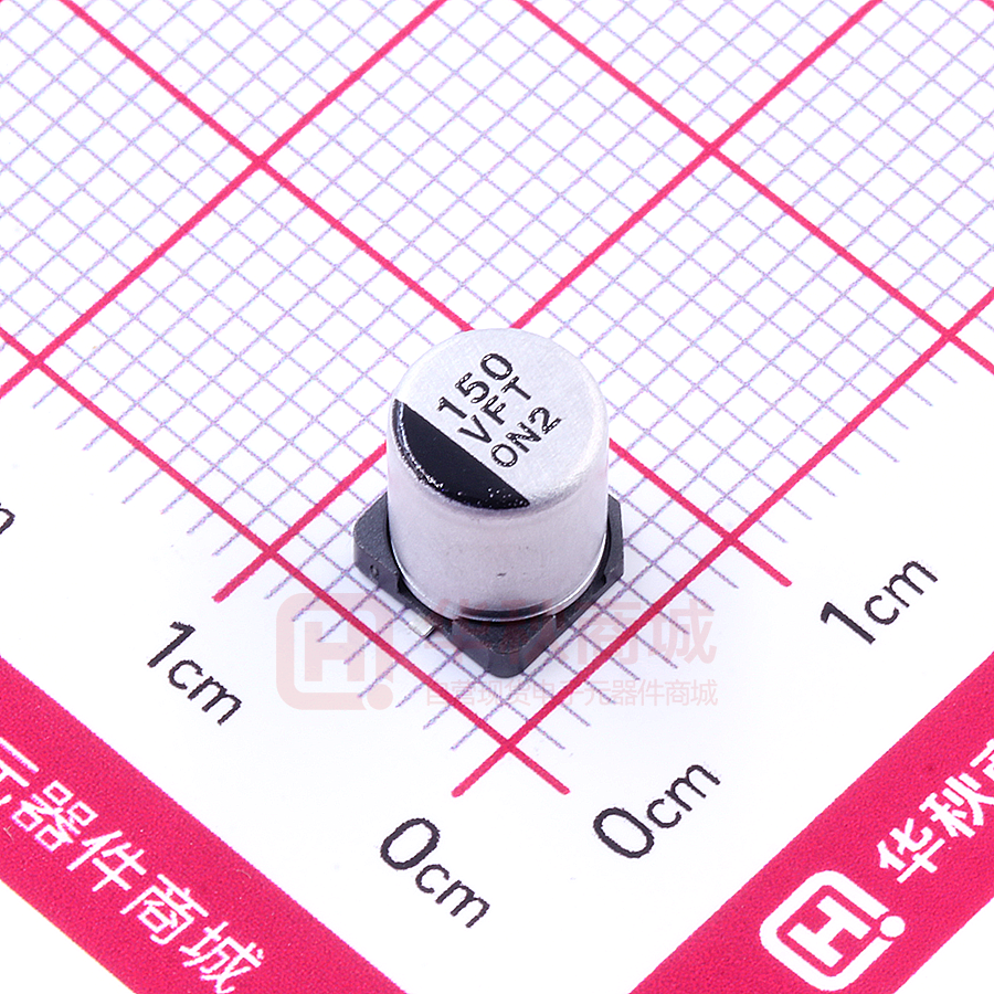

    SMD,D6.3xL7.7mm
    贴片铝电解电容 SMD,D6.3xL7.7mm 150µF ±20% 35V 2000Hrs@105℃
EEEFTV151XAP 数据手册
Aluminum Electrolytic Capacitors Surface Mount Type FT series V type High temperature Lead-Free reflow Features ● ● ● ● Endurance:105 ℃ 2000 h to 5000 h Miniaturized, Low ESR (1 size smaller than series FK) AEC-Q200 compliant RoHS compliant Specifications Category temp. range Rated voltage range Capacitance range Capacitance tolerance Leakage current Dissipation factor (tan δ) Endurance Shelf life Resistance to soldering heat –55 ℃ to +105 ℃ 6.3 V to 50 V 10 μF to 2200 μF ±20 % (120 Hz / +20 ℃) I ≦ 0.01 CV(μA)After 2 minutes Please see the attached characteristics list After applying rated working voltage for 2000 hours at +105 ℃ ± 2 ℃ and then being stabilized at +20 ℃, capacitors shall meet the following limits.  (Suffix “G” in 6.3 V : 3000 hours, 10 V to 50 V : 5000 hours) Capacitance change Within ±30 % of the initial value (Suffix “G” is ±35 %) Dissipation factor(tan δ) ≦ 200 % of the initial limit (Suffix “G” is ≦ 300 %) Leakage current Within the initial limit After storage for 1000 hours at +105 ℃ ± 2 ℃ with no voltage applied and then being stabilized at +20 ℃, capacitors shall meet the limits specified in endurance. (With voltage treatment) After reflow soldering and then being stabilized at +20 ℃, capacitors shall meet the following limits. Capacitance change Within ±10 % of the initial value Dissipation factor(tan δ) Within the initial limit Leakage current Within the initial limit Frequency correction factor for ripple current Freq.(Hz) Cap.(μF) 10 to 470 560 to 2200 120 1k 10 k 100 k to 0.65 0.70 0.85 0.90 0.95 0.95 1.00 1.00 Dimensions K R.voltage code Unit:V E V H 25 35 50 (P) (I) L Lot number 6.3 10 16 B±0.2 Series identification W Pressure Relief (φ10 and larger) Rated voltage code j A C H Capacitance (μF) φD±0.5 Negative polarity marking (–) 22 E FT A±0.2 0.3 max. Example:25 V 22 μF Marking color : BLACK (I) Marking ()Reference size Unit:mm Size code φD L A、B H I W P B 4.0 5.8±0.3 4.3 5.5 max. 1.8 0.65±0.1 1.0 0.35 K C 5.0 5.8±0.3 5.3 6.5 max. 2.2 0.65±0.1 1.5 0.35 D 6.3 5.8±0.3 6.6 7.8 max. 2.6 0.65±0.1 1.8 0.35 D8 6.3 7.7±0.3 6.6 7.8 max. 2.6 0.65±0.1 1.8 0.35 +0.15 ー0.20 +0.15 ー0.20 +0.15 ー0.20 +0.15 ー0.20 F 8.0 10.2±0.3 8.3 10.0 max. 3.4 0.90±0.2 3.1 0.70±0.2 G 10.0 10.2±0.3 10.3 12.0 max. 3.5 0.90±0.2 4.6 0.70±0.2 ・The dimensions of the vibration-proof products, please refer to the page of the mounting specification. Design and specifications are each subject to change without notice. Ask factory for the current technical specifications before purchase and/or use. Should a safety concern arise regarding this product, please be sure to contact us immediately. 06-Dec-19 Aluminum Electrolytic Capacitors (SMD Type) Dimensions (Vibration-proof products) ✽ The size and shape are different from standard products. Please inquire details of our company. φD H A, B max. L D 6.3 6.1 D8 E F G H13 J16 K16 K21 6.3 8.0 8.0 10.0 12.5 16.0 18.0 18.0 8.0 6.5 10.5 10.5 13.8 16.8 16.8 21.8 R (P) B±0.2 (S) H D±0.5 F W *1:E to G : L±0.3 W P ( ) Reference size Supportive Terminals H13 to K21 : L±0.5 I (I) (I) T L*1 ( ) Reference size Supportive Terminals A±0.2 (I) R (P) (S) B±0.2 D±0.5 H T W L±0.3 Size code F K A±0.2 F (I) < Size code:E, F, G, H13, J16, K16, K21 > K < Size code:D, D8 > Unit:mm K +0.15 -0.20 +0.15 -0.20 +0.15 -0.20 6.6 7.8 0 to +0.15 2.4 0.65±0.1 2.2 0.35 6.6 8.3 8.3 10.3 13.5 17.0 19.0 19.0 7.8 9.5 10.0 12.0 15.0 19.0 21.0 21.0 0 to +0.15 0 to +0.15 0 to +0.15 0 to +0.15 –0.1 to +0.15 –0.1 to +0.15 –0.1 to +0.15 –0.1 to +0.15 2.4 3.4 3.4 3.5 4.7 5.5 6.7 6.7 0.65±0.1 0.7±0.1 1.2±0.2 1.2±0.2 1.2±0.2 1.4±0.2 1.4±0.2 1.4±0.2 2.2 2.2 3.1 4.6 4.4 6.7 6.7 6.7 0.35 0.35 0.70±0.2 0.70±0.2 0.70±0.3 0.70±0.3 0.70±0.3 0.70±0.3 R S T 1.1±0.2 3.3 1.05±0.2 1.1±0.2 0.70±0.2 0.70±0.2 0.70±0.2 2.2±0.2 3.0±0.2 3.0±0.2 3.0±0.2 3.3 5.3 5.3 6.9 7.1 9.0 11.0 11.0 1.05±0.2 1.7±0.2 1.3±0.2 1.3±0.2 2.4±0.2 1.9±0.2 1.9±0.2 1.9±0.2 Land / Pad pattern The circuit board land/pad pattern size for chip capacitors is specified in the following table. The land pitch influences installation strength and consider it. (Table of board land size vs. capacitor size) ● Standard products Size code c b B (φ4) C (φ5) D (φ6.3) D8 (φ6.3x7.7L) E (φ8x6.2L) F (φ8x10.2L) G (φ10x10.2L) H (φ12.5) J (φ16) K (φ18) b a Land space ● Vibration-proof products 1.0 1.5 1.8 1.8 2.2 3.1 4.6 4.0 6.0 6.0 c 2.5 2.8 3.2 3.2 4.0 4.0 4.1 5.7 6.5 7.5 1.6 1.6 1.6 1.6 1.6 2.0 2.0 2.0 2.5 2.5 (Table of board land size vs. capacitor size) C B A A B Size code B G F H E D G G H D (φ6.3xL6.1) D8 (φ6.3xL8.0) E (φ8x6.5L) F (φ8x10.5L) G (φ10) H (φ12.5) J (φ16) K (φ18) A 1.2 1.2 1.8 2.7 3.9 3.9 5.8 5.8 B 3.6 3.6 4.2 4.0 4.4 6.0 6.8 7.3 C 3.2 3.2 5.0 4.7 4.7 6.9 6.2 6.2 D 2.0 2.0 1.3 1.3 1.3 2.8 3.6 3.6 Unit:mm E F G H 1.5 1.0 1.2 1.3 1.3 1.8 1.4 1.7 1.9 1.9 1.9 1.9 1.5 1.1 1.1 2.2 1.7 1.7 2.0 2.5 2.5 2.5 2.8 2.8 0.95 0.65 1.0 1.2 0.95 0.65 1.0 1.2 When size “A” is wide, back fi llet can be made, decreasing fi tting strength. C G F < Size code:E, F, G, H, J, K > C Unit:mm b When size “a” is wide, back fi llet can be made, decreasing fi tting strength. < Size code:D, D8 > C a *Take mounting conditions, solderability and fi tting strength into consideration B D B when selecting parts for your company’s design. * The vibration-proof capacitors of size Φ6.3 has support terminals extending A E A from the bottom side to the lead edge. Then, make sure to find appropriate soldering conditions to form fillet on the support terminals if required for B appearance inspection. Design and specifications are each subject to change without notice. Ask factory for the current technical specifications before purchase and/or use. Should a safety concern arise regarding this product, please be sure to contact us immediately. 26-Apr-19 Aluminum Electrolytic Capacitors (SMD Type) FT series Characteristics list Endurance : 105 ℃ 2000 h 6.3 10 16 25 35 Capacitance (±20 %) (μF) 100 220 330 470 680 1500 2200 68 150 220 330 470 1000 1500 47 68 100 150 220 330 680 820 1000 1200 22 33 47 68 100 150 220 470 560 820 1000 22 33 47 68 100 150 330 390 560 680 10 50 22 47 100 220 330 L φD 4.0 5.0 6.3 6.3 6.3 8.0 10.0 4.0 5.0 6.3 6.3 6.3 8.0 10.0 4.0 5.0 5.0 6.3 6.3 6.3 8.0 8.0 10.0 10.0 4.0 4.0 5.0 5.0 6.3 6.3 6.3 8.0 8.0 10.0 10.0 4.0 5.0 5.0 6.3 6.3 6.3 8.0 8.0 10.0 10.0 4.0 5.0 5.0 6.3 6.3 8.0 10.0 Vibration Standard -proof 5.8 5.8 5.8 7.7 7.7 10.2 10.2 5.8 5.8 5.8 7.7 7.7 10.2 10.2 5.8 5.8 5.8 5.8 5.8 7.7 10.2 10.2 10.2 10.2 5.8 5.8 5.8 5.8 5.8 7.7 7.7 10.2 10.2 10.2 10.2 5.8 5.8 5.8 5.8 5.8 7.7 10.2 10.2 10.2 10.2 5.8 5.8 5.8 5.8 7.7 10.2 10.2 ー ー 6.1 8.0 8.0 10.5 10.5 ー ー 6.1 8.0 8.0 10.5 10.5 ー ー ー 6.1 6.1 8.0 10.5 10.5 10.5 10.5 ー ー ー ー 6.1 8.0 8.0 10.5 10.5 10.5 10.5 ー ー ー 6.1 6.1 8.0 10.5 10.5 10.5 10.5 ー ー ー 6.1 8.0 10.5 10.5 Ripple current *2 ESR*3 (Ω) Min. Part No. Packaging tan δ*4 Standard Product Vibration-proof product 0.26 0.26 0.26 0.26 0.26 0.26 0.28 0.19 0.19 0.19 0.19 0.19 0.19 0.19 0.16 0.16 0.16 0.16 0.16 0.16 0.16 0.16 0.16 0.16 0.14 0.14 0.14 0.14 0.14 0.14 0.14 0.14 0.14 0.14 0.14 0.12 0.12 0.12 0.12 0.12 0.12 0.12 0.12 0.12 0.12 0.10 0.10 0.10 0.10 0.10 0.10 0.10 EEEFT0J101AR EEEFT0J221AR EEEFT0J331AP EEEFTJ471XAP EEEFTJ681XAP EEEFT0J152AP EEEFT0J222AP EEEFT1A680AR EEEFT1A151AR EEEFT1A221AP EEEFTA331XAP EEEFTA471XAP EEEFT1A102AP EEEFT1A152AP EEEFT1C470AR EEEFT1C680AR EEEFT1C101AR EEEFT1C151AP EEEFT1C221AP EEEFTC331XAP EEEFT1C681AP EEEFT1C821UP EEEFT1C102AP EEEFT1C122UP EEEFT1E220AR EEEFT1E330AR EEEFT1E470AR EEEFT1E680AR EEEFT1E101AP EEEFTE151XAP EEEFTE221XAP EEEFT1E471AP EEEFT1E561UP EEEFT1E821AP EEEFT1E102UP EEEFT1V220AR EEEFT1V330AR EEEFT1V470AR EEEFT1V680AP EEEFT1V101AP EEEFTV151XAP EEEFT1V331AP EEEFT1V391UP EEEFT1V561AP EEEFT1V681UP EEEFTH100UAR EEEFT1H100AR EEEFT1H220AR EEEFT1H470AP EEEFTH101XAP EEEFT1H221AP EEEFT1H331AP ー ー EEEFT0J331AV EEEFTJ471XAV EEEFTJ681XAV EEEFT0J152AV EEEFT0J222AV ー ー EEEFT1A221AV EEEFTA331XAV EEEFTA471XAV EEEFT1A102AV EEEFT1A152AV ー ー ー EEEFT1C151AV EEEFT1C221AV EEEFTC331XAV EEEFT1C681AV EEEFT1C821UV EEEFT1C102AV EEEFT1C122UV ー ー ー ー EEEFT1E101AV EEEFTE151XAV EEEFTE221XAV EEEFT1E471AV EEEFT1E561UV EEEFT1E821AV EEEFT1E102UV ー ー ー EEEFT1V680AV EEEFT1V101AV EEEFTV151XAV EEEFT1V331AV EEEFT1V391UV EEEFT1V561AV EEEFT1V681UV ー ー ー EEEFT1H470AV EEEFTH101XAV EEEFT1H221AV EEEFT1H331AV Reflow (V) (mm) Size code Rated voltage Specification *1 Case size (mA rms) B C D D8 D8 F G B C D D8 D8 F G B C C D D D8 F F G G B B C C D D8 D8 F F G G B C C D D D8 F F G G (B) C C D D8 F G 160 240 300 600 600 850 1190 160 240 300 600 600 850 1190 160 240 240 300 300 600 850 850 1190 1190 160 160 240 240 300 600 600 850 850 1190 1190 160 240 240 300 300 600 850 850 1190 1190 85 165 165 195 350 670 900 0.85 0.36 0.26 0.16 0.16 0.08 0.06 0.85 0.36 0.26 0.16 0.16 0.08 0.06 0.85 0.36 0.36 0.26 0.26 0.16 0.08 0.08 0.06 0.06 0.85 0.85 0.36 0.36 0.26 0.16 0.16 0.08 0.08 0.06 0.06 0.85 0.36 0.36 0.26 0.26 0.16 0.08 0.08 0.06 0.06 2.30 0.88 0.88 0.68 0.34 0.18 0.12 (5) (5) (5) (5) (5) (6) (6) (5) (5) (5) (5) (5) (6) (6) (5) (5) (5) (5) (5) (5) (6) (6) (6) (6) (5) (5) (5) (5) (5) (5) (5) (6) (6) (6) (6) (5) (5) (5) (5) (5) (5) (6) (6) (6) (6) (5) (5) (5) (5) (5) (6) (6) Q'ty Taping (pcs) 2000 1000 1000 900 900 500 500 2000 1000 1000 900 900 500 500 2000 1000 1000 1000 1000 900 500 500 500 500 2000 2000 1000 1000 1000 900 900 500 500 500 500 2000 1000 1000 1000 1000 900 500 500 500 500 2000 1000 1000 1000 900 500 500 *1: Size code( ): Miniaturization product *2: Ripple current (100 kHz / +105 ℃) *3: ESR (100 kHz / +20 ℃) *4: tan δ (120 Hz / +20 ℃) ・ If Part number exceeds 12 digits, voltage code is abbreviated as follows; 0J → J, 1A → A, 1C → C, 1E → E, 1V → V, 1H → H ・ Please refer to the page of "Reflow Profile" and "The Taping Dimensions". Design and specifications are each subject to change without notice. Ask factory for the current technical specifications before purchase and/or use. Should a safety concern arise regarding this product, please be sure to contact us immediately. 06-Dec-19 Aluminum Electrolytic Capacitors (SMD Type) FT series Characteristics list (Endurance 5000 h) Endurance : 105 ℃ 5000 h (6.3 V.DC : 105 ℃ 3000 h) (V) 6.3 10 16 25 35 50 Capacitance (±20 %) (μF) L φD Vibration Standard -proof Specification Ripple current *1 ESR*2 (Ω) Min. Part No. Standard Product tan δ*3 Packaging Vibration-proof product Reflow Rated voltage (mm) Size code Case size (mA rms) Q'ty Taping (pcs) 1500 8.0 10.2 10.5 F 850 0.08 0.26 EEEFT0J152GP EEEFT0J152GV (6) 500 2200 10.0 10.2 10.5 G 1190 0.06 0.28 EEEFT0J222GP EEEFT0J222GV (6) 500 1000 8.0 10.2 10.5 F 850 0.08 0.19 EEEFT1A102GP EEEFT1A102GV (6) 500 1500 10.0 10.2 10.5 G 1190 0.06 0.19 EEEFT1A152GP EEEFT1A152GV (6) 500 680 8.0 10.2 10.5 F 850 0.08 0.16 EEEFT1C681GP EEEFT1C681GV (6) 500 10.0 10.2 10.5 G 1190 0.06 0.16 EEEFT1C102GP EEEFT1C102GV (6) 500 470 8.0 10.2 10.5 F 850 0.08 0.14 EEEFT1E471GP EEEFT1E471GV (6) 500 820 10.0 10.2 10.5 G 1190 0.06 0.14 EEEFT1E821GP EEEFT1E821GV (6) 500 330 8.0 10.2 10.5 F 850 0.08 0.12 EEEFT1V331GP EEEFT1V331GV (6) 500 560 10.0 10.2 10.5 G 1190 0.06 0.12 EEEFT1V561GP EEEFT1V561GV (6) 500 220 8.0 10.2 10.5 F 670 0.18 0.10 EEEFT1H221GP EEEFT1H221GV (6) 500 330 10.0 10.2 10.5 G 900 0.12 0.10 EEEFT1H331GP EEEFT1H331GV (6) 500 1000 *1: Ripple current (100 kHz / +105 ℃) *2: ESR (100 kHz / +20 ℃) *3: tan δ (120 Hz / +20 ℃) ・ Please refer to the page of "Reflow Profile" and "The Taping Dimensions". Design and specifications are each subject to change without notice. Ask factory for the current technical specifications before purchase and/or use. Should a safety concern arise regarding this product, please be sure to contact us immediately. 06-Dec-19 *XLGHOLQHVDQGSUHFDXWLRQVUHJDUGLQJWKH WHFKQLFDOLQIRUPDWLRQDQGXVHRIRXUSURGXFWV GHVFULEHGLQWKLVRQOLQHFDWDORJ ‫ٹ‬,I\RXZDQWWRXVHRXUSURGXFWVGHVFULEHGLQWKLVRQOLQHFDWDORJIRUDSSOLFDWLRQVUHTXLULQJ VSHFLDOTXDOLWLHVRUUHOLDELOLW\RUIRUDSSOLFDWLRQVZKHUHWKHIDLOXUHRUPDOIXQFWLRQRIWKH SURGXFWVPD\GLUHFWO\MHRSDUGL]HKXPDQOLIHRUSRWHQWLDOO\FDXVHSHUVRQDOLQMXU\  HJDLUFUDIWDQGDHURVSDFHHTXLSPHQWWUDIILFDQGWUDQVSRUWDWLRQHTXLSPHQWFRPEXVWLRQ HTXLSPHQWPHGLFDOHTXLSPHQWDFFLGHQWSUHYHQWLRQDQWLFULPHHTXLSPHQWDQGRUVDIHW\ HTXLSPHQW LWLVQHFHVVDU\WRYHULI\ZKHWKHUWKHVSHFLILFDWLRQVRIRXUSURGXFWVILWWRVXFK DSSOLFDWLRQV3OHDVHHQVXUHWKDW\RXZLOODVNDQGFKHFNZLWKRXULQTXLU\GHVNDVWRZKHWKHU WKHVSHFLILFDWLRQVRIRXUSURGXFWVILWWRVXFKDSSOLFDWLRQVXVHEHIRUH\RXXVHRXUSURGXFWV ‫ٹ‬7KHTXDOLW\DQGSHUIRUPDQFHRIRXUSURGXFWVDVGHVFULEHGLQWKLVRQOLQHFDWDORJRQO\DSSO\ WRRXUSURGXFWVZKHQXVHGLQLVRODWLRQ7KHUHIRUHSOHDVHHQVXUH\RXHYDOXDWHDQGYHULI\ RXUSURGXFWVXQGHUWKHVSHFLILFFLUFXPVWDQFHVLQZKLFKRXUSURGXFWVDUHDVVHPEOHGLQ\RXU RZQSURGXFWVDQGLQZKLFKRXUSURGXFWVZLOODFWXDOO\EHXVHG ‫ٹ‬,I\RXXVHRXUSURGXFWVLQHTXLSPHQWWKDWUHTXLUHVDKLJKGHJUHHRIUHOLDELOLW\UHJDUGOHVV RIWKHDSSOLFDWLRQLWLVUHFRPPHQGHGWKDW\RXVHWXSSURWHFWLRQFLUFXLWVDQGUHGXQGDQF\ FLUFXLWVLQRUGHUWRHQVXUHVDIHW\RI\RXUHTXLSPHQW ‫ٹ‬7KHSURGXFWVDQGSURGXFWVSHFLILFDWLRQVGHVFULEHGLQWKLVRQOLQHFDWDORJDUHVXEMHFWWR FKDQJHIRULPSURYHPHQWZLWKRXWSULRUQRWLFH7KHUHIRUHSOHDVHEHVXUHWRUHTXHVWDQG FRQILUPWKHODWHVWSURGXFWVSHFLILFDWLRQVZKLFKH[SODLQWKHVSHFLILFDWLRQVRIRXUSURGXFWVLQ GHWDLOEHIRUH\RXILQDOL]HWKHGHVLJQRI\RXUDSSOLFDWLRQVSXUFKDVHRUXVHRXUSURGXFWV ‫ٹ‬7KHWHFKQLFDOLQIRUPDWLRQLQWKLVRQOLQHFDWDORJSURYLGHVH[DPSOHVRIRXUSURGXFWV  W\SLFDORSHUDWLRQVDQGDSSOLFDWLRQFLUFXLWV:HGRQRWJXDUDQWHHWKHQRQLQIULQJHPHQWRI WKLUGSDUW\ VLQWHOOHFWXDOSURSHUW\ULJKWVDQGZHGRQRWJUDQWDQ\OLFHQVHULJKWRULQWHUHVW LQRXULQWHOOHFWXDOSURSHUW\ ‫ٹ‬,IDQ\RIRXUSURGXFWVSURGXFWVSHFLILFDWLRQVDQGRUWHFKQLFDOLQIRUPDWLRQLQWKLVRQOLQH FDWDORJLVWREHH[SRUWHGRUSURYLGHGWRQRQUHVLGHQWVWKHODZVDQGUHJXODWLRQVRIWKH H[SRUWLQJFRXQWU\HVSHFLDOO\ZLWKUHJDUGWRVHFXULW\DQGH[SRUWFRQWUROVKDOOEHREVHUYHG 5HJDUGLQJWKH&HUWLILFDWHRI&RPSOLDQFHZLWK WKH(85R+6'LUHFWLYH5($&+5HJXODWLRQV! ‫ٹ‬7KHVZLWFKRYHUGDWHIRUFRPSOLDQFHZLWKWKH5R+6'LUHFWLYH5($&+5HJXODWLRQVYDULHV GHSHQGLQJRQWKHSDUWQXPEHURUVHULHVRIRXUSURGXFWV ‫ٹ‬:KHQ\RXXVHWKHLQYHQWRU\RIRXUSURGXFWVIRUZKLFKLWLVXQFOHDUZKHWKHUWKRVHSURGXFWV DUHFRPSOLDQWZLWKWKH5R+6'LUHFWLYH5($&+5HJXODWLRQSOHDVHVHOHFW6DOHV,QTXLU\LQWKH ZHEVLWHLQTXLU\IRUPDQGFRQWDFWXV :HGRQRWWDNHDQ\UHVSRQVLELOLW\IRUWKHXVHRIRXUSURGXFWVRXWVLGHWKHVFRSHRIWKH VSHFLILFDWLRQVGHVFULSWLRQVJXLGHOLQHVDQGSUHFDXWLRQVGHVFULEHGLQWKLVRQOLQHFDWDORJ 'HF 1RWLFHV,WHPVWREHREVHUYHG 1RWLFHV ‫ٹ‬$SSOLFDEOHODZVDQGUHJXODWLRQV 嵣7KLVSURGXFWFRPSOLHVZLWKWKH5R+6'LUHFWLYH 5HVWULFWLRQRIWKHXVHRIFHUWDLQKD]DUGRXVVXEVWDQFHVLQ HOHFWULFDODQGHOHFWURQLFHTXLSPHQW ',5(&7,9((8DQG‫(ق‬8   嵣1R2]RQH'HSOHWLQJ&KHPLFDOV 2'& V FRQWUROOHGXQGHUWKH0RQWUHDO3URWRFRO$JUHHPHQWDUHXVHGLQ SURGXFLQJWKLVSURGXFW 岜:HGRQRWXVH3%%VRU3%'(VDVEURPLQDWHGIODPHUHWDUGDQWV 嵣([SRUWSURFHGXUHZKLFKIROORZHGH[SRUWUHODWHGUHJXODWLRQVVXFKDVIRUHLJQH[FKDQJHDQGDIRUHLJQWUDGH PHWKRGRQWKHRFFDVLRQRIH[SRUWRIWKLVSURGXFW 嵣7KHVHSURGXFWVDUHQRWGDQJHURXVJRRGVRQWKHWUDQVSRUWDWLRQDVLGHQWLILHGE\81 8QLWHG1DWLRQV QXPEHUV RU81FODVVLILFDWLRQ ‫ٹ‬/LPLWHGDSSOLFDWLRQV 嵣7KLVFDSDFLWRULVGHVLJQHGWREHXVHGIRUHOHFWURQLFVFLUFXLWVVXFKDVDXGLRYLVXDOHTXLSPHQWKRPH DSSOLDQFHVFRPSXWHUVDQGRWKHURIILFHHTXLSPHQWRSWLFDOHTXLSPHQWPHDVXULQJHTXLSPHQW 嵣+LJKUHOLDELOLW\DQGVDIHW\DUHUHTXLUHG>EHDSRVVLELOLW\WKDWLQFRUUHFWRSHUDWLRQRIWKLVSURGXFWPD\GRKDUP 岜WRDKXPDQOLIHRUSURSHUW\@PRUH:KHQXVHLVFRQVLGHUHGE\WKHXVHWKHGHOLYHU\VSHFLILFDWLRQVZKLFKVXLWHG WKHXVHVHSDUDWHO\QHHGWREHH[FKDQJHG ‫ٹ‬,QWHOOHFWXDOSURSHUW\ULJKWVDQGOLFHQVHV 嵣7KHWHFKQLFDOLQIRUPDWLRQLQWKLVVSHFLILFDWLRQSURYLGHVH[DPSOHVRIRXUSURGXFWV W\SLFDORSHUDWLRQVDQGDSSOLFDWLRQ FLUFXLWV:HGRQRWJXDUDQWHHWKHQRQLQIULQJHPHQWRIWKLUGSDUW\ VLQWHOOHFWXDOSURSHUW\ULJKWVDQGZHGRQRWJUDQW DQ\OLFHQVHULJKWRULQWHUHVWLQRXULQWHOOHFWXDOSURSHUW\ ,WHPVWREHREVHUYHG ‫)ٹ‬RUVSHFLILFDWLRQ 嵣7KLVVSHFLILFDWLRQJXDUDQWHHVWKHTXDOLW\DQGSHUIRUPDQFHRIWKHSURGXFWDVLQGLYLGXDOFRPSRQHQWV 7KHGXUDELOLW\GLIIHUVGHSHQGLQJRQWKHHQYLURQPHQWDQGWKHFRQGLWLRQVRIXVDJH %HIRUHXVHFKHFNDQGHYDOXDWHWKHLUFRPSDWLELOLW\ZLWKDFWXDOFRQGLWLRQVZKHQLQVWDOOHGLQWKHSURGXFWV :KHQVDIHW\UHTXLUHPHQWVFDQQRWEHVDWLVILHGLQ\RXUWHFKQLFDOH[DPLQDWLRQLQIRUPXVLPPHGLDWHO\ 嵣'RQRWXVHWKHSURGXFWVEH\RQGWKHVSHFLILFDWLRQVGHVFULEHGLQWKLVGRFXPHQW ‫ٹ‬8SRQDSSOLFDWLRQWRSURGXFWVZKHUHVDIHW\LVUHJDUGHGDVLPSRUWDQW ,QVWDOOWKHIROORZLQJV\VWHPVIRUDIDLOVDIHGHVLJQWRHQVXUHVDIHW\LIWKHVHSURGXFWVDUHWREHXVHGLQ HTXLSPHQWZKHUHDGHIHFWLQWKHVHSURGXFWVPD\FDXVHWKHORVVRIKXPDQOLIHRURWKHUVLJQLILFDWLRQGDPDJH VXFKDVGDPDJHWRYHKLFOHV DXWRPRELOHWUDLQYHVVHO WUDIILFOLJKWVPHGLFDOHTXLSPHQWDHURVSDFHHTXLSPHQW HOHFWULFKHDWLQJDSSOLDQFHVFRPEXVWLRQJDVHTXLSPHQWURWDWLQJURWDWLQJHTXLSPHQWDQGGLVDVWHUFULPH SUHYHQWLRQHTXLSPHQW  7KHV\VWHPLVHTXLSSHGZLWKDSURWHFWLRQFLUFXLWDQGSURWHFWLRQGHYLFH  7KHV\VWHPLVHTXLSSHGZLWKDUHGXQGDQWFLUFXLWRURWKHUV\VWHPWRSUHYHQWDQXQVDIHVWDWXVLQWKHHYHQW RIDVLQJOHIDXOW ‫&ٹ‬RQGLWLRQVRIXVH 嵣%HIRUHXVLQJWKHSURGXFWVFDUHIXOO\FKHFNWKHHIIHFWVRQWKHLUTXDOLW\DQGSHUIRUPDQFHDQGGHWHUPLQHG 岜ZKHWKHURUQRWWKH\FDQEHXVHG7KHVHSURGXFWVDUHGHVLJQHGDQGPDQXIDFWXUHGIRUJHQHUDOSXUSRVHDQG 岜VWDQGDUGXVHLQJHQHUDOHOHFWURQLFHTXLSPHQW7KHVHSURGXFWVDUHQRWLQWHQGHGIRUXVHLQWKHIROORZLQJVSHFLDO 岜FRQGLWLRQV  ,QOLTXLGVXFKDV:DWHU2LO&KHPLFDOVRU2UJDQLFVROYHQW  ,QGLUHFWVXQOLJKWRXWGRRUVRULQGXVW  ,QYDSRUVXFKDVGHZFRQGHQVDWLRQZDWHURIUHVLVWLYHHOHPHQWRUZDWHUOHDNDJHVDOW\DLURUDLUZLWKD KLJKFRQFHQWUDWLRQFRUURVLYHJDVVXFKDV&O+61+62RU12[  ,QDQHQYLURQPHQWZKHUHVWURQJVWDWLFHOHFWULFLW\RUHOHFWURPDJQHWLFZDYHVH[LVW  0RXQWLQJRUSODFLQJKHDWJHQHUDWLQJFRPSRQHQWVRULQIODPPDEOHVVXFKDVYLQ\OFRDWHGZLUHVQHDU WKHVHSURGXFWV  6HDOLQJRUFRDWLQJRIWKHVHSURGXFWVRUDSULQWHGFLUFXLWERDUGRQZKLFKWKHVHSURGXFWVDUHPRXQWHG ZLWKUHVLQDQGRWKHUPDWHULDO  8VLQJUHVROYHQWZDWHURUZDWHUVROXEOHFOHDQHUIRUIOX[FOHDQLQJDJHQWDIWHUVROGHULQJ ,QSDUWLFXODU ZKHQXVLQJZDWHURUDZDWHUVROXEOHFOHDQLQJDJHQWEHFDUHIXOQRWWROHDYHZDWHUUHVLGXHV  8VLQJLQWKHDWPRVSKHUHZKHUHVWUD\VDFLGRUDONDOLQH  8VLQJLQWKHDWPRVSKHUHZKHUHWKHUHDUHH[FHVVLYHYLEUDWLRQDQGVKRFN 嵣3OHDVHDUUDQJHFLUFXLWGHVLJQIRUSUHYHQWLQJLPSXOVHRUWUDQVLWLRQDOYROWDJH 岜'RQRWDSSO\YROWDJHZKLFKH[FHHGVWKHIXOOUDWHGYROWDJHZKHQWKHFDSDFLWRUVUHFHLYHLPSXOVHYROWDJH 岜LQVWDQWDQHRXVKLJKYROWDJHKLJKSXOVHYROWDJHHWF 嵣2XUSURGXFWVWKHUHLVDSURGXFWDUHXVLQJDQHOHFWURO\WHVROXWLRQ7KHUHIRUHPLVXVHFDQUHVXOWLQUDSLG 岜GHWHULRUDWLRQRIFKDUDFWHULVWLFVDQGIXQFWLRQVRIHDFKSURGXFW(OHFWURO\WHOHDNDJHGDPDJHVSULQWHGFLUFXLWDQG DIIHFWVSHUIRUPDQFHFKDUDFWHULVWLFVDQGIXQFWLRQVRIFXVWRPHUV\VWHP 'HF $OXPLQXP(OHFWURO\WLF&DSDFLWRUV 60'7\SH 岜岜$SSOLFDWLRQJXLGHOLQHV‫ق‬60'7\SH‫ك‬ 岜 &LUFXLWGHVLJQ 2SHUDWLQJWHPSHUDWXUHDQGIUHTXHQF\ (OHFWULFDOFKDUDFWHULVWLFVRIWKHFDSDFLWRUDUHOLNHO\WRFKDQJHGXHWRYDULDWLRQLQWHPSHUDWXUHDQGRUIUHTXHQF\ &LUFXLWGHVLJQHUVVKRXOGWDNHWKHVHFKDQJHVLQWRFRQVLGHUDWLRQ  (IIHFWVRIRSHUDWLQJWHPSHUDWXUHRQHOHFWULFDOSDUDPHWHUV $WKLJKHUWHPSHUDWXUHV OHDNDJHFXUUHQWDQGFDSDFLWDQFHLQFUHDVHZKLOHHTXLYDOHQWVHULHVUHVLVWDQFH (65 GHFUHDVHV $WORZHUWHPSHUDWXUHV OHDNDJHFXUUHQWDQGFDSDFLWDQFHGHFUHDVHZKLOHHTXLYDOHQWVHULHVUHVLVWDQFH (65 LQFUHDVHV  (IIHFWVRIIUHTXHQF\RQHOHFWULFDOSDUDPHWHUV $WKLJKHUIUHTXHQFLHV FDSDFLWDQFHDQGLPSHGDQFHGHFUHDVHZKLOHWDQGLQFUHDVHV $WORZHUIUHTXHQFLHV KHDWJHQHUDWHGE\ULSSOHFXUUHQWZLOOULVHGXHWRDQLQFUHDVHLQHTXLYDOHQW VHULHVUHVLVWDQFH (65  2SHUDWLQJWHPSHUDWXUHDQGOLIHH[SHFWDQF\  ([SHFWHGOLIHLVDIIHFWHGE\RSHUDWLQJWHPSHUDWXUH*HQHUDOO\HDFK&UHGXFWLRQLQWHPSHUDWXUHZLOO GRXEOHWKHH[SHFWHGOLIH8VHFDSDFLWRUVDWWKHORZHVWSRVVLEOHWHPSHUDWXUHEHORZWKHXSSHUFDWHJRU\ WHPSHUDWXUH  ,IRSHUDWLQJWHPSHUDWXUHVH[FHHGWKHXSSHUFDWHJRU\OLPLWUDSLGGHWHULRUDWLRQRIHOHFWULFDOSDUDPHWHU ZLOORFFXUDQGLUUHYHUVLEOHGDPDJHZLOOUHVXOW &KHFNIRUWKHPD[LPXPFDSDFLWRURSHUDWLQJWHPSHUDWXUHVLQFOXGLQJDPELHQWWHPSHUDWXUHLQWHUQDO FDSDFLWRUWHPSHUDWXUHULVHGXHWRULSSOHFXUUHQWDQGWKHHIIHFWVRIUDGLDWHGKHDWIURPSRZHUWUDQVLVWRUV ,& VRUUHVLVWRUV $YRLGSODFLQJFRPSRQHQWVZKLFKFRXOGFRQGXFWKHDWWRWKHFDSDFLWRUIURPWKHEDFNVLGHRIWKHFLUFXLWERDUG  7KHIRUPXODIRUFDOFXODWLQJH[SHFWHGOLIHDWORZHURSHUDWLQJWHPSHUDWXUHVLVDVIROORZV 77 / /¼  / ‫*؟‬XDUDQWHHGOLIH K DWWHPSHUDWXUH7& / ‫[(؟‬SHFWHGOLIH K DWWHPSHUDWXUH7& 7 ‫؟‬8SSHUFDWHJRU\WHPSHUDWXUH & 7 ‫؟‬$FWXDORSHUDWLQJWHPSHUDWXUHDPELHQWWHPSHUDWXUHWHPSHUDWXUHULVHGXHWRULSSOHFXUUHQW &  8VLQJWKHFDSDFLWRUEH\RQGWKHHVWLPDWHGOLIHWLPHZLOOUHVXOWLQVKRUWFLUFXLWHOHFWURO\WHOHDNYHQWRSHQ DQGODUJHGHWHULRUDWLRQRIFKDUDFWHULVWLFV7KHOLIHWLPHFDQQRWJRDERYH\HDUVGXHWRDJLQJRIVHDOLQJUXEEHU &RPPRQDSSOLFDWLRQFRQGLWLRQVWRDYRLG 7KHIROORZLQJPLVDSSOLFDWLRQORDGFRQGLWLRQVZLOOFDXVHUDSLGGHWHULRUDWLRQRIDFDSDFLWRUbVHOHFWULFDOSDUDPHWHUV ,QDGGLWLRQUDSLGKHDWLQJDQGJDVJHQHUDWLRQZLWKLQWKHFDSDFLWRUFDQRFFXUFDXVLQJWKHSUHVVXUHUHOLHIYHQW WRRSHUDWHDQGUHVXOWDQWOHDNDJHRIHOHFWURO\WH8QGHUH[WUHPHFRQGLWLRQVH[SORVLRQDQGILUHLJQLWLRQFRXOGUHVXOW 7KHOHDNHGHOHFWURO\WHLVFRPEXVWLEOHDQGHOHFWULFDOO\FRQGXFWLYH  5HYHUVHYROWDJH '&FDSDFLWRUVKDYHSRODULW\7KHUHIRUHSOHDVHGRQRWDSSO\WKHUHYHUVHYROWDJH9HULI\FRUUHFWSRODULW\ EHIRUHLQVHUWLRQ )RUFLUFXLWVZLWKFKDQJLQJRUXQFHUWDLQSRODULW\XVH'&ELSRODUFDSDFLWRUV'&ELSRODUFDSDFLWRUVDUHQRW VXLWDEOHIRUXVHLQ$&FLUFXLWV  &KDUJH'LVFKDUJHDSSOLFDWLRQV 6WDQGDUGFDSDFLWRUVDUHQRWVXLWDEOHIRUXVHLQUHSHDWLQJFKDUJHGLVFKDUJHDSSOLFDWLRQV)RUFKDUJH GLVFKDUJHDSSOLFDWLRQVFRQVXOWXVZLWK\RXUDFWXDODSSOLFDWLRQFRQGLWLRQ )RUUXVKFXUUHQWSOHDVHWRQRUH[FHHG$  212))FLUFXLW 'RQRWXVHFDSDFLWRUVLQFLUFXLWZKHUH212))VZLWFKLQJLVUHSHDWHGPRUHWKDQWLPHVSHUGD\ ,QFDVHRIDSSO\LQJWRWKHWKHVHV212))FLUFXLWFRQVXOWZLWKXVDERXWFLUFXLWFRQGLWLRQDQGVRRQ 'HF $OXPLQXP(OHFWURO\WLF&DSDFLWRUV 60'7\SH  2YHUYROWDJH 'RQRWDSSO\YROWDJHVH[FHHGLQJWKHPD[LPXPVSHFLILHGUDWHGYROWDJH9ROWDJHVXSWRWKHVXUJHYROWDJH UDWLQJDUHDFFHSWDEOHIRUVKRUWSHULRGVRIWLPH (QVXUHWKDWWKHVXPRIWKH'&YROWDJHDQGWKHVXSHULPSRVHG$&ULSSOHYROWDJHGRHVQRWH[FHHGWKH UDWHGYROWDJH  5LSSOHFXUUHQW 'RQRWDSSO\ULSSOHFXUUHQWVH[FHHGLQJWKHPD[LPXPVSHFLILHGYDOXH)RUKLJKULSSOHFXUUHQWDSSOLFDWLRQV XVHDFDSDFLWRUGHVLJQHGIRUKLJKULSSOHFXUUHQWV,QDGGLWLRQFRQVXOWXVLIWKHDSSOLHGULSSOHFXUUHQWLVWR EHKLJKHUWKDQWKHPD[LPXPVSHFLILHGYDOXH(QVXUHWKDWUDWHGULSSOHFXUUHQWVWKDWVXSHULPSRVHGRQORZ '&ELDVYROWDJHVGRQRWFDXVHUHYHUVHYROWDJHFRQGLWLRQV (YHQLILWLVZLWKLQDUDWHGULSSOHFXUUHQWLQFDVHWKHSUDFWLFDOXVHLVRYHUWKHSUHGHVFULEHGHQGXUDQFH OLIHWLPHLWFDXVHVWKHLQFUHDVHRIGHWHULRUDWLRQRI(65FKDUDFWHULVWLFDQGWKHLQWHUQDOJHQHUDWLRQKHDWE\ ULSSOHFXUUHQW'XHWRWKLVWKHUHLVVRPHSRVVLELOLW\RIYHQWRSHQEXOJLQJRIVOHHYHDQGUXEEHUHOHFWURO\WH OHDNDJHDQGVKRWFLUFXLWH[SORVLRQDQGLJQLWLRQLQWKHZRUVWFDVH 8VLQJWZRRUPRUHFDSDFLWRUVLQSDUDOOHO  &DSDFLWRUVFRQQHFWHGLQSDUDOOHO 7KHFLUFXLWUHVLVWDQFHFDQFORVHO\DSSUR[LPDWHWKHVHULHVUHVLVWDQFHRIWKHFDSDFLWRUFDXVLQJDQLPEDODQFHRI ULSSOHFXUUHQWORDGVZLWKLQWKHFDSDFLWRUV&DUHIXOZLULQJPHWKRGVFDQPLQLPL]HWKHSRVVLEOHDSSOLFDWLRQRIDQ H[FHVVLYHULSSOHFXUUHQWWRDFDSDFLWRU  &DSDFLWRUVFRQQHFWHGLQVHULHV 'LIIHUHQFHVLQQRUPDO'&OHDNDJHFXUUHQWDPRQJFDSDFLWRUVFDQFDXVHYROWDJHLPEDODQFHV 7KHXVHRIYROWDJHGLYLGHUVKXQWUHVLVWRUVZLWKFRQVLGHUDWLRQWROHDNDJHFXUUHQWVFDQSUHYHQWFDSDFLWRU YROWDJHLPEDODQFHV 127(3OHDVHGRQRWXVHLQWKHVHULHVLQWKHFDVHRIFRQGXFWLYHSRO\PHUK\EULGDOXPLQXPHOHFWURO\WLFFDSDFLWRU &DSDFLWRUPRXQWLQJFRQVLGHUDWLRQV  'RXEOHVLGHGFLUFXLWERDUGV $YRLGZLULQJSDWWHUQUXQVZKLFKSDVVEHWZHHQWKHPRXQWHGFDSDFLWRUDQGWKHFLUFXLWERDUG  &OHDUDQFHIRUFDVHPRXQWHGSUHVVXUHUHOLHI ‫̷ۺ‬PP &DSDFLWRUVZLWKFDVHPRXQWHGSUHVVXUHUHOLHIUHTXLUHVXIILFLHQWFOHDUDQFHWRDOORZIRUSURSHUSUHVVXUH UHOLHIRSHUDWLRQ 7KHPLQLPXPFOHDUDQFHDUHGHSHQGHQWRQFDSDFLWRUGLDPHWHUVDVIROORZV 'LDPPWR'LDPPPPPLQLPXP'LDPPPPPLQLPXP  :LULQJQHDUWKHSUHVVXUHUHOLHI ‫̷ۺ‬PP $YRLGORFDWLQJKLJKYROWDJHRUKLJKFXUUHQWZLULQJRUFLUFXLWERDUGSDWKVDERYHWKHSUHVVXUHUHOLHI )ODPPDEOHKLJKWHPSHUDWXUHJDVWKDWH[FHHGV&PD\EHUHOHDVHGZKLFKFRXOGGLVVROYHWKHZLUH LQVXODWLRQDQGLJQLWH  &LUFXLWERDUGSDWWHUQVXQGHUWKHFDSDFLWRU $YRLGFLUFXLWERDUGUXQVXQGHUWKHFDSDFLWRUDVDQHOHFWULFDOVKRUWFDQRFFXUGXHWRDQHOHFWURO\WHOHDNDJH (OHFWULFDOLVRODWLRQRIWKHFDSDFLWRU &RPSOHWHO\LVRODWHWKHFDSDFLWRUDVIROORZV w%HWZHHQWKHFDWKRGHDQGWKHFDVHDQGEHWZHHQWKHDQRGHWHUPLQDODQGRWKHUFLUFXLWSDWKV &DSDFLWRUFRDWLQJ 7KHODPLQDWHFRDWLQJLVLQWHQGHGIRUPDUNLQJDQGLGHQWLILFDWLRQSXUSRVHVDQGLVQRWPHDQWWRHOHFWULFDOO\ LQVXODWHWKHFDSDFLWRU &DSDFLWRUKDQGOLQJWHFKQLTXHV &RQVLGHUDWLRQVEHIRUHXVLQJ  &DSDFLWRUVKDYHDILQLWHOLIH'RQRWUHXVHRUUHF\FOHFDSDFLWRUVIURPXVHGHTXLSPHQW  7UDQVLHQWUHFRYHU\YROWDJHPD\EHJHQHUDWHGLQWKHFDSDFLWRUGXHWRGLHOHFWULFDEVRUSWLRQ ,IUHTXLUHGWKLVYROWDJHFDQEHGLVFKDUJHGZLWKDUHVLVWRUZLWKDYDOXHRIDERXWN̚  &DSDFLWRUVVWRUHGIRUDORQJSHULRGRIWLPHPD\H[KLELWDQLQFUHDVHLQOHDNDJHFXUUHQW 7KLVFDQEHFRUUHFWHGE\JUDGXDOO\DSSO\LQJUDWHGYROWDJHLQVHULHVZLWKDUHVLVWRURIDSSUR[LPDWHO\N̚  ,IFDSDFLWRUVDUHGURSSHGWKH\FDQEHGDPDJHGPHFKDQLFDOO\RUHOHFWULFDOO\$YRLGXVLQJGURSSHG FDSDFLWRUV  'HQWHGRUFUXVKHGFDSDFLWRUVVKRXOGQRWEHXVHG 7KHVHDOLQWHJULW\FDQEHGDPDJHGDQGORVVRIHOHFWURO\WHVKRUWHQHGOLIHFDQUHVXOW 'HF $OXPLQXP(OHFWURO\WLF&DSDFLWRUV 60'7\SH &DSDFLWRULQVHUWLRQ  9HULI\WKHFRUUHFWFDSDFLWDQFHDQGUDWHGYROWDJHRIWKHFDSDFLWRU  9HULI\WKHFRUUHFWSRODULW\RIWKHFDSDFLWRUEHIRUHLQVHUWLRQ  9HULI\WKHFRUUHFWWHUPLQDOGLPHQVLRQDQGODQGSDWWHUQVL]HEHIRUHPRXQWWRDYRLGVWUHVVRQWKHWHUPLQDOV  ([FHVVLYHPRXQWLQJSUHVVXUHFDQFDXVHKLJKOHDNDJHFXUUHQWVKRUWFLUFXLWRUGLVFRQQHFWLRQ 5HIORZVROGHULQJ  6XUIDFHPRXQWW\SHFDSDFLWRUDUHH[FOXVLYHO\IRUUHIORZVROGHULQJ 岜:KHQUHIORZVROGHULVXVHGDQDPELHQWKHDWFRQGLWLRQV\VWHPVXFKDVWKHVLPXOWDQHRXVXVHRILQIUDUHG 岜DQGKRWDLULVUHFRPPHQGHG  2EVHUYHSURSHUVROGHULQJFRQGLWLRQV WHPSHUDWXUHWLPHHWF 'RQRWH[FHHGWKHVSHFLILHGOLPLWV ,IWKHSHDNWHPSHUDWXUHLVKLJKRULIWKHKHDWLQJWLPHLVORQJLWPD\FDXVHGHWHULRUDWLRQRIWKHHOHFWULFDO FKDUDFWHULVWLFVDQGOLIHFKDUDFWHULVWLFV 5HFRPPHQGHGVROGHULQJFRQGLWLRQLVDJXLGHOLQHIRUHQVXULQJWKHEDVLFFKDUDFWHULVWLFVRIWKHFRPSRQHQWV EXWQRWIRUWKHVWDEOHVROGHULQJFRQGLWLRQV&RQGLWLRQVIRUSURSHUVROGHULQJVKRXOGEHVHWXSDFFRUGLQJWR LQGLYLGXDORQGLWLRQV 岜嵣7KH7HPSHUDWXUHRQ&DSDFLWRUWRSVKDOOEHPHDVXUHGE\XVLQJWKHUPDOFRXSOHWKDWLVIL[HGILUPO\E\ HSR[\JOXH  ,QFDVHRIXVHLQWLPHVUHIORZQGUHIORZPXVWEHGRQHZKHQWKHFDSDFLWRUbVWHPSHUDWXUHUHWXUQEDFN 岜WRQRUPDOOHYHO  ,QRXUUHFRPPHQGHGUHIORZFRQGLWLRQWKHFDVHGLVFRORUDWLRQDQGWKHFDVHVZHOOLQJPLJKWEHVOLJKWO\ 岜JHQHUDWHG%XWSOHDVHDFNQRZOHGJHWKDWWKHVHWZRSKHQRPHQDGRQRWLQIOXHQFHWKHUHOLDELOLW\RIWKHSURGXFW  7KHFUDFNRQWRSPDUNLQJPLJKWEHRFFXUUHGE\UHIORZKHDWVWUHVV 岜%XWSOHDVHDFNQRZOHGJHWKDWLWGRHVQRWLQIOXHQFHWKHUHOLDELOLW\RIWKHSURGXFW  936 9DSRU3KDVH6ROGHULQJ UHIORZFDQFDXVHVLJQLILFDQWFKDUDFWHULVWLFVFKDQJHDQGRUPRXQWLQJIDLOXUH 岜GXHWRGHIRUPDWLRQE\DFXWHWHPSHUDWXUHULVH 岜936LVDFFHSWDEOHSURYLGHGWKDWWKHSURFHVVGRHVQRWH[FHHGUHFRPPHQGHGUHIORZSURILOHDQG 岜WHPSHUDWXUHULVHLVOHVVWKDQGHJ&VHF 岜3OHDVHFRQWDFW3DQDVRQLFIRUGHWDLOHGFRQGLWLRQV  7KHYLEUDWLRQSURRIFDSDFLWRUVRIVL]H̗KDVVXSSRUWWHUPLQDOVH[WHQGLQJIURPWKHERWWRPVLGHWRWKHOHDGHGJH 7KHQPDNHVXUHWRILQGDSSURSULDWHVROGHULQJFRQGLWLRQVWRIRUPILOOHWRQWKHVXSSRUWWHUPLQDOVLIUHTXLUHGIRU DSSHDUDQFHLQVSHFWLRQ+RZHYHUHYHQLIVXIILFLHQWVROGHUILOOHWVDUHQRWREVHUYHGWKHUHOLDELOLW\RI YLEUDWLRQSURRIZLOOQRWEHORZHUHGEHFDXVHWKHVXSSRUWWHUPLQDOVRQWKHERWWRPVLGHHQKDQFHWKHVROGHU MRLQWWR3&% 0DQXDOVROGHULQJ  2EVHUYHWHPSHUDWXUHDQGWLPHVROGHULQJVSHFLILFDWLRQVRUGRQRWH[FHHGWHPSHUDWXUHRI&IRU VHFRQGVRUOHVV  ,IDVROGHUHGFDSDFLWRUPXVWEHUHPRYHGDQGUHLQVHUWHGDYRLGH[FHVVLYHVWUHVVRQWKHFDSDFLWRUOHDGV  $YRLGSK\VLFDOFRQWDFWVEHWZHHQWKHWLSRIWKHVROGHULQJLURQDQGFDSDFLWRUVWRSUHYHQWRUFDSDFLWRUIDLOXUH &DSDFLWRUKDQGOLQJDIWHUVROGHULQJ  $YRLGPRYLQJWKHFDSDFLWRUDIWHUVROGHULQJWRSUHYHQWH[FHVVLYHVWUHVVRQWKHOHDGZLUHVZKHUHWKH\HQWHU WKHVHDO7KHFDSDFLWRUPD\EUHDNIURPHOHPHQWSRUWLRQGXHWRDWRUTXHDWRXWHUULPFDXVLQJDODUJHVWUHVV WRWHUPLQDOV  'RQRWXVHWKHFDSDFLWRUDVDKDQGOHZKHQPRYLQJWKHFLUFXLWERDUGDVVHPEO\7KHWRWDOZHLJKWRIWKH ERDUGZRXOGDSSO\WRHOHPHQWSRUWLRQWKURXJKWHUPLQDOVDQGWKHFDSDFLWRUPD\EUHDN  $YRLGVWULNLQJWKHFDSDFLWRUDIWHUDVVHPEO\WRSUHYHQWIDLOXUHGXHWRH[FHVVLYHVKRFN7KHFDSDFLWRUPD\ EUHDNGXHWRH[FHVVLYHVKRFNRUORDGDERYHVSHFLILHGUDQJH &LUFXLWERDUGFOHDQLQJ  &LUFXLWERDUGVFDQEHLPPHUVHGRUXOWUDVRQLFDOO\FOHDQHGXVLQJVXLWDEOHFOHDQLQJVROYHQWVIRUXSWR PLQXWHVDQGXSWR&PD[LPXPWHPSHUDWXUHV7KHERDUGVVKRXOGEHWKRURXJKO\ULQVHGDQGGULHG 7KHXVHRIR]RQHGHSOHWLQJFOHDQLQJDJHQWVLVQRWUHFRPPHQGHGIRUWKHSXUSRVHRISURWHFWLQJRXU HQYLURQPHQW 岧7DUJHWVROYHQW岨 3LQH$OSKD676$TXD&OHDQHU6(3&OHDQWKUX+/06XQHOHF% 6XQHOHF%&ROG&OHDQHU37HFKQR&OHDQHU'.%HFOHDU&: 7HOSHQH&OHDQHU(&57HFKQRFDUH)5:)5:)59 'HF $OXPLQXP(OHFWURO\WLF&DSDFLWRUV 60'7\SH  $YRLGXVLQJWKHIROORZLQJVROYHQWJURXSVXQOHVVVSHFLILFDOO\DOORZHGLQWKHVSHFLILFDWLRQ D +DORJHQDWHGFOHDQLQJVROYHQWV‫؟‬H[FHSWIRUVROYHQWUHVLVWDQWFDSDFLWRUW\SHVKDORJHQDWHGVROYHQWVFDQ SHUPHDWHWKHVHDODQGFDXVHLQWHUQDOFDSDFLWRUFRUURVLRQDQGIDLOXUH )RUVROYHQWUHVLVWDQWFDSDFLWRUVFDUHIXOO\IROORZWKHWHPSHUDWXUHDQGWLPHUHTXLUHPHQWVEDVHGRQWKH VSHFLILFDWLRQWULFKORURHWKDQHVKRXOGQHYHUEHXVHGRQDQ\DOXPLQXPHOHFWURO\WLFFDSDFLWRU E $ONDOLQHVROYHQWV ‫؟‬FRXOGUHDFWDQGGLVVROYHWKHDOXPLQXPFDVH F 3HWUROHXPEDVHGVROYHQWV ‫؟‬GHWHULRUDWLRQRIWKHUXEEHUVHDOFRXOGUHVXOW G ;\OHQH ‫؟‬GHWHULRUDWLRQRIWKHUXEEHUVHDOFRXOGUHVXOW H $FHWRQH ‫؟‬UHPRYDORIWKHLQNPDUNLQJVRQWKHYLQ\OVOHHYHFRXOGUHVXOW  $WKRURXJKGU\LQJDIWHUFOHDQLQJLVUHTXLUHGWRUHPRYHUHVLGXDOFOHDQLQJVROYHQWVWKDWPD\EHWUDSSHG EHWZHHQWKHFDSDFLWRUDQGWKHFLUFXLWERDUG$YRLGGU\LQJWHPSHUDWXUHVZKLFKH[FHHGWKHXSSHUFDWHJRU\ WHPSHUDWXUHRIWKHFDSDFLWRU  0RQLWRUWKHFRQWDPLQDWLRQOHYHOVRIWKHFOHDQLQJVROYHQWVGXULQJXVHLQWHUPVRIHOHFWULFDOFRQGXFWLYLW\ S+VSHFLILFJUDYLW\RUZDWHUFRQWHQW &KORULQHOHYHOVFDQULVHZLWKFRQWDPLQDWLRQDQGDGYHUVHO\DIIHFWWKHSHUIRUPDQFHRIWKHFDSDFLWRU &RQWUROWKHIOX[GHQVLW\LQWKHFOHDQLQJDJHQWWREHOHVVWKDQPDVV  'HSHQGLQJRQWKHFOHDQLQJPHWKRGWKHPDUNLQJRQDFDSDFLWRUPD\EHHUDVHGRUEOXUUHG ‫پ‬3OHDVHFRQVXOWXVLI\RXDUHQRWFHUWDLQDERXWDFFHSWDEOHFOHDQLQJVROYHQWVRUFOHDQLQJPHWKRGV 0RXQWLQJDGKHVLYHVDQGFRDWLQJDJHQWV :KHQXVLQJPRXQWLQJDGKHVLYHVRUFRDWLQJDJHQWVWRFRQWUROKXPLGLW\DYRLGXVLQJPDWHULDOVFRQWDLQLQJ KDORJHQDWHGVROYHQWV $OVRDYRLGWKHXVHRIFKORURSUHQHEDVHGSRO\PHUV +DUGHQRQGU\DGKHVLYHRUFRDWLQJDJHQWVZHOOOHVWWKHVROYHQWVKRXOGEHOHIW $IWHUDSSO\LQJDGKHVLYHVRUFRDWLQJVGU\WKRURXJKO\WRSUHYHQWUHVLGXDOVROYHQWVIURPEHLQJWUDSSHGEHWZHHQ WKHFDSDFLWRUDQGWKHFLUFXLWERDUG )XPLJDWLRQ ,QH[SRUWLQJHOHFWURQLFDSSOLDQFHVZLWKDOXPLQXPHOHFWURO\WLFFDSDFLWRUVLQVRPHFDVHVIXPLJDWLRQWUHDWPHQW XVLQJVXFKKDORJHQFRPSRXQGDVPHWK\OEURPLGHLVFRQGXFWHGIRUZRRGHQER[HV ,IVXFKER[HVDUHQRWGULHGZHOOWKHKDORJHQOHIWLQWKHER[LVGLVSHUVHGZKLOHWUDQVSRUWHGDQGHQWHUVLQWKH FDSDFLWRUVLQVLGH 7KLVSRVVLEO\FDXVHVHOHFWULFDOFRUURVLRQRIWKHFDSDFLWRUV7KHUHIRUHDIWHUSHUIRUPLQJIXPLJDWLRQDQGGU\LQJ PDNHVXUHWKDWQRKDORJHQLVOHIW 'RQbWSHUIRUPIXPLJDWLRQWUHDWPHQWWRWKHZKROHHOHFWURQLFDSSOLDQFHVSDFNHGLQDER[ /HDYHPRUHWKDQRIWKHVHDOLQJSRUWLRQRSHQDQGGRQRWFRYHUWKDWSRUWLRQZLWKDQ\DGKHVLYHVRUFRDWLQJ )OX[ ,I\RXXVHDKDORJHQW\SH &KORULQHW\SH%URPLQHW\SHHWF KLJKDFWLYLW\IOX[SOHDVHXVHLWDIWHUFRQILUPDWLRQ LQDGYDQFHDVLWPD\KDYHDQLPSDFWRQSHUIRUPDQFHDQGUHOLDELOLW\RIWKLVSURGXFWGXHWRWKHUHVLGXHRIWKHIOX[ 3UHFDXWLRQVIRUXVLQJFDSDFLWRUV (QYLURQPHQWDOFRQGLWLRQV &DSDFLWRUVVKRXOGQRWEHVWRUHGRUXVHGLQWKHIROORZLQJHQYLURQPHQWV  ([SRVXUHWRWHPSHUDWXUHVDERYHWKHXSSHUFDWHJRU\RUEHORZWKHORZHUFDWHJRU\WHPSHUDWXUHRIWKHFDSDFLWRU  'LUHFWFRQWDFWZLWKZDWHUVDOWZDWHURURLO  +LJKKXPLGLW\FRQGLWLRQVZKHUHZDWHUFRXOGFRQGHQVHRQWKHFDSDFLWRU  ([SRVXUHWRWR[LFJDVHVVXFKDVK\GURJHQVXOILGHVXOIXULFDFLGQLWULFDFLGFKORULQHFKORULQHFRPSRXQG EURPLQHEURPLQHFRPSRXQGRUDPPRQLD  ([SRVXUHWRR]RQHUDGLDWLRQRUXOWUDYLROHWUD\V  9LEUDWLRQDQGVKRFNFRQGLWLRQVH[FHHGLQJVSHFLILHGUHTXLUHPHQWV (YHQZLWKLQWKHVSHFLILHGUHTXLUHPHQWVDODUJHYLEUDWLRQDFFHOHUDWLRQPD\EHDSSOLHGGXHWRUHVRQDQFH VREHVXUHWRHYDOXDWHDQGFRQILUPZLWKWKHDFWXDOSURGXFW (OHFWULFDOSUHFDXWLRQV  $YRLGWRXFKLQJWKHWHUPLQDOVRIDFDSDFLWRUDVDSRVVLEOHHOHFWULFVKRFNFRXOGUHVXOW7KHH[SRVHG DOXPLQXPFDVHLVQRWLQVXODWHGDQGFRXOGDOVRFDXVHHOHFWULFVKRFNLIWRXFKHG  $YRLGVKRUWFLUFXLWLQJWKHDUHDEHWZHHQWKHFDSDFLWRUWHUPLQDOVZLWKFRQGXFWLYHPDWHULDOVLQFOXGLQJOLTXLGV VXFKDVDFLGVRUDONDOLQHVROXWLRQV  $ORZPROHFXODUZHLJKWVKLUR[DQHZKLFKLVLQFOXGHGLQDVLOLFRQPDWHULDOVKDOOFDXVHVDEQRUPDOHOHFWULFDO FKDUDFWHULVWLFV 'HF $OXPLQXP(OHFWURO\WLF&DSDFLWRUV 60'7\SH (PHUJHQF\SURFHGXUHV  ,IWKHSUHVVXUHUHOLHIRIWKHFDSDFLWRURSHUDWHVLPPHGLDWHO\WXUQRIIWKHHTXLSPHQWDQGGLVFRQQHFWIURP WKHSRZHUVRXUFH 7KLVZLOOPLQLPL]HDQDGGLWLRQDOGDPDJHFDXVHGE\WKHYDSRUL]LQJHOHFWURO\WH  $YRLGFRQWDFWZLWKWKHHVFDSLQJHOHFWURO\WHJDVZKLFKFDQH[FHHG&WHPSHUDWXUHV ,IHOHFWURO\WHRUJDVHQWHUVWKHH\HLPPHGLDWHO\IOXVKWKHH\HZLWKODUJHDPRXQWVRIZDWHU ,IHOHFWURO\WHRUJDVLVLQJHVWHGE\PRXWKJDUJOHZLWKZDWHU ,IHOHFWURO\WHFRQWDFWVWKHVNLQZDVKZLWKVRDSDQGZDWHU /RQJWHUPVWRUDJH  岜/HDNDJHFXUUHQWRIDFDSDFLWRULQFUHDVHVZLWKORQJVWRUDJHWLPHV7KHDOXPLQXPR[LGHILOPGHWHULRUDWHVDVD 岜IXQFWLRQRIWHPSHUDWXUHDQGWLPH 岜,IXVHGZLWKRXWUHFRQGLWLRQLQJDQDEQRUPDOO\KLJKFXUUHQWZLOOEHUHTXLUHGWRUHVWRUHWKHR[LGHILOP 岜7KLVVXUJHFXUUHQWFRXOGFDXVHWKHFLUFXLWRUWKHFDSDFLWRUWRIDLO 岜([SLUDWLRQGDWHLVPRQWKVIURPRXWJRLQJLQVSHFWLRQGDWH 岜+RZHYHUH[SLUDWLRQGDWHIRUVHULHVZKLFKDUHQRWOLVWHGEHORZLVPRQWKVIURPRXWJRLQJLQVSHFWLRQGDWH 6HULHV 6‫ق‬RQO\+LJKWHPSHUDWXUHUHIORZ‫ك‬ +$‫ق‬RQO\+LJKWHPSHUDWXUHUHIORZ‫ك‬ +%‫ق‬RQO\+LJKWHPSHUDWXUHUHIORZDQGPPKHLJKW‫ك‬ +&+')&$)&).$).).6)1)3)77*7.737&7&874 ([SLUDWLRQGDWH PRQWKVIURP RXWJRLQJ LQVSHFWLRQGDWH )RUVWRUDJHFRQGLWLRQNHHSURRPWHPSHUDWXUH &WR& DQGKXPLGLW\ WR ZKHUHGLUHFW VXQVKLQHGRHVQ WUHDFK ‫(كق‬QYLURQPHQWDO&RQGLWLRQV 'RQRWVWRUHXQGHUFRQGLWLRQRXWVLGHWKHDUHDGHVFULEHGLQWKHVSHFLILFDWLRQDQGDOVRXQGHUFRQGLWLRQVOLVWHG EHORZ D ([SRVXUHWRWHPSHUDWXUHVDERYHWKHXSSHUFDWHJRU\RUEHORZWKHORZHUFDWHJRU\WHPSHUDWXUHRIWKH FDSDFLWRU E 'LUHFWFRQWDFWZLWKZDWHUVDOWZDWHURURLO F +LJKKXPLGLW\FRQGLWLRQVZKHUHZDWHUFRXOGFRQGHQVHRQWKHFDSDFLWRU G ([SRVXUHWRWR[LFJDVHVVXFKDVK\GURJHQVXOILGHVXOIXULFDFLGQLWULFDFLGFKORULQH&KORULQHFRPSRXQG 岜%URPLQH%URPLQHFRPSRXQGRUDPPRQLD H ([SRVXUHWRR]RQHUDGLDWLRQRUXOWUDYLROHWUD\V I 9LEUDWLRQDQGVKRFNFRQGLWLRQVH[FHHGLQJVSHFLILHGUHTXLUHPHQWV &DSDFLWRUGLVSRVDO :KHQGLVSRVLQJFDSDFLWRUVXVHRQHRIWKHIROORZLQJPHWKRGV  ,QFLQHUDWHDIWHUFUXVKLQJWKHFDSDFLWRURUSXQFWXULQJWKHFDQZDOO WRSUHYHQWH[SORVLRQGXHWRLQWHUQDO SUHVVXUHULVH   'LVSRVHDVVROLGZDVWH 127(/RFDOODZVPD\KDYHVSHFLILFGLVSRVDOUHTXLUHPHQWVZKLFKPXVWEHIROORZHG 7KHSUHFDXWLRQVLQXVLQJDOXPLQXPHOHFWURO\WLFFDSDFLWRUVIROORZWKH6DIHW\DSSOLFDWLRQJXLGH IRUWKHXVHLQIL[HGDOXPLQXPHOHFWURO\WLFFDSDFLWRUVIRUHOHFWURQLFHTXLSPHQW5&5' LVVXHGE\-(,7$LQ2FWREHU 3OHDVHUHIHUWRWKHDERYHDSSOLFDWLRQJXLGHIRUGHWDLOV ‫ٹ‬$(&4岜FRPSOLDQW 7KHSURGXFWVDUHWHVWHGEDVHGRQDOORUSDUWRIWKHWHVWFRQGLWLRQVDQGPHWKRGVGHILQHGLQ$(&4 3OHDVHFRQVXOWZLWK3DQDVRQLFIRUWKHGHWDLOVRIWKHSURGXFWVSHFLILFDWLRQDQGVSHFLILFHYDOXDWLRQWHVWUHVXOWV HWFDQGSOHDVHUHYLHZDQGDSSURYH3DQDVRQLF VSURGXFWVSHFLILFDWLRQEHIRUHRUGHULQJ 'HF Mouser Electronics Authorized Distributor Click to View Pricing, Inventory, Delivery & Lifecycle Information: Panasonic: EEE-FT1E220AR EEE-FT1E330AR EEE-FT1E470AR EEE-FT1E680AR EEE-FT1E101AP EEE-FTE151XAP EEE-FTE221XAP EEE-FT1E471AP EEE-FT1E821AP EEE-FT1V220AR EEE-FT1V330AR EEE-FT1V470AR EEEFT1V680AP EEE-FT1V101AP EEE-FTV151XAP EEE-FT1V331AP EEE-FT1V561AP EEE-FTH100UAR EEEFT1H100AR EEE-FT1H220AR EEE-FT1H470AP EEE-FTH101XAP EEE-FT1H221AP EEE-FT1H331AP EEEFT0J331AP EEE-FTJ471XAP EEE-FTJ681XAP EEE-FT0J222AP EEE-FT1C680AR EEE-FT1C221AP EEEFT1C102AP EEE-FT1C101AR EEE-FT1A680AR EEE-FT1A221AP EEE-FT1A152AP EEE-FT1A151AR EEEFT1C681AP EEE-FT0J330AP EEE-FT1C470AR EEE-FT0J221AR EEE-FT0J152AP EEE-FT0J101AR EEEFTJ680XAP EEE-FTJ470XAP EEE-FTC331XAP EEE-FTA471XAP EEE-FTA331XAP EEE-FT1A102AP EEEFT1C151AP EEE-FT1V331GP EEE-FT1C681GP EEE-FT1H331GP EEE-FT0J222GP EEE-FT1A102GP EEEFT1C102GP EEE-FT1A152GP EEE-FT1E471GP EEE-FT1V561GP EEE-FT1E821GP EEE-FT1H221GP EEEFT0J152GP EEE-FT1V681UP EEE-FT1C821UP EEE-FT1C122UP EEE-FT1E102UP EEE-FT1E561UP EEEFT1V391UP EEE-FT0J222AV EEE-FT1E561UV EEE-FTE151XAV EEE-FTJ471XAV EEE-FT1E102UV EEEFT1C681GV EEE-FTH101XAV EEE-FT1A152AV EEE-FT1A102AV EEE-FT1E471AV EEE-FT1C221AV EEEFT1V681UV EEE-FT1V680AV EEE-FT1A102GV EEE-FT1H221GV EEE-FT1A221AV EEE-FT0J152GV EEEFT0J152AV EEE-FT1E821AV EEE-FTE221XAV EEE-FT1E101AV EEE-FT1E821GV EEE-FT1C821UV EEEFT1C681AV EEE-FT0J222GV EEE-FT1H331GV EEE-FT0J331AV EEE-FTC331XAV EEE-FT1E471GV EEEFT1V101AV EEE-FT1H221AV EEE-FT1V561AV EEE-FTJ681XAV
