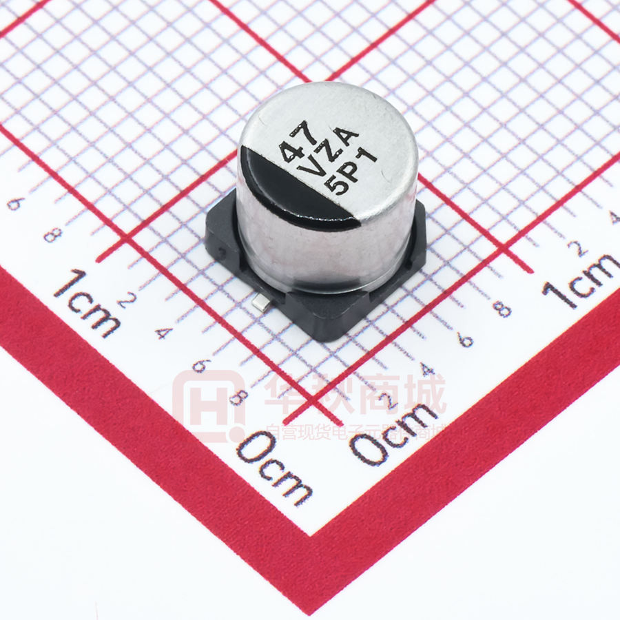

    SMD,D6.3xL5.8mm
    铝聚合物电容器 AEC_D6.3X5.8MM_SM 47µF ±20% 35V Ф6.30 x 5.80mm 60mΩ
EEHZA1V470P 数据手册
Hybrid Conductive Polymer Hybrid Aluminum Electrolytic Capacitors Surface Mount Type High temperature lead-free reflow ZA series Features ● Endurance : 10000 h at 105 ℃ ● Low ESR and high ripple current (over 70% lower ESR and 100% higher ripple current than V-FP) ● High voltage (to 80 V) ● Characteristics dependencies in frequency and low temperature are as small as polymer type ● Vibration-proof product is available upon request (ø6.3, ø8, ø10) ● AEC-Q200 compliant ● RoHS compliant Specifications Size code Category temp. range Rated voltage range Nominal cap.range Capacitance tolerance Leakage current Dissipation factor (tan δ) Surge voltage (V) Endurance Shelf life Damp heat (Load) Resistance to soldering heat C D8 F G –55 ℃ to +105 ℃ 25 V to 50 V 25 V to 63 V 25 V to 80 V 10 μF to 33 μF 10 μF to 56 μF 22 μF to 100 μF 22 μF to 220 μF 33 μF to 330 μF ±20 % (120 Hz / +20 ℃) I ≦ 0.01 CV (μA), 2 minutes after reaching rated voltage, 20 ℃ *CV = (Capacitance in μF) x (Rated voltage in V) Please see the attached characteristics list Rated voltage × 1.25 (15 ℃ to 35 ℃) +105 ℃ ± 2 ℃, 10000 h, apply the rated ripple current without exceeding the rated voltage. Capacitance change Within ±30% of the initial value Dissipation factor (tan δ) ≦ 200 % of the initial limit ESR ≦ 200 % of the initial limit Leakage current Within the initial limit Size code ESR after endurance C D D8 F G (Ω / 100 kHz)(-40 ℃) 2.0 1.4 0.8 0.4 0.3 After storage for 1000 hours at +105 ℃ ± 2 ℃ with no voltage applied and then being stabilized at +20 ℃, capacitors shall meet the limits specified in endurance. (With voltage treatment) +85 ℃ ± 2 ℃, 85 % to 90 %RH, 2000 h, rated voltage applied Capacitance change Within ±30% of the initial value Dissipation factor (tan δ) ≦ 200 % of the initial limit ESR ≦ 200 % of the initial limit Leakage current Within the initial limit After reflow soldering and then being stabilized at +20 ℃, capacitors shall meet the following limits. Capacitance change Within ±10% of the initial value Dissipation factor (tan δ) Within the initial limit Leakage current Within the initial limit Dimensions (not to scale) 5.8±0.3 5.8±0.3 7.7±0.3 10.2±0.3 10.2±0.3 5.3 6.6 6.6 8.3 10.3 < Size code:D, D8 > P 2.2 2.6 2.6 3.4 3.5 0.65±0.1 0.65±0.1 0.65±0.1 0.90±0.2 0.90±0.2 1.5 1.8 1.8 3.1 4.6 øD±0.5 K (I) F A±0.2 W L Supportive terminals Unit:V Size code D D8 F G øD L A, B 6.3 6.3 8.0 10.0 6.1±0.3 8.0±0.3 10.5±0.3 10.5±0.3 6.6 6.6 8.3 10.3 T L (I) Rated voltage code K +0.15 0.35 -0.20 +0.15 0.35 -0.20 +0.15 0.35 -0.20 0.70±0.2 0.70±0.2 I W P 0 to +0.15 2.4 2.4 3.4 3.5 0.65±0.1 0.65±0.1 1.2±0.2 1.2±0.2 2.2 2.2 3.1 4.6 0 to +0.15 0 to +0.15 Supportive terminals ( ) Reference size Unit:mm F 0 to +0.15 T W Pressure relief (ø10 ≦) ( ) Reference size H max. 7.8 7.8 10.0 12.0 Unit:mm R R (P) (S) B±0.2 A±0.2 H øD±0.5 W < Size code:F, G > F 25 35 50 63 80 I K 5.0 6.3 6.3 8.0 10.0 H max. 6.5 7.8 7.8 10 12.0 (I) A, B (P) ( ) Reference size L (I) K (I) W øD [Vibration-proof product] Lot number R. voltage code E V H J K C D D8 F G (P) L Pressure relief (ø10 ≦) 33 E ZA Size code (S) Series identification B±0.2 Capacitance (μF) H øD±0.5 Negative polarity marking (–) A±0.2 H 0.3 max. B±0.2 [Standard] Example : 25 V 33 μF Marking color : BLACK (I) Marking D K +0.15 0.35 -0.20 +0.15 0.35 -0.20 0.70±0.2 0.70±0.2 Design and specifications are each subject to change without notice. Ask factory for the current technical specifications before purchase and/or use. Should a safety concern arise regarding this product, please be sure to contact us immediately. R S T 1.1±0.2 1.1±0.2 0.70±0.2 0.70±0.2 3.3 3.3 5.3 6.9 1.05±0.2 1.05±0.2 1.3±0.2 1.3±0.2 01-Apr-22 ZA series Characteristics list Endurance : 105 ℃ 10000 h Case size Specification (mm) Rated voltage (V) 25 35 50 63 80 Capacitance (±20 %) (μF) 22 33 47 56 68 100 150 220 330 10 22 27 33 47 68 100 150 220 270 10 22 33 47 68 100 10 22 33 47 56 68 82 22 33 47 L øD 5.0 5.0 6.3 6.3 6.3 6.3 8.0 8.0 10.0 5.0 5.0 6.3 6.3 6.3 6.3 8.0 8.0 10.0 10.0 5.0 6.3 6.3 8.0 8.0 10.0 6.3 6.3 8.0 8.0 10.0 10.0 10.0 8.0 10.0 10.0 Size code Standard Vibration -proof 5.8 5.8 5.8 5.8 7.7 7.7 10.2 10.2 10.2 5.8 5.8 5.8 5.8 5.8 7.7 10.2 10.2 10.2 10.2 5.8 5.8 7.7 10.2 10.2 10.2 5.8 7.7 10.2 10.2 10.2 10.2 10.2 10.2 10.2 10.2 6.1 6.1 8.0 8.0 10.5 10.5 10.5 6.1 6.1 6.1 8.0 10.5 10.5 10.5 10.5 6.1 8.0 10.5 10.5 10.5 6.1 8.0 10.5 10.5 10.5 10.5 10.5 10.5 10.5 10.5 Ripple current*1 ESR*2 900 900 1300 1300 2000 2000 2300 2300 2500 900 900 1300 1300 1300 2000 2300 2300 2500 2500 750 1100 1600 1800 1800 2000 1000 1500 1700 1700 1800 1800 1800 1550 1700 1700 80 80 50 50 30 30 27 27 20 100 100 60 60 60 35 27 27 20 20 120 80 40 30 30 28 120 80 40 40 30 30 30 45 36 36 (mA rms) C C D D D8 D8 F F G C C D D D D8 F F G G C D D8 F F G D D8 F F G G G F G G (mΩ) Min.packaging q'ty (pcs) Part number Standard product tan δ*3 0.14 0.14 0.14 0.14 0.14 0.14 0.14 0.14 0.14 0.12 0.12 0.12 0.12 0.12 0.12 0.12 0.12 0.12 0.12 0.10 0.10 0.10 0.10 0.10 0.10 0.08 0.08 0.08 0.08 0.08 0.08 0.08 0.08 0.08 0.08 EEHZA1E220R EEHZA1E330R EEHZA1E470P EEHZA1E560P EEHZA1E680XP EEHZA1E101XP EEHZA1E151P EEHZA1E221P EEHZA1E331P EEHZA1V100R EEHZA1V220R EEHZA1V270P EEHZA1V330P EEHZA1V470P EEHZA1V680XP EEHZA1V101P EEHZA1V151P EEHZA1V221P EEHZA1V271P EEHZA1H100R EEHZA1H220P EEHZA1H330XP EEHZA1H470P EEHZA1H680P EEHZA1H101P EEHZA1J100P EEHZA1J220XP EEHZA1J330P EEHZA1J470P EEHZA1J560P EEHZA1J680P EEHZA1J820P EEHZA1K220P EEHZA1K330P EEHZA1K470P Vibration-proof product EEHZA1E470V EEHZA1E560V EEHZA1E680XV EEHZA1E101XV EEHZA1E151V EEHZA1E221V EEHZA1E331V EEHZA1V270V EEHZA1V330V EEHZA1V470V EEHZA1V680XV EEHZA1V101V EEHZA1V151V EEHZA1V221V EEHZA1V271V EEHZA1H220V EEHZA1H330XV EEHZA1H470V EEHZA1H680V EEHZA1H101V EEHZA1J100V EEHZA1J220XV EEHZA1J330V EEHZA1J470V EEHZA1J560V EEHZA1J680V EEHZA1J820V EEHZA1K220V EEHZA1K330V EEHZA1K470V Taping 1000 1000 1000 1000 900 900 500 500 500 1000 1000 1000 1000 1000 900 500 500 500 500 1000 1000 900 500 500 500 1000 900 500 500 500 500 500 500 500 500 *1: Ripple current (100 kHz / +105 ℃) *2: ESR (100 kHz / +20 ℃) *3: tan δ (120 Hz / +20 ℃) ◆ Please refer to the page of “Reflow profile” and “The taping dimensions”. ◆ The dimensions of the vibration-proof products, please refer to the page of the mounting specification. Frequency correction factor for ripple current Rated capacitance (C) C < 47 μF 47 μF ≦ C < 150 μF 150 μF ≦ C Frequency (f) Rated capacitance (C) C < 47 μF 47 μF ≦ C < 150 μF 150 μF ≦ C Frequency (f) Rated capacitance (C) C < 47 μF 47 μF ≦ C < 150 μF 150 μF ≦ C Frequency (f) Rated capacitance (C) C < 47 μF 47 μF ≦ C < 150 μF 150 μF ≦ C Frequency (f) Correction factor Correction factor Correction factor Correction factor 100 Hz ≦ f < 200 Hz 0.10 0.15 0.15 200 Hz ≦ f < 300 Hz 0.10 0.20 0.25 300 Hz ≦ f < 500 Hz 0.15 0.25 0.25 500 Hz ≦ f < 1 kHz 0.20 0.30 0.30 1 kHz ≦ f < 2 kHz 0.30 0.40 0.45 2 kHz ≦ f < 3 kHz 0.40 0.45 0.50 3 kHz ≦ f < 5 kHz 0.45 0.55 0.60 5 kHz ≦ f < 10 kHz 0.50 0.60 0.65 10 kHz ≦ f < 15 kHz 0.60 0.70 0.75 15 kHz ≦ f < 20 kHz 0.65 0.75 0.80 20 kHz ≦ f < 30 kHz 0.70 0.80 0.85 30 kHz ≦ f < 40 kHz 0.75 0.80 0.85 40 kHz ≦ f < 50 kHz 0.80 0.85 0.85 50 kHz ≦ f < 100 kHz 0.85 0.90 0.90 100 kHz ≦ f < 500 kHz 1.00 1.00 1.00 500 kHz ≦ f 1.05 1.00 1.00 Design and specifications are each subject to change without notice. Ask factory for the current technical specifications before purchase and/or use. Should a safety concern arise regarding this product, please be sure to contact us immediately. 01-Apr-22 Guidelines and precautions regarding the technical information and use of our products described in this online catalog. ■ If you want to use our products described in this online catalog for applications requiring special qualities or reliability, or for applications where the failure or malfunction of the products may directly jeopardize human life or potentially cause personal injury (e.g. aircraft and aerospace equipment, traffic and transportation equipment, combustion equipment, medical equipment, accident prevention, anti-crime equipment, and/or safety equipment), it is necessary to verify whether the specifications of our products fit to such applications. Please ensure that you will ask and check with our inquiry desk as to whether the specifications of our products fit to such applications use before you use our products. ■ The quality and performance of our products as described in this online catalog only apply to our products when used in isolation. Therefore, please ensure you evaluate and verify our products under the specific circumstances in which our products are assembled in your own products and in which our products will actually be used. ■ Please ensure the safety by means of protection circuit, redundant circuit etc. in your system design in order to prevent the occurrence of life crisis and other serious damages due to the failure of our products. ■ The products and product specifications described in this online catalog are subject to change for improvement without prior notice. Therefore, please be sure to request and confirm the latest product specifications which explain the specifications of our products in detail, before you finalize the design of your applications, purchase, or use our products. ■ The technical information in this online catalog provides examples of our products' typical operations and application circuits. We do not guarantee the non-infringement of third party's intellectual property rights and we do not grant any license, right, or interest in our intellectual property. ■ If any of our products, product specifications and/or technical information in this online catalog is to be exported or provided to non-residents, the laws and regulations of the exporting country, especially with regard to security and export control, shall be observed. ■ The switchover date for compliance with the RoHS Directive/REACH Regulations varies depending on the part number or series of our products. ■ When you use the inventory of our products for which it is unclear whether those products are compliant with the RoHS Directive/REACH Regulation, please select "Sales Inquiry" in the website inquiry form and contact us. Please note that we do not owe any liability and responsibility if our products are used beyond the description of this catalog or without complying with precautions in this catalog. 25-Nov-22 Notices / Items to be observed Notices ■ Applicable laws and regulations ・This product complies with the RoHS Directive (Restriction of the use of certain hazardous substances in electrical and electronic equipment (DIRECTIVE 2011/65/EU and(EU)2015/863)). ・ No Ozone Depleting Chemicals(ODC's), controlled under the Montreal Protocol Agreement, are used in producing this product. We do not use PBBs or PBDEs as brominated flame retardants. ・ Export procedure which followed export related regulations, such as foreign exchange and a foreign trade method, on the occasion of export of this product. ・ These products are not dangerous goods on the transportation as identified by UN(United Nations) numbers or UN classification. ■ Limited applications ・ This capacitor is designed to be used for electronics circuits such as audio/visual equipment, home appliances, computers and other office equipment, optical equipment, measuring equipment. ・ An advanced specification must be signed individually for high-reliability use that might threaten human life or property due to a malfunction of the capacitor. ■ Intellectual property rights and licenses ・ The technical information in this specification provides examples of our products' typical operations and application circuits. We do not guarantee the non-infringement of third party's intellectual property rights and we do not grant any license, right, or interest in our intellectual property. Items to be observed ■ For specification ・ This specification guarantees the quality and performance of the product as individual components. The durability differs depending on the environment and the conditions of usage. Before use, check and evaluate their compatibility with actual conditions when installed in the products. When safety requirements cannot be satisfied in your technical examination, inform us immediately. ・ Do not use the products beyond the specifications described in this document. ■ Upon application to products where safety is regarded as important Install the following systems for a fail-safe design to ensure safety if these products are to be used in equipment where a defect in these products may cause the loss of human life or other signification damage, such as damage to vehicles (automobile, train, vessel), traffic lights, medical equipment, aerospace equipment, electric heating appliances, combustion/ gas equipment, rotating rotating equipment, and disaster/crime prevention equipment. (1) The system is equipped with a protection circuit and protection device. (2) The system is equipped with a redundant circuit or other system to prevent an unsafe status in the event of a single fault. ■ Conditions of use ・ Before using the products, carefully check the effects on their quality and performance, and determined whether or not they  can be used. These products are designed and manufactured for general-purpose and standard use in general electronic equipment. These products are not intended for use in the following special conditions. (1) In liquid, such as Water, Oil, Chemicals, or Organic solvent. (2) In direct sunlight, outdoors, or in dust. (3) In vapor, such as dew condensation water of resistive element, or water leakage, salty air, or air with a high concentration corrosive gas, such as Cl2, H2S, NH3, SO2, or NOx. (4) In an environment where strong static electricity or electromagnetic waves exist. (5) Mounting or placing heat-generating components or inflammables, such as vinyl-coated wires, near these products. (6) Sealing or coating of these products or a printed circuit board on which these products are mounted, with resin and other material. (7) Using resolvent, water or water-soluble cleaner for flux cleaning agent after soldering. (In particular, when using water or a water-soluble cleaning agent, be careful not to leave water residues) (8) Using in the atmosphere where strays acid or alkaline. (9) Using in the atmosphere where there are excessive vibration and shock. (10) Using in the atmosphere where there are low pressure or decompression. ・ Please arrange circuit design for preventing impulse or transitional voltage.  Do not apply voltage, which exceeds the full rated voltage when the capacitors receive impulse voltage, instantaneous high  voltage, high pulse voltage etc. ・ Our products there is a product are using an electrolyte solution. Therefore, misuse can result in rapid deterioration of characteristics and functions of each product. Electrolyte leakage damages printed circuit and affects performance, characteristics, and functions of customer system. 16-Apr-21 Conductive Polymer Hybrid Aluminum Electrolytic Capacitors   Application Guidelines(Hybrid) 1. Circuit design 1.1 Operating temperature and frequency Electrical characteristics of the capacitor are likely to change due to variation in temperature and/or frequency. Circuit designers should take these changes into consideration. (1) Effects of operating temperature on electrical parameters At higher temperatures : Leakage current increases : Hybrid type has smaller capacitance and larger tan δ. At lower temperatures Other aluminum electrolytic capacitors have smaller capacitance, larger tan δ, and larger impedance as well as equivalent series resistance (ESR). (2) Effects of frequency on electrical parameters At higher frequency capacitance and impedance decrease while tanδ increases. At lower frequency, heat generated by ripple current will rise due to an increase in equivalent series resistance (ESR). 1.2 Operating temperature and life expectancy (1) Expected life is affected by operating temperature. Generally, each 10 °C reduction in temperature will double the expected life. Use capacitors at the lowest possible temperature below the upper category temperature. (2) If operating temperatures exceed the upper category limit, rapid deterioration of electrical parameter will occur and irreversible damage will result. Measure not only the ambient temperature but also the surface temperature of the capacitor’s case top, which has effects of ripple current and radiated heat from power transistors, IC's, and/or resistors. Avoid placing components, which could conduct heat to the capacitor from the back side of the circuit board. (3) The formula for calculating expected life is as follows ; L2 = L1×2 T1-(T2+⊿T) 10 where T1 ≧ T2 L1 L2 T1 T2 : Guaranteed life (h) at temperature, T1 (℃) : Expected life (h) at temperature, T2 (℃) : Upper category temperature (℃) *Hybrid type : + temperature rise due to rated ripple current (℃) : Capacitor's ambient temperature (℃) ⊿T : Temperature rise due to ripple current (°C) (4) Using the capacitor beyond the rated lifetime will result in short circuit, electrolyte leak, vent open, and large   deterioration of characteristics. The lifetime cannot exceed 15 years due to aging of sealing rubber. (5) If the capacitor is used in a high temperature condition for a long time, micro cracks may appear on the surface of sealing rubber, and/or capacitor case exterior may become brownish in color, but the product reliability will not be influenced. 1.3 Load conditions to avoid The following load conditions will cause rapid deterioration of capacitor’s electrical characteristics. In addition, instantaneous heating and gas generation within the capacitor may cause an operation of pressure relief vent, and that results in electrolyte leaks, explosion and/or fire ignition. The leaked electrolyte is combustible and electrically conductive. (1) Reverse voltage DC capacitors have polarity. Therefore, do not apply the reverse voltage. Find the correct polarity before insertion. (2) Charge / Discharge applications General purpose capacitors are not suitable for use in repeating charge/discharge applications. For such applications, consult a sales representative with actual application condition. Rush current must not exceed 100 A. (3) ON-OFF circuit When using capacitors in circuit where ON-OFF switching is repeated more than 10,000 times a day, consult a sales representative with actual application condition for an appropriate choice of capacitors. (4) Over voltage Do not apply a voltage exceeding the rated voltage. The rated surge voltage can be applied only for a short time. Make sure that a sum of the DC voltage and the superimposed AC ripple voltage does not exceed the rated voltage. (5) Ripple current Do not apply ripple currents exceeding the rated value. Make sure that rated ripple currents superimposed on low DC bias voltages do not cause reverse voltage conditions. Even if the current is below the rated ripple current, using the capacitor for longer than the rated lifetime will cause ESR increase and internal generation of heat, which may eventually lead to vent open, bulging of case/rubber, electrolyte leak, short circuit, explosion, or ignition in the worst case. 01-Apr-22 Conductive Polymer Hybrid Aluminum Electrolytic Capacitors 1.4 Connections in parallel Because the impedance of the capacitor and PCB’s wiring are very close, various impedance values may cause unbalanced ripple current loads among parallel capacitors. Combine the same part number and wire them carefully to minimize the potential risk of an excessive ripple current concentrating to one capacitor of the smallest impedance. The capacitors cannot be used in series. 1.5 Capacitor mounting considerations (1) For double sided circuit boards, avoid wiring patterns passing between the mounted capacitor and the circuit board. When a radial lead type capacitor is dipped into a solder bath, an excess solder may deposit under the capacitor by capillary action, causing short circuit between anode and cathode terminals. Also, lead holes must be placed with special care for radial lead type capacitors because laminate on capacitor’s surface may become damaged during flow process. (2) The pitch between circuit board holes should match the lead wire pitch of the radial lead type capacitors within the specified tolerances. Unmatched pitch may cause an excessive stress on lead wires during the insertion process and result in short/open circuit, increased leakage current, or electrolyte leak. (3) Clearance for case mounted pressure relief (≧ ø10 mm) Capacitors with case mounted pressure relief require sufficient clearance to allow for proper pressure relief operation. The minimum clearance are dependent on capacitor diameters as follows. * ≧ø10 mm : 2 mm minimum (4) Wiring near the pressure relief (≧ ø10 mm) Avoid locating high voltage or high current wiring or circuit board paths above the pressure relief. Flammable, high temperature gas that exceeds 100 ℃ may be released which could dissolve the wire insulation and ignite. (5) Circuit board patterns under the capacitor Avoid circuit board runs under the capacitor, as an electrical short can occur due to an electrolyte leakage. (6) Resonant vibration after circuit board’s production may make a heavy load on the capacitor and cause rapid change in characteristics and/or capacitor’s break. 1.6 Electrical isolation Electrically isolate the capacitor’s case from cathode terminals, as well as circuit patterns. 1.7 Capacitor coating The laminate coating is intended for marking and identification purposes and is not meant to electrically insulate the capacitor. Its color may become brownish in a high-temperature condition, but the marking appearance and electrical characteristics will not be influenced. 2. Capacitor handling techniques 2.1 Considerations before using (1) Capacitors have a finite life. Do not reuse or recycle capacitors from used equipment. (2) Transient recovery voltage may be generated in the capacitor due to dielectric absorption. If required, this voltage can be discharged with a resistor with a value of about 1 kΩ. (3) Capacitors stored for a long period of time may exhibit an increase in leakage current. This can be corrected by gradually applying rated voltage in series with a resistor of approximately 1 kΩ. (4) If capacitors are dropped, they can be damaged mechanically or electrically. Avoid using dropped capacitors. (5) Dented or crushed capacitors should not be used. The seal integrity can be damaged and loss of electrolyte/ shortened life can result. 2.2 Capacitor insertion (1) Verify the correct capacitance and rated voltage of the capacitor. (2) Verify the correct polarity of the capacitor before insertion. (3) Verify the correct terminal dimension and land pattern size for surface mount type, or holes’ pitch for radial lead type before mount to avoid short circuit, stress on terminals, and/or lack of terminal strength. (4) Excessive mounting pressure can cause high leakage current, short circuit, or disconnection. (5) When using a mounter for radial lead type, avoid cutter wear and acute angle of lead-bending with respect to circuit board. That may create excessive stress and pull the lead to damage the capacitor. 01-Apr-22 Conductive Polymer Hybrid Aluminum Electrolytic Capacitors 2.3 Reflow soldering (for surface mount type) (1) Surface-mount type capacitor are exclusively for reflow soldering. When reflow solder is used an ambient heat condition system such as the simultaneous use of infrared and hot-air is recommended. (2) Observe proper soldering conditions (temperature, time, etc.). Do not exceed the specified limits. If the peak temperature is high or if the heating time is long, it may cause deterioration of the electrical characteristics and life characteristics. Recommended soldering condition is a guideline for ensuring the basic characteristics of the components, but not for the stable soldering conditions. Conditions for proper soldering should be set up according to individual conditions.  ✽ The Temperature on capacitor top shall be measured by using thermal couple that is fixed firmly by epoxy glue. (3) In case of use in 2 times reflow, 2nd reflow must be done when the capacitor’s temperature return back to normal level. (4) In our recommended reflow condition , the case discoloration and the case swelling might be slightly generated. But please acknowledge that these two phenomena do not influence the reliability of the product. (5) The crack on top marking might be occurred by reflow heat stress.  But please acknowledge that it does not influence the reliability of the product. (6) VPS (Vapor Phase Soldering) reflow can cause significant characteristics change and/ or mounting failure due to deformation by acute temperature rise. VPS is acceptable provided that the process does not exceed recommended reflow profile and temperature rise is less than 3 ℃ / sec.  Please contact Panasonic for detailed conditions. (7) The vibration-proof capacitors of size ø6.3 has support terminals extending from the bottom side to the lead edge. Then, make sure to find appropriate soldering conditions to form fillet on the support terminals if required for appearance inspection. However, even if sufficient solder fillets are not observed, the reliability of vibration-proof will not be lowered because the support terminals on the bottom side enhance the solder joint to PCB. 2.4 Flow soldering (for radial type) (1) Radial lead type capacitors cannot apply to reflow soldering. (2) Do not immerse the capacitor body into the solder bath as excessive internal pressure could result. (3) Apply proper soldering conditions (temperature, time, etc.). Do not exceed the specified limits. (4) Do not allow other parts or components to touch the capacitor during soldering. (5) When mounting the radial type being touched to PCB, be sure to check the appearance of solder under the sealing rubber, which does not have an airflow structure. 2.5 Manual soldering (1) Apply soldering conditions (temperature and time) based on the specification, or do not exceed temperature of 350 ℃ for 3 seconds. (2) If a soldered capacitor must be removed and reinserted, avoid excessive stress on the capacitor leads. (3) Avoid physical contacts between the tip of the soldering iron and capacitors to prevent capacitor failure. (4) When bending lead wires of radial type capacitors to match the hole pitch on PCB, avoid applying excessive stress to the capacitor body. 2.6 Capacitor handling after soldering (1) Avoid moving the capacitor after soldering to prevent excessive stress on the lead wires where they enter the seal. The capacitor may break from element portion due to a torque at outer rim, causing a large stress to terminals. (2) Do not use the capacitor as a handle when moving the circuit board assembly. The total weight of the board would apply to element portion through terminals, and the capacitor may break. (3) Avoid striking the capacitor after assembly to prevent failure due to excessive shock. The capacitor may break due to excessive shock or load above specified range. 01-Apr-22 Conductive Polymer Hybrid Aluminum Electrolytic Capacitors 2.7 Circuit board cleaning (1) Circuit boards can be immersed or ultrasonically cleaned using suitable cleaning solvents for up to 5 minutes and up to 60 °C maximum temperatures. The boards should be thoroughly rinsed and dried. The use of ozone depleting cleaning agents is not recommended for the purpose of protecting our environment. 【Target solvent】 Pine Alpha ST-100S, Aqua Cleaner 210SEP, Clean-thru 750H / 750L / 710M, Sunelec B-12, Sunelec B-12, Cold Cleaner P3-375, Techno Cleaner 219, DK Be-clear CW-5790, Telpene Cleaner EC-7R, Technocare FRW-17 / FRW-1 / FRV-1 (2) Avoid using the following solvent groups unless specifically allowed in the specification ; (a) Halogenated based solvents : may permeate the seal and cause internal corrosion. Especially, 1-1-1 trichloroethane must not be used on any aluminum electrolytic capacitors. (b) Alkaline based solvents : may dissolve and react to the aluminum case. (c) Petroleum based solvents : may deteriorate the sealing rubber (d) Xylene : may deteriorate the sealing rubber (e) Acetone : may erase the markings on the capacitor top (3) A thorough drying after cleaning is required to remove residual cleaning solvents that may be trapped between the capacitor and the circuit board. Avoid drying temperatures, which exceed the upper category temperature of the capacitor. (4) Monitor the contamination levels of cleaning solvents during use in terms of electrical conductivity, pH, specific gravity, and water content. Inside the capacitor may corrode with high density of chlorine. Control the flux density in the cleaning agent to be less than 2 mass%. (5) Depending on the cleaning method, the marking on a capacitor may be erased or blurred. ※ Please consult us if you are not certain about acceptable cleaning solvents or cleaning methods. 2.8 Mounting adhesives and coating agents When using mounting adhesives or coating agents to control humidity, avoid using materials containing halogenated solvents. Also, avoid the use of chloroprene based polymers. Cure or dry out the coating agents thoroughly, and do not leave any solvents. Make sure to dry out cleaning agents completely immediately after washing the circuit board if the capacitors are mounted afterward, so that the solvents are not left under the capacitor body. Also, leave more than 1/3 of the sealing portion open, and do not cover that portion with any adhesives or coating. 2.9 Potting and molding Potting and molding processes cannot be recommended. They have potential risks to change the capacitor’s performance and reliability due to injection pressure, diffused material into the capacitor, as well as heat accumulation by covered resin. Also, evaporated electrolyte may remain inside the resin, then turn to liquid, and possibly short circuit PCB patterns. 2.10 Fumigation In exporting electronic appliances with aluminum electrolytic capacitors, in some cases fumigation treatment using such halogen compound as methyl bromide is conducted for wooden boxes. If such boxes are not dried well, the halogen left in the box is dispersed while transported and enters in the capacitors inside. This possibly causes electrical corrosion of the capacitors. Therefore, after performing fumigation and drying make sure that no halogen is left. Don’t perform fumigation treatment to the whole electronic appliances packed in a box. 2.11 Flux If you use a halogen type (Chlorine type, Bromine type, etc.) high-activity flux, please use it after confirmation in advance, as it may have an impact on performance and reliability of this product due to the residue of the flux. 3. Precautions for using capacitors 3.1 Environmental conditions Capacitors should not be stored or used in the following environments. (1) Exposure to temperatures above the upper category or below the lower category temperature of the capacitor. (2) Direct contact with water, salt water, or oil. (3) High humidity conditions where water could condense on the capacitor. (4) Exposure to toxic gases such as hydrogen sulfide, sulfuric acid, nitric acid, chlorine, chlorine compound, bromine, bromine compound or ammonia. (5) Exposure to ozone, radiation, or ultraviolet rays. (6) Vibration and shock conditions exceeding specified requirements. Even within the specified requirements, a large vibration acceleration may be applied due to resonance, so be sure to evaluate and confirm with the actual product. 01-Apr-22 Conductive Polymer Hybrid Aluminum Electrolytic Capacitors 3.2 Electrical precautions (1) Avoid touching the terminals of a capacitor as a possible electric shock could result. The exposed aluminum case is not insulated and could also cause electric shock if touched. (2) Avoid short circuiting the capacitor terminals with conductive materials such as acids or alkaline solutions. (3) Electrical characteristics may largely change if a silicon material with low molecular-weight siloxane is used near the capacitor. 4. Emergency procedures (1) If the pressure relief of the capacitor operates, immediately turn off the equipment and disconnect from the power source. This will minimize an additional damage caused by the vaporizing electrolyte. (2) Avoid contact with the escaping electrolyte gas, which can exceed 100 °C temperatures. If electrolyte or gas enters the eye, immediately flush the eye with large amounts of water. If electrolyte or gas is ingested by mouth, gargle with water. If electrolyte contacts the skin, wash with soap and water. 5. Long term storage (1) Leakage current of a capacitor tends to increase after a long-term storage due to dielectric dissolution, and very high current may flow at the first voltage load. However, applying voltage will form the dielectric, and the leakage current will decrease. Expiration date is 42 months from the outgoing inspection date. Storage condition is to keep in room temperature (5 ℃ to 35 ℃) and humidity (45 % to 85 %) with no direct sunshine. (2) Environmental conditions Do not store under condition outside the area described in the specification, and also under conditions listed below. (a) Exposure to temperatures above the upper category or below the lower category temperature of the capacitor. (b) Direct contact with water, salt water, or oil. (c) High humidity conditions where water could condense on the capacitor. (d) Exposure to toxic gases such as hydrogen sulfide, sulfuric acid, nitric acid, chlorine, chlorine compound, bromine, bromine compound or ammonia. (e) Exposure to ozone, radiation, or ultraviolet rays. (f) Vibration and shock conditions exceeding specified requirements. 6. Capacitor disposal When disposing capacitors, use one of the following methods. (1) Incinerate after crushing the capacitor or puncturing the can wall (to prevent explosion due to internal pressure rise). (2) Dispose as solid waste. NOTE : Local laws may have specific disposal requirements which must be followed. The precautions in using aluminum electrolytic capacitors follow the "Safety application guide for the use in fixed aluminum electrolytic capacitors for electronic equipment", RCR-2367D issued by JEITA in October 2017. Please refer to the above application guide for details. ■ AEC-Q200 compliant The products are tested based on all or part of the test conditions and methods defined in AEC-Q200. Please consult with Panasonic for the details of the product specification and specific evaluation test results, etc., and please review and approve Panasonic's product specification before ordering. ✽ Intellectual property right We, Panasonic Group are providing the product and service that customers can use without anxiety, and are working positively on the protection of our products under intellectual property rights. Representative patents relating to Conductive Polymer Hybrid Aluminum Electrolytic Capacitors are as follows: US Patent No.7497879, No.7621970, No.9208954, No.9595396, No.9966200, No.10453618, JP Patent EP Patent No.10559432, No.10679800, No.10685788, No.10790095 No.5360250 No.1808875, No.2698802 01-Apr-22
