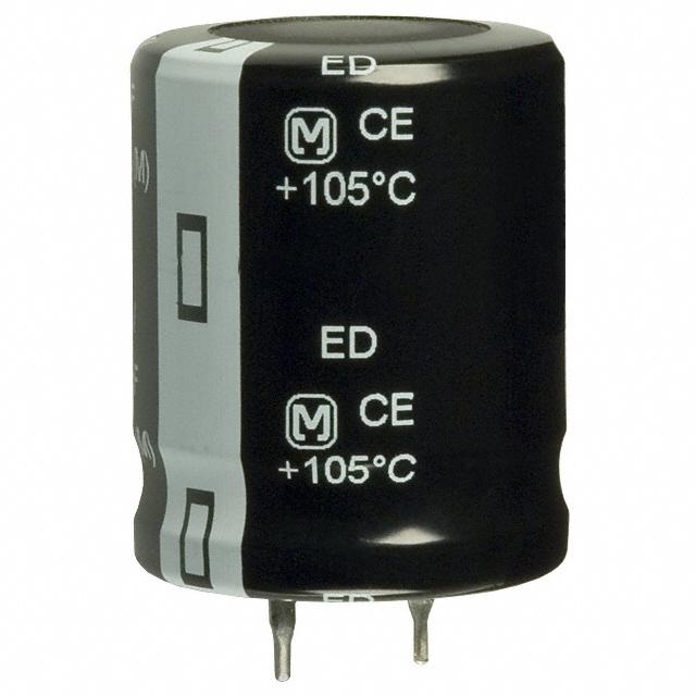

    470 µF 200 V 铝电解电容器 径向,Can - 卡入式 317 毫欧 @ 120Hz 105°C 时为 3000 小时
EET-ED2D471CA 数据手册
Large Can Aluminum Electrolytic Capacitors TS-ED Series two terminal snap-in  NEW PRODUCT  Very high ripple current capability for demanding inverter applications  3000 hour life at 105ºC  Can vent construction Rated Working Voltage: Operating Temperature: Nominal Capacitance: Capacitance Tolerance: Dissipation Factor: 200 ~ 250 VDC -40 ~ +105ºC 220~2200 µF 400 ~ 450 VDC -25 ~ +105ºC 56 ~ 560µF ± 20% 15% maximum (120Hz, +20°C) 3000 hours at +105ºC with maximum specified ripple current (see page 4) Endurance: Part Number System E E T E Common Code/ Terminal Type D Voltage Code Series Code Capacitance Code Case Dia. / Terminal Case Dia. Ripple Current Multipliers: Page 7 Top Vinyl Plate Terminal Length 6.3mm 4.0mm 22mm 25mm 30mm 35mm B C D E A With plate Without plate H J K L TS-ED Standard Ratings (part numbers shown with standard length terminal and top vinyl plate) Cap. (µF) Size (mm) Max 105°C R.C. (A rms) DxL 120Hz 10k~100kHz 20°C ESR (Ω, max.) 120Hz 20kHz Panasonic Cap. Part Number (µF) EETED2D271BA EETED2D331BA EETED2D391BA EETED2D471BA EETED2D561BA EETED2D681BA EETED2D821BA EETED2D391CA EETED2D471CA EETED2D561CA EETED2D681CA EETED2D821CA EETED2D102CA EETED2D561DA EETED2D681DA EETED2D821DA EETED2D102DA EETED2D122DA EETED2D152DA EETED2D821EA EETED2D102EA EETED2D122EA EETED2D152EA EETED2D182EA EETED2D222EA 220 270 330 390 470 270 330 390 470 560 680 390 470 560 680 820 1000 560 680 820 1000 1200 1500 Size (mm) Max 105°C R.C. (A rms) DxL 200 VDC Working, 250 VDC Surge 270 330 390 470 560 680 820 390 470 560 680 820 1000 560 680 820 1000 1200 1500 820 1000 1200 1500 1800 2200 22 22 22 22 22 22 22 25 25 25 25 25 25 30 30 30 30 30 30 35 35 35 35 35 35 x x x x x x x x x x x x x x x x x x x x x x x x x 25 30 30 35 40 45 50 25 30 30 35 40 45 25 30 30 35 40 50 25 30 35 40 45 50 1.42 1.56 1.71 1.85 2.14 2.42 2.63 1.71 1.85 2.14 2.42 2.63 2.84 2.14 2.42 2.63 2.84 3.13 3.56 2.63 2.84 3.13 3.56 3.84 4.12 2.03 2.23 2.44 2.64 3.05 3.45 3.76 2.44 2.64 3.05 3.45 3.76 4.06 3.05 3.45 3.76 4.06 4.47 5.08 3.76 4.06 4.47 5.08 5.48 5.89 0.553 0.452 0.383 0.317 0.266 0.219 0.182 0.383 0.317 0.266 0.219 0.182 0.149 0.266 0.219 0.182 0.149 0.124 0.099 0.182 0.149 0.124 0.099 0.083 0.068 0.249 0.203 0.172 0.143 0.120 0.099 0.082 0.172 0.143 0.120 0.099 0.082 0.067 0.120 0.099 0.082 0.067 0.062 0.050 0.091 0.067 0.062 0.050 0.041 0.041 120Hz 10k~100kHz 20°C ESR (Ω, max.) 120Hz 20kHz Panasonic Part Number 250 VDC Working, 300 VDC Surge 22 22 22 22 22 25 25 25 25 25 25 30 30 30 30 30 30 35 35 35 35 35 35 x x x x x x x x x x x x x x x x x x x x x x x 30 30 35 40 45 25 30 30 35 40 45 25 30 30 35 40 50 25 30 35 40 45 50 1.28 1.42 1.64 1.72 1.85 1.42 1.56 1.71 1.85 2.14 2.42 1.71 1.85 2.14 2.42 2.63 2.84 2.14 2.42 2.63 2.84 3.13 3.56 1.83 2.03 2.34 2.45 2.64 2.03 2.23 2.44 2.64 3.05 3.45 2.44 2.64 3.05 3.45 3.76 4.06 3.05 3.45 3.76 4.06 4.47 5.08 0.678 0.553 0.452 0.383 0.317 0.553 0.452 0.383 0.317 0.266 0.219 0.383 0.317 0.266 0.219 0.182 0.149 0.266 0.219 0.182 0.149 0.124 0.099 0.305 0.249 0.203 0.172 0.143 0.249 0.203 0.172 0.143 0.120 0.099 0.172 0.143 0.120 0.099 0.082 0.067 0.133 0.110 0.091 0.067 0.062 0.050 EETED2E221BA EETED2E271BA EETED2E331BA EETED2E391BA EETED2E471BA EETED2E271CA EETED2E331CA EETED2E391CA EETED2E471CA EETED2E561CA EETED2E681CA EETED2E391DA EETED2E471DA EETED2E561DA EETED2E681DA EETED2E821DA EETED2E102DA EETED2E561EA EETED2E681EA EETED2E821EA EETED2E102EA EETED2E122EA EETED2E152EA Design and specifications are subject to change without notice. Ask factory for technical specifications before purchase and/or use. Whenever a doubt about safety arises from this product, please contact us immediately for technical consultation. 23 Large Can Aluminum Electrolytic Capacitors TS-ED Standard Ratings (continued) Cap. (µF) Size (mm) Max 105°C R.C. (A rms) DxL 120Hz 10k~100kHz 20°C ESR (Ω, max.) 120Hz 20kHz Size (mm) Max 105°C R.C. (A rms) Cap. (µF) EETED2G820BA EETED2G101BA EETED2G121BA EETED2G151BA EETED2G181BA EETED2G221BA EETED2G101CA EETED2G121CA EETED2G151CA EETED2G181CA EETED2G221CA EETED2G271CA EETED2G151DA EETED2G181DA EETED2G221DA EETED2G271DA EETED2G331DA EETED2G391DA EETED2G221EA EETED2G271EA EETED2G331EA EETED2G391EA EETED2G471EA EETED2G561EA 56 68 82 100 120 150 180 68 82 100 120 150 180 220 120 150 180 220 270 330 150 180 220 270 330 390 22 22 22 22 22 22 22 25 25 25 25 25 25 25 30 30 30 30 30 30 35 35 35 35 35 35 25 30 30 35 40 45 50 25 25 30 35 40 40 45 25 30 30 35 40 50 25 25 30 35 40 40 0.67 0.76 0.80 0.91 1.02 1.07 1.12 0.76 0.80 0.91 1.02 1.07 1.12 1.42 1.02 1.07 1.12 1.42 1.72 1.85 1.07 1.12 1.42 1.72 1.85 1.97 0.95 1.08 1.14 1.30 1.46 1.53 1.60 1.08 1.14 1.30 1.46 1.53 1.60 2.03 1.46 1.53 1.60 2.03 2.45 2.64 1.53 1.60 2.03 2.45 2.64 2.82 2.368 1.950 1.617 1.326 1.105 0.884 0.737 1.950 1.617 1.326 1.105 0.884 0.737 0.603 1.105 0.884 0.737 0.603 0.491 0.402 0.884 0.737 0.603 0.491 0.402 0.340 1.066 0.878 0.728 0.597 0.497 0.398 0.332 0.878 0.728 0.597 0.497 0.398 0.332 0.271 0.497 0.398 0.332 0.271 0.221 0.181 0.398 0.332 0.271 0.221 0.181 0.153 EETED2W560BA EETED2W680BA EETED2W820BA EETED2W101BA EETED2W121BA EETED2W151BA EETED2W181BA EETED2W680CA EETED2W820CA EETED2W101CA EETED2W121CA EETED2W151CA EETED2W181CA EETED2W221CA EETED2W121DA EETED2W151DA EETED2W181DA EETED2W221DA EETED2W271DA EETED2W331DA EETED2W151EA EETED2W181EA EETED2W221EA EETED2W271EA EETED2W331EA EETED2W391EA 470 35 x 50 2.47 3.53 0.282 0.127 EETED2W471EA DxL 400 VDC Working, 450 VDC Surge 82 100 120 150 180 220 100 120 150 180 220 270 150 180 220 270 330 390 220 270 330 390 470 560 24 22 22 22 22 22 22 25 25 25 25 25 25 30 30 30 30 30 30 35 35 35 35 35 35 x x x x x x x x x x x x x x x x x x x x x x x x 25 30 35 40 45 50 25 30 30 35 40 45 25 30 30 35 40 45 25 30 30 35 40 45 0.80 0.91 1.02 1.07 1.12 1.42 0.91 1.02 1.07 1.12 1.42 1.56 1.07 1.12 1.42 1.56 1.71 1.85 1.42 1.56 1.71 1.85 2.01 2.35 1.14 1.30 1.46 1.53 1.60 2.03 1.30 1.46 1.53 1.60 2.03 2.23 1.53 1.60 2.03 2.23 2.44 2.64 2.03 2.23 2.44 2.64 2.87 3.36 1.617 1.326 1.105 0.884 0.737 0.603 1.326 1.105 0.884 0.737 0.603 0.491 0.884 0.737 0.603 0.491 0.402 0.340 0.603 0.491 0.402 0.340 0.282 0.237 0.728 0.597 0.497 0.398 0.332 0.271 0.597 0.497 0.398 0.332 0.271 0.221 0.398 0.332 0.271 0.221 0.181 0.153 0.271 0.221 0.181 0.153 0.127 0.107 20°C ESR (Ω, max.) Panasonic Part Number 120Hz 10k~100kHz 120Hz 20kHz Panasonic Part Number 450 VDC Working, 500 VDC Surge x x x x x x x x x x x x x x x x x x x x x x x x x x Design and specifications are subject to change without notice. Ask factory for technical specifications before purchase and/or use. Whenever a doubt about safety arises from this product, please contact us immediately for technical consultation.

物料型号:Panasonic TS-ED系列
器件简介:这是Panasonic推出的大型铝电解电容器,具有非常高的纹波电流承受能力,适用于要求严格的逆变器应用。该系列电容器在105°C下有3000小时的寿命。
引脚分配:文档中提到了两种引脚长度,分别是4.0mm和6.3mm。
参数特性: - 额定工作电压:200~250VDC和400~450VDC - 额定纹波电流:文档中提到了在105°C下的最大额定纹波电流,但具体数值需要查看第4页。 - 电容公差:±20% - 耗散因子:在120Hz和+20°C下最大为15% - 耐久性:在+105°C下,最大额定纹波电流下可工作3000小时
功能详解:文档中没有提供详细的功能详解,但可以推断这些电容器设计用于高纹波电流应用,如逆变器。
应用信息:适用于要求高纹波电流的逆变器应用。
封装信息:文档提供了详细的封装尺寸和类型,包括直径和长度,以及是否带有顶部乙烯基板和引脚长度。
