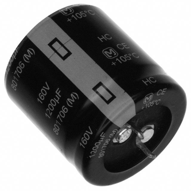

    1200 µF 160 V 铝电解电容器 径向,Can - 卡入式 166 毫欧 @ 120Hz 105°C 时为 2000 小时
EET-HC2C122KA 数据手册
Aluminum Electrolytic Capacitors TS-HC Series 105°C, 2000 hours  Long life with high capacitance (30% smaller than HB series)  2 and 3 pin versions available  RoHS compliant PVC and RoHS compliant PET sleeve options RoHS Compliant 10 ~ 250 VDC -40 ~ +105°C 270 ~ 100000µF Rated Working Voltage: Operating Temperature: Nominal Capacitance: Capacitance Tolerance: Dissipation Factor: (120 Hz, +20°C) 350 ~ 450 VDC -25 ~ +105°C 100 ~ 1000µF ± 20% Working Voltage [V]: Max. D.F. (%): 10 55 16 45 25 35 35 30 50 25 63 20 80 17 100 ~ 450 15 (rated cap. [µF] - 33000 ) 1000 For capacitance values > 33000µF, add the value of: 3¥CV (µA) max. after 5 minutes; C = Capacitance in µF, V = WV Leakage Current: Ripple Current Multipliers: Frequency(Hz): 16~100WV: 160~450WV: 50 0.93 0.75 60 0.95 0.8 100~120 1.0 1.0 500 1.05 1.2 1k 1.08 1.25 10k 1.15 1.4 Ripple Current Ambient Temperature Factors* Temperature (°C): 105°C 85°C 70°C 60°C Multiplier: 1.0 1.7 2.0 2.2 2000 hours at +105°C with maximum specified ripple current (see page 4) Endurance: *Use of temperature ripple current multipliers may limit life to the hours specified for the maximum operating temperature. Part Number System E T H Common Code 1A 10 1C 16 1E 25 C Series Code 1V 35 1H 50 1J 63 Sleeving Options: See Part Number listings Capacitance Code Voltage Code 1K 2A 2C 2D 2E 2V 2G 2S 2W 80 100 160 200 250 350 400 420 450 # of pins: pin length "T": 22mm 25mm 30mm 35mm Diameter E Diameter / Terminal Code 2 3 4.0±0.5mm 4.0±0.5mm H P J Q K R L S 2 6.3±1mm B C D E Dimensions in millimeters Circuit Board Mounting Holes 10.0±0.1 2 Pin Mounting Style L+2 max. 2 x Ø2.0±0.1 D+1 max. T Circuit Board Mounting Holes 10.0±0.1 Ø2.0±0.1 3 Pin Mounting Style 4.75±0.1 3.3±0.1 L+2 max. T D+1 max. Pin Dimensions Ø2.5 min. Ø2.0±0.1 +0.2 2.0 max. 2.0 max. 0.8 -0.1 +0.2 0.8 -0.1 Top of Capacitor Body 3.5 4.0 4.0±0.5 6.3±1.0 1.5±0.2 1.5±0.2 4mm Length: Standard on 2 and 3 Pin Mounting Styles 6.3mm Length: Available on 2 Pin Mounting Style Only 31 ”45°C 2.35 Aluminum Electrolytic Capacitors TS-HC Standard Ratings Cap. (µF) 12000 18000 22000 27000 33000 39000 47000 56000 68000 82000 100000 10000 12000 15000 18000 22000 27000 33000 39000 47000 56000 6800 8200 10000 12000 15000 18000 22000 27000 Size (mm) DxL 22 22 25 22 25 22 25 30 22 25 25 30 35 25 30 35 30 35 30 35 35 35 x x x x x x x x x x x x x x x x x x x x x x 25 30 25 35 30 40 35 25 45 40 45 30 25 50 35 30 40 35 45 40 45 50 22 22 25 22 22 25 22 25 30 22 25 30 35 25 30 35 30 35 30 35 30 35 x x x x x x x x x x x x x x x x x x x x x x 25 30 25 35 40 30 45 35 25 50 40 30 25 45 35 30 40 35 45 40 50 45 22 22 25 22 22 25 22 25 30 22 25 30 35 25 30 35 30 x x x x x x x x x x x x x x x x x 25 30 25 35 40 30 45 35 25 50 40 30 25 45 35 30 40 Max 105°C R.C. (Arms) 20°C ESR (Ȏ, max.) 120Hz 10kHz~ 120Hz 20kHz 10 VDC Working, 13 VDC Surge 2.20 2.53 0.076 0.065 2.40 2.76 0.051 0.043 2.40 2.76 0.051 0.043 2.60 2.99 0.041 0.035 2.60 2.99 0.041 0.035 3.10 3.57 0.034 0.029 3.10 3.57 0.034 0.029 3.10 3.57 0.034 0.029 3.40 3.91 0.028 0.023 3.40 3.91 0.028 0.023 3.70 4.26 0.026 0.022 3.70 4.26 0.026 0.023 3.70 4.26 0.026 0.022 4.20 4.83 0.024 0.021 4.20 4.83 0.024 0.022 4.20 4.83 0.024 0.021 5.00 5.75 0.023 0.021 5.00 5.75 0.023 0.020 5.40 6.21 0.022 0.020 5.40 6.21 0.022 0.019 6.10 7.02 0.021 0.019 6.90 7.94 0.020 0.019 16 VDC Working, 20 VDC Surge 2.60 2.99 0.075 0.063 2.90 3.34 0.062 0.053 2.90 3.34 0.062 0.053 3.20 3.68 0.050 0.042 3.50 4.03 0.041 0.035 3.50 4.03 0.041 0.035 3.80 4.37 0.034 0.029 3.80 4.37 0.034 0.029 3.80 4.37 0.034 0.029 4.20 4.83 0.028 0.023 4.20 4.83 0.028 0.023 4.20 4.83 0.028 0.023 4.20 4.83 0.028 0.023 4.70 5.41 0.023 0.019 4.70 5.41 0.023 0.019 4.70 5.41 0.023 0.020 5.10 5.87 0.022 0.018 5.10 5.87 0.022 0.020 5.50 6.33 0.016 0.014 5.50 6.33 0.021 0.019 6.00 6.90 0.020 0.018 6.00 6.90 0.020 0.018 25 VDC Working, 32 VDC Surge 2.40 2.76 0.085 0.064 2.70 3.11 0.071 0.053 2.70 3.11 0.071 0.053 3.00 3.45 0.058 0.044 3.20 3.68 0.048 0.036 3.20 3.68 0.048 0.036 3.60 4.14 0.039 0.029 3.60 4.14 0.039 0.029 3.60 4.14 0.039 0.029 3.90 4.49 0.032 0.024 3.90 4.49 0.032 0.024 3.90 4.49 0.032 0.024 3.90 4.49 0.032 0.024 4.30 4.95 0.026 0.020 4.30 4.95 0.026 0.020 4.30 4.95 0.026 0.020 4.80 5.52 0.021 0.016 32 Part numbers shown with 2 pins and 4.0mm length terminals Panasonic Part Number (By Sleeving Style) PVC with Top Plate PET without Top Plate EETHC1A123HA EETHC1A183HA EETHC1A183JA EETHC1A223HA EETHC1A223JA EETHC1A273HA EETHC1A273JA EETHC1A273KA EETHC1A333HA EETHC1A333JA EETHC1A393JA EETHC1A393KA EETHC1A393LA EETHC1A473JA EETHC1A473KA EETHC1A473LA EETHC1A563KA EETHC1A563LA EETHC1A683KA EETHC1A683LA EETHC1A823LA EETHC1A104LA EETHC1A123HJ EETHC1A183HJ EETHC1A183JJ EETHC1A223HJ EETHC1A223JJ EETHC1A273HJ EETHC1A273JJ EETHC1A273KJ EETHC1A333HJ EETHC1A333JJ EETHC1A393JJ EETHC1A393KJ EETHC1A393LJ EETHC1A473JJ EETHC1A473KJ EETHC1A473LJ EETHC1A563KJ EETHC1A563LJ EETHC1A683KJ EETHC1A683LJ EETHC1A823LJ EETHC1A104LJ EETHC1C103HA EETHC1C123HA EETHC1C123JA EETHC1C153HA EETHC1C183HA EETHC1C183JA EETHC1C223HA EETHC1C223JA EETHC1C223KA EETHC1C273HA EETHC1C273JA EETHC1C273KA EETHC1C273LA EETHC1C333JA EETHC1C333KA EETHC1C333LA EETHC1C393KA EETHC1C393LA EETHC1C473KA EETHC1C473LA EETHC1C563KA EETHC1C563LA EETHC1C103HJ EETHC1C123HJ EETHC1C123JJ EETHC1C153HJ EETHC1C183HJ EETHC1C183JJ EETHC1C223HJ EETHC1C223JJ EETHC1C223KJ EETHC1C273HJ EETHC1C273JJ EETHC1C273KJ EETHC1C273LJ EETHC1C333JJ EETHC1C333KJ EETHC1C333LJ EETHC1C393KJ EETHC1C393LJ EETHC1C473KJ EETHC1C473LJ EETHC1C563KJ EETHC1C563LJ EETHC1E682HA EETHC1E822HA EETHC1E822JA EETHC1E103HA EETHC1E123HA EETHC1E123JA EETHC1E153HA EETHC1E153JA EETHC1E153KA EETHC1E183HA EETHC1E183JA EETHC1E183KA EETHC1E183LA EETHC1E223JA EETHC1E223KA EETHC1E223LA EETHC1E273KA EETHC1E682HJ EETHC1E822HJ EETHC1E822JJ EETHC1E103HJ EETHC1E123HJ EETHC1E123JJ EETHC1E153HJ EETHC1E153JJ EETHC1E153KJ EETHC1E183HJ EETHC1E183JJ EETHC1E183KJ EETHC1E183LJ EETHC1E223JJ EETHC1E223KJ EETHC1E223LJ EETHC1E273KJ Aluminum Electrolytic Capacitors TS-HC Standard Ratings (continued) Cap. (µF) 27000 33000 39000 47000 4700 5600 6800 8200 10000 12000 15000 18000 22000 27000 33000 2700 3300 3900 4700 5600 6800 8200 10000 12000 15000 18000 2200 2700 3300 3900 4700 5600 Size (mm) DxL 35 30 35 30 35 35 x x x x x x 35 45 40 50 45 50 22 22 25 22 22 25 22 25 30 25 30 35 25 30 35 30 35 30 35 30 35 35 x x x x x x x x x x x x x x x x x x x x x x 25 30 25 35 40 30 45 35 25 40 30 25 45 35 30 40 35 45 40 50 45 50 22 22 22 25 22 25 22 25 30 22 25 30 35 25 30 25 30 35 30 35 30 35 35 x x x x x x x x x x x x x x x x x x x x x x x 25 30 35 25 40 30 45 35 25 50 40 30 25 45 35 50 40 30 45 35 50 40 45 22 22 25 22 22 25 30 22 25 22 x x x x x x x x x x 25 30 25 35 40 30 25 45 35 50 Part numbers shown with 2 pins and 4.0mm length terminals Max 105°C R.C. (Arms) 20°C ESR (ȍ, max.) Panasonic Part Number (By Sleeving Style) PVC with Top Plate 120Hz 10kHz~ 120Hz 20kHz PET without Top Plate 25 VDC Working, 32 VDC Surge (continued) EETHC1E273LA EETHC1E273LJ 4.80 5.52 0.021 0.016 EETHC1E333KA EETHC1E333KJ 5.50 6.33 0.018 0.013 EETHC1E333LJ EETHC1E333LA 5.50 6.33 0.018 0.014 EETHC1E393KA EETHC1E393KJ 5.80 6.67 0.017 0.013 EETHC1E393LA EETHC1E393LJ 5.80 6.67 0.017 0.014 EETHC1E473LA EETHC1E473LJ 6.30 7.25 0.017 0.014 35 VDC Working, 44 VDC Surge EETHC1V472HA EETHC1V472HJ 2.20 2.53 0.106 0.079 EETHC1V562HA EETHC1V562HJ 2.40 2.76 0.089 0.067 EETHC1V562JJ EETHC1V562JA 2.40 2.76 0.089 0.067 EETHC1V682HJ EETHC1V682HA 2.60 2.99 0.073 0.055 EETHC1V822HJ EETHC1V822HA 2.90 3.34 0.061 0.045 EETHC1V822JJ EETHC1V822JA 2.90 3.34 0.061 0.045 EETHC1V103HJ EETHC1V103HA 3.20 3.68 0.050 0.037 EETHC1V103JJ EETHC1V103JA 3.20 3.68 0.050 0.037 EETHC1V103KA EETHC1V103KJ 3.20 3.68 0.050 0.037 EETHC1V123JA EETHC1V123JJ 3.50 4.03 0.041 0.031 EETHC1V123KJ EETHC1V123KA 3.50 4.03 0.041 0.031 EETHC1V123LA EETHC1V123LJ 3.50 4.03 0.041 0.031 EETHC1V153JA EETHC1V153JJ 3.90 4.49 0.033 0.025 EETHC1V153KA EETHC1V153KJ 3.90 4.49 0.033 0.025 EETHC1V153LA EETHC1V153LJ 3.90 4.49 0.033 0.025 EETHC1V183KA EETHC1V183KJ 4.30 4.95 0.028 0.021 EETHC1V183LJ EETHC1V183LA 4.30 4.95 0.028 0.021 EETHC1V223KJ EETHC1V223KA 5.00 5.75 0.023 0.017 EETHC1V223LJ EETHC1V223LA 5.00 5.75 0.023 0.017 EETHC1V273KJ EETHC1V273KA 5.30 6.10 0.018 0.014 EETHC1V273LJ EETHC1V273LA 5.30 6.10 0.018 0.014 EETHC1V333LA EETHC1V333LJ 5.90 6.79 0.015 0.012 50 VDC Working, 63 VDC Surge EETHC1H272HA EETHC1H272HJ 1.80 2.07 0.154 0.115 EETHC1H332HJ EETHC1H332HA 2.00 2.30 0.126 0.094 EETHC1H392HJ EETHC1H392HA 2.20 2.53 0.106 0.080 EETHC1H392JJ EETHC1H392JA 2.20 2.53 0.106 0.080 EETHC1H472HA EETHC1H472HJ 2.50 2.88 0.088 0.066 EETHC1H472JA EETHC1H472JJ 2.50 2.88 0.088 0.066 EETHC1H562HJ EETHC1H562HA 2.80 3.22 0.074 0.056 EETHC1H562JJ EETHC1H562JA 2.80 3.22 0.074 0.056 EETHC1H562KA EETHC1H562KJ 2.80 3.22 0.074 0.056 EETHC1H682HA EETHC1H682HJ 3.30 3.80 0.061 0.046 EETHC1H682JA EETHC1H682JA 3.30 3.80 0.061 0.046 EETHC1H682KA EETHC1H682KJ 3.30 3.80 0.061 0.046 EETHC1H682LA EETHC1H682LJ 3.30 3.80 0.061 0.046 EETHC1H822JA EETHC1H822JJ 3.60 4.14 0.051 0.038 EETHC1H822KA EETHC1H822KJ 3.60 4.14 0.051 0.038 EETHC1H103JA EETHC1H103JJ 4.00 4.60 0.041 0.031 EETHC1H103KA EETHC1H103KJ 4.00 4.60 0.041 0.031 EETHC1H103LA EETHC1H103LJ 4.00 4.60 0.041 0.031 EETHC1H123KA EETHC1H123KJ 4.50 5.18 0.035 0.026 EETHC1H123LA EETHC1H123LJ 4.50 5.18 0.035 0.028 EETHC1H153KA EETHC1H153KJ 4.80 5.52 0.028 0.021 EETHC1H153LA EETHC1H153LJ 4.80 5.52 0.028 0.022 EETHC1H183LA EETHC1H183LJ 5.60 6.44 0.023 0.018 63 VDC Working, 79 VDC Surge EETHC1J222HA EETHC1J222HJ 2.00 2.30 0.151 0.113 EETHC1J272HA EETHC1J272HJ 2.20 2.53 0.123 0.092 EETHC1J272JA EETHC1J272JJ 2.20 2.53 0.123 0.092 EETHC1J332HA EETHC1J332HJ 2.50 2.88 0.100 0.075 EETHC1J392HA EETHC1J392HJ 2.70 3.11 0.085 0.064 EETHC1J392JA EETHC1J392JJ 2.70 3.11 0.085 0.064 EETHC1J392KA EETHC1J392KJ 2.70 3.11 0.085 0.064 EETHC1J472HJ EETHC1J472HA 3.00 3.45 0.071 0.053 EETHC1J472JA EETHC1J472JJ 3.00 3.45 0.071 0.053 EETHC1J562HA EETHC1J562HJ 3.30 3.80 0.059 0.044 33 Aluminum Electrolytic Capacitors TS-HC Standard Ratings (continued) Cap. (µF) Size (mm) DxL 5600 25 30 35 25 30 35 30 35 30 35 30 35 35 x x x x x x x x x x x x x 40 30 25 45 35 30 40 35 45 40 50 45 50 22 22 25 22 22 25 22 25 30 22 25 30 35 25 30 25 30 35 30 35 30 35 35 x x x x x x x x x x x x x x x x x x x x x x x 25 30 25 35 40 30 45 35 25 50 40 30 25 45 35 50 40 30 45 35 50 40 45 5600 6800 22 22 25 22 25 22 25 30 22 25 30 35 25 30 25 30 35 30 35 30 35 35 35 x x x x x x x x x x x x x x x x x x x x x x x 25 30 25 35 30 40 35 25 45 40 30 25 45 35 50 40 30 45 35 50 40 45 50 470 22 x 25 6800 8200 10000 12000 15000 1200 1500 1800 2200 2700 3300 3900 4700 5600 6800 8200 820 1200 1500 1800 2200 2700 3300 3900 4700 Part numbers shown with 2 pins and 4.0mm length terminals Max 105°C R.C. (Arms) 20°C ESR (ȍ, max.) Panasonic Part Number (By Sleeving Style) PVC with Top Plate 120Hz 10kHz~ 120Hz 20kHz PET without Top Plate 63 VDC Working, 79 VDC Surge (continued) EETHC1J562JJ EETHC1J562JA 3.30 3.80 0.059 0.044 EETHC1J562KA EETHC1J562KJ 3.30 3.80 0.059 0.044 EETHC1J562LA EETHC1J562LJ 3.30 3.80 0.059 0.044 EETHC1J682JJ EETHC1J682JA 3.60 4.14 0.049 0.037 EETHC1J682KA EETHC1J682KJ 3.60 4.14 0.049 0.037 EETHC1J682LA EETHC1J682LJ 3.60 4.14 0.049 0.037 EETHC1J822KA EETHC1J822KJ 3.90 4.49 0.040 0.030 EETHC1J822LA EETHC1J822LJ 3.90 4.49 0.040 0.030 EETHC1J103KA EETHC1J103KJ 4.40 5.06 0.033 0.025 EETHC1J103LA EETHC1J103LJ 4.40 5.06 0.033 0.025 EETHC1J123KA EETHC1J123KJ 4.80 5.52 0.028 0.021 EETHC1J123LA EETHC1J123LJ 4.80 5.52 0.028 0.022 EETHC1J153LA EETHC1J153LJ 5.40 6.21 0.022 0.018 80 VDC Working, 100 VDC Surge EETHC1K122HJ EETHC1K122HA 1.50 1.73 0.235 0.176 EETHC1K152HA EETHC1K152HJ 1.70 1.96 0.188 0.141 EETHC1K152JJ EETHC1K152JA 1.70 1.96 0.188 0.141 EETHC1K182HJ EETHC1K182HA 1.80 2.07 0.157 0.117 EETHC1K222HA EETHC1K222HJ 2.10 2.42 0.128 0.096 EETHC1K222JJ EETHC1K222JA 2.10 2.42 0.128 0.096 EETHC1K272HA EETHC1K272HJ 2.40 2.76 0.104 0.078 EETHC1K272JA EETHC1K272JJ 2.40 2.76 0.104 0.078 EETHC1K272KA EETHC1K272KJ 2.40 2.76 0.104 0.078 EETHC1K332HJ EETHC1K332HA 2.60 2.99 0.085 0.064 EETHC1K332JJ EETHC1K332JA 2.60 2.99 0.085 0.064 EETHC1K332KJ EETHC1K332KA 2.60 2.99 0.085 0.064 EETHC1K332LJ EETHC1K332LA 2.60 2.99 0.085 0.064 EETHC1K392JJ EETHC1K392JA 3.00 3.45 0.072 0.054 EETHC1K392KJ EETHC1K392KA 3.00 3.45 0.072 0.054 EETHC1K472JJ EETHC1K472JA 3.30 3.80 0.060 0.045 EETHC1K472KJ EETHC1K472KA 3.30 3.80 0.060 0.045 EETHC1K472LJ EETHC1K472LA 3.30 3.80 0.060 0.045 EETHC1K562KJ EETHC1K562KA 3.70 4.26 0.050 0.038 EETHC1K562LJ EETHC1K562LA 3.70 4.26 0.050 0.038 EETHC1K682KJ EETHC1K682KA 3.90 4.49 0.041 0.031 EETHC1K682LJ EETHC1K682LA 3.90 4.49 0.041 0.032 EETHC1K822LJ EETHC1K822LA 4.50 5.18 0.034 0.027 100 VDC Working, 125 VDC Surge EETHC2A821HJ EETHC2A821HA 1.40 1.61 0.303 0.197 EETHC2A122HA EETHC2A122HJ 1.80 2.07 0.207 0.135 EETHC2A122JA EETHC2A122JJ 1.80 2.07 0.207 0.135 EETHC2A152HJ EETHC2A152HA 2.10 2.42 0.166 0.108 EETHC2A152JJ EETHC2A152JA 2.10 2.42 0.166 0.108 EETHC2A182HJ EETHC2A182HA 2.30 2.65 0.138 0.090 EETHC2A182JJ EETHC2A182JA 2.30 2.65 0.138 0.090 EETHC2A182KJ EETHC2A182KA 2.30 2.65 0.138 0.090 EETHC2A222HJ EETHC2A222HA 2.60 2.99 0.113 0.073 EETHC2A222JJ EETHC2A222JA 2.60 2.99 0.113 0.073 EETHC2A222KA EETHC2A222KJ 2.60 2.99 0.113 0.073 EETHC2A222LA EETHC2A222LJ 2.60 2.99 0.113 0.073 EETHC2A272JA EETHC2A272JJ 2.90 3.34 0.092 0.060 EETHC2A272KA EETHC2A272KJ 2.90 3.34 0.092 0.060 EETHC2A332JJ EETHC2A332JA 3.20 3.68 0.075 0.049 EETHC2A332KJ EETHC2A332KA 3.20 3.68 0.075 0.049 EETHC2A332LJ EETHC2A332LA 3.20 3.68 0.075 0.049 EETHC2A392KA EETHC2A392KJ 3.60 4.14 0.064 0.043 EETHC2A392LA EETHC2A392LJ 3.60 4.14 0.064 0.043 EETHC2A472KA EETHC2A472KJ 3.80 4.37 0.053 0.038 EETHC2A472LJ EETHC2A472LA 3.80 4.37 0.053 0.037 EETHC2A562LA EETHC2A562LJ 4.20 4.83 0.044 0.031 EETHC2A682LA EETHC2A682LJ 4.70 5.41 0.037 0.027 160 VDC Working, 200 VDC Surge EETHC2C471HA EETHC2C471HJ 1.40 1.96 0.423 0.190 34 Aluminum Electrolytic Capacitors TS-HC Standard Ratings (continued) Cap. (µF) Size (mm) DxL 560 680 22 22 25 22 25 22 25 30 22 25 30 35 25 30 35 25 30 35 30 35 30 35 35 x x x x x x x x x x x x x x x x x x x x x x x 30 30 25 35 30 40 35 25 45 40 30 25 45 35 30 50 40 30 45 35 50 40 50 22 22 25 22 22 25 22 25 30 22 25 25 30 35 25 25 30 35 30 35 30 35 30 35 x x x x x x x x x x x x x x x x x x x x x x x x 25 30 25 30 40 30 45 35 25 50 40 45 30 25 45 50 35 30 40 30 45 40 50 45 22 22 25 22 22 25 22 22 25 30 22 22 25 30 x x x x x x x x x x x x x x 25 30 25 30 35 25 35 40 30 25 40 45 35 25 820 1000 1000 1200 1500 1800 2200 2700 3300 390 470 560 680 820 1000 1200 1500 1800 2200 270 330 390 470 560 Part numbers shown with 2 pins and 4.0mm length terminals Max 105°C R.C. (Arms) 20°C ESR (ȍ, max.) Panasonic Part Number (By Sleeving Style) PET sleeve without Top Plate PVC sleeve with Top Plate 120Hz 10kHz~ 120Hz 20kHz 160 VDC Working, 200 VDC Surge (continued) EETHC2C561HA EETHC2C561HJ 1.50 2.10 0.355 0.160 EETHC2C681HA EETHC2C681HJ 1.70 2.38 0.293 0.132 EETHC2C681JA EETHC2C681JJ 1.70 2.38 0.293 0.132 EETHC2C821HA EETHC2C821HJ 2.00 2.80 0.243 0.109 EETHC2C821JA EETHC2C821JJ 2.00 2.80 0.243 0.109 EETHC2C102HA EETHC2C102HJ 2.20 3.08 0.199 0.090 EETHC2C102JA EETHC2C102JJ 2.20 3.08 0.199 0.090 EETHC2C102KA EETHC2C102KJ 2.20 3.08 0.216 0.108 EETHC2C122HA EETHC2C122HJ 2.30 3.22 0.166 0.075 EETHC2C122JA EETHC2C122JJ 2.30 3.22 0.166 0.075 EETHC2C122KA EETHC2C122KJ 2.30 3.22 0.166 0.075 EETHC2C122LA EETHC2C122LJ 2.30 3.22 0.180 0.090 EETHC2C152JA EETHC2C152JJ 2.50 3.50 0.133 0.060 EETHC2C152KA EETHC2C152KJ 2.50 3.50 0.133 0.060 EETHC2C152LA EETHC2C152LJ 2.50 3.50 0.155 0.077 EETHC2C182JA EETHC2C182JJ 2.70 3.78 0.111 0.050 EETHC2C182KA EETHC2C182KJ 2.70 3.78 0.111 0.050 EETHC2C182LA EETHC2C182LJ 2.70 3.78 0.120 0.060 EETHC2C222KA EETHC2C222KJ 2.90 4.06 0.090 0.041 EETHC2C222LJ EETHC2C222LA 2.90 4.06 0.098 0.049 EETHC2C272KJ EETHC2C272KA 3.10 4.34 0.080 0.040 EETHC2C272LJ EETHC2C272LA 3.10 4.34 0.086 0.043 EETHC2C332LJ EETHC2C332LA 3.30 4.62 0.070 0.042 200 VDC Working, 250 VDC Surge EETHC2D391HJ EETHC2D391HA 1.31 1.83 0.510 0.230 EETHC2D471HJ EETHC2D471HA 1.45 2.03 0.423 0.190 EETHC2D471JF EETHC2D471JC 1.45 2.03 0.423 0.190 EETHC2D561HJ EETHC2D561HA 1.67 2.34 0.355 0.160 EETHC2D681HJ EETHC2D681HA 1.75 2.45 0.293 0.132 EETHC2D681JJ EETHC2D681JA 1.75 2.45 0.293 0.132 EETHC2D821HJ EETHC2D821HA 2.04 2.86 0.243 0.109 EETHC2D821JJ EETHC2D821JA 2.04 2.86 0.243 0.109 EETHC2D821KJ EETHC2D821KA 2.04 2.86 0.243 0.109 EETHC2D102HJ EETHC2D102HA 2.30 3.22 0.199 0.090 EETHC2D102JC EETHC2D102JF 2.30 2.90 0.199 0.090 EETHC2D102JJ EETHC2D102JA 2.30 3.22 0.199 0.090 EETHC2D102KJ EETHC2D102KA 2.30 3.22 0.199 0.090 EETHC2D102LA EETHC2D102LA 2.30 3.22 0.216 0.097 EETHC2D122JC EETHC2D122JF 2.65 3.33 0.166 0.075 EETHC2D122JJ EETHC2D122JA 2.65 3.71 0.166 0.075 EETHC2D122KJ EETHC2D122KA 2.65 3.71 0.166 0.075 EETHC2D122LA EETHC2D122LA 2.65 3.71 0.180 0.090 EETHC2D152KJ EETHC2D152KA 2.80 3.92 0.133 0.060 EETHC2D152LA EETHC2D152LA 2.80 3.92 0.144 0.072 EETHC2D182KJ EETHC2D182KA 3.08 4.31 0.111 0.050 EETHC2D182LA EETHC2D182LA 3.08 4.31 0.129 0.064 EETHC2D222KJ EETHC2D222KA 3.48 4.87 0.090 0.041 EETHC2D222LA EETHC2D222LA 3.48 4.87 0.098 0.044 250 VDC Working, 300 VDC Surge EETHC2E271HJ EETHC2E271HA 1.10 1.54 0.614 0.276 EETHC2E331HJ EETHC2E331HA 1.20 1.68 0.502 0.226 EETHC2E331JA EETHC2E331JJ 1.20 1.68 0.502 0.226 EETHC2E391HC EETHC2E391HF 1.20 1.68 0.425 0.191 EETHC2E391HJ EETHC2E391HA 1.30 1.82 0.425 0.191 EETHC2E391JJ EETHC2E391JA 1.30 1.82 0.425 0.191 EETHC2E471HC EETHC2E471HF 1.20 1.68 0.353 0.159 EETHC2E471HA EETHC2E471HJ 1.40 1.96 0.353 0.159 EETHC2E471JJ EETHC2E471JA 1.40 1.96 0.353 0.159 EETHC2E471KJ EETHC2E471KA 1.40 1.96 0.353 0.159 EETHC2E561HC EETHC2E561HF 1.40 1.96 0.296 0.133 EETHC2E561HJ EETHC2E561HA 1.50 2.10 0.296 0.133 EETHC2E561JJ EETHC2E561JA 1.50 2.10 0.296 0.133 EETHC2E561KA EETHC2E561KJ 1.50 2.10 0.296 0.133 35 Aluminum Electrolytic Capacitors TS-HC Standard Ratings (continued) Cap. (µF) Size (mm) DxL 680 22 22 25 30 35 25 30 35 25 30 35 30 35 35 35 35 x x x x x x x x x x x x x x x x 45 50 40 30 25 45 35 30 50 40 30 45 35 45 45 50 22 22 22 25 22 25 22 25 30 22 25 30 25 30 30 25 30 35 30 30 35 30 30 35 35 35 x x x x x x x x x x x x x x x x x x x x x x x x x x 25 30 30 25 35 30 40 35 25 45 40 30 45 30 35 50 35 30 40 45 35 45 50 40 45 50 22 22 22 25 22 25 22 22 25 30 22 22 25 30 35 25 30 30 35 x x x x x x x x x x x x x x x x x x x 25 30 30 25 35 30 40 45 35 25 45 50 40 30 25 45 30 35 30 820 1000 1200 1500 1800 120 150 180 220 270 330 390 470 560 680 820 1000 100 120 150 180 220 270 330 Part numbers shown with 2 pins and 4.0mm length terminals Max 105°C R.C. (Arms) 20°C ESR (ȍ, max.) Panasonic Part Number (By Sleeving Style) PVC with Top Plate PET without Top Plate 120Hz 10kHz~ 120Hz 20kHz 250 VDC Working, 300 VDC Surge (continued) EETHC2E681HC EETHC2E681HF 1.50 2.10 0.244 0.110 EETHC2E681HJ EETHC2E681HA 1.70 2.38 0.244 0.110 EETHC2E681JA EETHC2E681JJ 1.70 2.38 0.244 0.110 EETHC2E681KJ EETHC2E681KA 1.70 2.38 0.244 0.110 EETHC2E681LJ EETHC2E681LA 1.70 2.38 0.244 0.110 EETHC2E821JA EETHC2E821JJ 2.00 2.80 0.202 0.091 EETHC2E821KA EETHC2E821KJ 2.00 2.80 0.202 0.091 EETHC2E821LA EETHC2E821LJ 2.00 2.80 0.202 0.091 EETHC2E102JF EETHC2E102JC 2.20 3.08 0.166 0.075 EETHC2E102KJ EETHC2E102KA 2.20 3.08 0.166 0.075 EETHC2E102LJ EETHC2E102LA 2.20 3.08 0.166 0.075 EETHC2E122KJ EETHC2E122KA 2.30 3.22 0.138 0.062 EETHC2E122LJ EETHC2E122LA 2.30 3.22 0.138 0.062 EETHC2E152LA EETHC2E152LJ 2.50 3.50 0.111 0.050 EETHC2E182LC EETHC2E182LF 2.50 3.50 0.092 0.041 EETHC2E182LA EETHC2E182LJ 2.70 3.78 0.092 0.041 350 VDC Working, 400 VDC Surge EETHC2V121HA EETHC2V121HJ 0.75 1.05 1.382 0.622 EETHC2V151HJ EETHC2V151HA 0.82 1.15 1.105 0.497 EETHC2V181HJ EETHC2V181HA 0.90 1.26 0.921 0.414 EETHC2V181JA EETHC2V181JJ 0.90 1.26 0.921 0.414 EETHC2V221HA EETHC2V221HJ 1.00 1.40 0.754 0.339 EETHC2V221JA EETHC2V221JJ 1.00 1.40 0.754 0.339 EETHC2V271HF EETHC2V271HC 1.10 1.54 0.614 0.276 EETHC2V271JA EETHC2V271JJ 1.10 1.54 0.614 0.276 EETHC2V271KJ EETHC2V271KA 1.10 1.54 0.614 0.276 EETHC2V331HF EETHC2V331HC 1.20 1.68 0.502 0.226 EETHC2V331JJ EETHC2V331JA 1.20 1.68 0.502 0.226 EETHC2V331KA EETHC2V331KJ 1.20 1.68 0.502 0.226 EETHC2V391JA EETHC2V391JJ 1.30 1.82 0.425 0.191 EETHC2V391KF EETHC2V391KC 1.30 1.82 0.425 0.191 EETHC2V391KJ EETHC2V391KA 1.30 1.82 0.425 0.191 EETHC2V471JJ EETHC2V471JA 1.40 1.96 0.353 0.159 EETHC2V471KF EETHC2V471KC 1.40 1.96 0.353 0.159 EETHC2V471LJ EETHC2V471LA 1.40 1.96 0.353 0.159 EETHC2V561KF EETHC2V561KC 1.50 2.10 0.296 0.133 EETHC2V561KJ EETHC2V561KA 1.50 2.10 0.296 0.133 EETHC2V561LJ EETHC2V561LA 1.50 2.10 0.296 0.133 EETHC2V681KF EETHC2V681KC 1.70 2.38 0.244 0.110 EETHC2V681KJ EETHC2V681KA 1.70 2.38 0.244 0.110 EETHC2V681LA EETHC2V681LJ 1.70 2.38 0.244 0.110 EETHC2V821LA EETHC2V821LJ 1.90 2.66 0.202 0.091 EETHC2V102LC EETHC2V102LF 1.90 2.66 0.202 0.091 400 VDC Working, 450 VDC Surge EETHC2G101HA EETHC2G101HJ 0.70 0.98 1.824 0.821 EETHC2G121HJ EETHC2G121HA 0.75 1.05 1.520 0.684 EETHC2G151HJ EETHC2G151HA 0.88 1.23 1.216 0.547 EETHC2G151JC EETHC2G151JF 0.88 1.23 1.216 0.547 EETHC2G181HJ EETHC2G181HA 0.95 1.33 1.013 0.456 EETHC2G181JJ EETHC2G181JA 0.95 1.33 1.013 0.456 EETHC2G221HC EETHC2G221HF 1.00 1.40 0.829 0.373 EETHC2G221HJ EETHC2G221HA 1.10 1.54 0.829 0.373 EETHC2G221JJ EETHC2G221JA 1.10 1.54 0.829 0.373 EETHC2G221KJ EETHC2G221KA 1.10 1.54 0.829 0.373 EETHC2G271HC EETHC2G271HF 1.10 1.54 0.675 0.304 EETHC2G271HJ EETHC2G271HA 1.22 1.71 0.675 0.304 EETHC2G271JJ EETHC2G271JA 1.22 1.71 0.675 0.304 EETHC2G271KJ EETHC2G271KA 1.22 1.71 0.675 0.304 EETHC2G271LA EETHC2G271LJ 1.22 1.71 0.675 0.304 EETHC2G331JJ EETHC2G331JA 1.44 2.02 0.553 0.249 EETHC2G331KC EETHC2G331KF 1.44 2.02 0.553 0.249 EETHC2G331KJ EETHC2G331KA 1.44 2.02 0.553 0.249 EETHC2G331LJ EETHC2G331LA 1.44 2.02 0.553 0.249 36 Aluminum Electrolytic Capacitors TS-HC Standard Ratings (continued) Cap. (µF) Size (mm) DxL 390 25 30 30 35 30 35 30 30 35 35 35 x x x x x x x x x x x 50 35 40 30 45 35 45 50 40 45 50 22 25 22 22 25 22 25 30 22 25 30 35 25 30 35 30 35 30 35 30 35 35 x x x x x x x x x x x x x x x x x x x x x x 30 25 35 40 30 45 35 25 50 40 30 25 50 35 35 40 35 45 35 50 45 50 22 25 22 25 22 22 25 30 22 25 25 30 30 22 25 25 30 35 25 25 30 30 35 25 30 30 35 35 x x x x x x x x x x x x x x x x x x x x x x x x x x x x 30 25 35 30 35 40 30 25 45 35 40 25 30 50 40 45 30 25 45 50 35 40 30 50 40 45 30 35 470 560 680 820 120 150 180 220 270 330 330 390 470 560 680 100 120 150 180 220 270 330 Part numbers shown with 2 pins and 4.0mm length terminals Max 85°C R.C. (Arms) 20°C ESR (ȍ, max.) Panasonic Part Number (By Sleeving Style) PVC with Top Plate PET without Top Plate 120Hz 10kHz~ 120Hz 20kHz 400 VDC Working, 450 VDC Surge (continued) EETHC2G391JA EETHC2G391JJ 1.55 2.17 0.468 0.210 EETHC2G391KF EETHC2G391KC 1.40 1.96 0.468 0.210 EETHC2G391KA EETHC2G391KJ 1.55 2.17 0.468 0.210 EETHC2G391LJ EETHC2G391LA 1.55 2.17 0.468 0.210 EETHC2G471KA EETHC2G471KJ 1.68 2.35 0.388 0.175 EETHC2G471LA EETHC2G471LJ 1.68 2.35 0.388 0.175 EETHC2G561KF EETHC2G561KC 1.90 2.66 0.326 0.147 EETHC2G561KA EETHC2G561KJ 1.90 2.66 0.326 0.147 EETHC2G561LA EETHC2G561LJ 1.90 2.66 0.326 0.147 EETHC2G681LA EETHC2G681LJ 2.12 2.97 0.268 0.121 EETHC2G821LA EETHC2G821LJ 2.30 3.22 0.202 0.091 420 VDC Working, 470 VDC Surge 0.74 1.04 1.520 0.684 EETHC2S121HJ EETHC2S121HA EETHC2S121JA 0.74 1.04 1.520 0.684 EETHC2S121JJ 0.84 1.18 1.216 0.547 EETHC2S151HJ EETHC2S151HA 0.91 1.27 1.103 0.456 EETHC2S181HA EETHC2S181HJ 0.91 1.27 1.103 0.456 EETHC2S181JA EETHC2S181JJ 1.05 1.47 0.829 0.373 EETHC2S221HA EETHC2S221HJ 1.05 1.47 0.829 0.373 EETHC2S221JJ EETHC2S221JA 1.05 1.47 0.829 0.373 EETHC2S221KJ EETHC2S221KA 1.20 1.68 0.675 0.304 EETHC2S271HJ EETHC2S271HA 1.20 1.68 0.675 0.304 EETHC2S271JJ EETHC2S271JA 1.20 1.68 0.675 0.304 EETHC2S271KJ EETHC2S271KA 1.20 1.68 0.675 0.304 EETHC2S271LA EETHC2S271LJ 1.42 1.99 0.553 0.249 EETHC2S331JA EETHC2S331JJ 1.42 1.99 0.553 0.249 EETHC2S331KA EETHC2S331KJ 1.42 1.99 0.553 0.249 EETHC2S331LJ EETHC2S331LA 1.55 2.17 0.468 0.210 EETHC2S391KA EETHC2S391KJ 1.55 2.17 0.468 0.210 EETHC2S391LA EETHC2S391LJ 1.71 2.39 0.388 0.175 EETHC2S471KA EETHC2S471KJ 1.71 2.39 0.388 0.175 EETHC2S471LA EETHC2S471LJ 1.90 2.66 0.326 0.147 EETHC2S561KJ EETHC2S561KA 1.90 2.66 0.326 0.147 EETHC2S561LJ EETHC2S561LA 2.10 2.94 0.268 0.121 EETHC2S681LJ EETHC2S681LA 450 VDC Working, 500 VDC Surge EETHC2W101HA EETHC2W101HJ 0.64 0.90 1.824 0.821 EETHC2W101JA EETHC2W101JJ 0.64 0.90 1.824 0.821 EETHC2W121HJ EETHC2W121HA 0.72 1.01 1.520 0.684 EETHC2W121JJ EETHC2W121JA 0.72 1.01 1.520 0.684 EETHC2W151HF EETHC2W151HC 0.79 1.11 1.216 0.547 EETHC2W151HA EETHC2W151HJ 0.79 1.11 1.216 0.547 EETHC2W151JJ EETHC2W151JA 0.79 1.11 1.216 0.547 EETHC2W151KJ EETHC2W151KA 0.79 1.11 1.216 0.547 EETHC2W181HJ EETHC2W181HA 0.87 1.22 1.013 0.456 EETHC2W181JC EETHC2W181JF 0.87 1.22 1.013 0.456 EETHC2W181JJ EETHC2W181JA 0.87 1.22 1.013 0.456 EETHC2W181KC EETHC2W181KF 0.87 1.22 1.013 0.456 EETHC2W181KJ EETHC2W181KA 0.87 1.22 1.013 0.456 EETHC2W221HJ EETHC2W221HA 1.00 1.40 0.829 0.373 EETHC2W221JF EETHC2W221JC 1.00 1.40 0.829 0.373 EETHC2W221JJ EETHC2W221JA 1.00 1.40 0.829 0.373 EETHC2W221KA EETHC2W221KJ 1.00 1.40 0.829 0.373 EETHC2W221LA EETHC2W221LJ 1.00 1.40 0.829 0.373 EETHC2W271JF EETHC2W271JC 1.19 1.67 0.675 0.304 EETHC2W271JA EETHC2W271JJ 1.19 1.67 0.675 0.304 EETHC2W271KC EETHC2W271KF 1.19 1.67 0.675 0.304 EETHC2W271KJ EETHC2W271KA 1.19 1.67 0.675 0.304 EETHC2W271LJ EETHC2W271LA 1.19 1.67 0.675 0.304 EETHC2W331JC EETHC2W331JF 1.38 1.93 0.553 0.249 EETHC2W331KF EETHC2W331KC 1.38 1.93 0.553 0.249 EETHC2W331KJ EETHC2W331KA 1.38 1.93 0.553 0.249 EETHC2W331LC EETHC2W331LF 1.38 1.93 0.553 0.249 EETHC2W331LJ EETHC2W331LA 1.38 1.93 0.553 0.249 37 Aluminum Electrolytic Capacitors TS-HC Standard Ratings (continued) Cap. (µF) Size (mm) DxL 390 30 30 35 35 30 35 35 35 470 560 x x x x x x x x 45 50 35 40 50 40 45 50 Part numbers shown with 2 pins and 4.0mm length terminals Max 105°C R.C. (Arms) 20°C ESR (ȍ, max.) Panasonic Part Number (By Sleeving Style) PVC with Top Plate PET without Top Plate 120Hz 10kHz~ 120Hz 20kHz 450 VDC Working, 500 VDC Surge (continued) EETHC2W391KF EETHC2W391KC 1.55 2.17 0.468 0.210 EETHC2W391KA EETHC2W391KJ 1.55 2.17 0.468 0.210 EETHC2W391LF EETHC2W391LC 1.55 2.17 0.468 0.210 EETHC2W391LA EETHC2W391LJ 1.55 2.17 0.468 0.210 EETHC2W471KF EETHC2W471KC 1.74 2.44 0.388 0.175 EETHC2W471LF EETHC2W471LC 1.74 2.44 0.388 0.175 EETHC2W471LA EETHC2W471LJ 1.74 2.44 0.388 0.175 EETHC2W561LA EETHC2W561LJ 1.90 2.66 0.326 0.147 38
