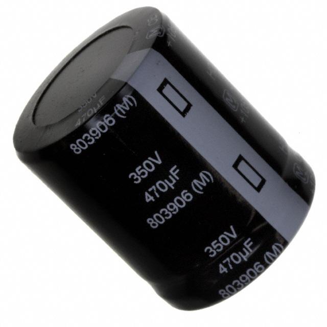

    470 µF 350 V 铝电解电容器 径向,Can - 卡入式 353 毫欧 @ 120Hz 105°C 时为 2000 小时
EET-HC2V471KF 数据手册
Large Can Aluminum Electrolytic Capacitors TS-HC Series 105°C, 2000 hours  Highly miniaturized version (30% smaller than HB series)  2 and 3 pin versions available  PET Sleeve Option Rated Working Voltage: Operating Temperature: Nominal Capacitance: Capacitance Tolerance: Dissipation Factor: (120 Hz, +20°C) 16 ~ 250 VDC -40 ~ +105°C 270 ~ 100000µF 350 ~ 450 VDC -25 ~ +105°C 100 ~ 820µF ± 20% Working Voltage [V]: Max. D.F. (%): 10 55 16 45 25 35 35 30 For capacitance values > 33000µF, add the value of: Leakage Current: Ripple Current Multipliers: 50 25 63 20 80 17 100 ~ 450 15 (rated cap. [µF] - 33000 ) 1000 3√CV (µA) max. after 5 minutes; C = Capacitance in µF, V = WV Frequency(Hz): 10~100WV: 160~450WV: Endurance: 50 0.93 0.75 60 0.95 0.8 100~120 1.0 1.0 500 1.05 1.2 1k 1.08 1.25 10k 1.15 1.4 Ripple Current Ambient Temperature Factors* Temperature (°C): 105°C 85°C 70°C 60°C Multiplier: 1.0 1.7 2.0 2.2 ≤45°C 2.35 2000 hours at +105°C with maximum specified ripple current (see page 6) *Use of temperature ripple current multipliers may limit life to the hours specified for the maximum operating temperature. Part Number System E E T C Series Code Voltage Code Sleeving Options: See Part Number listings Capacitance Code Diameter Common Code H TS-HC Standard Ratings Cap. (µF) 12000 18000 22000 27000 33000 39000 47000 56000 68000 82000 100000 Size (mm) DxL 22 22 25 22 25 22 25 30 22 25 25 30 35 25 30 35 30 35 30 35 35 35 x x x x x x x x x x x x x x x x x x x x x x 25 30 25 35 30 40 35 25 45 40 45 30 25 50 35 30 40 35 45 40 45 50 Diameter / Terminal Code # of pins: 2 2 3 pin length: 6.3mm 4.0mm 4.0mm 22mm B H P 25mm C J Q 30mm D K R 35mm E L S (Please see page 10 for details) (part numbers shown with 2 pins and 6.3mm length terminal) Max 105°C R.C. (Arms) 20°C ESR (Ω, max.) Panasonic Part Number 120Hz 10kHz~ 120Hz 20kHz 10 VDC Working, 13 VDC Surge EETHC1A123B_ 2.20 2.53 0.076 0.065 EETHC1A183B_ 2.40 2.76 0.051 0.043 EETHC1A183C_ 2.40 2.76 0.051 0.043 EETHC1A223B_ 2.60 2.99 0.041 0.035 EETHC1A223C_ 2.60 2.99 0.041 0.035 EETHC1A273B_ 3.10 3.57 0.034 0.029 EETHC1A273C_ 3.10 3.57 0.034 0.029 EETHC1A273D_ 3.10 3.57 0.034 0.029 EETHC1A333B_ 3.40 3.91 0.028 0.023 EETHC1A333C_ 3.40 3.91 0.028 0.023 EETHC1A393C_ 3.70 4.26 0.026 0.022 EETHC1A393D_ 3.70 4.26 0.026 0.023 EETHC1A393E_ 3.70 4.26 0.026 0.022 EETHC1A473C_ 4.20 4.83 0.024 0.021 EETHC1A473D_ 4.20 4.83 0.024 0.022 EETHC1A473E_ 4.20 4.83 0.024 0.021 EETHC1A563D_ 5.00 5.75 0.023 0.021 EETHC1A563E_ 5.00 5.75 0.023 0.020 EETHC1A683D_ 5.40 6.21 0.022 0.020 EETHC1A683E_ 5.40 6.21 0.022 0.019 EETHC1A823E_ 6.10 7.02 0.021 0.019 EETHC1A104E_ 6.90 7.94 0.020 0.019 Part Number Suffix Sleeving Options PVC with Top PVC without PET without Plate Top Plate Top Plate A A A A A A A A A A A A A A A A A A A A A A (No suffix) (No suffix) (No suffix) (No suffix) (No suffix) (No suffix) (No suffix) (No suffix) (No suffix) (No suffix) (No suffix) (No suffix) (No suffix) (No suffix) (No suffix) (No suffix) (No suffix) (No suffix) (No suffix) (No suffix) (No suffix) (No suffix) J J J J J J J J J J J J J J J J J J J J J J Design and specifications are subject to change without notice. Ask factory for technical specifications before purchase and/or use. Whenever a doubt about safety arises from this product, please contact us immediately for technical consultation. Large Can Aluminum Electrolytic Capacitors TS-HC Standard Ratings (continued) Cap. (µF) 10000 12000 15000 18000 22000 27000 33000 39000 47000 56000 6800 8200 10000 12000 15000 18000 22000 27000 33000 39000 47000 4700 5600 6800 8200 10000 12000 15000 Size (mm) DxL 22 22 25 22 22 25 22 25 30 22 25 30 35 25 30 35 30 35 30 35 30 35 x x x x x x x x x x x x x x x x x x x x x x 25 30 25 35 40 30 45 35 25 50 40 30 25 45 35 30 40 35 45 40 50 45 22 22 25 22 22 25 22 25 30 22 25 30 35 25 30 35 30 35 30 35 30 35 35 x x x x x x x x x x x x x x x x x x x x x x x 25 30 25 35 40 30 45 35 25 50 40 30 25 45 35 30 40 35 45 40 50 45 50 22 22 25 22 22 25 22 25 30 25 30 35 25 30 35 x x x x x x x x x x x x x x x 25 30 25 35 40 30 45 35 25 40 30 25 45 35 30 Max 105°C R.C. (Arms) 20°C ESR (Ω, max.) Panasonic Part Number 120Hz 10kHz~ 120Hz 20kHz 16 VDC Working, 20 VDC Surge EETHC1C103B_ 2.60 2.99 0.075 0.063 EETHC1C123B_ 2.90 3.34 0.062 0.053 EETHC1C123C_ 2.90 3.34 0.062 0.053 EETHC1C153B_ 3.20 3.68 0.050 0.042 EETHC1C183B_ 3.50 4.03 0.041 0.035 EETHC1C183C_ 3.50 4.03 0.041 0.035 EETHC1C223B_ 3.80 4.37 0.034 0.029 EETHC1C223C_ 3.80 4.37 0.034 0.029 EETHC1C223D_ 3.80 4.37 0.034 0.029 EETHC1C273B_ 4.20 4.83 0.028 0.023 EETHC1C273C_ 4.20 4.83 0.028 0.023 EETHC1C273D_ 4.20 4.83 0.028 0.023 EETHC1C273E_ 4.20 4.83 0.028 0.023 EETHC1C333C_ 4.70 5.41 0.023 0.019 EETHC1C333D_ 4.70 5.41 0.023 0.019 EETHC1C333E_ 4.70 5.41 0.023 0.020 EETHC1C393D_ 5.10 5.87 0.022 0.018 EETHC1C393E_ 5.10 5.87 0.022 0.020 EETHC1C473D_ 5.50 6.33 0.016 0.014 EETHC1C473E_ 5.50 6.33 0.021 0.019 EETHC1C563D_ 6.00 6.90 0.020 0.018 EETHC1C563E_ 6.00 6.90 0.020 0.018 25 VDC Working, 32 VDC Surge EETHC1E682B_ 2.40 2.76 0.085 0.064 EETHC1E822B_ 2.70 3.11 0.071 0.053 EETHC1E822C_ 2.70 3.11 0.071 0.053 EETHC1E103B_ 3.00 3.45 0.058 0.044 EETHC1E123B_ 3.20 3.68 0.048 0.036 EETHC1E123C_ 3.20 3.68 0.048 0.036 EETHC1E153B_ 3.60 4.14 0.039 0.029 EETHC1E153C_ 3.60 4.14 0.039 0.029 EETHC1E153D_ 3.60 4.14 0.039 0.029 EETHC1E183B_ 3.90 4.49 0.032 0.024 EETHC1E183C_ 3.90 4.49 0.032 0.024 EETHC1E183D_ 3.90 4.49 0.032 0.024 EETHC1E183E_ 3.90 4.49 0.032 0.024 EETHC1E223C_ 4.30 4.95 0.026 0.020 EETHC1E223D_ 4.30 4.95 0.026 0.020 EETHC1E223E_ 4.30 4.95 0.026 0.020 EETHC1E273D_ 4.80 5.52 0.021 0.016 EETHC1E273E_ 4.80 5.52 0.021 0.016 EETHC1E333D_ 5.50 6.33 0.018 0.013 EETHC1E333E_ 5.50 6.33 0.018 0.014 EETHC1E393D_ 5.80 6.67 0.017 0.013 EETHC1E393E_ 5.80 6.67 0.017 0.014 EETHC1E473E_ 6.30 7.25 0.017 0.014 35 VDC Working, 44 VDC Surge EETHC1V472B_ 2.20 2.53 0.106 0.079 EETHC1V562B_ 2.40 2.76 0.089 0.067 EETHC1V562C_ 2.40 2.76 0.089 0.067 EETHC1V682B_ 2.60 2.99 0.073 0.055 EETHC1V822B_ 2.90 3.34 0.061 0.045 EETHC1V822C_ 2.90 3.34 0.061 0.045 EETHC1V103B_ 3.20 3.68 0.050 0.037 EETHC1V103C_ 3.20 3.68 0.050 0.037 EETHC1V103D_ 3.20 3.68 0.050 0.037 EETHC1V123C_ 3.50 4.03 0.041 0.031 EETHC1V123D_ 3.50 4.03 0.041 0.031 EETHC1V123E_ 3.50 4.03 0.041 0.031 EETHC1V153C_ 3.90 4.49 0.033 0.025 EETHC1V153D_ 3.90 4.49 0.033 0.025 EETHC1V153E_ 3.90 4.49 0.033 0.025 Part Number Suffix Sleeving Options PVC with Top PVC without PET without Plate Top Plate Top Plate A A A A A A A A A A A A A A A A A A A A A A (No suffix) (No suffix) (No suffix) (No suffix) (No suffix) (No suffix) (No suffix) (No suffix) (No suffix) (No suffix) (No suffix) (No suffix) (No suffix) (No suffix) (No suffix) (No suffix) (No suffix) (No suffix) (No suffix) (No suffix) (No suffix) (No suffix) J J J J J J J J J J J J J J J J J J J J J J A A A A A A A A A A A A A A A A A A A A A A A (No suffix) (No suffix) (No suffix) (No suffix) (No suffix) (No suffix) (No suffix) (No suffix) (No suffix) (No suffix) (No suffix) (No suffix) (No suffix) (No suffix) (No suffix) (No suffix) (No suffix) (No suffix) (No suffix) (No suffix) (No suffix) (No suffix) (No suffix) J J J J J J J J J J J J J J J J J J J J J J J A A A A A A A A A A A A A A A (No suffix) (No suffix) (No suffix) (No suffix) (No suffix) (No suffix) (No suffix) (No suffix) (No suffix) (No suffix) (No suffix) (No suffix) (No suffix) (No suffix) (No suffix) J J J J J J J J J J J J J J J Design and specifications are subject to change without notice. Ask factory for technical specifications before purchase and/or use. Whenever a doubt about safety arises from this product, please contact us immediately for technical consultation. Large Can Aluminum Electrolytic Capacitors TS-HC Standard Ratings (continued) Cap. (µF) 18000 22000 27000 33000 2700 3300 3900 4700 5600 6800 8200 10000 12000 15000 18000 2200 2700 3300 3900 4700 5600 6800 8200 10000 12000 15000 1200 1500 1800 2200 Size (mm) DxL 30 35 30 35 30 35 35 x x x x x x x 40 35 45 40 50 45 50 22 22 22 25 22 25 22 25 30 22 25 30 35 25 30 25 30 35 30 35 30 35 35 x x x x x x x x x x x x x x x x x x x x x x x 25 30 35 25 40 30 45 35 25 50 40 30 25 45 35 50 40 30 45 35 50 40 45 22 22 25 22 22 25 30 22 25 22 25 30 35 25 30 35 30 35 30 35 30 35 35 x x x x x x x x x x x x x x x x x x x x x x x 25 30 25 35 40 30 25 45 35 50 40 30 25 45 35 30 40 35 45 40 50 45 50 22 22 25 22 22 25 x x x x x x 25 30 25 35 40 30 Max 105°C R.C. (Arms) Panasonic 20°C ESR (Ω, max.) Part Number 120Hz 10kHz~ 120Hz 20kHz 35 VDC Working, 44 VDC Surge (continued) EETHC1V183D_ 4.30 4.95 0.028 0.021 EETHC1V183E_ 4.30 4.95 0.028 0.021 EETHC1V223D_ 5.00 5.75 0.023 0.017 EETHC1V223E_ 5.00 5.75 0.023 0.017 EETHC1V273D_ 5.30 6.10 0.018 0.014 EETHC1V273E_ 5.30 6.10 0.018 0.014 EETHC1V333E_ 5.90 6.79 0.015 0.012 50 VDC Working, 63 VDC Surge EETHC1H272B_ 1.80 2.07 0.154 0.115 EETHC1H332B_ 2.00 2.30 0.126 0.094 EETHC1H392B_ 2.20 2.53 0.106 0.080 EETHC1H392C_ 2.20 2.53 0.106 0.080 EETHC1H472B_ 2.50 2.88 0.088 0.066 EETHC1H472C_ 2.50 2.88 0.088 0.066 EETHC1H562B_ 2.80 3.22 0.074 0.056 EETHC1H562C_ 2.80 3.22 0.074 0.056 EETHC1H562D_ 2.80 3.22 0.074 0.056 EETHC1H682B_ 3.30 3.80 0.061 0.046 EETHC1H682C_ 3.30 3.80 0.061 0.046 EETHC1H682D_ 3.30 3.80 0.061 0.046 EETHC1H682E_ 3.30 3.80 0.061 0.046 EETHC1H822C_ 3.60 4.14 0.051 0.038 EETHC1H822D_ 3.60 4.14 0.051 0.038 EETHC1H103C_ 4.00 4.60 0.041 0.031 EETHC1H103D_ 4.00 4.60 0.041 0.031 EETHC1H103E_ 4.00 4.60 0.041 0.031 EETHC1H123D_ 4.50 5.18 0.035 0.026 EETHC1H123E_ 4.50 5.18 0.035 0.028 EETHC1H153D_ 4.80 5.52 0.028 0.021 EETHC1H153E_ 4.80 5.52 0.028 0.022 EETHC1H183E_ 5.60 6.44 0.023 0.018 63 VDC Working, 79 VDC Surge EETHC1J222B_ 2.00 2.30 0.151 0.113 EETHC1J272B_ 2.20 2.53 0.123 0.092 EETHC1J272C_ 2.20 2.53 0.123 0.092 EETHC1J332B_ 2.50 2.88 0.100 0.075 EETHC1J392B_ 2.70 3.11 0.085 0.064 EETHC1J392C_ 2.70 3.11 0.085 0.064 EETHC1J392D_ 2.70 3.11 0.085 0.064 EETHC1J472B_ 3.00 3.45 0.071 0.053 EETHC1J472C_ 3.00 3.45 0.071 0.053 EETHC1J562B_ 3.30 3.80 0.059 0.044 EETHC1J562C_ 3.30 3.80 0.059 0.044 EETHC1J562D_ 3.30 3.80 0.059 0.044 EETHC1J562E_ 3.30 3.80 0.059 0.044 EETHC1J682C_ 3.60 4.14 0.049 0.037 EETHC1J682D_ 3.60 4.14 0.049 0.037 EETHC1J682E_ 3.60 4.14 0.049 0.037 EETHC1J822D_ 3.90 4.49 0.040 0.030 EETHC1J822E_ 3.90 4.49 0.040 0.030 EETHC1J103D_ 4.40 5.06 0.033 0.025 EETHC1J103E_ 4.40 5.06 0.033 0.025 EETHC1J123D_ 4.80 5.52 0.028 0.021 EETHC1J123E_ 4.80 5.52 0.028 0.022 EETHC1J153E_ 5.40 6.21 0.022 0.018 80 VDC Working, 100 VDC Surge EETHC1K122B_ 1.50 1.73 0.235 0.176 EETHC1K152B_ 1.70 1.96 0.188 0.141 EETHC1K152C_ 1.70 1.96 0.188 0.141 EETHC1K182B_ 1.80 2.07 0.157 0.117 EETHC1K222B_ 2.10 2.42 0.128 0.096 EETHC1K222C_ 2.10 2.42 0.128 0.096 Part Number Suffix Sleeving Options PVC with Top PVC without PET without Plate Top Plate Top Plate A A A A A A A (No suffix) (No suffix) (No suffix) (No suffix) (No suffix) (No suffix) (No suffix) J J J J J J J A A A A A A A A A A A A A A A A A A A A A A A (No suffix) (No suffix) (No suffix) (No suffix) (No suffix) (No suffix) (No suffix) (No suffix) (No suffix) (No suffix) (No suffix) (No suffix) (No suffix) (No suffix) (No suffix) (No suffix) (No suffix) (No suffix) (No suffix) (No suffix) (No suffix) (No suffix) (No suffix) J J J J J J J J J J J J J J J J J J J J J J J A A A A A A A A A A A A A A A A A A A A A A A (No suffix) (No suffix) (No suffix) (No suffix) (No suffix) (No suffix) (No suffix) (No suffix) (No suffix) (No suffix) (No suffix) (No suffix) (No suffix) (No suffix) (No suffix) (No suffix) (No suffix) (No suffix) (No suffix) (No suffix) (No suffix) (No suffix) (No suffix) J J J J J J J J J J J J J J J J J J J J J J J A A A A A A (No suffix) (No suffix) (No suffix) (No suffix) (No suffix) (No suffix) J J J J J J Design and specifications are subject to change without notice. Ask factory for technical specifications before purchase and/or use. Whenever a doubt about safety arises from this product, please contact us immediately for technical consultation. Large Can Aluminum Electrolytic Capacitors TS-HC Standard Ratings (continued) Cap. (µF) Size (mm) DxL 2700 22 25 30 22 25 30 35 25 30 25 30 35 30 35 30 35 35 x x x x x x x x x x x x x x x x x 45 35 25 50 40 30 25 45 35 50 40 30 45 35 50 40 45 22 22 25 22 25 22 25 30 22 25 30 35 25 30 25 30 35 30 35 30 35 35 35 x x x x x x x x x x x x x x x x x x x x x x x 25 30 25 35 30 40 35 25 45 40 30 25 45 35 50 40 30 45 35 50 40 45 50 3300 3900 4700 5600 6800 8200 820 1200 1500 1800 2200 2700 3300 3900 4700 5600 6800 470 560 680 820 1000 1000 1200 1500 1800 22 22 22 25 22 25 22 25 30 22 25 30 35 25 30 35 25 30 35 x x x x x x x x x x x x x x x x x x x 25 30 30 25 35 30 40 35 25 45 40 30 25 45 35 30 50 40 30 Max 105°C R.C. (Arms) 20°C ESR (Ω, max.) Panasonic Part Number 120Hz 10kHz~ 120Hz 20kHz 80 VDC Working, 100 VDC Surge (continued) EETHC1K272B_ 2.40 2.76 0.104 0.078 EETHC1K272C_ 2.40 2.76 0.104 0.078 EETHC1K272D_ 2.40 2.76 0.104 0.078 EETHC1K332B_ 2.60 2.99 0.085 0.064 EETHC1K332C_ 2.60 2.99 0.085 0.064 EETHC1K332D_ 2.60 2.99 0.085 0.064 EETHC1K332E_ 2.60 2.99 0.085 0.064 EETHC1K392C_ 3.00 3.45 0.072 0.054 EETHC1K392D_ 3.00 3.45 0.072 0.054 EETHC1K472C_ 3.30 3.80 0.060 0.045 EETHC1K472D_ 3.30 3.80 0.060 0.045 EETHC1K472E_ 3.30 3.80 0.060 0.045 EETHC1K562D_ 3.70 4.26 0.050 0.038 EETHC1K562E_ 3.70 4.26 0.050 0.038 EETHC1K682D_ 3.90 4.49 0.041 0.031 EETHC1K682E_ 3.90 4.49 0.041 0.032 EETHC1K822E_ 4.50 5.18 0.034 0.027 100 VDC Working, 125 VDC Surge EETHC2A821B_ 1.40 1.61 0.303 0.197 EETHC2A122B_ 1.80 2.07 0.207 0.135 EETHC2A122C_ 1.80 2.07 0.207 0.135 EETHC2A152B_ 2.10 2.42 0.166 0.108 EETHC2A152C_ 2.10 2.42 0.166 0.108 EETHC2A182B_ 2.30 2.65 0.138 0.090 EETHC2A182C_ 2.30 2.65 0.138 0.090 EETHC2A182D_ 2.30 2.65 0.138 0.090 EETHC2A222B_ 2.60 2.99 0.113 0.073 EETHC2A222C_ 2.60 2.99 0.113 0.073 EETHC2A222D_ 2.60 2.99 0.113 0.073 EETHC2A222E_ 2.60 2.99 0.113 0.073 EETHC2A272C_ 2.90 3.34 0.092 0.060 EETHC2A272D_ 2.90 3.34 0.092 0.060 EETHC2A332C_ 3.20 3.68 0.075 0.049 EETHC2A332D_ 3.20 3.68 0.075 0.049 EETHC2A332E_ 3.20 3.68 0.075 0.049 EETHC2A392D_ 3.60 4.14 0.064 0.043 EETHC2A392E_ 3.60 4.14 0.064 0.043 EETHC2A472D_ 3.80 4.37 0.053 0.038 EETHC2A472E_ 3.80 4.37 0.053 0.037 EETHC2A562E_ 4.20 4.83 0.044 0.031 EETHC2A682E_ 4.70 5.41 0.037 0.027 160 VDC Working, 200 VDC Surge EETHC2C471B_ 1.40 1.96 0.423 0.190 EETHC2C561B_ 1.50 2.10 0.355 0.160 EETHC2C681B_ 1.70 2.38 0.293 0.132 EETHC2C681C_ 1.70 2.38 0.293 0.132 EETHC2C821B_ 2.00 2.80 0.243 0.109 EETHC2C821C_ 2.00 2.80 0.243 0.109 EETHC2C102B_ 2.20 3.08 0.199 0.090 EETHC2C102C_ 2.20 3.08 0.199 0.090 EETHC2C102D_ 2.20 3.08 0.216 0.108 EETHC2C122B_ 2.30 3.22 0.166 0.075 EETHC2C122C_ 2.30 3.22 0.166 0.075 EETHC2C122D_ 2.30 3.22 0.166 0.075 EETHC2C122E_ 2.30 3.22 0.180 0.090 EETHC2C152C_ 2.50 3.50 0.133 0.060 EETHC2C152D_ 2.50 3.50 0.133 0.060 EETHC2C152E_ 2.50 3.50 0.155 0.077 EETHC2C182C_ 2.70 3.78 0.111 0.050 EETHC2C182D_ 2.70 3.78 0.111 0.050 EETHC2C182E_ 2.70 3.78 0.120 0.060 Part Number Suffix Sleeving Options PVC with Top PVC without PET without Plate Top Plate Top Plate A A A A A A A A A A A A A A A A A (No suffix) (No suffix) (No suffix) (No suffix) (No suffix) (No suffix) (No suffix) (No suffix) (No suffix) (No suffix) (No suffix) (No suffix) (No suffix) (No suffix) (No suffix) (No suffix) (No suffix) J J J J J J J J J J J J J J J J J A A A A A A A A A A A A A A A A A A A A A A A (No suffix) (No suffix) (No suffix) (No suffix) (No suffix) (No suffix) (No suffix) (No suffix) (No suffix) (No suffix) (No suffix) (No suffix) (No suffix) (No suffix) (No suffix) (No suffix) (No suffix) (No suffix) (No suffix) (No suffix) (No suffix) (No suffix) (No suffix) J J J J J J J J J J J J J J J J J J J J J J J A A A A A A A A A A A A A A A A A A A (No suffix) (No suffix) (No suffix) (No suffix) (No suffix) (No suffix) (No suffix) (No suffix) (No suffix) (No suffix) (No suffix) (No suffix) (No suffix) (No suffix) (No suffix) (No suffix) (No suffix) (No suffix) (No suffix) J J J J J J J J J J J J J J J J J J J Design and specifications are subject to change without notice. Ask factory for technical specifications before purchase and/or use. Whenever a doubt about safety arises from this product, please contact us immediately for technical consultation. Large Can Aluminum Electrolytic Capacitors TS-HC Standard Ratings (continued) Cap. (µF) Size (mm) DxL 2200 30 35 30 35 35 x x x x x 45 35 50 40 50 22 22 22 22 25 22 25 30 22 25 25 30 35 25 25 30 35 30 35 30 35 30 35 x x x x x x x x x x x x x x x x x x x x x x x 25 30 30 40 30 45 35 25 50 40 45 30 25 45 50 35 30 40 30 45 40 50 45 22 22 25 22 22 25 22 22 25 30 22 22 25 30 22 22 25 30 35 25 30 35 25 30 35 30 35 35 35 35 x x x x x x x x x x x x x x x x x x x x x x x x x x x x x x 25 30 25 30 35 25 35 40 30 25 40 45 35 25 45 50 40 30 25 45 35 30 50 40 30 45 35 45 45 50 2700 3300 390 470 560 680 820 1000 1200 1500 1800 2200 270 330 390 470 560 680 820 1000 1200 1500 1800 Max 105°C R.C. (Arms) 20°C ESR (Ω, max.) Panasonic Part Number 120Hz 10kHz~ 120Hz 20kHz 160 VDC Working, 200 VDC Surge (continued) EETHC2C222D_ 2.90 4.06 0.090 0.041 EETHC2C222E_ 2.90 4.06 0.098 0.049 EETHC2C272D_ 3.10 4.34 0.080 0.040 EETHC2C272E_ 3.10 4.34 0.086 0.043 EETHC2C332E_ 3.30 4.62 0.070 0.042 200 VDC Working, 250 VDC Surge EETHC2D391B_ 1.31 1.83 0.510 0.230 EETHC2D471B_ 1.45 2.03 0.423 0.190 EETHC2D561B_ 1.67 2.34 0.355 0.160 EETHC2D681B_ 1.75 2.45 0.293 0.132 EETHC2D681C_ 1.75 2.45 0.293 0.132 EETHC2D821B_ 2.04 2.86 0.243 0.109 EETHC2D821C_ 2.04 2.86 0.243 0.109 EETHC2D821D_ 2.04 2.86 0.243 0.109 EETHC2D102B_ 2.30 3.22 0.199 0.090 EETHC2D102C_ 2.07 2.90 0.199 0.090 EETHC2D102C_ 2.30 3.22 0.199 0.090 EETHC2D102D_ 2.30 3.22 0.199 0.090 EETHC2D102E_ 2.30 3.22 0.216 0.097 EETHC2D122C_ 2.38 3.33 0.166 0.075 EETHC2D122C_ 2.65 3.71 0.166 0.075 EETHC2D122D_ 2.65 3.71 0.166 0.075 EETHC2D122E_ 2.65 3.71 0.180 0.090 EETHC2D152D_ 2.80 3.92 0.133 0.060 EETHC2D152E_ 2.80 3.92 0.144 0.072 EETHC2D182D_ 3.08 4.31 0.111 0.050 EETHC2D182E_ 3.08 4.31 0.129 0.064 EETHC2D222D_ 3.48 4.87 0.090 0.041 EETHC2D222E_ 3.48 4.87 0.098 0.044 250 VDC Working, 300 VDC Surge EETHC2E271B_ 1.10 1.54 0.614 0.276 EETHC2E331B_ 1.20 1.68 0.502 0.226 EETHC2E331C_ 1.20 1.68 0.502 0.226 EETHC2E391B_ 1.20 1.68 0.425 0.191 EETHC2E391B_ 1.30 1.82 0.425 0.191 EETHC2E391C_ 1.30 1.82 0.425 0.191 EETHC2E471B_ 1.20 1.68 0.353 0.159 EETHC2E471B_ 1.40 1.96 0.353 0.159 EETHC2E471C_ 1.40 1.96 0.353 0.159 EETHC2E471D_ 1.40 1.96 0.353 0.159 EETHC2E561B_ 1.40 1.96 0.296 0.133 EETHC2E561B_ 1.50 2.10 0.296 0.133 EETHC2E561C_ 1.50 2.10 0.296 0.133 EETHC2E561D_ 1.50 2.10 0.296 0.133 EETHC2E681B_ 1.50 2.10 0.244 0.110 EETHC2E681B_ 1.70 2.38 0.244 0.110 EETHC2E681C_ 1.70 2.38 0.244 0.110 EETHC2E681D_ 1.70 2.38 0.244 0.110 EETHC2E681E_ 1.70 2.38 0.244 0.110 EETHC2E821C_ 2.00 2.80 0.202 0.091 EETHC2E821D_ 2.00 2.80 0.202 0.091 EETHC2E821E_ 2.00 2.80 0.202 0.091 EETHC2E102C_ 2.20 3.08 0.166 0.075 EETHC2E102D_ 2.20 3.08 0.166 0.075 EETHC2E102E_ 2.20 3.08 0.166 0.075 EETHC2E122D_ 2.30 3.22 0.138 0.062 EETHC2E122E_ 2.30 3.22 0.138 0.062 EETHC2E152E_ 2.50 3.50 0.111 0.050 EETHC2E182E_ 2.50 3.50 0.092 0.041 EETHC2E182E_ 2.70 3.78 0.092 0.041 Part Number Suffix Sleeving Options PVC with Top PVC without PET without Plate Top Plate Top Plate A A A A A (No suffix) (No suffix) (No suffix) (No suffix) (No suffix) J J J J J A A A A A A A A A F A A A F A A A A A A A A A (No suffix) (No suffix) (No suffix) (No suffix) (No suffix) (No suffix) (No suffix) (No suffix) (No suffix) U (No suffix) (No suffix) (No suffix) U (No suffix) (No suffix) (No suffix) (No suffix) (No suffix) (No suffix) (No suffix) (No suffix) (No suffix) J J J J J J J J J C J J J C J J J J J J J J J A A A F A A F A A A F A A A F A A A A A A A F A A A A A F A (No suffix) (No suffix) (No suffix) U (No suffix) (No suffix) U (No suffix) (No suffix) (No suffix) U (No suffix) (No suffix) (No suffix) U (No suffix) (No suffix) (No suffix) (No suffix) (No suffix) (No suffix) (No suffix) U (No suffix) (No suffix) (No suffix) (No suffix) (No suffix) U (No suffix) J J J C J J C J J J C J J J C J J J J J J J C J J J J J C J Design and specifications are subject to change without notice. Ask factory for technical specifications before purchase and/or use. Whenever a doubt about safety arises from this product, please contact us immediately for technical consultation. Large Can Aluminum Electrolytic Capacitors TS-HC Standard Ratings (continued) Cap. (µF) Size (mm) DxL 120 150 180 22 22 22 25 22 25 25 30 25 30 25 30 25 35 30 35 30 35 35 x x x x x x x x x x x x x x x x x x x 25 30 30 25 35 30 35 25 40 30 45 35 50 30 45 35 50 40 45 22 22 22 22 25 22 22 25 30 22 22 25 30 35 25 30 35 25 30 30 35 30 35 30 35 35 35 x x x x x x x x x x x x x x x x x x x x x x x x x x x 25 30 30 35 30 40 45 35 25 45 50 40 30 25 45 35 30 50 35 40 30 45 35 50 40 45 50 22 25 22 22 25 22 25 30 22 25 30 35 25 x x x x x x x x x x x x x 30 25 35 40 30 45 35 25 50 40 30 25 50 220 270 330 390 470 560 680 820 100 120 150 180 220 270 330 390 470 560 680 820 120 150 180 220 270 330 Max 105°C R.C. (Arms) 20°C ESR (Ω, max.) Panasonic Part Number 120Hz 10kHz~ 120Hz 20kHz 350 VDC Working, 400 VDC Surge EETHC2V121B_ 0.75 1.05 1.382 0.622 EETHC2V151B_ 0.82 1.15 1.105 0.497 EETHC2V181B_ 0.90 1.26 0.921 0.414 EETHC2V181C_ 0.90 1.26 0.921 0.414 EETHC2V221B_ 1.00 1.40 0.754 0.339 EETHC2V221C_ 1.00 1.40 0.754 0.339 EETHC2V271C_ 1.10 1.54 0.614 0.276 EETHC2V271D_ 1.10 1.54 0.614 0.276 EETHC2V331C_ 1.20 1.68 0.502 0.226 EETHC2V331D_ 1.20 1.68 0.502 0.226 EETHC2V391C_ 1.30 1.82 0.425 0.191 EETHC2V391D_ 1.30 1.82 0.425 0.191 EETHC2V471C_ 1.40 1.96 0.353 0.159 EETHC2V471E_ 1.40 1.96 0.353 0.159 EETHC2V561D_ 1.50 2.10 0.296 0.133 EETHC2V561E_ 1.50 2.10 0.296 0.133 EETHC2V681D_ 1.70 2.38 0.244 0.110 EETHC2V681E_ 1.70 2.38 0.244 0.110 EETHC2V821E_ 1.90 2.66 0.202 0.091 400 VDC Working, 450 VDC Surge EETHC2G101B_ 0.70 0.98 1.824 0.821 EETHC2G121B_ 0.75 1.05 1.520 0.684 EETHC2G151B_ 0.88 1.23 1.216 0.547 EETHC2G181B_ 0.95 1.33 1.013 0.456 EETHC2G181C_ 0.95 1.33 1.013 0.456 EETHC2G221B_ 1.00 1.40 0.829 0.373 EETHC2G221B_ 1.10 1.54 0.829 0.373 EETHC2G221C_ 1.10 1.54 0.829 0.373 EETHC2G221D_ 1.10 1.54 0.829 0.373 EETHC2G271B_ 1.10 1.54 0.675 0.304 EETHC2G271B_ 1.22 1.71 0.675 0.304 EETHC2G271C_ 1.22 1.71 0.675 0.304 EETHC2G271D_ 1.22 1.71 0.675 0.304 EETHC2G271E_ 1.22 1.71 0.675 0.304 EETHC2G331C_ 1.44 2.02 0.553 0.249 EETHC2G331D_ 1.44 2.02 0.553 0.249 EETHC2G331E_ 1.44 2.02 0.553 0.249 EETHC2G391C_ 1.55 2.17 0.468 0.210 EETHC2G391D_ 1.40 1.96 0.468 0.210 EETHC2G391D_ 1.55 2.17 0.468 0.210 EETHC2G391E_ 1.55 2.17 0.468 0.210 EETHC2G471D_ 1.68 2.35 0.388 0.175 EETHC2G471E_ 1.68 2.35 0.388 0.175 EETHC2G561D_ 1.90 2.66 0.326 0.147 EETHC2G561E_ 1.90 2.66 0.326 0.147 EETHC2G681E_ 2.12 2.97 0.268 0.121 EETHC2G821E_ 2.30 3.22 0.202 0.091 420 VDC Working, 470 VDC Surge 0.74 1.04 1.520 0.684 EETHC2S121B_ 0.74 1.04 1.520 0.684 EETHC2S121C_ 0.84 1.18 1.216 0.547 EETHC2S151B_ 0.91 1.27 1.103 0.456 EETHC2S181B_ 0.91 1.27 1.103 0.456 EETHC2S181C_ 1.05 1.47 0.829 0.373 EETHC2S221B_ 1.05 1.47 0.829 0.373 EETHC2S221C_ 1.05 1.47 0.829 0.373 EETHC2S221D_ 1.20 1.68 0.675 0.304 EETHC2S271B_ 1.20 1.68 0.675 0.304 EETHC2S271C_ 1.20 1.68 0.675 0.304 EETHC2S271D_ 1.20 1.68 0.675 0.304 EETHC2S271E_ 1.42 1.99 0.553 0.249 EETHC2S331C_ Part Number Suffix Sleeving Options PVC with Top PVC without PET without Plate Top Plate Top Plate A A A A A A A A A A A A A A A A A A A (No suffix) (No suffix) (No suffix) (No suffix) (No suffix) (No suffix) (No suffix) (No suffix) (No suffix) (No suffix) (No suffix) (No suffix) (No suffix) (No suffix) (No suffix) (No suffix) (No suffix) (No suffix) (No suffix) J J J J J J J J J J J J J J J J J J J A A A A A F A A A F A A A A A A A A F A A A A A A A A (No suffix) (No suffix) (No suffix) (No suffix) (No suffix) U (No suffix) (No suffix) (No suffix) U (No suffix) (No suffix) (No suffix) (No suffix) (No suffix) (No suffix) (No suffix) (No suffix) U (No suffix) (No suffix) (No suffix) (No suffix) (No suffix) (No suffix) (No suffix) (No suffix) J J J J J C J J J C J J J J J J J J C J J J J J J J J A A A A A A A A A A A A A (No suffix) (No suffix) (No suffix) (No suffix) (No suffix) (No suffix) (No suffix) (No suffix) (No suffix) (No suffix) (No suffix) (No suffix) (No suffix) J J J J J J J J J J J J J Design and specifications are subject to change without notice. Ask factory for technical specifications before purchase and/or use. Whenever a doubt about safety arises from this product, please contact us immediately for technical consultation. Large Can Aluminum Electrolytic Capacitors TS-HC Standard Ratings (continued) Size (mm) DxL 330 30 35 30 35 30 35 30 35 35 x x x x x x x x x 35 35 40 35 45 35 50 45 50 1.42 1.42 1.55 1.55 1.71 1.71 1.90 1.90 2.10 22 25 22 25 22 25 30 22 25 25 30 22 25 30 35 25 30 30 35 30 30 35 30 30 35 35 x x x x x x x x x x x x x x x x x x x x x x x x x x 30 25 35 30 40 30 25 45 35 40 30 50 45 30 25 50 35 40 30 40 45 35 45 50 40 45 0.64 0.64 0.72 0.72 0.79 0.79 0.79 0.87 0.79 0.87 0.87 0.90 1.00 1.00 1.00 1.19 1.07 1.19 1.19 1.24 1.38 1.38 1.39 1.55 1.55 1.74 390 470 560 680 100 120 150 180 220 270 330 390 470 Part Number Suffix Sleeving Options Max 105°C R.C. (Arms) Cap. (µF) 120Hz 20°C ESR (Ω, max.) Panasonic Part Number 10kHz~ 120Hz 20kHz 420 VDC Working, 470 VDC Surge (continued) EETHC2S331D_ 1.99 0.553 0.249 EETHC2S331E_ 1.99 0.553 0.249 EETHC2S391D_ 2.17 0.468 0.210 EETHC2S391E_ 2.17 0.468 0.210 EETHC2S471D_ 2.39 0.388 0.175 EETHC2S471E_ 2.39 0.388 0.175 EETHC2S561D_ 2.66 0.326 0.147 EETHC2S561E_ 2.66 0.326 0.147 EETHC2S681E_ 2.94 0.268 0.121 450 VDC Working, 500 VDC Surge EETHC2W101B_ 0.90 1.824 0.821 EETHC2W101C_ 0.90 1.824 0.821 EETHC2W121B_ 1.01 1.520 0.684 EETHC2W121C_ 1.01 1.520 0.684 EETHC2W151B_ 1.11 1.216 0.547 EETHC2W151C_ 1.11 1.216 0.547 EETHC2W151D_ 1.11 1.216 0.547 EETHC2W181B_ 1.22 1.013 0.456 EETHC2W181C_ 1.11 1.013 0.456 EETHC2W181C_ 1.22 1.013 0.456 EETHC2W181D_ 1.22 1.013 0.456 EETHC2W221B_ 1.26 0.829 0.373 EETHC2W221C_ 1.40 0.829 0.373 EETHC2W221D_ 1.40 0.829 0.373 EETHC2W221E_ 1.40 0.829 0.373 EETHC2W271C_ 1.67 0.675 0.304 EETHC2W271D_ 1.50 0.675 0.304 EETHC2W271D_ 1.67 0.675 0.304 EETHC2W271E_ 1.67 0.675 0.304 EETHC2W331D_ 1.74 0.553 0.249 EETHC2W331D_ 1.93 0.553 0.249 EETHC2W331E_ 1.93 0.553 0.249 EETHC2W391D_ 1.95 0.468 0.210 EETHC2W391D_ 2.17 0.468 0.210 EETHC2W391E_ 2.17 0.468 0.210 EETHC2W471E_ 2.44 0.388 0.175 PVC with Top PVC without PET without Plate Top Plate Top Plate A A A A A A A A A (No suffix) (No suffix) (No suffix) (No suffix) (No suffix) (No suffix) (No suffix) (No suffix) (No suffix) J J J J J J J J J A A A A A A A A F A A A A A A A F A A F A A F A A A (No suffix) (No suffix) (No suffix) (No suffix) (No suffix) (No suffix) (No suffix) (No suffix) U (No suffix) (No suffix) (No suffix) (No suffix) (No suffix) (No suffix) (No suffix) U (No suffix) (No suffix) U (No suffix) (No suffix) U (No suffix) (No suffix) (No suffix) J J J J J J J J C J J J J J J J C J J C J J C J J J Design and specifications are subject to change without notice. Ask factory for technical specifications before purchase and/or use. Whenever a doubt about safety arises from this product, please contact us immediately for technical consultation.
