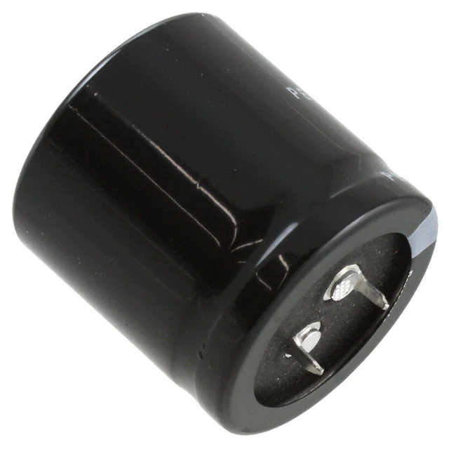

Aluminum Electrolytic Capacitors/ HD Snap-in Type Series: HD Type: TS ■ Features ■ Country of origin ● Endurance : 105 °C 3000 h ● 30 % smaller than series TS-HC ● RoHS directive compliant Malaysia ■ Specifications Category Temp. Range Rated W.V. Range Nominal Cap. Range Capacitance Tolerance –25 °C to +105 °C 400 V.DC to 450 V.DC 120 µF to 680 µF ±20 % (120 Hz/+20 °C) 3앀 CV (µA) max. After 5 minutes application of rated working voltage at +20 °C. C : Capacitance (µF) V: W.V. (V.DC) DC Leakage Current tan δ Please see the attached standard products list After 3000 hours application of DC voltage with specified ripple current (< rated DC working voltage) at +105 °C, the capacitors shall meet the following limits. Capacitance change < ±20 % of initial measured value tan δ < 200 % of initial specified value DC leakage current < initial specified value Endurance After storage for 1000 hours at +105 °C±20 °C within no voltage applied and then being stabilized at +20 °C, capacitors shall meet the limits specified in Endurance. (With voltage treatment) Shelf Life ■ Frequency correction factor for ripple current 50 0.75 Correction factor 60 0.80 100 0.95 Frequency (Hz) 120 1.00 500 1.20 1k 1.25 10 k to 1.40 ■ Dimensions in mm (not to scale) φD+1.0 max. Polarity bar (mm) (1 0 .0 P.E.T. Sleeve 2-φ2.0±0.1 10 .0± 0.1 ) Vent L+2.0 max. (φD) 4.0±0.5 Rated voltage etc. indicate to sleeve. Recommended PWB piercing plan 2.0 max. 4.0±0.5 +0.2 Terminal (t=0.8) (3.5) 0.8 –0.1 1.5±0.2 Top of spin Standard terminal type does not require terminal trimming peocess. Design and specifications are each subject to change without notice. Ask factory for the current technical specifications before purchase and/or use. Should a safety concern arise regarding this product, please be sure to contact us immediately. – EE160 – 01 Jul. 2011 Aluminum Electrolytic Capacitors/ HD ■ Standard Products Case size W.V. Cap. (120 Hz) (±20 %) (V. DC) (µF) 120 180 220 270 330 400 390 470 560 680 120 150 180 220 270 420 330 390 470 560 120 180 220 450 270 330 390 470 560 Dia. Length (mm) 22 25 22 25 25 30 22 25 35 25 35 25 30 35 30 35 30 35 22 22 25 22 25 22 25 22 25 30 35 25 30 25 30 35 30 35 30 35 22 25 22 25 22 25 30 22 25 30 35 25 30 30 35 30 35 30 35 (mm) 25 25 35 30 35 25 50 40 25 45 25 50 35 30 40 35 50 40 25 30 25 35 30 40 35 50 40 30 25 45 35 50 40 30 45 35 50 40 30 25 35 30 45 35 25 50 40 30 25 45 35 40 30 45 35 50 40 Part No. PET sleeve Terminal Length 4.0 mm (Without Top Plate) EETHD2G121HJ EETHD2G181JJ EETHD2G221HJ EETHD2G221JJ EETHD2G271JJ EETHD2G271KJ EETHD2G331HJ EETHD2G331JJ EETHD2G331LJ EETHD2G391JJ EETHD2G391LJ EETHD2G471JJ EETHD2G471KJ EETHD2G471LJ EETHD2G561KJ EETHD2G561LJ EETHD2G681KJ EETHD2G681LJ EETHD2S121HJ EETHD2S151HJ EETHD2S151JJ EETHD2S181HJ EETHD2S181JJ EETHD2S221HJ EETHD2S221JJ EETHD2S271HJ EETHD2S271JJ EETHD2S271KJ EETHD2S271LJ EETHD2S331JJ EETHD2S331KJ EETHD2S391JJ EETHD2S391KJ EETHD2S391LJ EETHD2S471KJ EETHD2S471LJ EETHD2S561KJ EETHD2S561LJ EETHD2W121HJ EETHD2W121JJ EETHD2W181HJ EETHD2W181JJ EETHD2W221HJ EETHD2W221JJ EETHD2W221KJ EETHD2W271HJ EETHD2W271JJ EETHD2W271KJ EETHD2W271LJ EETHD2W331JJ EETHD2W331KJ EETHD2W391KJ EETHD2W391LJ EETHD2W471KJ EETHD2W471LJ EETHD2W561KJ EETHD2W561LJ Specification Ripple tan δ Current (120 Hz) (120 Hz) (+20 °C) (+105 °C) max. (A r.m.s.) 0.75 0.15 0.95 0.15 1.10 0.15 1.10 0.15 1.22 0.15 1.22 0.15 1.44 0.15 1.44 0.15 1.44 0.15 1.55 0.15 1.55 0.15 1.68 0.15 1.68 0.15 1.68 0.15 1.90 0.15 1.90 0.15 2.12 0.15 2.12 0.15 0.74 0.15 0.84 0.15 0.84 0.15 0.91 0.15 0.91 0.15 1.05 0.15 1.05 0.15 1.20 0.15 1.20 0.15 1.20 0.15 1.20 0.15 1.42 0.15 1.42 0.15 1.55 0.15 1.55 0.15 1.55 0.15 1.71 0.15 1.71 0.15 1.90 0.15 1.90 0.15 0.72 0.20 0.72 0.20 0.87 0.20 0.87 0.20 1.00 0.20 1.00 0.20 1.00 0.20 1.19 0.20 1.19 0.20 1.19 0.20 1.19 0.20 1.38 0.20 1.38 0.20 1.55 0.20 1.55 0.20 1.74 0.20 1.74 0.20 1.90 0.20 1.90 0.20 Min. Packaging Q'ty (pcs) 200 200 200 200 200 200 200 200 200 200 200 200 100 200 100 100 100 100 200 200 200 200 200 200 200 200 200 200 200 200 100 200 100 200 100 100 100 100 200 200 200 200 200 200 200 200 200 200 200 200 100 100 200 100 100 100 100 Endurance : 105 °C 3000 h, Terminal Pitch : 10 mm Design and specifications are each subject to change without notice. Ask factory for the current technical specifications before purchase and/or use. Should a safety concern arise regarding this product, please be sure to contact us immediately. – EE161 – 00 Sep. 2010

物料型号:EETHD2G121HJ, EETHD2G181JJ, EETHD2G221HJ, 等,具体型号根据额定工作电压(W.V.)和电容值(Cap)而定。
器件简介:Panasonic HD系列铝电解电容器,符合RoHS指令,比TS-HC系列小30%,原产地为马来西亚。
引脚分配:标准端子类型不需要终端修整过程,端子间距为10mm。
参数特性: - 工作温度范围:-25°C至+105°C。 - 额定工作电压范围:400V至450V DC。 - 标称电容范围:120μF至680μF。 - 电容公差:20%(在120Hz/+20°C时)。 - DC漏电流:3CV(μA)最大值,5分钟后在+20°C下施加额定工作电压。 - tanδ值:请参考附带的标准产品列表。
功能详解: - 耐久性:在+105°C下,经过3000小时的直流电压应用,满足特定纹波电流条件下,电容变化不超过初始测量值的20%,tanδ不超过初始指定值的200%,DC漏电流不超过初始指定值。 - 存储寿命:在+105°C下存储1000小时后,无电压应用并在+20°C下稳定,满足耐久性规定的限制。
应用信息:文档中未明确提供应用信息,但铝电解电容器通常用于电源滤波、信号耦合等。
封装信息:提供了不同电压和电容值的电容器尺寸,包括直径和长度,以及推荐的PCB穿刺计划。
