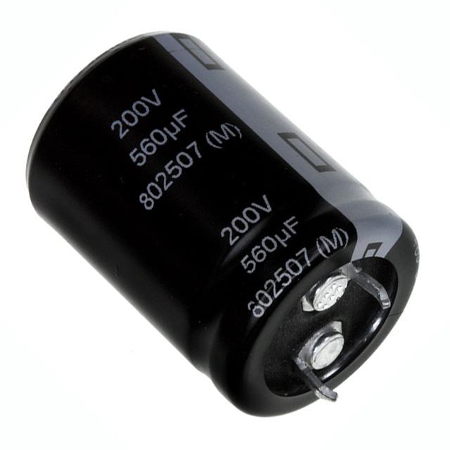

    82 µF 450 V 铝电解电容器 径向,Can - 卡入式 2.426 欧姆 @ 120Hz 85°C 时为 2000 小时
EET-UQ2W820BA 数据手册
Panasonic Industrial Company TS-UQ Series Aluminum Electrolytic Capacitors 85°C, 2000 hours  Highest capacitance version (30% smaller than UP series)  2 and 3 pin versions available  RoHS compliant PVC and RoHS compliant PET sleeve options Rated Working Voltage: Operating Temperature: Nominal Capacitance: Capacitance Tolerance: Dissipation Factor: (120 Hz, +20°C) RoHS Compliant 16 ~ 250 VDC -40 ~ +85°C 270 ~ 100000µF 350 ~ 450 VDC -25 ~ +85°C 82 ~ 1000µF ± 20% Working Voltage [V]: Max. D.F. (%): 16 50 25 40 35 35 50 30 63 25 100 20 160 ~ 450 15 (rated cap. [µF] - 33000 ) 1000 For capacitance values > 33000µF, add the value of: Leakage Current: Ripple Current Multipliers: 80 20 3¥CV (µA) max. after 5 minutes; C = Capacitance in µF, V = WV Frequency(Hz): 16~100WV: 160~450WV: 50 0.93 0.75 Endurance: 60 0.95 0.8 100~120 1.0 1.0 500 1.05 1.2 1k 1.08 1.25 10k 1.15 1.4 Ripple Current Ambient Temperature Factors* Temperature (°C): 85°C 70°C 60°C Multiplier: 1.0 1.3 1.4 ”45°C 1.5 2000 hours at +85°C with maximum specified ripple current (see page 4) *Use of temperature ripple current multipliers may limit life to the hours specified for the maximum operating temperature. Part Number System E T U Common Code 1C 16 1E 25 1V 35 Q Series Code 1H 50 1J 63 Sleeving Options: See Part Number listings Capacitance Code Voltage Code 1K 2A 2C 2D 2E 2V 2G 2S 2W 80 100 160 200 250 350 400 420 450 # of pins: pin length "T": 22mm 25mm 30mm 35mm Diameter E Dimensions in millimeters Diameter / Terminal Code 2 3 4.0±0.5mm 4.0±0.5mm H P J Q K R L S 2 6.3±1mm B C D E Circuit Board Mounting Holes 10.0±0.1 2 Pin Mounting Style L+2 max. T 2 x Ø2.0±0.1 D+1 max. Circuit Board Mounting Holes 10.0±0.1 Ø2.0±0.1 3 Pin Mounting Style 4.75±0.1 3.3±0.1 L+2 max. T D+1 max. Pin Dimensions 2.0 max. 2.0 max. 0.8 +0.2 0.8 -0.1 3.5 Ø2.5 min. Ø2.0±0.1 Top of Capacitor Body 4.0±0.5 1.5±0.2 4mm Length: Standard on 2 and 3 Pin Mounting Styles 4.0 +0.2 -0.1 6.3±1.0 1.5±0.2 6.3mm Length: Available on 2 Pin Mounting Style Only Design and specifications are subject to change without notice. Contact the factory or your sales representative for technical specifications before purchase and/or use. When safety concerns arise, please contact Panasonic immediately for technical consultation. 7 Panasonic Industrial Company TS-UQ Standard Ratings Cap. (µF) 12000 15000 18000 22000 27000 33000 39000 47000 56000 68000 82000 100000 8200 12000 15000 18000 22000 27000 33000 39000 47000 56000 68000 5600 8200 10000 12000 15000 18000 8 Max 85°C R.C. (Arms) Size (mm) DxL 120Hz 22 22 22 25 22 25 22 25 30 22 25 30 35 25 30 25 30 35 30 35 30 35 35 35 x x x x x x x x x x x x x x x x x x x x x x x x 25 30 35 25 40 30 45 35 25 50 40 30 25 45 35 50 40 30 45 35 50 40 45 50 4.52 5.26 5.57 5.57 6.10 6.10 6.31 6.31 6.31 6.84 6.84 6.84 6.84 6.94 6.94 7.47 7.47 7.47 8.73 8.73 9.05 9.05 9.49 10.18 22 22 25 22 25 22 25 30 22 25 30 35 25 30 25 30 35 30 35 30 35 35 35 x x x x x x x x x x x x x x x x x x x x x x x 25 30 25 35 30 40 35 25 45 40 30 25 45 35 50 40 30 45 35 50 40 45 50 3.57 4.10 4.10 4.63 4.63 5.47 5.47 5.47 6.10 6.10 6.10 6.10 6.21 6.21 6.84 6.84 6.84 7.36 7.36 8.00 8.00 8.91 9.79 22 22 25 22 25 22 25 30 22 25 25 30 35 x x x x x x x x x x x x x 25 30 25 35 30 40 35 25 45 40 45 30 25 3.36 4.00 4.00 4.42 4.42 5.05 5.05 5.05 5.57 5.57 5.68 5.68 5.68 20°C ESR (Ȏ, max.) 10kHz~ 120Hz 20kHz 16 VDC Working, 20 VDC Surge 5.20 0.069 0.059 6.05 0.055 0.047 6.41 0.046 0.039 6.41 0.046 0.039 7.02 0.038 0.032 7.02 0.038 0.032 7.26 0.031 0.026 7.26 0.031 0.026 7.26 0.031 0.026 7.87 0.025 0.021 7.87 0.025 0.021 7.87 0.025 0.021 7.87 0.025 0.021 7.98 0.024 0.020 7.98 0.024 0.020 8.59 0.023 0.019 8.59 0.023 0.019 8.59 0.023 0.019 10.04 0.022 0.019 10.04 0.022 0.019 10.41 0.021 0.018 10.41 0.021 0.018 10.91 0.020 0.018 11.71 0.019 0.018 25 VDC Working, 32 VDC Surge 4.11 0.081 0.065 4.72 0.055 0.044 4.72 0.055 0.044 5.32 0.044 0.035 5.32 0.044 0.035 6.29 0.037 0.029 6.29 0.037 0.029 6.29 0.037 0.029 7.02 0.030 0.024 7.02 0.030 0.024 7.02 0.030 0.024 7.02 0.030 0.024 7.14 0.025 0.020 7.14 0.025 0.020 7.87 0.020 0.016 7.87 0.020 0.016 7.87 0.020 0.016 8.46 0.020 0.016 8.46 0.020 0.016 9.20 0.019 0.016 9.20 0.019 0.016 10.25 0.019 0.016 11.26 0.018 0.016 35 VDC Working, 44 VDC Surge 3.86 0.104 0.078 4.60 0.071 0.053 4.60 0.071 0.053 5.08 0.058 0.044 5.08 0.058 0.044 5.81 0.048 0.036 5.81 0.048 0.036 5.81 0.048 0.036 6.41 0.039 0.029 6.41 0.039 0.029 6.53 0.032 0.024 6.53 0.032 0.024 6.53 0.032 0.024 Aluminum Electrolytic Capacitors Part numbers shown with 2 pins and 4.0mm length terminal Panasonic Part Number (By Sleeving Style) PVC with Top Plate PET without Top Plate EETUQ1C123HA EETUQ1C153HA EETUQ1C183HA EETUQ1C183JA EETUQ1C223HA EETUQ1C223JA EETUQ1C273HA EETUQ1C273JA EETUQ1C273KA EETUQ1C333HA EETUQ1C333JA EETUQ1C333KA EETUQ1C333LA EETUQ1C393JA EETUQ1C393KA EETUQ1C473JA EETUQ1C473KA EETUQ1C473LA EETUQ1C563KA EETUQ1C563LA EETUQ1C683KA EETUQ1C683LA EETUQ1C823LA EETUQ1C104LA EETUQ1C123HJ EETUQ1C153HJ EETUQ1C183HJ EETUQ1C183JJ EETUQ1C223HJ EETUQ1C223JJ EETUQ1C273HJ EETUQ1C273JJ EETUQ1C273KJ EETUQ1C333HJ EETUQ1C333JJ EETUQ1C333KJ EETUQ1C333LJ EETUQ1C393JJ EETUQ1C393KJ EETUQ1C473JJ EETUQ1C473KJ EETUQ1C473LJ EETUQ1C563KJ EETUQ1C563LJ EETUQ1C683KJ EETUQ1C683LJ EETUQ1C823LJ EETUQ1C104LJ EETUQ1E822HA EETUQ1E123HA EETUQ1E123JA EETUQ1E153HA EETUQ1E153JA EETUQ1E183HA EETUQ1E183JA EETUQ1E183KA EETUQ1E223HA EETUQ1E223JA EETUQ1E223KA EETUQ1E223LA EETUQ1E273JA EETUQ1E273KA EETUQ1E333JA EETUQ1E333KA EETUQ1E333LA EETUQ1E393KA EETUQ1E393LA EETUQ1E473KA EETUQ1E473LA EETUQ1E563LA EETUQ1E683LA EETUQ1E822HJ EETUQ1E123HJ EETUQ1E123JJ EETUQ1E153HJ EETUQ1E153JJ EETUQ1E183HJ EETUQ1E183JJ EETUQ1E183KJ EETUQ1E223HJ EETUQ1E223JJ EETUQ1E223KJ EETUQ1E223LJ EETUQ1E273JJ EETUQ1E273KJ EETUQ1E333JJ EETUQ1E333KJ EETUQ1E333LJ EETUQ1E393KJ EETUQ1E393LJ EETUQ1E473KJ EETUQ1E473LJ EETUQ1E563LJ EETUQ1E683LJ EETUQ1V562HA EETUQ1V822HA EETUQ1V822JA EETUQ1V103HA EETUQ1V103JA EETUQ1V123HA EETUQ1V123JA EETUQ1V123KA EETUQ1V153HA EETUQ1V153JA EETUQ1V183JA EETUQ1V183KA EETUQ1V183LA EETUQ1V562HJ EETUQ1V822HJ EETUQ1V822JJ EETUQ1V103HJ EETUQ1V103JJ EETUQ1V123HJ EETUQ1V123JJ EETUQ1V123KJ EETUQ1V153HJ EETUQ1V153JJ EETUQ1V183JJ EETUQ1V183KJ EETUQ1V183LJ Design and specifications are subject to change without notice. Contact the factory or your sales representative for technical specifications before purchase and/or use. When safety concerns arise, please contact Panasonic immediately for technical consultation. Panasonic Industrial Company TS-UQ Standard Ratings (continued) Cap. (µF) 22000 27000 33000 39000 47000 3300 4700 5600 6800 8200 10000 12000 15000 18000 22000 27000 2200 3300 3900 4700 5600 6800 8200 10000 12000 15000 18000 1500 1800 2200 2700 Size (mm) DxL Aluminum Electrolytic Capacitors Part numbers shown with 2 pins and 4.0mm length terminal 20°C ESR (ȍ, max.) Panasonic Part Number (By Sleeving Style) PVC with Top Plate 10kHz~ 120Hz 20kHz PET without Top Plate 35 VDC Working, 44 VDC Surge (continued) EETUQ1V223JA EETUQ1V223JJ 7.02 0.026 0.020 EETUQ1V223KA EETUQ1V223KJ 7.02 0.026 0.020 EETUQ1V223LA EETUQ1V223LJ 7.02 0.026 0.020 EETUQ1V273KA EETUQ1V273KJ 7.87 0.021 0.016 EETUQ1V273LA EETUQ1V273LJ 7.87 0.021 0.016 EETUQ1V333KA EETUQ1V333KJ 8.22 0.018 0.013 EETUQ1V333LA EETUQ1V333LJ 8.22 0.018 0.014 EETUQ1V393LJ EETUQ1V393LA 9.10 0.017 0.014 EETUQ1V473LJ EETUQ1V473LA 9.84 0.017 0.014 50 VDC Working, 63 VDC Surge EETUQ1H332HA EETUQ1H332HJ 3.14 0.151 0.113 EETUQ1H472HA EETUQ1H472HJ 3.48 0.106 0.079 EETUQ1H472JA EETUQ1H472JJ 3.48 0.106 0.079 EETUQ1H562HA EETUQ1H562HJ 3.93 0.089 0.067 EETUQ1H682HA EETUQ1H682HJ 4.43 0.073 0.055 EETUQ1H682JA EETUQ1H682JJ 4.43 0.073 0.055 EETUQ1H682KA EETUQ1H682KJ 4.43 0.073 0.055 EETUQ1H822HA EETUQ1H822HJ 5.07 0.061 0.045 EETUQ1H822JA EETUQ1H822JJ 5.07 0.061 0.045 EETUQ1H103HA EETUQ1H103HJ 5.72 0.050 0.037 EETUQ1H103JA EETUQ1H103JJ 5.72 0.050 0.037 EETUQ1H103KA EETUQ1H103KJ 5.72 0.050 0.037 EETUQ1H103LA EETUQ1H103LJ 5.72 0.050 0.037 EETUQ1H123JA EETUQ1H123JJ 6.42 0.041 0.031 EETUQ1H123KA EETUQ1H123KJ 6.42 0.041 0.031 EETUQ1H123LA EETUQ1H123LJ 6.42 0.041 0.031 EETUQ1H153KA EETUQ1H153KJ 7.41 0.033 0.025 EETUQ1H153LA EETUQ1H153LJ 7.41 0.033 0.025 EETUQ1H183KA EETUQ1H183KJ 7.98 0.028 0.021 EETUQ1H183LA EETUQ1H183LJ 7.98 0.028 0.021 EETUQ1H223LA EETUQ1H223LJ 8.71 0.023 0.018 EETUQ1H273LA EETUQ1H273LJ 10.30 0.018 0.015 63 VDC Working, 79 VDC Surge EETUQ1J222HJ EETUQ1J222HA 2.90 0.188 0.141 EETUQ1J332HA EETUQ1J332HJ 4.72 0.126 0.094 EETUQ1J332JA EETUQ1J332JJ 4.72 0.126 0.094 EETUQ1J392HA EETUQ1J392HJ 5.11 0.106 0.080 EETUQ1J392JA EETUQ1J392JJ 5.11 0.106 0.080 EETUQ1J472HJ EETUQ1J472HA 5.59 0.088 0.066 EETUQ1J472JA EETUQ1J472JJ 5.59 0.088 0.066 EETUQ1J472KA EETUQ1J472KJ 5.59 0.088 0.066 EETUQ1J562HJ EETUQ1J562HA 6.16 0.074 0.056 EETUQ1J562JA EETUQ1J562JJ 6.16 0.074 0.056 EETUQ1J682JA EETUQ1J682JJ 6.72 0.061 0.046 EETUQ1J682KA EETUQ1J682KJ 6.72 0.061 0.046 EETUQ1J682LA EETUQ1J682LJ 6.72 0.061 0.046 EETUQ1J822JA EETUQ1J822JJ 6.90 0.051 0.038 EETUQ1J822KA EETUQ1J822KJ 6.90 0.051 0.038 EETUQ1J822LA EETUQ1J822LJ 6.90 0.051 0.038 EETUQ1J103KA EETUQ1J103KJ 7.50 0.041 0.031 EETUQ1J103LA EETUQ1J103LJ 7.50 0.041 0.031 EETUQ1J123KA EETUQ1J123KJ 8.22 0.035 0.026 EETUQ1J123LA EETUQ1J123LJ 8.22 0.035 0.026 EETUQ1J153LA EETUQ1J153LJ 9.10 0.028 0.021 EETUQ1J183LA EETUQ1J183LJ 9.83 0.023 0.018 80 VDC Working, 100 VDC Surge EETUQ1K152HA EETUQ1K152HJ 2.60 0.221 0.166 EETUQ1K182HA EETUQ1K182HJ 2.90 0.184 0.138 EETUQ1K222HA EETUQ1K222HJ 3.14 0.151 0.113 EETUQ1K222JA EETUQ1K222JJ 3.14 0.151 0.113 EETUQ1K272HA EETUQ1K272HJ 3.20 0.123 0.092 EETUQ1K272JA EETUQ1K272JJ 3.20 0.123 0.092 Max 85°C R.C. (Arms) 120Hz 25 30 35 30 35 30 35 35 35 x x x x x x x x x 50 35 30 45 35 50 40 45 50 6.10 6.10 6.10 6.84 6.84 7.15 7.15 7.91 8.56 22 22 25 22 22 25 30 22 25 22 25 30 35 25 30 35 30 35 30 35 35 35 x x x x x x x x x x x x x x x x x x x x x x 25 30 25 35 40 30 25 45 35 50 40 30 25 45 35 30 40 35 45 40 45 50 2.73 3.03 3.03 3.42 3.85 3.85 3.85 4.41 4.41 4.97 4.97 4.97 4.97 5.58 5.58 5.58 6.44 6.44 6.94 6.94 7.57 8.96 22 22 25 22 25 22 25 30 22 25 25 30 35 25 30 35 30 35 30 35 35 35 x x x x x x x x x x x x x x x x x x x x x x 25 30 25 35 30 40 35 25 45 40 45 30 25 50 35 30 40 35 45 40 45 50 2.52 4.10 4.10 4.44 4.44 4.86 4.86 4.86 5.36 5.36 5.84 5.84 5.84 6.00 6.00 6.00 6.52 6.52 7.15 7.15 7.91 8.55 22 22 22 25 22 25 x x x x x x 25 30 35 25 40 30 2.26 2.52 2.73 2.73 2.78 2.78 Design and specifications are subject to change without notice. Contact the factory or your sales representative for technical specifications before purchase and/or use. When safety concerns arise, please contact Panasonic immediately for technical consultation. 9 Panasonic Industrial Company TS-UQ Standard Ratings (continued) Size (mm) DxL 3300 22 25 30 22 25 35 25 30 25 30 35 30 35 30 35 35 35 x x x x x x x x x x x x x x x x x 45 35 25 50 40 25 45 30 50 35 30 45 35 50 40 45 50 3.21 3.21 3.21 3.59 3.59 3.59 4.09 4.09 4.55 4.55 4.55 5.16 5.16 5.83 5.83 6.51 7.28 22 25 22 22 25 22 25 30 22 25 30 35 25 30 25 30 35 30 35 30 35 35 35 x x x x x x x x x x x x x x x x x x x x x x x 25 25 30 35 30 45 35 25 50 40 30 25 45 35 50 40 30 45 35 50 40 45 50 1.96 2.31 2.57 2.84 2.84 3.14 3.14 3.14 3.71 3.71 3.71 3.71 4.06 4.06 4.54 4.54 4.54 5.13 5.13 5.75 5.75 6.60 7.29 25 30 35 40 30 45 35 25 50 40 30 25 45 35 30 40 35 45 40 45 50 2.25 2.50 2.75 3.00 3.00 3.25 3.25 3.25 3.73 3.73 3.73 3.73 4.20 4.20 4.20 4.78 4.78 5.45 5.45 5.75 6.00 4700 5600 6800 8200 10000 12000 1000 1200 1500 1800 2200 2700 3300 3900 4700 5600 6800 8200 560 680 820 1000 1200 1500 1800 2200 2700 3300 3900 10 22 22 22 22 25 22 25 30 22 25 30 35 25 30 35 30 35 30 35 35 35 x x x x x x x x x x x x x x x x x x x x x Part numbers shown with 2 pins and 4.0mm length terminal 20°C ESR (ȍ, max.) Panasonic Part Number (By Sleeving Style) PVC with Top Plate 10kHz~ 120Hz 20kHz PET without Top Plate 80 VDC Working, 105 VDC Surge (continued) EETUQ1K332HA EETUQ1K332HJ 3.69 0.100 0.075 EETUQ1K332JJ EETUQ1K332JA 3.69 0.100 0.075 EETUQ1K332KJ EETUQ1K332KA 3.69 0.100 0.075 EETUQ1K392HJ EETUQ1K392HA 4.13 0.085 0.064 EETUQ1K392JJ EETUQ1K392JA 4.13 0.085 0.064 EETUQ1K392LJ EETUQ1K392LA 4.13 0.085 0.064 EETUQ1K472JJ EETUQ1K472JA 4.70 0.071 0.053 EETUQ1K472KJ EETUQ1K472KA 4.70 0.071 0.053 EETUQ1K562JJ EETUQ1K562JA 5.23 0.059 0.044 EETUQ1K562KJ EETUQ1K562KA 5.23 0.059 0.044 EETUQ1K562LJ EETUQ1K562LA 5.23 0.059 0.044 EETUQ1K682KJ EETUQ1K682KA 5.93 0.049 0.037 EETUQ1K682LJ EETUQ1K682LA 5.93 0.049 0.037 EETUQ1K822KJ EETUQ1K822KA 6.70 0.040 0.030 EETUQ1K822LJ EETUQ1K822LA 6.70 0.040 0.030 EETUQ1K103LJ EETUQ1K103LA 7.49 0.033 0.025 EETUQ1K123LJ EETUQ1K123LA 8.37 0.028 0.021 100 VDC Working, 125 VDC Surge EETUQ2A102HA EETUQ2A102HJ 2.25 0.332 0.216 EETUQ2A122JA EETUQ2A122JJ 2.66 0.276 0.180 EETUQ2A152HA EETUQ2A152HJ 2.96 0.221 0.144 EETUQ2A182HA EETUQ2A182HJ 3.27 0.184 0.120 EETUQ2A182JA EETUQ2A182JJ 3.27 0.184 0.120 EETUQ2A222HJ EETUQ2A222HA 3.61 0.151 0.098 EETUQ2A222JA EETUQ2A222JJ 3.61 0.151 0.098 EETUQ2A222KJ EETUQ2A222KA 3.61 0.151 0.098 EETUQ2A272HA EETUQ2A272HJ 4.27 0.123 0.080 EETUQ2A272JJ EETUQ2A272JA 4.27 0.123 0.080 EETUQ2A272KJ EETUQ2A272KA 4.27 0.123 0.080 EETUQ2A272LA EETUQ2A272LJ 4.27 0.123 0.080 EETUQ2A332JA EETUQ2A332JJ 4.67 0.100 0.065 EETUQ2A332KA EETUQ2A332KJ 4.67 0.100 0.065 EETUQ2A392JA EETUQ2A392JJ 5.22 0.085 0.055 EETUQ2A392KA EETUQ2A392KJ 5.22 0.085 0.055 EETUQ2A392LA EETUQ2A392LJ 5.22 0.085 0.055 EETUQ2A472KA EETUQ2A472KJ 5.90 0.071 0.046 EETUQ2A472LJ EETUQ2A472LA 5.90 0.071 0.046 EETUQ2A562KJ EETUQ2A562KA 6.61 0.059 0.041 EETUQ2A562LJ EETUQ2A562LA 6.61 0.059 0.038 EETUQ2A682LJ EETUQ2A682LA 7.59 0.049 0.034 EETUQ2A822LJ EETUQ2A822LA 8.38 0.040 0.030 160 VDC Working, 200 VDC Surge EETUQ2C561HJ EETUQ2C561HA 3.15 0.355 0.160 EETUQ2C681HA EETUQ2C681HJ 3.50 0.293 0.132 EETUQ2C821HA EETUQ2C821HJ 3.85 0.243 0.109 EETUQ2C102HJ EETUQ2C102HA 4.20 0.199 0.090 EETUQ2C102JJ EETUQ2C102JA 4.20 0.199 0.090 EETUQ2C122HJ EETUQ2C122HA 4.55 0.166 0.075 EETUQ2C122JJ EETUQ2C122JA 4.55 0.166 0.075 EETUQ2C122KJ EETUQ2C122KA 4.55 0.166 0.075 EETUQ2C152HJ EETUQ2C152HA 5.22 0.133 0.060 EETUQ2C152JJ EETUQ2C152JA 5.22 0.133 0.060 EETUQ2C152KJ EETUQ2C152KA 5.22 0.133 0.060 EETUQ2C152LA EETUQ2C152LJ 5.22 0.133 0.060 EETUQ2C182JA EETUQ2C182JJ 5.88 0.111 0.050 EETUQ2C182KJ EETUQ2C182KA 5.88 0.120 0.060 EETUQ2C182LJ EETUQ2C182LA 5.88 0.111 0.050 EETUQ2C222KJ EETUQ2C222KA 6.69 0.090 0.041 EETUQ2C222LA EETUQ2C222LJ 6.69 0.098 0.049 EETUQ2C272KJ EETUQ2C272KA 7.63 0.074 0.033 EETUQ2C272LJ EETUQ2C272LA 7.63 0.080 0.040 EETUQ2C332LJ EETUQ2C332LA 8.05 0.070 0.035 EETUQ2C392LJ EETUQ2C392LA 8.40 0.055 0.028 Max 85°C R.C. (Arms) Cap. (µF) 3900 Aluminum Electrolytic Capacitors 120Hz Design and specifications are subject to change without notice. Contact the factory or your sales representative for technical specifications before purchase and/or use. When safety concerns arise, please contact Panasonic immediately for technical consultation. Panasonic Industrial Company TS-UQ Standard Ratings (continued) Cap. (µF) Size (mm) DxL 390 470 560 22 22 22 25 22 25 22 25 30 22 25 30 35 22 25 30 25 30 35 30 35 30 35 35 x x x x x x x x x x x x x x x x x x x x x x x x 25 30 30 25 35 30 40 30 25 45 35 30 25 50 40 30 50 35 30 45 35 50 40 50 22 22 22 25 22 25 22 25 30 22 25 30 30 22 25 30 35 25 30 35 30 35 30 35 35 35 x x x x x x x x x x x x x x x x x x x x x x x x x x 25 30 30 25 35 30 40 30 25 45 35 25 30 50 40 30 25 45 35 30 40 35 50 40 45 50 22 22 22 22 25 22 25 22 25 30 35 x x x x x x x x x x x 25 30 35 40 30 45 35 50 40 30 25 680 820 1000 1200 1500 1800 2200 2700 270 330 390 470 560 680 820 1000 1200 1500 1800 2200 150 180 220 270 330 390 Max 85°C R.C. (Arms) 20°C ESR (ȍ, max.) 120Hz 10kHz~ 120Hz 20kHz 200 VDC Working, 250 VDC Surge 1.68 2.35 0.510 0.230 1.85 2.59 0.423 0.190 2.43 3.40 0.355 0.160 2.43 3.40 0.355 0.160 2.68 3.75 0.293 0.132 2.68 3.75 0.293 0.132 2.93 4.10 0.243 0.109 2.93 4.10 0.243 0.109 2.93 4.10 0.243 0.109 3.25 4.55 0.199 0.090 3.25 4.55 0.199 0.090 3.25 4.55 0.199 0.090 3.25 4.55 0.232 0.116 3.50 4.90 0.166 0.075 3.50 4.90 0.166 0.075 3.50 4.90 0.166 0.075 3.87 5.42 0.133 0.060 3.87 5.42 0.144 0.065 3.87 5.42 0.144 0.065 4.32 6.05 0.120 0.060 4.32 6.05 0.120 0.060 4.92 6.89 0.098 0.049 4.92 6.89 0.105 0.053 5.45 7.63 0.086 0.043 250 VDC Working, 300 VDC Surge 1.31 1.83 0.737 0.332 1.75 2.45 0.603 0.271 1.91 2.67 0.510 0.230 1.91 2.67 0.510 0.230 2.11 2.95 0.423 0.190 2.11 2.95 0.423 0.190 2.25 3.15 0.355 0.160 2.25 3.15 0.355 0.160 2.25 3.15 0.355 0.160 2.50 3.50 0.293 0.132 2.50 3.50 0.293 0.132 2.30 3.22 0.293 0.132 2.50 3.50 0.293 0.132 2.77 3.88 0.243 0.109 2.77 3.88 0.243 0.109 2.77 3.88 0.243 0.109 2.77 3.88 0.243 0.121 3.32 4.65 0.199 0.090 3.32 4.65 0.199 0.090 3.32 4.65 0.199 0.090 3.53 4.94 0.166 0.075 3.53 4.94 0.166 0.083 4.04 5.66 0.133 0.066 4.04 5.66 0.133 0.066 4.55 6.37 0.111 0.055 4.75 6.65 0.098 0.049 350 VDC Working, 400 VDC Surge 1.12 1.57 1.326 0.663 1.22 1.71 1.105 0.553 1.44 2.02 0.904 0.452 1.66 2.32 0.737 0.368 1.66 2.32 0.737 0.368 1.88 2.63 0.603 0.301 1.88 2.63 0.603 0.301 2.06 2.88 0.510 0.255 2.06 2.88 0.510 0.255 2.06 2.88 0.510 0.255 2.06 2.88 0.510 0.255 Aluminum Electrolytic Capacitors Part numbers shown with 2 pins and 4.0mm length terminal Panasonic Part Number (By Sleeving Style) PET sleeve without Top Plate PVC sleeve with Top Plate EETUQ2D391HA EETUQ2D471HA EETUQ2D561HA EETUQ2D561JA EETUQ2D681HA EETUQ2D681JA EETUQ2D821HA EETUQ2D821JA EETUQ2D821KA EETUQ2D102HA EETUQ2D102JA EETUQ2D102KA EETUQ2D102LA EETUQ2D122HA EETUQ2D122JA EETUQ2D122KA EETUQ2D152JA EETUQ2D152KA EETUQ2D152LA EETUQ2D182KA EETUQ2D182LA EETUQ2D222KA EETUQ2D222LA EETUQ2D272LA EETUQ2D391HJ EETUQ2D471HJ EETUQ2D561HJ EETUQ2D561JJ EETUQ2D681HJ EETUQ2D681JJ EETUQ2D821HJ EETUQ2D821JJ EETUQ2D821KJ EETUQ2D102HJ EETUQ2D102JJ EETUQ2D102KJ EETUQ2D102LJ EETUQ2D122HJ EETUQ2D122JJ EETUQ2D122KJ EETUQ2D152JJ EETUQ2D152KJ EETUQ2D152LJ EETUQ2D182KJ EETUQ2D182LJ EETUQ2D222KJ EETUQ2D222LJ EETUQ2D272LJ EETUQ2E271HA EETUQ2E331HA EETUQ2E391HA EETUQ2E391JA EETUQ2E471HA EETUQ2E471JA EETUQ2E561HA EETUQ2E561JA EETUQ2E561KA EETUQ2E681HA EETUQ2E681JA EETUQ2E681KF EETUQ2E681KA EETUQ2E821HA EETUQ2E821JA EETUQ2E821KA EETUQ2E821LA EETUQ2E102JA EETUQ2E102KA EETUQ2E102LA EETUQ2E122KA EETUQ2E122LA EETUQ2E152KA EETUQ2E152LA EETUQ2E182LA EETUQ2E222LA EETUQ2E271HJ EETUQ2E331HJ EETUQ2E391HJ EETUQ2E391JJ EETUQ2E471HJ EETUQ2E471JJ EETUQ2E561HJ EETUQ2E561JJ EETUQ2E561KJ EETUQ2E681HJ EETUQ2E681JJ EETUQ2E681KC EETUQ2E681KJ EETUQ2E821HJ EETUQ2E821JJ EETUQ2E821KJ EETUQ2E821LJ EETUQ2E102JJ EETUQ2E102KJ EETUQ2E102LJ EETUQ2E122KJ EETUQ2E122LJ EETUQ2E152KJ EETUQ2E152LJ EETUQ2E182LJ EETUQ2E222LJ EETUQ2V151HA EETUQ2V181HA EETUQ2V221HA EETUQ2V271HA EETUQ2V271JA EETUQ2V331HA EETUQ2V331JA EETUQ2V391HA EETUQ2V391JA EETUQ2V391KA EETUQ2V391LA EETUQ2V151HJ EETUQ2V181HJ EETUQ2V221HJ EETUQ2V271HJ EETUQ2V271JJ EETUQ2V331HJ EETUQ2V331JJ EETUQ2V391HJ EETUQ2V391JJ EETUQ2V391KJ EETUQ2V391LJ Design and specifications are subject to change without notice. Contact the factory or your sales representative for technical specifications before purchase and/or use. When safety concerns arise, please contact Panasonic immediately for technical consultation. 11 Panasonic Industrial Company Aluminum Electrolytic Capacitors TS-UQ Standard Ratings (continued) Cap. (µF) Size (mm) DxL 470 25 30 35 25 30 35 30 35 30 35 35 x x x x x x x x x x x 45 35 30 50 40 30 45 35 50 45 50 22 22 22 22 22 22 25 22 25 30 30 22 25 30 35 25 30 35 25 30 35 30 35 30 35 35 35 35 x x x x x x x x x x x x x x x x x x x x x x x x x x x x 25 30 30 35 35 40 30 45 35 30 25 50 40 30 25 45 35 30 50 40 30 45 35 50 40 45 45 50 22 22 25 22 25 22 25 30 22 25 30 25 30 35 25 30 35 30 35 30 35 30 35 x x x x x x x x x x x x x x x x x x x x x x 560 680 820 1000 120 150 180 220 270 330 390 470 560 680 820 120 150 180 220 270 330 390 470 560 680 12 x 25 30 25 35 30 40 35 25 45 40 30 45 30 25 50 35 30 40 35 45 40 50 45 Part numbers shown with 2 pins and 4.0mm length terminal Max 85°C R.C. (Arms) 20°C ESR (ȍ, max.) Panasonic Part Number (By Sleeving Style) PVC with Top Plate PET without Top Plate 120Hz 10kHz~ 120Hz 20kHz 350 VDC Working, 400 VDC Surge (continued) EETUQ2V471JA EETUQ2V471JJ 2.40 3.36 0.423 0.212 EETUQ2V471KA EETUQ2V471KJ 2.40 3.36 0.423 0.212 EETUQ2V471LA EETUQ2V471LJ 2.40 3.36 0.423 0.233 EETUQ2V561JJ EETUQ2V561JA 2.60 3.64 0.355 0.178 EETUQ2V561KJ EETUQ2V561KA 2.60 3.64 0.355 0.178 EETUQ2V561LA EETUQ2V561LJ 2.60 3.64 0.355 0.195 EETUQ2V681KA EETUQ2V681KJ 2.96 4.14 0.293 0.146 EETUQ2V681LA EETUQ2V681LJ 2.96 4.14 0.293 0.146 EETUQ2V821KA EETUQ2V821KJ 3.25 4.55 0.243 0.121 EETUQ2V821LA EETUQ2V821LJ 3.25 4.55 0.243 0.121 EETUQ2V102LA EETUQ2V102LJ 3.54 4.96 0.199 0.109 400 VDC Working, 450 VDC Surge EETUQ2G121HA EETUQ2G121HJ 1.02 1.43 1.658 0.829 EETUQ2G151HA EETUQ2G151HJ 1.16 1.62 1.326 0.663 EETUQ2G181HF EETUQ2G181HC 1.44 2.02 1.105 0.553 EETUQ2G181HA EETUQ2G181HJ 1.44 2.02 1.105 0.553 EETUQ2G221HF EETUQ2G221HC 1.49 2.09 0.904 0.452 EETUQ2G221HA EETUQ2G221HJ 1.49 2.09 0.904 0.452 EETUQ2G221JA EETUQ2G221JJ 1.49 2.09 0.904 0.452 EETUQ2G271HJ EETUQ2G271HA 1.67 2.34 0.737 0.368 EETUQ2G271JA EETUQ2G271JJ 1.67 2.34 0.737 0.368 EETUQ2G271KA EETUQ2G271KJ 1.67 2.34 0.737 0.368 EETUQ2G271KF EETUQ2G271KC 1.67 2.34 0.737 0.368 EETUQ2G331HA EETUQ2G331HJ 1.90 2.66 0.603 0.301 EETUQ2G331JA EETUQ2G331JJ 1.90 2.66 0.603 0.301 EETUQ2G331KA EETUQ2G331KJ 1.90 2.66 0.603 0.301 EETUQ2G331LA EETUQ2G331LJ 1.90 2.66 0.603 0.301 EETUQ2G391JA EETUQ2G391JJ 2.13 2.98 0.510 0.255 EETUQ2G391KA EETUQ2G391KJ 2.13 2.98 0.510 0.255 EETUQ2G391LA EETUQ2G391LJ 2.13 2.98 0.510 0.255 EETUQ2G471JA EETUQ2G471JJ 2.39 3.35 0.423 0.212 EETUQ2G471KA EETUQ2G471KJ 2.39 3.35 0.423 0.212 EETUQ2G471LJ EETUQ2G471LA 2.39 3.35 0.423 0.212 EETUQ2G561KJ EETUQ2G561KA 2.69 3.77 0.355 0.178 EETUQ2G561LA EETUQ2G561LJ 2.69 3.77 0.355 0.178 EETUQ2G681KA EETUQ2G681KJ 2.96 4.14 0.293 0.146 EETUQ2G681LF EETUQ2G681LC 2.96 4.14 0.293 0.146 EETUQ2G681LA EETUQ2G681LJ 2.96 4.14 0.293 0.146 EETUQ2G821LF EETUQ2G821LC 3.25 4.55 0.243 0.121 EETUQ2G821LJ EETUQ2G821LA 3.25 4.55 0.243 0.121 420 VDC Working, 470 VDC Surge EETUQ2S121HA EETUQ2S121HJ 1.08 1.51 1.658 0.829 EETUQ2S151HA 1.30 1.82 1.326 0.663 EETUQ2S151HJ EETUQ2S151JA 1.30 1.82 1.326 0.663 EETUQ2S151JJ EETUQ2S181HA EETUQ2S181HJ 1.48 2.07 1.105 0.553 1.48 2.07 1.105 0.553 EETUQ2S181JA EETUQ2S181JJ 1.65 2.31 0.904 0.452 EETUQ2S221HF EETUQ2S221HC 1.65 2.31 0.904 0.452 EETUQ2S221JA EETUQ2S221JJ 1.65 2.31 0.904 0.452 EETUQ2S221KJ EETUQ2S221KA EETUQ2S271HC 1.94 2.72 0.737 0.368 EETUQ2S271HF EETUQ2S271JJ 1.94 2.72 0.737 0.368 EETUQ2S271JA EETUQ2S271KJ 1.94 2.72 0.737 0.368 EETUQ2S271KA 2.17 3.03 0.603 0.301 EETUQ2S331JA EETUQ2S331JJ EETUQ2S331KC 2.17 3.03 0.603 0.301 EETUQ2S331KF EETUQ2S331LA 2.17 3.03 0.603 0.301 EETUQ2S331LJ 2.27 3.18 0.510 0.255 EETUQ2S391JA EETUQ2S391JJ EETUQ2S391KJ 2.27 3.18 0.510 0.255 EETUQ2S391KA EETUQ2S391LA 2.27 3.18 0.510 0.255 EETUQ2S391LJ EETUQ2S471KF 2.61 3.65 0.423 0.212 EETUQ2S471KC EETUQ2S471LA 2.61 3.65 0.423 0.212 EETUQ2S471LJ EETUQ2S561KF 2.82 3.95 0.355 0.178 EETUQ2S561KC EETUQ2S561LA 2.82 3.95 0.355 0.178 EETUQ2S561LJ 3.11 4.35 0.293 0.146 EETUQ2S681KC EETUQ2S681KF EETUQ2S681LA 3.11 4.35 0.293 0.146 EETUQ2S681LJ Design and specifications are subject to change without notice. Contact the factory or your sales representative for technical specifications before purchase and/or use. When safety concerns arise, please contact Panasonic immediately for technical consultation. Panasonic Industrial Company Aluminum Electrolytic Capacitors TS-UQ Standard Ratings (continued) Cap. (µF) Size (mm) DxL 820 35 x 50 82 100 120 150 22 22 22 22 22 25 25 22 22 25 22 25 25 30 30 35 22 25 30 35 25 30 30 35 30 35 35 30 35 35 30 35 35 35 180 220 270 330 390 470 560 680 x x x x x x x x x x x x x x x x x x x x x x x x x x x x x x x x x x 25 25 30 30 35 25 30 35 40 30 45 35 40 25 30 25 50 40 30 25 45 35 40 30 40 30 35 45 35 40 50 40 45 45 Part numbers shown with 2 pins and 4.0mm length terminal Max 85°C R.C. (Arms) 20°C ESR (ȍ, max.) Panasonic Part Number (By Sleeving Style) PVC with Top Plate PET without Top Plate 120Hz 10kHz~ 120Hz 20kHz 420 VDC Working, 470 VDC Surge (continued) 3.30 4.62 0.243 0.121 EETUQ2S821LJ EETUQ2S821LA 450 VDC Working, 500 VDC Surge EETUQ2W820HA EETUQ2W820HJ 0.83 1.16 2.426 1.213 EETUQ2W101HA EETUQ2W101HJ 0.93 1.30 1.989 0.995 EETUQ2W121HA EETUQ2W121HJ 1.04 1.46 1.658 0.829 EETUQ2W151HC EETUQ2W151HF 1.19 1.67 1.326 0.663 EETUQ2W151HA EETUQ2W151HJ 1.19 1.67 1.326 0.663 EETUQ2W151JC EETUQ2W151JF 1.19 1.67 1.326 0.663 EETUQ2W151JA EETUQ2W151JJ 1.19 1.67 1.326 0.663 EETUQ2W181HF EETUQ2W181HC 1.35 1.89 1.105 0.553 EETUQ2W181HJ EETUQ2W181HA 1.35 1.89 1.105 0.553 EETUQ2W181JJ EETUQ2W181JA 1.35 1.89 1.105 0.553 EETUQ2W221HA EETUQ2W221HJ 1.55 2.17 0.904 0.452 EETUQ2W221JF EETUQ2W221JC 1.45 2.03 0.904 0.452 EETUQ2W221JA EETUQ2W221JJ 1.55 2.17 0.904 0.452 EETUQ2W221KF EETUQ2W221KC 1.55 2.17 0.904 0.452 EETUQ2W221KA EETUQ2W221KJ 1.55 2.17 0.904 0.452 EETUQ2W221LA EETUQ2W221LJ 1.55 2.17 0.904 0.452 EETUQ2W271HA EETUQ2W271HJ 1.78 2.49 0.737 0.368 EETUQ2W271JA EETUQ2W271JJ 1.78 2.49 0.737 0.368 EETUQ2W271KA EETUQ2W271KJ 1.78 2.49 0.737 0.368 EETUQ2W271LC EETUQ2W271LF 1.78 2.49 0.737 0.368 EETUQ2W331JF EETUQ2W331JC 2.01 2.81 0.603 0.301 EETUQ2W331KF EETUQ2W331KC 2.01 2.63 0.603 0.301 EETUQ2W331KJ EETUQ2W331KA 2.01 2.81 0.603 0.301 EETUQ2W331LA EETUQ2W331LJ 2.01 2.81 0.603 0.301 EETUQ2W391KJ EETUQ2W391KA 2.24 3.14 0.510 0.255 EETUQ2W391LC EETUQ2W391LF 2.24 3.14 0.510 0.255 EETUQ2W391LA EETUQ2W391LJ 2.24 3.14 0.510 0.255 EETUQ2W471KJ EETUQ2W471KA 2.53 3.54 0.423 0.212 EETUQ2W471LC EETUQ2W471LF 2.53 3.54 0.423 0.212 EETUQ2W471LJ EETUQ2W471LA 2.53 3.54 0.423 0.212 EETUQ2W561KA EETUQ2W561KJ 2.82 3.95 0.355 0.178 EETUQ2W561LC EETUQ2W561LF 2.82 3.95 0.355 0.178 EETUQ2W561LJ EETUQ2W561LA 2.82 3.95 0.355 0.178 EETUQ2W681LC EETUQ2W681LF 3.02 4.23 0.293 0.146 Design and specifications are subject to change without notice. Contact the factory or your sales representative for technical specifications before purchase and/or use. When safety concerns arise, please contact Panasonic immediately for technical consultation. 13
EET-UQ2W820BA
物料型号:Panasonic Industrial Company生产的铝电解电容器,型号为TS-UQ系列。
器件简介:TS-UQ系列电容器是85°C、2000小时的高温长寿命型电容器,具有比UP系列更高的电容值(最高可达30%),并且体积更小。该系列提供2针和3针版本,并有RoHS合规的PVC和PET套管选项。
引脚分配:电容器有2针和3针两种安装方式,提供了不同长度的引脚选项,以适应不同的电路板安装需求。
参数特性: - 额定工作电压范围为16至250VDC或350至450VDC。 - 工作温度范围为-40至+85°C或-25至+85°C。 - 电容值从270μF至100000μF不等,容差为±20%。 - 在120Hz时的耗散因子最大值为50%,并且随着工作电压的增加而降低。 - 漏电流按照3CV(μA)最大值计算,其中C是电容值,V是额定工作电压。
功能详解:文档提供了详细的电容器性能参数,包括在不同频率和环境温度下的纹波电流乘数,以及在85°C下2000小时的耐久性测试。
应用信息:虽然文档没有明确列出具体的应用场景,但铝电解电容器通常用于电源滤波、能量存储等场合。
封装信息:提供了不同直径和引脚数量的封装选项,以及对应的尺寸和电路板安装孔信息。
