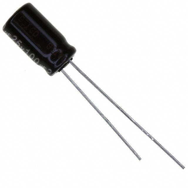

    22 µF 63 V 铝电解电容器 径向,Can 105°C 时为 7000 小时
EEU-EB1J220B 数据手册
Aluminum Electrolytic Capacitors/ EB Radial Lead Type Series: EB Type: A ■ Features ● Endurance : +105 °C 5000 h to 10000 h ● Hight ripple hight frequency (Hight Voltage) ● RoHS directive compliant ■ Specifications Category Temp. Range Rated W.V. Range Nominal Cap. Range Capacitance Tolerance –40 °C to +105 °C 10 V.DC to 63 V.DC 0.47 µF to 3300 µF –25 °C to +105 °C 160 V.DC to 450 V.DC 10 µF to 330 µF ±20 % (120 Hz/+20 °C) I < 0.01 CV or 3 (µA) After 2 minutes application of rated working voltage at +20 °C (Whichever is greater) DC Leakage Current tan δ Please see the attached standard products list After following life test with DC voltage and +105 °C±2 °C ripple current value applied (The sum of DC and ripple peak voltage shall not exceed the rated working voltage), when the capacitors are restord to 20 °C, the capacitors shall meet the limits specified below. (10 to 63 V.DC) Duration : φ5҂11 to φ8҂11.5 : 5000 hours φ5҂15 to φ6.3҂15 : 7000 hours φ8҂15 to φ12.5҂25 : 10000 hours Capacitance change ±30 % of initial measured value tan δ < 300 % of initial specified value DC leakage current < initial specified value Endurance (160 to 450 V.DC) Duration : 5000 hours Capacitance change ±20 % of initial measured value tan δ < 200 % of initial specified value DC leakage current < initial specified value After storage for 1000 hours at +105 °C±2 °C with no voltage applied and then being stabilized at +20 °C, capacitors shall meet the limits specified in Endurance. (With voltage treatment) Shelf Life ■ Frequency correction factor for ripple current (10 ~ 63 V.DC) Frequency (Hz) Capacitance (µF) 1000 120 1k 10 k 100 k Frequency (Hz) W. V. (V. DC) 120 1k 10 k to 30k 30 k to 100k 10 0.75 1.00 1.40 1.55 1.65 160 to 250 0.55 0.85 0.90 1.00 470 0.85 1.00 1.20 1.25 1.30 350 to 450 0.50 0.80 0.90 1.00 to 3300 0.95 1.00 1.05 1.10 1.15 0.47 to 22 60 to ■ Dimensions in mm (not to scale) Sleeve Pressure relief φ6.3< (Unit : mm) φ5 to φ8 φd±0.05 φ10< + L✽ 14 min. φD±0.5 3 min. F±0.5 – φD±0.5 ✽ L20 : L±2.0 Body Dia. φD Lead Dia. φd Lead space F 5 0.5 2.0 6.3 0.5 2.5 8 0.6 3.5 10 0.6 5.0 12.5 0.6 5.0 16 0.8 7.5 Design and specifications are each subject to change without notice. Ask factory for the current technical specifications before purchase and/or use. Should a safety concern arise regarding this product, please be sure to contact us immediately. – EEE-87 – 18 0.8 7.5 00 Nov. 2012 Aluminum Electrolytic Capacitors/ EB ■ Standard Products Endurance : 105 °C φ5҂11 to φ8҂11.5=5000 h, φ5×15 to φ6.3҂15=7000 h, φ8×15 to φ12.5҂25=10000 h Case size Specification Lead Length Ripple tan δ Endur- Lead Lead Space Cap. W.V. ance Dia. (±20 %) Dia. Length Current Taping Taping (120 Hz) (120 Hz) Straight ✽B ✽H (+105 °C) (+20 °C) (V) (µF) (mm) (mm) (mA r.m.s.) (hours) (mm) (mm) (mm) (mm) 5 15 105 0.30 7000 0.5 2.0 5.0 2.5 100 5 11 66 0.30 5000 0.5 2.0 5.0 2.5 6.3 15 152 0.30 7000 0.5 2.5 5.0 2.5 220 6.3 11.2 100 0.30 5000 0.5 2.5 5.0 2.5 10 8 15 278 0.30 10000 0.6 3.5 5.0 470 8 11.5 180 0.30 5000 0.6 3.5 5.0 2200 12.5 20 540 0.32 10000 0.6 5.0 5.0 3300 12.5 25 802 0.34 10000 0.6 5.0 5.0 1000 10 20 430 0.25 10000 0.6 5.0 5.0 16 2200 12.5 25 706 0.27 10000 0.6 5.0 5.0 5 15 78 0.22 7000 0.5 2.0 5.0 2.5 47 5 11 55 0.22 5000 0.5 2.0 5.0 2.5 6.3 15 135 0.22 7000 0.5 2.5 5.0 2.5 100 6.3 11.2 95 0.22 5000 0.5 2.5 5.0 2.5 25 220 8 11.5 125 0.22 5000 0.6 3.5 5.0 330 8 15 255 0.22 10000 0.6 3.5 5.0 470 10 16 321 0.22 10000 0.6 5.0 5.0 1000 12.5 20 498 0.22 10000 0.6 5.0 5.0 5 15 66 0.18 7000 0.5 2.0 5.0 2.5 33 5 11 46 0.18 5000 0.5 2.0 5.0 2.5 220 8 15 197 0.18 10000 0.6 3.5 5.0 35 330 10 16 278 0.18 10000 0.6 5.0 5.0 470 10 20 349 0.18 10000 0.6 5.0 5.0 1000 12.5 25 586 0.18 10000 0.6 5.0 5.0 0.47 5 11 4 0.15 5000 0.5 2.0 5.0 2.5 1 5 11 8 0.15 5000 0.5 2.0 5.0 2.5 2.2 5 11 15 0.15 5000 0.5 2.0 5.0 2.5 3.3 5 11 18 0.15 5000 0.5 2.0 5.0 2.5 4.7 5 11 18 0.15 5000 0.5 2.0 5.0 2.5 10 5 11 27 0.15 5000 0.5 2.0 5.0 2.5 5 15 55 0.15 7000 0.5 2.0 5.0 2.5 50 22 5 11 39 0.15 5000 0.5 2.0 5.0 2.5 6.3 15 87 0.15 7000 0.5 2.5 5.0 2.5 47 6.3 11.2 61 0.15 5000 0.5 2.5 5.0 2.5 100 8 11.5 99 0.15 5000 0.6 3.5 5.0 220 10 16 234 0.15 10000 0.6 5.0 5.0 330 10 20 293 0.15 10000 0.6 5.0 5.0 470 12.5 20 370 0.15 10000 0.6 5.0 5.0 5 15 6 0.12 7000 0.5 2.0 5.0 2.5 0.47 5 11 4.5 0.12 5000 0.5 2.0 5.0 2.5 5 15 12 0.12 7000 0.5 2.0 5.0 2.5 1 5 11 9 0.12 5000 0.5 2.0 5.0 2.5 5 15 22 0.12 7000 0.5 2.0 5.0 2.5 2.2 5 11 16.5 0.12 5000 0.5 2.0 5.0 2.5 5 15 30 0.12 7000 0.5 2.0 5.0 2.5 3.3 5 11 20 0.12 5000 0.5 2.0 5.0 2.5 5 15 30 0.12 7000 0.5 2.0 5.0 2.5 4.7 5 11 23 0.12 5000 0.5 2.0 5.0 2.5 5 15 46 0.12 7000 0.5 2.0 5.0 2.5 63 10 5 11 30 0.12 5000 0.5 2.0 5.0 2.5 6.3 15 55 0.12 7000 0.5 2.5 5.0 2.5 22 6.3 11.2 40 0.12 5000 0.5 2.5 5.0 2.5 6.3 15 71 0.12 7000 0.5 2.5 5.0 2.5 33 6.3 11.2 50 0.12 5000 0.5 2.5 5.0 2.5 8 15 94 0.12 10000 0.6 3.5 5.0 47 8 11.5 80 0.12 5000 0.6 3.5 5.0 100 8 15 180 0.12 10000 0.6 3.5 5.0 220 10 20 292 0.12 10000 0.6 5.0 5.0 330 12.5 20 381 0.12 10000 0.6 5.0 5.0 470 12.5 25 454 0.12 10000 0.6 5.0 5.0 Min. Packaging Q'ty Part No. EEUEB1A101( ) EEUEB1A101S( ) EEUEB1A221( ) EEUEB1A221S( ) EEUEB1A471( ) EEUEB1A471S( ) EEUEB1A222( ) EEUEB1A332( ) EEUEB1C102( ) EEUEB1C222( ) EEUEB1E470( ) EEUEB1E470S( ) EEUEB1E101( ) EEUEB1E101S( ) EEUEB1E221S( ) EEUEB1E331( ) EEUEB1E471( ) EEUEB1E102( ) EEUEB1V330( ) EEUEB1V330S( ) EEUEB1V221( ) EEUEB1V331( ) EEUEB1V471( ) EEUEB1V102( ) EEUEB1HR47S( ) EEUEB1H1R0S( ) EEUEB1H2R2S( ) EEUEB1H3R3S( ) EEUEB1H4R7S( ) EEUEB1H100S( ) EEUEB1H220( ) EEUEB1H220S( ) EEUEB1H470( ) EEUEB1H470S( ) EEUEB1H101S( ) EEUEB1H221( ) EEUEB1H331( ) EEUEB1H471( ) EEUEB1JR47( ) EEUEB1JR47S( ) EEUEB1J1R0( ) EEUEB1J1R0S( ) EEUEB1J2R2( ) EEUEB1J2R2S( ) EEUEB1J3R3( ) EEUEB1J3R3S( ) EEUEB1J4R7( ) EEUEB1J4R7S( ) EEUEB1J100( ) EEUEB1J100S( ) EEUEB1J220( ) EEUEB1J220S( ) EEUEB1J330( ) EEUEB1J330S( ) EEUEB1J470( ) EEUEB1J470S( ) EEUEB1J101( ) EEUEB1J221( ) EEUEB1J331( ) EEUEB1J471( ) Straight Taping Leads (pcs) 200 200 200 200 200 200 200 200 200 200 200 200 200 200 200 200 200 200 200 200 200 200 200 200 200 200 200 200 200 200 200 200 200 200 200 200 200 200 200 200 200 200 200 200 200 200 200 200 200 200 200 200 200 200 200 200 200 200 200 200 (pcs) 2000 2000 2000 2000 1000 1000 500 500 500 500 2000 2000 2000 2000 1000 1000 500 500 2000 2000 1000 500 500 500 2000 2000 2000 2000 2000 2000 2000 2000 2000 2000 1000 500 500 500 2000 2000 2000 2000 2000 2000 2000 2000 2000 2000 2000 2000 2000 2000 2000 2000 1000 1000 1000 500 500 500 · When requesting taped product, please put the letter "B" or "H" between the "( )". Lead wire pitch B=5 mm, 7.5 mm, H=2.5 mm. · Please refer to the page of “Taping Dimensions”. Design and specifications are each subject to change without notice. Ask factory for the current technical specifications before purchase and/or use. Should a safety concern arise regarding this product, please be sure to contact us immediately. – EEE-88 – 00 Nov. 2012 Aluminum Electrolytic Capacitors/ EB ■ Standard Products Endurance : 105 °C 5000 h Case size W.V. (V) Cap. (±20 %) (µF) 22 33 47 68 160 100 150 220 330 22 33 47 68 200 100 150 220 22 33 47 250 68 100 150 10 22 33 350 47 68 100 10 22 400 33 47 10 22 450 33 47 Dia. (mm) 10 10 12.5 12.5 16 16 18 16 18 16 18 18 10 12.5 12.5 12.5 16 16 18 16 18 18 12.5 12.5 12.5 16 16 18 16 18 18 10 12.5 16 16 18 16 18 18 10 12.5 16 16 18 16 18 12.5 16 18 16 18 18 Specification Ripple tan δ EndurCurrent ance Length (100 kHz) (120 Hz) (+105 °C) (+20 °C) (mm) (mA r.m.s.) (hours) 20 470 0.15 5000 20 470 0.15 5000 20 600 0.15 5000 25 750 0.15 5000 20 750 0.15 5000 25 1060 0.15 5000 20 1060 0.15 5000 31.5 1280 0.15 5000 25 1280 0.15 5000 31.5 1280 0.15 5000 25 1280 0.15 5000 31.5 1690 0.15 5000 20 470 0.15 5000 20 600 0.15 5000 20 600 0.15 5000 25 750 0.15 5000 20 750 0.15 5000 25 1060 0.15 5000 20 1060 0.15 5000 31.5 1280 0.15 5000 25 1280 0.15 5000 31.5 1690 0.15 5000 20 560 0.15 5000 20 560 0.15 5000 25 710 0.15 5000 20 710 0.15 5000 25 990 0.15 5000 20 990 0.15 5000 31.5 1200 0.15 5000 25 1200 0.15 5000 31.5 1470 0.15 5000 20 270 0.20 5000 20 350 0.20 5000 20 480 0.20 5000 25 640 0.20 5000 20 640 0.20 5000 31.5 780 0.20 5000 25 780 0.20 5000 31.5 970 0.20 5000 20 250 0.24 5000 25 410 0.24 5000 20 410 0.24 5000 25 600 0.24 5000 20 600 0.24 5000 31.5 730 0.24 5000 25 730 0.24 5000 20 310 0.24 5000 25 560 0.24 5000 20 560 0.24 5000 31.5 680 0.24 5000 25 680 0.24 5000 31.5 850 0.24 5000 Lead Length Lead Lead Space Dia. Taping Straight ✽B (mm) 0.6 0.6 0.6 0.6 0.8 0.8 0.8 0.8 0.8 0.8 0.8 0.8 0.6 0.6 0.6 0.6 0.8 0.8 0.8 0.8 0.8 0.8 0.6 0.6 0.6 0.8 0.8 0.8 0.8 0.8 0.8 0.6 0.6 0.8 0.8 0.8 0.8 0.8 0.8 0.6 0.6 0.8 0.8 0.8 0.8 0.8 0.6 0.8 0.8 0.8 0.8 0.8 (mm) 5.0 5.0 5.0 5.0 7.5 7.5 7.5 7.5 7.5 7.5 7.5 7.5 5.0 5.0 5.0 5.0 7.5 7.5 7.5 7.5 7.5 7.5 5.0 5.0 5.0 7.5 7.5 7.5 7.5 7.5 7.5 5.0 5.0 7.5 7.5 7.5 7.5 7.5 7.5 5.0 5.0 7.5 7.5 7.5 7.5 7.5 5.0 7.5 7.5 7.5 7.5 7.5 (mm) 5.0 5.0 5.0 5.0 7.5 7.5 7.5 – 7.5 – 7.5 – 5.0 5.0 5.0 5.0 7.5 7.5 7.5 – 7.5 – 5.0 5.0 5.0 7.5 7.5 7.5 – 7.5 – 5.0 5.0 7.5 7.5 7.5 – 7.5 – 5.0 5.0 7.5 7.5 7.5 – 7.5 5.0 7.5 7.5 – 7.5 – Min. Packaging Q'ty Part No. EEUEB2C220( ) EEUEB2C330( ) EEUEB2C470( ) EEUEB2C680( ) EEUEB2C680S( ) EEUEB2C101( ) EEUEB2C101S( ) EEUEB2C151 EEUEB2C151S( ) EEUEB2C221 EEUEB2C221S( ) EEUEB2C331 EEUEB2D220( ) EEUEB2D330( ) EEUEB2D470( ) EEUEB2D680( ) EEUEB2D680S( ) EEUEB2D101( ) EEUEB2D101S( ) EEUEB2D151 EEUEB2D151S( ) EEUEB2D221 EEUEB2E220( ) EEUEB2E330( ) EEUEB2E470( ) EEUEB2E470S( ) EEUEB2E680( ) EEUEB2E680S( ) EEUEB2E101 EEUEB2E101S( ) EEUEB2E151 EEUEB2V100( ) EEUEB2V220( ) EEUEB2V330S( ) EEUEB2V470( ) EEUEB2V470S( ) EEUEB2V680 EEUEB2V680S( ) EEUEB2V101 EEUEB2G100( ) EEUEB2G220( ) EEUEB2G220S( ) EEUEB2G330( ) EEUEB2G330S( ) EEUEB2G470 EEUEB2G470S( ) EEUEB2W100( ) EEUEB2W220( ) EEUEB2W220S( ) EEUEB2W330( ) EEUEB2W330S( ) EEUEB2W470 Straight Taping Leads (pcs) 200 200 200 200 100 100 100 100 100 100 100 50 200 200 200 200 100 100 100 100 100 100 200 200 200 100 100 100 100 100 50 200 200 100 100 100 100 100 50 200 200 100 100 100 100 100 200 100 100 100 100 50 (pcs) 500 500 500 500 250 250 250 – 250 – 250 – 500 500 500 500 250 250 250 – 250 – 500 500 500 250 250 250 – 250 – 500 500 250 250 250 – 250 – 500 500 250 250 250 – 250 500 250 250 – 250 – · When requesting taped product, please put the letter "B" between the "( )". Lead wire pitch B=5 mm, 7.5 mm. · Please refer to the page of “Taping Dimensions”. Design and specifications are each subject to change without notice. Ask factory for the current technical specifications before purchase and/or use. Should a safety concern arise regarding this product, please be sure to contact us immediately. – EEE-89 – 00 Nov. 2012
