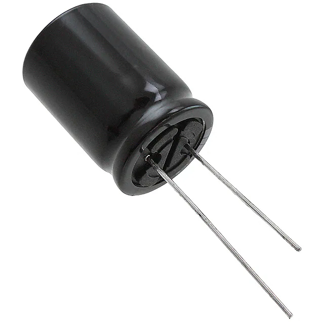

EEU-TP1E332SB
EEU-TP1E332SB
    NAIS(松下)
    插件,D18xL25mm
    3300UF ±20% 25V
EEU-TP1E332SB 数据手册
Aluminum Electrolytic Capacitors This Series is no longer available for purchase in the country of Japan. Radial Lead Type TP series A type Features ● ● ● ● ● Endurance : 125 ℃ 2000 h to 5000 h or 135 ℃ 1000 h to 2000 h Smaller than series TA High ripple current (at high frequency) : 20 to 40% higher than TA series AEC-Q200 compliant RoHS compliant Specifications Category temp. range Rated voltage range Capacitance range Capacitance tolerance Leakage current –40 ℃ to +135 ℃ 25 V to 35 V 100 μF to 5100 μF ±20 % (120 Hz / +20℃) I ≦ 0.01 CV (μA) After 2 minutes Rated voltage(V) 25 35 (120 Hz /+20℃) Dissipation factor(tan δ) Dissipation factor(tan δ) 0.14 0.12 For capacitance value ≧ 1000 μF , add 0.02 per every 1000 μF. After following life test with DC voltage and +125 ℃±2 ℃ ripple current value applied (The sum of DC and ripple peak voltage shall not exceed the rated working voltage)when the capacitors are restored to 20 ℃, the capacitors shall meet the limits specified bellow. φ8 : 2000 h, φ10 : 3000 h, φ12.5 : 4000 h, φ16 to φ18 : 5000 h Endurance 1 Capacitance change Within ±30 % of the initial value Dissipation factor(tan δ) ≦ 300 % of the initial limit DC leakage current Within the initial limit After following life test with DC voltage and +135 ℃±2 ℃ ripple current value applied (The sum of DC and ripple peak voltage shall not exceed the rated working voltage)when the capacitors are restored to 20 ℃, the capacitors shall meet the limits specified bellow. Endurance 2 φ8: 1000 h, φ10 to φ18: 2000 h Capacitance change Within ±30 % of the initial value Dissipation factor(tan δ) ≦ 300 % of the initial limit DC leakage current Within the initial limit After storage for 1000 hours at +125 ℃±2 ℃ with no voltage applied and then being Shelf life 1 stabilized at +20 °C, capacitors shall meet the limits specified in endurance. (With voltage treatment) After storage for 1000 h at +135 ℃±2 ℃ with no voltage applied and then being Shelf life 2 stabilized at +20 °C, capacitors shall meet the limits specified in endurance. (With voltage treatment) Frequency correction factor for ripple current Freq. (Hz) Cap. (μF) 100 to 330 390 to 1000 1200 to 5100 60 120 1k 10 k 100 k 0.55 0.70 0.75 0.65 0.75 0.80 0.85 0.90 0.90 0.90 0.95 0.95 1.00 1.00 1.00 Pressure relief φ8 14min. L* 3min. φD±0.5 * L ≦ 16:L±1.5 φD φd F L ≧ 20:L±2.0 φ10 ≦ F±0.5 Sleeve φd±0.05 Dimensions 8 0.6 3.5 10 0.6 5.0 12.5 0.6 5.0 φD±0.5 16 0.8 7.5 Design and specifications are each subject to change without notice. Ask factory for the current technical specifications before purchase and/or use. Should a safety concern arise regarding this product, please be sure to contact us immediately. Unit:mm 18 0.8 7.5 20-Dec-19 Aluminum Electrolytic Capacitors (Radial Lead Type) TP series Characteristics list Endurance : φ8 / 125℃ 2000 h, φ10 / 125℃ 3000 h, φ12.5 / 125℃ 4000 h, φ16 to φ18 / 125℃ 5000 h Specification Case size Rated voltage (V) Capaci- (μF) 470 510 820 1000 1200 1800 2000 2200 2700 3300 3900 4700 5100 100 120 220 270 35 Ripple *1 current (±20 %) 220 330 25 (mm) tance 330 390 470 560 620 820 1000 1200 1500 1600 1800 2000 2200 2700 φD 10.0 10.0 8.0 10.0 10.0 10.0 12.5 12.5 12.5 16.0 16.0 16.0 18.0 16.0 18.0 16.0 18.0 16.0 18.0 18.0 18.0 10.0 10.0 8.0 10.0 8.0 10.0 10.0 10.0 12.5 12.5 12.5 12.5 16.0 16.0 16.0 18.0 16.0 16.0 18.0 16.0 18.0 18.0 18.0 L 12.5 16.0 20.0 16.0 16.0 20.0 20.0 20.0 25.0 20.0 20.0 25.0 20.0 25.0 20.0 31.5 25.0 31.5 25.0 31.5 31.5 12.5 12.5 20.0 16.0 16.0 16.0 20.0 20.0 20.0 20.0 20.0 25.0 20.0 20.0 25.0 20.0 25.0 31.5 25.0 31.5 25.0 31.5 31.5 (mA rms) 125℃ 135℃ 580 1100 1060 1100 1100 1540 1860 1860 2180 2380 2380 2760 2700 2760 2700 3250 2960 3250 2960 3480 3480 580 580 1060 1100 1060 1100 1540 1540 1860 1860 1860 2180 2380 2380 2760 2700 2760 3250 2960 3250 2960 3480 3480 500 945 760 945 945 1100 1490 1490 1750 1985 1985 2300 2250 2300 2250 2710 2470 2710 2470 2900 2900 500 500 760 945 760 945 1100 1100 1490 1490 1490 1750 1985 1985 2300 2250 2300 2710 2470 2710 2470 2900 2900 ESR*2 (Ω) 0.190 0.130 0.067 0.130 0.130 0.052 0.038 0.038 0.030 0.029 0.029 0.022 0.028 0.022 0.028 0.018 0.020 0.018 0.020 0.016 0.016 0.190 0.190 0.067 0.130 0.067 0.130 0.052 0.052 0.038 0.038 0.038 0.030 0.029 0.029 0.022 0.028 0.022 0.018 0.020 0.018 0.020 0.016 0.016 Lead length (mm) Endurance tan δ*3 0.14 0.14 0.14 0.14 0.14 0.14 0.14 0.14 0.14 0.14 0.16 0.16 0.16 0.16 0.16 0.18 0.18 0.18 0.18 0.20 0.22 0.12 0.12 0.12 0.12 0.12 0.12 0.12 0.12 0.12 0.12 0.12 0.12 0.12 0.12 0.12 0.12 0.12 0.12 0.12 0.14 0.14 0.14 0.14 (h) 125℃ 135℃ 3000 3000 2000 3000 3000 3000 4000 4000 4000 5000 5000 5000 5000 5000 5000 5000 5000 5000 5000 5000 5000 3000 3000 2000 3000 2000 3000 3000 3000 4000 4000 4000 4000 5000 5000 5000 5000 5000 5000 5000 5000 5000 5000 5000 2000 2000 1000 2000 2000 2000 2000 2000 2000 2000 2000 2000 2000 2000 2000 2000 2000 2000 2000 2000 2000 2000 2000 1000 2000 1000 2000 2000 2000 2000 2000 2000 2000 2000 2000 2000 2000 2000 2000 2000 2000 2000 2000 2000 Part No. ★:Substandard (E24 series Taping numbers) Straight ✽B Lead space Lead dia. (φd) 0.6 0.6 0.6 0.6 0.6 0.6 0.6 0.6 0.6 0.8 0.8 0.8 0.8 0.8 0.8 0.8 0.8 0.8 0.8 0.8 0.8 0.6 0.6 0.6 0.6 0.6 0.6 0.6 0.6 0.6 0.6 0.6 0.6 0.8 0.8 0.8 0.8 0.8 0.8 0.8 0.8 0.8 0.8 0.8 5.0 5.0 3.5 5.0 5.0 5.0 5.0 5.0 5.0 7.5 7.5 7.5 7.5 7.5 7.5 7.5 7.5 7.5 7.5 7.5 7.5 5.0 5.0 3.5 5.0 3.5 5.0 5.0 5.0 5.0 5.0 5.0 5.0 7.5 7.5 7.5 7.5 7.5 7.5 7.5 7.5 7.5 7.5 7.5 5.0 5.0 5.0 5.0 5.0 5.0 5.0 5.0 5.0 7.5 7.5 7.5 7.5 7.5 7.5 ― 7.5 ― 7.5 ― ― 5.0 5.0 5.0 5.0 5.0 5.0 5.0 5.0 5.0 5.0 5.0 5.0 7.5 7.5 7.5 7.5 7.5 ― 7.5 ― 7.5 ― ― Min. Packaging Q'ty (PCS) StraiTapght ing leads 200 200 EEUTP1E471L( ) 200 EEUTP1E471( ) 200 EEUTP1E511( )★ 200 EEUTP1E821( ) 200 EEUTP1E102( ) 200 EEUTP1E122( ) 200 EEUTP1E182( ) 200 EEUTP1E182S( ) 100 EEUTP1E202S( )★ 100 EEUTP1E222( ) 100 EEUTP1E222S( ) 100 EEUTP1E272( ) 100 EEUTP1E272S( ) 100 EEUTP1E332 100 EEUTP1E332S( ) 100 EEUTP1E392 100 EEUTP1E392S( ) 100 EEUTP1E472 50 ★ 50 EEUTP1E512 EEUTP1V101( ) 200 EEUTP1V121( ) 200 EEUTP1V221L( ) 200 EEUTP1V221( ) 200 EEUTP1V271L( ) 200 EEUTP1V271( ) 200 EEUTP1V331( ) 200 EEUTP1V391( ) 200 EEUTP1V471( ) 200 EEUTP1V561( ) 200 EEUTP1V621( )★ 200 EEUTP1V821( ) 200 EEUTP1V102( ) 100 EEUTP1V122( ) 100 EEUTP1V152( ) 100 EEUTP1V152S( ) 100 EEUTP1V162( )★ 100 EEUTP1V182 100 EEUTP1V182S( ) 100 100 EEUTP1V202★ EEUTP1V202S( )★ 100 EEUTP1V222 50 EEUTP1V272 50 EEUTP1E221( ) EEUTP1E331( ) 500 500 1000 500 500 500 500 500 500 250 250 250 250 250 250 ― 250 ― 250 ― ― 500 500 1000 500 1000 500 500 500 500 500 500 500 250 250 250 250 250 ― 250 250 ― ― *1: Ripple current (100 kHz) *2: ESR (100 kHz / +20 ℃) *3: tan δ(120 Hz / +20 ℃) ・ When requesting taped product, please put the letter "B" be tween the "( )". Lead wire pitch ✽B=5 mm, 7.5 mm. ・ Please refer to the page of “Taping dimensions”. Design and specifications are each subject to change without notice. Ask factory for the current technical specifications before purchase and/or use. Should a safety concern arise regarding this product, please be sure to contact us immediately. 20-Dec-19 *XLGHOLQHVDQGSUHFDXWLRQVUHJDUGLQJWKH WHFKQLFDOLQIRUPDWLRQDQGXVHRIRXUSURGXFWV GHVFULEHGLQWKLVRQOLQHFDWDORJ ‫ٹ‬,I\RXZDQWWRXVHRXUSURGXFWVGHVFULEHGLQWKLVRQOLQHFDWDORJIRUDSSOLFDWLRQVUHTXLULQJ VSHFLDOTXDOLWLHVRUUHOLDELOLW\RUIRUDSSOLFDWLRQVZKHUHWKHIDLOXUHRUPDOIXQFWLRQRIWKH SURGXFWVPD\GLUHFWO\MHRSDUGL]HKXPDQOLIHRUSRWHQWLDOO\FDXVHSHUVRQDOLQMXU\  HJDLUFUDIWDQGDHURVSDFHHTXLSPHQWWUDIILFDQGWUDQVSRUWDWLRQHTXLSPHQWFRPEXVWLRQ HTXLSPHQWPHGLFDOHTXLSPHQWDFFLGHQWSUHYHQWLRQDQWLFULPHHTXLSPHQWDQGRUVDIHW\ HTXLSPHQW LWLVQHFHVVDU\WRYHULI\ZKHWKHUWKHVSHFLILFDWLRQVRIRXUSURGXFWVILWWRVXFK DSSOLFDWLRQV3OHDVHHQVXUHWKDW\RXZLOODVNDQGFKHFNZLWKRXULQTXLU\GHVNDVWRZKHWKHU WKHVSHFLILFDWLRQVRIRXUSURGXFWVILWWRVXFKDSSOLFDWLRQVXVHEHIRUH\RXXVHRXUSURGXFWV ‫ٹ‬7KHTXDOLW\DQGSHUIRUPDQFHRIRXUSURGXFWVDVGHVFULEHGLQWKLVRQOLQHFDWDORJRQO\DSSO\ WRRXUSURGXFWVZKHQXVHGLQLVRODWLRQ7KHUHIRUHSOHDVHHQVXUH\RXHYDOXDWHDQGYHULI\ RXUSURGXFWVXQGHUWKHVSHFLILFFLUFXPVWDQFHVLQZKLFKRXUSURGXFWVDUHDVVHPEOHGLQ\RXU RZQSURGXFWVDQGLQZKLFKRXUSURGXFWVZLOODFWXDOO\EHXVHG ‫ٹ‬,I\RXXVHRXUSURGXFWVLQHTXLSPHQWWKDWUHTXLUHVDKLJKGHJUHHRIUHOLDELOLW\UHJDUGOHVV RIWKHDSSOLFDWLRQLWLVUHFRPPHQGHGWKDW\RXVHWXSSURWHFWLRQFLUFXLWVDQGUHGXQGDQF\ FLUFXLWVLQRUGHUWRHQVXUHVDIHW\RI\RXUHTXLSPHQW ‫ٹ‬7KHSURGXFWVDQGSURGXFWVSHFLILFDWLRQVGHVFULEHGLQWKLVRQOLQHFDWDORJDUHVXEMHFWWR FKDQJHIRULPSURYHPHQWZLWKRXWSULRUQRWLFH7KHUHIRUHSOHDVHEHVXUHWRUHTXHVWDQG FRQILUPWKHODWHVWSURGXFWVSHFLILFDWLRQVZKLFKH[SODLQWKHVSHFLILFDWLRQVRIRXUSURGXFWVLQ GHWDLOEHIRUH\RXILQDOL]HWKHGHVLJQRI\RXUDSSOLFDWLRQVSXUFKDVHRUXVHRXUSURGXFWV ‫ٹ‬7KHWHFKQLFDOLQIRUPDWLRQLQWKLVRQOLQHFDWDORJSURYLGHVH[DPSOHVRIRXUSURGXFWV  W\SLFDORSHUDWLRQVDQGDSSOLFDWLRQFLUFXLWV:HGRQRWJXDUDQWHHWKHQRQLQIULQJHPHQWRI WKLUGSDUW\ VLQWHOOHFWXDOSURSHUW\ULJKWVDQGZHGRQRWJUDQWDQ\OLFHQVHULJKWRULQWHUHVW LQRXULQWHOOHFWXDOSURSHUW\ ‫ٹ‬,IDQ\RIRXUSURGXFWVSURGXFWVSHFLILFDWLRQVDQGRUWHFKQLFDOLQIRUPDWLRQLQWKLVRQOLQH FDWDORJLVWREHH[SRUWHGRUSURYLGHGWRQRQUHVLGHQWVWKHODZVDQGUHJXODWLRQVRIWKH H[SRUWLQJFRXQWU\HVSHFLDOO\ZLWKUHJDUGWRVHFXULW\DQGH[SRUWFRQWUROVKDOOEHREVHUYHG 5HJDUGLQJWKH&HUWLILFDWHRI&RPSOLDQFHZLWK WKH(85R+6'LUHFWLYH5($&+5HJXODWLRQV! ‫ٹ‬7KHVZLWFKRYHUGDWHIRUFRPSOLDQFHZLWKWKH5R+6'LUHFWLYH5($&+5HJXODWLRQVYDULHV GHSHQGLQJRQWKHSDUWQXPEHURUVHULHVRIRXUSURGXFWV ‫ٹ‬:KHQ\RXXVHWKHLQYHQWRU\RIRXUSURGXFWVIRUZKLFKLWLVXQFOHDUZKHWKHUWKRVHSURGXFWV DUHFRPSOLDQWZLWKWKH5R+6'LUHFWLYH5($&+5HJXODWLRQSOHDVHVHOHFW6DOHV,QTXLU\LQWKH ZHEVLWHLQTXLU\IRUPDQGFRQWDFWXV :HGRQRWWDNHDQ\UHVSRQVLELOLW\IRUWKHXVHRIRXUSURGXFWVRXWVLGHWKHVFRSHRIWKH VSHFLILFDWLRQVGHVFULSWLRQVJXLGHOLQHVDQGSUHFDXWLRQVGHVFULEHGLQWKLVRQOLQHFDWDORJ 'HF 1RWLFHV,WHPVWREHREVHUYHG 1RWLFHV ‫ٹ‬$SSOLFDEOHODZVDQGUHJXODWLRQV 嵣7KLVSURGXFWFRPSOLHVZLWKWKH5R+6'LUHFWLYH 5HVWULFWLRQRIWKHXVHRIFHUWDLQKD]DUGRXVVXEVWDQFHVLQ HOHFWULFDODQGHOHFWURQLFHTXLSPHQW ',5(&7,9((8DQG‫(ق‬8   嵣1R2]RQH'HSOHWLQJ&KHPLFDOV 2'& V FRQWUROOHGXQGHUWKH0RQWUHDO3URWRFRO$JUHHPHQWDUHXVHGLQ SURGXFLQJWKLVSURGXFW 岜:HGRQRWXVH3%%VRU3%'(VDVEURPLQDWHGIODPHUHWDUGDQWV 嵣([SRUWSURFHGXUHZKLFKIROORZHGH[SRUWUHODWHGUHJXODWLRQVVXFKDVIRUHLJQH[FKDQJHDQGDIRUHLJQWUDGH PHWKRGRQWKHRFFDVLRQRIH[SRUWRIWKLVSURGXFW 嵣7KHVHSURGXFWVDUHQRWGDQJHURXVJRRGVRQWKHWUDQVSRUWDWLRQDVLGHQWLILHGE\81 8QLWHG1DWLRQV QXPEHUV RU81FODVVLILFDWLRQ ‫ٹ‬/LPLWHGDSSOLFDWLRQV 嵣7KLVFDSDFLWRULVGHVLJQHGWREHXVHGIRUHOHFWURQLFVFLUFXLWVVXFKDVDXGLRYLVXDOHTXLSPHQWKRPH DSSOLDQFHVFRPSXWHUVDQGRWKHURIILFHHTXLSPHQWRSWLFDOHTXLSPHQWPHDVXULQJHTXLSPHQW 嵣+LJKUHOLDELOLW\DQGVDIHW\DUHUHTXLUHG>EHDSRVVLELOLW\WKDWLQFRUUHFWRSHUDWLRQRIWKLVSURGXFWPD\GRKDUP 岜WRDKXPDQOLIHRUSURSHUW\@PRUH:KHQXVHLVFRQVLGHUHGE\WKHXVHWKHGHOLYHU\VSHFLILFDWLRQVZKLFKVXLWHG WKHXVHVHSDUDWHO\QHHGWREHH[FKDQJHG ‫ٹ‬,QWHOOHFWXDOSURSHUW\ULJKWVDQGOLFHQVHV 嵣7KHWHFKQLFDOLQIRUPDWLRQLQWKLVVSHFLILFDWLRQSURYLGHVH[DPSOHVRIRXUSURGXFWV W\SLFDORSHUDWLRQVDQGDSSOLFDWLRQ FLUFXLWV:HGRQRWJXDUDQWHHWKHQRQLQIULQJHPHQWRIWKLUGSDUW\ VLQWHOOHFWXDOSURSHUW\ULJKWVDQGZHGRQRWJUDQW DQ\OLFHQVHULJKWRULQWHUHVWLQRXULQWHOOHFWXDOSURSHUW\ ,WHPVWREHREVHUYHG ‫)ٹ‬RUVSHFLILFDWLRQ 嵣7KLVVSHFLILFDWLRQJXDUDQWHHVWKHTXDOLW\DQGSHUIRUPDQFHRIWKHSURGXFWDVLQGLYLGXDOFRPSRQHQWV 7KHGXUDELOLW\GLIIHUVGHSHQGLQJRQWKHHQYLURQPHQWDQGWKHFRQGLWLRQVRIXVDJH %HIRUHXVHFKHFNDQGHYDOXDWHWKHLUFRPSDWLELOLW\ZLWKDFWXDOFRQGLWLRQVZKHQLQVWDOOHGLQWKHSURGXFWV :KHQVDIHW\UHTXLUHPHQWVFDQQRWEHVDWLVILHGLQ\RXUWHFKQLFDOH[DPLQDWLRQLQIRUPXVLPPHGLDWHO\ 嵣'RQRWXVHWKHSURGXFWVEH\RQGWKHVSHFLILFDWLRQVGHVFULEHGLQWKLVGRFXPHQW ‫ٹ‬8SRQDSSOLFDWLRQWRSURGXFWVZKHUHVDIHW\LVUHJDUGHGDVLPSRUWDQW ,QVWDOOWKHIROORZLQJV\VWHPVIRUDIDLOVDIHGHVLJQWRHQVXUHVDIHW\LIWKHVHSURGXFWVDUHWREHXVHGLQ HTXLSPHQWZKHUHDGHIHFWLQWKHVHSURGXFWVPD\FDXVHWKHORVVRIKXPDQOLIHRURWKHUVLJQLILFDWLRQGDPDJH VXFKDVGDPDJHWRYHKLFOHV DXWRPRELOHWUDLQYHVVHO WUDIILFOLJKWVPHGLFDOHTXLSPHQWDHURVSDFHHTXLSPHQW HOHFWULFKHDWLQJDSSOLDQFHVFRPEXVWLRQJDVHTXLSPHQWURWDWLQJURWDWLQJHTXLSPHQWDQGGLVDVWHUFULPH SUHYHQWLRQHTXLSPHQW  7KHV\VWHPLVHTXLSSHGZLWKDSURWHFWLRQFLUFXLWDQGSURWHFWLRQGHYLFH  7KHV\VWHPLVHTXLSSHGZLWKDUHGXQGDQWFLUFXLWRURWKHUV\VWHPWRSUHYHQWDQXQVDIHVWDWXVLQWKHHYHQW RIDVLQJOHIDXOW ‫&ٹ‬RQGLWLRQVRIXVH 嵣%HIRUHXVLQJWKHSURGXFWVFDUHIXOO\FKHFNWKHHIIHFWVRQWKHLUTXDOLW\DQGSHUIRUPDQFHDQGGHWHUPLQHG 岜ZKHWKHURUQRWWKH\FDQEHXVHG7KHVHSURGXFWVDUHGHVLJQHGDQGPDQXIDFWXUHGIRUJHQHUDOSXUSRVHDQG 岜VWDQGDUGXVHLQJHQHUDOHOHFWURQLFHTXLSPHQW7KHVHSURGXFWVDUHQRWLQWHQGHGIRUXVHLQWKHIROORZLQJVSHFLDO 岜FRQGLWLRQV  ,QOLTXLGVXFKDV:DWHU2LO&KHPLFDOVRU2UJDQLFVROYHQW  ,QGLUHFWVXQOLJKWRXWGRRUVRULQGXVW  ,QYDSRUVXFKDVGHZFRQGHQVDWLRQZDWHURIUHVLVWLYHHOHPHQWRUZDWHUOHDNDJHVDOW\DLURUDLUZLWKD KLJKFRQFHQWUDWLRQFRUURVLYHJDVVXFKDV&O+61+62RU12[  ,QDQHQYLURQPHQWZKHUHVWURQJVWDWLFHOHFWULFLW\RUHOHFWURPDJQHWLFZDYHVH[LVW  0RXQWLQJRUSODFLQJKHDWJHQHUDWLQJFRPSRQHQWVRULQIODPPDEOHVVXFKDVYLQ\OFRDWHGZLUHVQHDU WKHVHSURGXFWV  6HDOLQJRUFRDWLQJRIWKHVHSURGXFWVRUDSULQWHGFLUFXLWERDUGRQZKLFKWKHVHSURGXFWVDUHPRXQWHG ZLWKUHVLQDQGRWKHUPDWHULDO  8VLQJUHVROYHQWZDWHURUZDWHUVROXEOHFOHDQHUIRUIOX[FOHDQLQJDJHQWDIWHUVROGHULQJ ,QSDUWLFXODU ZKHQXVLQJZDWHURUDZDWHUVROXEOHFOHDQLQJDJHQWEHFDUHIXOQRWWROHDYHZDWHUUHVLGXHV  8VLQJLQWKHDWPRVSKHUHZKHUHVWUD\VDFLGRUDONDOLQH  8VLQJLQWKHDWPRVSKHUHZKHUHWKHUHDUHH[FHVVLYHYLEUDWLRQDQGVKRFN 嵣3OHDVHDUUDQJHFLUFXLWGHVLJQIRUSUHYHQWLQJLPSXOVHRUWUDQVLWLRQDOYROWDJH 岜'RQRWDSSO\YROWDJHZKLFKH[FHHGVWKHIXOOUDWHGYROWDJHZKHQWKHFDSDFLWRUVUHFHLYHLPSXOVHYROWDJH 岜LQVWDQWDQHRXVKLJKYROWDJHKLJKSXOVHYROWDJHHWF 嵣2XUSURGXFWVWKHUHLVDSURGXFWDUHXVLQJDQHOHFWURO\WHVROXWLRQ7KHUHIRUHPLVXVHFDQUHVXOWLQUDSLG 岜GHWHULRUDWLRQRIFKDUDFWHULVWLFVDQGIXQFWLRQVRIHDFKSURGXFW(OHFWURO\WHOHDNDJHGDPDJHVSULQWHGFLUFXLWDQG DIIHFWVSHUIRUPDQFHFKDUDFWHULVWLFVDQGIXQFWLRQVRIFXVWRPHUV\VWHP 'HF $OXPLQXP(OHFWURO\WLF&DSDFLWRUV 5DGLDOOHDG7\SH 岜岜$SSOLFDWLRQJXLGHOLQHV‫ق‬5DGLDOOHDG7\SH‫ك‬ 岜 &LUFXLWGHVLJQ 2SHUDWLQJWHPSHUDWXUHDQGIUHTXHQF\ (OHFWULFDOFKDUDFWHULVWLFVRIWKHFDSDFLWRUDUHOLNHO\WRFKDQJHGXHWRYDULDWLRQLQWHPSHUDWXUHDQGRUIUHTXHQF\ &LUFXLWGHVLJQHUVVKRXOGWDNHWKHVHFKDQJHVLQWRFRQVLGHUDWLRQ  (IIHFWVRIRSHUDWLQJWHPSHUDWXUHRQHOHFWULFDOSDUDPHWHUV $WKLJKHUWHPSHUDWXUHV OHDNDJHFXUUHQWDQGFDSDFLWDQFHLQFUHDVHZKLOHHTXLYDOHQWVHULHVUHVLVWDQFH (65 GHFUHDVHV $WORZHUWHPSHUDWXUHV OHDNDJHFXUUHQWDQGFDSDFLWDQFHGHFUHDVHZKLOHHTXLYDOHQWVHULHVUHVLVWDQFH (65 LQFUHDVHV  (IIHFWVRIIUHTXHQF\RQHOHFWULFDOSDUDPHWHUV $WKLJKHUIUHTXHQFLHV FDSDFLWDQFHDQGLPSHGDQFHGHFUHDVHZKLOHWDQGLQFUHDVHV $WORZHUIUHTXHQFLHV KHDWJHQHUDWHGE\ULSSOHFXUUHQWZLOOULVHGXHWRDQLQFUHDVHLQHTXLYDOHQW VHULHVUHVLVWDQFH (65  2SHUDWLQJWHPSHUDWXUHDQGOLIHH[SHFWDQF\  ([SHFWHGOLIHLVDIIHFWHGE\RSHUDWLQJWHPSHUDWXUH*HQHUDOO\HDFK&UHGXFWLRQLQWHPSHUDWXUHZLOO GRXEOHWKHH[SHFWHGOLIH8VHFDSDFLWRUVDWWKHORZHVWSRVVLEOHWHPSHUDWXUHEHORZWKHXSSHUFDWHJRU\ WHPSHUDWXUH  ,IRSHUDWLQJWHPSHUDWXUHVH[FHHGWKHXSSHUFDWHJRU\OLPLWUDSLGGHWHULRUDWLRQRIHOHFWULFDOSDUDPHWHU ZLOORFFXUDQGLUUHYHUVLEOHGDPDJHZLOOUHVXOW &KHFNIRUWKHPD[LPXPFDSDFLWRURSHUDWLQJWHPSHUDWXUHVLQFOXGLQJDPELHQWWHPSHUDWXUHLQWHUQDO FDSDFLWRUWHPSHUDWXUHULVHGXHWRULSSOHFXUUHQWDQGWKHHIIHFWVRIUDGLDWHGKHDWIURPSRZHUWUDQVLVWRUV ,& VRUUHVLVWRUV $YRLGSODFLQJFRPSRQHQWVZKLFKFRXOGFRQGXFWKHDWWRWKHFDSDFLWRUIURPWKHEDFNVLGHRIWKHFLUFXLWERDUG  7KHIRUPXODIRUFDOFXODWLQJH[SHFWHGOLIHDWORZHURSHUDWLQJWHPSHUDWXUHVLVDVIROORZV 77 / /¼  / ‫*؟‬XDUDQWHHGOLIH K DWWHPSHUDWXUH7& / ‫[(؟‬SHFWHGOLIH K DWWHPSHUDWXUH7& 7 ‫؟‬8SSHUFDWHJRU\WHPSHUDWXUHWHPSHUDWXUHULVHGXHWRUDWHGULSSOHFXUUHQW & 7 ‫؟‬$FWXDORSHUDWLQJWHPSHUDWXUHDPELHQWWHPSHUDWXUHWHPSHUDWXUHULVHGXHWRULSSOHFXUUHQW &  8VLQJWKHFDSDFLWRUEH\RQGWKHHVWLPDWHGOLIHWLPHZLOOUHVXOWLQVKRUWFLUFXLWHOHFWURO\WHOHDNYHQWRSHQ DQGODUJHGHWHULRUDWLRQRIFKDUDFWHULVWLFV7KHOLIHWLPHFDQQRWJRDERYH\HDUVGXHWRDJLQJRIVHDOLQJUXEEHU &RPPRQDSSOLFDWLRQFRQGLWLRQVWRDYRLG 7KHIROORZLQJPLVDSSOLFDWLRQORDGFRQGLWLRQVZLOOFDXVHUDSLGGHWHULRUDWLRQRIDFDSDFLWRUbVHOHFWULFDOSDUDPHWHUV ,QDGGLWLRQUDSLGKHDWLQJDQGJDVJHQHUDWLRQZLWKLQWKHFDSDFLWRUFDQRFFXUFDXVLQJWKHSUHVVXUHUHOLHIYHQW WRRSHUDWHDQGUHVXOWDQWOHDNDJHRIHOHFWURO\WH8QGHUH[WUHPHFRQGLWLRQVH[SORVLRQDQGILUHLJQLWLRQFRXOGUHVXOW 7KHOHDNHGHOHFWURO\WHLVFRPEXVWLEOHDQGHOHFWULFDOO\FRQGXFWLYH  5HYHUVHYROWDJH '&FDSDFLWRUVKDYHSRODULW\7KHUHIRUHSOHDVHGRQRWDSSO\WKHUHYHUVHYROWDJH9HULI\FRUUHFWSRODULW\ EHIRUHLQVHUWLRQ )RUFLUFXLWVZLWKFKDQJLQJRUXQFHUWDLQSRODULW\XVH'&ELSRODUFDSDFLWRUV'&ELSRODUFDSDFLWRUVDUHQRW VXLWDEOHIRUXVHLQ$&FLUFXLWV  &KDUJH'LVFKDUJHDSSOLFDWLRQV 6WDQGDUGFDSDFLWRUVDUHQRWVXLWDEOHIRUXVHLQUHSHDWLQJFKDUJHGLVFKDUJHDSSOLFDWLRQV)RUFKDUJH GLVFKDUJHDSSOLFDWLRQVFRQVXOWXVZLWK\RXUDFWXDODSSOLFDWLRQFRQGLWLRQ )RUUXVKFXUUHQWSOHDVHWRQRUH[FHHG$  212))FLUFXLW 'RQRWXVHFDSDFLWRUVLQFLUFXLWZKHUH212))VZLWFKLQJLVUHSHDWHGPRUHWKDQWLPHVSHUGD\ ,QFDVHRIDSSO\LQJWRWKHWKHVHV212))FLUFXLWFRQVXOWZLWKXVDERXWFLUFXLWFRQGLWLRQDQGVRRQ 'HF $OXPLQXP(OHFWURO\WLF&DSDFLWRUV 5DGLDOOHDG7\SH  2YHUYROWDJH 'RQRWDSSO\YROWDJHVH[FHHGLQJWKHPD[LPXPVSHFLILHGUDWHGYROWDJH9ROWDJHVXSWRWKHVXUJHYROWDJH UDWLQJDUHDFFHSWDEOHIRUVKRUWSHULRGVRIWLPH (QVXUHWKDWWKHVXPRIWKH'&YROWDJHDQGWKHVXSHULPSRVHG$&ULSSOHYROWDJHGRHVQRWH[FHHGWKH UDWHGYROWDJH  5LSSOHFXUUHQW 'RQRWDSSO\ULSSOHFXUUHQWVH[FHHGLQJWKHPD[LPXPVSHFLILHGYDOXH)RUKLJKULSSOHFXUUHQWDSSOLFDWLRQV XVHDFDSDFLWRUGHVLJQHGIRUKLJKULSSOHFXUUHQWV,QDGGLWLRQFRQVXOWXVLIWKHDSSOLHGULSSOHFXUUHQWLVWR EHKLJKHUWKDQWKHPD[LPXPVSHFLILHGYDOXH(QVXUHWKDWUDWHGULSSOHFXUUHQWVWKDWVXSHULPSRVHGRQORZ '&ELDVYROWDJHVGRQRWFDXVHUHYHUVHYROWDJHFRQGLWLRQV (YHQLILWLVZLWKLQDUDWHGULSSOHFXUUHQWLQFDVHWKHSUDFWLFDOXVHLVRYHUWKHSUHGHVFULEHGHQGXUDQFH OLIHWLPHLWFDXVHVWKHLQFUHDVHRIGHWHULRUDWLRQRI(65FKDUDFWHULVWLFDQGWKHLQWHUQDOJHQHUDWLRQKHDWE\ ULSSOHFXUUHQW'XHWRWKLVWKHUHLVVRPHSRVVLELOLW\RIYHQWRSHQEXOJLQJRIVOHHYHDQGUXEEHUHOHFWURO\WH OHDNDJHDQGVKRWFLUFXLWH[SORVLRQDQGLJQLWLRQLQWKHZRUVWFDVH 8VLQJWZRRUPRUHFDSDFLWRUVLQSDUDOOHO  &DSDFLWRUVFRQQHFWHGLQSDUDOOHO 7KHFLUFXLWUHVLVWDQFHFDQFORVHO\DSSUR[LPDWHWKHVHULHVUHVLVWDQFHRIWKHFDSDFLWRUFDXVLQJDQLPEDODQFHRI ULSSOHFXUUHQWORDGVZLWKLQWKHFDSDFLWRUV&DUHIXOZLULQJPHWKRGVFDQPLQLPL]HWKHSRVVLEOHDSSOLFDWLRQRIDQ H[FHVVLYHULSSOHFXUUHQWWRDFDSDFLWRU  &DSDFLWRUVFRQQHFWHGLQVHULHV 'LIIHUHQFHVLQQRUPDO'&OHDNDJHFXUUHQWDPRQJFDSDFLWRUVFDQFDXVHYROWDJHLPEDODQFHV 7KHXVHRIYROWDJHGLYLGHUVKXQWUHVLVWRUVZLWKFRQVLGHUDWLRQWROHDNDJHFXUUHQWVFDQSUHYHQWFDSDFLWRU YROWDJHLPEDODQFHV 127(3OHDVHGRQRWXVHLQWKHVHULHVLQWKHFDVHRIFRQGXFWLYHSRO\PHUK\EULGDOXPLQXPHOHFWURO\WLFFDSDFLWRU &DSDFLWRUPRXQWLQJFRQVLGHUDWLRQV  'RXEOHVLGHGFLUFXLWERDUGV $YRLGZLULQJSDWWHUQUXQVZKLFKSDVVEHWZHHQWKHPRXQWHGFDSDFLWRUDQGWKHFLUFXLWERDUG :KHQGLSSLQJLQWRDVROGHUEDWKDQH[FHVVVROGHUPD\GHSRVLWXQGHUWKHFDSDFLWRUE\FDSLOODU\DFWLRQ FDXVLQJVKRUWFLUFXLWEHWZHHQDQRGHDQGFDWKRGHWHUPLQDOV  &LUFXLW%RDUG+ROH3RVLWLRQLQJ 7KHYLQ\OVOHHYHRIWKHFDSDFLWRUFDQEHGDPDJHGLIVROGHUSDVVHVWKURXJKDOHDGKROHLQWRWKHVXEVHTXHQWO\ SURFHVVHGSDUWV 6SHFLDOFDUHZKHQORFDWLQJKROHSRVLWLRQVLQSUR[LPLW\WRFDSDFLWRUVLVUHFRPPHQGHG  &LUFXLW%RDUG+ROH6SDFLQJ 7KHVSDFLQJRIFLUFXLWERDUGKROHVVKRXOGPDWFKWKHOHDGZLUHVSDFLQJRIFDSDFLWRUVZLWKLQWKHVSHFLILHG WROHUDQFHV,QFRUUHFWVSDFLQJFDQFDXVHDQH[FHVVLYHOHDGZLUHVWUHVVGXULQJWKHLQVHUWLRQSURFHVV 7KLVPD\UHVXOWLQSUHPDWXUHFDSDFLWRUIDLOXUHGXHWRWKHVKRUWRURSHQFLUFXLWLQFUHDVHGOHDNDJHFXUUHQW RUHOHFWURO\WHOHDNDJH  &OHDUDQFHIRUFDVHPRXQWHGSUHVVXUHUHOLHI &DSDFLWRUVZLWKFDVHPRXQWHGSUHVVXUHUHOLHIUHTXLUHVXIILFLHQWFOHDUDQFHWRDOORZIRUSURSHUSUHVVXUH UHOLHIRSHUDWLRQ 7KHPLQLPXPFOHDUDQFHDUHGHSHQGHQWRQFDSDFLWRUGLDPHWHUVDVIROORZV 'LDPPWR'LDPPPPPLQLPXP'LDPPPPPLQLPXP  :LULQJQHDUWKHSUHVVXUHUHOLHI $YRLGORFDWLQJKLJKYROWDJHRUKLJKFXUUHQWZLULQJRUFLUFXLWERDUGSDWKVDERYHWKHSUHVVXUHUHOLHI )ODPPDEOHKLJKWHPSHUDWXUHJDVWKDWH[FHHGV&PD\EHUHOHDVHGZKLFKFRXOGGLVVROYHWKHZLUH LQVXODWLRQDQGLJQLWH  &LUFXLWERDUGSDWWHUQVXQGHUWKHFDSDFLWRU $YRLGFLUFXLWERDUGUXQVXQGHUWKHFDSDFLWRUDVDQHOHFWULFDOVKRUWFDQRFFXUGXHWRDQHOHFWURO\WHOHDNDJH  3OHDVHQRWHWKHUHVRQDQWDIWHUSURGXFWLPSOHPHQWDWLRQ 7KHYLFLQLW\RIWKHUHVRQDQWSRLQWZLOOWDNHDKHDY\ORDGRQWKHFDSDFLWRU &DSDFLWRUVFDQFDXVHUDSLGFKDQJHLQFKDUDFWHULVWLFVDQGGURSRXWE\WKLVORDG (OHFWULFDOLVRODWLRQRIWKHFDSDFLWRU &RPSOHWHO\LVRODWHWKHFDSDFLWRUDVIROORZV %HWZHHQWKHFDWKRGHDQGWKHFDVHDQGEHWZHHQWKHDQRGHWHUPLQDODQGRWKHUFLUFXLWSDWKV 'HF $OXPLQXP(OHFWURO\WLF&DSDFLWRUV 5DGLDOOHDG7\SH &DSDFLWRU6OHHYH 7KHYLQ\OVOHHYHRUODPLQDWHFRDWLQJLVLQWHQGHGIRUPDUNLQJDQGLGHQWLILFDWLRQSXUSRVHVDQGLVQRWPHDQWWR HOHFWULFDOO\LQVXODWHWKHFDSDFLWRU 7KHVOHHYHPD\VSOLWRUFUDFNLILPPHUVHGLQWRVROYHQWVVXFKDVWROXHQHRU[\OHQHDQGWKHQVXEVHTXHQWO\ H[SRVHGWRKLJKWHPSHUDWXUHV &DSDFLWRUKDQGOLQJWHFKQLTXHV &RQVLGHUDWLRQVEHIRUHXVLQJ  &DSDFLWRUVKDYHDILQLWHOLIH'RQRWUHXVHRUUHF\FOHFDSDFLWRUVIURPXVHGHTXLSPHQW  7UDQVLHQWUHFRYHU\YROWDJHPD\EHJHQHUDWHGLQWKHFDSDFLWRUGXHWRGLHOHFWULFDEVRUSWLRQ ,IUHTXLUHGWKLVYROWDJHFDQEHGLVFKDUJHGZLWKDUHVLVWRUZLWKDYDOXHRIDERXWN̚  &DSDFLWRUVVWRUHGIRUDORQJSHULRGRIWLPHPD\H[KLELWDQLQFUHDVHLQOHDNDJHFXUUHQW 7KLVFDQEHFRUUHFWHGE\JUDGXDOO\DSSO\LQJUDWHGYROWDJHLQVHULHVZLWKDUHVLVWRURIDSSUR[LPDWHO\N̚  ,IFDSDFLWRUVDUHGURSSHGWKH\FDQEHGDPDJHGPHFKDQLFDOO\RUHOHFWULFDOO\$YRLGXVLQJGURSSHG FDSDFLWRUV  'HQWHGRUFUXVKHGFDSDFLWRUVVKRXOGQRWEHXVHG 7KHVHDOLQWHJULW\FDQEHGDPDJHGDQGORVVRIHOHFWURO\WHVKRUWHQHGOLIHFDQUHVXOW &DSDFLWRULQVHUWLRQ  9HULI\WKHFRUUHFWFDSDFLWDQFHDQGUDWHGYROWDJHRIWKHFDSDFLWRU  9HULI\WKHFRUUHFWSRODULW\RIWKHFDSDFLWRUEHIRUHLQVHUWLRQ  9HULI\WKHFRUUHFWWHUPLQDOGLPHQVLRQDQGODQGSDWWHUQVL]HEHIRUHPRXQWWRDYRLGVWUHVVRQWKHWHUPLQDOV  (QVXUHWKDWWKHOHDGFOLQFKLQJRSHUDWLRQGRQHE\DXWRLQVHUWLRQHTXLSPHQWVGRHVQRWVWUHVVWKHFDSDFLWRUOHDGV ZKHUHWKH\HQWHUWKHVHDORIWKHFDSDFLWRU )ORZ6ROGHULQJ  'RQRWLPPHUVHWKHFDSDFLWRUERG\LQWRWKHVROGHUEDWKDVH[FHVVLYHLQWHUQDOSUHVVXUHFRXOGUHVXOW  $SSO\SURSHUVROGHULQJFRQGLWLRQV WHPSHUDWXUHWLPHHWF 'RQRWH[FHHGWKHVSHFLILHGOLPLWV  'RQRWDOORZRWKHUSDUWVRUFRPSRQHQWVWRWRXFKWKHFDSDFLWRUGXULQJVROGHULQJ  5DGLDOOHDGW\SHFDSDFLWRUVDUHQRWDOORZHGIRUWKHUHIORZVROGHULQJ 0DQXDOVROGHULQJ  $SSO\VROGHULQJFRQGLWLRQV WHPSHUDWXUHDQGWLPH EDVHGRQWKHVSHFLILFDWLRQRUGRQRWH[FHHGWHPSHUDWXUH RI٦IRUVHFRQGVRUOHVV  ,IOHDGZLUHVPXVWEHPRGLILHGWRPHHWWHUPLQDOERDUGKROHVSDFLQJDYRLGVWUHVVRQWKHOHDGZLUHZKHUHLW HQWHUVWKHFDSDFLWRUVHDO  ,IDVROGHUHGFDSDFLWRUPXVWEHUHPRYHGDQGUHLQVHUWHGDYRLGH[FHVVLYHVWUHVVRQWKHFDSDFLWRUOHDGV  $YRLGSK\VLFDOFRQWDFWVEHWZHHQWKHWLSRIWKHVROGHULQJLURQDQGFDSDFLWRUVWRSUHYHQWPHOWLQJRIWKHYLQ\OVOHHYH 2WKHU6ROGHULQJ&RQVLGHUDWLRQV 5DSLGWHPSHUDWXUHULVHGXULQJWKHSUHKHDWRSHUDWLRQDQGUHVLQERQGLQJRSHUDWLRQFDQFDXVHFUDFNLQJRIWKH FDSDFLWRUbVYLQ\OVOHHYH )RUKHDWFXULQJGRQRWH[FHHG&IRUWKHPD[LPXPWLPHRIPLQXWHV &DSDFLWRUKDQGOLQJDIWHUVROGHULQJ  $YRLGPRYLQJWKHFDSDFLWRUDIWHUVROGHULQJWRSUHYHQWH[FHVVLYHVWUHVVRQWKHOHDGZLUHVZKHUHWKH\HQWHU WKHVHDO7KHFDSDFLWRUPD\EUHDNIURPHOHPHQWSRUWLRQGXHWRDWRUTXHDWRXWHUULPFDXVLQJDODUJHVWUHVV WRWHUPLQDOV  'RQRWXVHWKHFDSDFLWRUDVDKDQGOHZKHQPRYLQJWKHFLUFXLWERDUGDVVHPEO\7KHWRWDOZHLJKWRIWKH ERDUGZRXOGDSSO\WRHOHPHQWSRUWLRQWKURXJKWHUPLQDOVDQGWKHFDSDFLWRUPD\EUHDN  $YRLGVWULNLQJWKHFDSDFLWRUDIWHUDVVHPEO\WRSUHYHQWIDLOXUHGXHWRH[FHVVLYHVKRFN7KHFDSDFLWRUPD\ EUHDNGXHWRH[FHVVLYHVKRFNRUORDGDERYHVSHFLILHGUDQJH &LUFXLWERDUGFOHDQLQJ  &LUFXLWERDUGVFDQEHLPPHUVHGRUXOWUDVRQLFDOO\FOHDQHGXVLQJVXLWDEOHFOHDQLQJVROYHQWVIRUXSWR PLQXWHVDQGXSWR&PD[LPXPWHPSHUDWXUHV7KHERDUGVVKRXOGEHWKRURXJKO\ULQVHGDQGGULHG 7KHXVHRIR]RQHGHSOHWLQJFOHDQLQJDJHQWVLVQRWUHFRPPHQGHGIRUWKHSXUSRVHRISURWHFWLQJRXU HQYLURQPHQW 岧7DUJHWVROYHQW岨 3LQH$OSKD676$TXD&OHDQHU6(3&OHDQWKUX+/06XQHOHF% 6XQHOHF%&ROG&OHDQHU37HFKQR&OHDQHU'.%HFOHDU&: 7HOSHQH&OHDQHU(&57HFKQRFDUH)5:)5:)59 'HF $OXPLQXP(OHFWURO\WLF&DSDFLWRUV 5DGLDOOHDG7\SH  $YRLGXVLQJWKHIROORZLQJVROYHQWJURXSVXQOHVVVSHFLILFDOO\DOORZHGLQWKHVSHFLILFDWLRQ D +DORJHQDWHGFOHDQLQJVROYHQWV‫؟‬H[FHSWIRUVROYHQWUHVLVWDQWFDSDFLWRUW\SHVKDORJHQDWHGVROYHQWVFDQ SHUPHDWHWKHVHDODQGFDXVHLQWHUQDOFDSDFLWRUFRUURVLRQDQGIDLOXUH )RUVROYHQWUHVLVWDQWFDSDFLWRUVFDUHIXOO\IROORZWKHWHPSHUDWXUHDQGWLPHUHTXLUHPHQWVEDVHGRQWKH VSHFLILFDWLRQWULFKORURHWKDQHVKRXOGQHYHUEHXVHGRQDQ\DOXPLQXPHOHFWURO\WLFFDSDFLWRU E $ONDOLQHVROYHQWV ‫؟‬FRXOGUHDFWDQGGLVVROYHWKHDOXPLQXPFDVH F 3HWUROHXPEDVHGVROYHQWV ‫؟‬GHWHULRUDWLRQRIWKHUXEEHUVHDOFRXOGUHVXOW G ;\OHQH ‫؟‬GHWHULRUDWLRQRIWKHUXEEHUVHDOFRXOGUHVXOW H $FHWRQH ‫؟‬UHPRYDORIWKHLQNPDUNLQJVRQWKHYLQ\OVOHHYHFRXOGUHVXOW  $WKRURXJKGU\LQJDIWHUFOHDQLQJLVUHTXLUHGWRUHPRYHUHVLGXDOFOHDQLQJVROYHQWVWKDWPD\EHWUDSSHG EHWZHHQWKHFDSDFLWRUDQGWKHFLUFXLWERDUG$YRLGGU\LQJWHPSHUDWXUHVZKLFKH[FHHGWKHXSSHUFDWHJRU\ WHPSHUDWXUHRIWKHFDSDFLWRU  0RQLWRUWKHFRQWDPLQDWLRQOHYHOVRIWKHFOHDQLQJVROYHQWVGXULQJXVHLQWHUPVRIHOHFWULFDOFRQGXFWLYLW\ S+VSHFLILFJUDYLW\RUZDWHUFRQWHQW &KORULQHOHYHOVFDQULVHZLWKFRQWDPLQDWLRQDQGDGYHUVHO\DIIHFWWKHSHUIRUPDQFHRIWKHFDSDFLWRU &RQWUROWKHIOX[GHQVLW\LQWKHFOHDQLQJDJHQWWREHOHVVWKDQPDVV  'HSHQGLQJRQWKHFOHDQLQJPHWKRGWKHPDUNLQJRQDFDSDFLWRUPD\EHHUDVHGRUEOXUUHG ‫پ‬3OHDVHFRQVXOWXVLI\RXDUHQRWFHUWDLQDERXWDFFHSWDEOHFOHDQLQJVROYHQWVRUFOHDQLQJPHWKRGV 0RXQWLQJDGKHVLYHVDQGFRDWLQJDJHQWV :KHQXVLQJPRXQWLQJDGKHVLYHVRUFRDWLQJDJHQWVWRFRQWUROKXPLGLW\DYRLGXVLQJPDWHULDOVFRQWDLQLQJ KDORJHQDWHGVROYHQWV $OVRDYRLGWKHXVHRIFKORURSUHQHEDVHGSRO\PHUV +DUGHQRQGU\DGKHVLYHRUFRDWLQJDJHQWVZHOOOHVWWKHVROYHQWVKRXOGEHOHIW $IWHUDSSO\LQJDGKHVLYHVRUFRDWLQJVGU\WKRURXJKO\WRSUHYHQWUHVLGXDOVROYHQWVIURPEHLQJWUDSSHGEHWZHHQ WKHFDSDFLWRUDQGWKHFLUFXLWERDUG )XPLJDWLRQ ,QH[SRUWLQJHOHFWURQLFDSSOLDQFHVZLWKDOXPLQXPHOHFWURO\WLFFDSDFLWRUVLQVRPHFDVHVIXPLJDWLRQWUHDWPHQW XVLQJVXFKKDORJHQFRPSRXQGDVPHWK\OEURPLGHLVFRQGXFWHGIRUZRRGHQER[HV ,IVXFKER[HVDUHQRWGULHGZHOOWKHKDORJHQOHIWLQWKHER[LVGLVSHUVHGZKLOHWUDQVSRUWHGDQGHQWHUVLQWKH FDSDFLWRUVLQVLGH 7KLVSRVVLEO\FDXVHVHOHFWULFDOFRUURVLRQRIWKHFDSDFLWRUV7KHUHIRUHDIWHUSHUIRUPLQJIXPLJDWLRQDQGGU\LQJ PDNHVXUHWKDWQRKDORJHQLVOHIW 'RQbWSHUIRUPIXPLJDWLRQWUHDWPHQWWRWKHZKROHHOHFWURQLFDSSOLDQFHVSDFNHGLQDER[ /HDYHPRUHWKDQRIWKHVHDOLQJSRUWLRQRSHQDQGGRQRWFRYHUWKDWSRUWLRQZLWKDQ\DGKHVLYHVRUFRDWLQJ )OX[ ,I\RXXVHDKDORJHQW\SH &KORULQHW\SH%URPLQHW\SHHWF KLJKDFWLYLW\IOX[SOHDVHXVHLWDIWHUFRQILUPDWLRQ LQDGYDQFHDVLWPD\KDYHDQLPSDFWRQSHUIRUPDQFHDQGUHOLDELOLW\RIWKLVSURGXFWGXHWRWKHUHVLGXHRIWKHIOX[ 3UHFDXWLRQVIRUXVLQJFDSDFLWRUV (QYLURQPHQWDOFRQGLWLRQV &DSDFLWRUVVKRXOGQRWEHVWRUHGRUXVHGLQWKHIROORZLQJHQYLURQPHQWV  ([SRVXUHWRWHPSHUDWXUHVDERYHWKHXSSHUFDWHJRU\RUEHORZWKHORZHUFDWHJRU\WHPSHUDWXUHRIWKHFDSDFLWRU  'LUHFWFRQWDFWZLWKZDWHUVDOWZDWHURURLO  +LJKKXPLGLW\FRQGLWLRQVZKHUHZDWHUFRXOGFRQGHQVHRQWKHFDSDFLWRU  ([SRVXUHWRWR[LFJDVHVVXFKDVK\GURJHQVXOILGHVXOIXULFDFLGQLWULFDFLGFKORULQHFKORULQHFRPSRXQG EURPLQHEURPLQHFRPSRXQGRUDPPRQLD  ([SRVXUHWRR]RQHUDGLDWLRQRUXOWUDYLROHWUD\V  9LEUDWLRQDQGVKRFNFRQGLWLRQVH[FHHGLQJVSHFLILHGUHTXLUHPHQWV (YHQZLWKLQWKHVSHFLILHGUHTXLUHPHQWVDODUJHYLEUDWLRQDFFHOHUDWLRQPD\EHDSSOLHGGXHWRUHVRQDQFH VREHVXUHWRHYDOXDWHDQGFRQILUPZLWKWKHDFWXDOSURGXFW (OHFWULFDOSUHFDXWLRQV  $YRLGWRXFKLQJWKHWHUPLQDOVRIDFDSDFLWRUDVDSRVVLEOHHOHFWULFVKRFNFRXOGUHVXOW7KHH[SRVHG DOXPLQXPFDVHLVQRWLQVXODWHGDQGFRXOGDOVRFDXVHHOHFWULFVKRFNLIWRXFKHG  $YRLGVKRUWFLUFXLWLQJWKHDUHDEHWZHHQWKHFDSDFLWRUWHUPLQDOVZLWKFRQGXFWLYHPDWHULDOVLQFOXGLQJOLTXLGV VXFKDVDFLGVRUDONDOLQHVROXWLRQV  $ORZPROHFXODUZHLJKWVKLUR[DQHZKLFKLVLQFOXGHGLQDVLOLFRQPDWHULDOVKDOOFDXVHVDEQRUPDOHOHFWULFDO FKDUDFWHULVWLFV 'HF $OXPLQXP(OHFWURO\WLF&DSDFLWRUV 5DGLDOOHDG7\SH (PHUJHQF\SURFHGXUHV  ,IWKHSUHVVXUHUHOLHIRIWKHFDSDFLWRURSHUDWHVLPPHGLDWHO\WXUQRIIWKHHTXLSPHQWDQGGLVFRQQHFWIURP WKHSRZHUVRXUFH 7KLVZLOOPLQLPL]HDQDGGLWLRQDOGDPDJHFDXVHGE\WKHYDSRUL]LQJHOHFWURO\WH  $YRLGFRQWDFWZLWKWKHHVFDSLQJHOHFWURO\WHJDVZKLFKFDQH[FHHG&WHPSHUDWXUHV ,IHOHFWURO\WHRUJDVHQWHUVWKHH\HLPPHGLDWHO\IOXVKWKHH\HZLWKODUJHDPRXQWVRIZDWHU ,IHOHFWURO\WHRUJDVLVLQJHVWHGE\PRXWKJDUJOHZLWKZDWHU ,IHOHFWURO\WHFRQWDFWVWKHVNLQZDVKZLWKVRDSDQGZDWHU /RQJWHUPVWRUDJH  岜/HDNDJHFXUUHQWRIDFDSDFLWRULQFUHDVHVZLWKORQJVWRUDJHWLPHV7KHDOXPLQXPR[LGHILOPGHWHULRUDWHVDVD 岜IXQFWLRQRIWHPSHUDWXUHDQGWLPH 岜,IXVHGZLWKRXWUHFRQGLWLRQLQJDQDEQRUPDOO\KLJKFXUUHQWZLOOEHUHTXLUHGWRUHVWRUHWKHR[LGHILOP 岜7KLVVXUJHFXUUHQWFRXOGFDXVHWKHFLUFXLWRUWKHFDSDFLWRUWRIDLO 岜([SLUDWLRQGDWHLVPRQWKVIURPRXWJRLQJLQVSHFWLRQGDWH 岜+RZHYHUH[SLUDWLRQGDWHIRUVHULHVZKLFKDUHQRWOLVWHGEHORZLVPRQWKVIURPRXWJRLQJLQVSHFWLRQGDWH 6HULHV )&).+'7$73 ([SLUDWLRQGDWH PRQWKVIURP RXWJRLQJ LQVSHFWLRQGDWH )RUVWRUDJHFRQGLWLRQNHHSURRPWHPSHUDWXUH &WR& DQGKXPLGLW\ WR ZKHUHGLUHFW VXQVKLQHGRHVQ WUHDFK ‫(كق‬QYLURQPHQWDO&RQGLWLRQV 'RQRWVWRUHXQGHUFRQGLWLRQRXWVLGHWKHDUHDGHVFULEHGLQWKHVSHFLILFDWLRQDQGDOVRXQGHUFRQGLWLRQVOLVWHG EHORZ D ([SRVXUHWRWHPSHUDWXUHVDERYHWKHXSSHUFDWHJRU\RUEHORZWKHORZHUFDWHJRU\WHPSHUDWXUHRIWKH FDSDFLWRU E 'LUHFWFRQWDFWZLWKZDWHUVDOWZDWHURURLO F +LJKKXPLGLW\FRQGLWLRQVZKHUHZDWHUFRXOGFRQGHQVHRQWKHFDSDFLWRU G ([SRVXUHWRWR[LFJDVHVVXFKDVK\GURJHQVXOILGHVXOIXULFDFLGQLWULFDFLGFKORULQH&KORULQHFRPSRXQG 岜%URPLQH%URPLQHFRPSRXQGRUDPPRQLD H ([SRVXUHWRR]RQHUDGLDWLRQRUXOWUDYLROHWUD\V I 9LEUDWLRQDQGVKRFNFRQGLWLRQVH[FHHGLQJVSHFLILHGUHTXLUHPHQWV &DSDFLWRUGLVSRVDO :KHQGLVSRVLQJFDSDFLWRUVXVHRQHRIWKHIROORZLQJPHWKRGV  ,QFLQHUDWHDIWHUFUXVKLQJWKHFDSDFLWRURUSXQFWXULQJWKHFDQZDOO WRSUHYHQWH[SORVLRQGXHWRLQWHUQDO SUHVVXUHULVH   'LVSRVHDVVROLGZDVWH 127(/RFDOODZVPD\KDYHVSHFLILFGLVSRVDOUHTXLUHPHQWVZKLFKPXVWEHIROORZHG 7KHSUHFDXWLRQVLQXVLQJDOXPLQXPHOHFWURO\WLFFDSDFLWRUVIROORZWKH6DIHW\DSSOLFDWLRQJXLGH IRUWKHXVHLQIL[HGDOXPLQXPHOHFWURO\WLFFDSDFLWRUVIRUHOHFWURQLFHTXLSPHQW5&5' LVVXHGE\-(,7$LQ2FWREHU 3OHDVHUHIHUWRWKHDERYHDSSOLFDWLRQJXLGHIRUGHWDLOV ‫ٹ‬$(&4岜FRPSOLDQW 7KHSURGXFWVDUHWHVWHGEDVHGRQDOORUSDUWRIWKHWHVWFRQGLWLRQVDQGPHWKRGVGHILQHGLQ$(&4 3OHDVHFRQVXOWZLWK3DQDVRQLFIRUWKHGHWDLOVRIWKHSURGXFWVSHFLILFDWLRQDQGVSHFLILFHYDOXDWLRQWHVWUHVXOWV HWFDQGSOHDVHUHYLHZDQGDSSURYH3DQDVRQLF VSURGXFWVSHFLILFDWLRQEHIRUHRUGHULQJ 'HF
