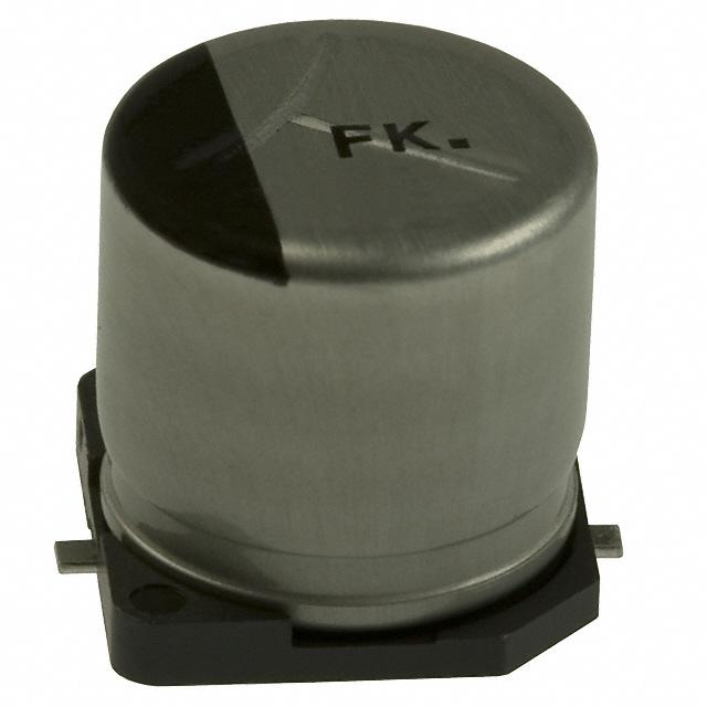

Aluminum Electrolytic Capacitor/FK series Surface Mount Type Series: FK Type : V n Features Country of Origin Endurance: 2000 to 5000h at105°C Low impedance (40 to 60% less than FCseries) Miniaturization(30 to 50% less than FC series) Vibration-proof product is available upon request.(f8 < =) Japan n Specifications Category temp. range -55 to +105°C 6.3 to 100V .DC 3.3 to 6800 µ F ±20 % (120Hz/+20°C) Rated W.V. Range Nominal Cap. Range Capacitance Tolerance DC Leakage Current I dia.12.5 and suffix “G” in dia.8 to 10mm are 5000 hours)the capacitors shall meet the limits specified below. post-test requirement at +20°C. Endurance Capacitance change ±30% of initial measured value (Suffix “G” is 35%) < 200 % of initial specified value (Suffix “G” is 300%) tan d = < DC leakage current = initial specified value After storage for 1000hours at +105±2 °C with no voltage applied and then being stabilized at +20°C, capacitors shall meet the limits specified in Endurance.(With voltage treatment) After reflow soldering ( Refer to the "Application Guide" for recommended temperature profile.) and then being stabilized at +20°C, capacitor shall meet the following limits. Capacitance change ±10% of initial measured value < initial specified value D.F. tan d = < initial specified value DC leakage current = Resistance to Soldering Heat n Marking n Dimensions Example.16V10µF Marking color : BLACK in mm (not to scale) ( ) reference size A±0.2 0.3 max (I) Shelf Life C FK Series identification Size code Lot number >f12.5) (= W.V. code Capacitance (µF) Negative polarity marking FK Series identification Lot number W.V. code V 6.3 10 16 25 35 Code j A C E V V Code 50 H 63 J 80 K 100 2A (P) B~G=L ±0.3 H~K=L±0.5 D L B 4.0 5.8 C 5.0 5.8 D 6.3 5.8 D8 6.3 7.7 E 8.0 6.2 w A,B H max. I W (I) Negative polarity marking B±0.2 Capacitance (µF) 10 fD±0.5 W.V. code P K 4.3 5.5 1.8 0.65±0.1 1.0 0.35 -0.20 to +0.15 5.3 6.5 2.2 0.65±0.1 1.5 0.35 -0.20 to +0.15 6.6 7.8 2.6 0.65±0.1 1.8 0.35 -0.20 to +0.15 6.6 7.8 2.6 0.65±0.1 1.8 0.35 -0.20 to +0.15 8.3 9.5 3.4 0.65±0.1 2.2 0.35 -0.20 to +0.15 8.3 F 8.0 10.2 10.0 3.4 0.90±0.2 3.1 0.70 ±0.20 G 10.0 10.2 10.3 12.0 3.5 0.90±0.2 4.6 0.70 ±0.20 H13 12.5 13.5 13.5 15.0 4.7 0.90±0.3 4.4 0.70 ±0.30 J16 16.0 16.5 17.0 19.0 5.5 1.20±0.3 6.7 0.70 ±0.30 K16 18.0 16.5 19.0 21.0 6.7 1.20±0.3 6.7 0.70 ±0.30 Design and specifications are subject to change without notice. Ask factory for technical specifications before purchase and/or use. Whenever a doubt about safety arises from this product, please contact us immediately for technical consultation. Aluminum Electrolytic Capacitor/FK series Impedance;(W/100kHz,+20°C), Ripple current;(mA r.m.s./100kHz+105°C) n Case size VS Capacitance, Impedance and Ripple current W.V. Capacitance Size (µF) 10 22 33 47 68 100 150 220 330 470 680 1000 1500 2200 3300 4700 6800 W.V. Capacitance (µF) 4.7 10 22 33 47 68 100 150 220 330 390 470 680 1000 1500 2200 3300 W.V. Capacitance (µF) 6.3 Impedance Ripple current B 1.35 90 C(B) 0.7(1.35) 160(90) D(C) 0.36(0.7) 240(160) D 0.36 240 D8 E 0F 0.34 0.26 0.16 280 300 600 0F 0G 0.16 0.08 600 850 H13 0.06 1100 J16 0.035 1800 25 10 Size Impedance Ripple current B C(B) 1.35 0.7(1.35) 90 160(90) D D8 E 0F 0.36 0.34 0.26 0.16 240 280 300 600 0F 0F 0G 0.16 0.16 0.08 600 600 850 H13 0.06 1100 J16 K16 0.035 1800 2060 Size Impedance 0.033 35 Size Impedance Ripple current B C D(C) 1.35 0.7 0.36(0.7) 90 160 240(160) B C(B) C D 1.35 0.7(1.35) 0.7 0.36 Ripple current 90 160(90) 160 240 D D D8 E 0F 0F 0F 0.36 0.36 0.34 0.26 0.16 0.16 0.16 240 240 280 300 600 600 600 D D8 D8 0F 0F 0F 0G 0.36 0.34 0.34 0.16 0.16 0.16 0.08 240 280 280 600 600 600 850 0G 0.08 850 H13 0.06 1100 H13 H13 J16 J16 0.06 0.06 0.035 0.035 1100 1100 1800 1800 J16 K16 0.035 0.033 1800 2060 63 16 Size Impedance B C(B) 1.35 0.7(1.35) Ripple current 90 160(90) D(C) D D D8 D8 E 0F 0.36(0.7) 0.36 0.36 0.34 0.34 0.26 0.16 240(160) 240 240 280 280 300 600 0F 0G 0.16 0.08 600 850 H13 0.06 1100 J16 K16 0.035 0.033 1800 Size Impedance B D(C) D D8 E E(D8) 2.9 0.88(1.52) 0.88 0.68 0.68 0.68 Ripple current 60 165(85) 165 195 195 195 0F 0.34 350 0G 0G H13 H13 J16 J16 J16 0.18 0.18 0.12 0.12 0.073 0.073 0.073 670 670 900 900 1610 1610 1610 50 80 100 Size Impedance Ripple current 4.7 C 3 50 D 10 D 1.5 80 D8 E 2.4 60 3.3 2060 Size Impedance C 5 Ripple current 25 3 40 2.4 60 Size Impedance Ripple current F 1.3 130 D8 1.2 120 F 1.3 130 E 1.2 120 F 1.3 130 33 F 0.65 250 F 1.3 130 G 0.7 200 47 F 0.65 250 G 0.7 200 H13 0.32 500 68 F 0.65 250 H13 0.32 500 H13 0.32 500 100 G 0.35 400 H13 0.32 500 J16 0.17 793 150 H13 0.16 800 H13 0.32 500 J16 0.17 793 220 H13 0.16 800 K16 0.153 917 K16 0.153 917 22 J16 330 470 J16 K16 680 ( );Miniaturization type 0.082 1410 0.080 1690 K16 0.17 0.153 793 917 0Life time 5000h available upon request(suffix : G) Design and specifications are subject to change without notice. Ask factory for technical specifications before purchase and/or use. Whenever a doubt about safety arises from this product, please contact us immediately for technical consultation. Aluminum Electrolytic Capacitors/FK Series W.V. [V.DC] 6.3 10 16 25 Cap. [µF] 22 47 47 100 100 220 330 330 470 1000 1500 3300 6800 22 33 33 150 220 220 330 470 680 1000 2200 4700 6800 10 22 22 47 47 68 100 150 220 220 330 470 680 1500 3300 4700 10 22 33 33 47 68 100 100 150 220 330 470 1000 2200 3300 Part No. EEVFK0J220R EEVFK0J470UR EEVFK0J470R EEVFK0J101UR EEVFK0J101P EEVFK0J221P EEVFK0J331XP EEVFK0J331P EEVFK0J471P EEVFK0J102P EEVFK0J152P EEVFK0J332Q EEVFK0J682M EEVFK1A220R EEVFK1A330UR EEVFK1A330R EEVFK1A151P EEVFK1A221XP EEVFK1A221P EEVFK1A331P EEVFK1A471P EEVFK1A681P EEVFK1A102P EEVFK1A222Q EEVFK1A472M EEVFK1A682M EEVFK1C100R EEVFK1C220UR EEVFK1C220R EEVFK1C470UR EEVFK1C470P EEVFK1C680P EEVFK1C101P EEVFK1C151XP EEVFK1C221XP EEVFK1C221P EEVFK1C331P EEVFK1C471P EEVFK1C681P EEVFK1C152Q EEVFK1C332M EEVFK1C472M EEVFK1E100R EEVFK1E220R EEVFK1E330UR EEVFK1E330P EEVFK1E470P EEVFK1E680P EEVFK1E101XP EEVFK1E101P EEVFK1E151P EEVFK1E221P EEVFK1E331P EEVFK1E471P EEVFK1E102Q EEVFK1E222M EEVFK1E332M tan d 0.26 0.26 0.26 0.26 0.26 0.26 0.26 0.26 0.26 0.26 0.26 0.30 0.36 0.19 0.19 0.19 0.19 0.19 0.19 0.19 0.19 0.49 0.19 0.21 0.25 0.29 0.16 0.16 0.16 0.16 0.16 0.16 0.16 0.16 0.16 0.16 0.16 0.16 0.16 0.16 0.20 0.22 0.14 0.14 0.14 0.14 0.14 0.14 0.14 0.14 0.14 0.14 0.14 0.14 0.14 0.16 0.18 R.C. [mA rms] 90 90 160 160 240 240 280 300 600 600 850 1100 1800 90 90 160 240 280 300 600 600 600 850 1100 1800 2060 90 90 160 160 240 240 240 280 280 300 600 600 850 1100 1800 2060 90 160 160 240 240 240 280 300 600 600 600 850 1100 1800 2060 Imp./ESR [o] 1.35 1.35 0.70 0.70 0.36 0.36 0.34 0.26 0.16 0.16 0.080 0.060 0.035 1.35 1.35 0.70 0.36 0.34 0.26 0.16 0.16 0.16 0.080 0.060 0.035 0.033 1.35 1.35 0.70 0.70 0.36 0.36 0.36 0.34 0.34 0.26 0.16 0.16 0.08 0.060 0.035 0.033 1.35 0.70 0.70 0.36 0.36 0.36 0.34 0.26 0.16 0.16 0.16 0.080 0.060 0.035 0.033 Size D 4 4 5 5 6.3 6.3 6.3 8 8 8 10 12.5 16 4 4 5 6.3 6.3 8 8 8 8 10 12.5 16 18 4 4 5 5 6.3 6.3 6.3 6.3 6.3 8 8 8 10 12.5 16 18 4 5 5 6.3 6.3 6.3 6.3 8 8 8 8 10 12.5 16 18 L 5.8 5.8 5.8 5.8 5.8 5.8 7.7 6.2 10.2 10.2 10.2 13.5 16.5 5.8 5.8 5.8 5.8 7.7 6.2 10.2 10.2 10.2 10.2 13.5 16.5 16.5 5.8 5.8 5.8 5.8 5.8 5.8 5.8 7.7 7.7 6.2 10.2 10.2 10.2 13.5 16.5 16.5 5.8 5.8 5.8 5.8 5.8 5.8 7.7 6.2 10.2 10.2 10.2 10.2 13.5 16.5 16.5 W.V. [V.DC] 35 50 63 80 100 Cap. [µF] 4.7 10 10 22 33 47 68 100 100 150 220 330 470 680 1000 1500 4.7 10 10 22 33 33 47 47 100 150 220 330 680 1000 4.7 10 22 22 33 47 68 100 150 220 470 680 3.3 4.7 10 10 22 33 47 68 100 150 330 470 22 33 47 68 100 150 220 330 Part No. EEVFK1V4R7R EEVFK1V100UR EEVFK1V100R EEVFK1V220R EEVFK1V330P EEVFK1V470P EEVFK1V680XP EEVFK1V101XP EEVFK1V101P EEVFK1V151P EEVFK1V221P EEVFK1V331P EEVFK1V471Q EEVFK1V681Q EEVFK1V102M EEVFK1V152M EEVFK1H4R7R EEVFK1H100UR EEVFK1H100P EEVFK1H220P EEVFK1H330XP EEVFK1H330P EEVFK1H470XP EEVFK1H470P EEVFK1H101P EEVFK1H151P EEVFK1H221P EEVFK1H331Q EEVFK1H681M EEVFK1H102M EEVFK1J4R7R EEVFK1J100P EEVFK1J220XP EEVFK1J220P EEVFK1J330P EEVFK1J470P EEVFK1J680P EEVFK1J101P EEVFK1J151Q EEVFK1J221Q EEVFK1J471M EEVFK1J681M EEVFK1K3R3R EEVFK1K4R7P EEVFK1K100XP EEVFK1K100P EEVFK1K220P EEVFK1K330P EEVFK1K470P EEVFK1K680Q EEVFK1K101Q EEVFK1K151Q EEVFK1K331M EEVFK1K471M EEVFK2A220P EEVFK2A330P EEVFK2A470Q EEVFK2A680Q EEVFK2A101M EEVFK2A151M EEVFK2A221M EEVFK2A331M tan d 0.12 0.12 0.12 0.12 0.12 0.12 0.12 0.12 0.12 0.12 0.12 0.12 0.12 0.12 0.12 0.12 0.10 0.10 0.10 0.10 0.10 0.10 0.10 0.10 0.10 0.10 0.10 0.10 0.10 0.10 0.08 0.08 0.08 0.08 0.08 0.08 0.08 0.08 0.08 0.08 0.08 0.08 0.08 0.08 0.08 0.08 0.08 0.08 0.08 0.08 0.08 0.08 0.08 0.08 0.07 0.07 0.07 0.07 0.07 0.07 0.07 0.07 R.C. [mA rms] 90 90 160 160 240 240 280 280 600 600 600 850 1100 1100 1800 1800 60 85 165 165 195 195 195 195 350 670 670 900 1610 1610 50 80 120 120 250 250 400 400 800 800 1410 1690 25 40 60 60 130 130 200 500 500 500 793 917 130 200 500 500 793 793 917 917 Imp./ESR [o] 1.35 1.35 0.70 0.70 0.36 0.36 0.34 0.34 0.16 0.16 0.16 0.080 0.060 0.060 0.035 0.035 2.90 1.52 0.88 0.88 0.68 0.68 0.68 0.68 0.34 0.18 0.18 0.12 0.073 0.073 3.00 1.50 1.20 1.20 0.65 0.65 0.35 0.35 0.16 0.16 0.082 0.080 5.00 3.00 2.40 2.40 1.30 1.30 0.70 0.32 0.32 0.32 0.17 0.153 1.30 0.70 0.32 0.32 0.17 0.17 0.153 0.153 Size D 4 4 5 5 6.3 6.3 6.3 6.3 8 8 8 10 12.5 12.5 16 16 4 5 6.3 6.3 6.3 8 6.3 8 8 10 10 12.5 16 16 5 6.3 6.3 8 8 8 10 10 12.5 12.5 16 18 5 6.3 6.3 8 8 8 10 12.5 12.5 12.5 16 18 8 10 12.5 12.5 16 16 18 18 L 5.8 5.8 5.8 5.8 5.8 5.8 7.7 7.7 10.2 10.2 10.2 10.2 13.5 13.5 16.5 16.5 5.8 5.8 5.8 5.8 7.7 6.2 7.7 6.2 10.2 10.2 10.2 13.5 16.5 16.5 5.8 5.8 7.7 6.2 10.2 10.2 10.2 10.2 13.5 13.5 16.5 16.5 5.8 5.8 7.7 6.2 10.2 10.2 10.2 13.5 13.5 13.5 16.5 16.5 10.2 10.2 13.5 13.5 16.5 16.5 16.5 16.5 Tan a = at 120Hz/+20°C Ripple current = at 100kHz/+105°C Impedance/ESR = at 100kHz/+20°C Design and specifications are subject to change without notice. Ask factory for technical specifications before purchase and/or use. Whenever a doubt about safety arises from this product, please contact us immediately for technical consultation. Aluminum Electrolytic Capacitors/FK Series ■ Frequency Characteristics (Impedance) ● 16WV 1000 EEVFK1V4R7R (35V4.7µF, ø4x5.8) EEVFK1V470P (35V47µF, ø6.3x5.8) EEVFK1V221P (35V220µF, ø8x10.2) EEVFK1V331P (35V330µF, ø10x10.2) at 20Ǜ 100 100 10 10 1 1 0.1 0.1 0.01 0.01 0.1 1 10 100 Frequency (kHz) 1000 0.1 10000 1 10 100 1000 10000 Frequency (kHz) ● 63WV ● 80WV EEVFK1J4R7R (63V4.7µF, ø5x5.8) EEVFK1J100P (63V10µF, ø6.3x5.8) EEVFK1J330P (63V47µF, ø8x10.2) EEVFK1J101P (63V100µF, ø10x10.2) EEVFK1J471M (63V470µF, ø16x16.5) EEVFK1J681M (63V680µF, ø18x16.5) 1000 at 20Ǜ EEVFK1K3R3R (80V3.3µF, ø5x5.8) EEVFK1K4R7P (80V4.7µF, ø6.3x5.8) EEVFK1K330P (80V33µF, ø8x10.2) EEVFK1K470P (80V47µF, ø10x10.2) EEVFK1K331M (80V330µF, ø16x16.5) EEVFK1K471M (80V470µF, ø18x16.5) 1000 100 100 10 10 Impedance (Ω) Impedance (Ω) at 20Ǜ 1000 Impedance (Ω) Impedance (Ω) ● 35WV EEVFK1C100R (16V10µF, ø4x5.8) EEVFK1C220R (16V22µF, ø5x5.8) EEVFK1C470P (16V47µF, ø6.3x5.8) EEVFK1C221P (16V220µF, ø8x6.2) EEVFK1C471P (16V470µF, ø8x10.2) EEVFK1C681P (16V680µF, ø10x10.2) EEVFK1C152Q (16V1500µF, ø12.5x13.5) 1 at 20Ǜ 1 0.1 0.1 0.01 0.01 0.1 1 10 100 Frequency (kHz) 1000 10000 0.1 1 10 100 1000 10000 Frequency (kHz) Design and specifications are subject to change without notice. Ask factory for technical specifications before purchase and/or use. Whenever a doubt about safety arises from this product, please contact us immediately for technical consultation. Aluminum Electrolytic Capacitors/FK Series ■ Frequency Characteristics (ESR) ● 16WV ● 35WV EEVFK1C100R (16V10µF, ø4x5.8) EEVFK1C220R (16V22µF, ø5x5.8) EEVFK1C470P (16V47µF, ø6.3x5.8) EEVFK1C221P (16V220µF, ø8x6.2) EEVFK1C471P (16V470µF, ø8x10.2) EEVFK1C681P (16V680µF, ø10x10.2) EEVFK1C152Q (16V1500µF, ø12.5x13.5) 1000 EEVFK1V4R7R (35V4.7µF, ø4x5.8) EEVFK1V470P (35V47µF, ø6.3x5.8) EEVFK1V221P (35V220µF, ø8x10.2) EEVFK1V331P (35V330µF, ø10x10.2) at 20Ǜ at 20Ǜ 1000 100 10 10 E.S.R. (Ω) E.S.R. (Ω) 100 1 1 0.1 0.1 0.01 0.01 0.1 1 10 100 1000 0.1 10000 1 10 100 1000 10000 Frequency (kHz) Frequency (kHz) ● 63WV ● 80WV EEVFK1J4R7R (63V4.7µF, ø5x5.8) EEVFK1J100P (63V10µF, ø6.3x5.8) EEVFK1J330P (63V47µF, ø8x10.2) EEVFK1J101P (63V100µF, ø10x10.2) EEVFK1J471M (63V470µF, ø16x16.5) EEVFK1J681M (63V680µF, ø18x16.5) 1000 EEVFK1K3R3R (80V3.3µF, ø5x5.8) EEVFK1K4R7P (80V4.7µF, ø6.3x5.8) EEVFK1K330P (80V33µF, ø8x10.2) EEVFK1K470P (80V47µF, ø10x10.2) EEVFK1K331M (80V330µF, ø16x16.5) EEVFK1K471M (80V470µF, ø18x16.5) at 20Ǜ at 20Ǜ 1000 100 10 10 E.S.R. (Ω) E.S.R. (Ω) 100 1 1 0.1 0.1 0.01 0.01 0.1 1 10 100 Frequency (kHz) 1000 10000 0.1 1 10 100 1000 10000 Frequency (kHz) Design and specifications are subject to change without notice. Ask factory for technical specifications before purchase and/or use. Whenever a doubt about safety arises from this product, please contact us immediately for technical consultation. Aluminum Electrolytic Capacitors/FK Series ■ Temperature Characteristics ● ø6.3 x 5.8 EEVFK0J101R (6.3V100µF, ø6.3x5.8) EEVFK1C470P (16V47µF, ø6.3x5.8) EEVFK1J100P (63V10µF, ø6.3x5.8) EEVFK1K4R7P (80V4.7µF, ø6.3x5.8) 20 EEVFK0J101R (6.3V100µF, ø6.3x5.8) EEVFK1C470P (16V47µF, ø6.3x5.8) EEVFK1J100P (63V10µF, ø6.3x5.8) EEVFK1K4R7P (80V4.7µF, ø6.3x5.8) at 120Hz 10 4 0 3 D.F. Capacitance Change (%) at 120Hz 5 -10 2 -20 1 -30 -40 0 -60 -40 -20 0 20 40 60 Temperature (Ǜ) 80 100 120 -60 -40 -20 0 20 40 60 Temperature (Ǜ) 80 100 120 ● ø8 x 10.2 EEVFK0J102P (6.3V1000µF, ø8x10.2) EEVFK1V221P (35V220µF, ø8x10.2) EEVFK1J470P (63V33µF, ø8x10.2) EEVFK1K330P (80V33µF, ø8x10.2) 20 EEVFK0J102P (6.3V1000µF, ø8x10.2) EEVFK1V221P (35V220µF, ø8x10.2) EEVFK1J470P (63V33µF, ø8x10.2) EEVFK1K330P (80V33µF, ø8x10.2) at 120Hz 10 4 0 3 D.F. Capacitance Change (%) at 120Hz 5 -10 2 -20 1 -30 -40 0 -60 -40 -20 0 20 40 Temperature (Ǜ) 60 80 100 120 -60 -40 -20 0 20 40 60 Temperature (Ǜ) 80 100 120 Design and specifications are subject to change without notice. Ask factory for technical specifications before purchase and/or use. Whenever a doubt about safety arises from this product, please contact us immediately for technical consultation. Aluminum Electrolytic Capacitors/FK Series ■ Load Life Capacitance Change (%) EEVFK0J220R (6.3V22µF, ø4x5.8) EEVFK0J101P (6.3V100µF, ø6.3x5.8) EEVFK0J152P (6.3V1500µF, ø10x10.2) at 105ºC 10 0 -10 -20 -30 -40 -50 0 500 1000 1500 2000 2500 3000 3500 2000 2500 3000 3500 2000 2500 3000 3500 Time (h) 1 D.F. 0.8 0.6 0.4 0.2 0 0 500 1000 1500 Leakage Current (µA) Time (h) 10 8 6 4 2 0 0 500 1000 1500 Time (h) Design and specifications are subject to change without notice. Ask factory for technical specifications before purchase and/or use. Whenever a doubt about safety arises from this product, please contact us immediately for technical consultation.
EEV-FK1A102P
物料型号:Panasonic FK系列铝电解电容器,为贴片式电容器。
器件简介:FK系列电容器具有以下特点: - 耐久性:在105°C下可工作2000至5000小时。 - 低阻抗:比FC系列低40%至60%。 - 迷你化:体积比FC系列小30%至50%。 - 可应要求提供防振产品。
引脚分配:文档中未明确提供引脚分配信息,但通常贴片电容器不需要特别的引脚分配说明。
参数特性: - 工作温度范围:-55°C至+105°C。 - 额定工作电压范围:6.3V至100V DC。 - 标称电容范围:3.3μF至6800μF。 - 电容公差:+20%(在120Hz/+20°C下)。 - 直流漏电流:在+20°C下,应用额定工作电压2分钟后,为0.01CV或3μA(以较大者为准)。
功能详解: - tanδ:请参考附带的标准产品列表。 - 低温特性:在不同温度下,电容器的阻抗比在120Hz时的比值。 - 耐久性:在+105°C下,电容器在额定工作电压下工作2000小时(直径12.5mm及以上的“G”系列为5000小时)后,应满足特定要求。
应用信息:文档中未提供具体的应用案例,但铝电解电容器通常用于电源滤波、信号耦合等。
封装信息:提供了不同尺寸代码对应的尺寸和最大高度等信息,例如: - 尺寸代码B:直径4.0mm,长度5.8mm,最大高度1.8mm。
