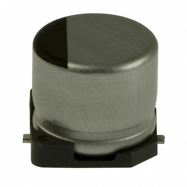

    33 µF 35 V 铝电解电容器 径向,Can - SMD 105°C 时为 1000 小时
EEV-HA1V330WP 数据手册
Aluminum Electrolytic Capacitors/HA Series Surface Mount Type Series : HA Long life Series : ■ Features ● Life time: 105°C 1000 h ● 5.5 mm height ( Yφ6 . 3 ) HA ↑ Series : VS ■ Specifications Operating Temp.Range Rated W.V.Range -40 to +105°C 6.3 to 100 V .DC Nominal Cap.Range Capacitance Tolerance 0.1 to 1500µF ± 20 % (120Hz/+20°C) I Y= 0.01 CV or 3(µA) after 2 minutes (Whichever is greater) D.C. Leakage Current Dissipation Factor (tan £) Refer to standard products table. W.V. (V) -25 / +20 °C -40 / +20 °C Characteristics at Low Temperature 6.3 4 8 10 3 6 16 2 4 25 2 4 35 2 3 50 2 3 63 3 4 100 3 4 (Impedance ratio max at 120 Hz ) Af ter applying rated working voltage for 1000 hours for B~D size, 2000 hours for E~G size at +105°C and then being stabilized at +20°C, capacitors shall meet the following limits . Endurance Capacitance change ±20% of initial measured value (±30% for E~G size of 6.3V & UP suffix) Y 200% of initial specified value (Y300% for E~G size of 6.3V & UP suffix) D.F. D.C leakage current Y=initial specified value After storage for 1000 hours at +105oC ±2°C with no voltage applied and then being stabilized at +20°C, capacitor shall meet the limits specified in “Endurance.” (With voltage treatment) Shelf Life Af ter reflow soldering (refer to Application Guidelines) and then being stabilized at +20°C, capacitor shall meet the following limits. Resistance to Soldering Heat Capacitance change ±10% of initial measured value D.F. =Y initial specified value D.C leakage current =Y=initial specified value ■ Marking ■ Dimensions in mm (not to scale) Example;50V1µF(polarized) φD±0.5 1 H HA H Negative polarity marking Series identification Lot.number (P) ] A±0.2 0.3 max K (I) (mm) Capacitance(µF) L +0.1 -0.2 w (I) W.V.code W.V.code V 6.3 10 16 25 35 50 63 100 code J A C E V H J ( )reference size E,F,G = L±0.3 2A Size H I code D L A B 4.0 5.4 4.3 5.5 MAX 1.8 C 5.0 5.4 5.3 6.5 MAX 2.2 D 6.3 5.4 6.6 7.8 MAX 2.6 D8 6.3 7.9 6.6 7.8MAX 2.6 E 8.0 6.2 8.3 9.5 MAX 3.4 F 8.0 10.2 8.3 10.0MAX 3.4 G 10.0 10.2 10.312.0MAX 3.5 W P 0.65 ± 0.1 1.0 0.65±0.1 1.5 0.65±0.1 1.8 0.65±0.1 1.8 0.65±0.1 2.2 0.90±0.2 3.1 0.90±0.2 4.6 K +0.15 0.35 -0.20 +0.15 0.35 -0.20 0.35 +0.15 -0.20 0.35 +0.15 -0.20 0.35 ±0.2 0.70 ±0.2 0.70 ±0.2 ■ Case size ● Polarized ïKîK `~éKE¨cF MKN MKOO MKPP MKQT NKM OKO PKP QKT NM OO PP QT NMM OOM PPM QTM NMMM NRMM 10 SKP EMgF _ _ _I` `Ia a aUIc c cId d NM EN^F _ _I` ` aIb aUIc cId d NS EN`F _ _I` ` `Ia a aUIcId cId cId OR ENbF _ _I` `Ia `Ia aIb bIc cId cId d PR ENsF _ _I` `Ia aIb bIc aUIcId cId d RM ENeF _ _ _ _ _ _ _ ` a b aUIbIc aUIcId cId d SP ENgF b bIc d cId NMM EO^F b bIc c cId d Design and specifications are subject to change without notice. Ask factory for technical specifications before purchase and/or use. Whenever a doubt about safety arises from this product, please contact us immediately for technical consultation. Aluminum Electrolytic Capacitors/HA Series ■ Standard Products tKsK `~éK xsKa`z x¨cz bbse^MgOOMo bbse^MgPPMto bbse^MgQTMto QT bbse^MgQTMo bbse^MgNMNto NMM bbse^MgNMNm OOM bbse^MgOONtm bbse^MgPPNum PPM bbse^MgPPNm QTM bbse^MgQTNrm bbse^MgNMOrm= NMMM bbse^MgNMOm NRMM bbse^MgNROm OO bbse^N^OOMto bbse^N^PPMto PP bbse^N^PPMo QT bbse^N^QTMto bbse^N^NMNtm NMM bbse^N^NMNm bbse^N^OONum OOM bbse^N^OONm bbse^N^QTNrm QTM bbse^N^QTNm NMMM bbse^N^NMOm NM bbse^N`NMMo bbse^N`OOMto OO bbse^N`OOMo PP bbse^N`PPMto bbse^N`QTMto QT bbse^N`QTMm NMM bbse^N`NMNtm bbse^N`OONum OOM bbse^N`OONrm bbse^N`OONm bbse^N`PPNrm PPM bbse^N`PPNm bbse^N`QTNrm QTM bbse^N`QTNm QKT bbse^NbQoTo bbse^NbNMMto NM bbse^NbNMMo bbse^NbOOMto OO bbse^NbOOMm bbse^NbPPMto PP bbse^NbPPMm bbse^NbQTMtm QT bbse^NbQTMm bbse^NbNMNrm NMM bbse^NbNMNm bbse^NbOONrm OOM bbse^NbOONm OO PP SKP NM NS OR m~êí=kçK í~å=£ MKPM MKPR MKPR MKPM MKPR MKPM MKPR MKPM MKPR MKPR MKPR MKPR MKPR MKPM MKPM MKOO MKPM MKPM MKOS MKOO MKOS MKOS MKOS MKOS MKNS MKOS MKNS MKOS MKOS MKNS MKOS MKNS MKOM MKOM MKOM MKOM MKOM MKOM MKNQ MKOM MKNQ MKOM MKNQ MKOM MKNQ MKOM MKNS MKNS MKNS MKNS MKNS oK`K xã^=êãëz OV OV PS QS QT TN TQ NMR OPM PMM PMM QMM QUM OU OV QP QP TM NNM NMR NSM OMM OTM RUM OU OU PV PR PV TM TM NMR NRM ONM NTM OPM NVM PQM OO OO OU PR RR QO SR TM VN VN NPM NSM NVM páòÉ=xããz a i Q RKQ Q RKQ Q RKQ R RKQ R RKQ SKP RKQ SKP RKQ SKP TKV U NMKO U NMKO U NMKO NM NMKO NM NMKO Q RKQ Q RKQ R RKQ R RKQ SKP RKQ U SKO SKP TKV U NMKO U NMKO NM NMKO NM NMKO Q RKQ Q RKQ R RKQ R RKQ R RKQ SKP RKQ SKP RKQ SKP TKV U NMKO NM NMKO U NMKO NM NMKO U NMKO NM NMKO Q RKQ Q RKQ R RKQ R RKQ SKP RKQ R RKQ SKP RKQ SKP RKQ U SKO U SKO U NMKO U NMKO NM NMKO tKsK `~éK xsKa`z x¨cz OR PR RM SP NMM m~êí=kçK bbse^NbPPNrm bbse^NbPPNm QTM bbse^NbQTNm QKT bbse^NsQoTo bbse^NsNMMto NM bbse^NsNMMo bbse^NsOOMto OO bbse^NsOOMm bbse^NsPPMtm PP bbse^NsPPMm bbse^NsQTMrm QT bbse^NsQTMm bbse^NsNMNum NMM bbse^NsNMNrm bbse^NsNMNm bbse^NsOONrm OOM bbse^NsOONm PPM bbse^NsPPNm MKN bbse^NeoNMo MKOO bbse^NeoOOo MKPP bbse^NeoPPo MKQT bbse^NeoQTo bbse^NeNoMo N OKO bbse^NeOoOo PKP bbse^NePoPo QKT bbse^NeQoTo NM bbse^NeNMMm OO bbse^NeOOMm bbse^NePPMum PP bbse^NePPMrm bbse^NePPMm bbse^NeQTMum QT bbse^NeQTMrm bbse^NeQTMm bbse^NeNMNrm NMM bbse^NeNMNm OOM bbse^NeOONm NM bbse^NgNMMm bbse^NgOOMrm OO bbse^NgOOMm PP bbse^NgPPMm bbse^NgQTMrm QT bbse^NgQTMm PKP bbse^O^PoPm bbse^O^QoTrm QKT bbse^O^QoTm NM bbse^O^NMMm bbse^O^OOMrm OO bbse^O^OOMm PP bbse^O^PPMm PPM í~å=£ MKNS MKNS MKNS MKNO MKNS MKNO MKNS MKNO MKNS MKNQ MKNQ MKNQ MKNO MKNQ MKNQ MKNQ MKNQ MKNQ MKNO MKNO MKNO MKNO MKNO MKNO MKNO MKNO MKNO MKNO MKNO MKNO MKNO MKNO MKNO MKNO MKNO MKNO MKNO MKNU MKNU MKNU MKNU MKNU MKNU MKNU MKNU MKNU MKNU MKNU MKNU MKNU oK`K xã^=êãëz NUM PQM PSM OO OO PM PR SM QO UQ UQ VU UQ NOM NSM NTM ONM ORM N O P R NM NS NS OP PR TM SM TM VN SP VR NMM NNM NOM NRM OR PM PM QR RM RM PM PM RM RR RR SM SR páòÉ=xããz a i U NMKO NM NMKO NM NMKO Q RKQ Q RKQ R RKQ R RKQ SKP RKQ SKP RKQ U SKO U SKO U NMKO SKP TKV U NMKO NM NMKO U NMKO NM NMKO NM NMKO Q RKQ Q RKQ Q RKQ Q RKQ Q RKQ Q RKQ Q RKQ R RKQ SKP RKQ U SKO SKP TKV U SKO U NMKO SKP TKV U NMKO NM NMKO U NMKO NM NMKO NM NMKO U SKO U SKO U NMKO NM NMKO U NMKO NM NMKO U SKO U SKO U NMKO U NMKO U NMKO NM NMKO NM NMKO tan £ = at 120Hz/+20oC, Ripple current = at 120Hz/+105oC Design and specifications are subject to change without notice. Ask factory for technical specifications before purchase and/or use. Whenever a doubt about safety arises from this product, please contact us immediately for technical consultation. 11 Aluminum Electrolytic Capacitors/HA Series ■ Temperature Characteristics Data ■ Load Life Data 12 Design and specifications are subject to change without notice. Ask factory for technical specifications before purchase and/or use. Whenever a doubt about safety arises from this product, please contact us immediately for technical consultation. Aluminum Electrolytic Capacitors/HA Series ■ Frequency Characteristics Data Design and specifications are subject to change without notice. Ask factory for technical specifications before purchase and/or use. Whenever a doubt about safety arises from this product, please contact us immediately for technical consultation. 13 Aluminum Electrolytic Capacitors/HA Series ■ Temperature Characteristics Data 14 Design and specifications are subject to change without notice. Ask factory for technical specifications before purchase and/or use. Whenever a doubt about safety arises from this product, please contact us immediately for technical consultation.

物料型号:Panasonic HA系列铝电解电容器,有多种额定工作电压(W.V.)和电容值(Cap.)的型号。
器件简介:HA系列是贴片式铝电解电容器,设计用于长寿命和高温操作环境。
引脚分配:文档中未明确提供引脚分配信息,但通常这类电容器会有正负极性标记。
参数特性: - 工作温度范围:-40至+105°C - 额定工作电压范围:6.3至100V DC - 标称电容范围:0.1至1500μF - 电容公差:±20%(在120Hz/+20°C时) - 直流漏电流:I ≤ 0.01 CV或3μA(取较大者),2分钟后测量 - 损耗因子(tan δ):请参考标准产品表
功能详解: - 低温特性:在不同温度和额定工作电压下,电容器的阻抗比最大值。 - 耐久性:在+105°C下,B-D尺寸的电容器经过1000小时、E-G尺寸的电容器经过2000小时的额定工作电压测试后,电容变化和损耗因子需满足特定限制。 - 储存寿命:在+105°C下储存1000小时后,电容器需满足耐久性测试的限制。 - 耐焊热性:在经历回流焊接后,电容器需满足特定限制。
应用信息:适用于需要长寿命和高温操作环境的电子设备。
封装信息:提供了不同尺寸代码的电容器尺寸,包括直径(D)、长度(L)、宽度(W)、高度(H)等。
